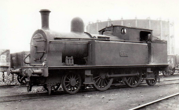

How about Irelands largest class of 2-4-2T GSR F1 & 2? Class F 1 - 438 - D&SER 2-4-2T - built 1909 by Grand Canal Street Works as No.30 ST IBERIUS - 1925 to GSR as No.438 - 1930 rebuilt with round top boiler, 1933 rebuilt with Belpaire boiler, 1937 rebuilt with round top bolier, 1945 to CIE - withdrawn 1952. Large choice of livery DSER lined black, GSR Gray, CIE lined green worked Dublin suburban trains from the early 1900s to the 1950s, one seems to have been a long term resident on the West Cork another loaned to the BCDR during the Second World War.
