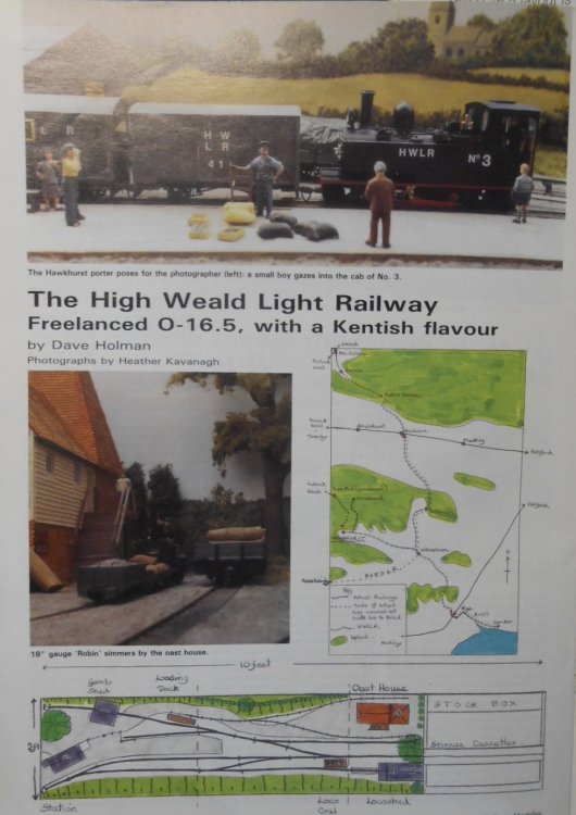

David Holman Posted April 27, 2020 Author Posted April 27, 2020 Seem to remember the track plan mostly evolved around the use of Y points, rather than the usual left or right. In Cyril Freezer's booklet on track plans for small spaces (mine is priced 2/6, which dates me somewhat), at the back are 10 generic plans where he showed how a six foot terminus could be reduced to 4' 6" by using all Y points. The result is contrived to say the least, but Y points can be useful. On Belmullet, the turnout to the goods shed is a Y, but the Marcway version, where the distance from the toe to the clearance point is just 12" on a 6' radius point. A Peco Y in 0 gauge is the same as as left or right hand point, where the distance from toe to clearance is more like me 18". So, used carefully, Y points can be good space savers, likewise slips and three ways, though these were much less common in Ireland where space mostly wasn't a problem. 1
