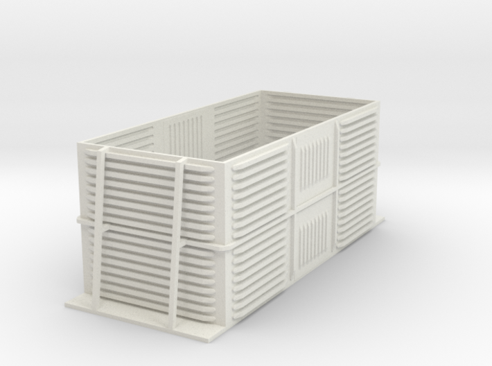

Noel Posted May 14, 2017 Author Share Posted May 14, 2017 Thanks for the info Richard. Personally so far I have only tried beat wagons and a 121 body, but keen to hear how others found 3D especially for 00. I wondered why some model bodies are not printed in multiple pieces instead of one, as it may use less material and reduce surface 'stepping' on curved areas of some models. 3D still seems a long way behind injection moulding for quality, but offers reasonable enough quality depending on the design for some models not available as RTR. Quote Link to comment Share on other sites More sharing options...

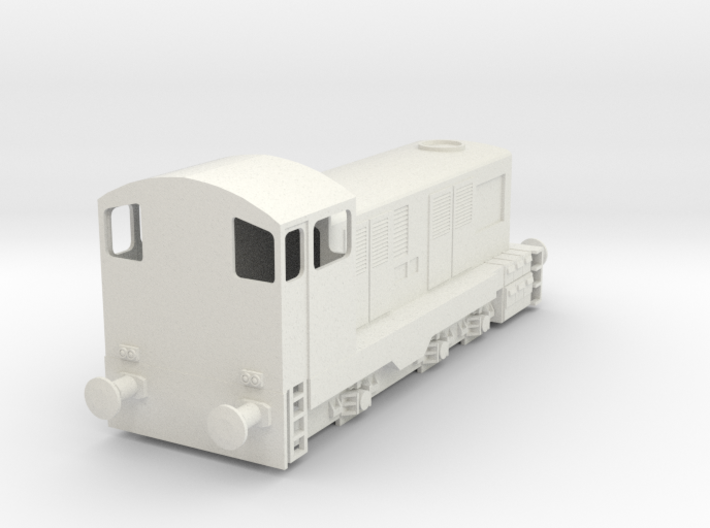

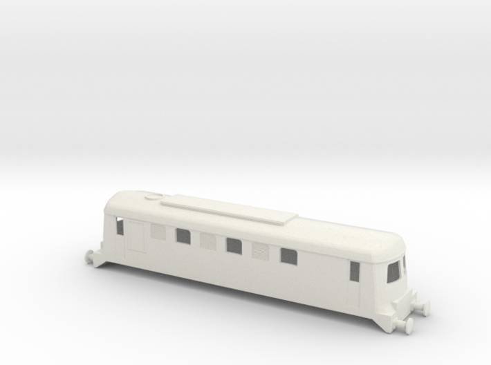

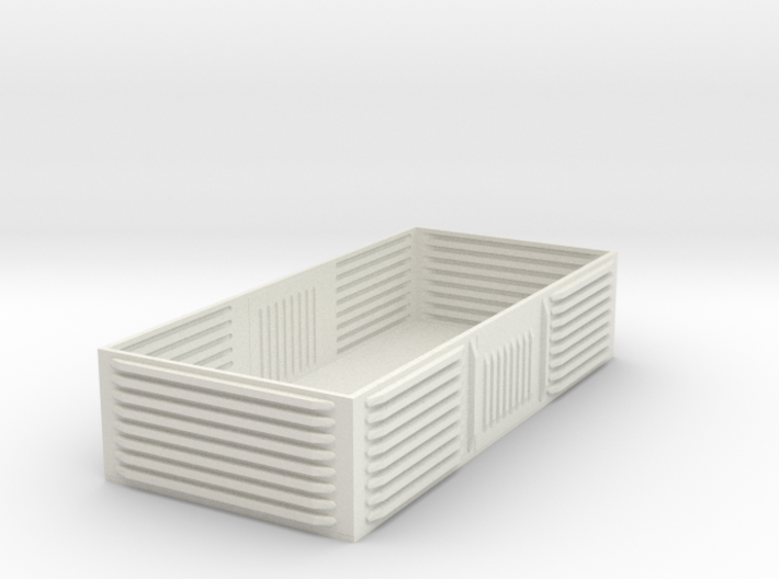

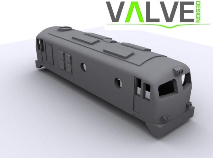

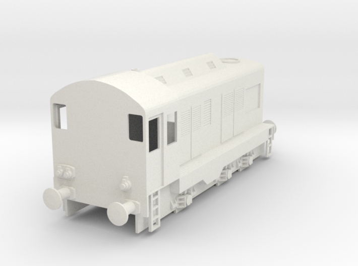

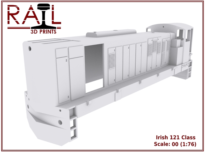

Noel Posted May 22, 2017 Author Share Posted May 22, 2017 (edited) I am awaiting feedback from a designer on the feasibility of an 00 gauge 'A class' body in 3D. Not convinced 3D stepping can be minimised on the compound curves of the A class cab roof, nor the cost of using materials suitable for higher resolution prints. Some interesting 3D prints of Irish Locos https://www.shapeways.com/product/ED2F7SGHT/cie-e-class-421-oo-scale?optionId=40683661 https://www.shapeways.com/product/TUAAF8NZS/cie-e-class-401-oo-scale?optionId=42307672 https://www.shapeways.com/product/PZZCYVXM6/cie-b-class-sulzer-locomotive-oo-scale?optionId=42321334 https://www.shapeways.com/product/S3QTQFYCT/irish-railways-121-class?optionId=57420082 E 421 class E 401 class Sulzer B113 - Looks like curves would need a lot of filing and rubbing down! 121 class Beet wagon Double beet wagon N gauge C class Edited May 22, 2017 by Noel Quote Link to comment Share on other sites More sharing options...
