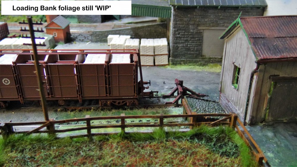

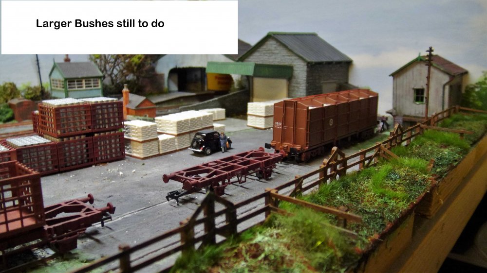

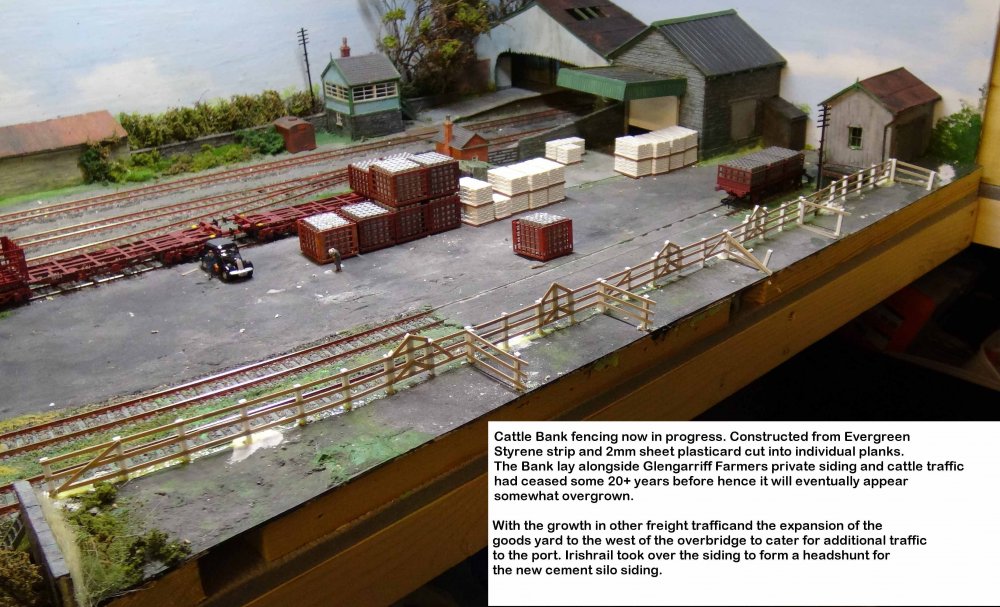

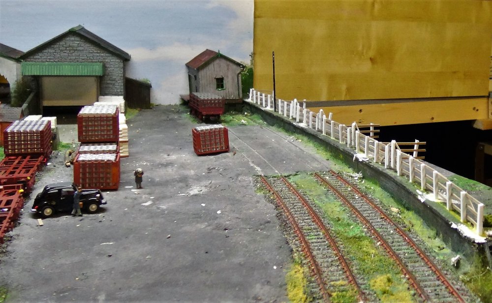

Work continues on the 'dereliction-ing'  of the cattle loading bank. I need to get the shrubbery and small trees planted.

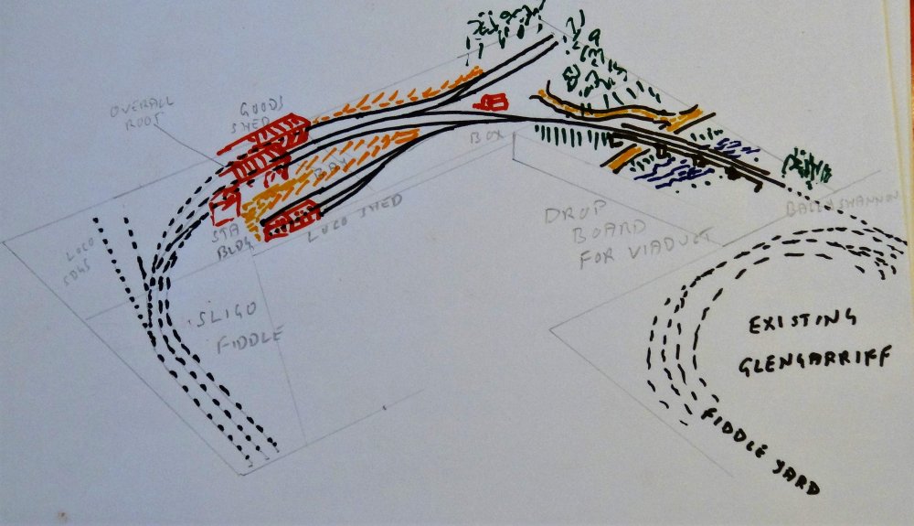

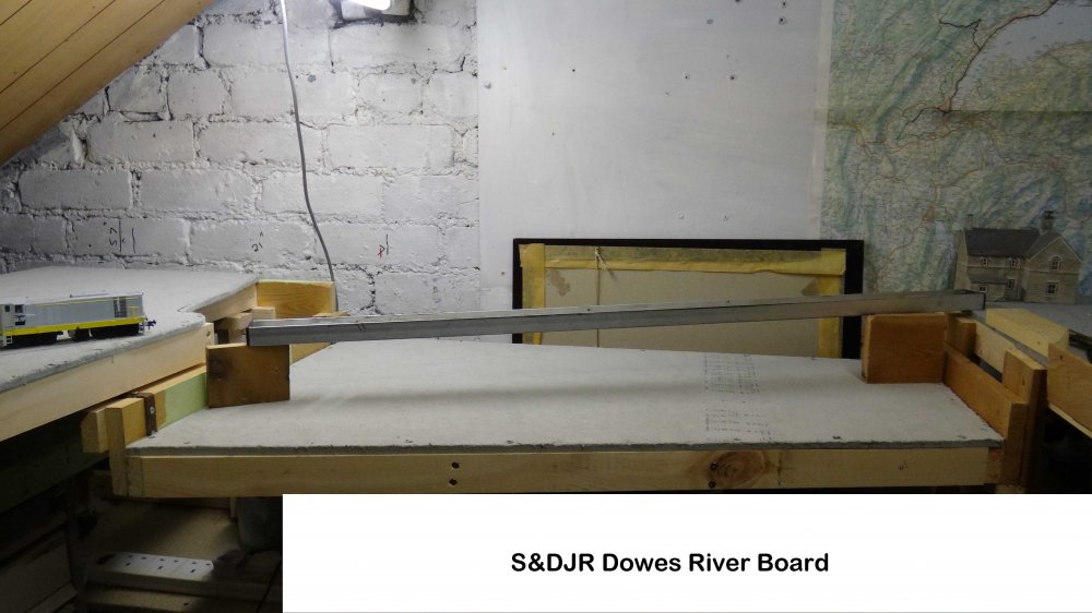

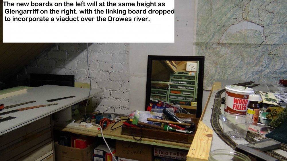

As regards the Sligo and Donegal Junction, the wood has been acquired and the building site cleared. The actual size of the base boards established and detailed work
on the track plan underway. Here are a few views of the proposed layout with a revised scheme which uses the Glengarriff fiidle yard and with a few alterations to the off scene trackage it should be possible to run Sligo fiddle yard , - S&DJR station - hidden loops - Glengarriff - Glengarriff fiddle yard giving a running route of some 60 feet without any point changing.
The actual location is envisaged as being at the crossing of the Drowes River at a place now known as Four Masters bridge south of Bundoran. In the past it appears to have been called Mullanaleek Bridge and the site of a Corn Mill and Kiln. Mullanaleek for Bundoran could well be the layouts eventual title.

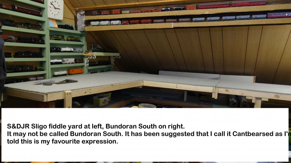

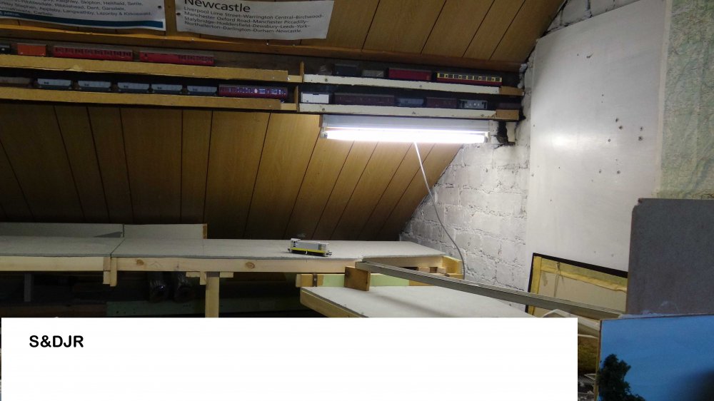

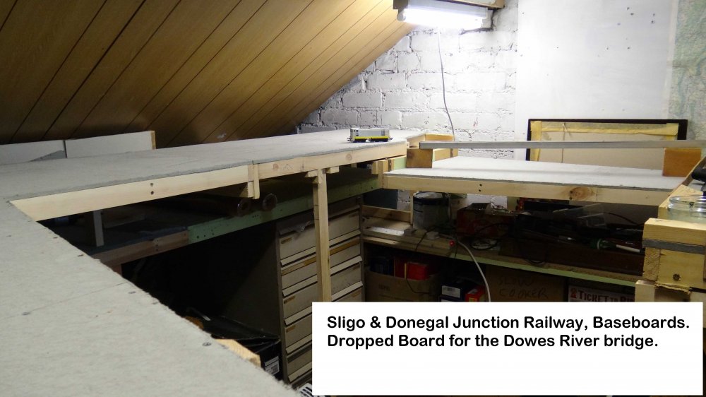

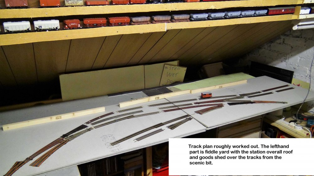

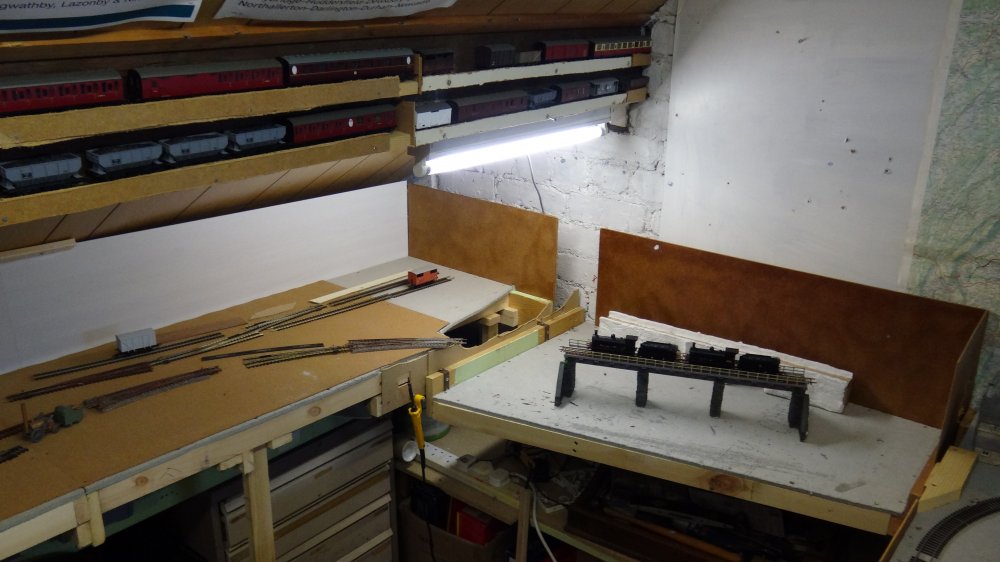

Over the last few days I have constructed the baseboards for the Sligo & Donegal Junction. All that is holding up construction is some wire and tube for the points as this has to be included at the same time as track laying. Sourcing a couple of  points took some time as there is a great shortage at the moment due to an upturn in layout construction during lockdown.
The original detailed track plan and wiring diagram appears to have been eaten by one of the dogs so I am sketching it out on the boards and working out running/shunting moves etc whilst waiting for the wire & tube which has "allow 28 days for delivery" on the advertising. Well parceling up 5 yards of 2mm tube and wire and then squeezing it into a large envelope and then finding a courier or perhaps Royal Mail with a delivery slot to send it can be quite daunting. I struck it lucky with the pack of 10mm track pins and the 2 rolls of cork underlay from 2 different dealers who  both managed to get them to me next day.

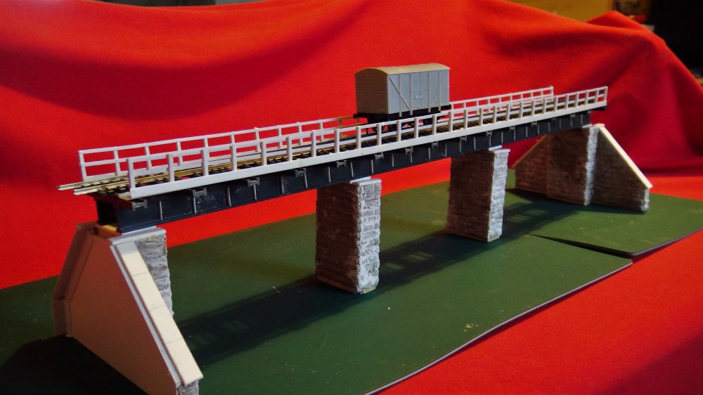

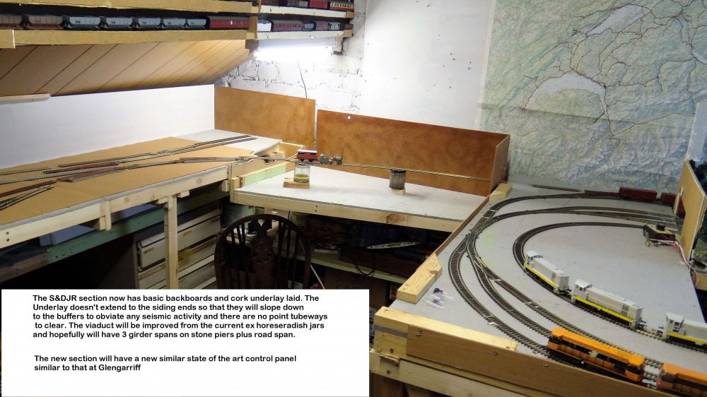

Well they can't complain I have and here are the photos to prove it. Glengarriff has been spruced up and the piles of plastic bits tools, brushes paint pots etc tidied away. In addition the new layout is coming on. I can't really lay any track until the viaduct is constructed as I am planning on open topped girder spans with the rails supported on longitudinal beams laid on stone piers.

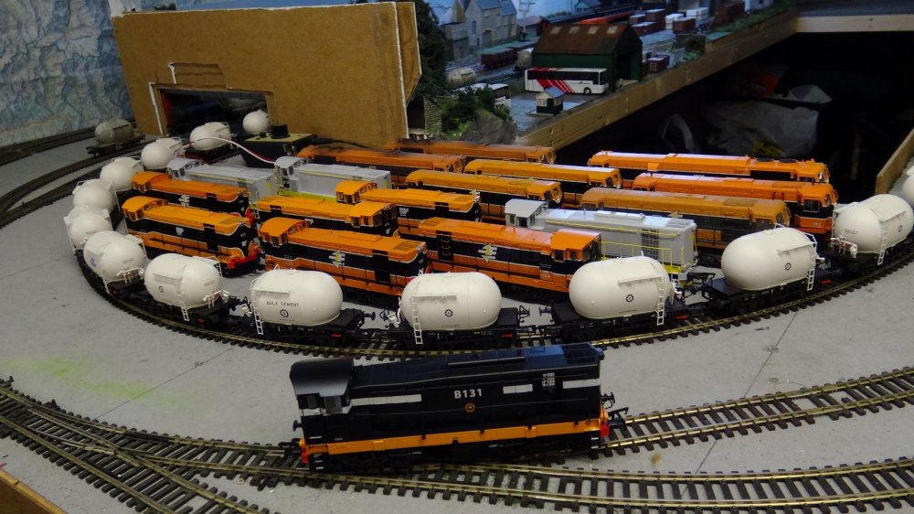

I wasn't going to get a black n Tan 121 but thinking that in a couple of years time I will probably wish I had; thought better of it.
This is the 'Insurance' shot. All locos arrived safely with only one loose coupling across the deliveries. I'm thinking that if I go the same way with the A Class I might have to rebuild Glengarriff as a Diesel depot. Well no! I prefer the countryside.

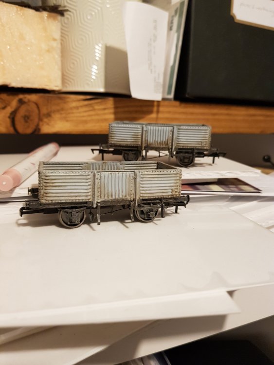

I've begun to remove flash from the cattle wagon parts, put a few of the sides in hot water for 5 mins then under a big flat lump (actually a NEMA23 stepper motor, but it was weighty, flat and next to me when I needed a weight) for a few days.
Cant say I love batch building, especially the brake gear!
The supplied thin staples for the door springs were a pain - you're supposed to do 2 staples together so they're wide enough, but every time I tried to trim or bend a pair they would split and separate somewhere. A look in the tool cupboard turned up some Stanley 6mm heavy duty staples which are the correct width to use as single staples, a bit thicker, but I think they look alright, and they're certainly more robust.
They're not quite finished yet - when the brown wash I used to suggest rust dries I'll do a little work with weathering powders.

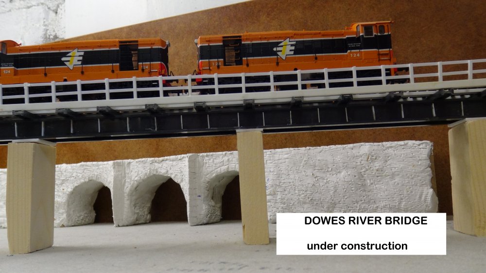

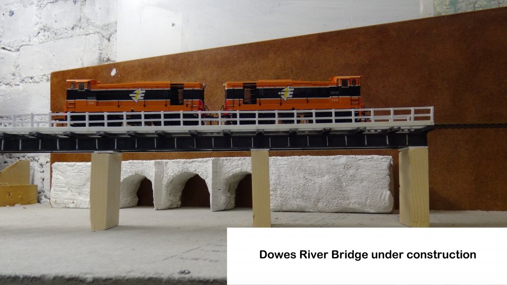

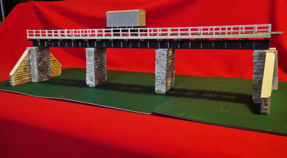

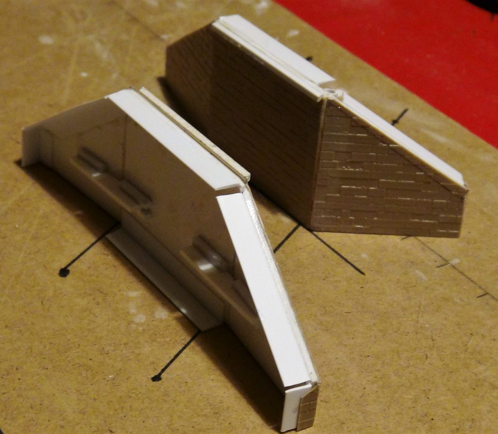

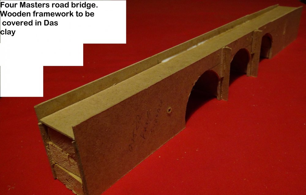

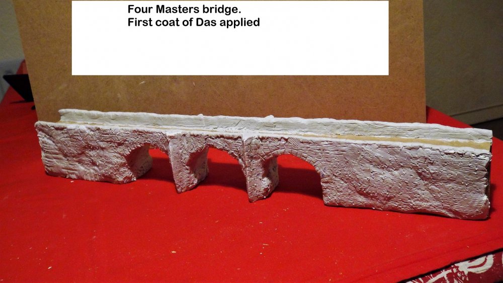

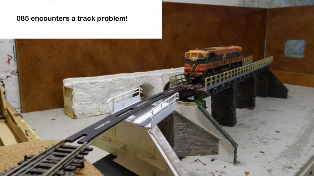

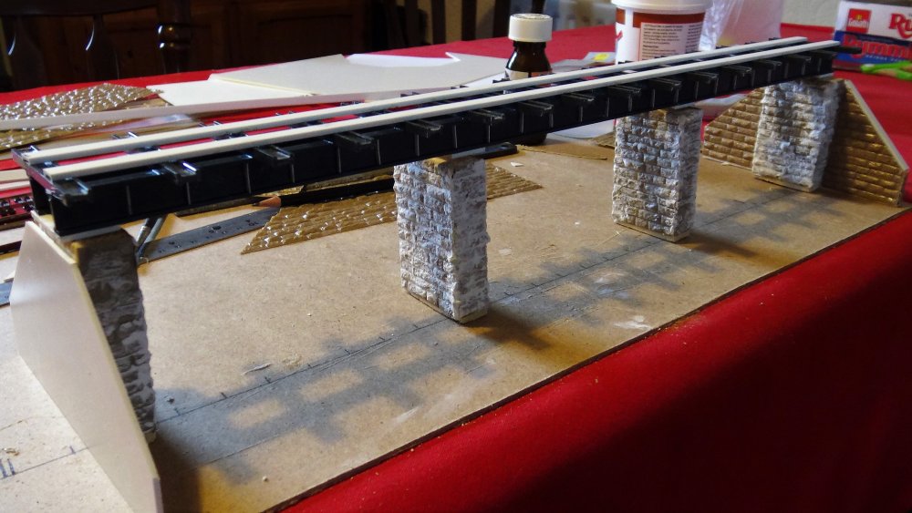

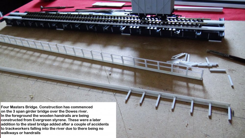

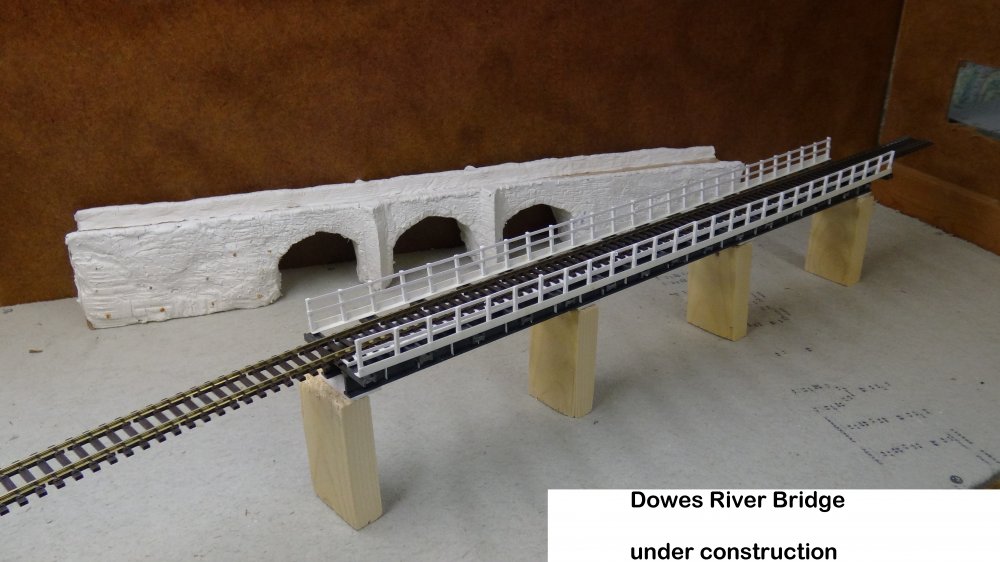

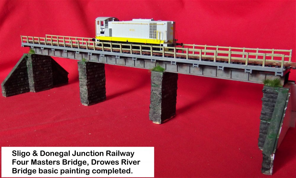

I've actually done a bit of modelling this weekend. This is the road bridge at Four Masters under construction. This will form the backdrop to the girder railway viaduct which is planned to have an open deck hence it will have to be built before any tracklaying on the extension from Glengarriff can be laid

Thanks all - the kits themselves are nicely made, and theres a lot of texture to the wagons in terms of rivets, strapping and corrugations, so painting is just highlighting what is already there, if that makes sense.
The instructions describe using diluted b&q tester pots of paint. I didnt fancy that! Working from photos the wagons seem to have been unpainted, but the zinc galvanisation weathers to a slightly blue light grey. I used a can of u-pol acid etch primer (it works fine on plastics, and gives a much lighter gray and slightly finer finish than standard halfords gray primer) which looked about right for the base colour.
The underframes were originally painted. I mixed up some lner wagon grey, a bit of br bauxite and a few drops of black and put a few drops of water in to thin it a bit, then smeared it over the underframe. As each brush load of this was used, the drying remnants were used to dry brush the rivets on the wagon bodies. A few spots of corrosion were dry brushed on in bauxite. Looking at photos the bottom of the bodies and where the rivets were takes on a slightly brown colour where the rust stains it, this was done by putting army painter soft tone wash on those bits (not all over as you might often use a toning wash). This allows you to make the corrosion slightly different on each wagon.

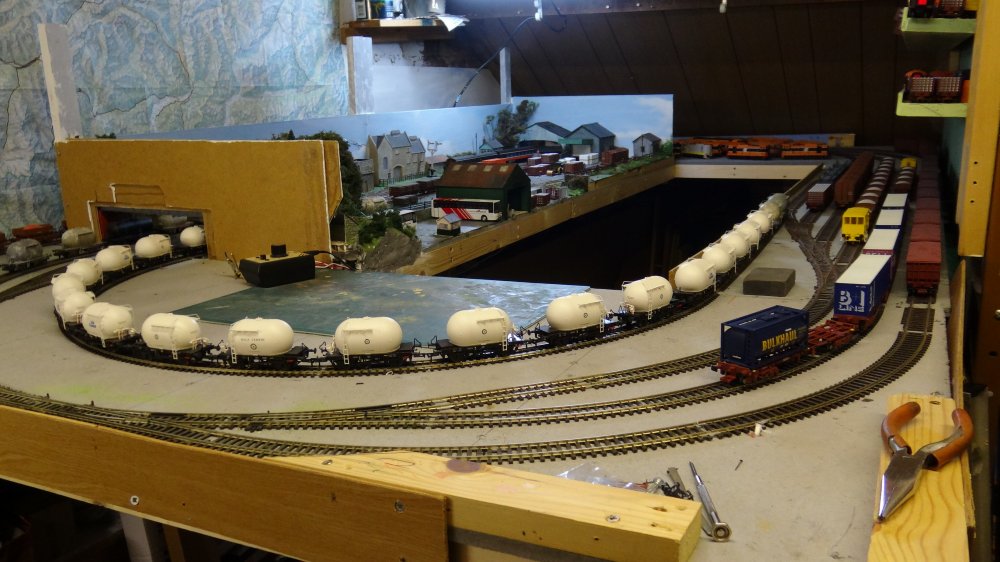

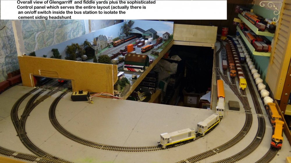

Hi Paul, the original layout containing Glengarriff and the fiddle yard etc is 10 feet x 5ft-3 ins . There are 6 baseboards. 2 end boards 5'-3'' x 2'. these are separated by the main fiddle (1ft wide) and the back fiddle yard (6'' wide) They are 6 ft long. These 4 boards have no scenery on and if the layout was dismantled could be transported relatively easily. In front of the back fiddle yard are the scenic boards for Glengarriff each 3ft long x 2 ft wide. They were designed to be taken out and could be stored box-like screwed together facing each other. It is possible to run trains without the scenic sections in place as the continuous run still exists. One other criteria was that I  sometimes want to run long trains so the 3 longest fiddle yard loops can hold a 20 wagon + 2 baby GM's. The longest loop will hold 10 Tara's and 8 Fertilisers at the same time.
The operating well is therefore 6 ft x 20 inchs - not very wide but neither am I!
The original idea with the removable scenic part was so that I could build other boards displaying different scenarios covering my NER/Scottish models and possibly USA or 7mm narrow gauge without having to build a lot more fiddle yards etc.
This concept however has been modified owing to the passage of time and a consequent lack of cooperation from my knees and back!
I decided therefore to give up on the switching scenic boards idea and instead build an extension which could also include more elaborate scenery. Four Masters Bridge is the result. L shaped 5ft x 8ft.
Maximum overall layout size is 15 feet x 8 feet. This extension is dual purpose, Irish modelling wise it is the Sligo & Donegal Junction railway but it will also serve as a station on the Caledonian & North Eastern Junction railway a direct line from Morpeth then over the Border into Scotland to Carstairs on the West Coast Mainline. This will be late steam early diesel in both Irish and UK formats. The scenery in both areas is very similar.
There will be some loss of the original fiddle yard capacity when operating in S&DJ or C&NE format but this will be offset by a new 7 road fiddle yard at Four Masters.

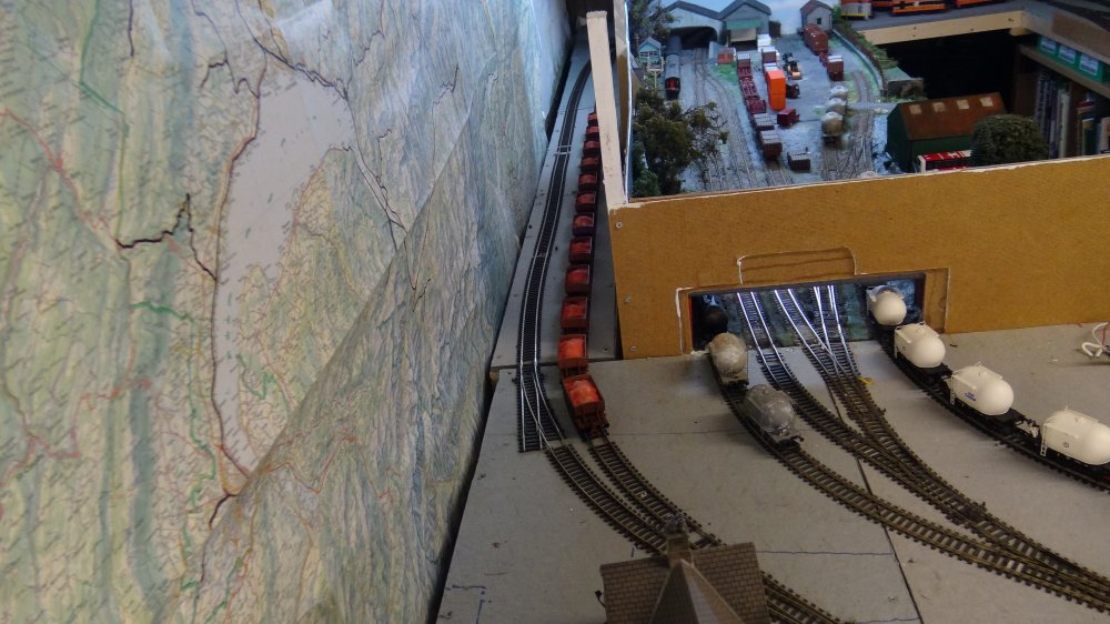

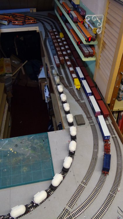

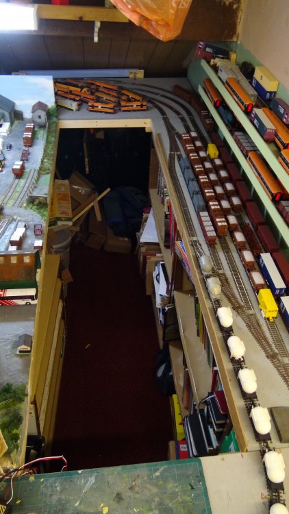

Hired a drone to take some views from up in the rafters.

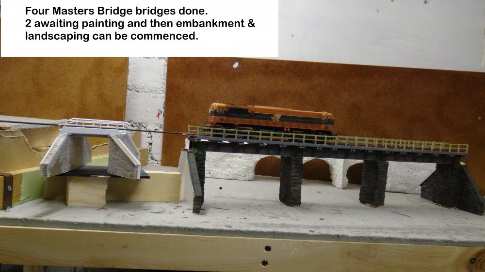

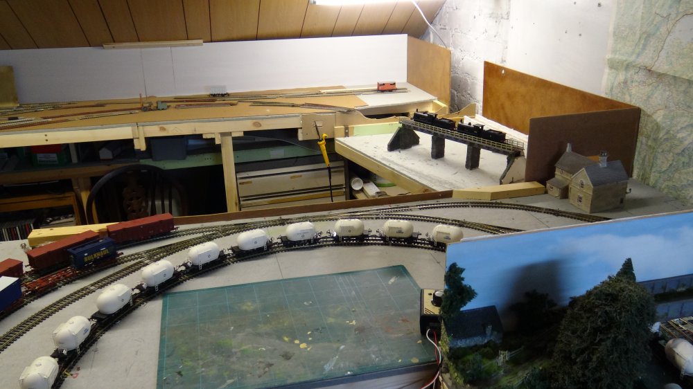

Looking good Alan. Started on the last bridge for Four Masters (Small railway overbridge over a minor road) Hopefully might have some track laid  by the Summer Hols!
