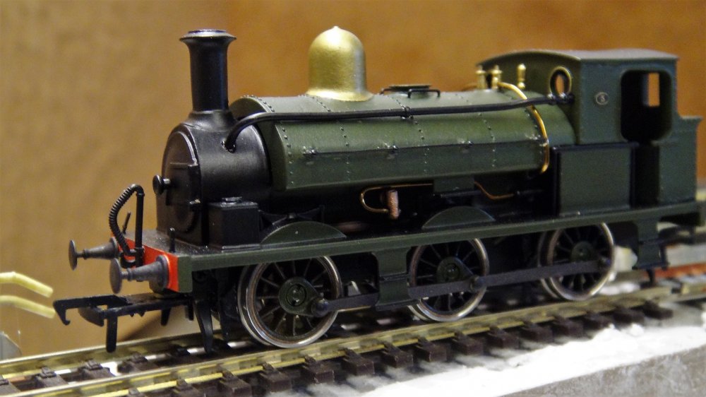

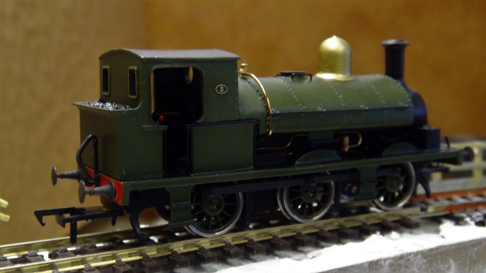

Irishswissernie Posted March 20, 2021 Author Share Posted March 20, 2021 Its a Tank engine and therefore carries its water in the saddle tank and coal in the bunker behind the cab rather than having a separate tender. Looking at the instructions (I don't use DCC) there is space in the boiler to fit a chip which will need to be cold wired, OO Works do not provide this service. I notice that whilst the loco comes with a 12 month guarantee for manufacturing faults fitting a DCC chip also voids the guarantee. 1 1 Quote Link to comment Share on other sites More sharing options...

Mike 84C Posted March 23, 2021 Share Posted March 23, 2021 My happiness factor is very high! In the hand said green 0-6-0t looks much better than photographs and it weighs enough to pull more wagons than I will ever need. My only puzzlement is what is the small hole in the front top of the saddle tank? Its an odd place for a washout plug. I shall contact 00works. Quote Link to comment Share on other sites More sharing options...

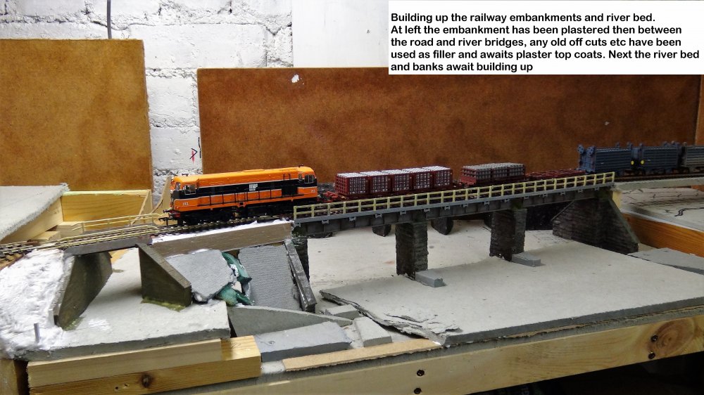

Irishswissernie Posted March 29, 2021 Author Share Posted March 29, 2021 Progress at Four Masters. Building up the embankments etc 10 Quote Link to comment Share on other sites More sharing options...

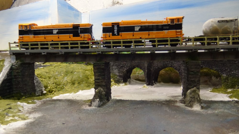

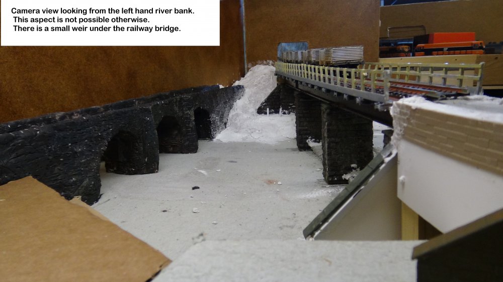

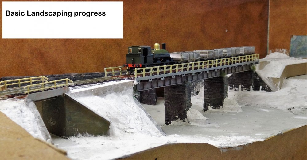

Irishswissernie Posted April 4, 2021 Author Share Posted April 4, 2021 Getting plastered at the Drowes River 12 Quote Link to comment Share on other sites More sharing options...
Galteemore Posted April 4, 2021 Share Posted April 4, 2021 (edited) Nice to see the CBSC tank earning its coal. Nice Beyer cab windows - can see something of a family likeness to the Welshpool and Llanfair locos here Edited April 4, 2021 by Galteemore 6 Quote Link to comment Share on other sites More sharing options...
the Bandon tank Posted April 4, 2021 Share Posted April 4, 2021 Looking very well, any chance of a close up shot of the loco. Quote Link to comment Share on other sites More sharing options...
Irishswissernie Posted April 4, 2021 Author Share Posted April 4, 2021 Done 9 Quote Link to comment Share on other sites More sharing options...

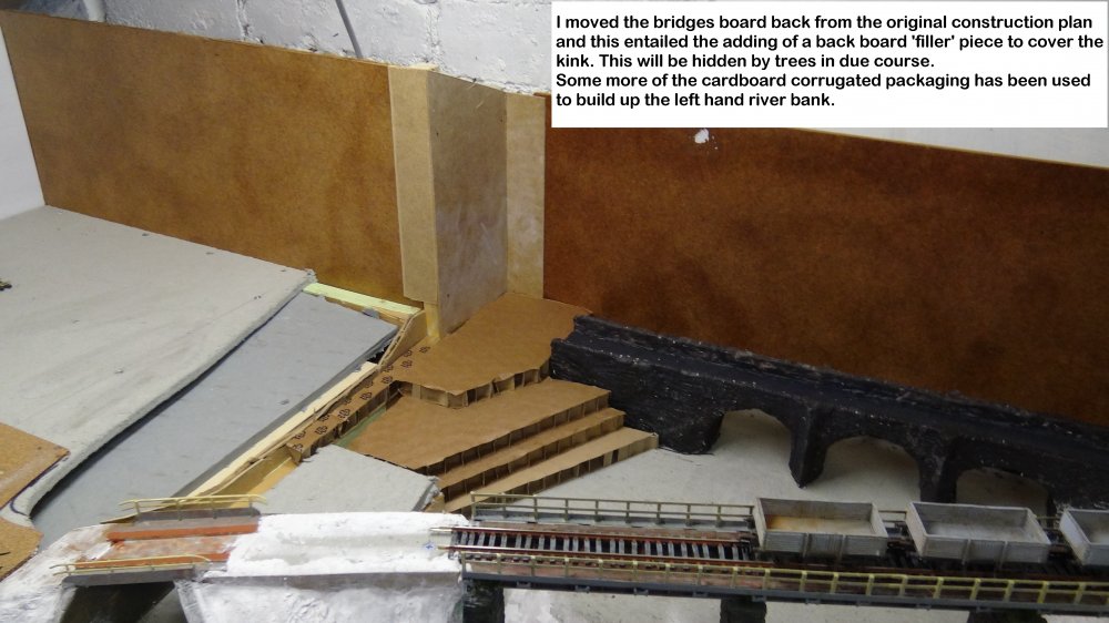

Irishswissernie Posted April 11, 2021 Author Share Posted April 11, 2021 Some more progress on the bridges board. After I had built the original baseboards I decided to push the bridges board back a few inches so that the radius of the curve from Five Bridges station could be increased. This has introduced a 'kink' in the back drop, now filled in, which will be hidden by trees in due course. 14 Quote Link to comment Share on other sites More sharing options...

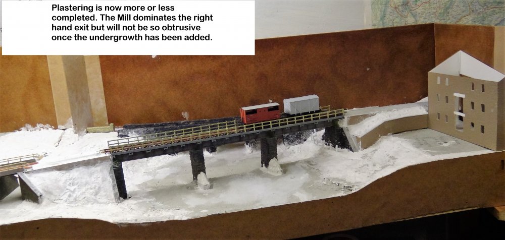

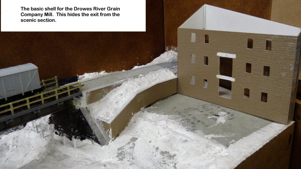

Irishswissernie Posted May 4, 2021 Author Share Posted May 4, 2021 Having spent the last few weeks identifying and annotating 2000 negs, not much progress to report on Four Masters although I have completed the basic plaster work and work has commenced this week on the Drowes River Grain Company Warehouse which will disguise the right hand exit to the fiddle yard etc. This is a fairly complicated plastikard structure which is situated at an angle next to the backdrop but at least the windows will all be just wooden boards so no sashes etc to be made. There will be a sack hoist to the 3 floors to be added next. 8 Quote Link to comment Share on other sites More sharing options...

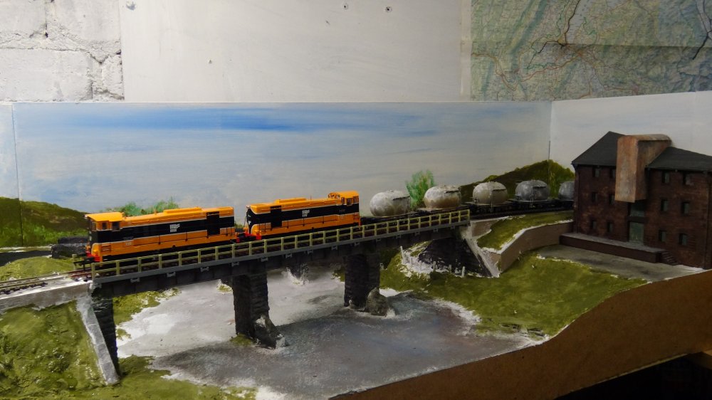

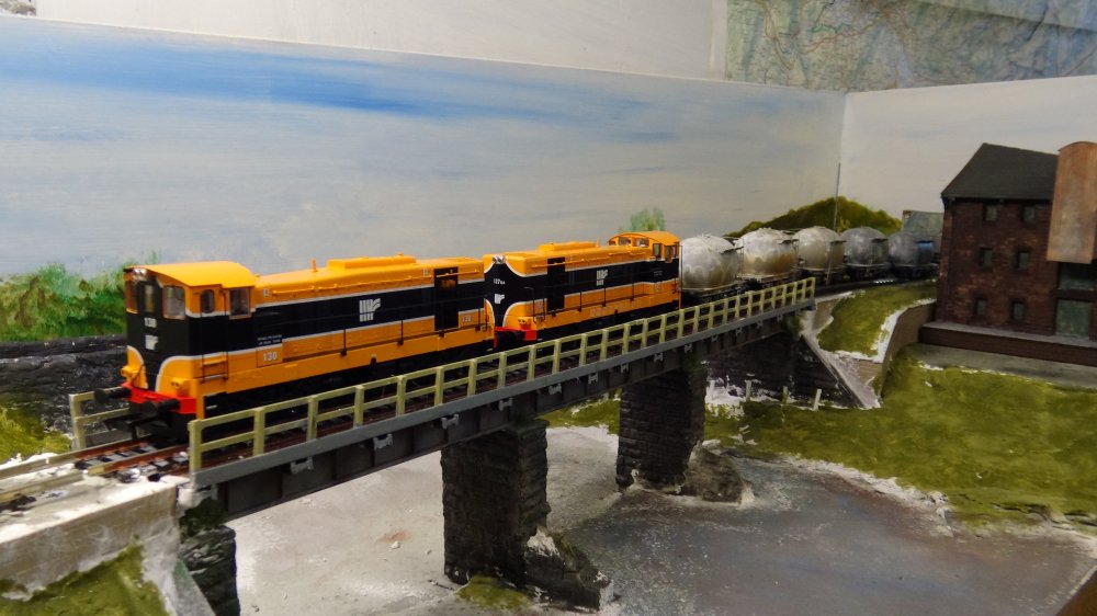

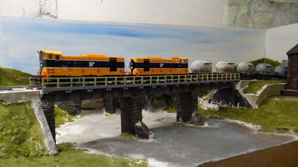

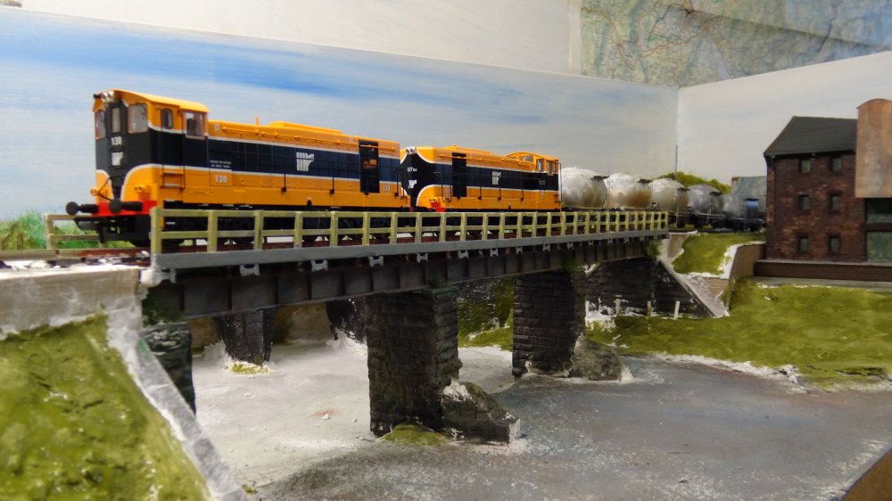

Irishswissernie Posted May 15, 2021 Author Share Posted May 15, 2021 (edited) I have slapped a bit of basic colour on this morning to get rid of the 'snow' scene. Hopefully 130 + 127 will draw the viewers attention rather than looking too closely at the paint job. Edited May 15, 2021 by Irishswissernie 17 Quote Link to comment Share on other sites More sharing options...
Galteemore Posted May 15, 2021 Share Posted May 15, 2021 Great work Ernie. Looks very effective Quote Link to comment Share on other sites More sharing options...
popeye Posted May 15, 2021 Share Posted May 15, 2021 I love the bridge and river, they will look great when finished. The roof on the mill looks a little odd though, could it not have a level top edge? Quote Link to comment Share on other sites More sharing options...
Irishswissernie Posted May 15, 2021 Author Share Posted May 15, 2021 The Mill is set at an angle to the backdrop which is why the roof level is how it is, hopefully it won't be so obvious when the backdrop is fully painted with trees etc so there will be far less contrast between the dark roof and blue sky. Quote Link to comment Share on other sites More sharing options...
StevieB Posted May 15, 2021 Share Posted May 15, 2021 One of the most realistic scenes I’ve seen in a long time. Stephen 1 Quote Link to comment Share on other sites More sharing options...

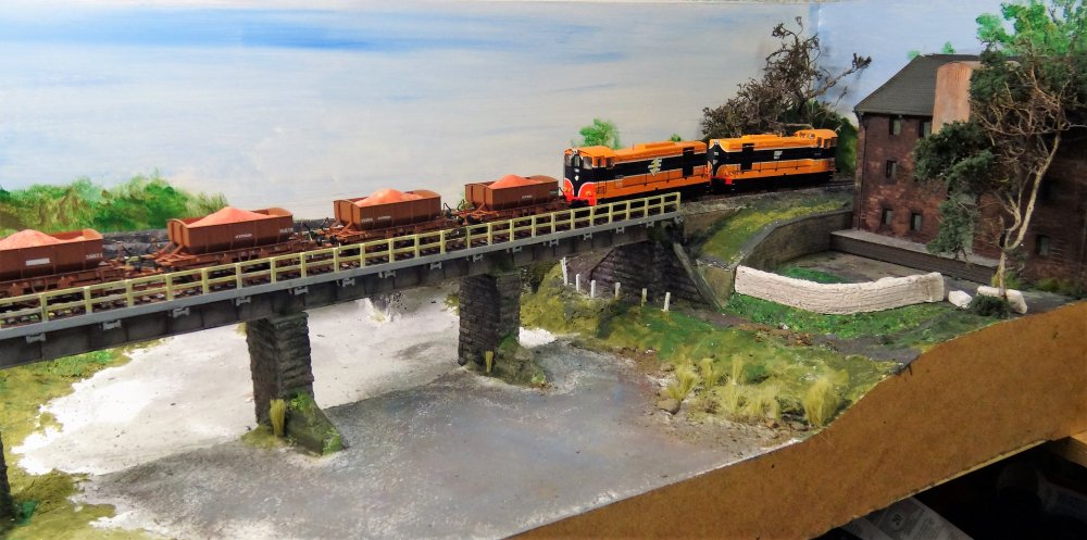

Popular Post Irishswissernie Posted June 22, 2021 Author Popular Post Share Posted June 22, 2021 Its a few weeks since I managed to do any more work on Four Masters Bridge, but have done a bit today. The main hold up was finding a source of small fragments of stone and sand so that I could detail the river bank. Last Saturday we went to the seaside and I filled a small doggy bag on the beach but on getting it home realised that the contents were a kaleidoscope of colours with a high content of coal dust etc. Not very suitable unfortunately. I pondered over where I could find a supply of material with more appropriate colouring and it came to me this morning that approx 90 seconds walk away from where I have resided for the last 30 years is the River Tyne which possibly might have the odd pebbles and correctly coloured sand. I accordingly dragged one of the dogs out for a mid-day constitutional and on finding a suitable supply loaded a dog bag and put it in my pocket. Disaster! One of the old dears observed me doing this, and didn't notice that the contents hadn't just seen the light of day from the dogs rear. My behaviour has no doubt been broadcast through the local Granny Mafia Media and I shall no doubt be getting a few peculiar looks over the next few days! Here are a couple of views - appears to look (and smell) OK 22 3 Quote Link to comment Share on other sites More sharing options...
popeye Posted June 22, 2021 Share Posted June 22, 2021 It looks very well indeed. I like that low angle view. 1 Quote Link to comment Share on other sites More sharing options...
KMCE Posted June 23, 2021 Share Posted June 23, 2021 Very Nice! Everything well blended together to develop the scene. Super work. Ken 1 Quote Link to comment Share on other sites More sharing options...
StevieB Posted June 23, 2021 Share Posted June 23, 2021 It really does look like the real thing. Well done. Stephen 1 Quote Link to comment Share on other sites More sharing options...
murphaph Posted June 23, 2021 Share Posted June 23, 2021 Shades of Monasterevin for me. Love it. 1 1 Quote Link to comment Share on other sites More sharing options...
JasonB Posted June 24, 2021 Share Posted June 24, 2021 Fantastic stuff. The details added along the river bank has really helped blend everything together, along with the mill which looks right at home. The 121's crossing with the gypsums complete a great scene. Quote Link to comment Share on other sites More sharing options...

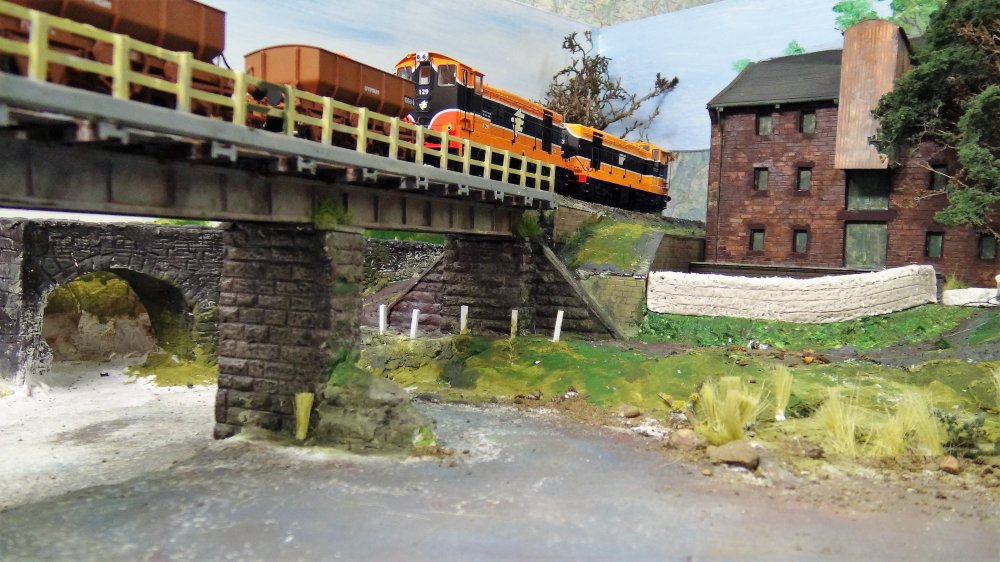

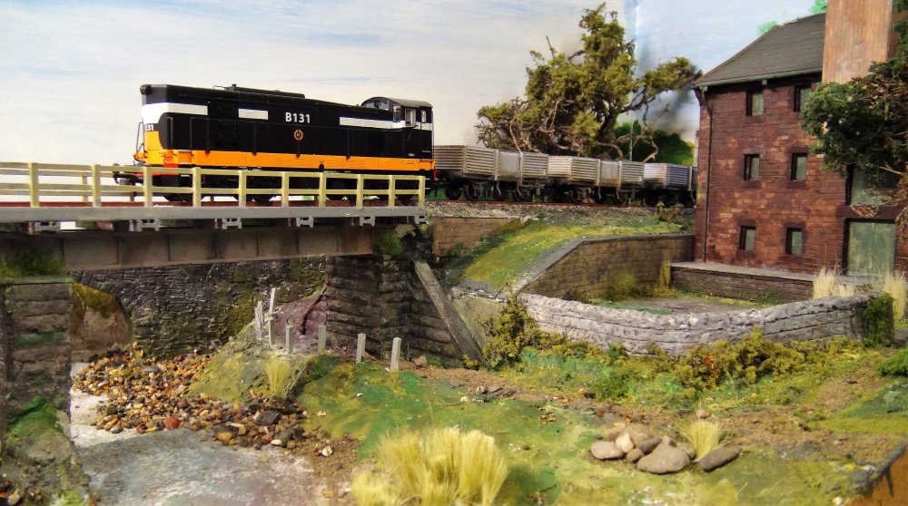

Irishswissernie Posted July 1, 2021 Author Share Posted July 1, 2021 Still 'vegetating' at Four Masters Bridge with a lot more detailing still in the pipeline 15 2 Quote Link to comment Share on other sites More sharing options...
Galteemore Posted July 1, 2021 Share Posted July 1, 2021 (edited) Nice convincing scene taking shape Edited July 1, 2021 by Galteemore 1 Quote Link to comment Share on other sites More sharing options...
jhb171achill Posted July 1, 2021 Share Posted July 1, 2021 32 minutes ago, Irishswissernie said: Still 'vegetating' at Four Masters Bridge with a lot more detailing still in the pipeline Classic scene! 2 1 Quote Link to comment Share on other sites More sharing options...
StevieB Posted July 1, 2021 Share Posted July 1, 2021 I expect there’s a good reason why B131 is running bonnet first. Stephen Quote Link to comment Share on other sites More sharing options...
Irishswissernie Posted July 2, 2021 Author Share Posted July 2, 2021 (edited) 7 hours ago, StevieB said: I expect there’s a good reason why B131 is running bonnet first. Stephen Propelling wagons into the Mill siding. I just missed the train arriving from Ballyshannon and managed to catch a view of the loco on the bridge as it reversed in to the siding with the 3 wagons. Edited July 2, 2021 by Irishswissernie 2 Quote Link to comment Share on other sites More sharing options...
