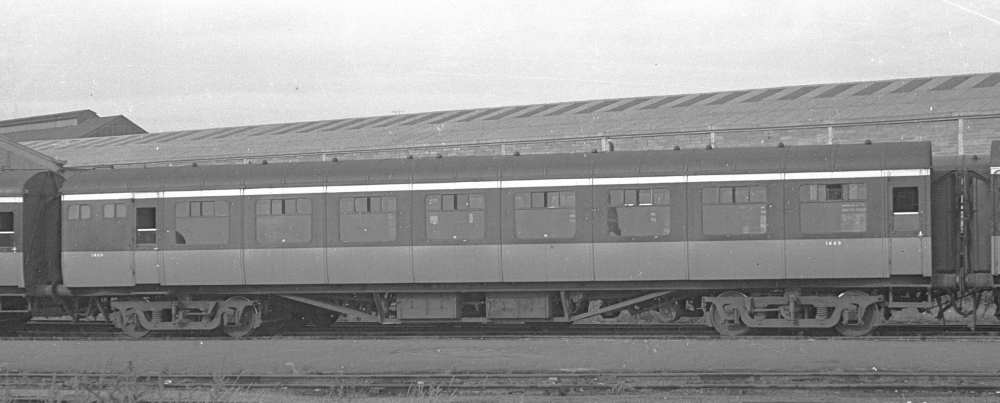

flange lubricator Posted January 19, 2019 Posted January 19, 2019 Just one minor detail the Inchicore coach builders who put these coaches together were real craftsmen the rib's on the body work always matched the rib's on the roof this is very well illustrated in josefstadt's pictures 3

Mayner Posted January 19, 2019 Posted January 19, 2019 32 minutes ago, flange lubricator said: Just one minor detail the Inchicore coach builders who put these coaches together were real craftsmen the rib's on the body work always matched the rib's on the roof this is very well illustrated in josefstadt's pictures The Laminates & the Tin Vans were of modular pre-fabricated construction that could be assembled quicker and required less skill compared to the timber framed coaches built by CIE between 1951 &55. The introduction of the Park Royals & Laminates allowed CIE to speed up its carriage building construction during the mid-late 50s introducing a greater number of coaches more quickly that could be achieved with traditional carriage building techniques and the available pool of labour. Ironically Inchacore returned to traditional timber frame carriage construction in the early 1960s for the final batch of coaches designed and built by CIE shortly before the introduction of the Craven Coaches. Apparently it was intended to re-body the Laminates after 15-20 years (use due to the limited design life of the composite aluminium insulation body panels) but the concept of re-bodying the coaches became obsolete with the introduction of the stress skinned MK2 coaches from the 1960s onwards. Interestingly some Laminate coaches were re-skinned with new sides and windows in the early 80s presumably as a stop gap measure to keep sufficient coaches in services until enough MK3 were in services to allow Cravens & Park Royals to be cascaded to suburban and secondary services. I was quite surprised to see several Laminate coaches stripped down to underframes, ends and roof during a visit to Inchacore in the early-mid 80s, the coaches looked distinctly odd with the sides and interior removed and roof supported by the ends and underframe. 1 2

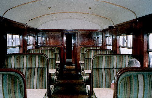

murrayec Posted February 6, 2019 Author Posted February 6, 2019 Does anybody have a notion on the seat upholstery for the laminates, I read on the forum some time back and I think it was JHB's comment that the seats were 'grey with a blue fleck' or maybe 'charcoal grey with a blue fleck'? Here is a test of both;- Any input is welcome...... Eoin 2
flange lubricator Posted February 6, 2019 Posted February 6, 2019 Pictures of the interior here https://www.steamtrainsireland.com/rpsi-collection/35/1463-open-third 1
murrayec Posted February 6, 2019 Author Posted February 6, 2019 (edited) 43 minutes ago, flange lubricator said: Pictures of the interior here https://www.steamtrainsireland.com/rpsi-collection/35/1463-open-third I went with the later seats as per Mr Brendan McCausland's photo of the interior of a Break Standard on flicker;- I felt the material may have been by Downpatrick rather than CIE, but the seats were easier and quicker to make than the old type with arms! I'll do the blue as per the RPSI photo Eoin Edited February 6, 2019 by murrayec 1
Glover Posted February 6, 2019 Posted February 6, 2019 Eoin, There was a reference in an early 1960s issue of Irish Railfans News (available on the RPSI website at one time) which said that standard CIE seat colours were maroon in second/standard class and green in first class. I suspect that was the 'base' colour with floral type patterns giving a variety of shades. I'm trying to think back to CIE buses of that era; my memory would suggest that the coverings used on the RPSI coaches are rather too modern for the mid/late 1950s. A rummage around old furniture shops/auction rooms might provide some clues. Cheers, Glover 1
murrayec Posted February 6, 2019 Author Posted February 6, 2019 Hi Glover Yes I think someone posted those photos on the forum somewhere- black n white photos if I remember correctly? The floral pattern is a bit hard to do, so I'm going to stick with the blue material in the RPSI website photo linked in FL's post above. Eoin

jhb171achill Posted February 10, 2019 Posted February 10, 2019 (edited) The green and red coloured upholstery (1st & 2nd class) mentioned in the 1960s had disappeared by, at a wild guess, about 1970/2. The dark charcoal grey with blue fleck became almost universal, though the Loughrea coach had light brown plastic “leather”, and I seem to recall some old laminates with light greyish blue, like Dublin buses. It’s important to note that NONE of the RPSI or DCDR carriages have upholstery which is like the original. A few are roughly similar, but most including those shown above are completely different, with even base colours as different as painting a model ICR in NCC maroon with yellow wheels and a tartan roof! Edited February 10, 2019 by jhb171achill
