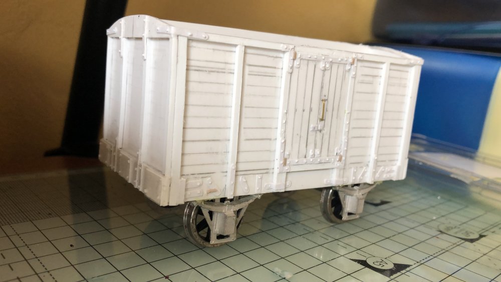

Galteemore Posted August 3, 2019 Author Posted August 3, 2019 (edited) Yes - I do get that...Almost done - on wheels now... Edited August 3, 2019 by Galteemore 5

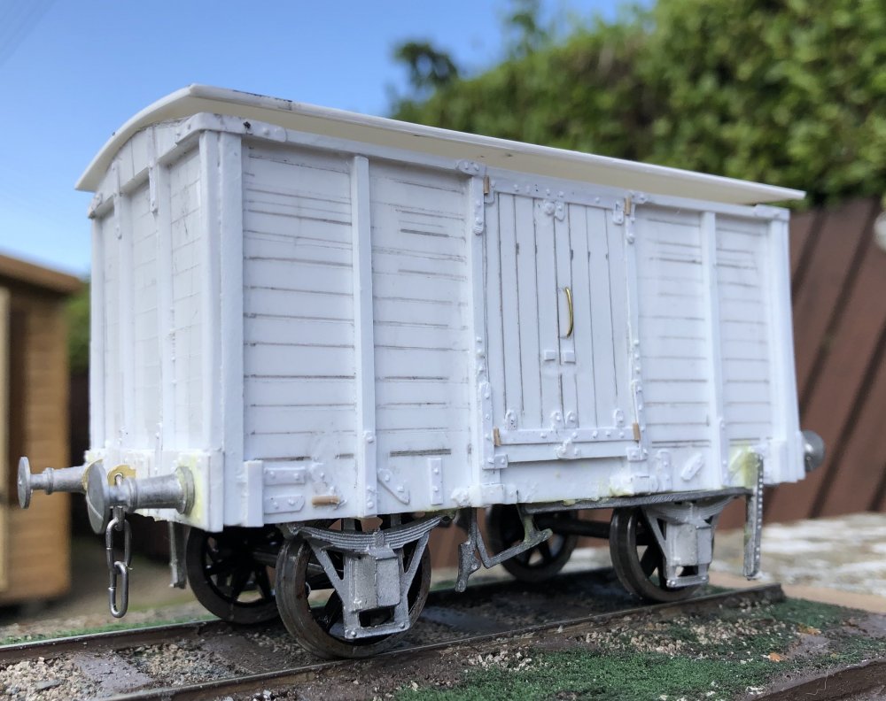

Galteemore Posted August 4, 2019 Author Posted August 4, 2019 Dummy run with loose roof in the sunshine 5
PorkyP Posted August 4, 2019 Posted August 4, 2019 Who's wheels are those btw ? ....( and don't yer dare say "they're mine, I bought em" ! )
Galteemore Posted August 4, 2019 Author Posted August 4, 2019 They are from Slaters - ref 7120 from memory. They are 32mm gauge originally but I have squeezed them out to 36.75- they simply slide along the axle. 1

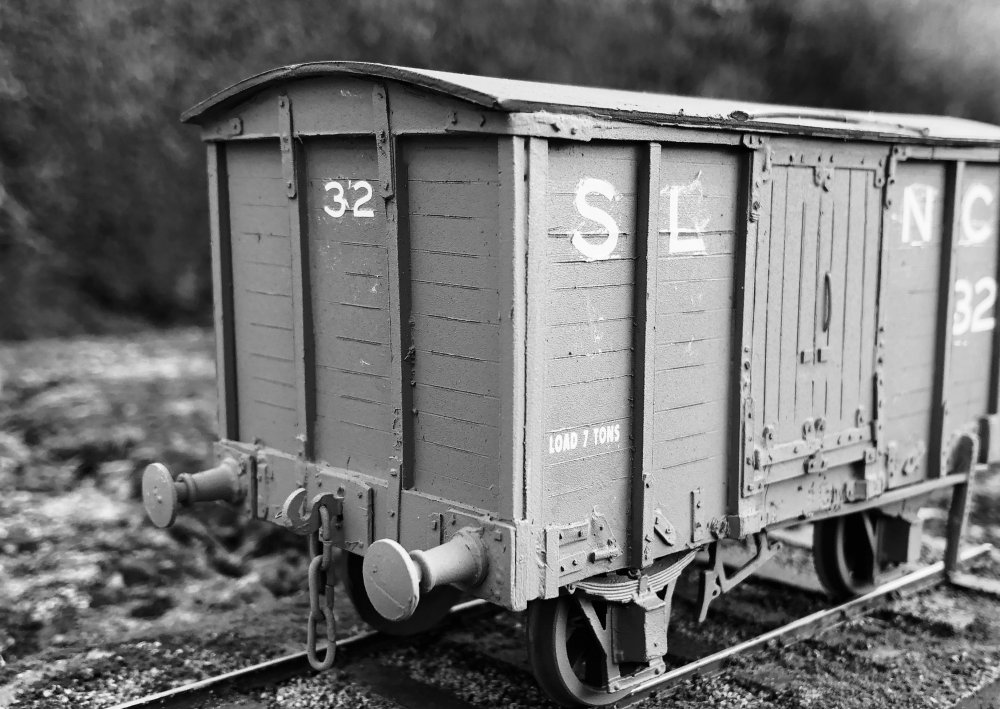

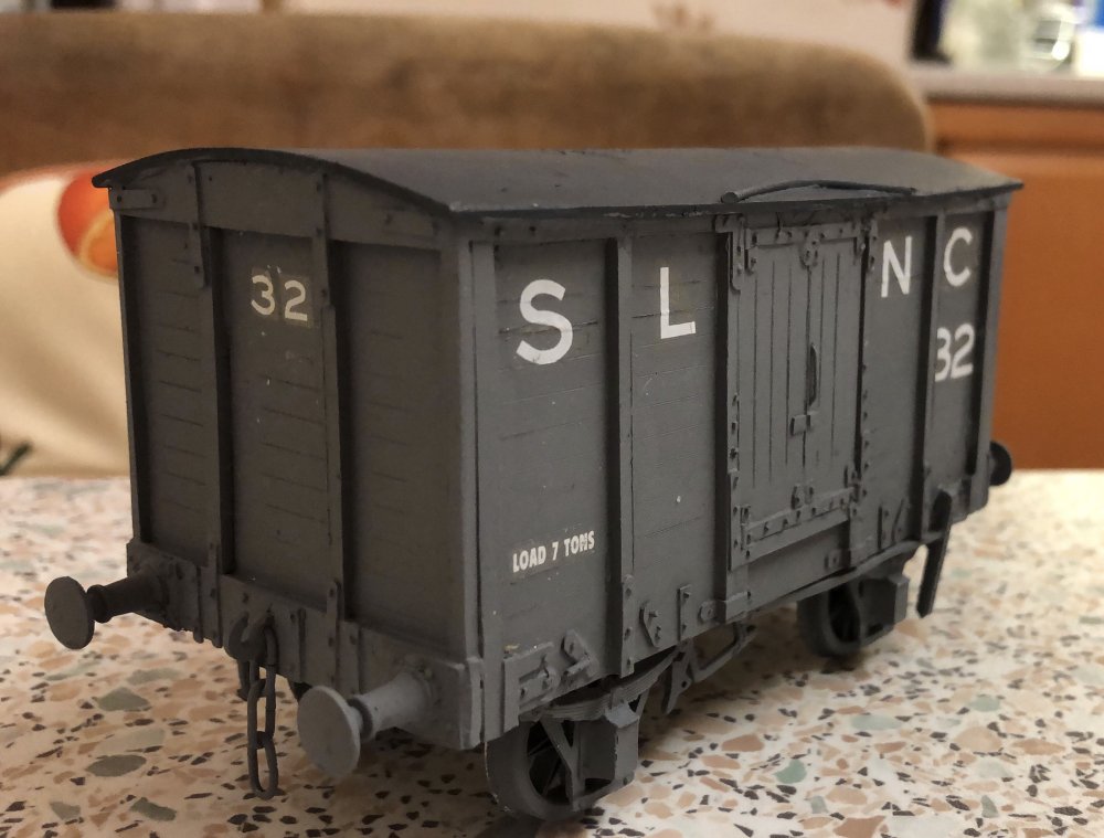

Galteemore Posted August 8, 2019 Author Posted August 8, 2019 (edited) Almost finished but the last few bits I need are back in GB. In the lower picture, it’s 0700 on an Irish summer morning in 1957 and van no 32 waits on a siding for collection on the 0630 ex Sligo goods....it’s quite nice I’ve got to this stage before we leave Ireland and head home, as I can show my mother the wagon later- she travelled on the SLNCR as a child...:) Edited August 8, 2019 by Galteemore 6 3

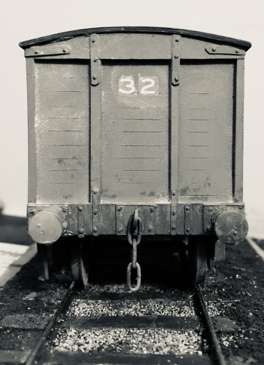

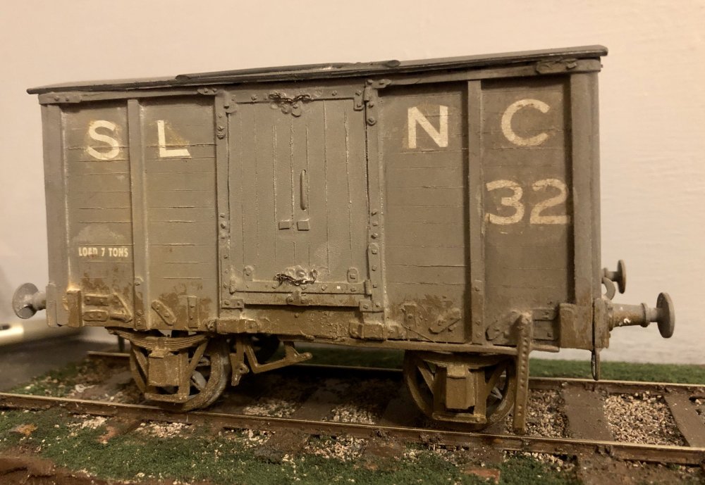

Galteemore Posted August 15, 2019 Author Posted August 15, 2019 (edited) Door chains and a bit of weathering. Not entirely happy but that’s all part of the learning experience...think it may look ok from a distance. A mile might suffice... Edited August 15, 2019 by Galteemore 5
popeye Posted August 15, 2019 Posted August 15, 2019 Close up pictures will show up every little flaw. But it looks great and has an aged look to it. 1 1
PorkyP Posted August 16, 2019 Posted August 16, 2019 ^ like the man said ! ..also with weathering you can always add a bit more to it, that's what happens in real life ! I got one if those really really cheap airbrush sets from evil bay not long ago, the type with everything in it 'compressor' and all...now, I had to fiddle with it to even get it going, but it's great for adding a bit of dust and muck and even looked pretty realistic with my crude attempts! Might be worth looking at one of these for your stuff...anyway your wagons are brilliant mate!.. 1

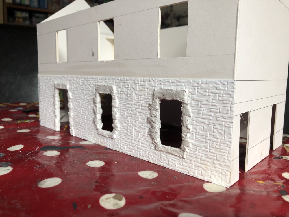

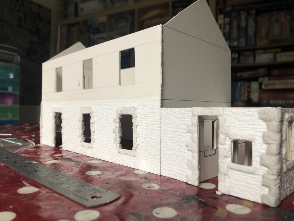

Galteemore Posted August 17, 2019 Author Posted August 17, 2019 (edited) Station building work today. Crude stone quoins applied from DAS clay on PVA Edited August 17, 2019 by Galteemore 4
PorkyP Posted August 17, 2019 Posted August 17, 2019 Looking very promising!.. Are you doing an actual station from life ?

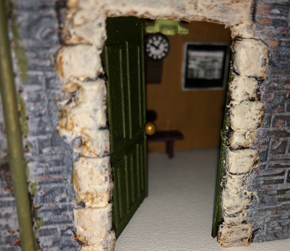

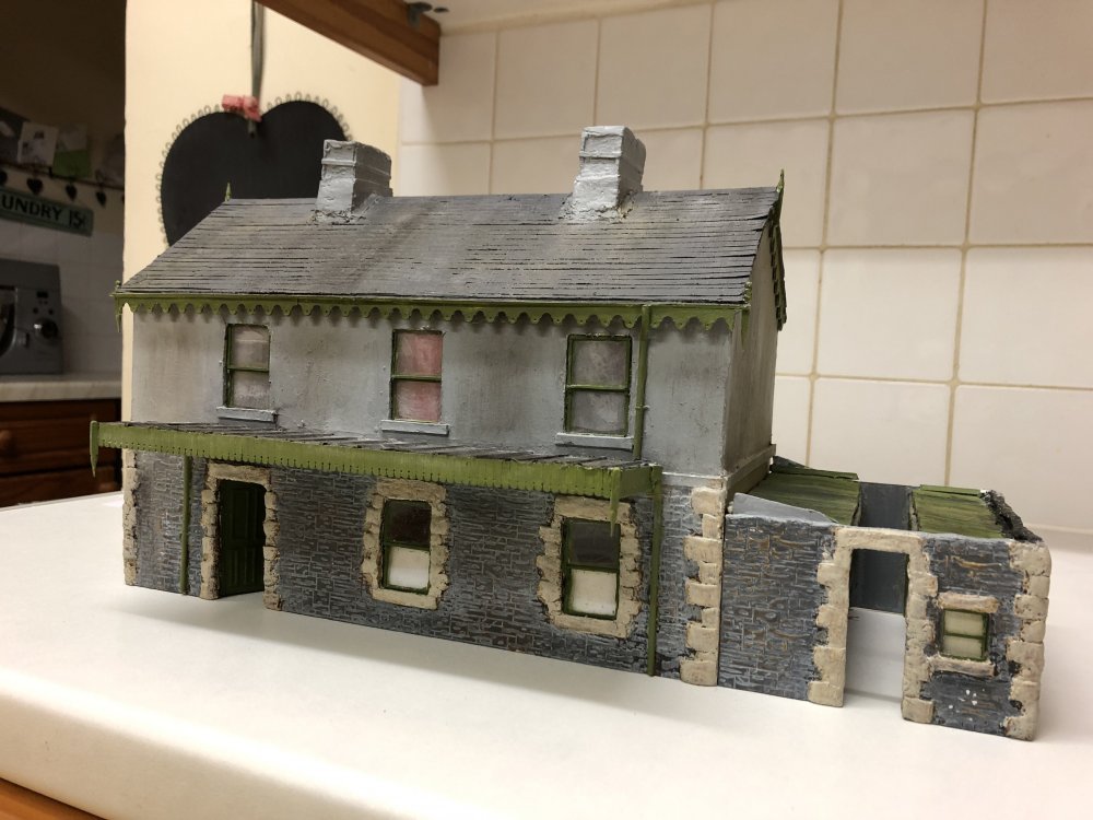

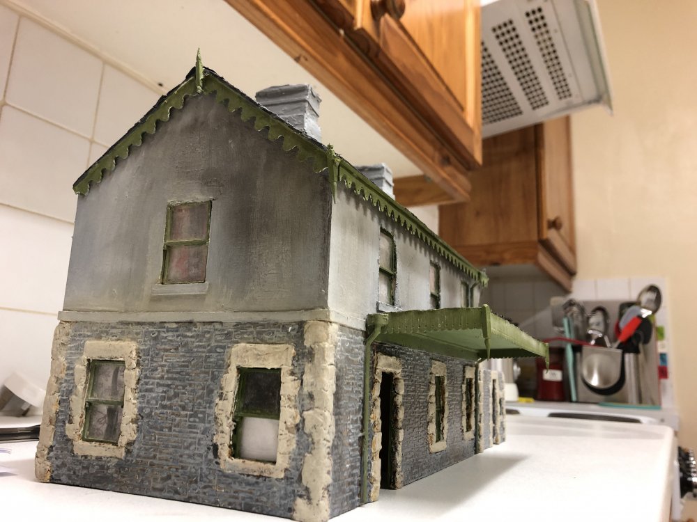

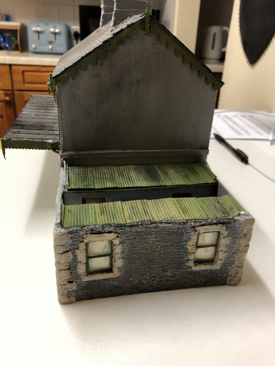

Galteemore Posted September 25, 2019 Author Posted September 25, 2019 (edited) Well, finally something to post after many weeks of occasional modelling interrupted by other stuff. It’s my first ever scratch built structure so loads of mistakes but I’m reasonably happy for a first attempt.....a few finishing touches to add still. Since posting the images, I’ve toned down the mould effect on the render a bit to make it slightly more subtle... also included is a pic of the inspiration! It’s not a 100% accurate model of Dromahair - there are tiny bits of Florencecourt too such as the prominent stonework on the join between the main building and the outhouses. Some of the details are rather obscure in photos so some parts of the build are taken from my grandparents’ farmhouse! They are both buried in Dromahair and the farmhouse (which was up the line near Lisgorman halt) was of similar layout to the station.... Edited September 26, 2019 by Galteemore 7
popeye Posted September 25, 2019 Posted September 25, 2019 WOW, good job, it has a real old look to it, if you don't mind me saying that. 1 1
Galteemore Posted September 25, 2019 Author Posted September 25, 2019 Thanks Popeye - it’s designed to look rather careworn so happy you agree!
PorkyP Posted September 25, 2019 Posted September 25, 2019 Brilliant! Can't wait to see it sitting on the platform, maybe a few chickens wandering about..! 1
