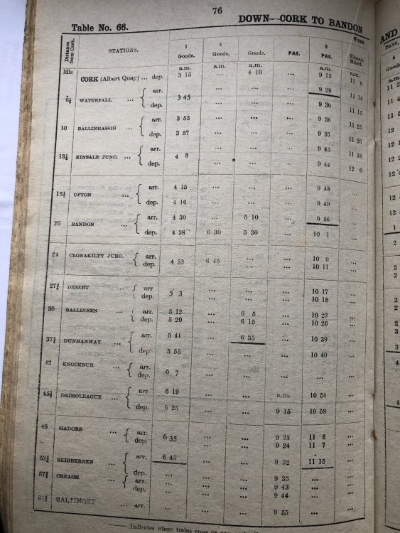

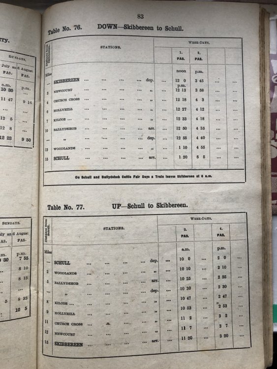

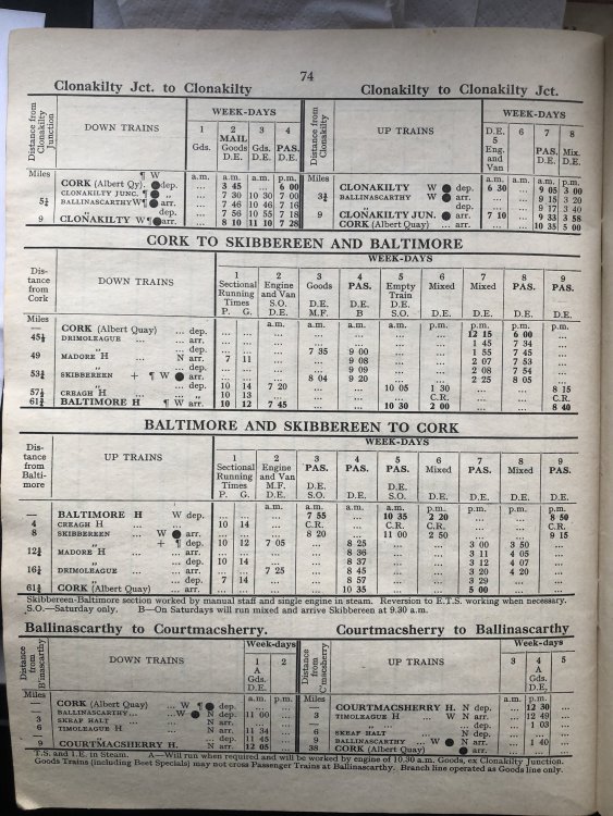

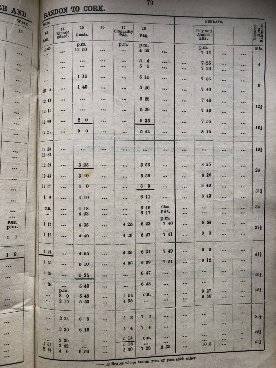

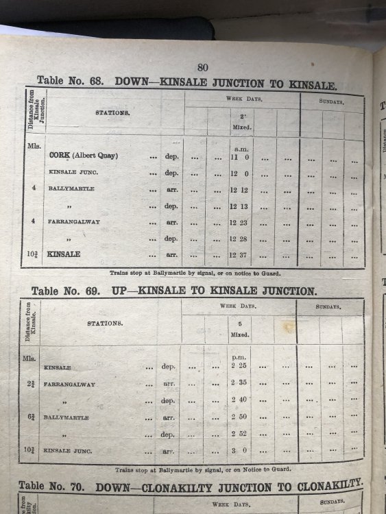

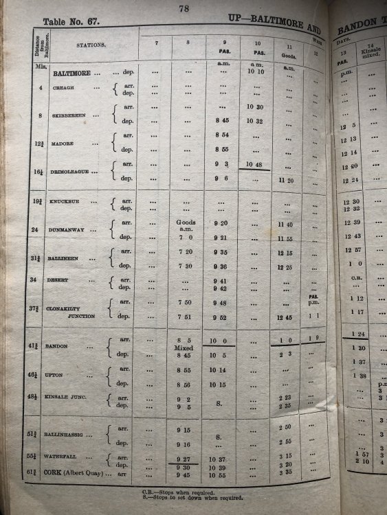

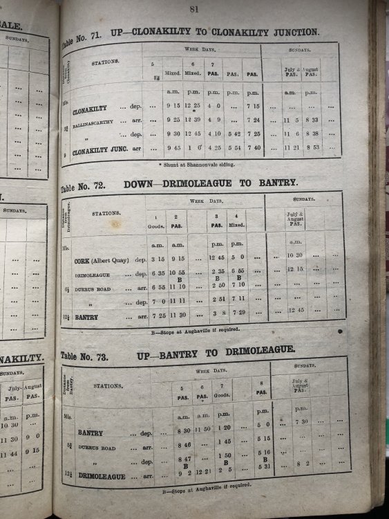

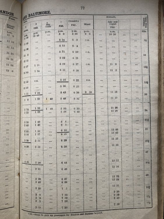

Mike 84C Posted February 14, 2020 Posted February 14, 2020 Is there any WTT information out there for the West Cork Lines? I'm particularly interested in trains to and from Bantry '50's until closure. From what I read the service was quite sparse but two trains a day is not going to keep the public interested ! and we need to build an operating sequence for the layout. Hope you quys can help and thanks in advance. Mick
jhb171achill Posted February 14, 2020 Posted February 14, 2020 Yes. Gimme a year and I’ll post it here. I actually worked out a sequence some years ago and came to the conclusion that a realistic mix was (from memory) 7 locos, one bring a pilot in Cork, and one AEC railcar set which did two return trips a day. I thinks that’s what it was. I opted for five “C” class, 90, and 464 for the locos. A GSWR tank engine would be another option. Its a shame the J15s never set foot there - indeed, I'm unaware of ANY tender engines going anywhere in West Cork ever. 2

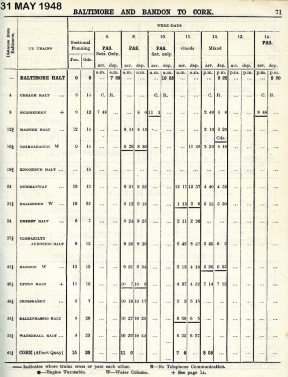

Irishswissernie Posted February 14, 2020 Posted February 14, 2020 (edited) June 1957 Working Timetable on my Flickr CB&SC Album ( They are not copyright the overlay was added on the whole album in error) Ernie Edited February 14, 2020 by Irishswissernie boob in adding links! 1 1

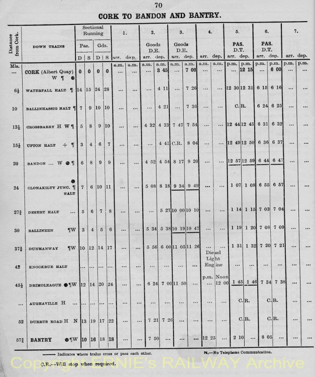

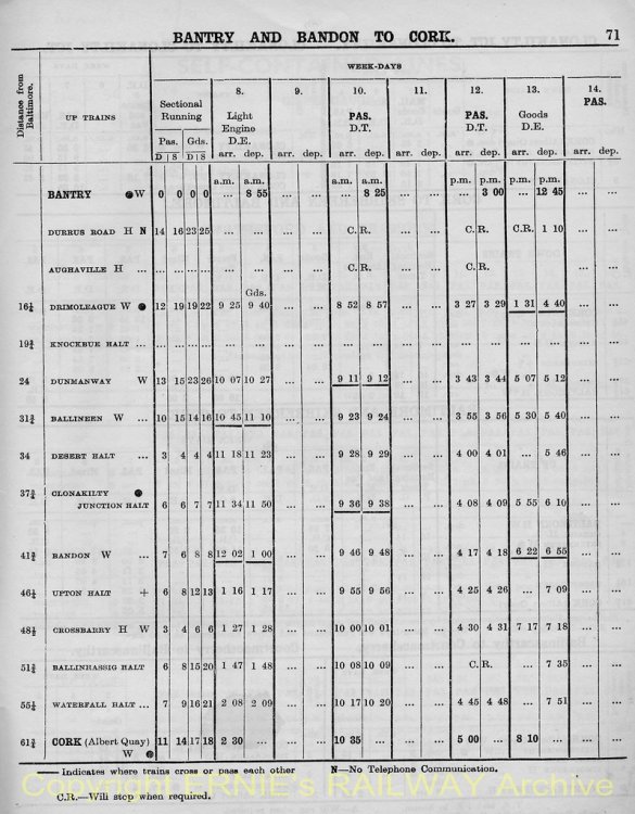

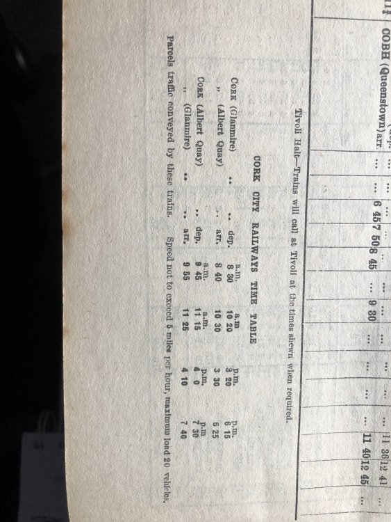

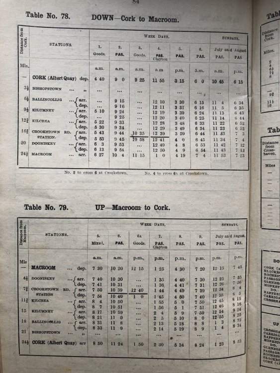

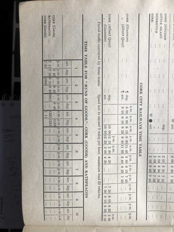

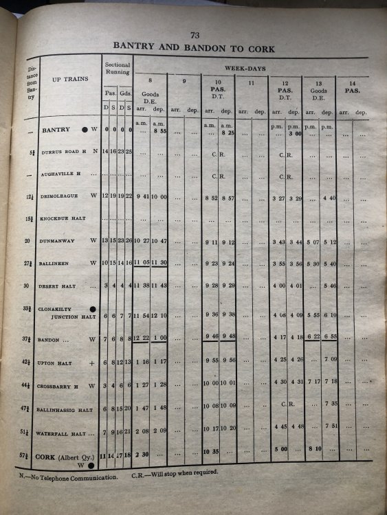

jhb171achill Posted February 14, 2020 Posted February 14, 2020 (edited) OK, 1960 to start, then 1930. Now, 1930. This will include Macroom, Kinsale and Schull (S & SLR). If there is any other year you need, i think I have all from 1926 at least. I also have appendix supplements regarding signal cabin hours, loco whistle codes and cattle traffic arrangements, all that sort of thing. Edited February 14, 2020 by jhb171achill 2 2
jhb171achill Posted February 14, 2020 Posted February 14, 2020 Trying to crop them, turn 'em right way up, etc., but I can't work out how!

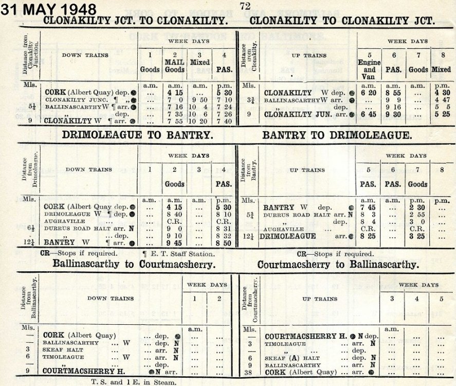

Irishswissernie Posted February 15, 2020 Posted February 15, 2020 I also have the WTT for 31May 1948. The service then was even worse than in the 1950's Cork to Baltimore was treated as the main line with a single connection each way to Bantry from Drimoleague. The sole passenger service was designed to bring passengers to Cork in the morning with a return service in the evening. Probably due to post war coal shortages etc My copy of the West Cork book has no binding problems. Ernie 1

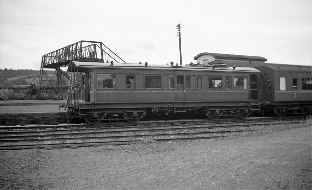

jhb171achill Posted February 16, 2020 Posted February 16, 2020 That carriage was scheduled for preservation by CIE but was scrapped! Had it survived, it would almost certainly have gone with “Maedb” and would now reside in Cultra. 2
Galteemore Posted February 16, 2020 Posted February 16, 2020 (edited) Shame! But as we both know, the reality is that it would probably have spent the 70s and early 80s mouldering outside Witham Street until it decayed into oblivion , or been reduced to ashes by the East Antrim Arsonists who regularly targeted Whitehead! Edited February 16, 2020 by Galteemore 2
jhb171achill Posted February 16, 2020 Posted February 16, 2020 True, Galteemore....... To go back to topic, the following public timetable (1958) makes it easier to work out passenger turns in West Cork. As you can see, some ECS workings were very much the norm. The entire Cork - Bantry service was worked by one AEC set - a necessary RTR thing, by the way, for the entire CIE and GNR systems, and a lot of the UTA & early NIR.... 2 1
Galteemore Posted February 16, 2020 Posted February 16, 2020 Fascinating stuff. Is that the timetable in its entirety? Just seems that nothing arrived in Albert Quay before 1035! Must have made commuting rather difficult....
jhb171achill Posted February 16, 2020 Posted February 16, 2020 Yep, as far as passengers were concerned, that’s it!
