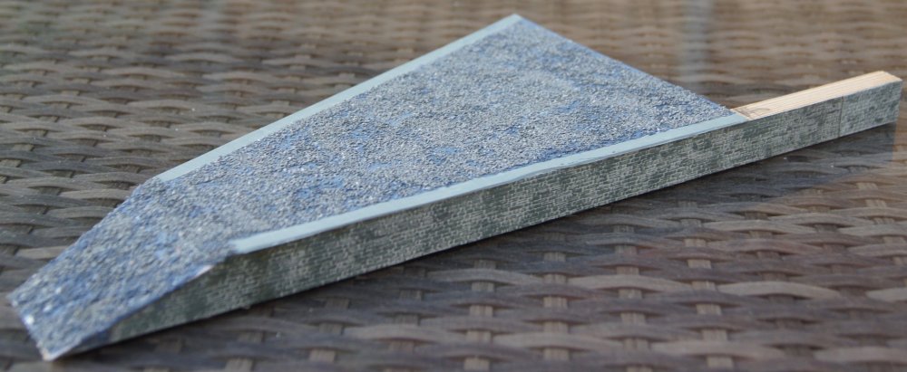

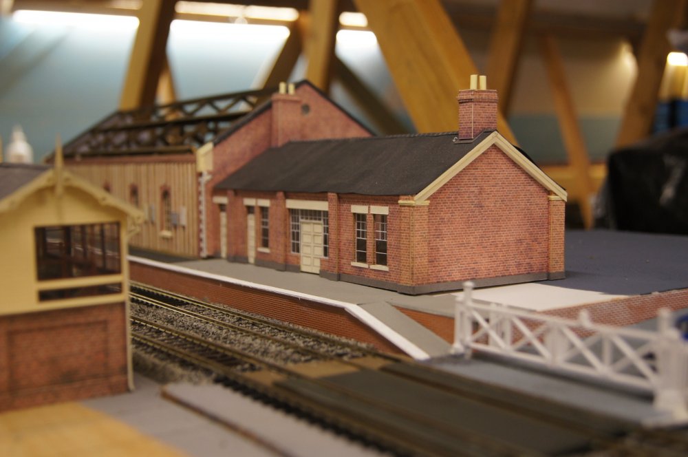

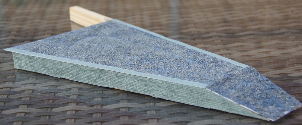

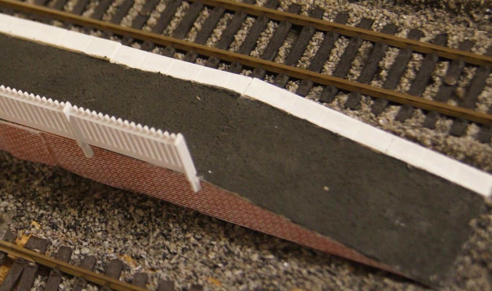

leslie10646 Posted April 16, 2020 Author Posted April 16, 2020 (edited) Well, for good or ill, I've made a start to scenery. I'm ballasting the Junction area and of course, you can only do a bit before you go crazy and in any event, it's best to leave each section to dry for a day or two. Soooo...... It so happens that the station at the North end of the house - Richhill - has had beautiful buildings for the past 5/6 years, but nothing else. The builder is a man of great renown on this site and I'll name him when I get the buildings planted. A large area needs to be built up to platform level for the station yard facing the building entrance (on the level, no steps) and a goods "beach" (dock to most people who didn't hear the local stationmaster call it that). The building up has been done - photos later, but for now, that "Beach". No laughing at the first efforts for fifty-odd years of a one eyed (LEFT, by the way) right-handed 73 year old bloke, who was never any good at modelling anyway. This is the side everyone would see and this other side is invisible, except you crawl under the board and view it from the suitcase storage area behind! You can see my "method" - platform height batten with a Plasticard surface. The Plasticard embossed sides were painted and then stuck on with good oul' Rocket Cardboard glue. Those sides were given a "mortar" undercoat and then "dry-brushed to bring out the stones - to say that it's a slow process would be a fine piece of English understatement. The gravel surface used a method championed by Gordon Gravett in his landscape modelling book - a thick coat of paint and then scatter the preferred surface material. I did it in small sections, scattering the material when the paint was barely off the brush. I have made an error in that the prototype had edging right down the ramp and the edging stones should be off-white. You may wonder at the long wall with no surface. Just a feature of my design tactics - it WILL get a surface! Final point - I first modelled this beach in 1970 (in the bedroom of my digs in Manchester) on the first Richhill - believe me, it was crude! Edited April 16, 2020 by leslie10646 7 Quote
Midland Man Posted April 16, 2020 Posted April 16, 2020 Lovely little platform No offense but a bit small for Portadown junction platforms but you've got the nack to build great looking platform. MM Quote
leslie10646 Posted April 16, 2020 Author Posted April 16, 2020 Hi MM Thanks. It probably got lost in my verbiage, but it's only a loading platform for goods and is part of the Richhill station on the layout. Quote

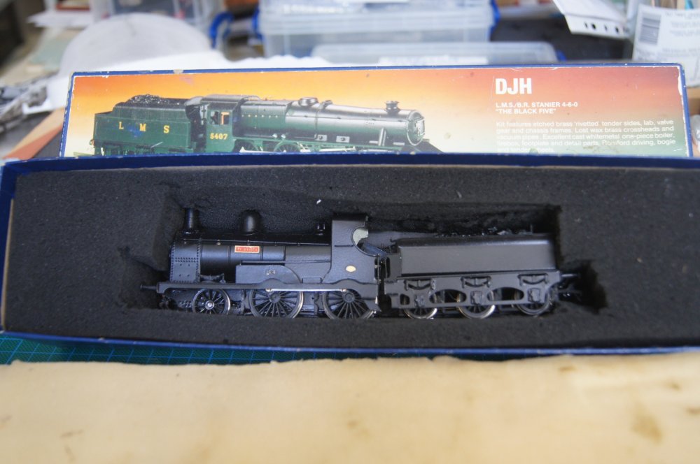

leslie10646 Posted June 2, 2020 Author Posted June 2, 2020 Now, that box ..... Sort of a clue here? Eh? Ah, so that's what it is! 5 Quote
leslie10646 Posted June 2, 2020 Author Posted June 2, 2020 Fast forward twenty minutes, climb three flights of stairs, gently ease her out of the foam ...... Take note that Portadown Jct has now grown some grass, you could see it but for the loco...... All the way from Kiwiland and about to take its first wheelturn in the Northern Hemisphere 4 3 Quote

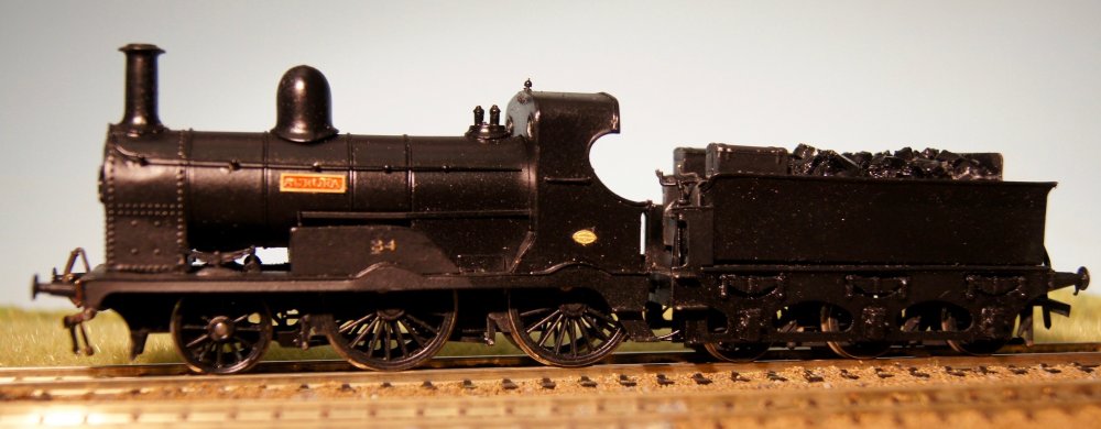

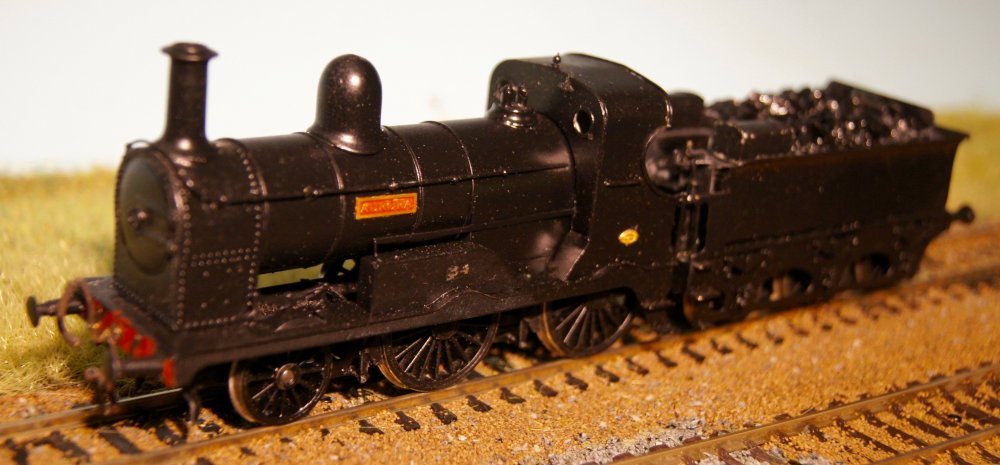

leslie10646 Posted June 2, 2020 Author Posted June 2, 2020 (edited) So, specially for Mr Mayne - Thanks by the way - he's probably asleep as I post this - First Steps in the Northern Hemisphere - much more exciting than that on the Moon (Yep, saw that) or getting Americans to the ISS the other day (saw that too). Here she runs even under the dubious gravity of Surrey - apologies that I haven't got David's skills with a video camera! By the way, turn the sound up - REAL steam sounds - actually it's the fan, as it's sweltering up there today! Aurora first Northern steps.m4v As Mr Ahrons said of the Midland - "The Most Irish of Railways". Hmm, now I need some six wheelers .... Great stuff Mayner - thanks a Million. Edited June 2, 2020 by leslie10646 10 1 2 Quote
Midland Man Posted June 2, 2020 Posted June 2, 2020 Mr Ahorn is quite right. Amazing locomotive you have there. Quote
Mayner Posted June 2, 2020 Posted June 2, 2020 It was an anxious moment whether she would run in the Northern Hemisphere & perform on a layout as we only had a temporary oval of Hornby set track as a test track. Like all good mechanics/loco builders I still have to finish off a Midland 2-4-0 for myself. 1 Quote
leslie10646 Posted June 3, 2020 Author Posted June 3, 2020 7 hours ago, Mayner said: It was an anxious moment whether she would run in the Northern Hemisphere & perform on a layout as we only had a temporary oval of Hornby set track as a test track. Like all good mechanics/loco builders I still have to finish off a Midland 2-4-0 for myself. Yes, it's an amusing thought that the Midland had locos which could run upside down! John, now you're awake, I can thank you more personally. I hope to try her again today at the Richhill end of the railway - where she can have a longer run. At the moment, with platform building, ballasting, grass sowing etc, there are a lot of things over the track! Enyoy your evening. 1 Quote

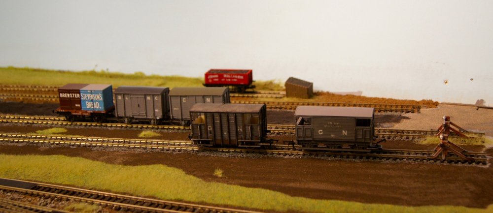

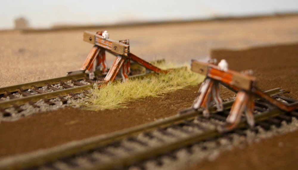

leslie10646 Posted June 15, 2020 Author Posted June 15, 2020 (edited) Anyway, getting back to the rail built buffer stops, mentioned as a "lesson" elsewhere. I was so enthusiastic chucking ballast in the rear sidings that the stop wouldn't clip onto the ballasted track - so quick change of plan and put the two I had in stock before Lockdown on less-ballasted sidings and then played with static grass (a great toy). Interesting how the close-up shows that my hand-held vacuum cleaner hasn't picked up all the spare blades of grass - nor is the stop as well clipped down as it could be - but with my lighting, you'd never notice it - this is under an anglepoise lamp!. The sandy area behind needs a bit of explaining - but that's for tomorrow. Edited June 15, 2020 by leslie10646 9 Quote

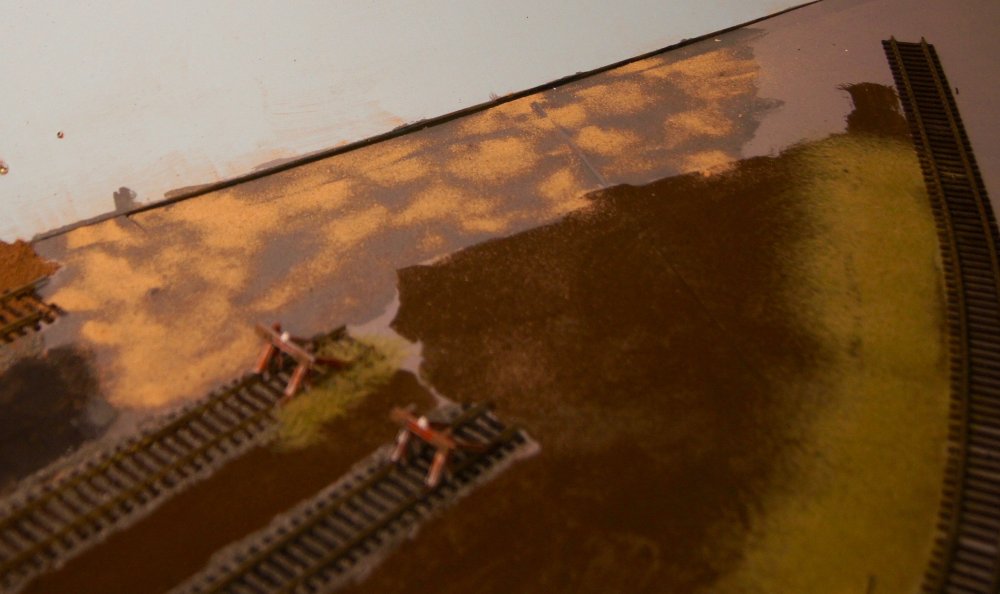

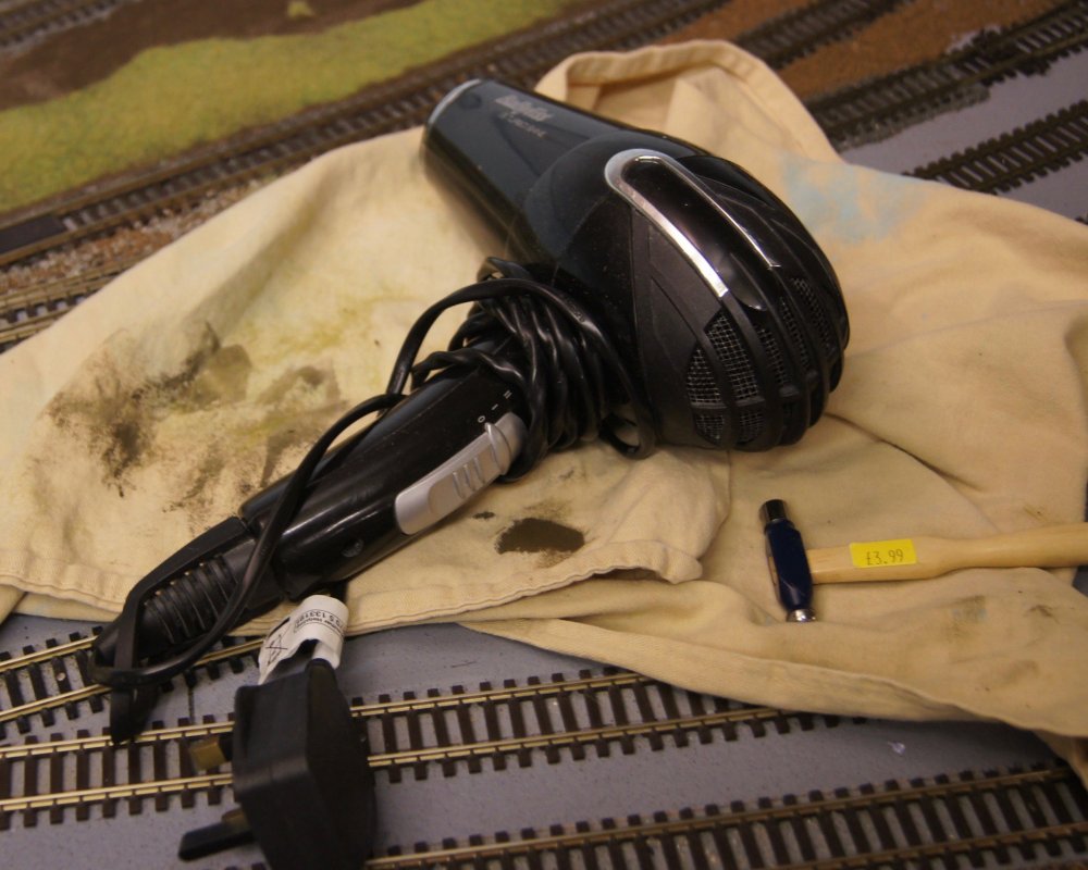

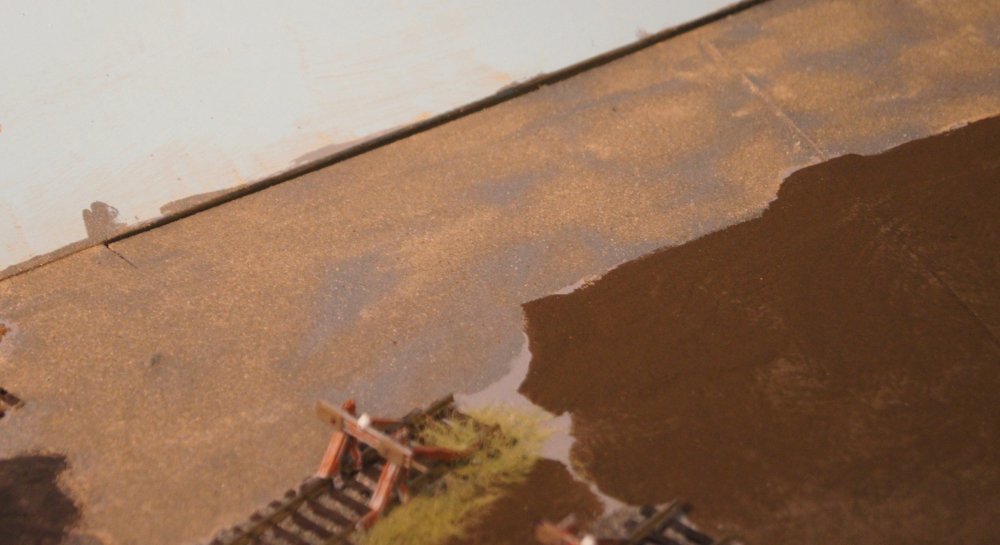

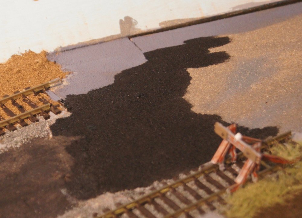

leslie10646 Posted June 16, 2020 Author Posted June 16, 2020 (edited) Now, the sandy area ..... I was looking at Andy Cundick's Valentia Harbour and was admiring the rough road surface at the front of the layout - so I asked him how it was done. "PVC, playpit sand ant d Acrylic paint" was the answer. I made notes, lost them (naturally) but vaguely remembered the method when I came to simulate roads / loading areas between the sidings at the Portadown Goods. I bought playsand, dried it out and then put it in a bag for a couple of years. That bit wasn't intentional, but when Lockdown began, I started to add "scenery" to the layout and the first thing I tried was that road. It went well until I applied the paint - I used a water-based sample pot from B&Q (remember, it should have been Acrylic) and guess what - the sand lost contact with the PVC and moved all over the place - result a very messy "road". I e-mailed Andy who put me straight! Now, instead of PVC, Gordon Gravett (Grass and Scenery book) likes to use Gloss Paint (Admiralty Gloss, Humbrol No.5), then scatter Talcum powder scattered through an old stocking. Tried it - couldn't make any sense of it. I tried the gloss paint and scattered the playpit sand on it to simulate gravel surfaces on my platforms and I liked the result - hence the sandy area in the previous post. Ah, now that's a bit too much - I usually just blow it off - but it's 18 inches away and I can't bend that far .... So that's what this thing was for - stolen from a wardrobe - quick blast and there's a lot less of it. Leave 24 hours and let it dry - I did remember that bit of Andy's advice. You're probably wondering about the hammer beside the hair-dryer - for banging in an earth for the static grass thingy - I have a pet nail which has more grass adherring to it than on the layout. Edited June 16, 2020 by leslie10646 4 Quote
leslie10646 Posted June 16, 2020 Author Posted June 16, 2020 Despite all this, I am making a bit of progress! 5 2 Quote
Galteemore Posted June 16, 2020 Posted June 16, 2020 Good progress, Leslie. Nice to see an SLNC van - Manorhamilton button factory exporting to the drapers of Portadown? Quote

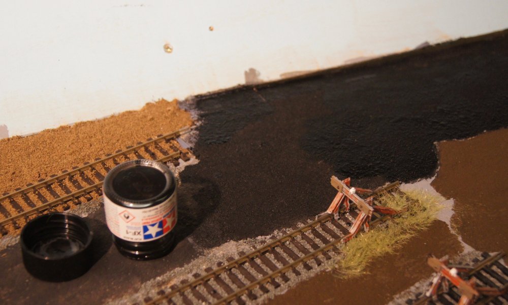

leslie10646 Posted June 16, 2020 Author Posted June 16, 2020 (edited) So, back to the sad tale of the SAND! When you apply Humbrol 66 (described as "Olive Drab") to a surface of sand on Gloss No.5, you should get a nice black-ish colour, as on my platforms - But instead, it came out quite a light GREY, look right at the back of the yard, please ..... Now how did that happen? Same combination of paints (No.5)/ sand (from Andy's sandpit) / paint (No.66) which should come up a nice tarmac-y black. Back to Mr Gravett to see what I'd done wrong. Easy (and very boring) the platforms have a Plasticard surface, on which was painted the Gloss No.5, the sand scattered on that and finally, after 24 hours a coat of No.66. However, Mr G remarked (and I IGNORED) that if you were putting a road, or whatever on a porous surface - to give it a coat of Shellac (whatever that is, especially in Lockdown). The observant among you will have noticed that the Goods Yard has surface of cork right across the place, so, guess what - a very different result! I found a tin of Black and sloshed on a sample, didn't look too bad, so continued..... and ran out of paint, just as I covered the last bit (for now). When does Kernow, Guildford open again? LESSON - read everything the experts tell you, not just the bits that YOU think are important! That's that for 24 hours while it dries. Edited June 16, 2020 by leslie10646 3 Quote
Old Blarney Posted June 16, 2020 Posted June 16, 2020 Leslie, Why not make your own mixtures? https://www.faspaints.com/fas-paints-blog/basic-primary-colour-combinations-worksheet It is a great deal less expensive and you get what you desire. Happy Birthday. 1 Quote
Old Blarney Posted June 16, 2020 Posted June 16, 2020 7 minutes ago, popeye said: Could you not have used dark grey paint? Don't be mentioning Green to him, he's from the North. You know the type, they want orange grass as supplied by a well know seed-merchants in Armagh - William Hannover Boyne, Battlefield Road, Armagh BT16 9O 4 Quote
Galteemore Posted June 16, 2020 Posted June 16, 2020 The address is incomplete though, OB - it’s White Horse House on Battlefield Road! Quote
leslie10646 Posted June 16, 2020 Author Posted June 16, 2020 Popeye, yes, I could, indeed, have used dark grey paint - however, as I liked the result with the dodgy combination which had worked on the platforms, I tried it again. Frankly, that part of the yard will see so little light you would be hard-pressed to determine the colour - my photos are lit by an anglepoise lamp which gives a false impression. Now..... I wonder if that black has dried yet ........ 1 Quote

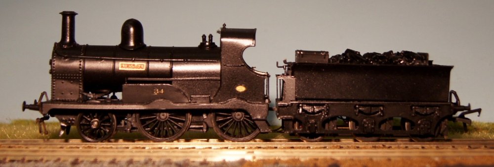

leslie10646 Posted June 19, 2020 Author Posted June 19, 2020 (edited) GUINNESS at RICHHILL: First a short clip (obviously hand held) of No.53 on an unlikely train. Richhill is still under construction and the position makes it very difficult to film - I must get my photographer son in to do it. MAQ03454.m4v Mr Glenderg, Architect of this Parish, built the buildings - the platforms etc are mine (the difference is obvious. However, it's a clip of his new train, hauled by a loco which would NEVER have been there, pulling wagons which didn't appear until 10 years after the station closed. Then, for those with two minutes to spare, two IRM trains cross, turn up the SOUND! MAQ03455.m4v Edited June 19, 2020 by leslie10646 9 Quote
