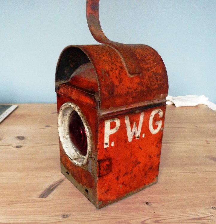

Wexford70 Posted April 23, 2020 Author Share Posted April 23, 2020 What would these different types of lamps be used for? Quote Link to comment Share on other sites More sharing options...
minister_for_hardship Posted April 23, 2020 Share Posted April 23, 2020 First pic, brake van lamp with removable red filter. Side mounted on van and you place the filter behind whichever lens you want to show red. Second, red tail lamp for rear of train. Both of these are British, although CIE bought in some of the British style tail lamps latterly, they didn't use the brake van lamp. CIE brake vans had the lamp housings built into them, the oil burners and red filters were changed around within the van. 1 Quote Link to comment Share on other sites More sharing options...
minister_for_hardship Posted April 23, 2020 Share Posted April 23, 2020 A few pics. In order of appearance. CIE Loco headlamp, CIE handlamp x 2, GSR gauge glass lamp (illuminating loco water gauge glasses), Duck lamp (inspection), Bardic (successor to oil handlamp), CIE brake van lamp reservoir and burner, oil tail lamp, pot lamp (pre elect and gas coach lighting), signal and LC gate lamp interior. 4 1 Quote Link to comment Share on other sites More sharing options...

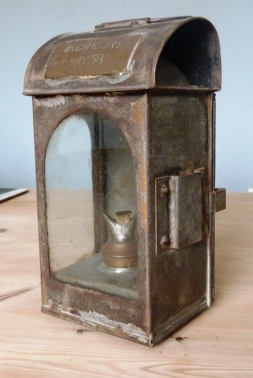

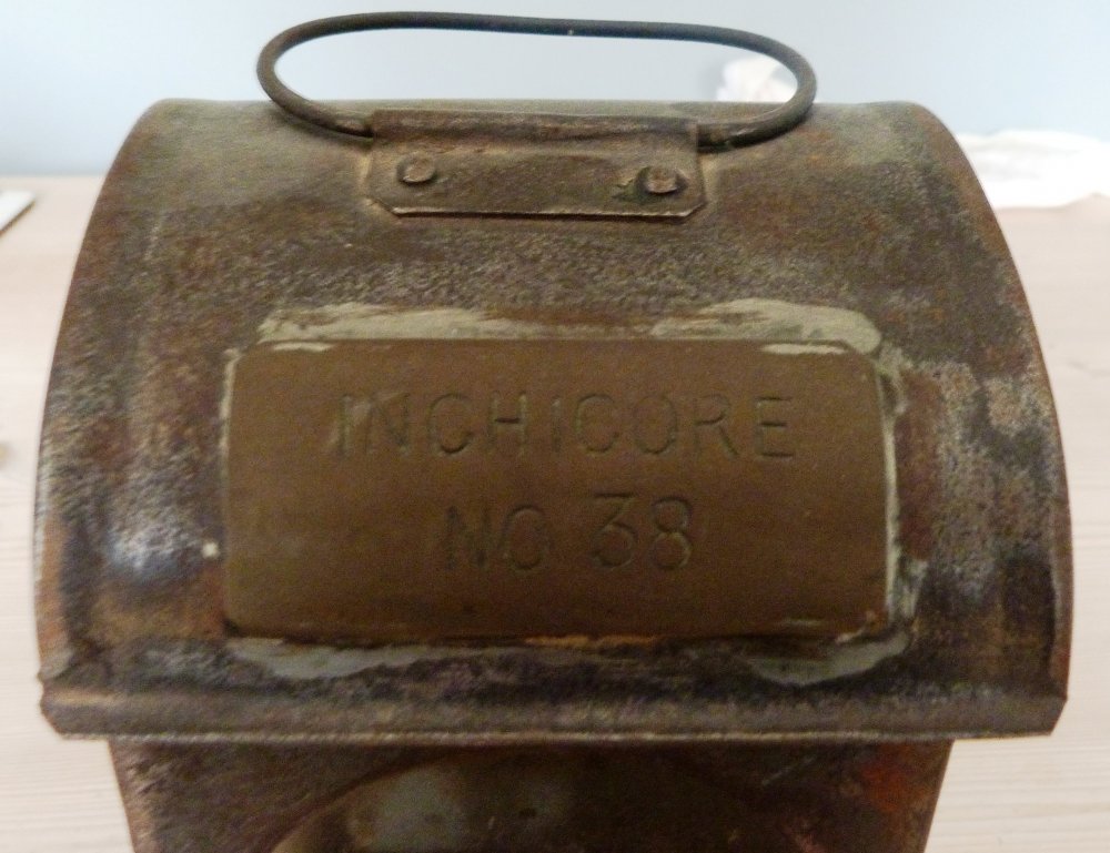

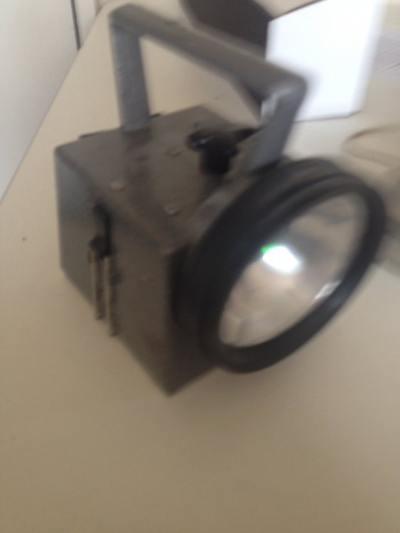

WRENNEIRE Posted April 23, 2020 Share Posted April 23, 2020 A few from the loft 3 Quote Link to comment Share on other sites More sharing options...

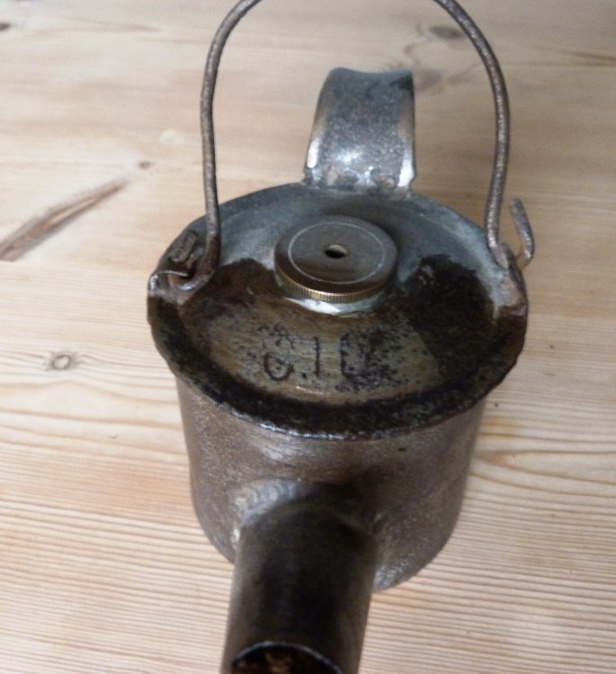

Midland Man Posted April 23, 2020 Share Posted April 23, 2020 Here is my one. Made by NRS Quote Link to comment Share on other sites More sharing options...
