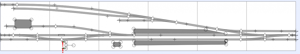

Angus Posted May 3, 2020 Posted May 3, 2020 (edited) Groan ! I've been pondering what direction my Irish modelling should take, I like to have an ultimate aim as this helps shape research and model construction. Until last year other than a fleeting interest in the SLCNR I hadn't given much attention to the Irish Railway scene, however, I decided to produce a small module (600mm x 225mm) for the 2mm Scale Association Diamond Jubilee Layout competition based on Dromahair Station on the SLNCR. The limited size of the module will restrict interest once the competition is over and it would be a shame to waste the stock built by not taking my Irish modelling further. Obviously the SLNCR shared tracks with the MGWR for the last few miles into Sligo and in the course of reading about the SLNCR my research has extended into the MGWR, a prototype to which I am become increasingly drawn. A model of Sligo Station is become a very attractive preposition. The time period will be early to mid 1930s (which I will deal with in another post). Whilst it is several years off being started (the majority of the stock will have to be scratch built and a core amount of stock will be required before the layout is viable) I thought I would start a topic to enable discussion and assistance to ensure the model is as an accurate representation as possible. The thread will also serve as a way to sort and capture the information for future use, and I hope, provide a useful resource for others. Working out the how and why and what was used by the real railway, for me, is a key part of any model build. So why Sligo? It fits in a nicely model able space, I reckon 9' x 1'6" will give enough room to model the station, engine sheds and junction down to the goods yard/quay in scale distance. I've already worked up a proof of concept Templot plan based on the 25" to the mile historic map available. A bit of shortening through the engine shed could be done without compromising the integrity of the model. The drawing above still needs a bit of work to correctly position the pointwork and achieve the smooth curve through the station approaches. The Engine shed is conveniently positioned to form a nice view blocker for the fiddle yard exit and the curve through the approaches and the station will remove the parallel to the baseboard "model" look. Whilst being a main town station there is little built environment in the immediate vicinity helping focus on the railway (and avoids the need to model time consuming urban buildings). The Station was built on embankment which gives an imposing look, quite different to most locations (as seen below in this extract form Google Street View. Apart from being the terminus of the SLNCR from Enniskillen it was operated by the MGWR from Dublin and the WLWR (later GSWR) from Limerick. Large quantities of freight from the GNR came in over the SLNCR along with the occasional passenger coach on excursion so lots of variety of stock which included the majority of my favourite Irish prototypes. The was no run round facility in the station which will add to operational interest. Although not as intensive as main city terminal the convergence of three routes did give a good number of trains working (I think 24, 12 up and 12 down, in the period modelled, more anon). Train lengths were relatively short ( and model able). I already have quite a few of the main texts dealing with Sligo but any pointers to the less obvious sources or photos would be appreciated. I do intend to get over for a visit at some point in the next few years, hopefully with my bike so I can cycle the SLNCR route. I can take some detailed photos and measurements of any structures that remain. Thanks for your interest. Angus Edited March 26, 2022 by Angus 6

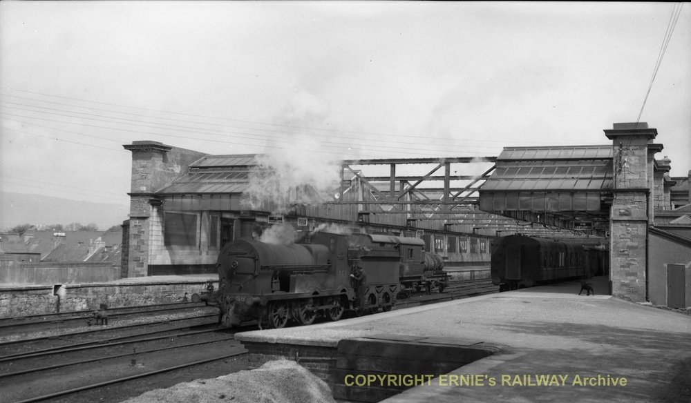

RichL Posted May 3, 2020 Posted May 3, 2020 I once thought about this as a project. The tall walls are a big visibility issue though, even without a roof. I concluded that it would be better to have spectators viewing the model from the other side - its the only way you get a decent view of the trains in the platforms. https://en.wikipedia.org/wiki/File:Entering_Sligo_station,_1948_(geograph_5308005).jpg There are plenty of trees to make a scenic break. Just a very gentle opinion though - you should do it your way! 5

Angus Posted May 4, 2020 Author Posted May 4, 2020 9 hours ago, RichL said: What about this one? Definitely a roof! Thanks RichL, that's exactly the view I haven't been able to find. IT will still be useful for the post civil war condition. With the post civil war girder roof I am hoping to make it lift out. I don't think this should be too difficult and that way I can have the best of both worlds, the roof in for photography and out for operating. The solid roof would hide too much of the trackwork and operation. 33 minutes ago, David Holman said: with enough variety to last a lifetime of stock building. Thanks David, Especially at the speed I build stock! hopefully I can get some core stock built in a reasonable timescale, will still involve 6 engines and associated trains if I define "core" as being one passenger and one freight from each of the feeding lines. Better get my finger out! 1

RichL Posted May 5, 2020 Posted May 5, 2020 There's another photo with the roof on here - good angle to judge what your model will look like (even roofless) https://www.independent.ie/regionals/sligochampion/lifestyle/sligo-railway-station-and-peter-oconnor-28982763.html 1 1

Angus Posted May 5, 2020 Author Posted May 5, 2020 12 hours ago, RichL said: There's another photo with the roof on here - good angle to judge what your model will look like (even roofless) Thanks RichL, another great photo. A couple of MGWR 6 wheeled coaches can be made including one of the characterful birdcage brake thirds. Also, is my imagination, or is the station home a dual repeater signal with two arms on the post? In all Post civil war pictures I've seen this is just a single arm.

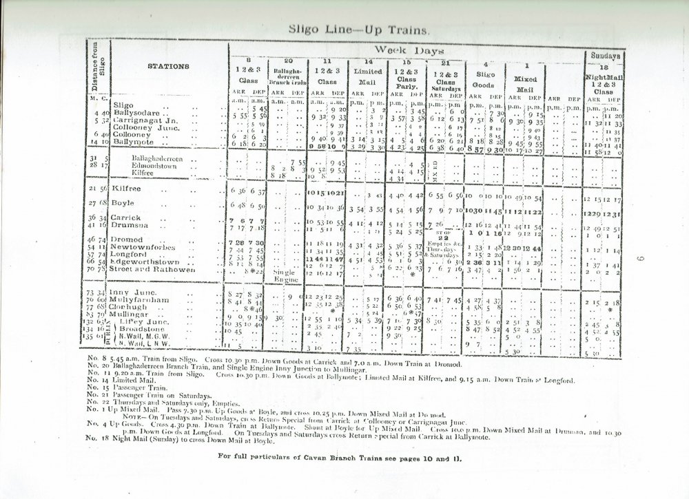

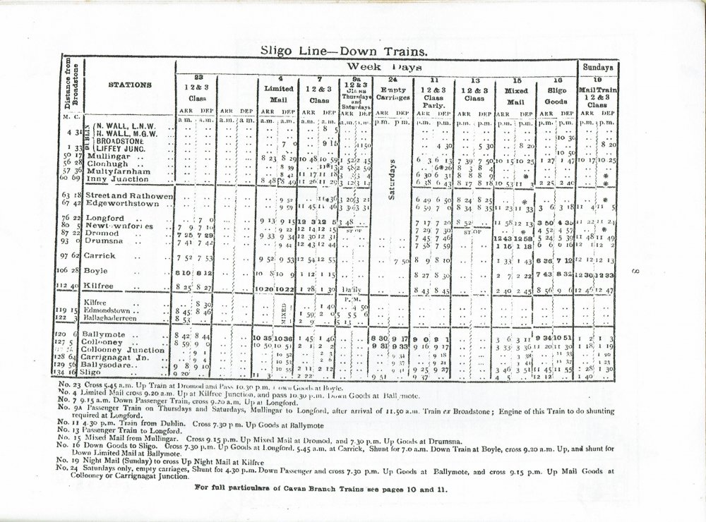

Mayner Posted May 6, 2020 Posted May 6, 2020 Relevant sections from 1897 MGWR WTT, there are unlikely to been significant changes in train workings and frequency until services were cut back during the Emergency 1 1 2

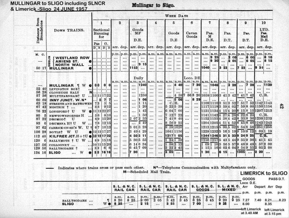

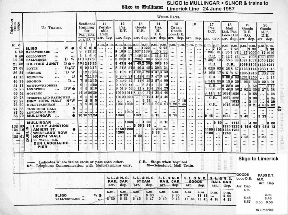

jhb171achill Posted May 6, 2020 Posted May 6, 2020 1930 GSR Working Timetable, Sligo area, in response to @Angus’s request. This includes the SLNCR movements, actually showing greater detail than the SLNCR records do. I don’t know if they’ll all upload in the right order but if you copy them, enlarge them and print them out, you’ll have the whole three routes into Sligo. The line from Dublin and Mullingar at this particular stage was monopolised by ex-Midland engines, mainly 0.6.0s and 2.4.0s, but the brand-new Woolwiches were appearing too, before the GSR moved many of them south. According to the late Billy Lohan who regularly drove on the WLWR line, by 1930 most trains on that line north of Tuam were J15s. 1 3
Mayner Posted May 6, 2020 Posted May 6, 2020 Holy moley! Three southbound passenger trains and a goods daily over the Burma Road in the 1930WTT , a far cry from the single Limerick-Sligo passenger during CIE days. There are several photos of ex-MGWR C or GSR D6& D7 Class 4-4-0s in addition to the 2-4-0s on Sligo Road passenger trains in GSR days, train consists appear to be short 3-4 coaches and the mandatory tail of non-passenger coaching stock & vans. The ex MGWR F or GSR J5 "Cattle Engine" and Woolwich Moguls appear to have worked the heavier through goods from Dublin and the various ex-MGWR Standard Goods (GSR J18 & 19) handled the lighter goods trains. Most of the ex-WLWR 0-6-0 goods locos were still in service and may have worked north of Tuam to Sligo, there are photos of ex-GSWR "Kerry Bogies" & 52 Class 4-4-0s on Limerick Sligo passenger trains, its just about possible that an ex-WLWR 4-4-2T or 0-4-4T may have worked the Sligo-Tuam passenger train. I don't know if anyone does a Woolwich or a Southern N Class in N Scale, an ex-WLWR 0-6-0 or WLWR tank loco would be a simpler proposition for a scratch build in any scale than a Midland or GSWR loco having a simpler outline with a straight running board. The WLWR 0-6-0s are said to be close to the GWR Dean Goods its just about possible that some may have retained their original Belpair boiler in GSR days. This Sligo thread seems to becoming more infectious that a certain virus, I have been planning to build a Burma or Mayo Road layout for the past 20 years, but Ballysodare-Sligo would give me a plausible excuse to run my collection of GNR, Southern and Midland locos and stock& CIE diesels on the one layout. 5 1

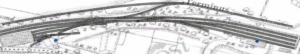

NIR Posted May 7, 2020 Posted May 7, 2020 (edited) 1 hour ago, Angus said: I'm not sure it works as I've compressed the eastern end to fit in a six foot length, the station is also a bit short. I've noticed compression seems to work the bigger the scale, 2mm scale really needs to reflect the real scale distance more. Thinking about it the ultimate in compression is 1:1. Look at any lineside photo, perspective compresses the track layout massively. Scale seems to impose a viewpoint, from distant to immediate. I expect the level of detail and the viewpoint need to align too. Edited May 7, 2020 by NIR
David Holman Posted May 7, 2020 Posted May 7, 2020 Here lies the dilemma between actual and fictitious modelling. Build a model of an actual location and you have the issues of finding a suitable view breaker for the fiddle yard(s), together with whether or not to compress/leave out certain aspects to fit the space available. Build a might have been or fictitious location and you can tailor everything to fit your site, but will it end up looking contrived? No easy answer of course! 3
