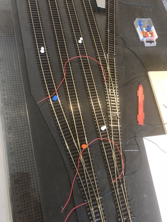

5 minutes ago, mmie353 said:
@murrayec is that also for Peco streamline? I know that set track is 67mm
It would all be the same, it's to do with stock hanging out over the rails on the bends and fouling a train doing the same thing on the other track, you may have some leeway with HO stock but if your going to be running OO Irish stick to above 65mm- at that dim Irish Cravens get pretty close!
Eoin
  • 0
You can, subject to experimentation with your own layout and stock, run straight (flexi)track much closer than the track on bends.
Flaring out the track slightly as you approach the bend, to the point where clashes don't occur..
  • 0
@mmie353just remember that Cravens were not the broadest stock to run on irish rails and some PRs and laminate stock (if ever produced) might be a scaled mm or two wider. The longer your stock, (Mk3s, 201s), the wider your stock, the tighter your curves, the greater the wobble when running (occasional cravens, uneven axle, imperfect handmade) the greater your chance of fouling and collision. The track can be a little closer on straights but must begin to diverge approaching a curve to ensure that minimum recommended as the curve starts. Long stock in particular will both overhang on the inside of the curve and the corner will project more from the outside of an inner curve relative to the wheel position
  • 0
@DiveController thanks dude, I was looking at the Peco gauges and I am going to get them, I may have to get them on Amazon but we shall see, must get some track and get a plan together. From what you and Murrayrec have advised, I may stick with going 67mm between the rails.
  • 0
On 7/26/2020 at 5:37 PM, mmie353 said:
@DiveController thanks dude, I was looking at the Peco gauges and I am going to get them,..... I may stick with going 67mm between the rails.
The gauges are usually back to back to measure the distance between the rails on one track. There are others but don't know that much about them. The 67mm rec is from between centers (or any given same point on both rails e.g inside of the R/H rail on track 1 to inside of R/H rail on track 2).
It might be easier for spacing to lay two parallel tracks with 67mm centers and then measure exactly the correct distance between the rails of adjacent tracks (less than 67 mm), or between the sleepers (less again). Then you can get some spacers to shove between the tracks as you lay them rather than keep trying to measure 67 between centers.
Other option is to mark one track center, then an adjacent line 67 away and stick your pins in but it get trickier if you want to put down cork or closed foam then you remark etc. Seems like spacers would be easier and if you get a mm or 2mm off laying the first track, your track separation is maintained
Edited by DiveController
