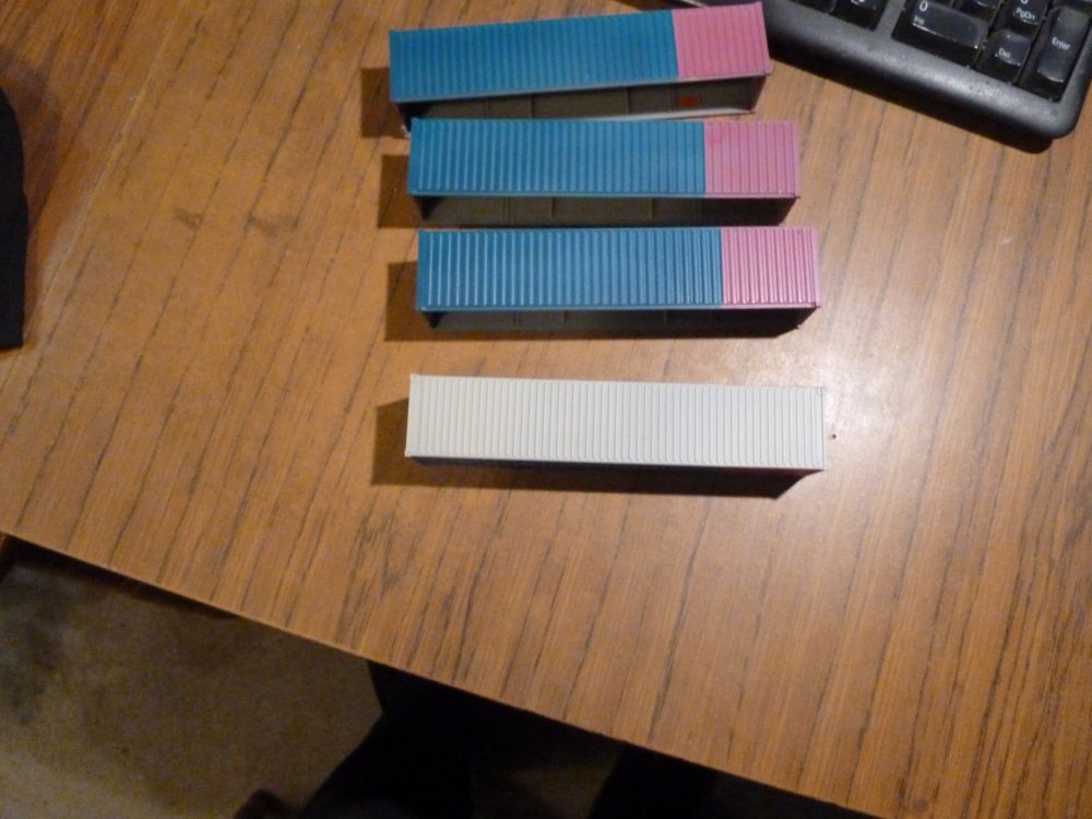

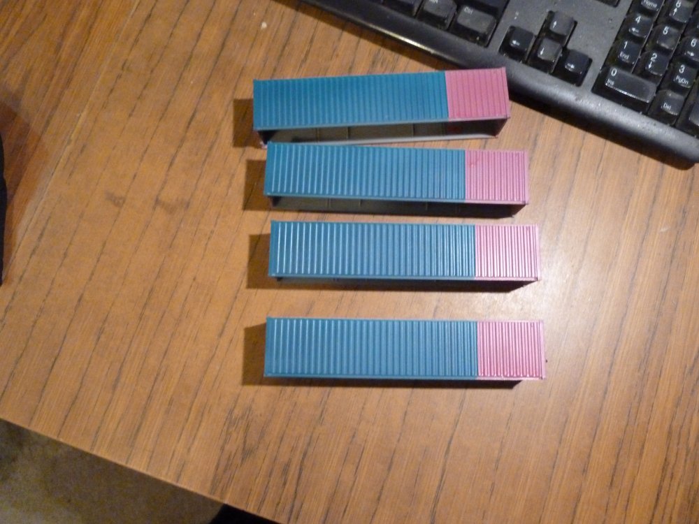

Robert Shrives Posted October 12, 2020 Posted October 12, 2020 Hi I bought 4 unpainted 40 foot boxes from Arran at C rail the other week and Bell transfers from SSM For painting I have found that the Bell magenta is a good match to P297 Precision paints First group Magenta (dull) The blue I used P140 BR electric blue and this matches very well to the 20 foot container to my eye The roof is P151 BR rail grey. Pictures to follow when all dry and masking removed. The door gear seems to have started magneta as well but also just plain galvansied grey/silver so will do two in each . The blind end and door end and sides to 10 ribs in Magenta, checking several on line phots. When transfers land I will do a final pic. Hope this helps somebody else in time Robert 2
Robert Shrives Posted October 12, 2020 Author Posted October 12, 2020 Having got masking off they might be a shade light compared to the 20 foot I have but look ok all the same and I blame some time in a sunny climate has faded them ! 1

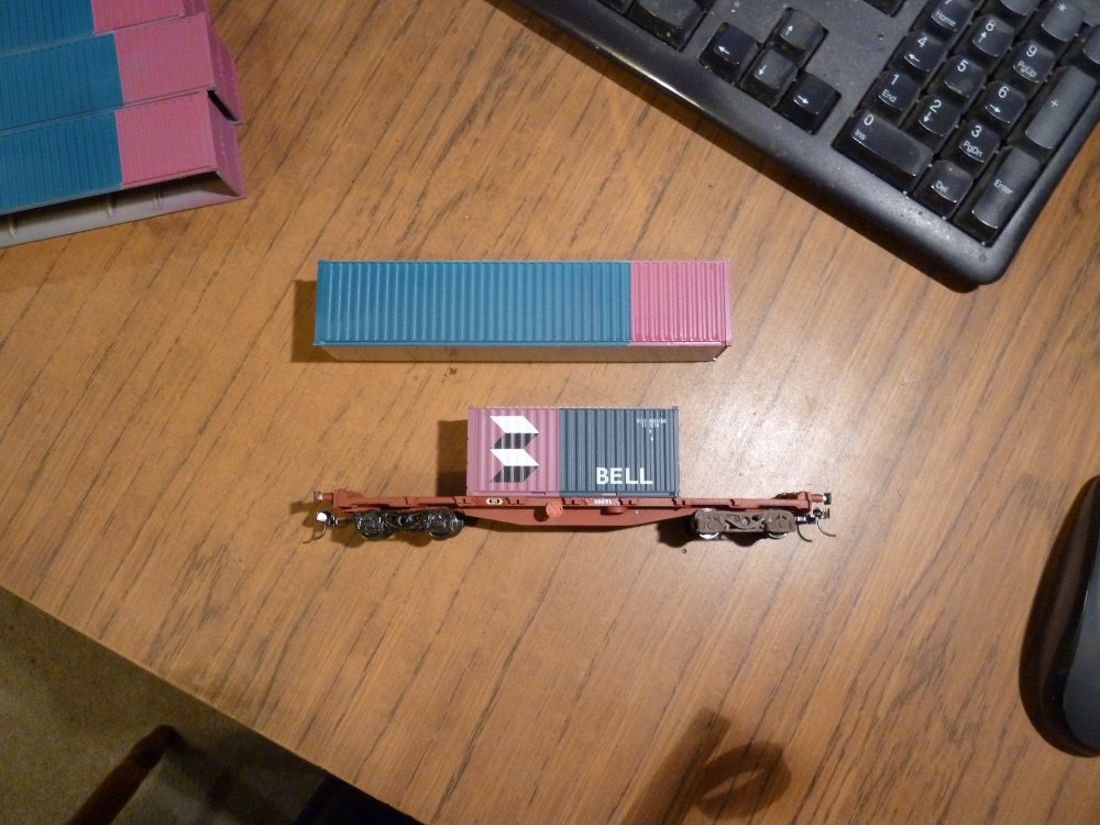

Robert Shrives Posted October 13, 2020 Author Posted October 13, 2020 A couple of views: side view ,then top down of one and a comparison . I have added 20grammes of sticky wheel weights to the floors ready to refit once transfers are applied. 3

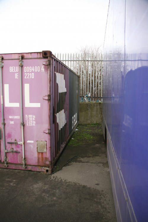

Arran Posted October 13, 2020 Posted October 13, 2020 HI All The colours i use for BELL are all pantone for bells , something that i scraped and cleaned bits on a 20ft at Leith docks. Although faded the true colours are underneath Regards Arran 5
Robert Shrives Posted October 13, 2020 Author Posted October 13, 2020 Hi, I am certain Arran you got the right colours but I was trying from my large stash of tinlets to get close, perhaps not close enough on the blue but masking was such a faff I think they will stay. I look forward to more 40 fts from C Rail stable in time - meanwhile this does for me and can always get used as scenic land fillers. Thanks for great pic - weathering really useful and a good find of the box. happy modelling Robert 1

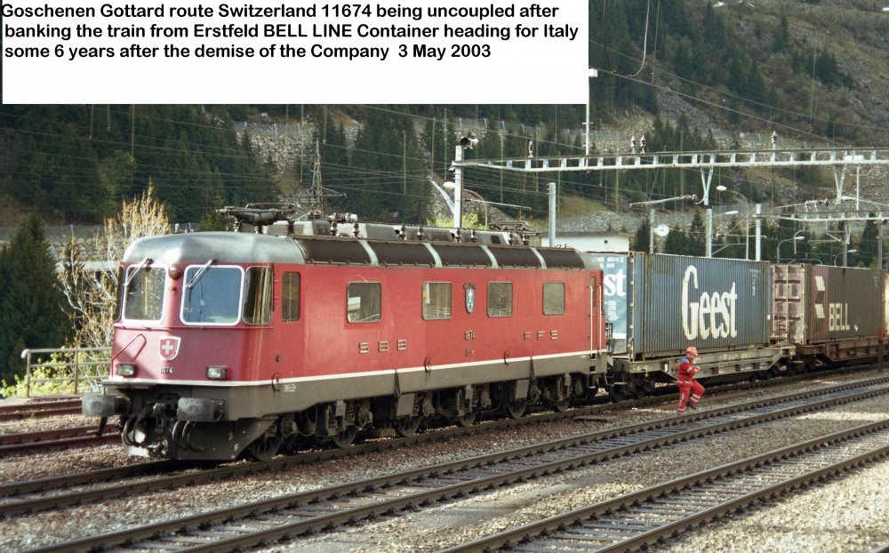

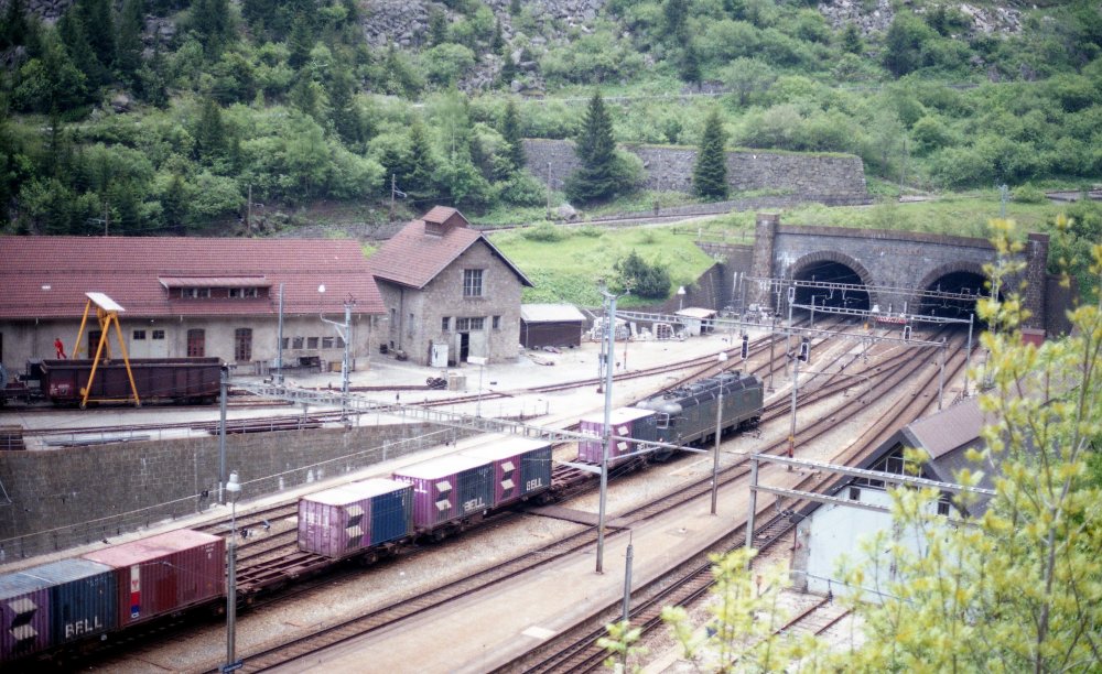

Irishswissernie Posted October 14, 2020 Posted October 14, 2020 (edited) I came across this one today whilst sorting out some Swiss negatives. Rather faded or possibly lighter paint on the Container end. Some 6 years after Bell Lines folded. EDIT Another one at Goschenen 26 May 1988 20 foot containers , white roofs but possibly one grey or just dirty. Edited October 14, 2020 by Irishswissernie 4
DJ Dangerous Posted October 14, 2020 Posted October 14, 2020 To be honest, the rooves in Arran and Ernie's photos look more like a faded Bell blue to me, than an actual grey.
jhb171achill Posted October 14, 2020 Posted October 14, 2020 (edited) 16 minutes ago, DJ Dangerous said: To be honest, the rooves in Arran and Ernie's photos look more like a faded Bell blue to me, than an actual grey. Correct, that’s what it would be. When at sea, salt spray would wear away at it. Or - grubbied white. Edited October 14, 2020 by jhb171achill 1

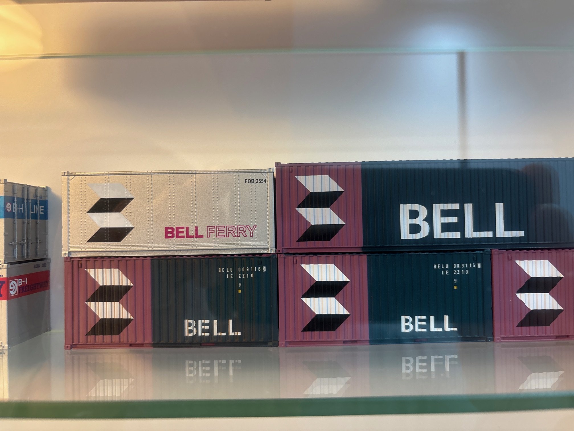

Mol_PMB Posted July 2, 2025 Posted July 2, 2025 8 hours ago, Arran said: HI All Well some food for thought in this little lot. Is the the Netherlands ? Regards Arran I've only watched the first few minutes and already seen some excellent container photos, particularly the early 'silver' (unpainted alloy) Bells. For example, from around 4:55 there are some good shots of the flush-sided type which I represented with a simple repaint of one of your boxes, top left here: In the early days of Bell, there were several subsidiaries including Bell Ferry and Bell Lines, and some of the early containers were lettered as such. I chose a Bell Ferry example that I found a photo of in Ireland; some of the photos in that youtube link show the Bell Lines equivalent. Nice to see some good photos of some of the sheet and post alloy types used by Bell in the early days too. Most of the images do seem to be in the Netherlands. 1 1
