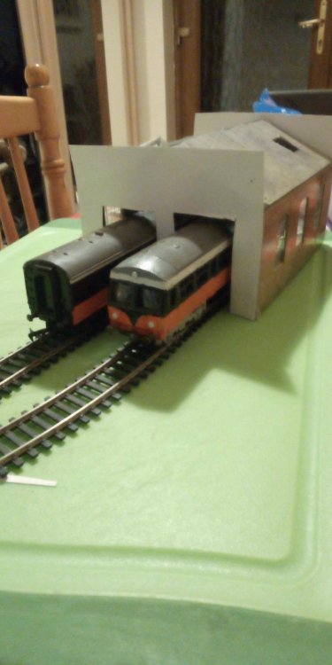

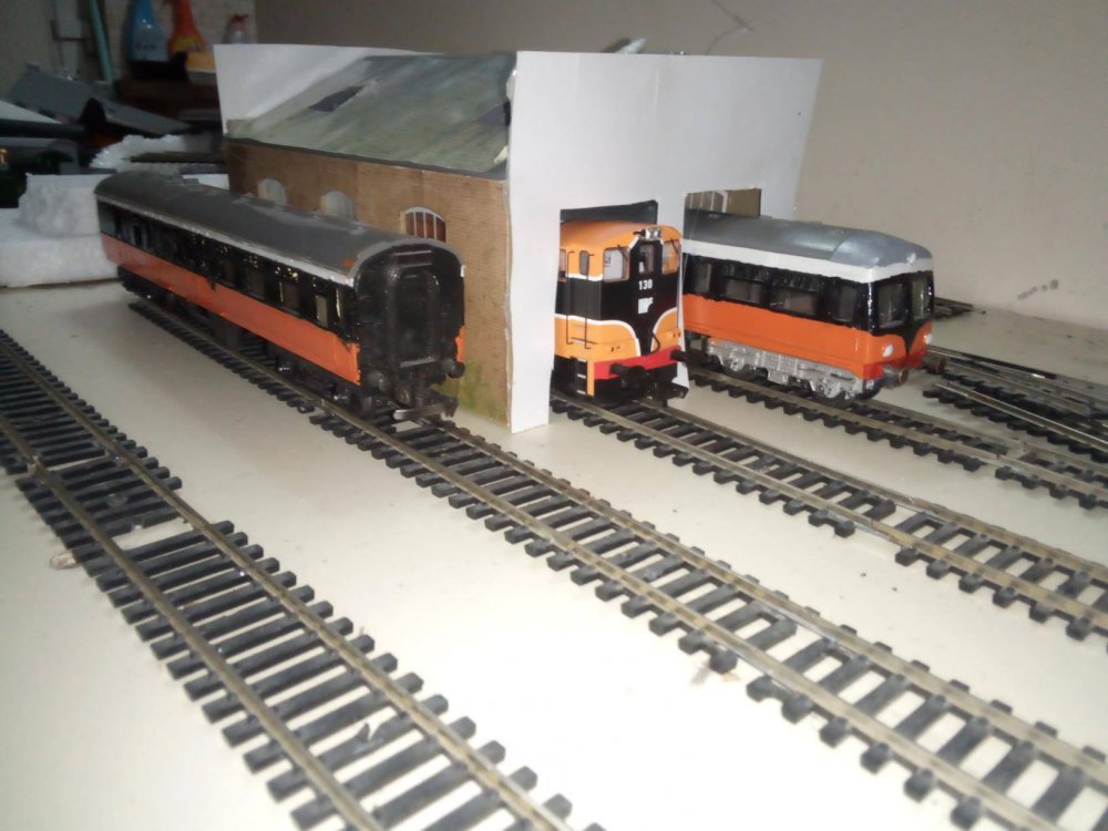

at the other end of the layout will be a 2 road tmd building with some sort of fuelling stand. this tmd will require regular deliverys of fuel from the depot at the other end of the layout. beside this depot are 2 sidings which serve both the tmd  and the container yard, and therefore could be occupied by anything from coaches and locos awaiting work, to container rakes to permenant way sets. and as previously mentioned fuel deliveries.
As 130 will operate the layout regularly i may opt to install a turntable in the rounded area of the track plan. the other open part of the layout will be modelled as a general industrial area

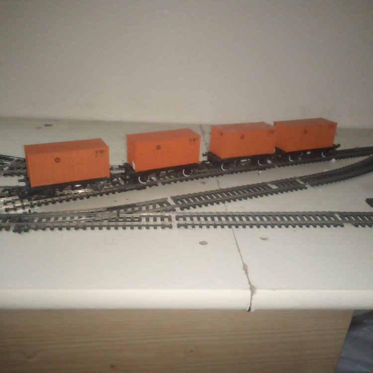

4 20 footers sit in the goods loop

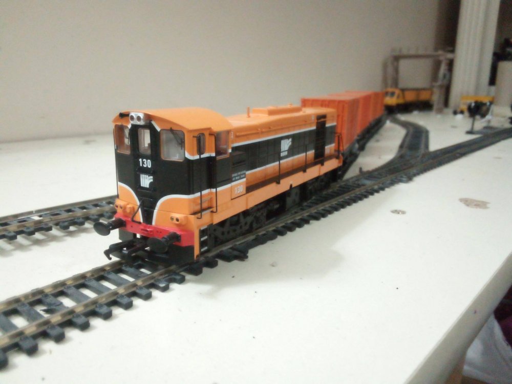

mm130 looks right at home amongst her stable of home made friends. a second lane can be added to the engine shed later

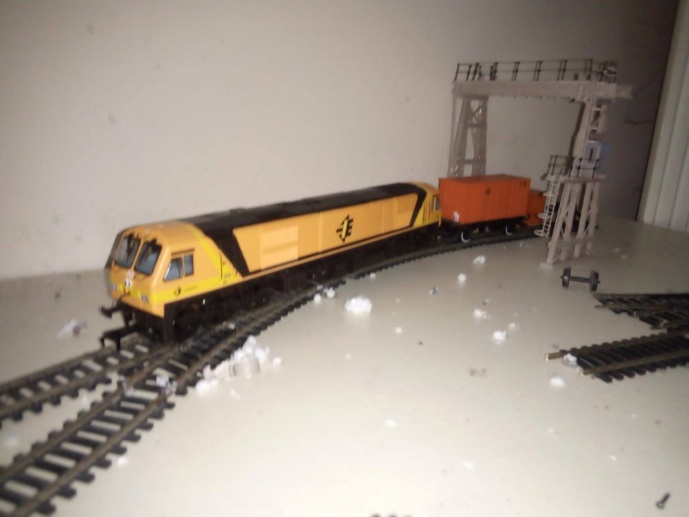

203 shunting a single container.as the crane line is also used as the layouts headshunt it must be kept clear at all times. this is why containers can be kept at the tmd sidings.i must also finish the crane.

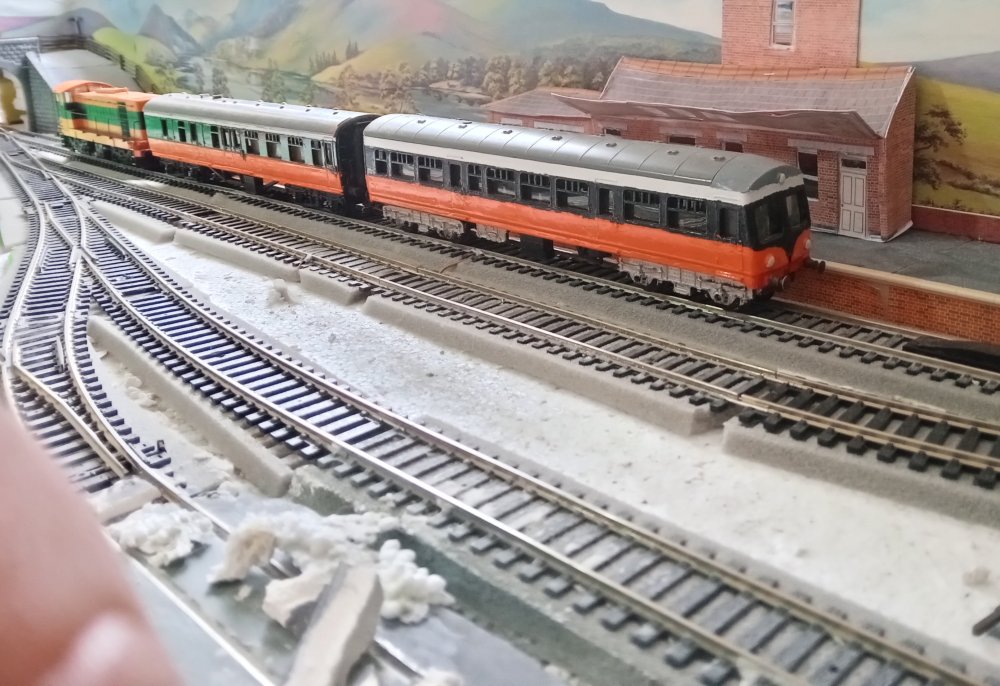

141258874_458138692237653_3885622794834519557_n.thumb.jpg.20fe01fea331584693cdd17b23a966b1.jpg
watching youtube videos of inchicore and one distinctive building with a 2700 poking its head out stood out to me so ive started a little project to convert my hornby shed into somthing similar.
if anybody knows the building im on about and would have more close up pictures of it they would be greatly appreciated.

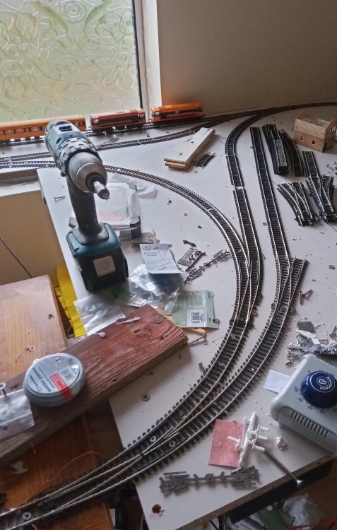

140740048_3561040947342407_29159050963165639_n.thumb.jpg.fd2222a171b57634134f941828f36332.jpg
i like this atmos, will look like a nice little yard when it all comes together.

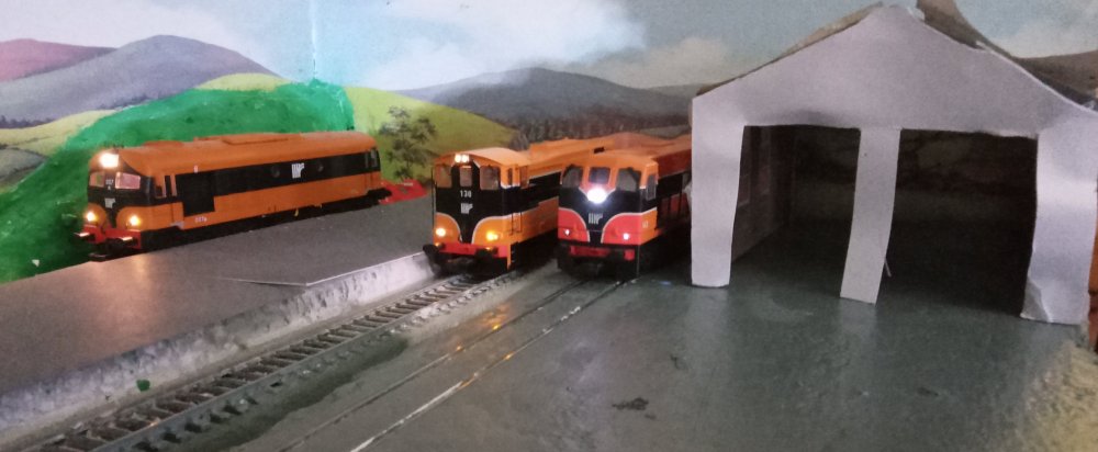

140280032_426477875166814_1221168016682135247_n.thumb.jpg.e4973b49bb1215c84f4326aabc1ccad5.jpg
short container runs look great too, so these along with a couple of IRM flats and a few bells etc will look great on this. there are also 9 dapol tankers under construction(and 5 vans for the micro 🤣) so there will be no shortage of stock to run on this.

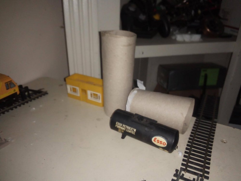

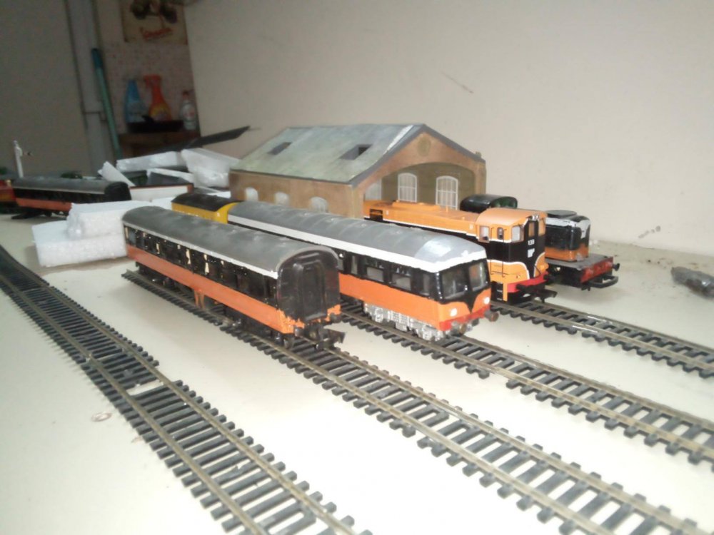

not a huge amount to report from the oil depot side of the layout cut up a few kitchen roll tubes and an old dapol tank to try and turn into big static tanks at a later time.141771467_440556387072254_3605374844460819195_n.thumb.jpg.4f47a8be4130e72069d79758857b0b1f.jpg

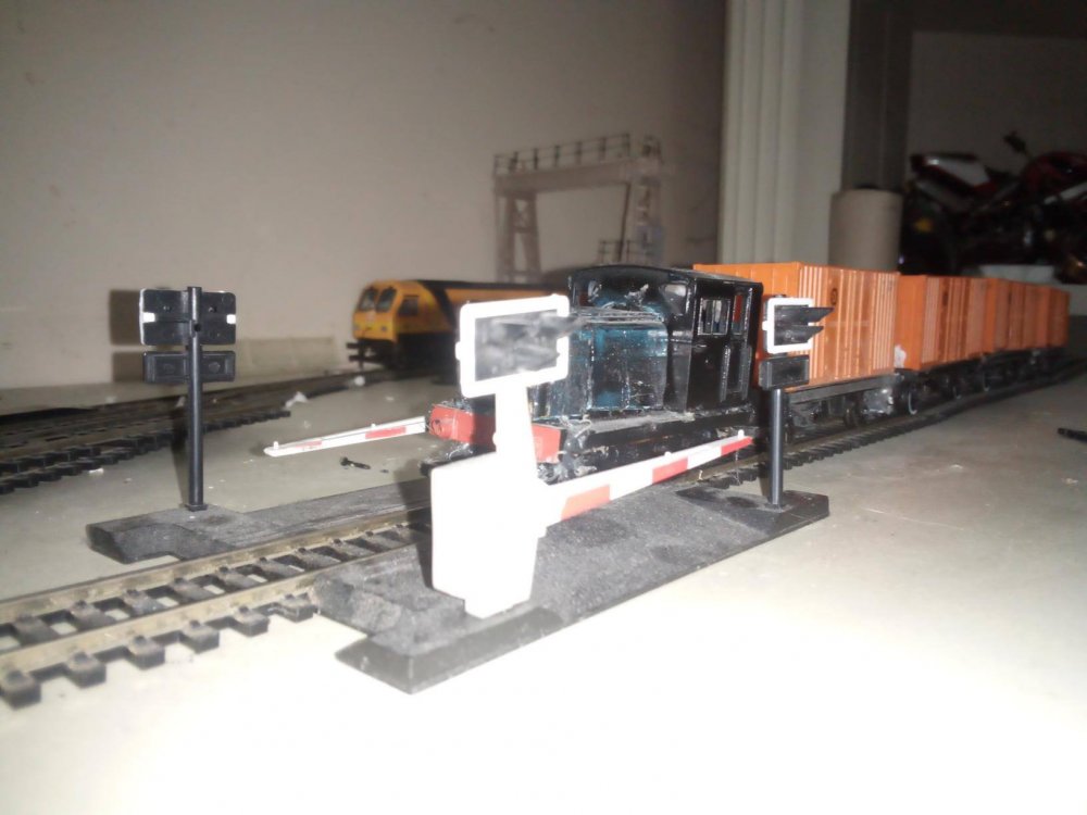

and finally not really 90s but the little deutz that could 😅
So whilst i havent really done much i have fashioned up 3-4 little scenes of interest on a very small layout, so im pleased with that.

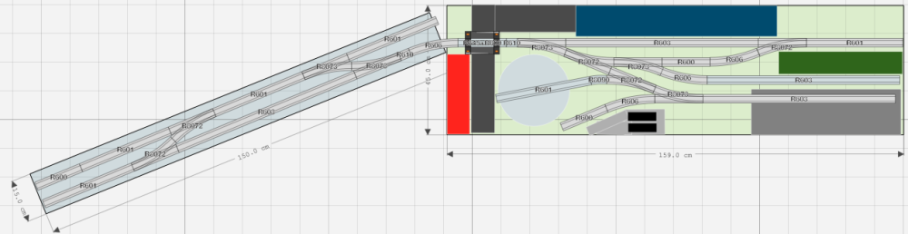

onto the track plan, i have coloured in the different elements for easier reference. i am basing the layout on a terminus in a yet to be decided location in the IR points era.
the train enters by a fiddle yard on the left side and the view will be obstructed by some large building placed within the red area.
the track crosses the road leading up to the station in blue and stops at the station, passenger traffic either runs round the train and exits, or simply push pull exits the layout. 130 hauling cravens must use turntable.
I am hoping to motorise the dapol turntable for this project but thats neither here nor there at present :P i have a solid idea in the pipeline for that.
the rectangles in the top right corner represent a fuelling point for the locos and the green box represents an old disused goods platform, inspiration for this taken from the old westport quay goods platform. the middle siding does not see much use since the end of loose coupled goods and will be suitably weathered, but it is occassionally used for overnight storage during busier periods.
the bottom gray rectangle will be the freight yard and the track will be buried in the standing to give vehicles access to both sidings, have always loved this look so finally need to try that out. originally there was a gantry crane but i have removed this in favour of the large forklift type vehicles. this also allows me to model a number of different industries as time and money allows as the yard will not be defined to have one single purpose. to use the middle yard or siding the loco must first run around and then propel its rake into the destination siding.
finally the small siding down by the turntable is simply a small loco spur to be used when a loco has to stand for some reason but it will give the operator scope to work 2 locomotives on the layout during a session. would it be better to move the fuelling area down to here also or is it better left situated where i have it now? perhaps i could plop an old engine shed here.

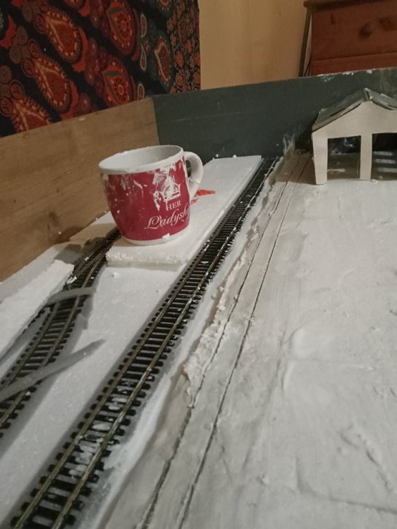

Ive already got a nice baseboard for this, but i need to make space for it, so im going to take the oppertunity to upgrade it a bit and add a backscene and sides before i get started properly, should get a test track down pretty soon though as 007 is in the post!
would love to know what people think of this idea as a whole? i want the actual operations on the layout to be as realistic as possible but there will definitely be some artistic license to running some non period stock also.
Thanks

While the track plan seems ok, angling it across the baseboard, as per the first photo, is always better visually. If you can run to Peco code 75 track and points that will also make a difference - if not, operating the layout at eye level will help hide the narrow gauge and heavy rail section. Likewise inset track as per the front siding.
 If there is room at the right hand end of the layout, having one of the sidings, or the headshunt going off scene adds a multitude of possibilities. It could be just a single siding, or it could lead to several. Either way, just 30-50 cm allows you to add all sorts of wagons to serve whatever you fancy. As for the turntable, Frizinghall Models do a hand cranked mechanism (essentially bits of Meccano), which works very well and includes getting power to the track.
Seems the basis of a good, clear idea there and while there might be tweaks along the way, l'd say go for it and continue enjoying the execution of the plan to enjoy it all! 👍👍👍
would you believe that is exactly what i had planned in an earlier drawing, the approach line was a bit shorter and the level crossing and road on the very right hand side of the layout. the bottom siding was going to run off the baseboard and onto another small little modular scene that i could change as i seen fit and served with a diesel shunter.
sort of abandoned this idea due to space constraints as i have also sort of turned into a fish tank hoarder over the past year and thats a dangerous game within itself! the current plan allows the user to operate with or without the fiddle yard as space allows.

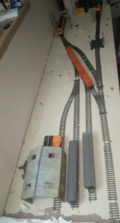

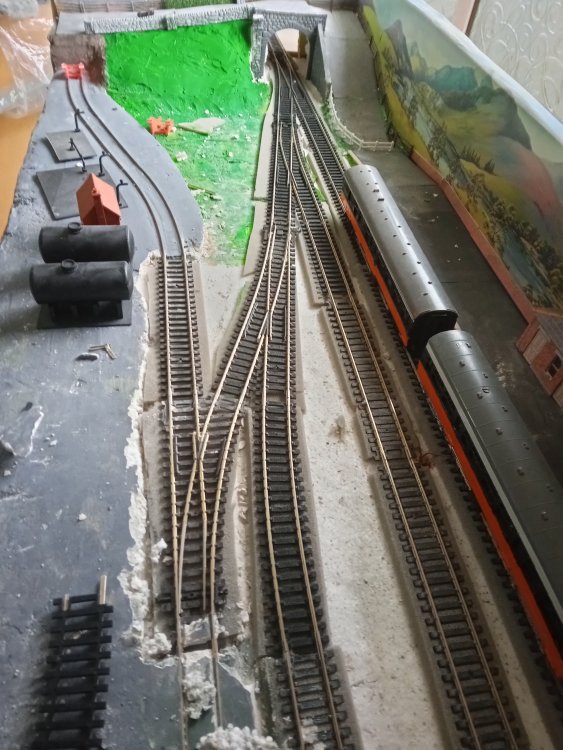

track is down to test out clearances, whilst the layout is good a little tweaking needs to be done regarding the loop and sidings length, i reckon i will compromise with slightly shorter sidings so that the loop can hold 120 foot of rolling stock.
my goal is to be able to fit class 201 into either of the headshunts and 3 flats or 2 cravens within the loop. so its gonna be tight! but just about doable. worst coming to worst i will have to shorten the approach fiddle just a little bit.
have a few solid ideas for the turntable but have as of yet to attempt to execute any of them., a shaft, motor and gearbox have been mated to the dapol turntable, but i havent gotten any further than that just yet as ill need to mount it to somthing before testing it out. the motor has a rotary encoder for position sensing with a microcontroller, so im confident i can pull somthing off with it.
plans for a fiddle yard are in the works, however as im very space limited it may have to be set up and put away with each operating session.  in that case i would really like to be able to operate the layout with no fiddle. once buffer stops arrive i will be able to work out just exactly how long the sidings MUST be as it the moment they are simply based on settrack lenghts and guesstimation.

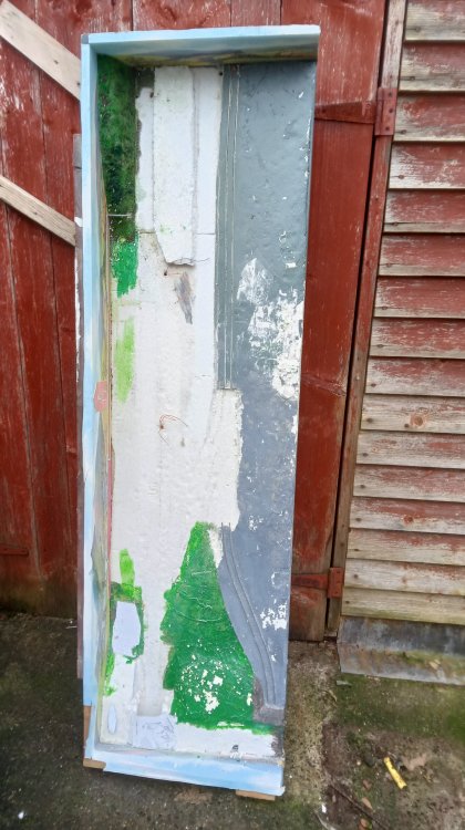

Following a successful trip to marks yesterday planning permission for the fiddle yard has been granted in the most unusual of locations, hopefully the drivers do not become too distracted by their new aquatic overlords.
272636873_655418435774557_8700600471004425431_n.jpeg.95825c5ae342d1cb4c51e179d7e1cbc0.jpeg
PWD have been brought in to take care of construction of the new line. (very tempted to turn the spoil boxes into 4w barytes although i know i really shouldnt, lol)

probabaly the final track plan, offering heaps of siding space and a massive loop. still need to tweak lenghts on the fiddleyard, a balance must been found between loop lenght and siding size in order to maximise workability.
fuelling area is a the loco spur now, which actually gives justification to have the spur and its also space for a rake of tankers.

Finally have everything laid (except the turny. more to come around that, im bouncing between 2 very different ideas) backscene soon as i cant avoid it for much longer nearly time for the A class to travel under its own power for the first time. need to set up a circle of track somewhere for that all important running in.

also got some new containers. not too fussed about the livery being prototypical here as im sure clients will have changed from time to time on the real container network. im sure the evergreen car will derail violently at the level crossing at some stage and become lodged for a few weeks.

Some lovely new mk2's have been sourced in order to handle  passenger travel on the branch.
the colour on these seems to be closer to 130 than on 007 so adding in stripes and such should be easy,  however it is far more plausible that they kept this ST livery into the 1990s if they are working this backwater branch station all the time so i may keep them as is, "Intercity" is just the livery that i remember from growing up, was a little too young to see or remember any supertrains.

sizing up the sidings and loop.

Today on the Railway;
Railcar turns on turntable for the first time, with a satisfying index click to altert the user on proper alignment!
next time ye shall see 130 use it under its own power.

All track has been temporarily lifted and the basedboard is gone away until tonight to have a backscene installed.
272824146_355966199413647_3264311791015180728_n.jpeg.26fca2e985b0b60543960f26027a1c5c.jpeg

lifted everything off the board again to do the usual "slab the whole yoke with polystyrene" treatment and to lay the underlay, hopefully the trackwork is a little more forgiving now!273670015_660209105179449_7314909145028738222_n.jpeg.1d8a7024331e7c1a4896ba7ead6e2f5b.jpeg
just about ready to fill this lot in with das and hope for the best! madly the styrene exactly matches the rail height with the underlay underneath!

Irish Locos, working lights, hard standing,  irish bufferstops, lights reflecting off rails, ive died and gone to model train heaven. :D
273986171_1340985173013338_4102898973894855515_n.jpeg.e9f1f3789b3084276d87f771392a7633.jpeg
Happy to see a few different sub projects coming together in completion on the baseboard.
