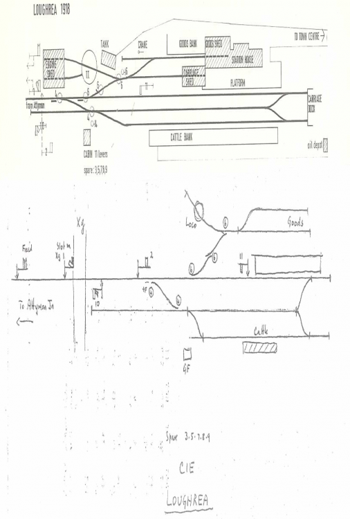

I dug out the book on the Loughrea and Ballinrobe branches, which has the 1918 diagram and also a 1961 diagram, which looks rather the same! I hope that TRA don't mind reproducing the diagram, but I think it is some time since the book has been available. The outer home is clearer in the second diagram, and is really there for the level crossing. The discs are point indicators, worked off the adjacent turnout. The last one I can remember was at the traps from the goods yard at Gort.
I would not disagree with Snapper's suggestion, except that it seems over-signalled. It is more like what a UK heritage railway would apply now under current regs, rather than what historically would be put in, which would probably be a home, starter and a few discs, with hand signals for a lot of things, given there would be few locos moving at any one time - generally one. JHB, I would suggest your layout looks rather like Loughrea in part. Perhaps if you have the Transport Research Associates Baronial Lines book, it may have a diagram that might offer some help? As a comment, I'm not convinced about the three-way point (too expensive for a poor Irish branch line?), a trap would be needed exiting the goods/run-round to the main line, and the crossover to the goods/loco would be operated as such to ensure there was a trap from the goods. However, as is said many times, it's your layout and do what you like...
