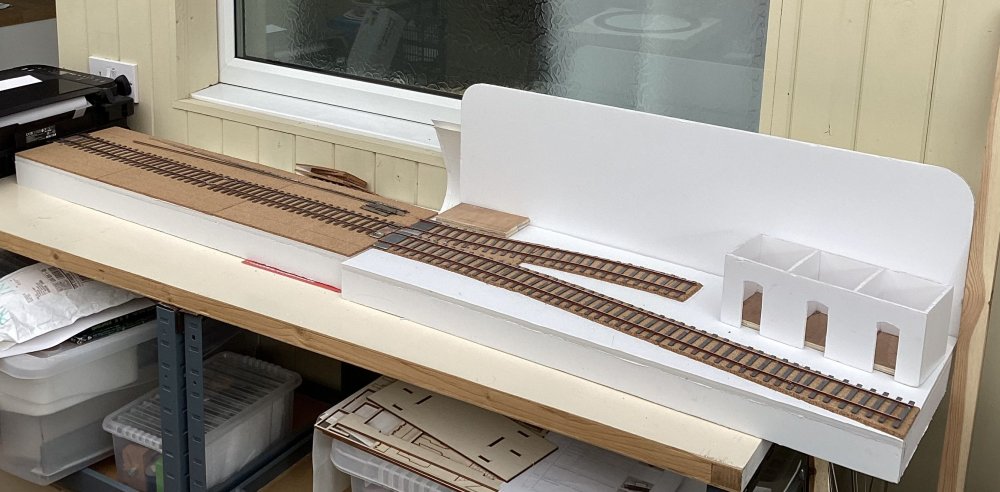

Galteemore Posted November 21, 2023 Share Posted November 21, 2023 (edited) For a while now it’s been apparent that my plan to build a slice of Florencecourt won’t happen immediately, as I just don’t have 12’ of convenient space to put up the main board fed by fiddles either end. But I was feeling rather guilty about the three baseboards and trestles I’d built two years ago for the project. I also really need some kind of layout on which to test out locos and stock - even just a bit of back and forth. Much head scratching and I realised I could use one of the boards to make an Iain Rice cameo, with two tracks fed by a cassette fiddle. This can stay up more or less permanently in the workshop. So a busy morning at our local community woodwork facility saw the carcass made……and painted in SLNC station colour of grey/blue. So if I can’t model Florencecourt - for all its simplicity - what on earth can I model? Why Enniskillen of course! Sounds lunacy but check out…..https://www.carendt.com/micro-layout-design-gallery/passenger-lines/ The Farthing layouts are also inspiring….https://farthinglayouts.blogspot.com/ - layouts built as various sections of a station. I had initially thought of modelling a segment of Dromahair goods yard to allow a shunting puzzle but that would rule out passenger ops. Then I recalled dear old Carl Arendt’s micro terminals as above. So I can model a section of the SLNC bay at Enniskillen. There was no run round so quite prototypical for trains to run in and propel out. The canopy will be at rear of layout - just have to work out how to imply that the station continues beyond ! Trains will be short but it’s better than no layout!! And in any case I am more of a rolling stock constructor than an operator at heart. With some thought and care, I could run the full SLNC timetable with the right stock. After all most services were by railbus so quite short in length - and the goods services would often shunt as far as the dock platform. Thus lots of scope for meaningful minimal space operation. Unlike anything I have done before this is straight out of Rice’s cameo layout book in terms of planning from day 1, rather than the suck it and see approach of previous efforts. Shunting, for instance, will be hands off - no space for electro-magnets so I am not using AJs. I have ordered a batch of Flippems from our own @Bob49 and when those arrive I will start experimenting with magnet placement. Edited November 21, 2023 by Galteemore 15 Quote Link to comment Share on other sites More sharing options...

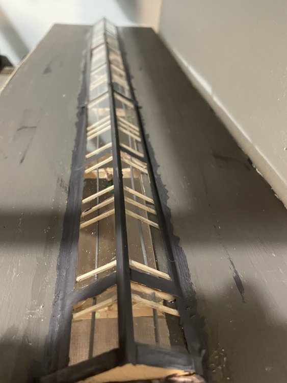

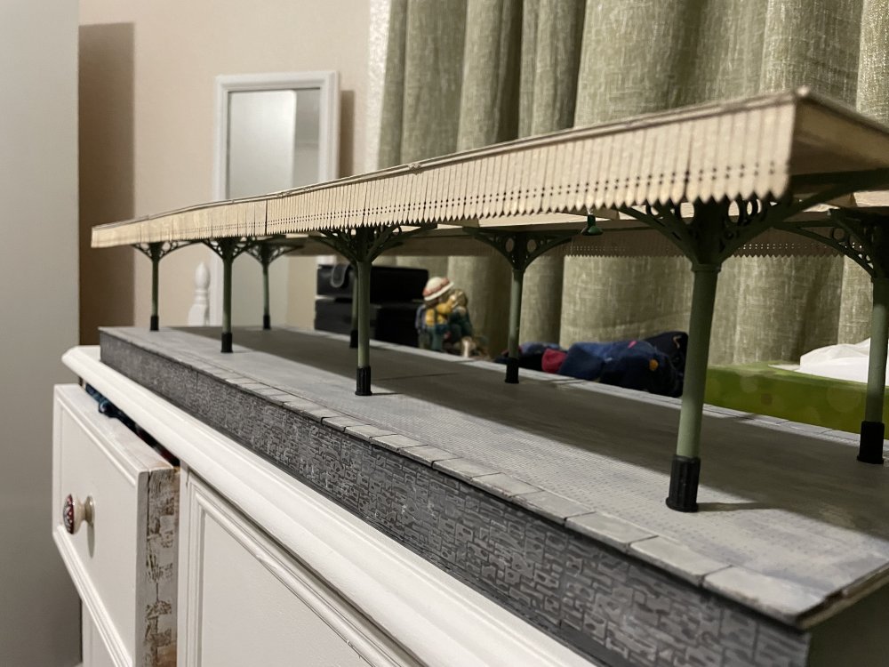

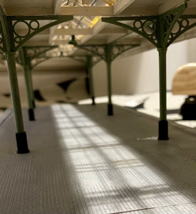

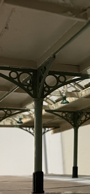

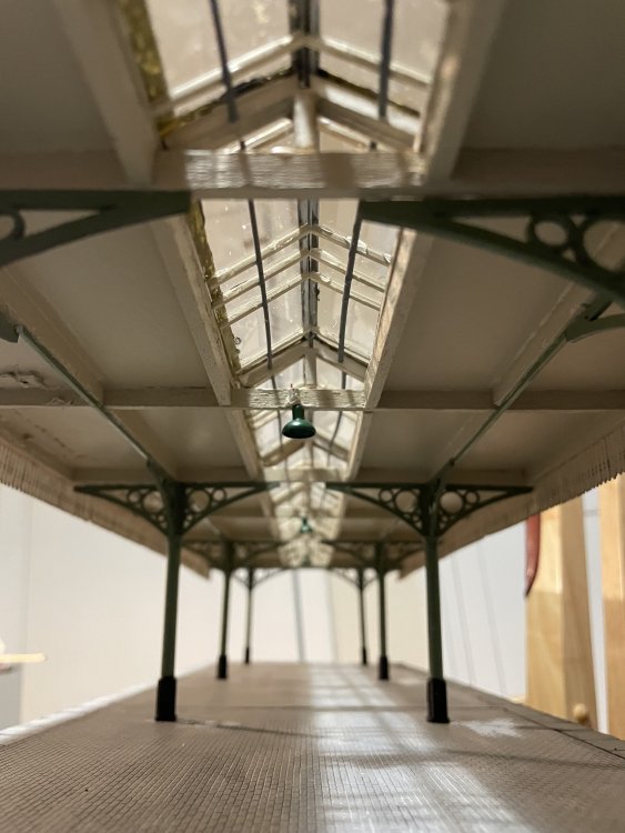

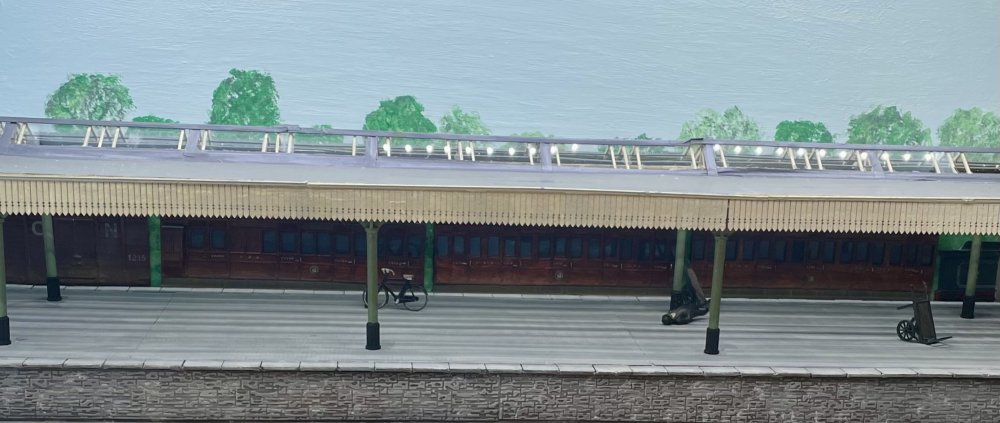

Popular Post Galteemore Posted January 22 Author Popular Post Share Posted January 22 (edited) Being only a scenic area of 2’ long, there’s not much scope for buildings. There’s one key structure for Enniskillen, though, and that’s the canopy. Ernie’s photo archive was incredibly helpful in identifying the various component parts. Hesitant though I am to post GNR architecture in the presence of @Patrick Davey, here we are….. Much hacking about of various laser cut canopy parts, cruelly mixed up with plastic rod and superglue, plus 12’ of obeche wood. That was the simple bit. The complication lay in the fact that - only really gleaned from careful photo analysis -was that there was a very low-pitched roof light. This took a lot of careful construction from 1mm Perspex sections, butchered laser-cut roof trusses and plastic strip. Omitting it was not an option - although it would have simplified matters enormously - as the light and shadows it provides will be critical to the composition. It’s turned out reasonably enough. Colours gleaned from Ernie’s SLNC album as shown. The dodgy, misaligned daggerboards are prototypical btw! Edited January 22 by Galteemore 11 16 Quote Link to comment Share on other sites More sharing options...
Gabhal Luimnigh Posted January 22 Share Posted January 22 Looking good, that's a great likeness, well done you. 1 Quote Link to comment Share on other sites More sharing options...
Patrick Davey Posted January 22 Share Posted January 22 Now that is a work of art GM, it truly is! Looking forward to seeing more progress! 1 1 Quote Link to comment Share on other sites More sharing options...
Patrick Davey Posted January 22 Share Posted January 22 Great job on the actual platform as well 1 1 Quote Link to comment Share on other sites More sharing options...
Noel Posted January 22 Share Posted January 22 That could be the centrepiece of any layout. Love it. 1 Quote Link to comment Share on other sites More sharing options...
jhb171achill Posted January 23 Share Posted January 23 Superb! 1 Quote Link to comment Share on other sites More sharing options...
Tullygrainey Posted January 23 Share Posted January 23 Wonderful! 1 Quote Link to comment Share on other sites More sharing options...
David Holman Posted January 23 Share Posted January 23 Can only concur with all the above. How many individual pieces are there? No, don't!! Beautiful. 1 Quote Link to comment Share on other sites More sharing options...
Northroader Posted January 23 Share Posted January 23 Really involved constructional work, I’d be scared how sturdy it would prove to be if I was doing it, but going through your materials it sounds strong enough. I found there’s a great temptation picking up those canopies for your fingers to curl over the edges, where the daggerboards are, so don't be like Bob. The appearance of the end result will set off the cameo very well. 2 1 Quote Link to comment Share on other sites More sharing options...

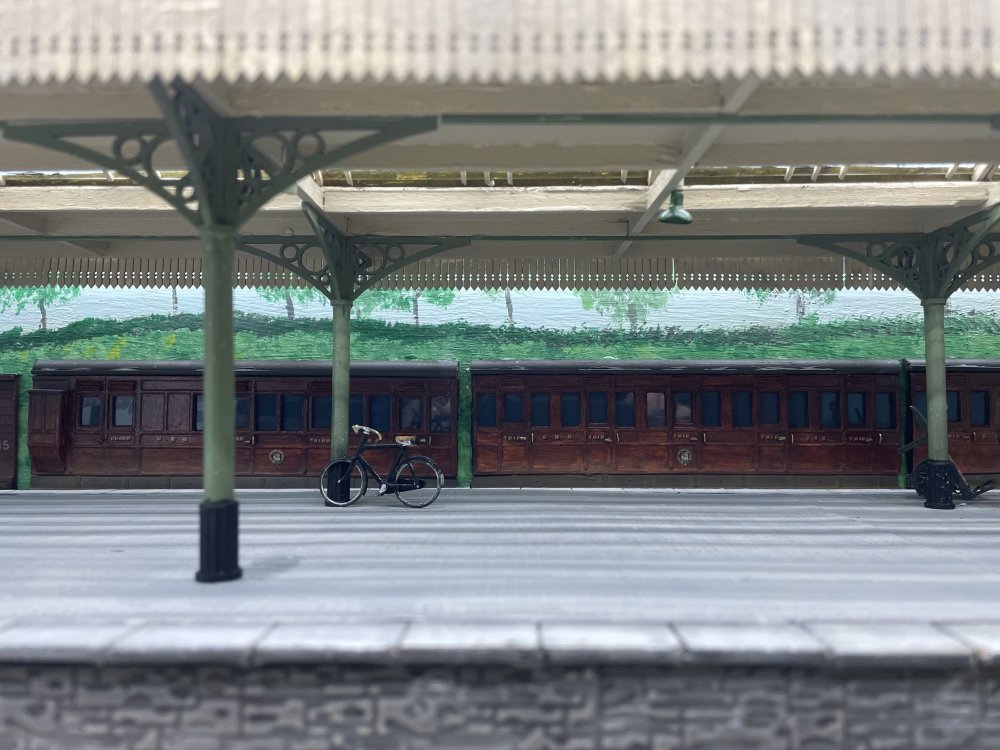

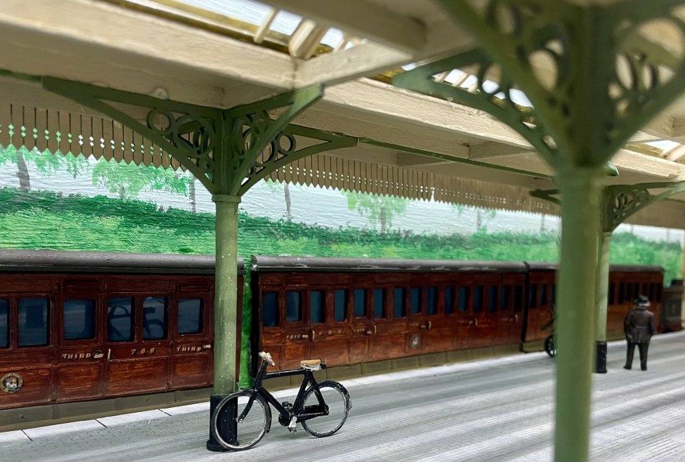

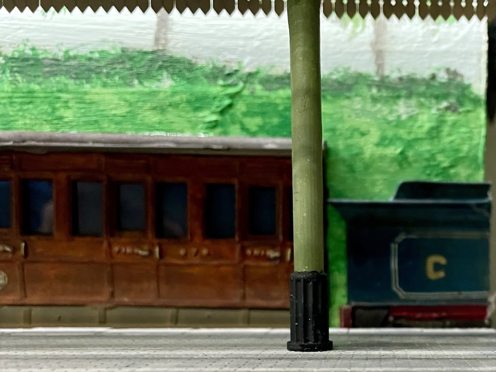

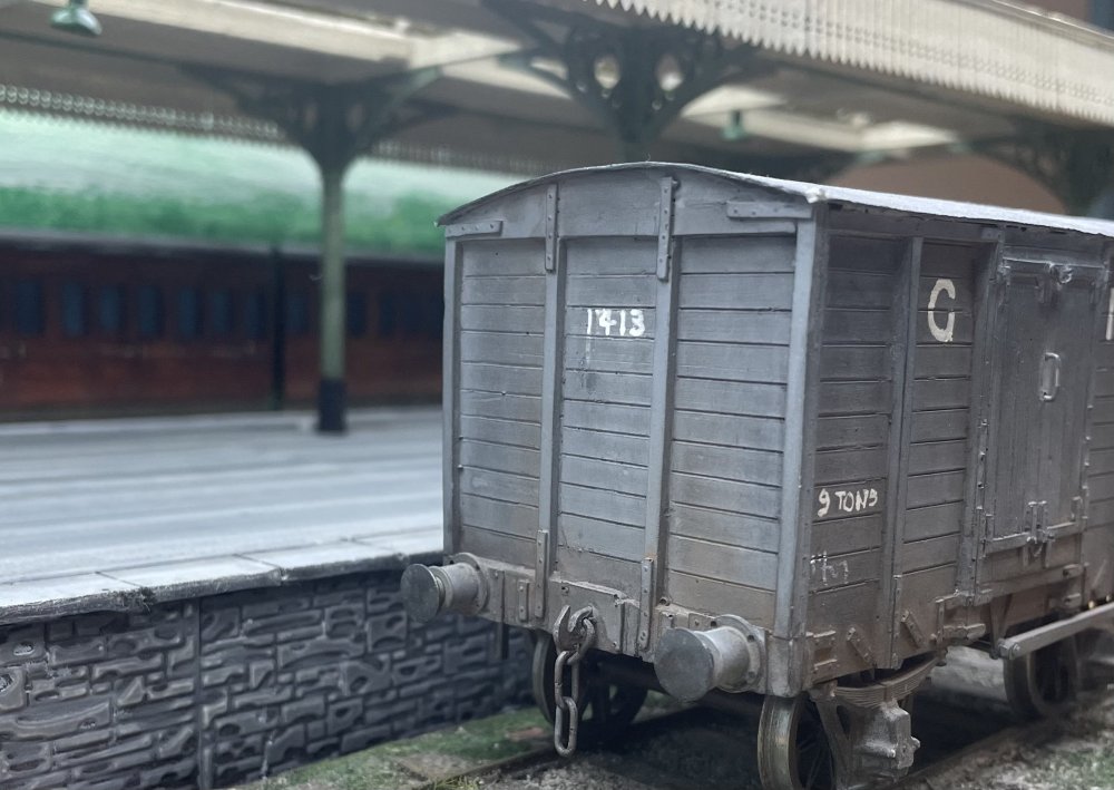

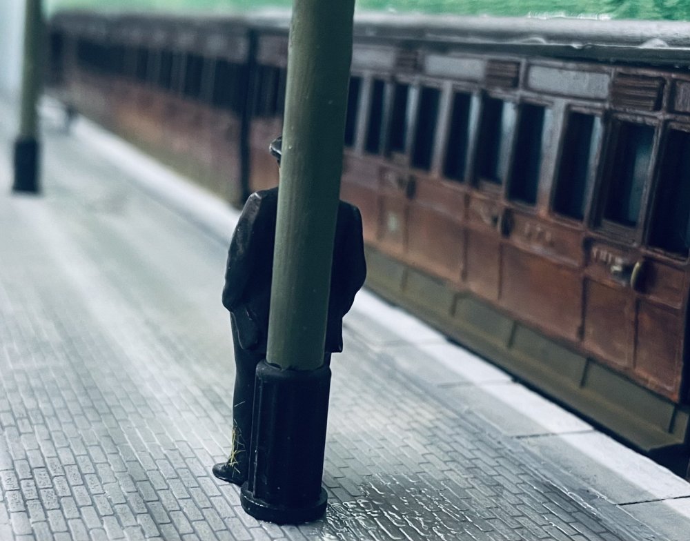

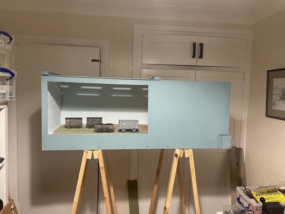

Popular Post Galteemore Posted January 29 Author Popular Post Share Posted January 29 (edited) Although not an inch of track has been laid - a train has arrived on the backscene. A 3 coach train to Clones, headed by an old U. Happy now, @Patrick Davey? All low relief, and I only modelled 1/3 of the Us tender but it’s hopefully enough to suggest the rest is there…..platform still a bit bare but will be dressed with seats etc when glued down ….it’s a backscene so not designed for cruel closeups like these The bottom picture hopefully shows what the effect will look like in relation to the main scene. What is hopefully clear here is how important light is to the composition -to get anywhere near the look of the prototype, there has to be light on both canopy sides and in the middle of it. Had I pushed the canopy right against the backscene, as I was tempted to do, it would have put the background foliage into shade, which just wouldn’t look right. Light is shining on the coach roofs so I think we’ve got away with it…. Edited January 29 by Galteemore 13 9 Quote Link to comment Share on other sites More sharing options...
Gabhal Luimnigh Posted January 29 Share Posted January 29 Brilliant 1 1 Quote Link to comment Share on other sites More sharing options...
Patrick Davey Posted January 30 Share Posted January 30 Magnificent!!!! 1 1 Quote Link to comment Share on other sites More sharing options...
David Holman Posted January 30 Share Posted January 30 Remarkable. With the low viewing angle the scene is so spacious and looks far bigger than we know it actually is. The lighting works well too, while is a leaky roof responsible for that damp patch in the first picture? Really coming to life. 1 1 Quote Link to comment Share on other sites More sharing options...
Irishrailwayman Posted January 30 Share Posted January 30 A true layout "on a plank"! Well done. 1 Quote Link to comment Share on other sites More sharing options...
Northroader Posted January 30 Share Posted January 30 Highly unusual composition, and works very well. The low relief coach sides are a different way of doing things, certainly. 1 Quote Link to comment Share on other sites More sharing options...
Mike 84C Posted January 30 Share Posted January 30 Are you a cyclist? 'cos I love the gravity defying bicycle. Seriously, that is a brilliant cameo. makes me want to sit on a platform seat and enjoy the trains. I look forward to more from yourself. 1 Quote Link to comment Share on other sites More sharing options...

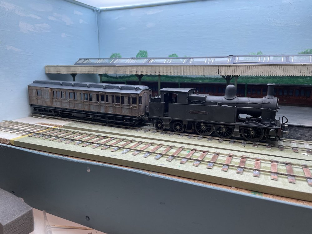

Galteemore Posted February 7 Author Share Posted February 7 (edited) IMG_0418.mov The catalyst for this layout was ‘Enniskillen’s shockingly poor performance on Northport Quay at Uckfield in October. This made me realise that I needed some kind of layout to run locos - at least back and forward a bit to fine tune the adjustments that handbuilt metal locos need. They require much more fettling than RTR and you really need some kind of test track. There aren’t many 5’3 test tracks around though!! So tonight the track, after soldering, sleeper gapping and wiring up, was temporarily installed to see if Enniskillen redeemed herself. This took a while to prove as the bogie pillar broke off! Quick soldering job and we were in business. I think she has earned her coal….departing here on the 7:20 to Sligo…..it’s a tiny layout with a few bits to do yet…but we are getting there I think…another big job carried out was installation of diffused LED lighting which has proved well worth doing. Sorry for dubious camera work! Edited February 7 by Galteemore 12 1 Quote Link to comment Share on other sites More sharing options...
jhb171achill Posted February 7 Share Posted February 7 26 minutes ago, Galteemore said: The catalyst for this layout was ‘Enniskillen’s shockingly poor performance on Northport Quay at Uckfield in October. This made me realise that I needed some kind of layout to run locos - at least back and forward a bit to fine tune the adjustments that handbuilt metal locos need. So tonight the track, after soldering, sleeper gapping and wiring up, was temporarily installed to see if Enniskillen redeemed herself. This took a while to prove as the bogie pillar broke off! Quick soldering job and we were in business. I think she has earned her coal….departing here on the 7:20 to Sligo…..it’s a tiny layout with a few bits to do yet…but we are getting there I think…another big job carried out was installation of diffused LED lighting which has proved well worth doing. IMG_0431.mov 30.05 MB · 0 downloads VERY nice! 1 Quote Link to comment Share on other sites More sharing options...
