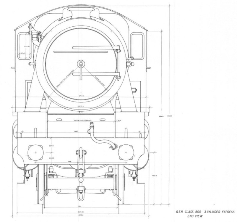

16miller Posted December 30, 2023 Posted December 30, 2023 The first thing would be to obtain the current loading gauge for the two railway companies and measure the engine. If anything was out of gauge could it be mounted a different way or elsewhere on the engine? Then find out if the axleweight is within tolerances. Having satisfied ourselves that it could move on the rails, it would require an examination. Would the museum allow an examination? There are things that could be done to see if it was feasible, and gauge what sort of finance would be required. 1 Quote

jhb171achill Posted December 30, 2023 Posted December 30, 2023 2 hours ago, 16miller said: The first thing would be to obtain the current loading gauge for the two railway companies and measure the engine. If anything was out of gauge could it be mounted a different way or elsewhere on the engine? Then find out if the axleweight is within tolerances. Having satisfied ourselves that it could move on the rails, it would require an examination. Would the museum allow an examination? There are things that could be done to see if it was feasible, and gauge what sort of finance would be required. It barely fitted under bridges before, and being so tall there's no scope to lower the chimney - and the track level is well above what it used to be, so that one's known already. Based on current and recent RPSI jobs, it could be anything from half a million upwards. Yes, as you say, many things could be done to assess and even restore: but nowhere to eventually run it, nowhere to look after it, and unlikely to be an ongoing market of sufgficient level to fund its future needs. Quote

16miller Posted December 31, 2023 Posted December 31, 2023 3 hours ago, jhb171achill said: It barely fitted under bridges before, and being so tall there's no scope to lower the chimney - and the track level is well above what it used to be, so that one's known already. Based on current and recent RPSI jobs, it could be anything from half a million upwards. Yes, as you say, many things could be done to assess and even restore: but nowhere to eventually run it, nowhere to look after it, and unlikely to be an ongoing market of sufgficient level to fund its future needs. Has it been measured to the current loading gauge? Could a new chimney be cast? The problem with preservation here is that there are plenty who say 'It can't be done', and very few who say 'How could it be done?'. 1 Quote
jhb171achill Posted December 31, 2023 Posted December 31, 2023 5 minutes ago, 16miller said: Has it been measured to the current loading gauge? Could a new chimney be cast? The problem with preservation here is that there are plenty who say 'It can't be done', and very few who say 'How could it be done?'. Indeed; thirty years ago such questions were asked (and answered!) regarding No. 74 "Dunluce Castle" in UFTM. Despite incredible hurdles, the overall answer, after all things had been considered very carefully, was "yes". That remains the case. The same answer would apply, in theory, to BCDR 30 there, the GNR 2.4.2T and the derry shunter; as well as "Lough Erne" at Whitehead. This is what I was afraid of in my initial answer; that I might be seen as one of the majority of "naysayers" as opposed to the few with the miagination to make things happen. In the case of Maedb, the clearance was some three inches when the track was about 2ft lower; this in itself answers that question. As it was, the safety valves had to be removed en route. A cursory look at the thing shows that shortening of the chimney is not viable. In the most purist form of theoretical possibility, it's quite possible to run it again - provided Irish Rail either raise the heights of all bridges necessary on the Cork line, or rebuild all the track at a lower level; also, that they build and install sheds and turntables at Dublin and Cork. Other than that, for once the naysayers have their moment! 1 Quote

jhb171achill Posted December 31, 2023 Posted December 31, 2023 4 hours ago, 16miller said: Is the chimney a separate casting? What you're saying is exactly what I said. I doubt if the chimney is built into the smokebox, it'll be a casting bolted on. Rather than say 'It can't go under bridges', say 'what can be done to get it under bridges?' Raise the bridges or drop the trackbed. IE will be unlikely to even consider either; I doubt even mcManus could fund that.....! As an aside, whether the chimney was a separate casting or bolted on wouldn't actually be an issue either way - it would be thye bridges, now known to be insufficient in height. Quote
16miller Posted January 3 Posted January 3 On 31/12/2023 at 9:37 PM, jhb171achill said: Raise the bridges or drop the trackbed. IE will be unlikely to even consider either; I doubt even mcManus could fund that.....! As an aside, whether the chimney was a separate casting or bolted on wouldn't actually be an issue either way - it would be thye bridges, now known to be insufficient in height. What is the current loading gauge on both companies, and what's the height of the chimney top, whistle and safety valves. I'm hearing about thoughts of height, but very little actual dimensions to gauge it properly. Quote
jhb171achill Posted January 3 Posted January 3 21 minutes ago, 16miller said: What is the current loading gauge on both companies, and what's the height of the chimney top, whistle and safety valves. I'm hearing about thoughts of height, but very little actual dimensions to gauge it properly. Don’t know exact dimensions myself, but the one statistic I am aware of is that when Maedb was going north, there was barely 3ins to spare once the tallest fittings were off. Trackbed higher now by more than that, so a journey to Dublin now would be by road. I’m sure someone here might have current Cork line loading gauge details? Quote

KMCE Posted January 3 Posted January 3 On 31/12/2023 at 4:48 PM, 16miller said: Rather than say 'It can't go under bridges', say 'what can be done to get it under bridges?' This may help to give an idea of how the loco was constructed to maximise the loading gauge of the time. Overall dimension from railhead to top of chimney is 13' 5 1/2" or 4.1m, so this can be compared to current bridge clearance to get an idea of accessibility. Hope this helps Ken 2 Quote
