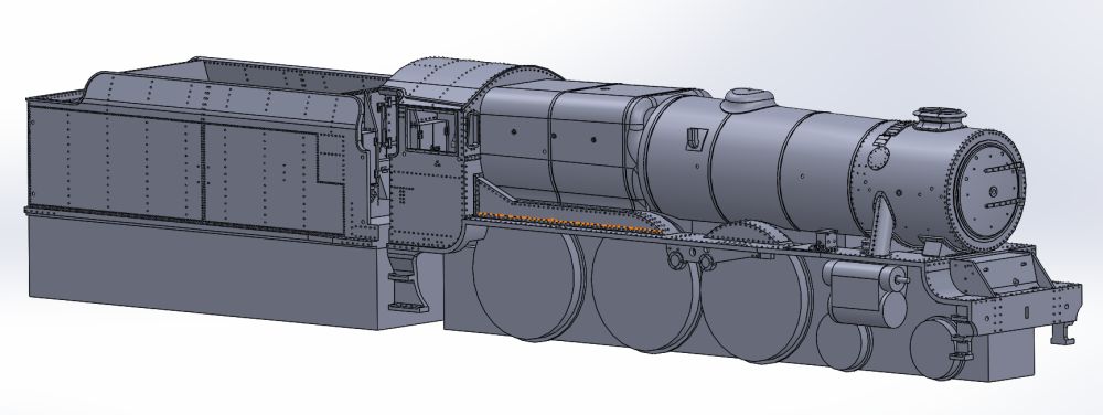

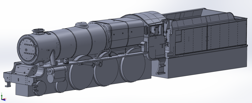

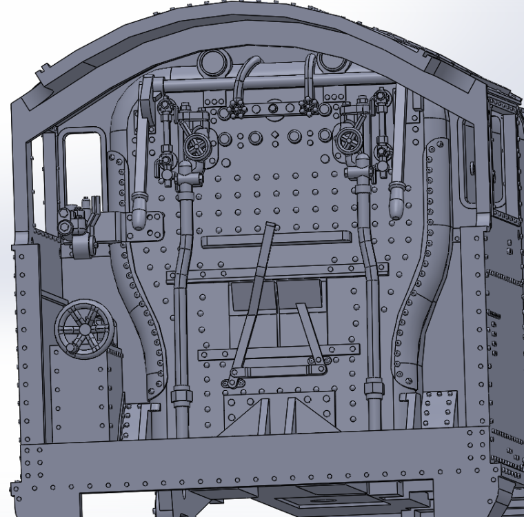

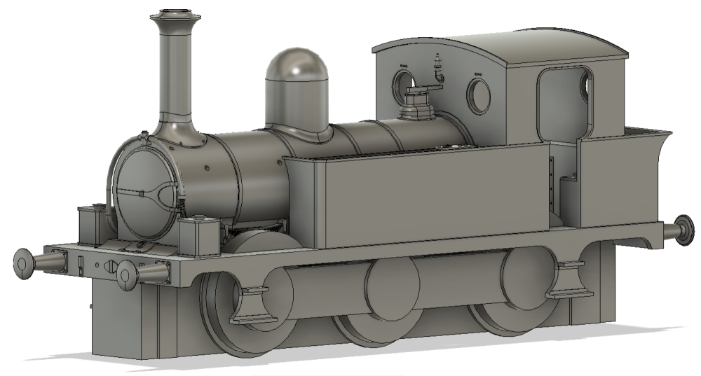

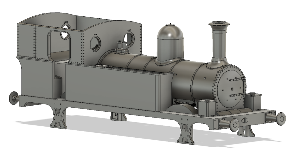

The 800 class is officially finished awaiting the first test print

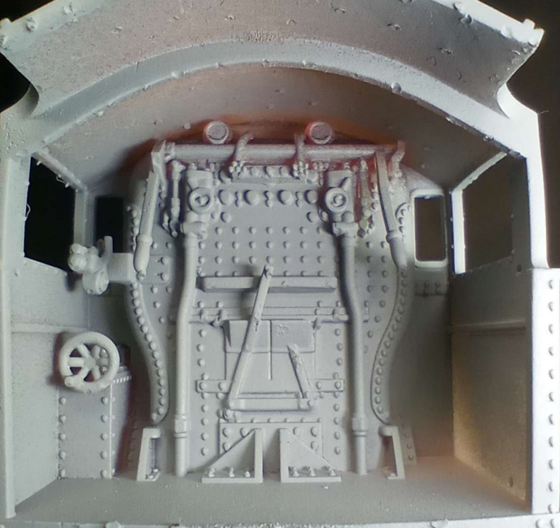

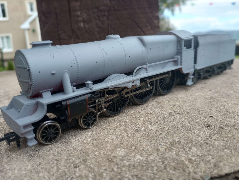

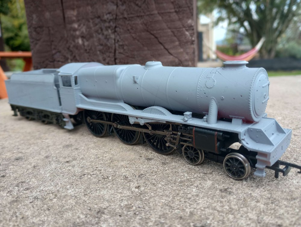

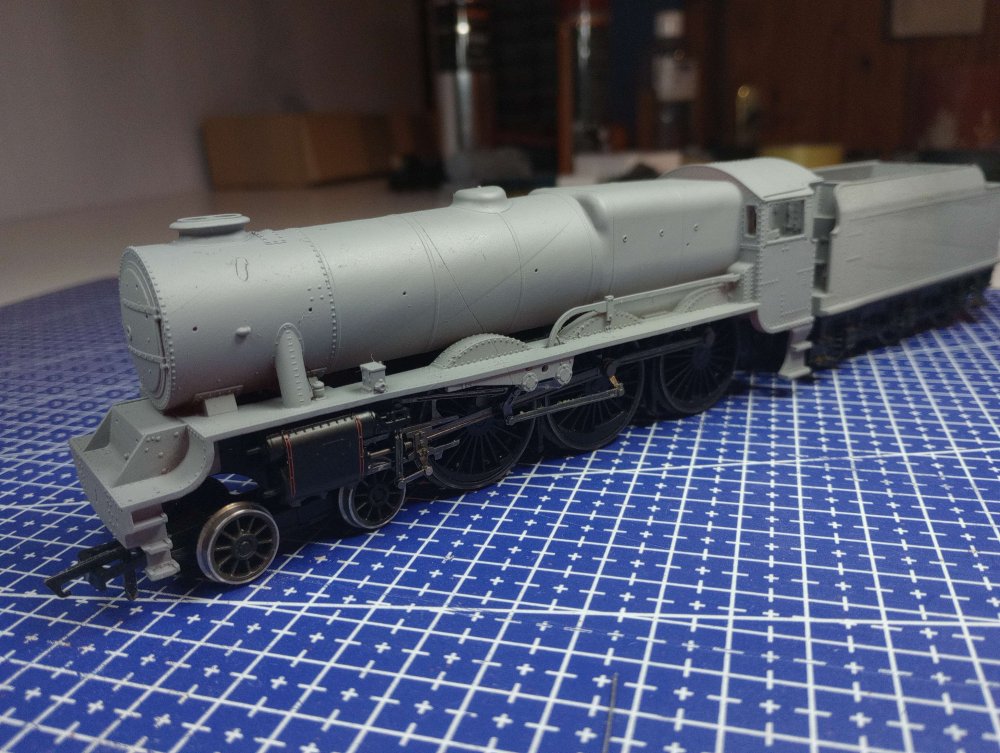

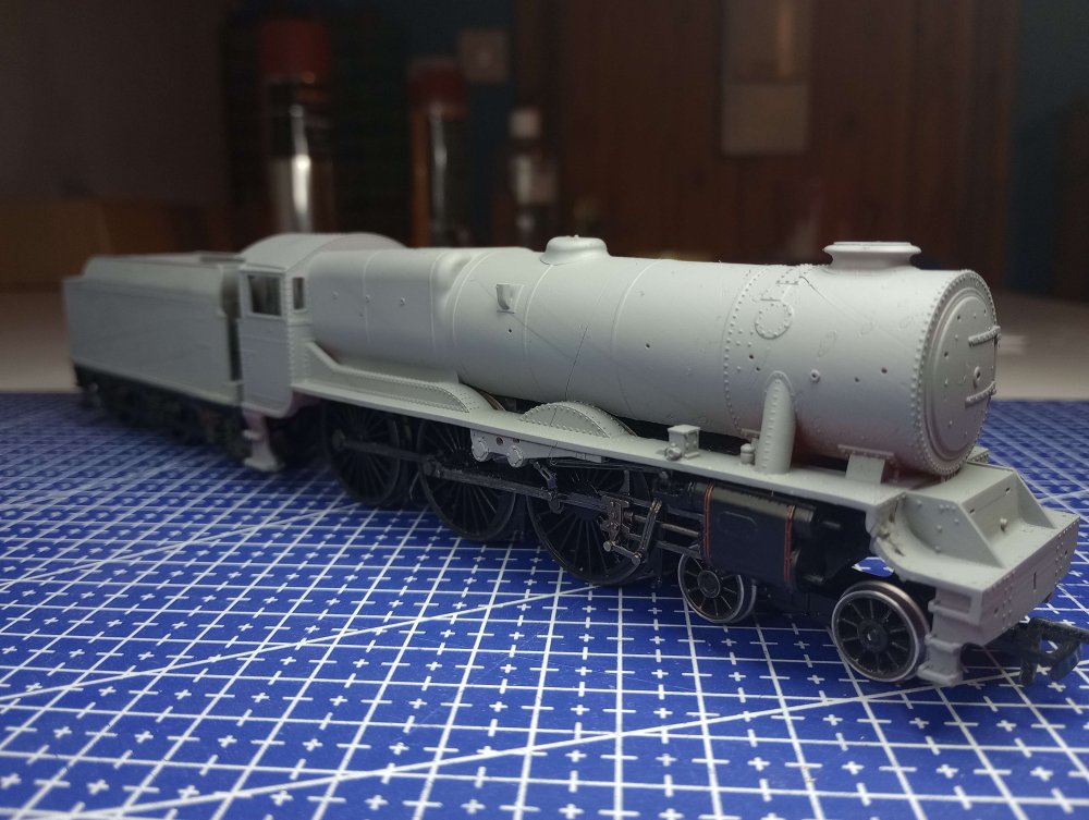

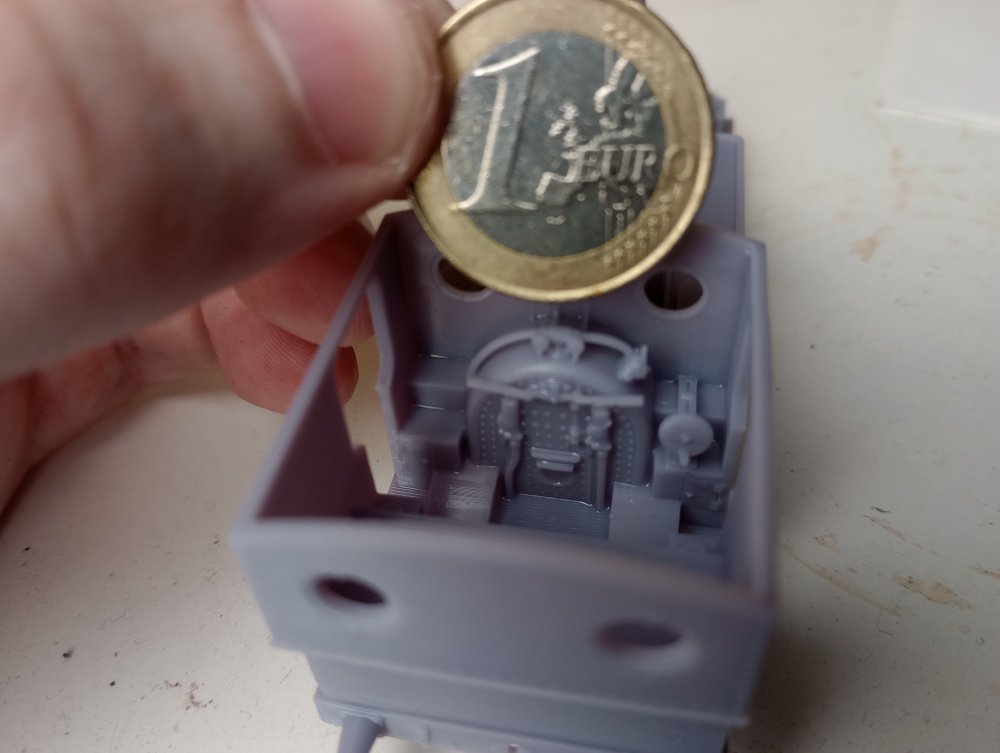

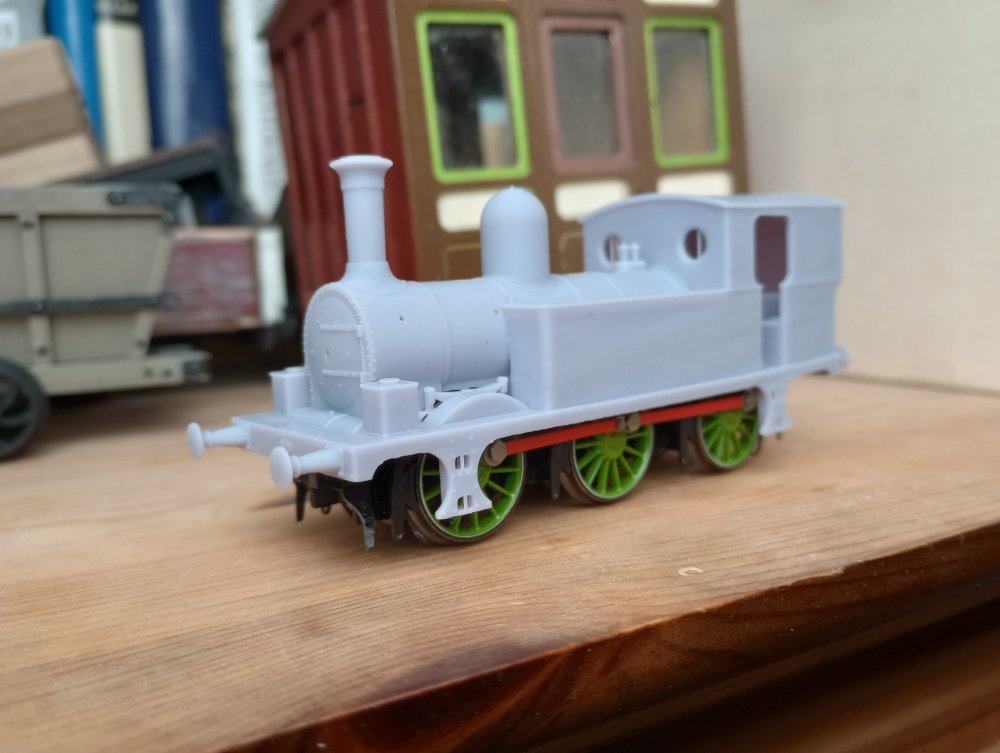

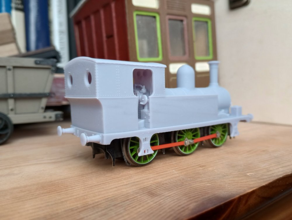

Thanks very much all! truly praise from Caesar
The surface finish in person is significantly better than the last sample, however there were some unfortunate marks on the boiler and smokebox which are down to the printer having to be cleaned out, as well as a small hole in the running board on the front right side
IMG_20240830_160158473_HDR.thumb.jpg.d4022256014989b739343ab073439a69.jpgIMG_20240830_160117288_HDR.thumb.jpg.f8d98cb553d6d4439e995f698a50dd16.jpg

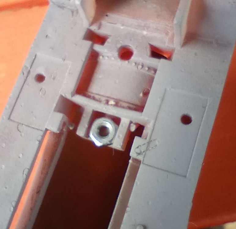

I am particularly pleased with the way the M2.5 nut is held, it goes in this little trough as shown, the model is tipped forward to line it up with the hole, and then the chassis can be inserted, and the original mounting hole used

Very elegant solution 👏👏👏

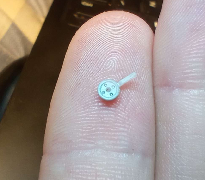

The last piece in the 800 class puzzle, the smokebox handwheel
There is a piece that the carpet monster will eat in short order should you drop it !

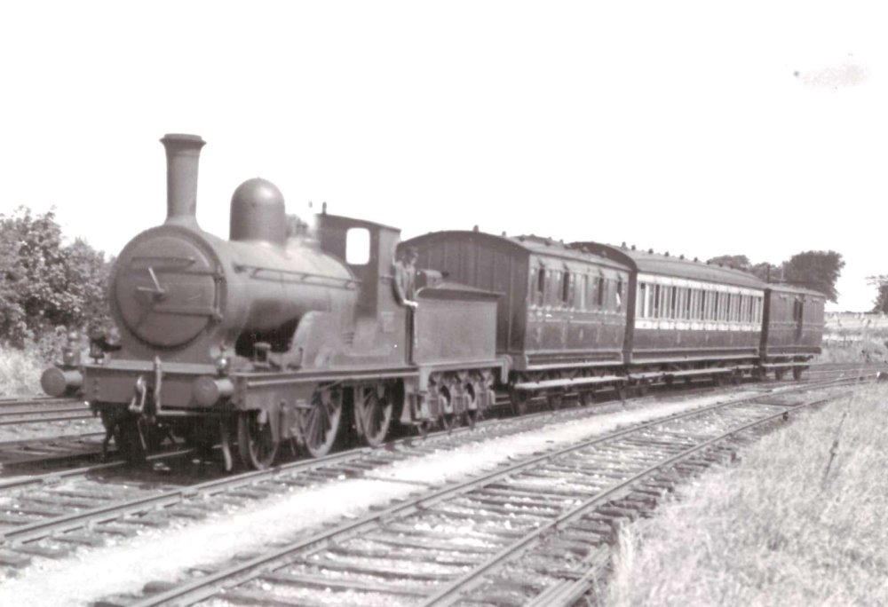

The 2-4-0s (GSR class G3) were very nice engines, first built 1889 last withdrawn 1959. They're a strong contender for my next project after the 0-6-0 is finished
Very attractive and purposeful indeed. Something of the GER 2-4-0 about them. Ideal candidate for 3D - those splashers would be ‘fun’ to scratch build ….image courtesy Science Museum

Any idea where that picture was taken?

Ciaran Cooney on Twitter reckons its a southbound Athenry-Limerick working seen at Ennis with the WCR lines in the background
I wasn’t entirely convinced those tracks were narrow gauge in the background, but very possible; and Ciarán’s knowledge of locations is absolutely encyclopaedic!

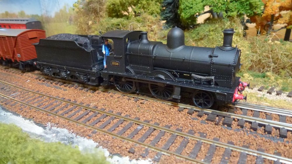

In a rather charming, deliberately retro, project a few years ago, Chris Leigh changed a Dean Goods into a 2-4-0 as used on the Lambourn branch. Image from Model Rail. The idea of a generic 2-4-0 is quite plausible! Image by J F Russell-Smith. This one below, of course is an ex MSJWR one which has been Swindonised….IMG_2836.webp.3cf396148e3efdd296a98b9775f41b80.webp
