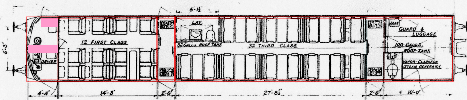

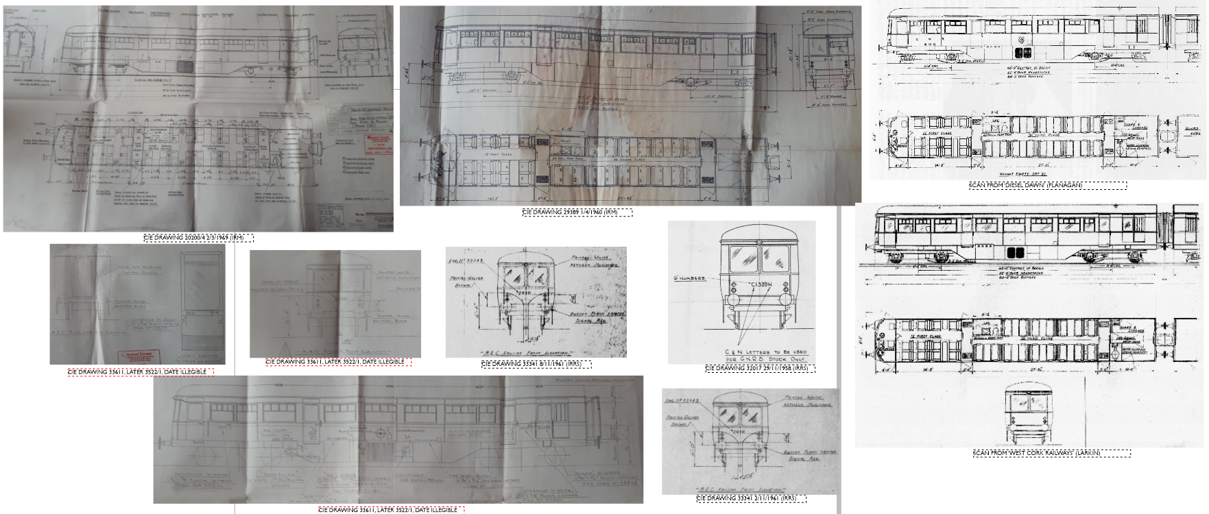

I've also been gathering drawings from various sources, none are perfect but I think that between them I can develop a reasonably accurate shape. Here I've just pasted them all onto a drawing board. They're not even all to the same scale yet, bear with me (and sadly I don't have the originals to smooth out those folds).

I assume that you've got Richard McLachlan's scans of the IRRS Archive set of the drawings?

I do have Richard's scans, but there aren't many good ones featuring the railcars - mostly livery diagrams of the front ends. Unless I'm missing something?
If my work makes IRM produce a model, then great! I think it's unlikely in the present climate, but we'll see.

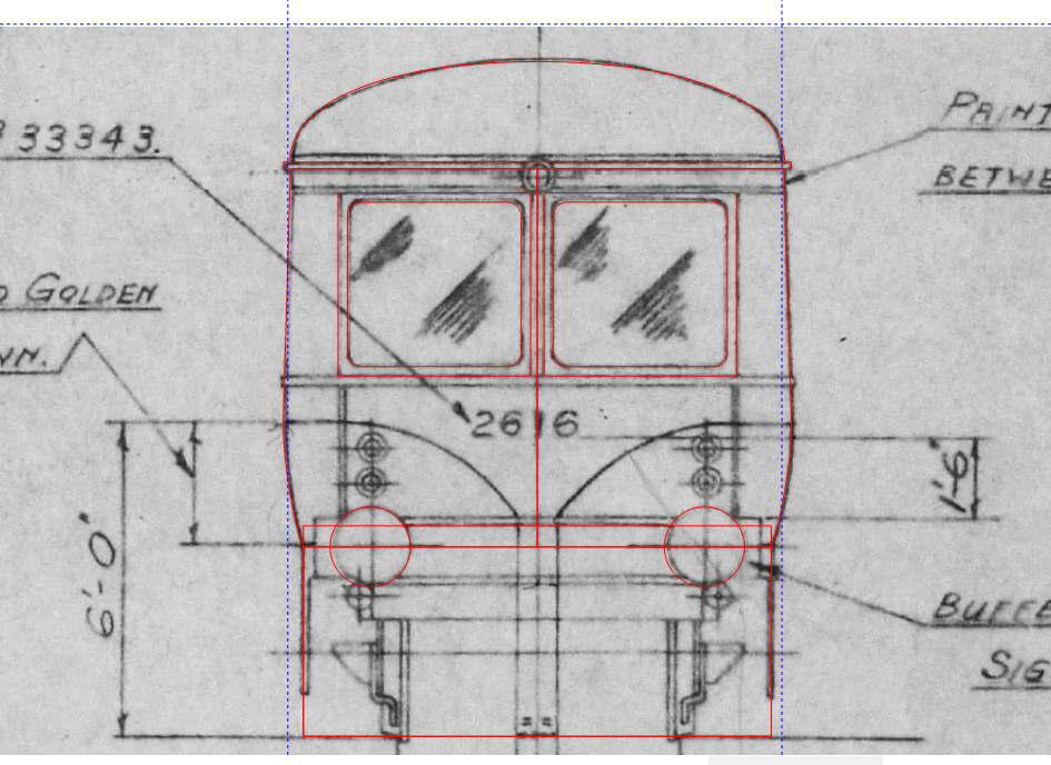

The drawing with the most comprehensive dimensions is a photo of a rather rumpled original. It is pleasing that drawing up cross-sections and plans based on the quoted dimensions gives something that can be overlaid over other drawings that are flat, but less well dimensioned. This starts to give some confidence in what I'm drawing (in red).
A long way to go yet - the proof of the pudding will be when we can produce a 3D 'face' that looks right.

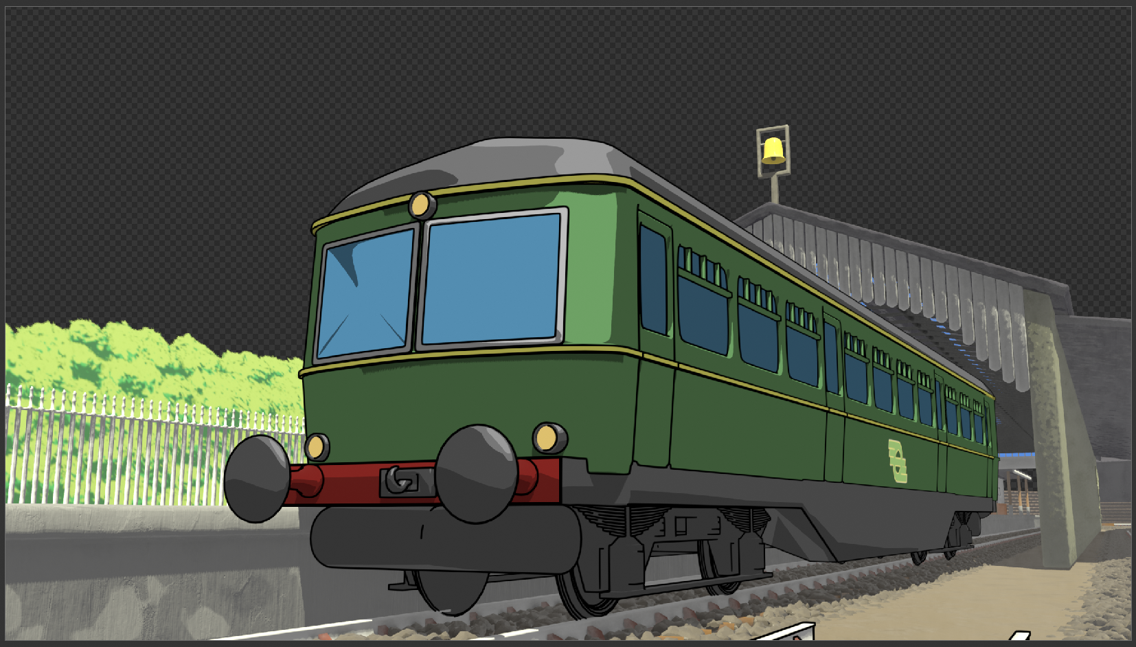

Very funny timing! I've been modelling an AEC railcar in Blender, doing it by eye as I couldn't find any good scans of 'em, and here you have a ton! Hope you don't mind if I borrow the scans to rework my model 😅
You're right about the 'face' of it as that's been the most finicky part despite being relatively simple. Looking forward to seeing how this project progresses!

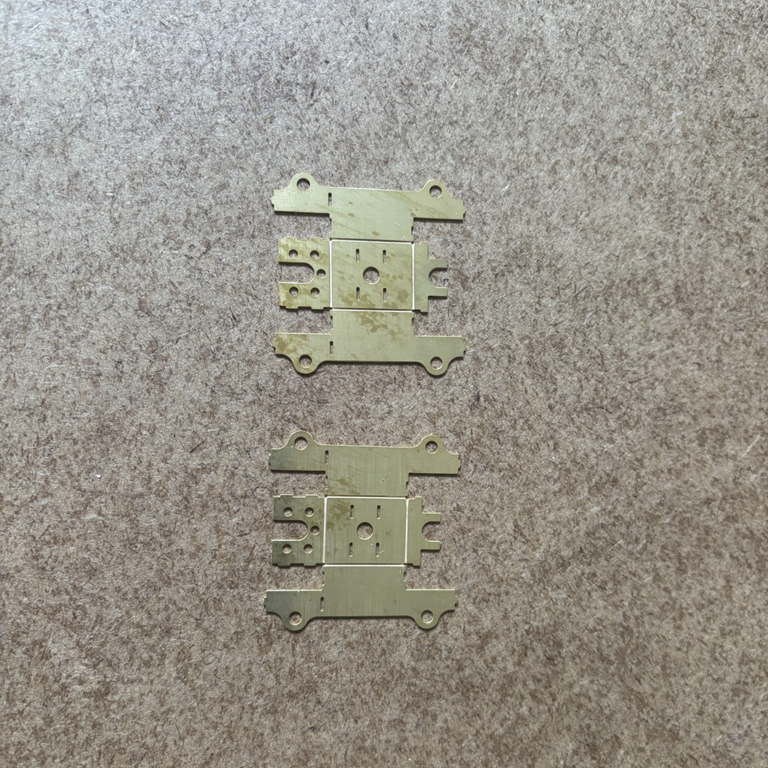

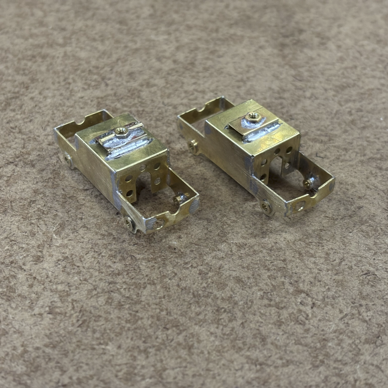

I am in the process of making my own etched motorbogies for my C class build. They're designed around a Mitsumi motor with a 30:1 gear ratio (the largest gear ratio I could find for a single stage worm) which should give a nice slow top speed of ~50 scale mph.
I had already built the first set, but I miscalculated the clearance so the gears bind up pretty badly. I need to get them remade with a bit more clearance. I have attached some pictures below.

Some of my thoughts:
My design only works for 21mm, it's too wide for OO gauge. You would either need to have a design where the motor isn't contained within the side frames, or a teeny tiny motor.
High Level discontinued the LoRider/LongRider when their supply of Mashima motors ran out. There aren't many sources of good dual-shaft motors anymore which are required for motorbogies like these. I'm using Mitsumi motors I bought in bulk from China for cheap, but there are definitely a few duds in my batch. I spent half an afternoon testing and measuring all my motors to make sure the ones I'm using are good and well matched, but not everyone has the equipment to do that. And I have no idea about their longevity.
As far as I know Black Beetles use Mashima motors too (or at least did in the past) so if you're planning to use them it might be worth checking if they have enough supply available.
Motorbogies aren't very powerful, so for a railcar with 2 intermediate coaches you would probably need at least 2 of them. But it might be worth doing some testing through tight curves or an incline.

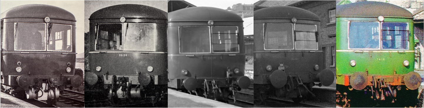

This is an extract from one of the slides in my talk showing the evolution of wipers, headlights and buffers. The position of the number also changed, and later larger numerals were used.
Not shown here, but in the early 1970s many of them gained an obstacle deflector 'skirt' below the bufferbeam (these were not all the same). When converted to push-pull, the driving trailers got a GM-style headlight on the roof dome.
There were indeed several exhaust variants trialled, and I have some photos, but I'm not sure if there was ever a permanent solution to the fumes problem seen here. (photo by Bob Smallman in my collection)
2633 had an exhaust fitted on the front corner of the cab, while this excellent photo of 2602 in Ernie's collection shows a rather stylish exhaust straddling the gangway at the inner end:

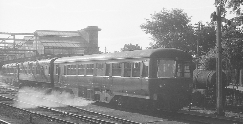

GMK032 CIE 1955-xx Dublin Heuston 2602 D171

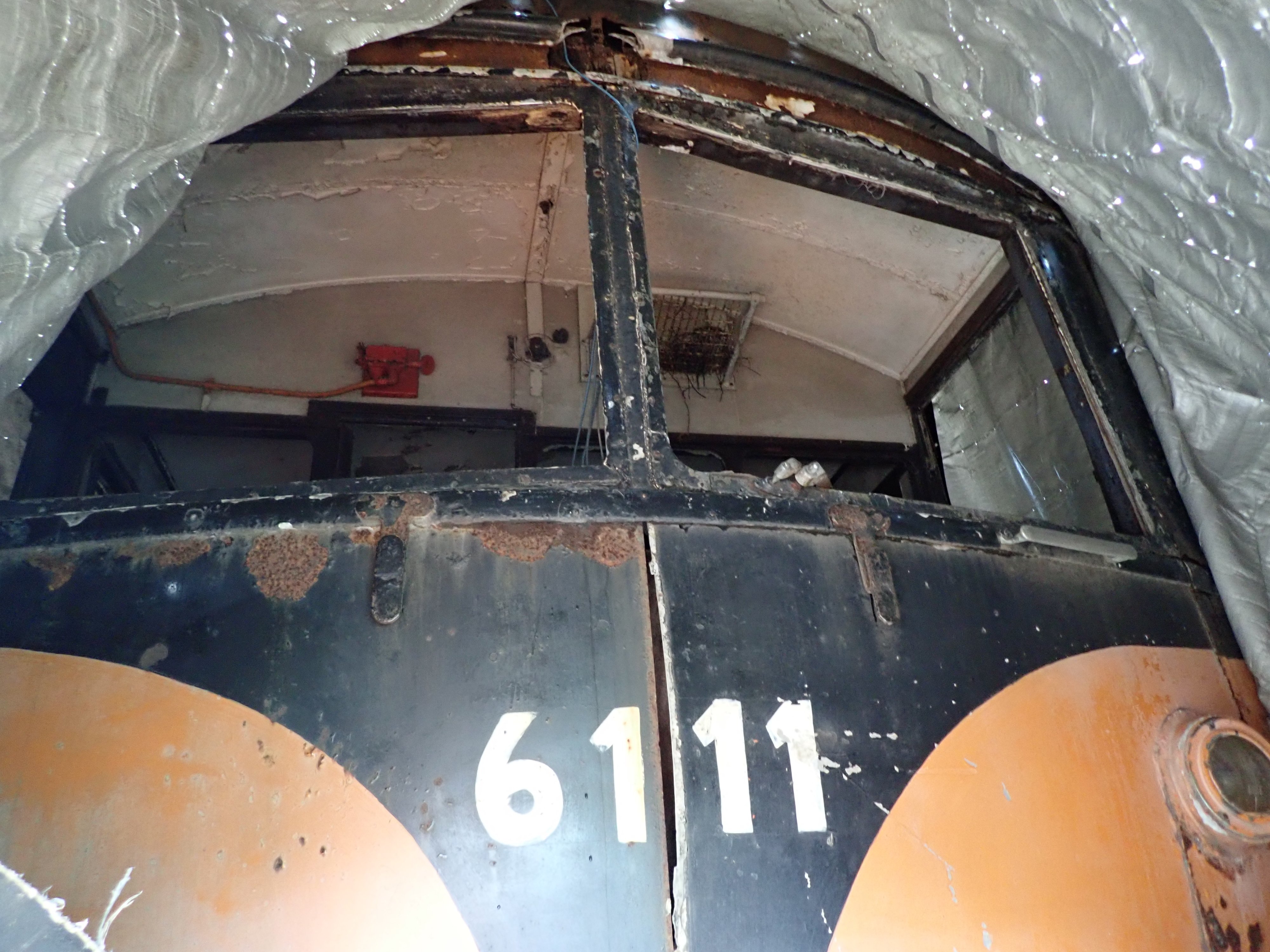

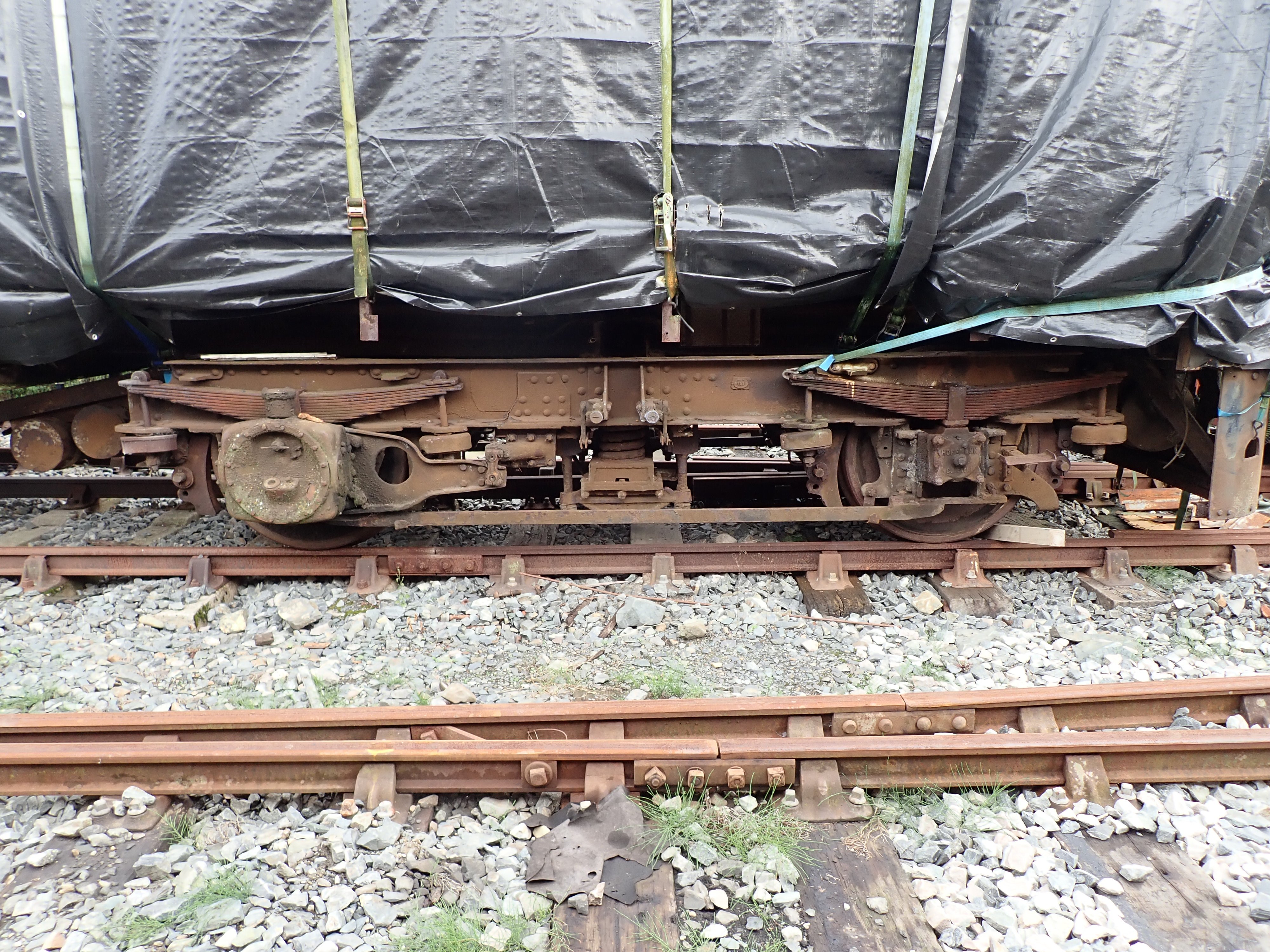

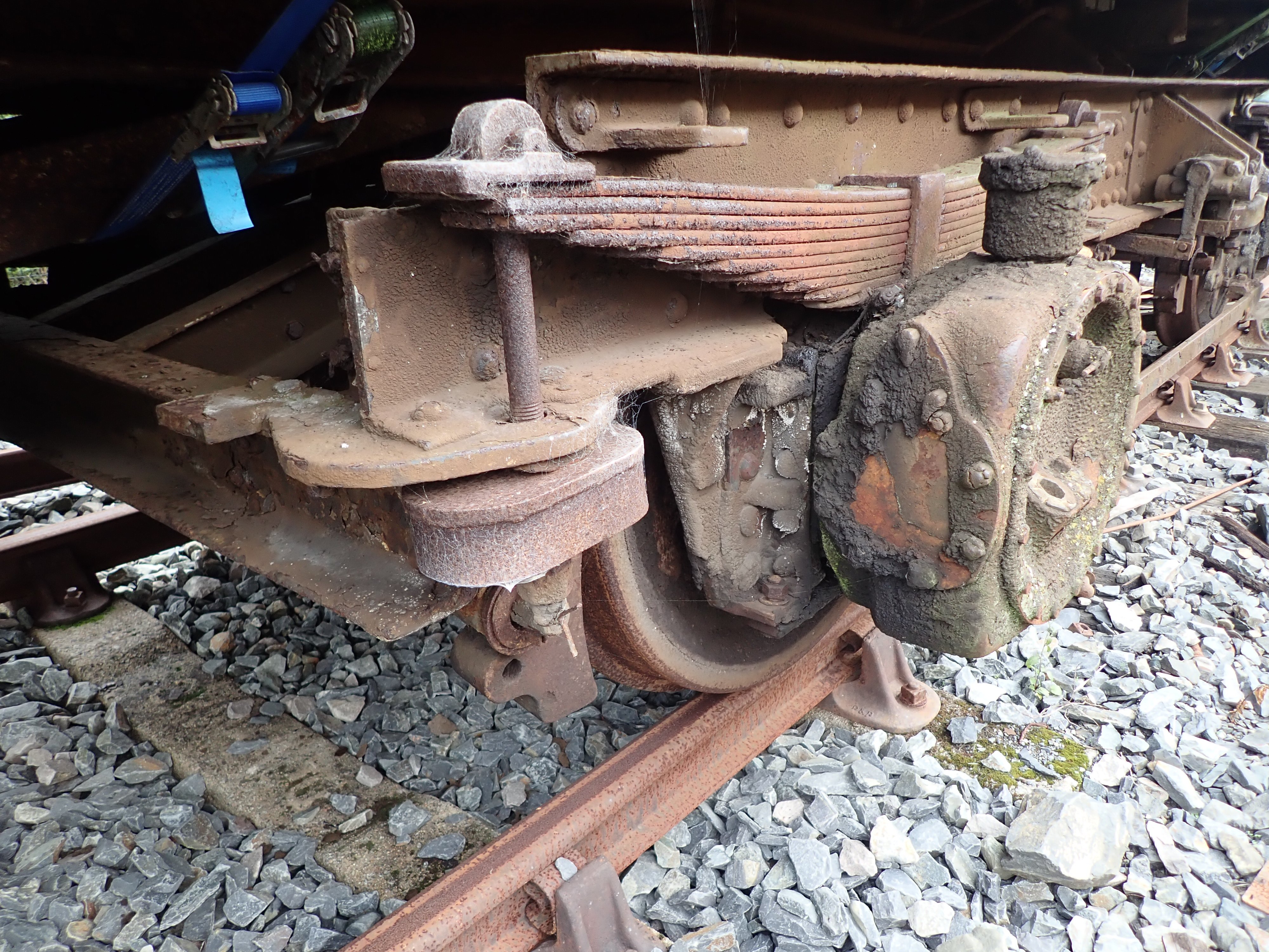

I photographed as much of 6111 as was safe to do so. It needs a lot of work but I think it could be restored.
I believe the long term aim is to rebuild it as a push-pull trailer, in which guise it could hypothetically work with any of the GMs or C231…..

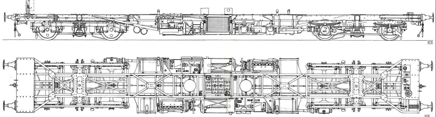

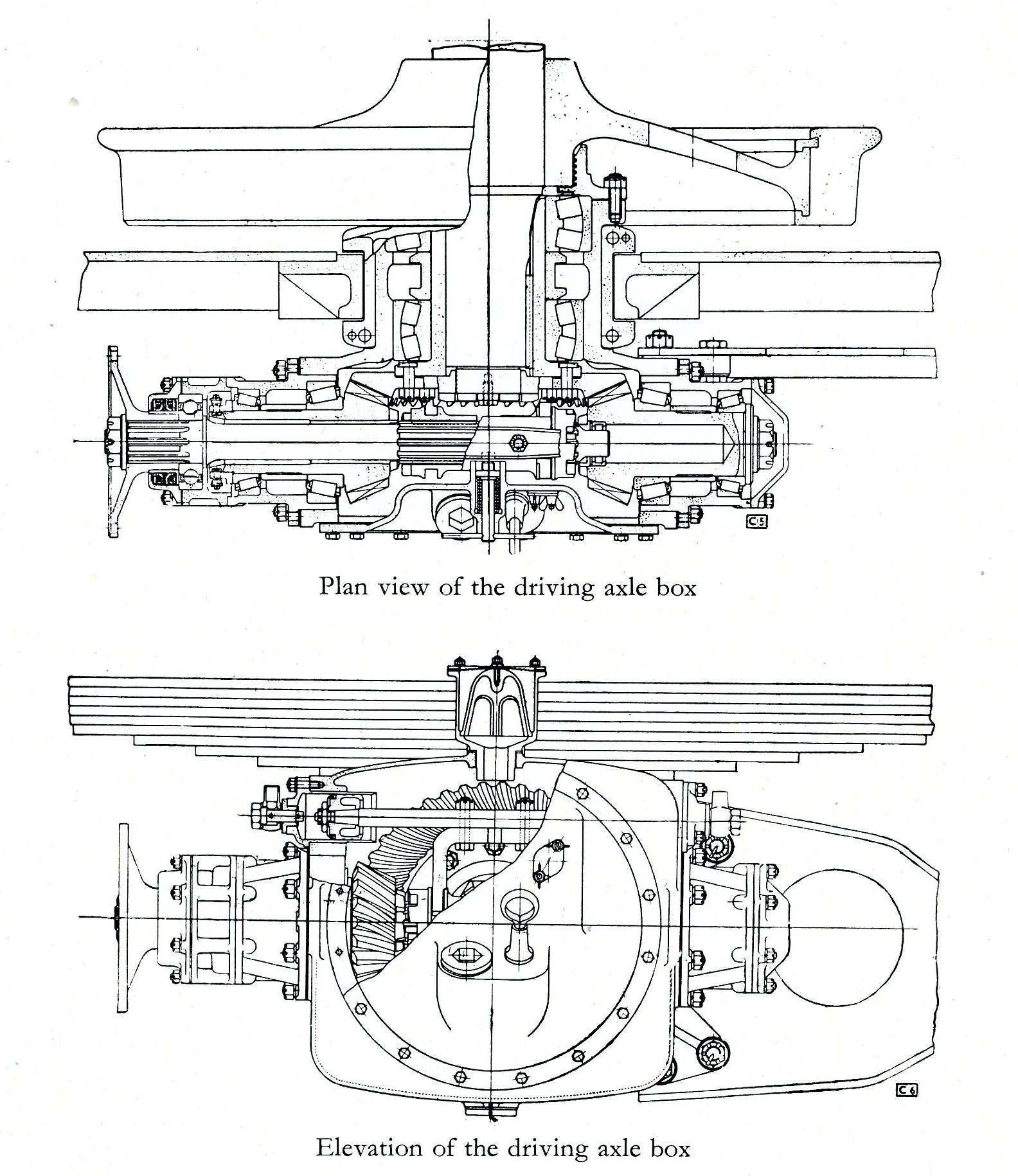

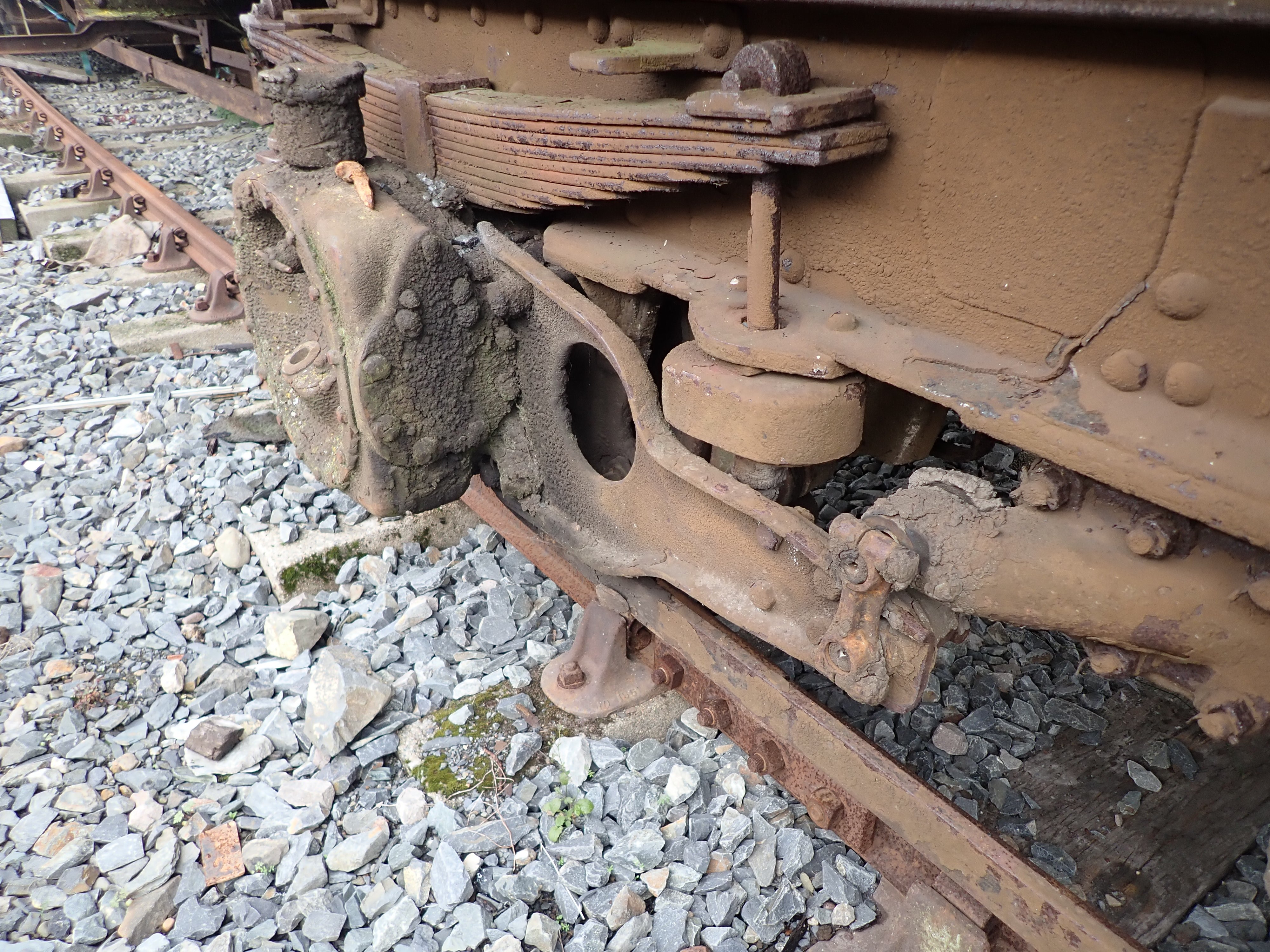

Photos of the final drive on 6111, very similar to the GWR design but the bogie is completely different:
Cutaway drawing showing the two small bevel gears on the drive shaft. Either of these could be engaged, and that would select the direction of movement.
A peer under the tarp...
  • Like 6

  • Some of the timber body (originally it was Ash) remains sound, but a lot is in poor condition and some parts have rotted away to nothing. I suspect it would need to be rebuilt mostly in new material, but there's enough left of the old to use as a pattern. With many similar-shaped pillars, modern techniques of CNC timber machining could make the job quicker, though the cost of the wood and the manpower to assemble it shouldn't be underestimated.
  • The all-steel roof seems to have lasted better.
  • It looks like the vehicle was largely complete when set aside for preservation, but the subsequent 40-odd years have not been kind to it.
I doubt any original construction drawings survive, but there are quite a few photos taken during build which may be helpful. An essential first step would be a proper survey to record in detail the surviving parts.
In the meantime, I'll focus on the miniature version...
