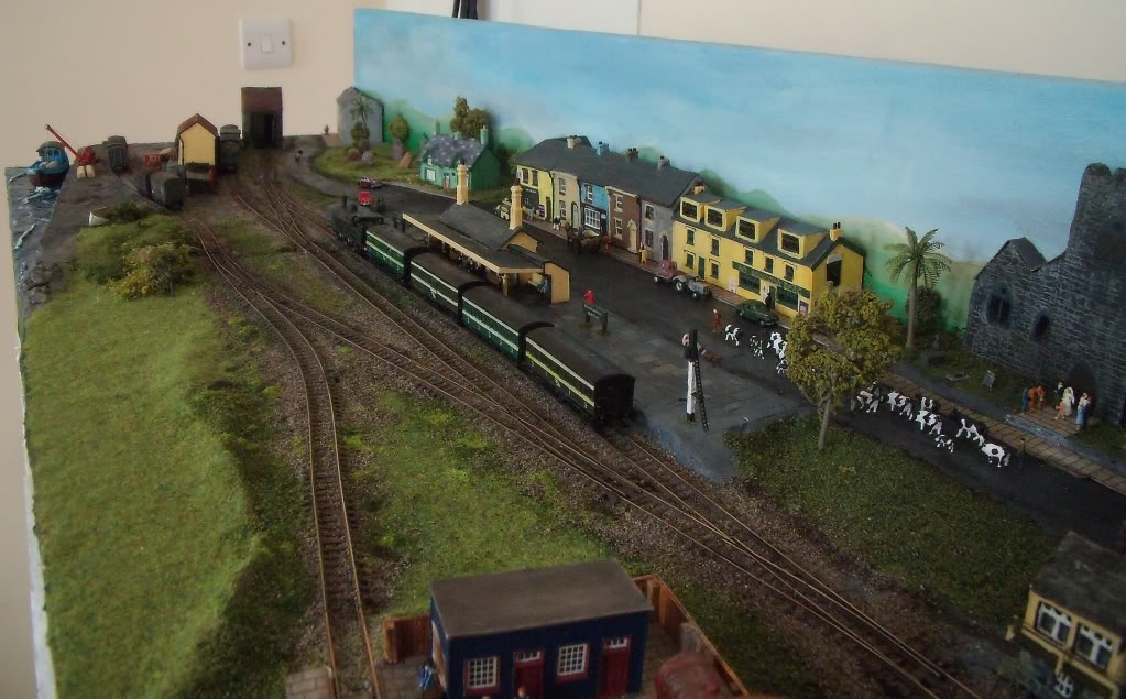

Kilnevan, my Irish N gauge layout.

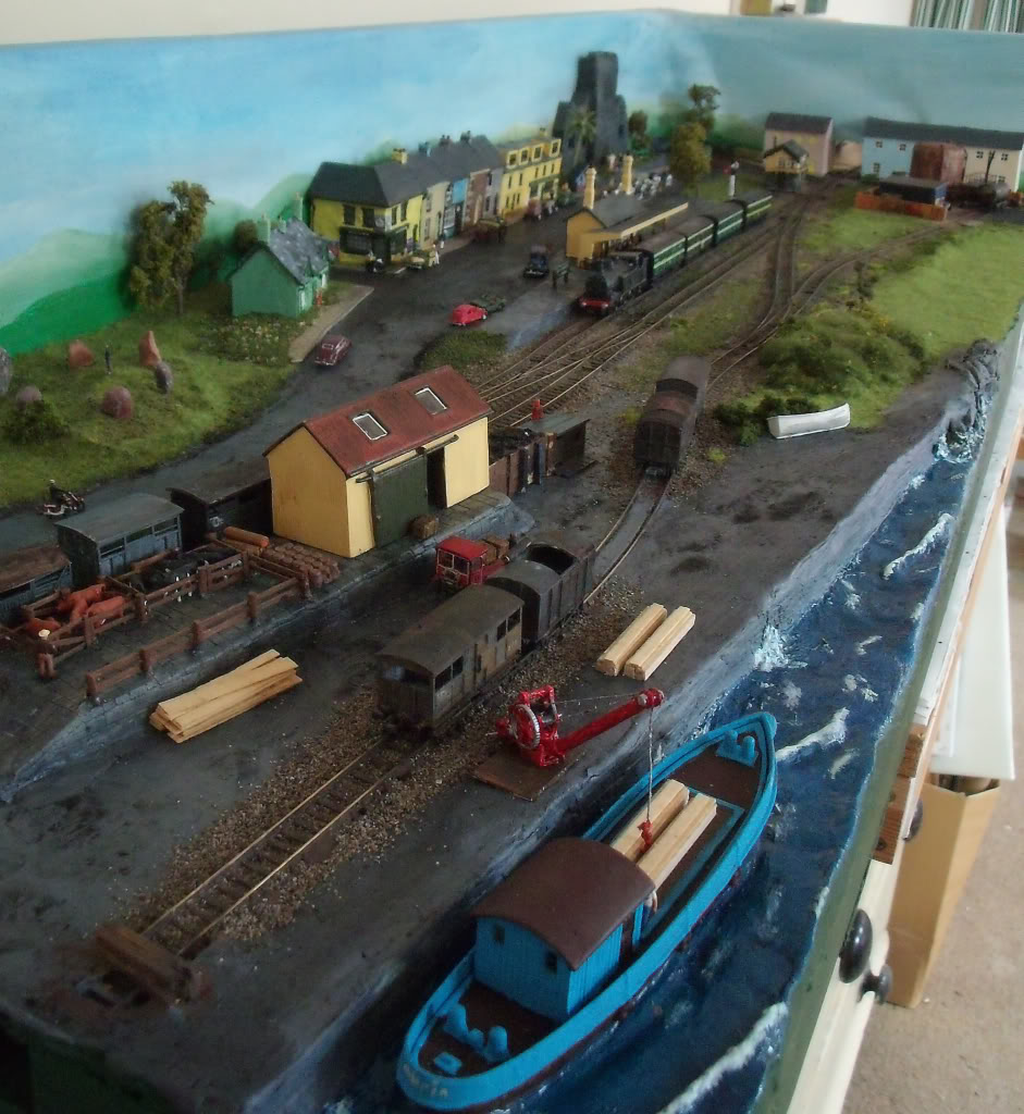

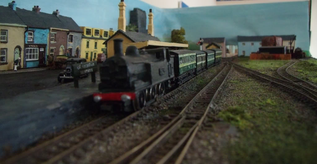

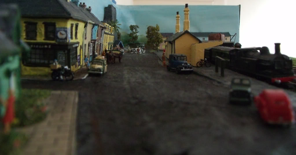

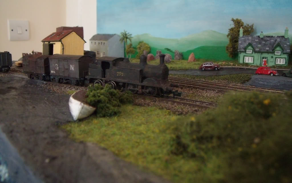

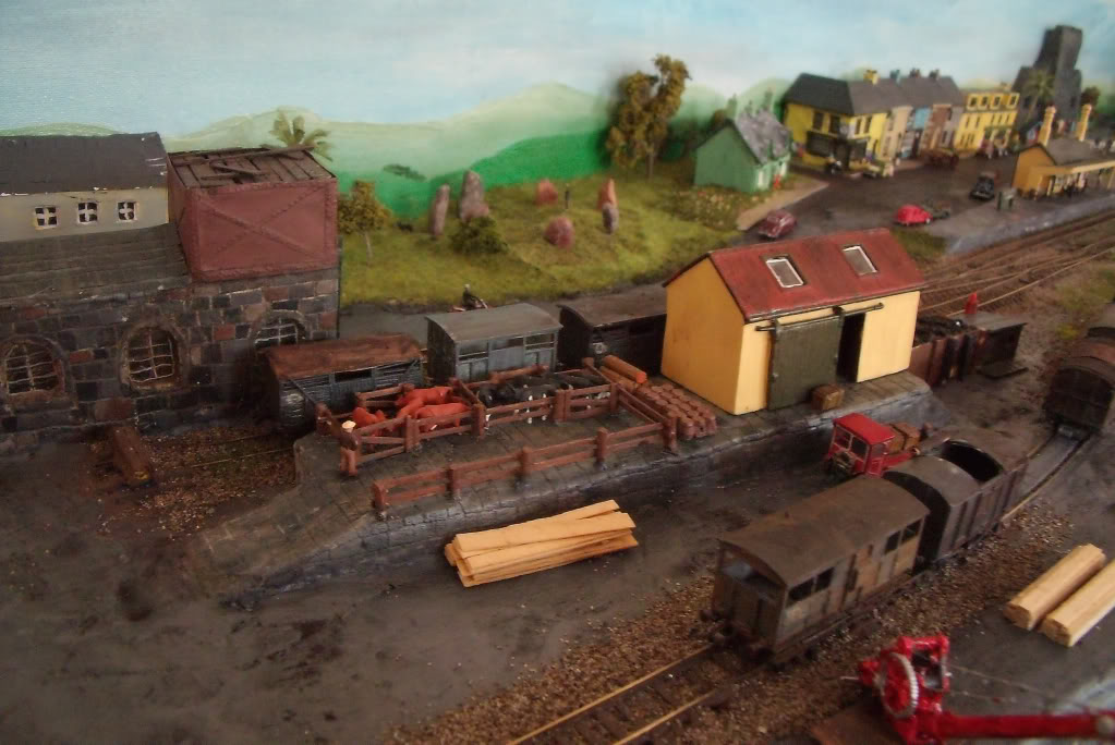

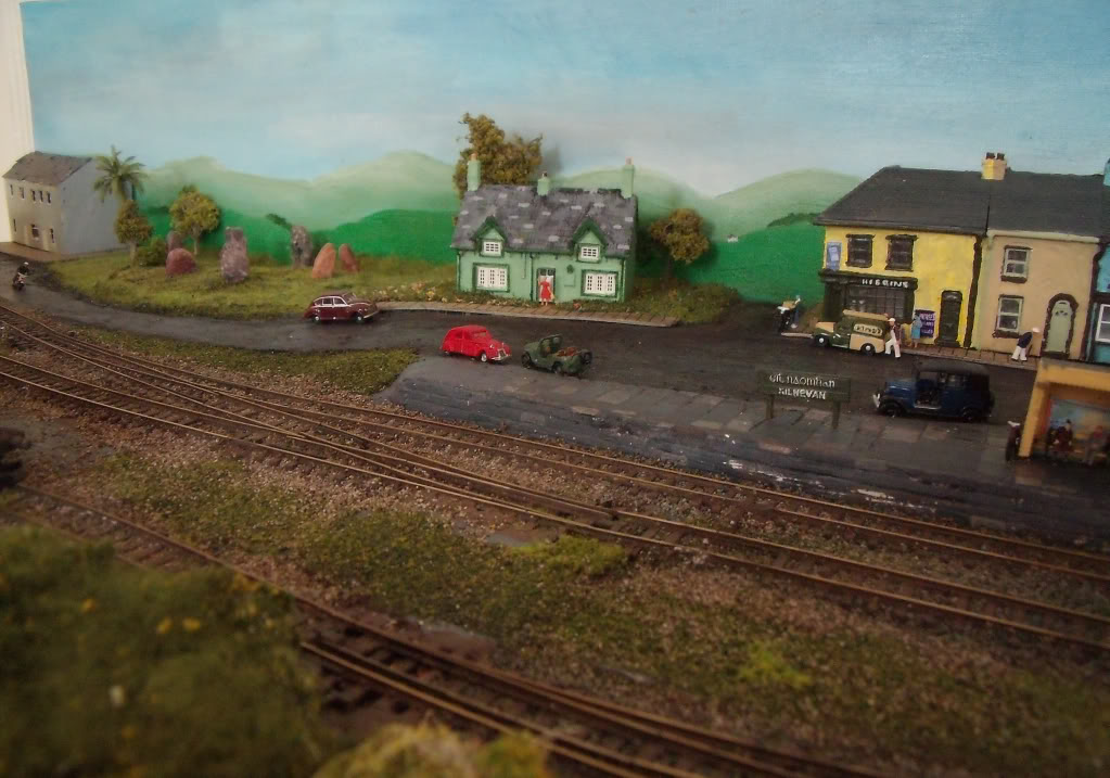

Hi everyone,
thought I'd post some pictures of my N gauge layout, Kilnevan.
Its the end of a branchline set in the late 1950's somewhere in the south west.

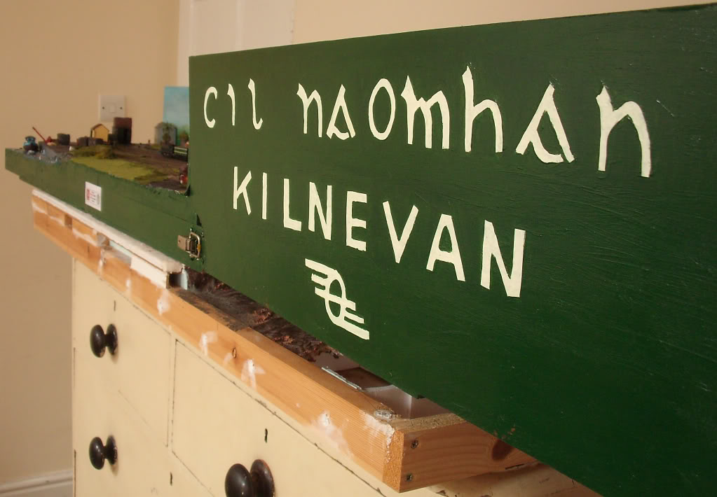

Currently devoid of a fiddle yard (behind the nameboard above) and needing some small track repairs/wiring.
Standard Peco code 55 track is used as I'm good with scenery but rubbish with chassis, hence 9mm gauge not 10.5 (or 10.8 even!).
This means I can use all the British N gauge stuff that looks like it can be cannibalised. :D
Buildings are a mixture of adapted r-t-p, kit bashed and scratchbuilt, of which some are still not finished!
The scenic portion of Kilnevan is 16" wide and 4' long, plus 2' for the fiddle yard.
Loco's and rolling stock is either r-t-r suitably 'Irish-ised', Worsley works etches or Valvedesign.
I have also designed a GSR cattle wagon that I've 3D printed on Shapeways.
Uses a cut down Peco 9' chassis.
I know there's probably too many road vehicles for the period but I felt that they helped to add life to the layout.
They are mainly by Oxford Diecast, suitably repainted if needed!
Although I haven't worked on it for over a year now due to other projects, I still tinker with bits and pieces for it.
One day I plan to extend the layout into a tail-chaser but haven't the room at the moment.
I hope you all enjoy my little bit of Ireland.
Oh and yes, Courtmacsherry was a big inspiration in case you're wondering!

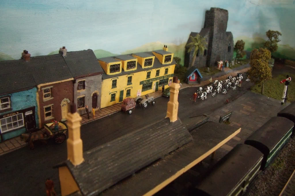

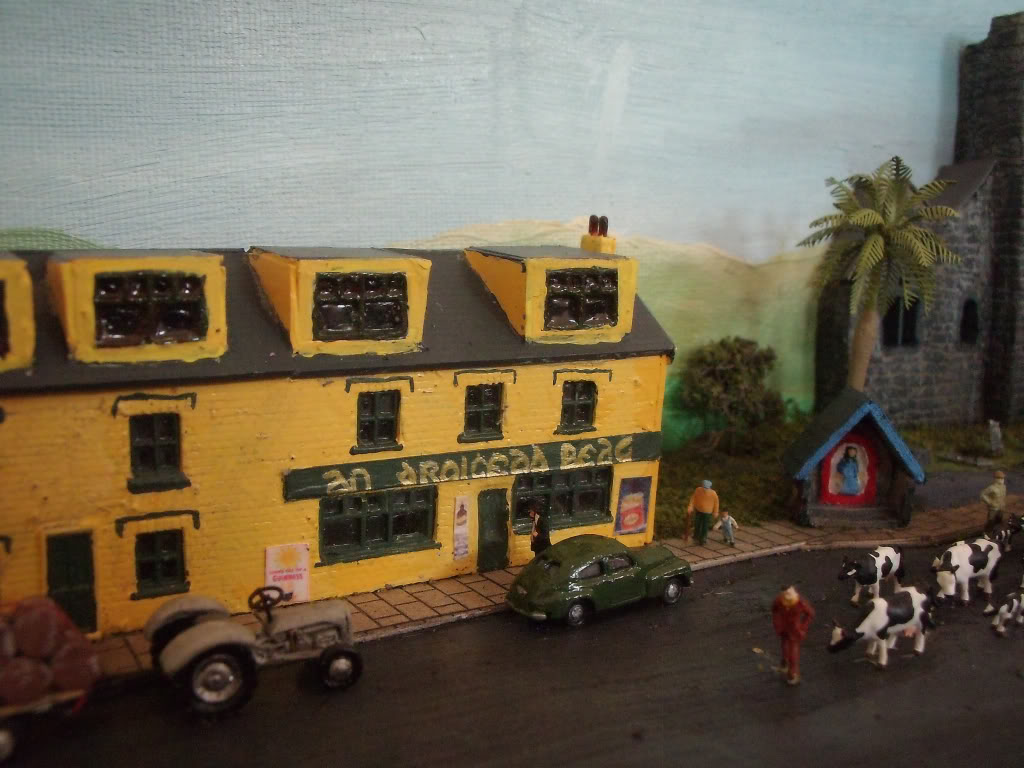

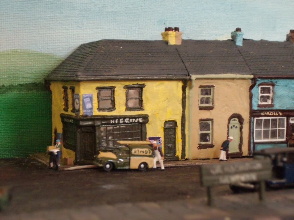

Loving an droicead beag! Many pints were had in there when I lived in Dingle!
I'm glad someone recognised it!
The Small Bridge Bar is the only building I based on a prototype.
Its made from Kestral kits and parts and was built at least 8 years before the layout!

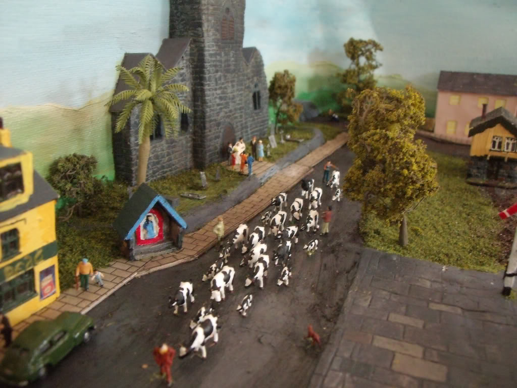

Lovely job with great atmosphere. Not sure about that palm tree though, looks more at home in Hawaii than the west of Ireland variation you see!
The palm trees (there's 2 of them!) are the nearest type I could find that would grow on a coastline warmed by the gulf stream.
I know they're not correct but I don't know of anything better, hence their use. I may have to try to scratchbuild some that look the part!

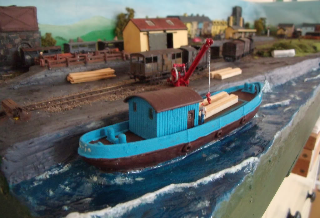

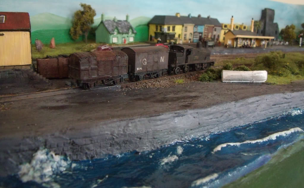

You can get sea sick with the waves at the loading of the boat just fantastic
Thank you. A good cure for sea sickness is to visit that big yellow building behind the station. :tumbsup::cheers:

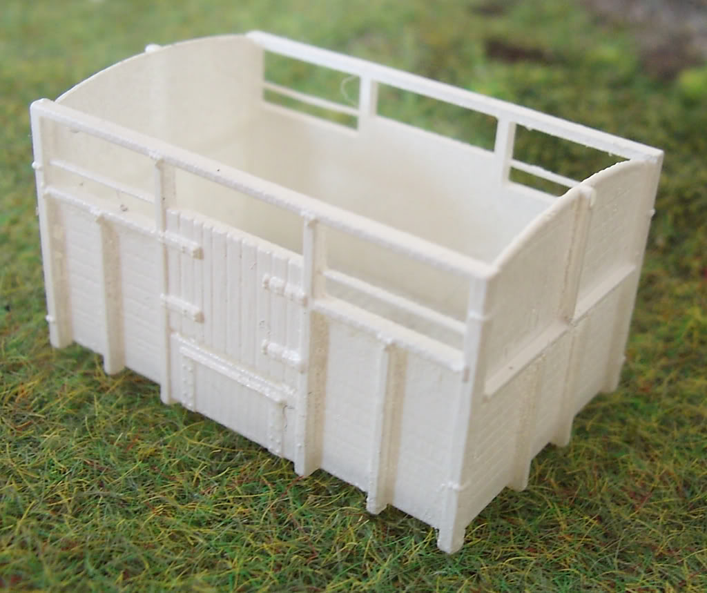

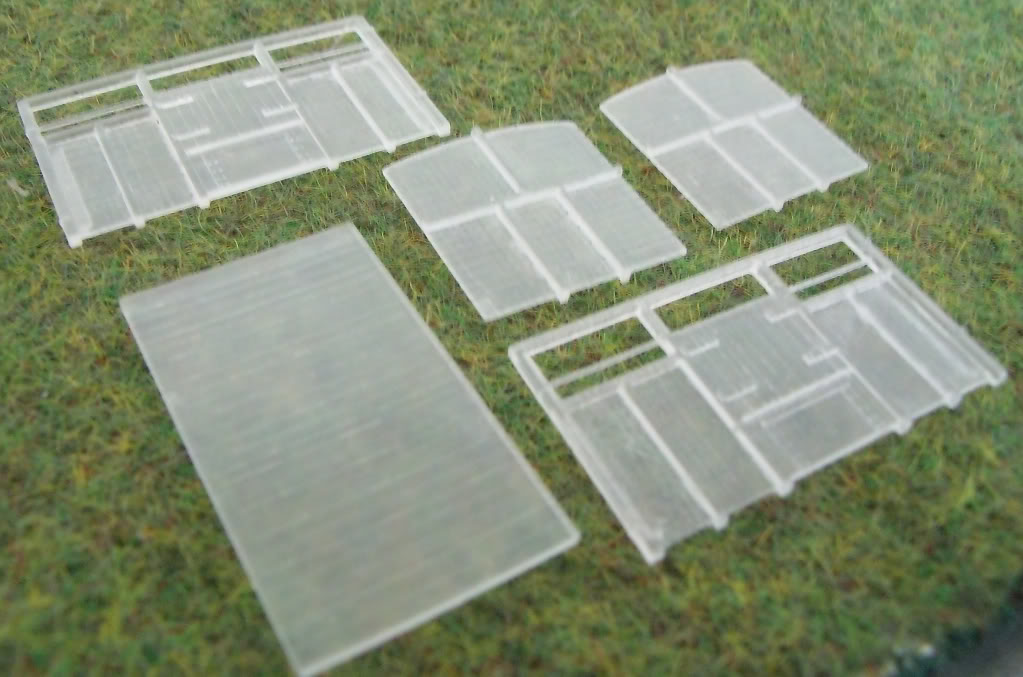

This is the cattle wagon I designed, assembled and in primer. Note to self, need grey primer!
And unassembled as it comes:

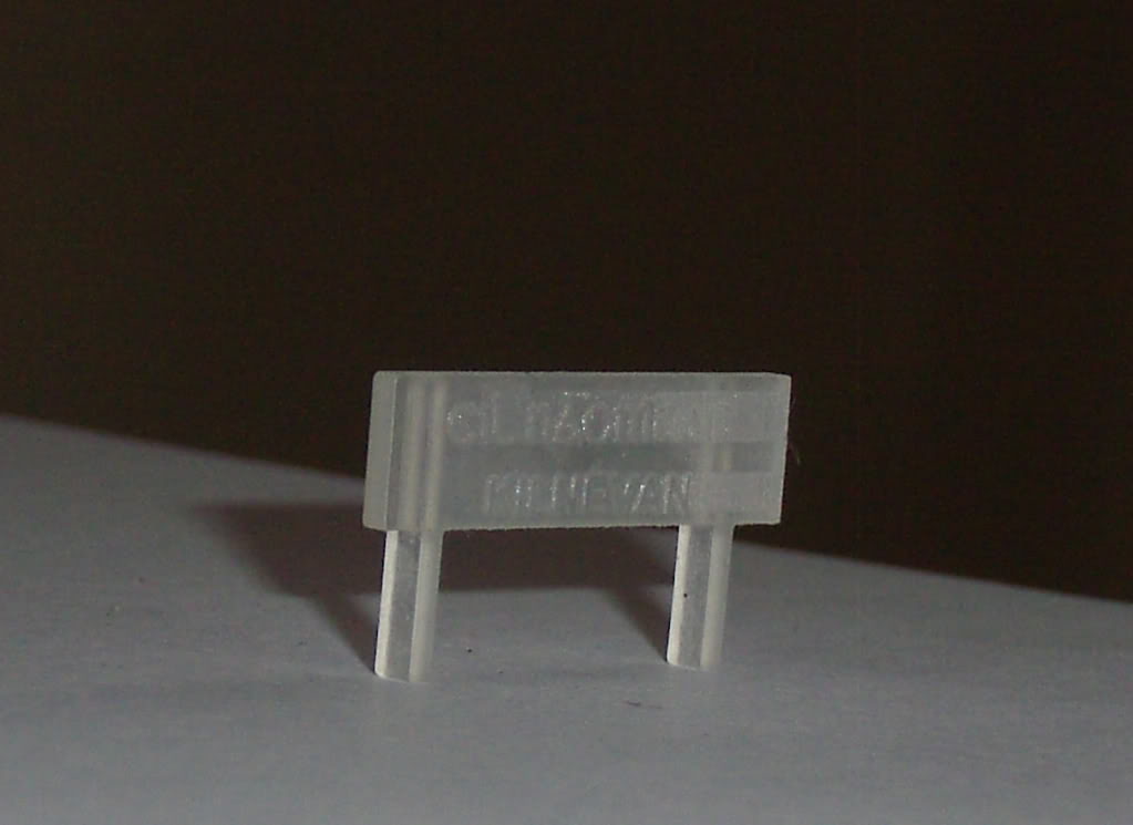

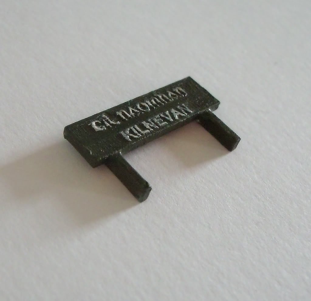

It's not the only item on Kilnevan I've 3D printed, did the bilingual station signs too.
I just painted them dark green and dry brushed the lettering.

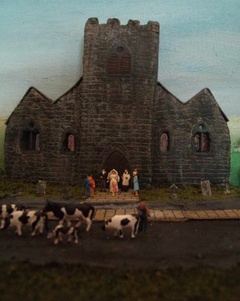

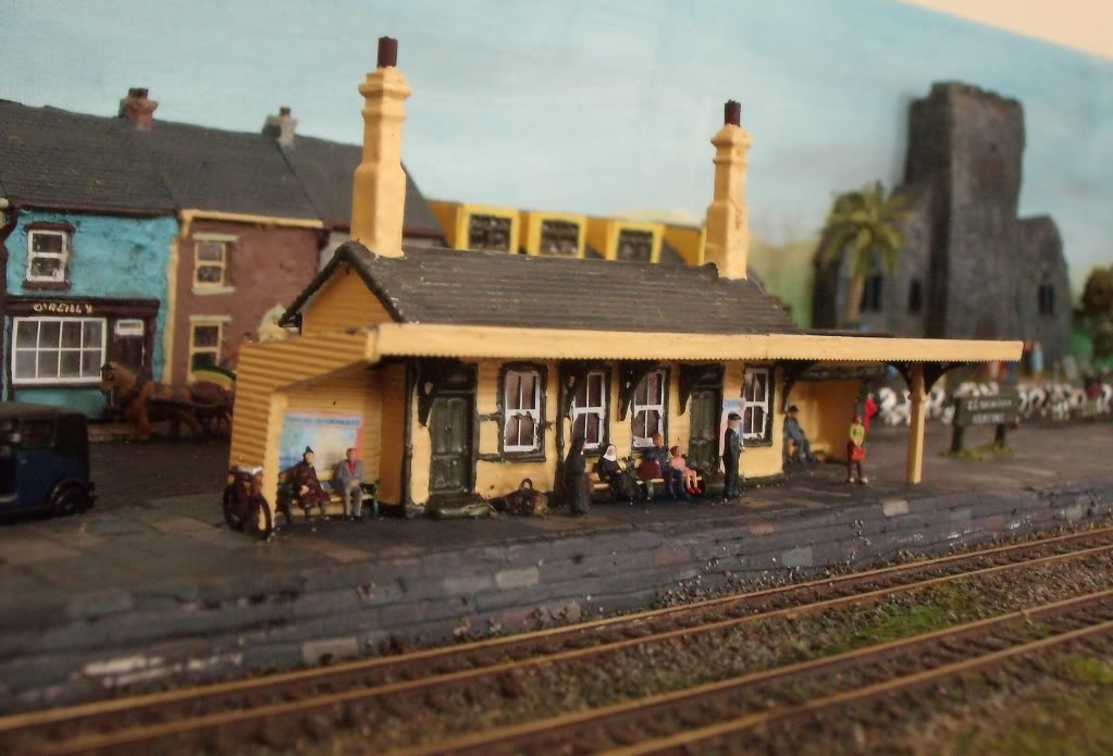

Found a few more pictures I'd taken.

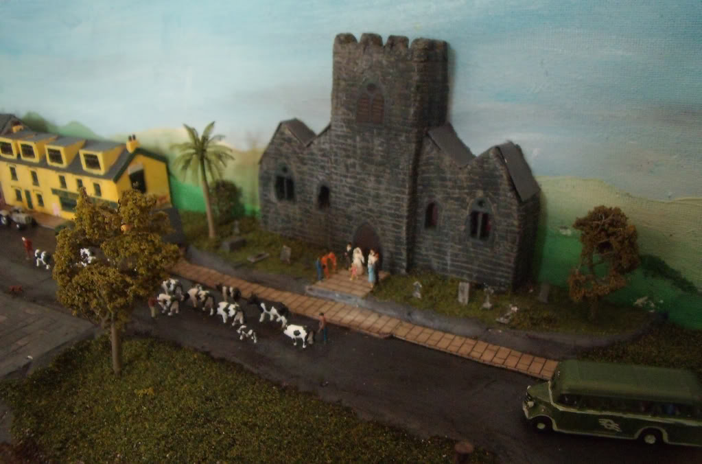

This one shows the church face on and shows the unfinished roof up!

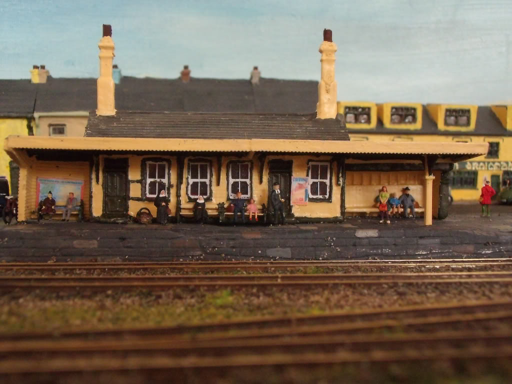

The station building is made up of Hornby Liddle End office building, waiting shelter, some old Graham Farish canopies, chimneys and canopy supports from the junk box and cotton bud middles for the chimney pots. So if thats not a 'bashed' building I don't know what is!

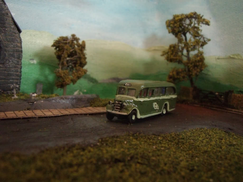

A close up of the bus. Mine is not a strict prototype, just a repaint!
The prototype, one of six built for Dublin Airport, had a slightly different cab, see pages 57 -58:
http://issuu.com/rivierabrian/docs/ftt-bbsept11_fullweb
And details under 1949 here:
http://www.skylineaviation.co.uk/buses/+CIE-45-50.html

Thank you. It took me a long time, a lot of trial and error but I'm pleased with how they turned out.
It's actually the GSR one from drawings in Patrick O'Sullivans book of the Farranfore and Valentia Harbour railway, vol 2.
It is very similar in design to others built earlier, CB&SCR springs to mind.
One day I might get round to drawing up the slightly larger CIE version!

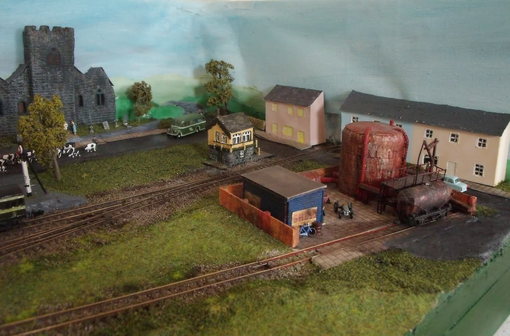

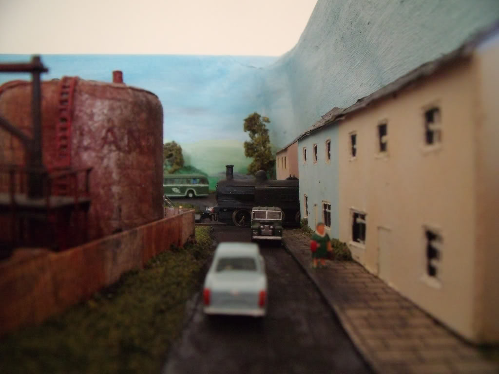

Still nothing more done to Kilnevan, but I have made one decision.
It needs a petrol station behind the fuel depot!
dioramainitsfinalplace.jpg"]dioramainitsfinalplace.jpg[/url]
There's just enough space for a pair of pumps and maybe a small office I reckon.
Office will probably be at the end of the fence by the wagon in the above photo.
crossing.jpg"]crossing.jpg[/url]
Pumps will probably be against the fence on the left here in a sort of lay by!
It won't be huge I grant you, but I think its one thing that is missing that I've overlooked.
As to when it gets done though is anybody's guess! =))

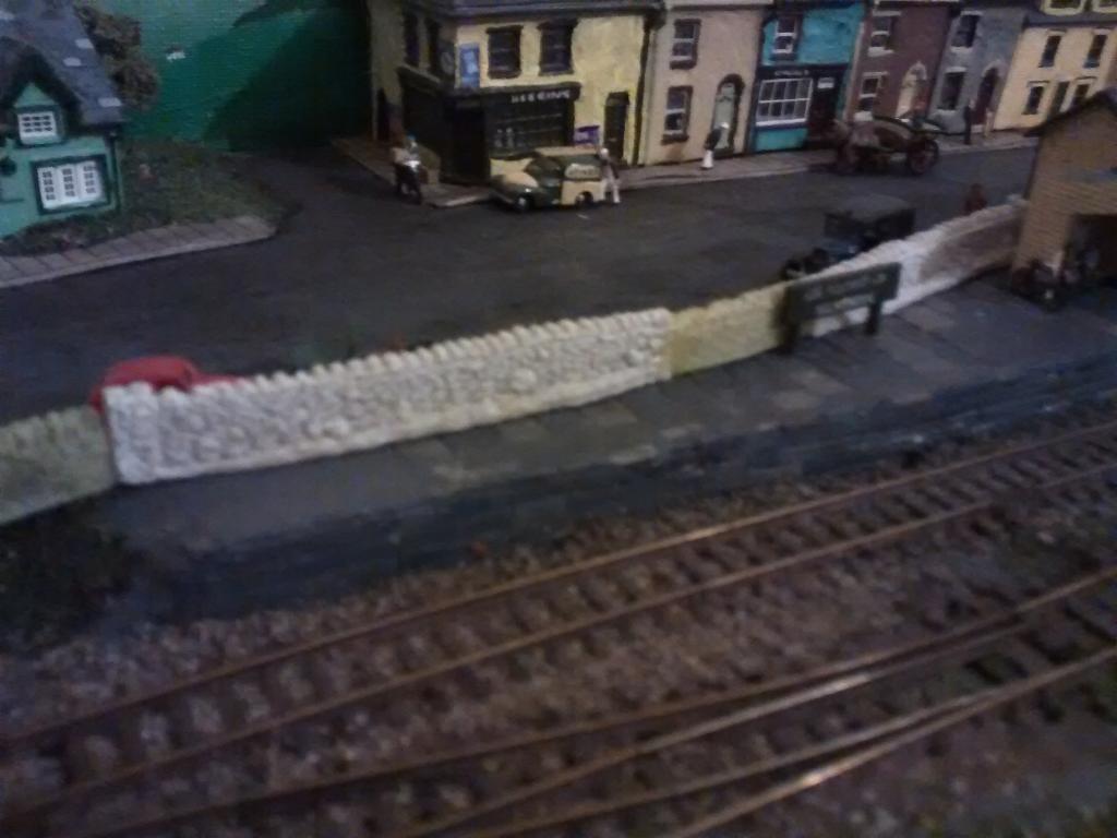

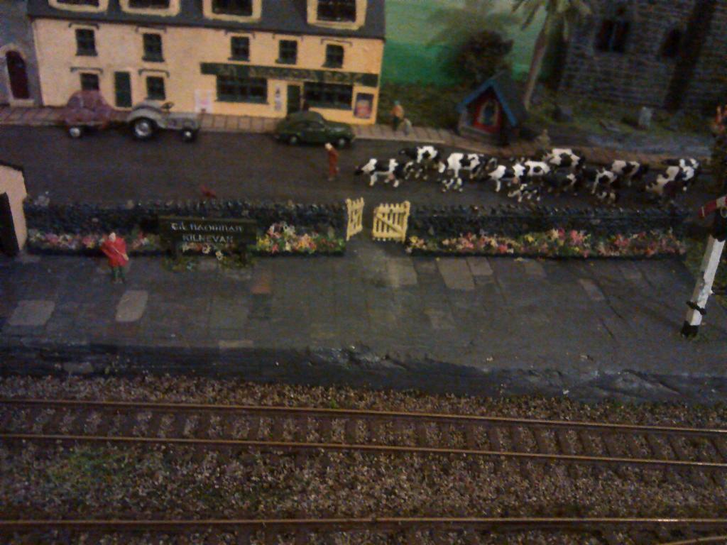

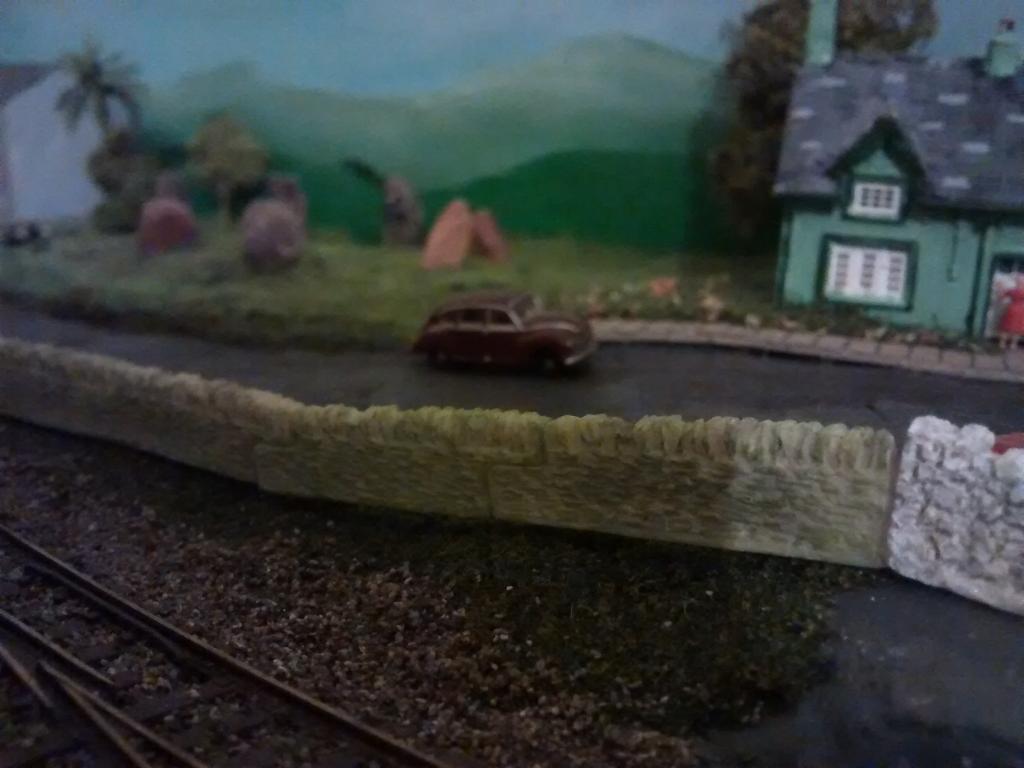

After a long time not doing any modelling, moving and various other things I've finally started some work on the layout again.

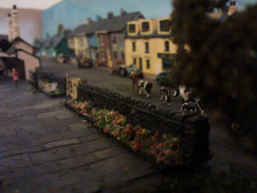

Been adding some stone walling around the railway.
Need a lot of work still. A mixture of Liddle End and Jarvis if I remember rightly.
Finish some with entry gate and flower beds.
Not started on the petrol station. I am looking at what pumps would suit it first, so more research!
Apologies for the poor photos. Camera is still packed away in one of the many boxes from moving!

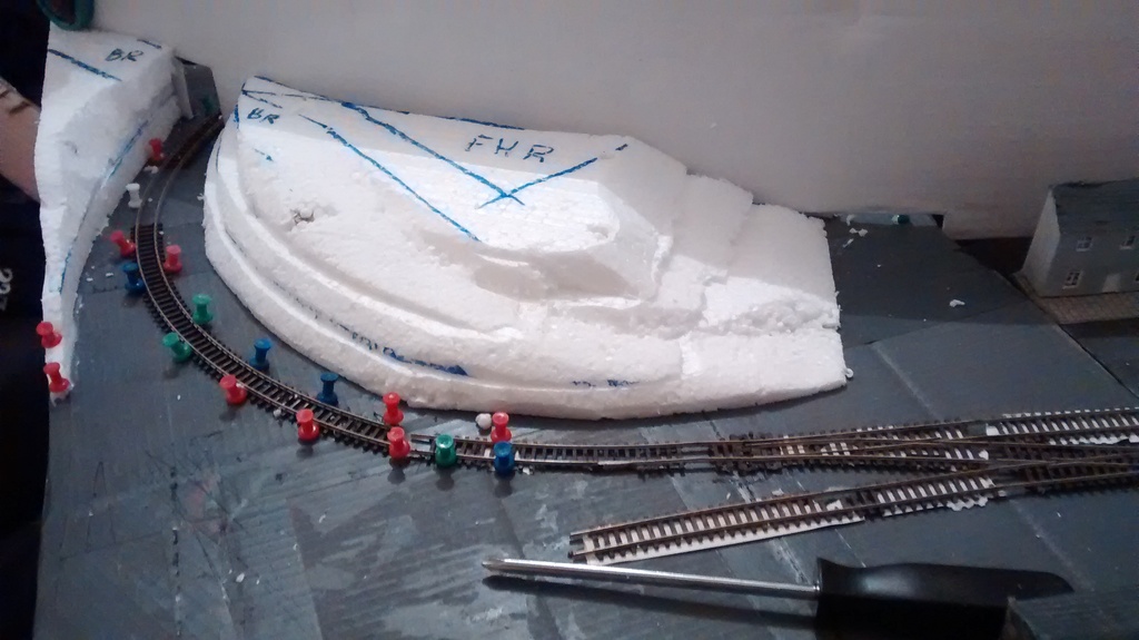

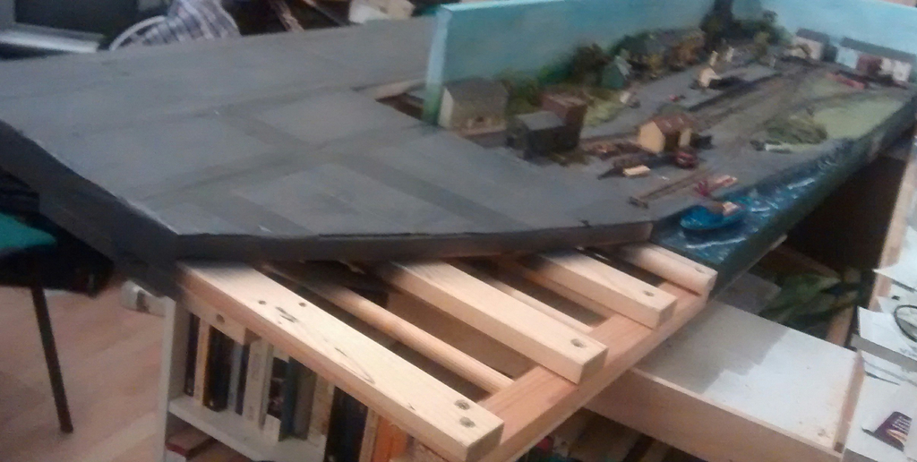

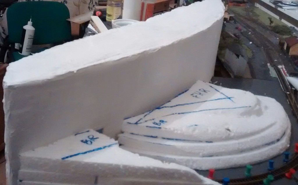

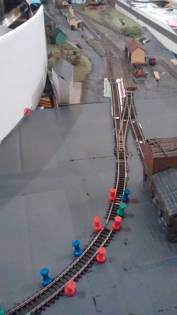

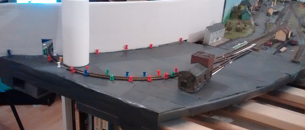

I'm back and over the last few months I've done some work on Kilnevan for the 1st time in over a year!

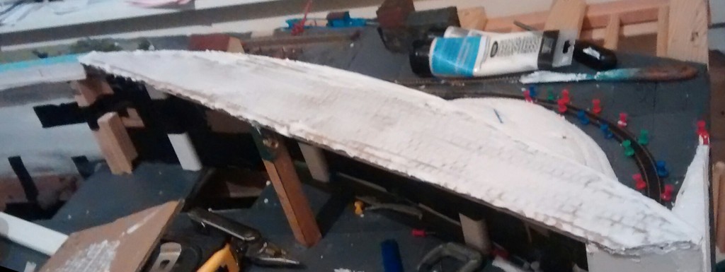

Yes, I've finally extended the layout into a tailchaser, just like I've wanted to do for the last few years.
The layout now measures 6' 4” x 2' 7”, so not much longer than it was, but a fair bit wider.
The original backscene has been cut back slightly and a new curved one added to it.
This is card covered in canvas with wooden supports at the rear.
The track in the pictures isn't fixed down yet as the curve is an old length of code 80 and I'll be using code 55.
I have most of the points needed, but it will be a while before I get the rest of the points and track thats needed.
Meanwhile I can at least work on some of the scenery.

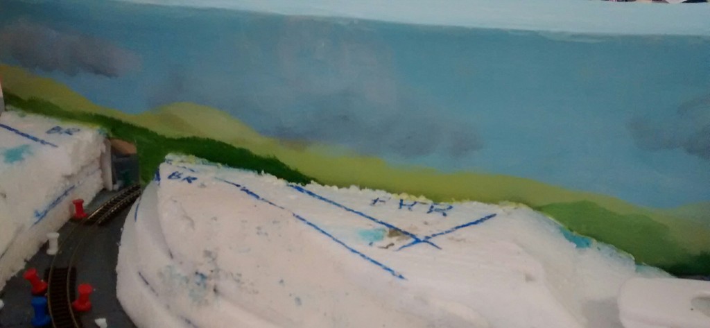

Made a start on some polystyrene formers for the only hill on the layout which will have a road curving up one side of it in order to cross over the railway where the scenic break will be.
Need to find a suitable Cork area prototype bridge to model!

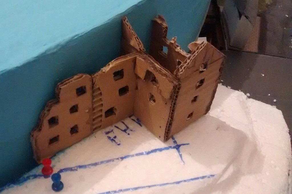

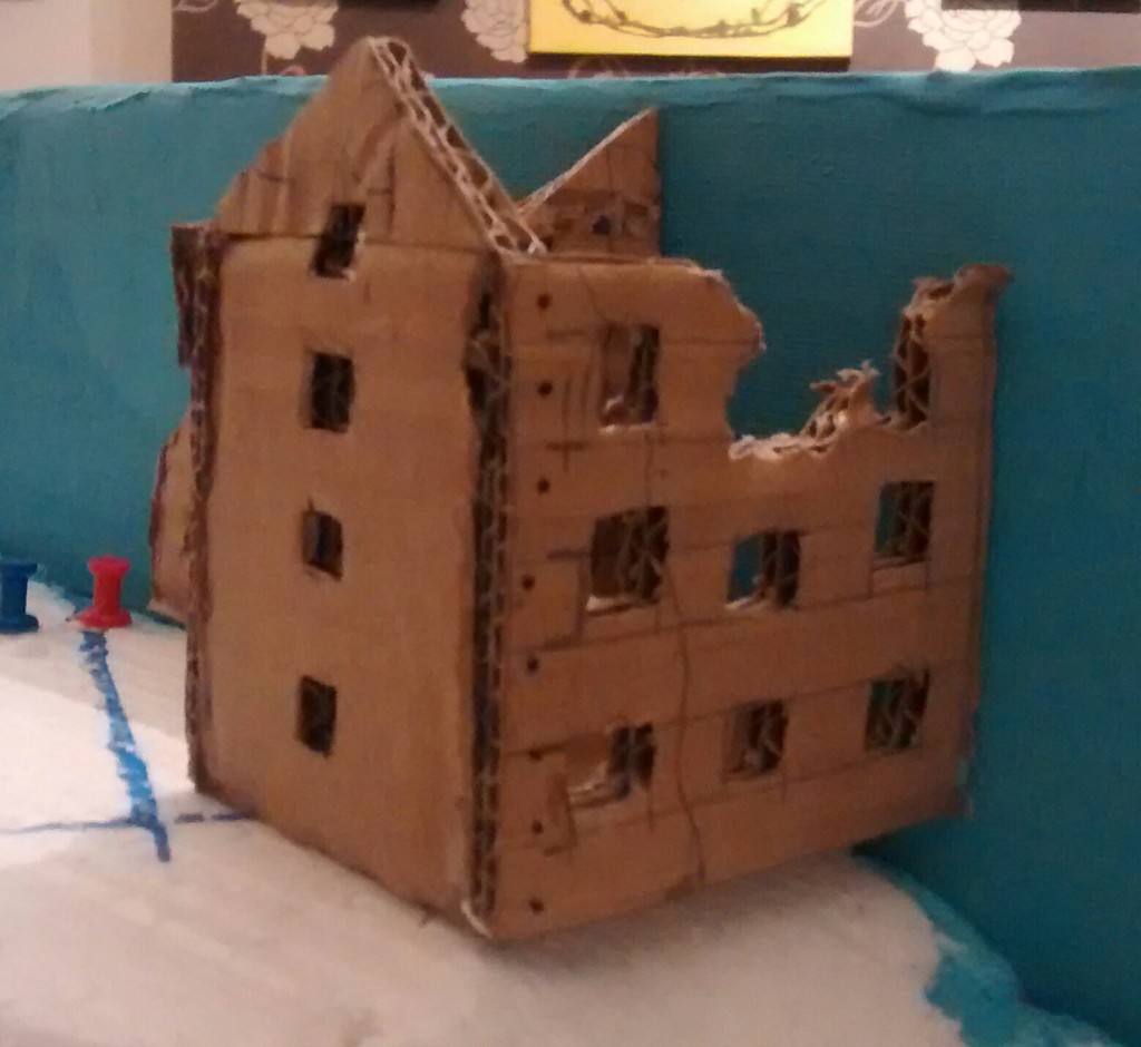

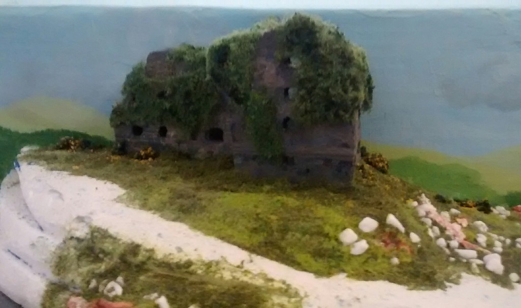

There will be a ruined fortified house on the hill.
Edited by moogle

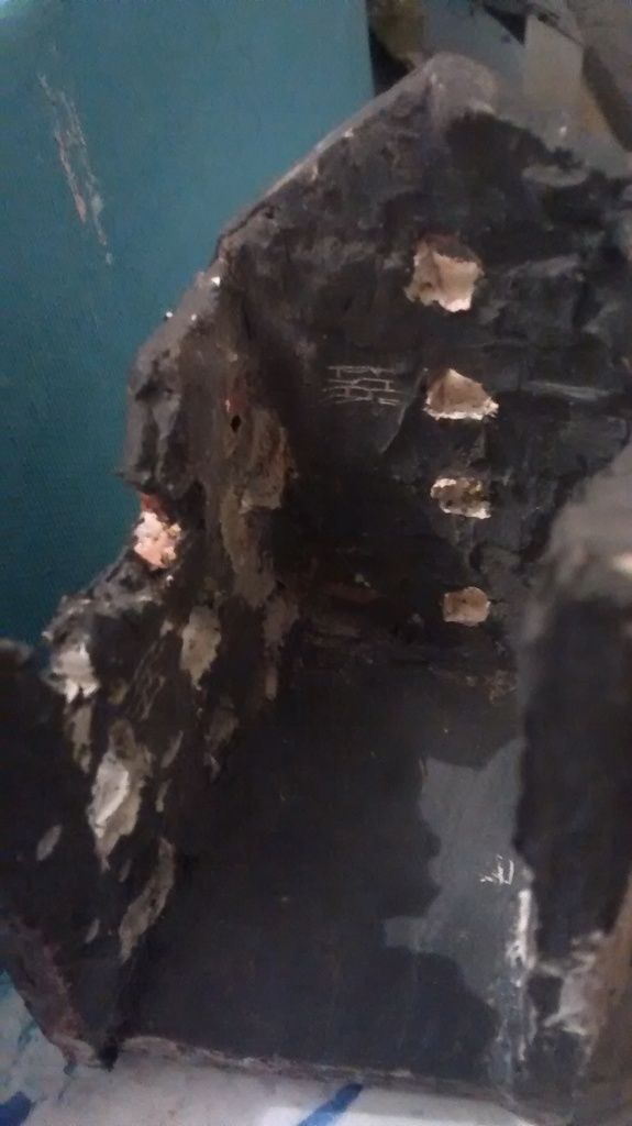

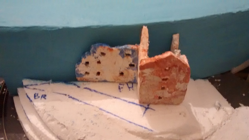

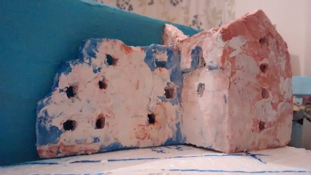

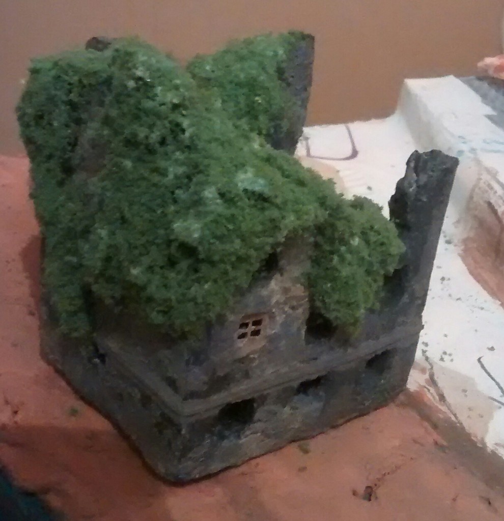

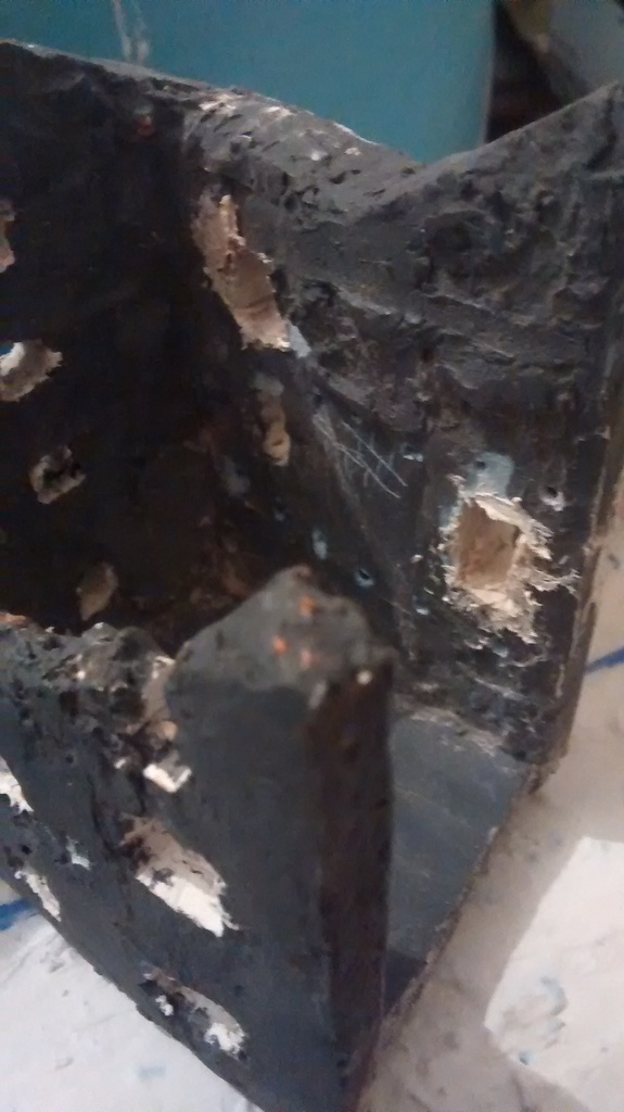

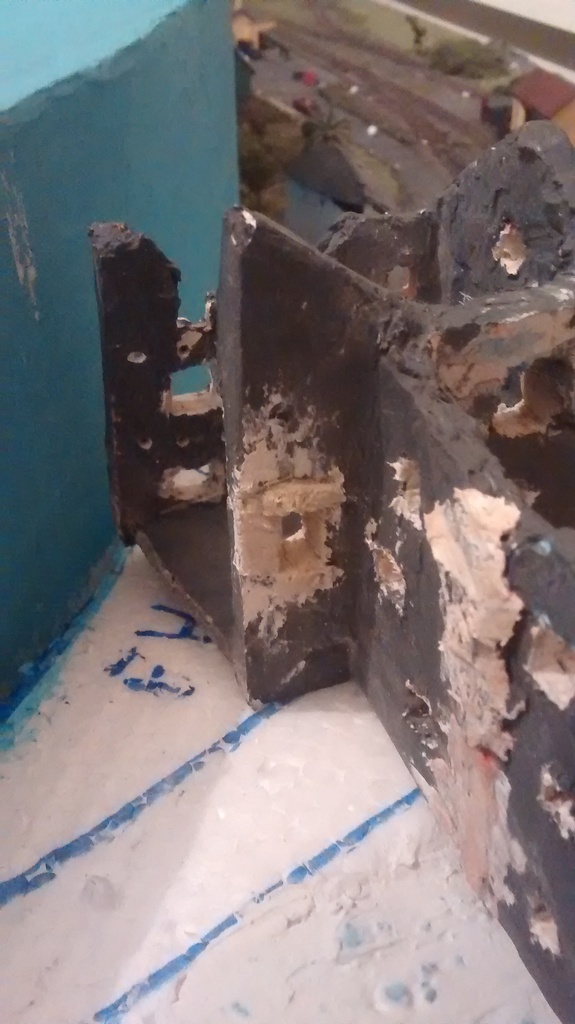

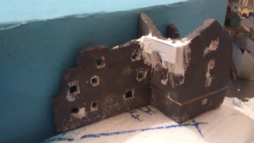

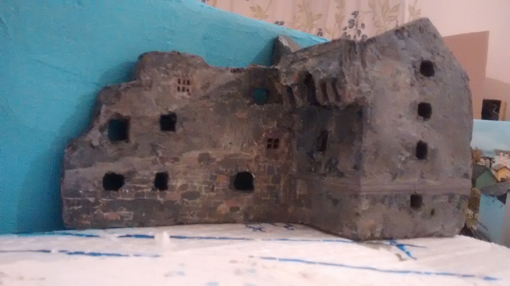

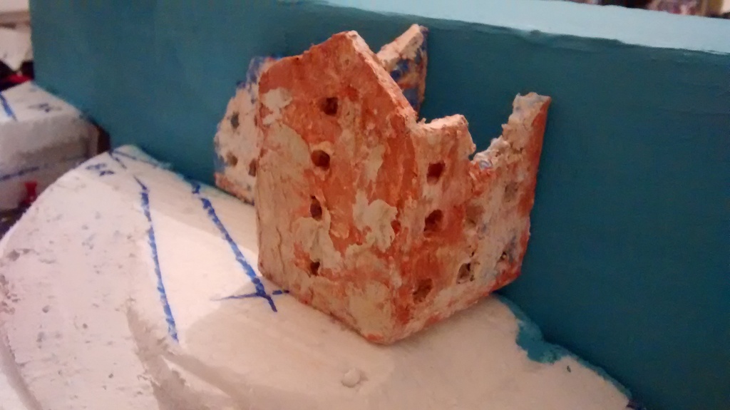

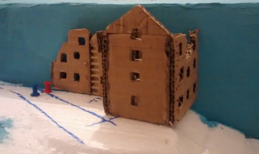

For the fortified house ruins I used materials at hand: corrugated card...

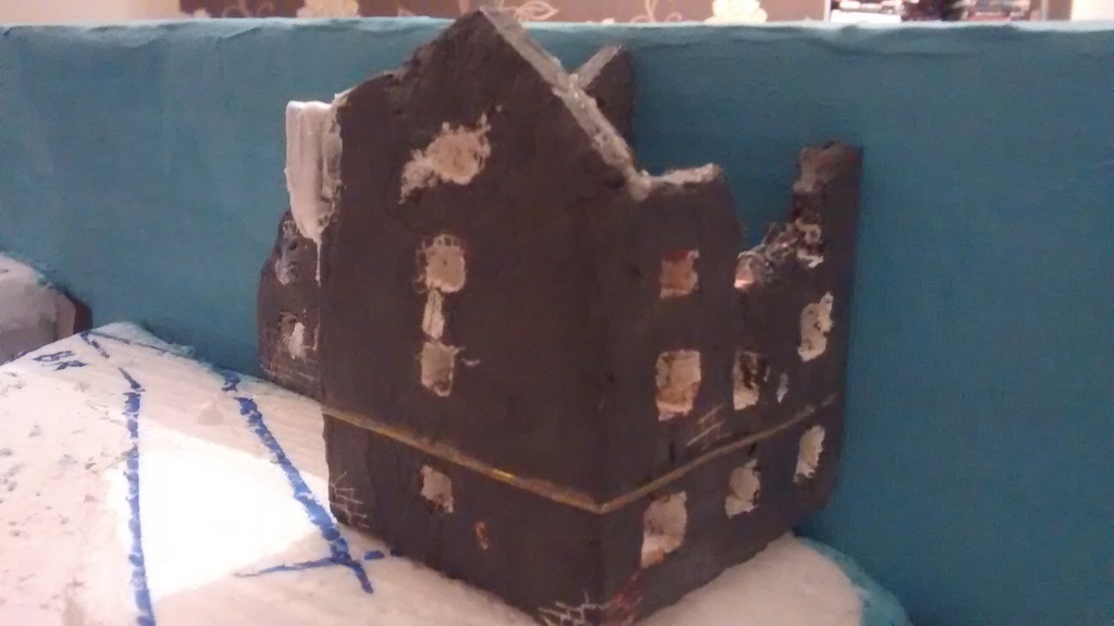

Walls have been covered on plaster and clay. A little warping occurred but nothing drastic.
Not that it matters as its a ruin so perfection isn't needed!

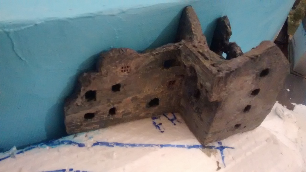

Lots to do still. Stonework to scribe, musket loops to add, holes where floor joists were etc...

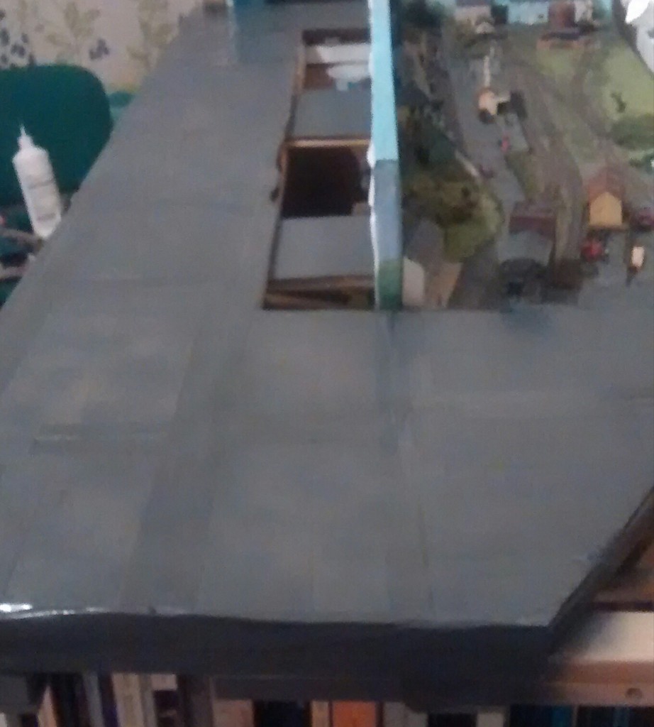

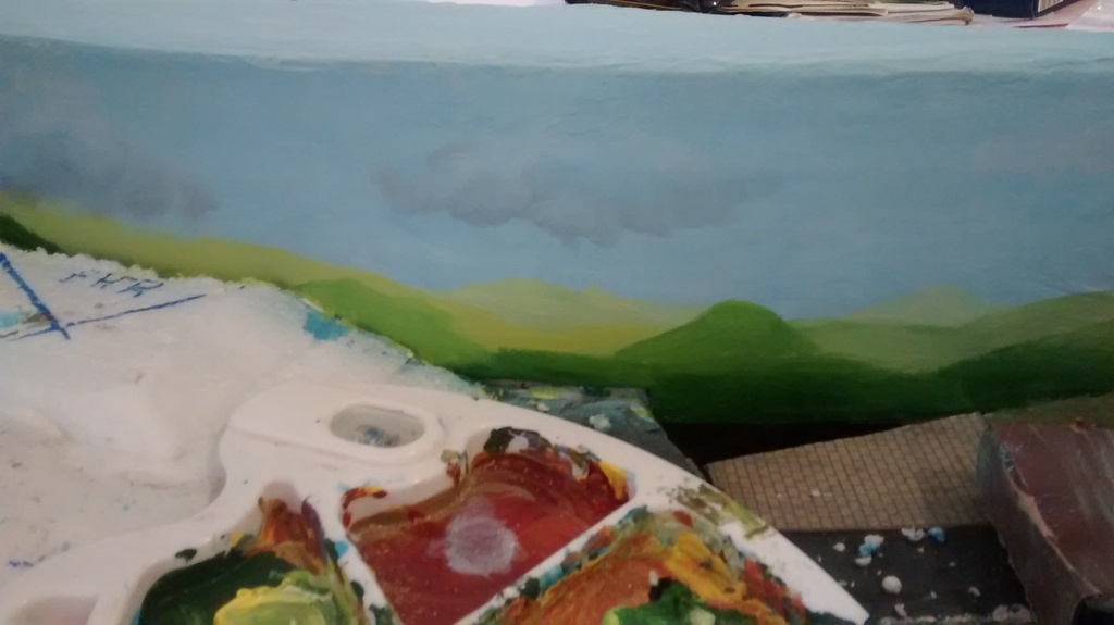

The backscene has a coat of blue on it to aid sanding out any bumps where I had to infill some dents with modelling paste.
When sanded they'll show up as white, then I can paint the backscene properly!
The inspiration for these ruins, architectural wise, came from here
Edited by moogle

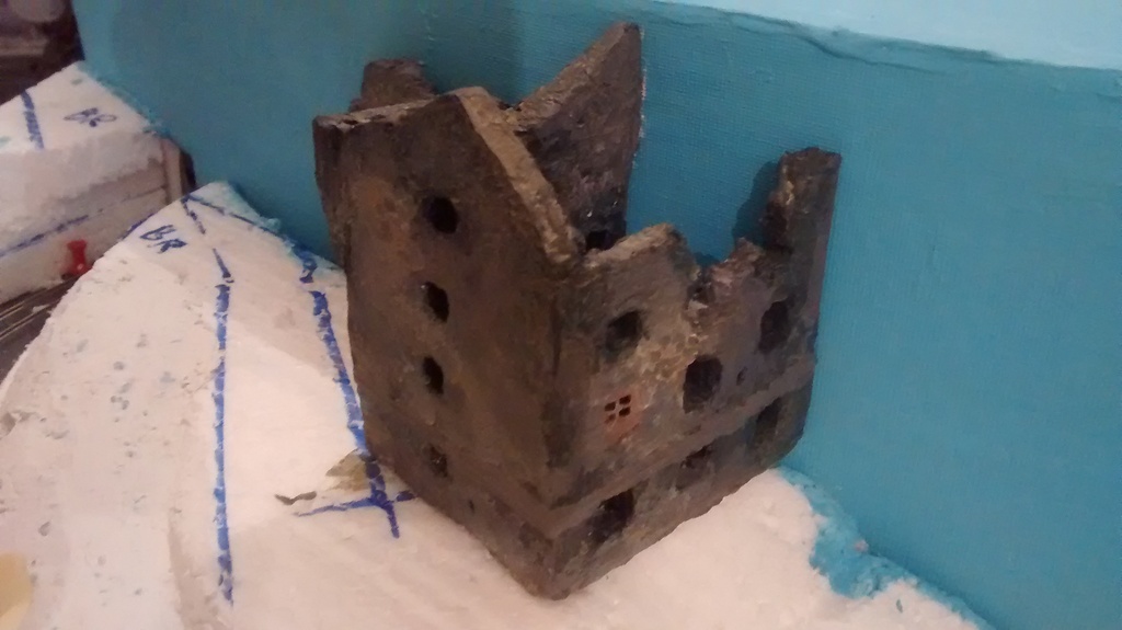

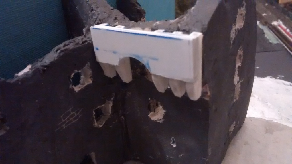

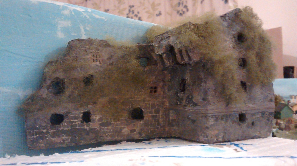

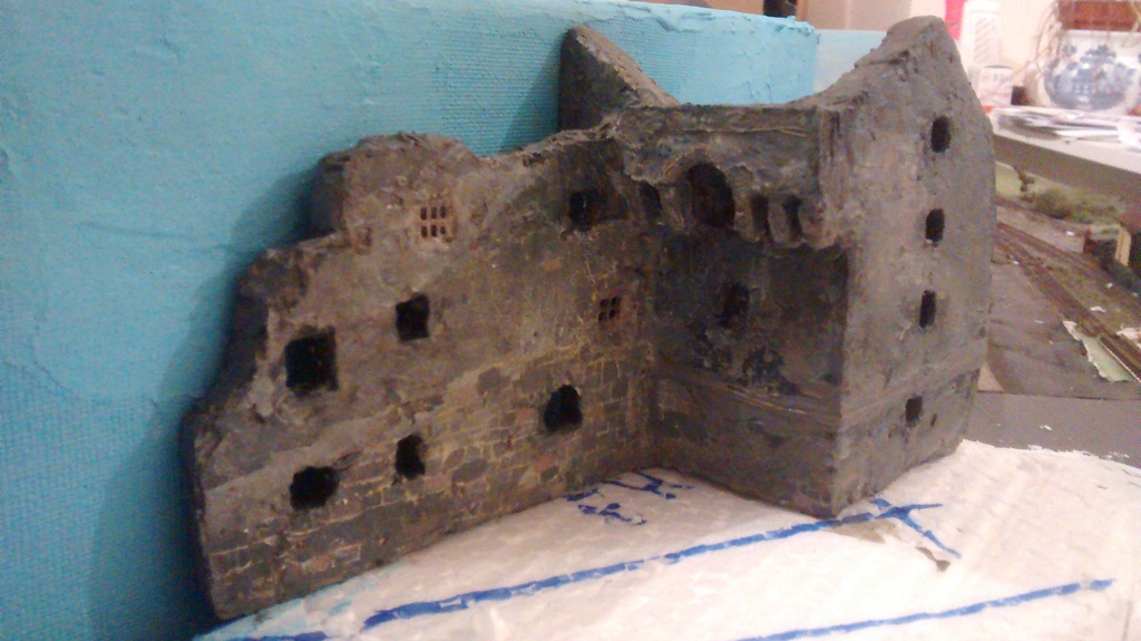

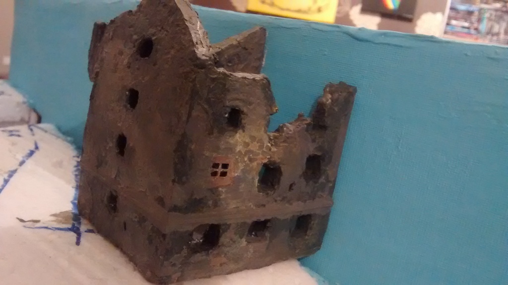

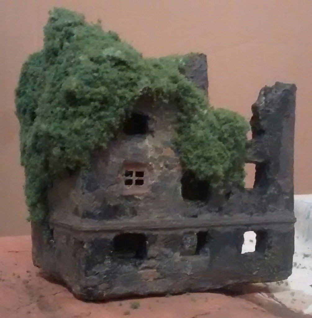

Done some more work, filled in window edges, added joist holes, musket loops, stonework, oh and a bit of painting.
Added some battlements/defences and mullioned window remains...
All I need now is to add ivy. Hence why I haven't scribed stonework all over it!

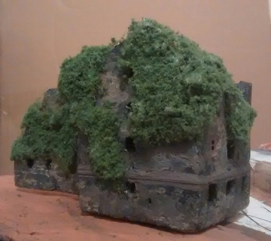

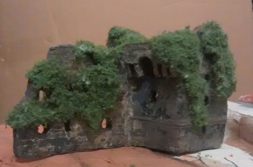

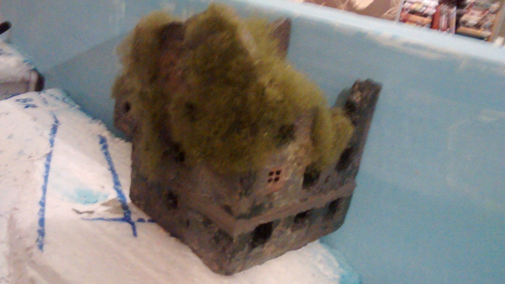

Added some ivy.
Began with adding some polyfibre with pva glue.
Once the glue had dried I added some medium coarse medium green flock using a slightly watered down pva.
I think the ivy has enough 'bulk' without being too much.
May dry brush a few green highlights onto the ivy, not sure yet.

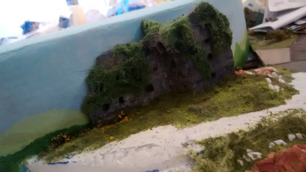

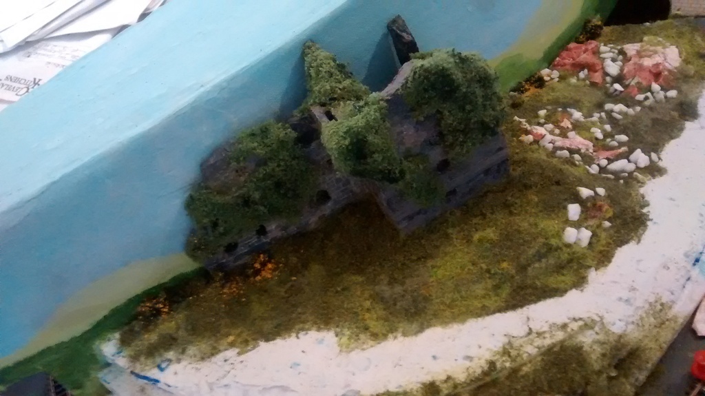

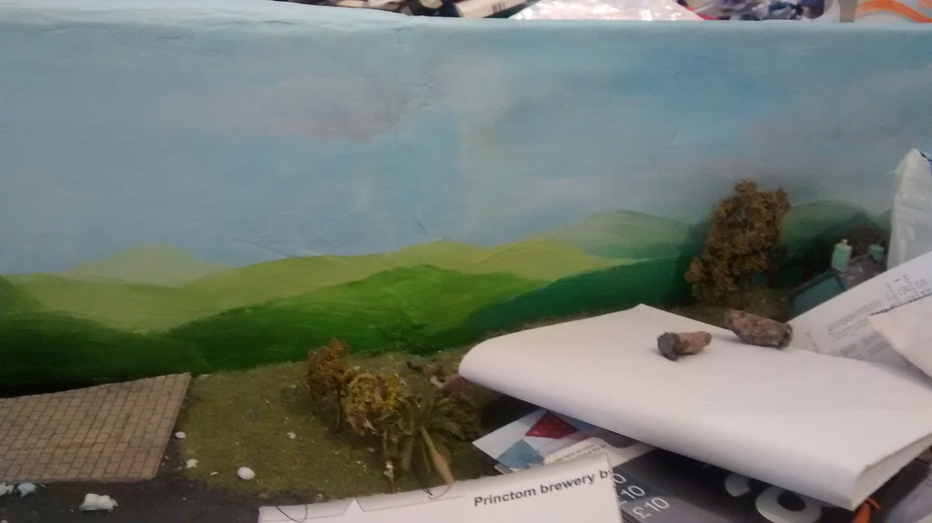

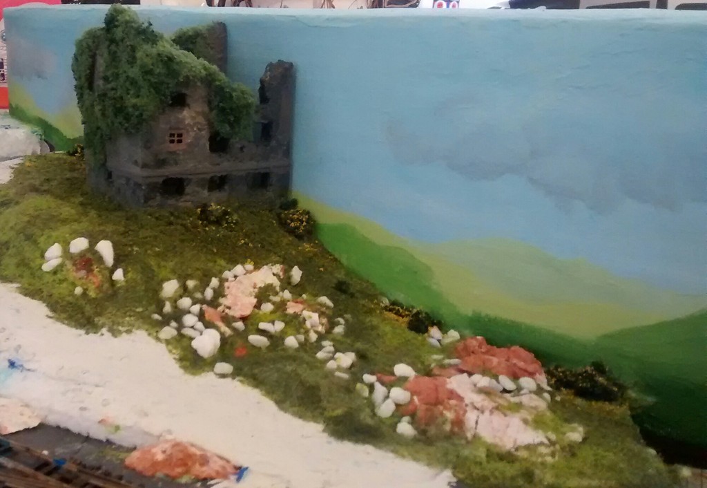

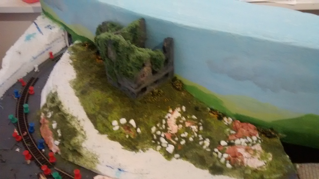

Painted the backscene and made a start on planting the ruins!
Used acrylics as I prefer them for landscape painting. I think the backscene join has blended well:
Planted the ruins doing some landscaping while I went.
Still got the rocks and boulders to paint.
Then the road, a bridge to build, cutting sides to model...
Hold on, need to buy some track first! Next update may be some time...
