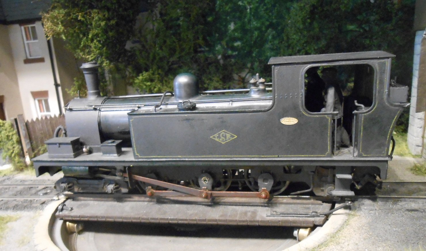

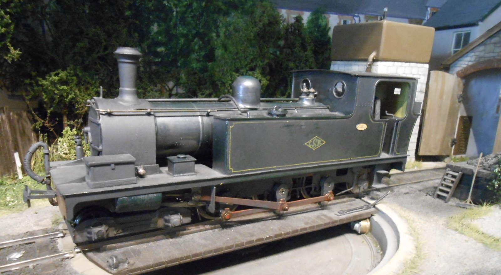

What a great opportunity David! Gordon Gravett is up there with Iain Rice and Mike Sharman in my list of railway modelling heroes. Though I never managed to see Pempoul in the flesh, for me it took modelling to a new level the first time I saw photos of it in BRM. And later, Arun Quay was equally impressive. Sounds like Ashford was a great show.

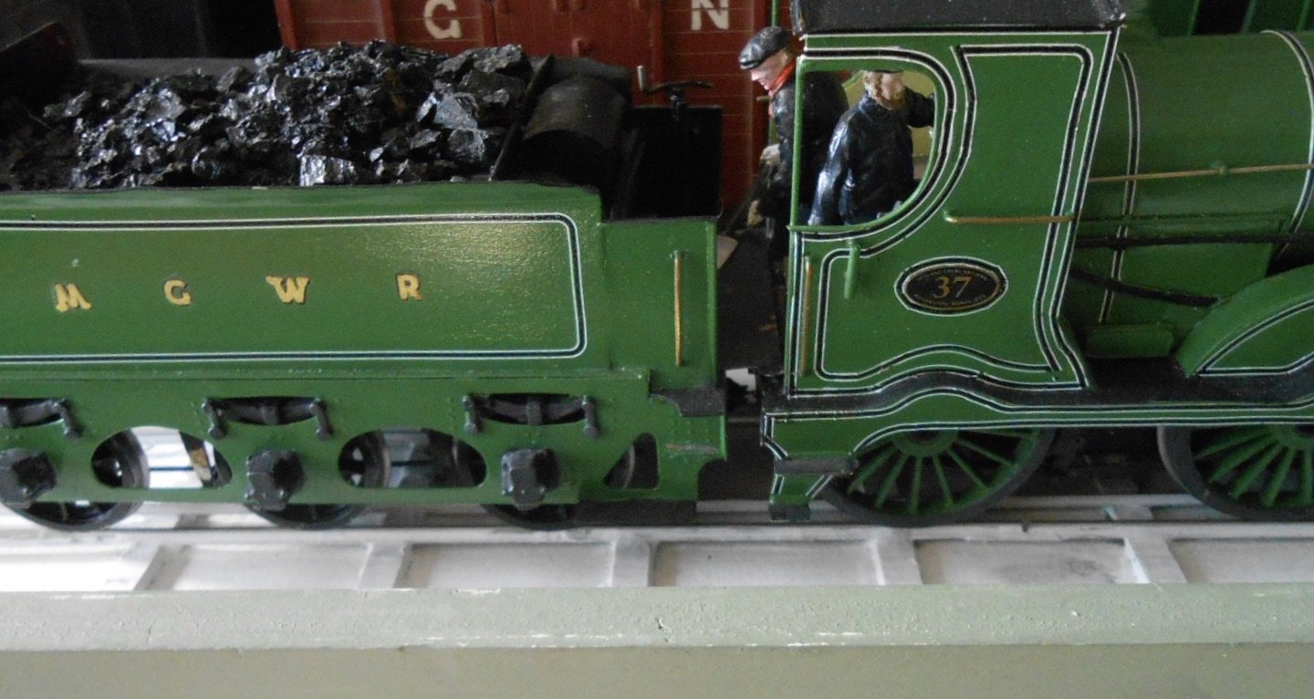

The Swilly tank is brilliant. Perfect weathering job. You've definitely achieved the look you were aiming for. Totally convincing. The rods and wheels are just right for a well used loco. I know what you mean about airbrushes. It takes a deal of courage to spray a weathering mix all over a pristine model. Something I haven't yet had the guts to do!
Thanks folks. The air brushing took all of two minutes, though I did practice on bits of card beforehand to try and get the spray pattern right. Truth be known, it looks ok with the two foot rule, but close up, it could be better. Must make sure I request barriers when the layout goes out again!

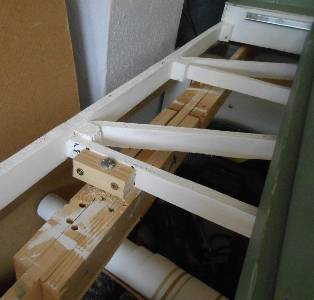

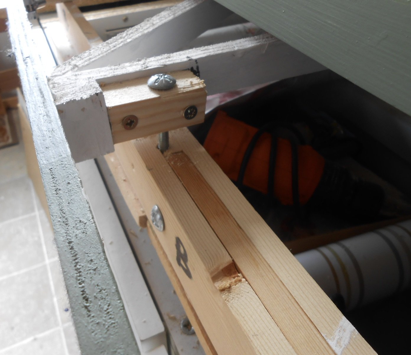

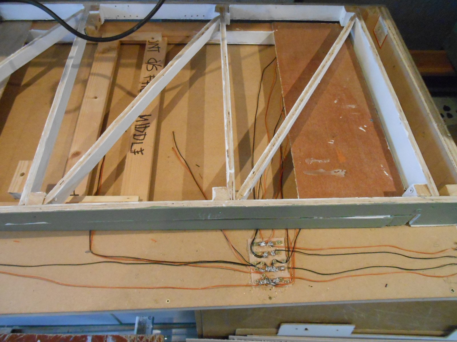

 Something that has had me worried for a while is the sliding/rotating fiddle yard. It's a bit of a nervous breakdown every time the train table needs rotating and though I'm [fairly] sure everything is safe, decided a bit of belt and braces was needed - hence a couple of wooden blocks screwed to the frame so that long bolts can go through the beams for a bit of extra security.
  Also decided a new, separate storage box was merited for all the electrics - instead of chucking them all in the 'sundries crate' at the end of a show.

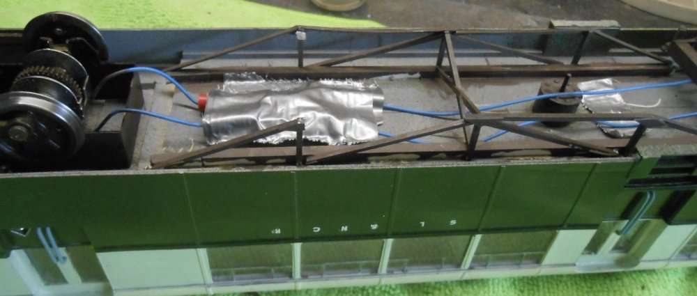

 As Mayner has already pointed out with his large scale garden railway stock, our models can lead a hard life and so it is with exhibitions - mainly down to getting things in and out of boxes all the time. Going through my stuff found a host of minor problems, plus several niggles like loose cab roofs and so on:

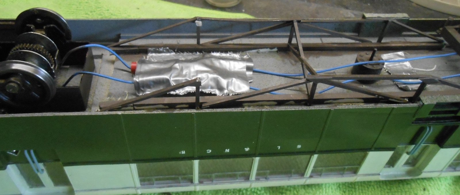

 Above is the under frame of Railcar B, missing one of its struts. Below is one of the exMGWR 6 wheel coaches, lacking a cover to the guard's Duckett.

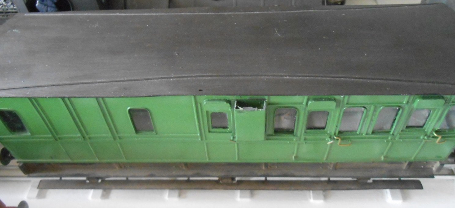

 Discovered several wagons with missing bits of under frame, brake handles & so on,  while even Wof Dog wasn't immune, having lost a step from its tender.
  None of the remedial work took long to fix - though the repairs still need painting and there are a fair few other models that need a bit of touching up as well while I'm at it. As stuff goes back in the stock boxes, I'm also taking time to make sure each of the sections is secure, including the all important pieces which protect the Alex Jackson couplings.

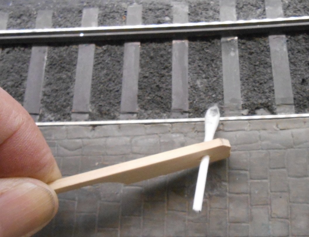

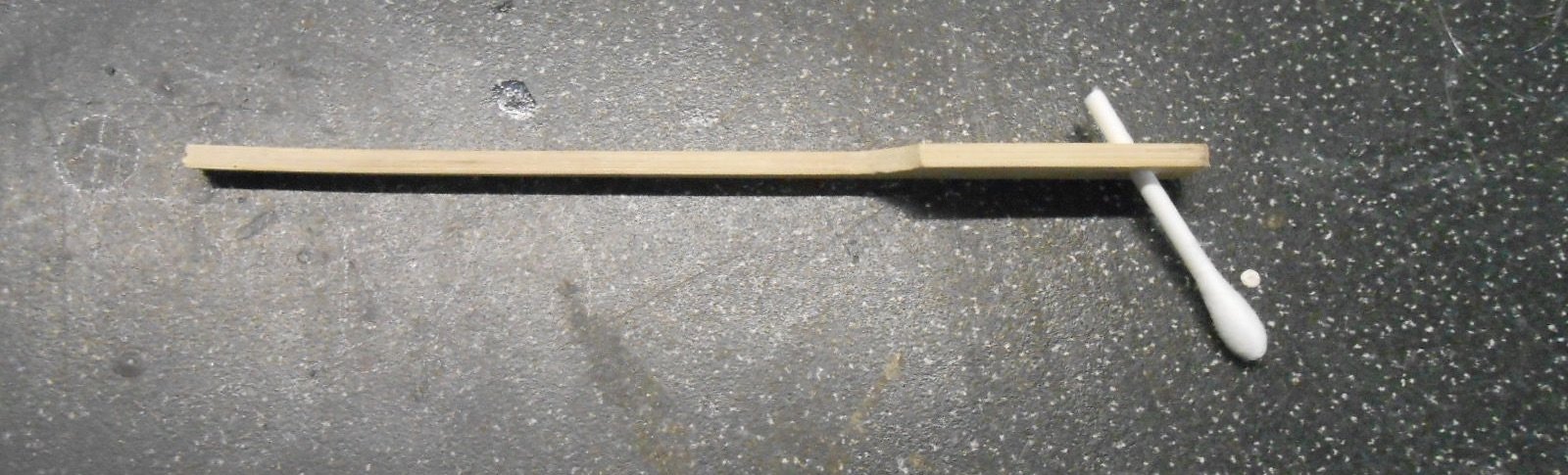

 Finally, a neat little idea I learned from Gordon at the Ashford Show. It's his track cleaner, which uses a barbecue skewer with a hole drilled in it to take half a cotton bud. Soak the bud in meths/alcohol/lighter fluid and it becomes a very handy way to clean to the rail tops.

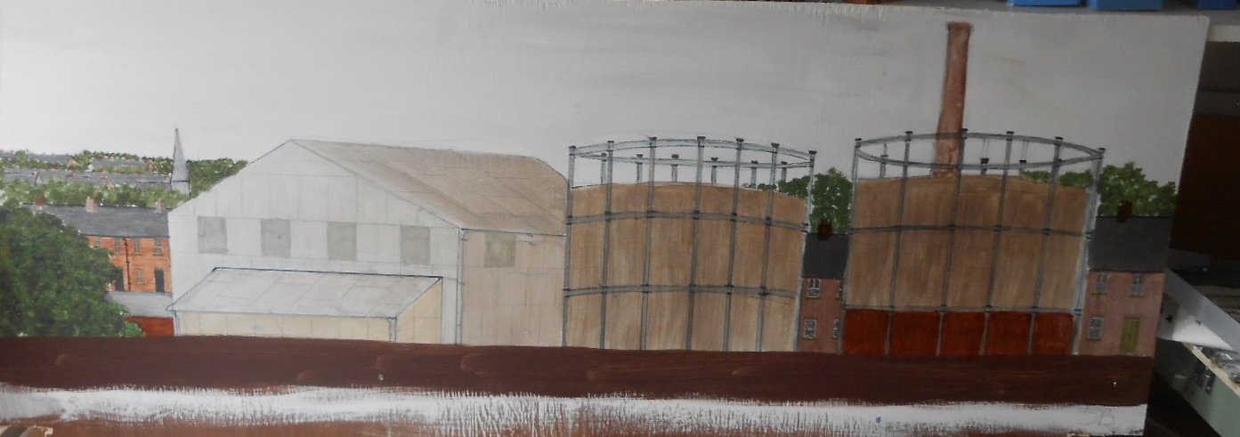

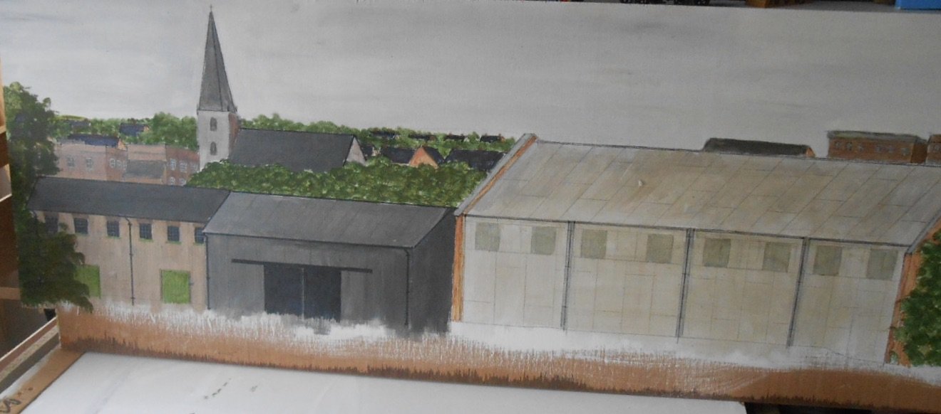

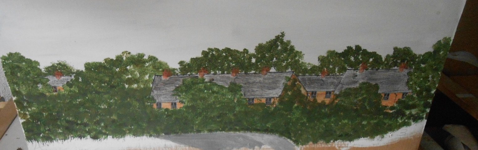

 However, we decided that a back scene would be important. This started out as a pale grey sky [white emulsion & black acrylic], but the creative muse got hold of me & decided to something more creative, essentially a mix of urban scenery, ranging from parklands to housing and industry. Nothing too fancy, just an impression, so stippling acrylics for distant trees, with slate roofs poking out between/above, then a mix of felt pens, water colour pencils & the like for the details.
 There are 15 boards in total, four of them 1.2m x 0.4m, the others 0.9m x 0.4m, so quite a task. The pictures below give an idea of some of them & will post a few more when I get everything mounted on the layout.

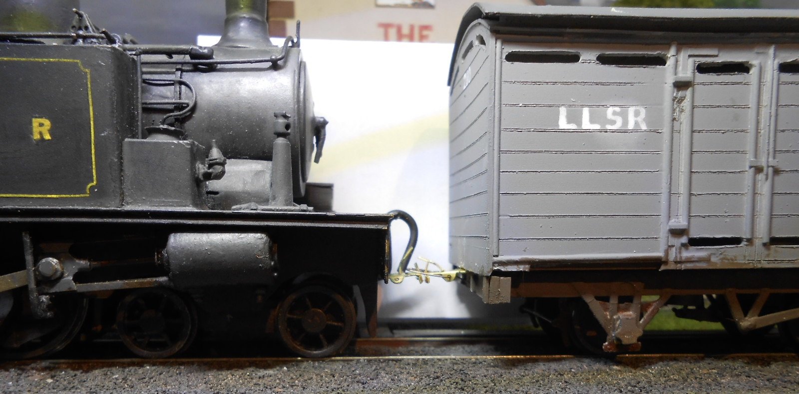

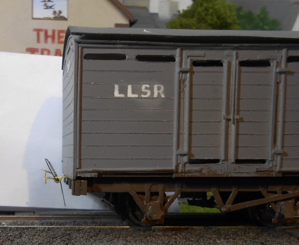

 Decided I didn't like the tension lock couplings I'd been adapting for Swillybegs, so ordered some DG etches from Wizard Models. They are the 0 gauge/7mm scale version and [unlike the tension lock adaptions] aren't handed, so should simplify shunting sequences.
 Have made up a few for testing purposes and, so far, so good, though am wondering if I've used the right gauge wire for the loops. The instructions don't say, other than to use phosphor bronze. What I have is 0.5mm - does anybody know if this is ok, please?

Interesting - thanks Angus. Just received some more etches from Wizard and they've come with 0.5mm wire, which is what I had in stock. Gradually getting used to what is, for me, the fiddly nature of the DGs, but having seen how well they work in smaller scales, decided I really ought to try.
 The good thing is that even if the 0.5 proves to thick, it will be easy to substitute something finer. As ever, hats off to everyone in 2 and 3mm scale!

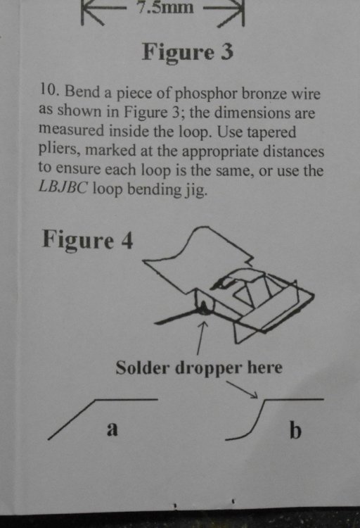

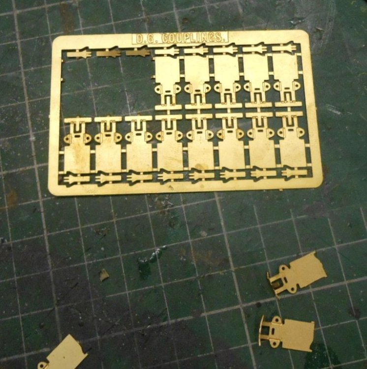

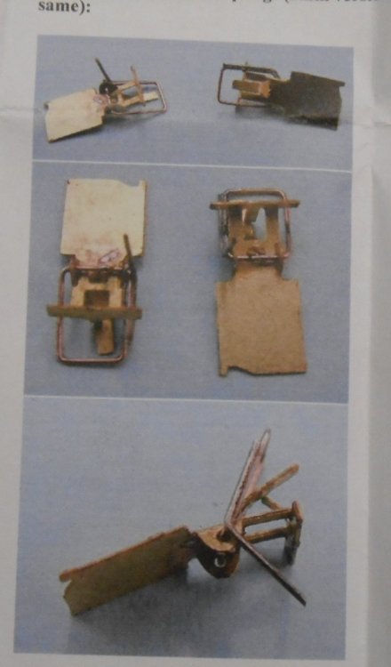

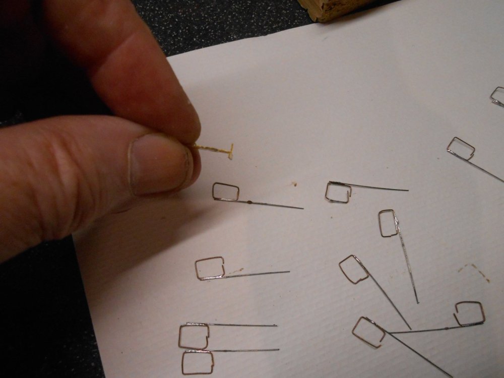

 A bit more on the DG couplings. This is just my experience, in 7mm scale at that and there are people far more qualified and experienced than me.
 Considering that, in 7mm scale, the whole coupling measures about 7mm wide by 12mm long, the 2mm scale ones must be tiny - though these are small enough for me. Also small is the price - an etched fret for 16 costs as little as three quid, though my versions are £6.30, so that's about 50p a pair...
 The etches are nicely done too, plus you get a coil of 0.5mm phosphor bronze wire for the loops too.
 As you can see, there are fold lines etched in, with two separate pieces for each coupling, plus the loop. Once the main etch is cut out [craft knife], the main cross piece is folded down [pliers], which means the middle bit now sticks up and then needs bending back about 20 degrees. This forms the coupling 'hook', while the bit just bent down is the buffing plate.
 Next job is to cut out the other, smaller, etch. This is tiny [and must be minute in 2 or 3mm scale]. It is perhaps the only issue with the DG coupling as can't help thinking a few spares could have been included on the etch to cover the ones that can ping off and get lost. Already been there and got that T-shirt...
 Anyway, this smaller etch is the 'delayed action' part of the coupling, enabling a vehicle to be uncoupled and pushed into place without reconnecting. It needs about a 45 degree bend and then is fitted into the slot in the main etch, with the two lugs tweaked outwards to hold it in place. After that, the two lugs with the round holes on the main etch are bent down as these are what the wire loop is fixed to. It all takes less time to do than read this.
 The only other thing to do is make the coupling loop. For another couple of quid, you can buy a brass block which works as a bending jig. You wrap the phosphor bronze wire around this up to 15 times to make 10mm x 7mm rectangles. Once separated, each one needs a short piece of steel wire soldering to it. This acts as the dropper wire, enabling hands free uncoupling using below track electro magnets.
 Again, slightly fiddly, but you soon get into a routine. These wire loops are then sprung into the lugs of the main etch, after which the whole assembly needs to be chemically blackened with something like gun blue. All that is left is to then fit the coupling, using contact adhesive.
 Considering the small size of these couplings, not only do they look ideal for 7mm narrow gauge, I think they would make a fine alternative to tension locks in 4mm scale, being both discreet and offering hands free uncoupling.

Nice work. I seriously considered the DG couplings for my own stock as I wanted handsfree uncoupling but I was reluctant because of the construction involved and ended up going with Kadees for all my stock.
 Been spending the last couple of days making up enough DGs for my narrow gauge stock and also adapting everything to enable fitting. DGs are designed to sit immediately below the bottom of wagon and coach sole bars. Unfortunately I'd previously cut notches in the latter for the tension locks, so these needed filling in. Perversely some of my loco and railcars have deeper buffer beams, requiring a different approach. However, nothing too drastic, though a bit of painting will certainly be needed.
 DG instructions suggest using either contact adhesive, solder, or screw/bolt to fit the couplings. Mostly, I've used the former, though brass locos have enabled solder fixing. The two pictures below show a CVR butter van, re-lettered to Swilly. In the first the coupling loop is in the normal, horizontal position, the second the loop has lifted because the electro magnet uncoupler has pulled down the iron wire tail.
 So far, this seems to work well. I use the former Dingham magnets, now sold by the Gauge 0 Guild, but a similar DG magnet is available from Wizard Models. On advice from Gordon Gravett, I power the magnets with 15v, rather than 12v, which gives a bit more oomph. This also means the iron tail can be kept fairly short, which helps the loop to drop back in place once the magnet is switched off. The latter is buried in the ballast by the way, with the top level with the top of the sleepers.
 It doesn't seem to matter if there are two loops together, which is good, because with turntables at both ends of my layout, I don't want couplings to be 'handed' as this would complicate shunting. Locomotives are a different matter, because in some cases, things like bogie or pony wheels get in the way of the iron wire 'tail'. At the moment, am leaving the coupling loop off the loco coupling, relying instead on the ones on the wagons and coaches. This seems to still work fine and if you can get away with your couplings being handed, might be the way to go for all stock. The next two pictures try to show this.
 Among things still to do are blackening all the couplings with gun blue [paint not a good idea] and tidying up all the buffer beams. Unlike AJs, it seems DG couplings are fairly forgiving in that the various bend angles don't need to be too precise - ideal for a bodger like me, though time will tell.
I have used DG's in 2mm and 4mm.
In 2mm, a loop on one end only worked best as two loops coming together at exactly the same height just resulted in the wagon being pushed away.
In 4mm I had no issues using loops at both ends, the extra mass of the wagons helping. I would imagine that your 7mm stock would be even better.
I did blacken the whole brass fret before assembling the couplings, just touching up any odd shiny bits with a black marker pen after assembly.
Rob

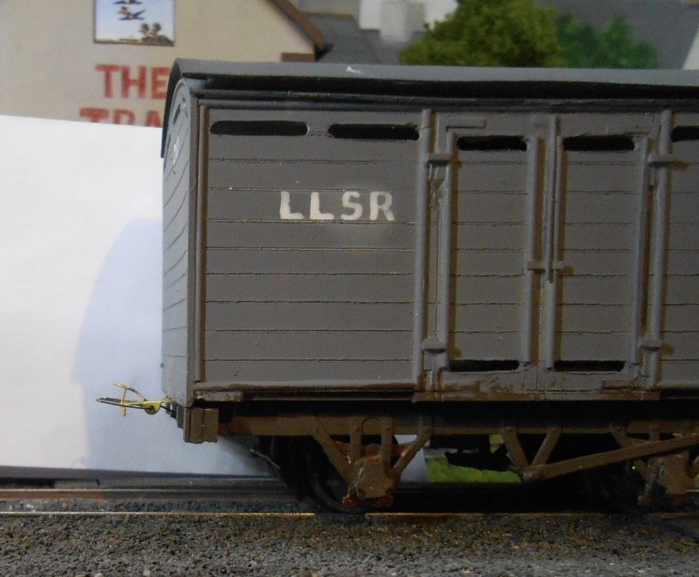

Hi David,
a post on RMweb has just reminded me of an issue with DGs.
If you have long stock and sharp curves body mounting the couplers can cause derailments.
The loop pushes on the coupler vertical of the wagon in front sideways pushing it off the track. With a 2mm scale diesel (about 4" long) if the couplers are body mounted it will push anything longer than a short wheelbase wagon off the track on and A5 point (although I think the curve exiting the point is slightly sharper)
I now bogie mount my couplers.
It might be worth checking all your stocks works through your point work before progressing any further.

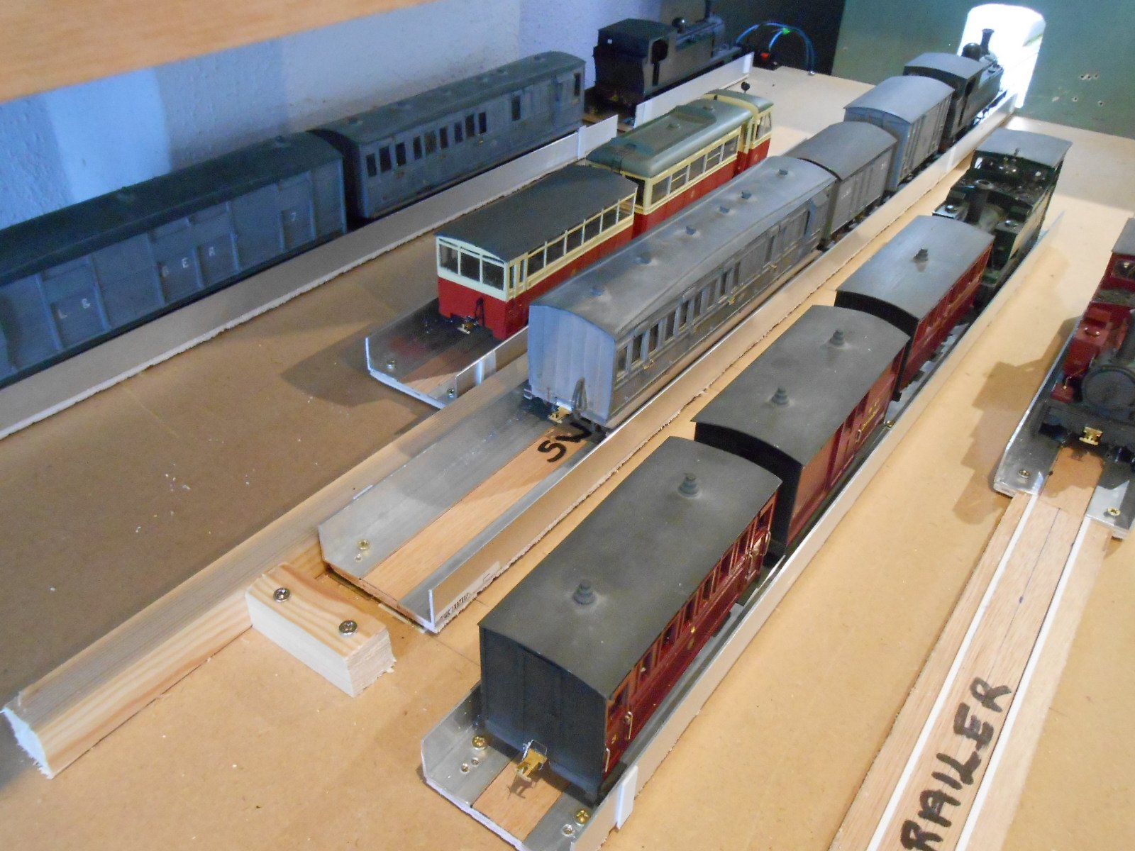

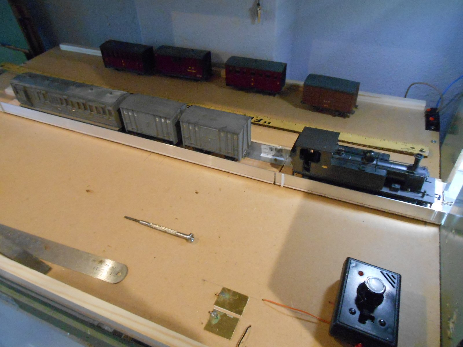

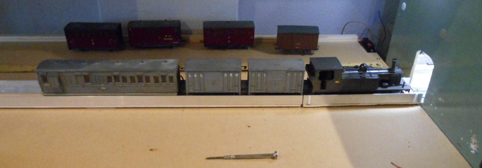

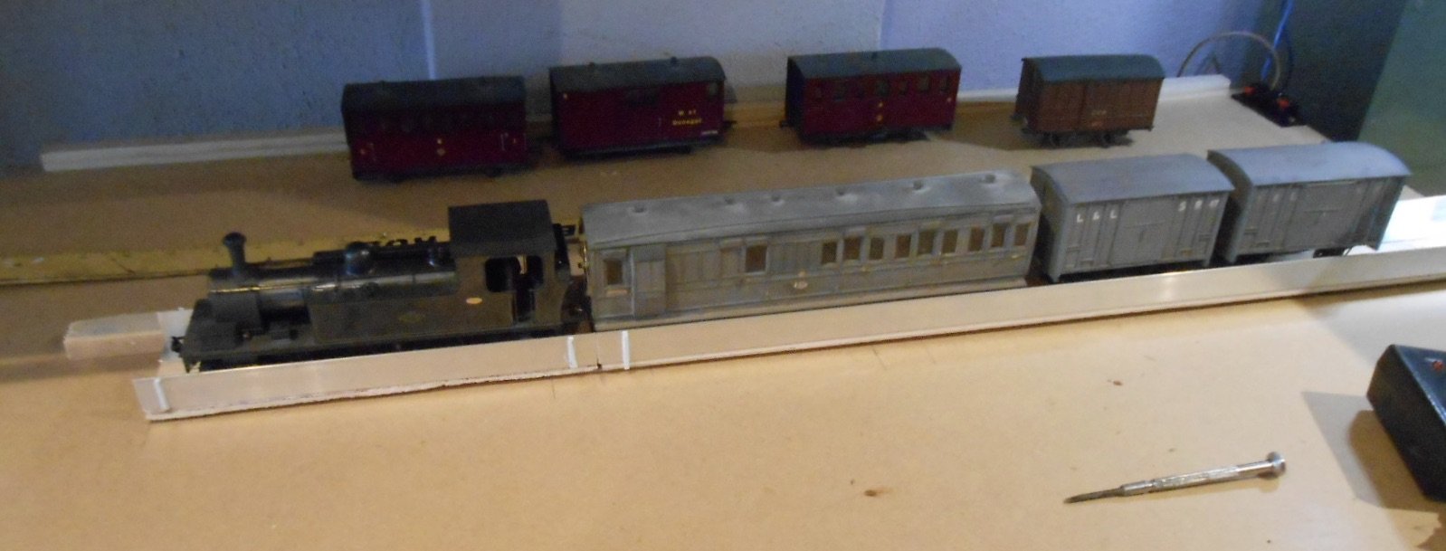

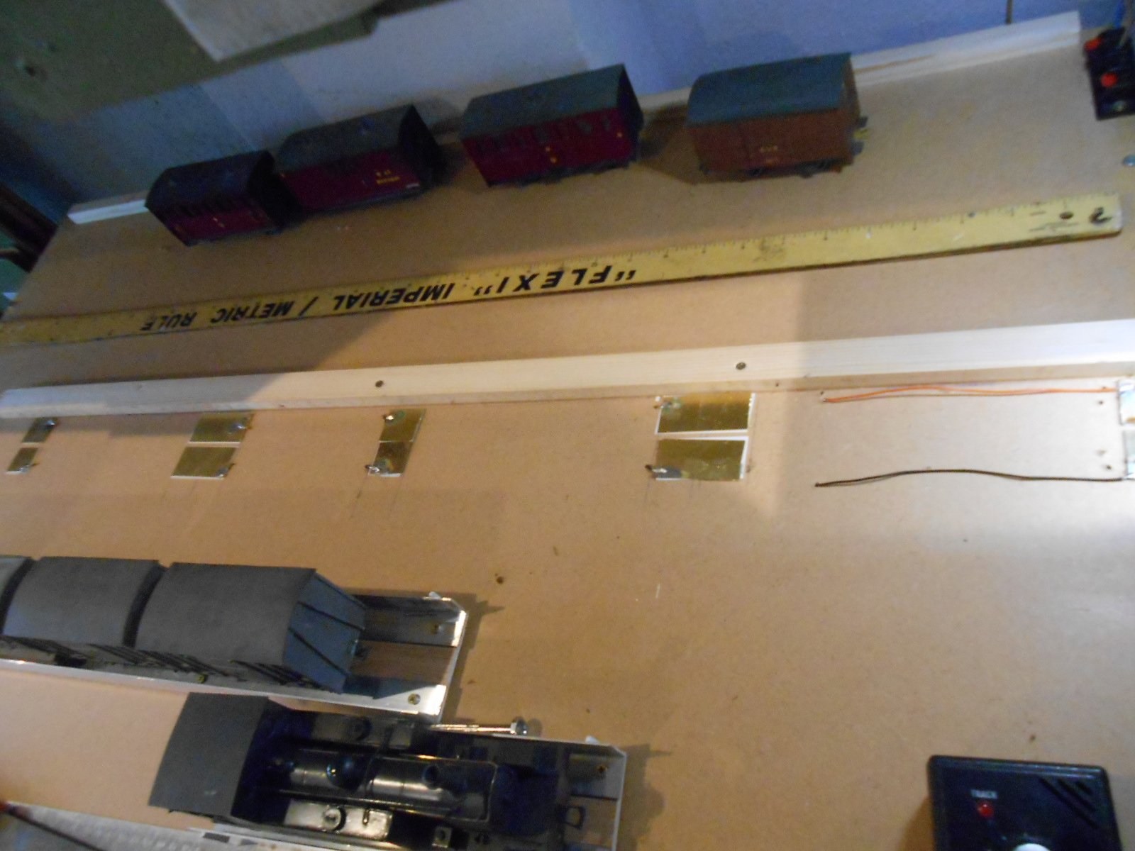

 I'd long had a feeling that my sliding/turntable fiddle yard for Northport Quay might not be completely compatible with Swillybegs and so it has proved. A slight discrepancy of height on the interface causes stock to uncouple - not good. Also, the short interface section between the train table and the layout means two joints in the space of 10cm AND on a gradient.
 So, what to do?

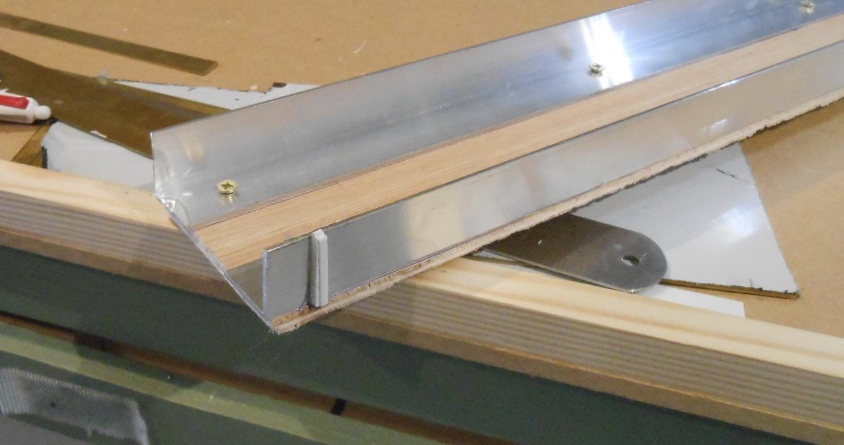

 After much thought, decided the best option was to remove the train table and fit a new top that could take cassettes instead. Cassettes are not a new idea, but my take on simple alignment and power may be of interest.

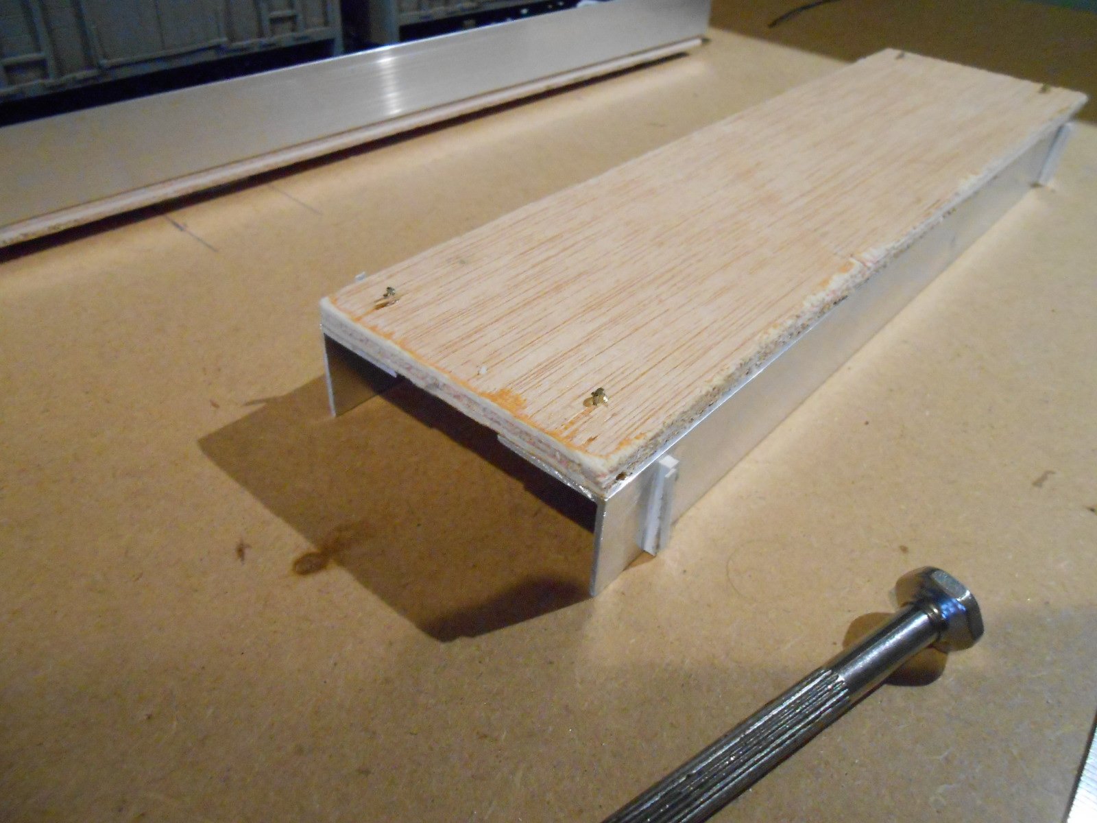

 The cassette table itself is just a piece of 6mm MDF, strengthened with a piece of softwood along each edge. Each cassette is a piece of 5.5mm plywood, with two 20mm L section aluminium angle pieces that act as the track. The angle is screwed to the plywood, though I also use double sided tape to position it initially. The clever [?] bit is that the screws project through the plywood, sticking out about 1.5mm the other side. Why? Because these screws carry the electric power, which comes via brass strip fitted at strategic points to the cassette table. Another piece of softwood is screwed to the cassette table and is used to align the cassette, as shown below.
 While two long pieces of brass strip could be used to span the full length of the cassette table, for economy, I use several smaller pieces, spaced to match the separate loco and train cassettes. This requires a bit of extra wiring, of course, but have found it works well in practice on a previous 0 gauge layout.

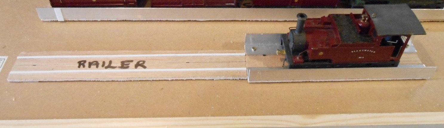

 Some cassettes [eg a railcar, or a short freight] are not difficult to pick up and turn round when the trains come back to the fiddle yard, so they are ready to be sent out again. Longer trains are better having separate loco and train cassettes, so just the loco has to be picked up, turned and moved to the other end.

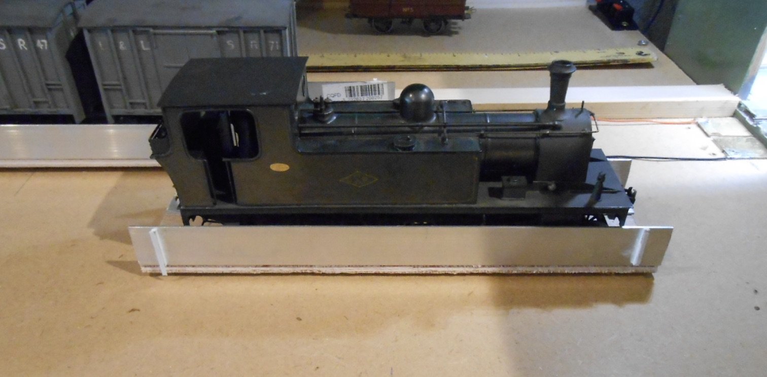

 So, loco cassettes are 9" long, train cassettes are 24" and railcar [+ trailer] 18", equating to how the brass strips are spaced out.
Vertical and horizontal alignment is fine tuned with pieces of plasticard. The brass strips sit on 20thou [0.5mm] plastic sheet, which ensures the aluminium angle matches the rail height on the layout. Horizontal alignment uses micro strip of various sections to ensure the cassettes line up with the rails. While am sure some of you out there would make a jig to ensure this, on the cassettes illustrated, all I've used are pieces of 2.5mm square plastic strip.
 There is no physical connection between a loco and train cassette - simply pushing them together and against the central strip of wood is all that is needed. Below is a sequence of photos that hopefully show how this happens. Youshould also be able to pick out the plastic strip used for fine tuning horizontal alignment, which may thicker or thinner on other cassettes, so they will need to be clearly labelled so the work properly as pairs.

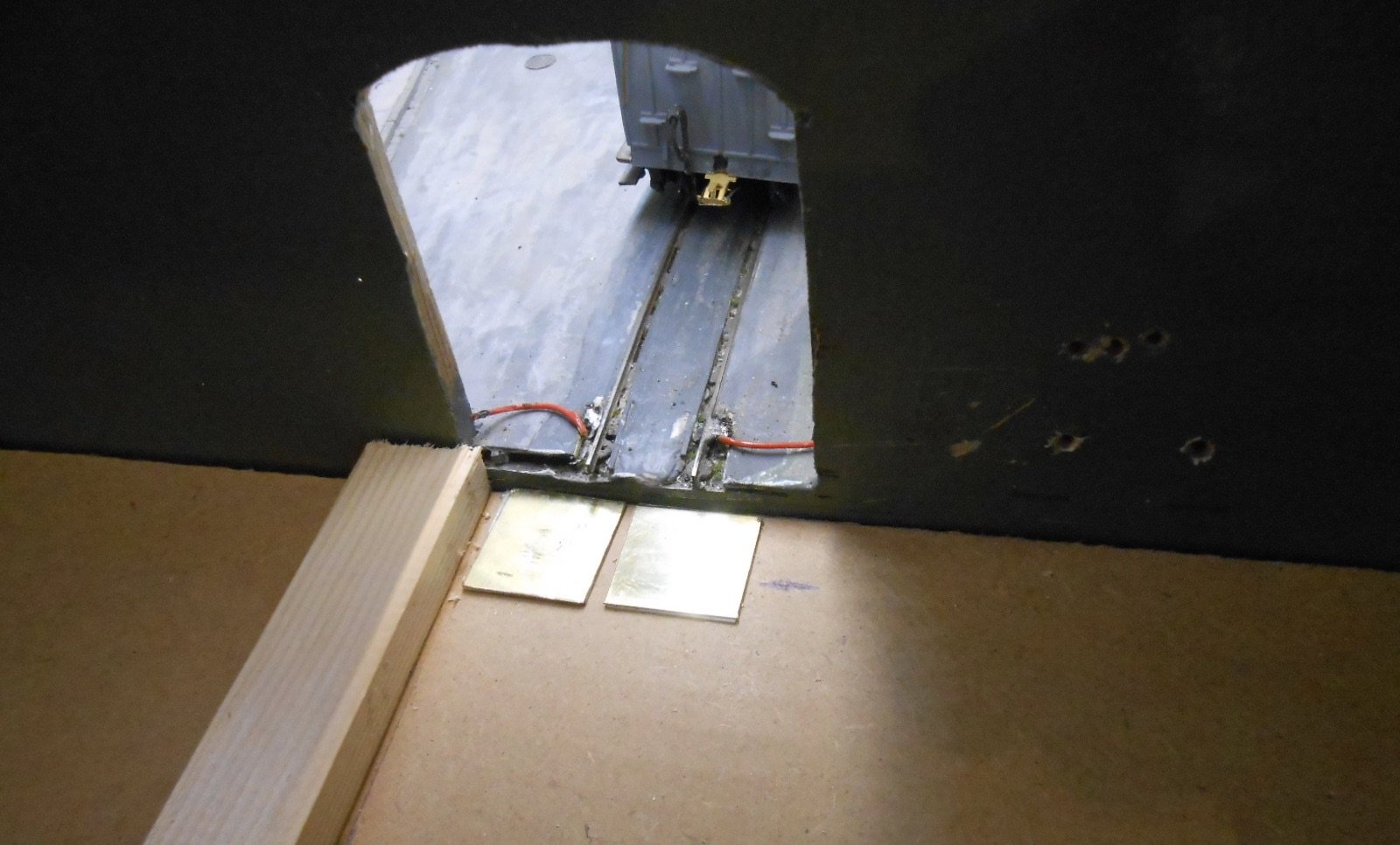

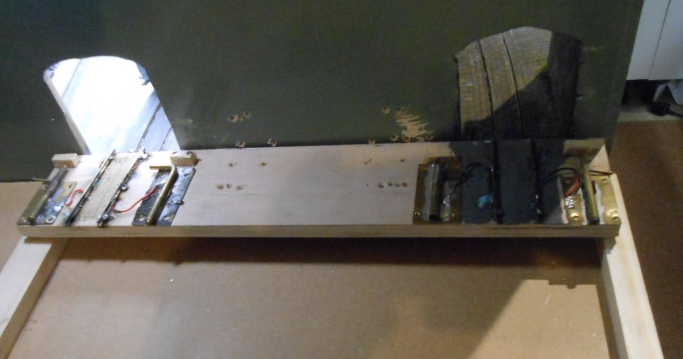

 A bit of wiring is shown below. Notice too how the cassette table is wider than the layout. This is deliberate, so there is enough room on the table to move the trains around.
 Having seen a variety of complex ways for aligning and powering cassettes over the years, I wrote my version up and entered it in a competition for original ideas in Model Railway Journal and was pleasantly surprised to be awarded second prize and a Wild Swan Books voucher. This was at least ten years ago, so if anyone thinks they thought of the same thing before me, sorry, but the voucher has long since been spent!

You have used the aluminum angle for the running rails that I/we used on Bantry. If making cassettes again I think I would lay track on the cassette. Lining up always seemed a problem so a cause of derailments! Maybe the greater mass of 7mm makes the system work better or maybe it was something else.  🤣
The trick is in the fine tuning, Mick. The plasticard strip on the aluminium angle vertical is just pushed against that strip of wood. If the cassette doesn't line up exactly and anything derails going to/from the layout, I add a bit more plasticard. Ten thou is just 0.25mm, so a bit of trial and error soon gets it sorted.
I found screwing aluminium angle to chipboard (in my case) that one material wants to expand and  contract and the other doesn’t, so you end up with concave or convex banana sort of pieces, although with yours being fairly short it shouldn’t be too bad.

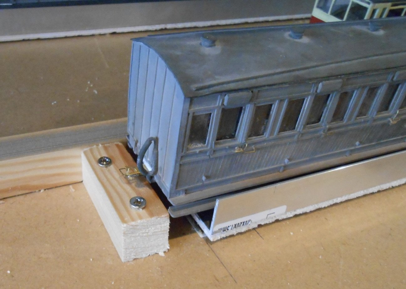

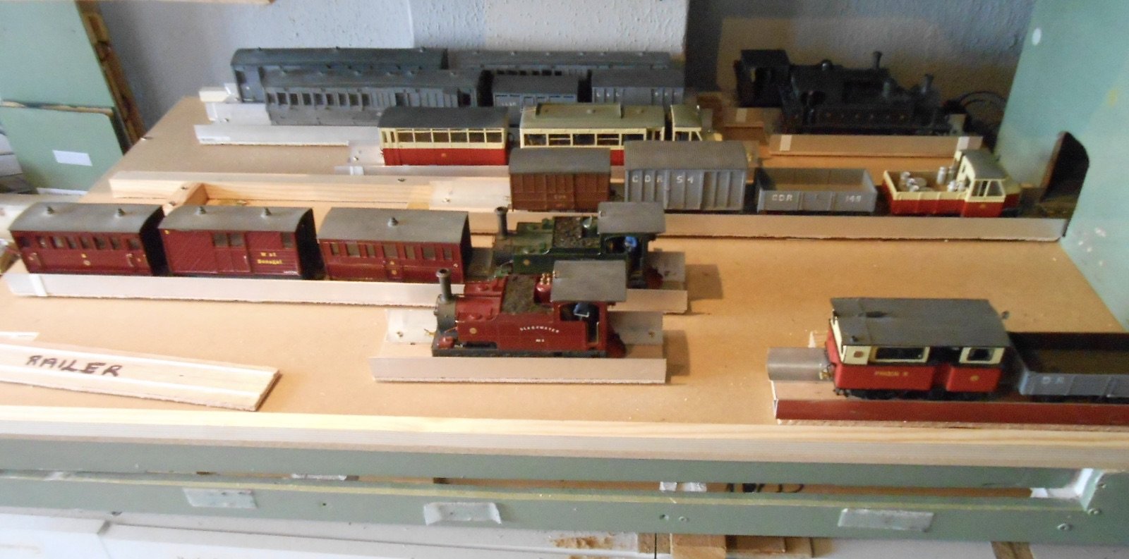

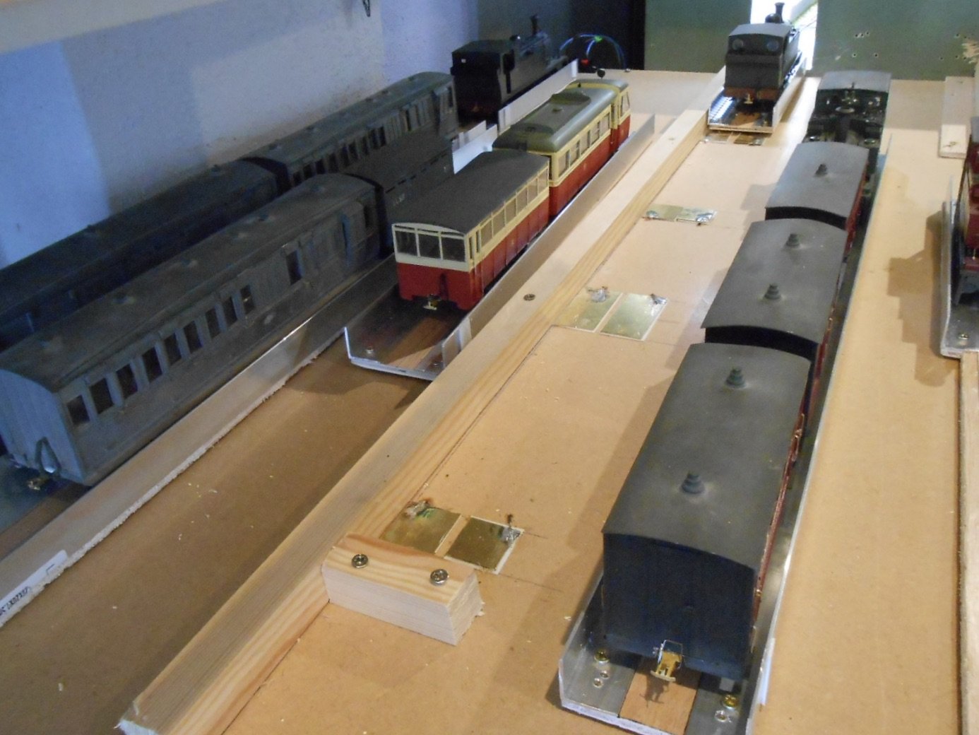

 Much time has been spent this week fine tuning the cassettes and fiddle yard table. Above you can see the five trains, spare engine, plus Phoenix and its wagon cassette. I was expecting a bit of work because experience with Fintonagh taught me that if the back to backs are more than 0.2mm out, then derailments are possible on the points and so it proved.
 Horizontal alignment is achieved by glueing plasticard strip to the vertical wall of each cassette. Mostly this has been 40 thou/one millimetre thickness, but occasionally, only 20 thou has been needed and in one case 60 thou [20+40].
 Vertical alignment is really just careful filing of the fixing screws. Occasionally, I found I'd taken too much off and a fresh screw was needed. Also managed to fix one or two screws too far inboard, meaning bogies, axle boxes etc could clout them. Needless to say, this brought out more than a bit of creative bad language, but only myself to blame.

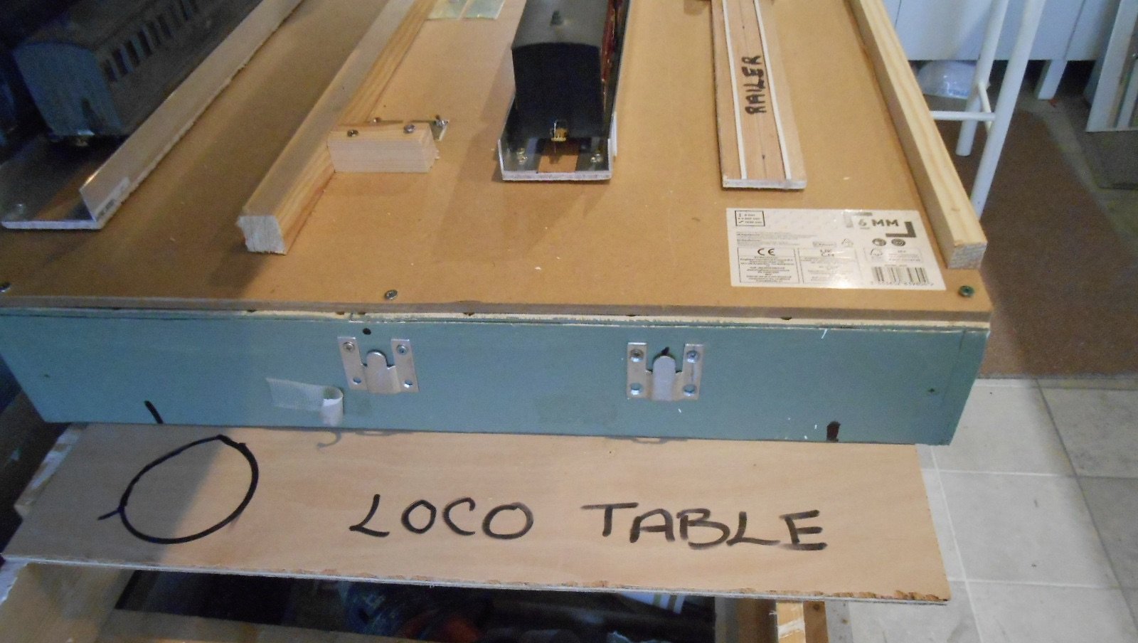

 Quickly realised that a different cassette was going to be needed - one without any sides to make railing stock easier. Narrow gauge vehicles are hard enough at the best of times, with their wide overhangs, but the cassette sides make putting on anything other than a four wheel vehicle pretty much impossible. My simple solution was to stick 60 x 100 plastic strip to a piece of plywood that has flat aluminium strip glued underneath. White plastic works well with dark wheels too.
 Though there is plenty of room on the cassette table, have found a piece of plywood pushed under the outer end of the table gives space to put a loco cassette while it is being turned. Doubles up as space for a coffee mug and nicely levels the cassette table too.
 An important safety item is this small block of wood, just beyond the end of where the main cassette goes - just in case a train should over run. The height is just right for the DG couplings to clear it.
 A couple of other pictures show how the train cassettes might be shuffled around. Otherwise, so far so good. Now need to work on rehearsing operation on the layout itself, while all the new couplings need to be checked and then chemically blackened.

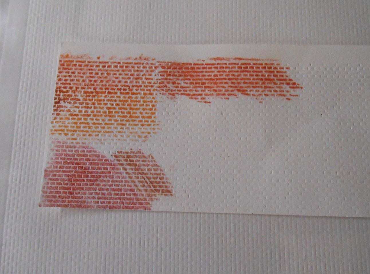

 Have some buildings to do for my 0 gauge project and found myself drawn to the old Howard Scenics embossed brick paper. Still had some left over from at least 15 years ago, but was surprised to find Squires still do it and ordered some more, only to find I had two packs tucked away in a folder already. So now I have four.
 Nevertheless, 'tis good stuff and is easily stuck to card or foam board with PVA. Colouring is simple: a wash of mortar colour [I use acrylics] and then when dry, water colour pencils are used to shade over the embossing - a bit like brass rubbing. Another nice thing is that the sheets are available in English bond too.
