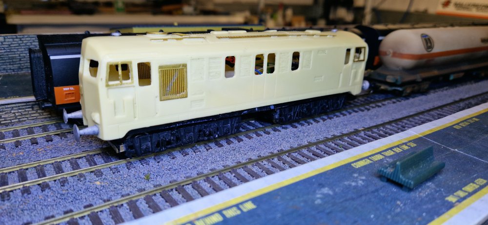

enniscorthyman Posted April 13, 2013 Author Posted April 13, 2013 I have stuck in a bass enhanced 4 ohm speaker to 073. It gives a nice bit of extra bass to the loco and is handy enough to pop in. After taking off the bonnet section,the original speaker needs to be taken out,and a bit of heat from the iron lets the wires pop out handy enough. The main problem sticking in the bass enhanced speaker is the fan plate will have to be removed and either glue the fans on or I put a bit of brass wire accross them as I have done,maybe there is a better way?. [/url The Bass reflex speaker can be fitted too,but needs a lot more work so this photo shows the difference in size.The speaker will protrude into the cab,so you have to think if you want this in order to have more bang for your buck.

enniscorthyman Posted April 13, 2013 Author Posted April 13, 2013 Great work mate can't wait to see the video Cheers Ant,tell me any suggestions on mounting the fan blades?. The way I done it does work,but there could be a better way.
Flying Scotsman 4472 Posted April 13, 2013 Posted April 13, 2013 Actually what you have done looks spot on. You don't really want to try gluing them to the grills as if you you get to much glue on the grill it will ruin the look of it. As I said it looks great as well as the new layout
