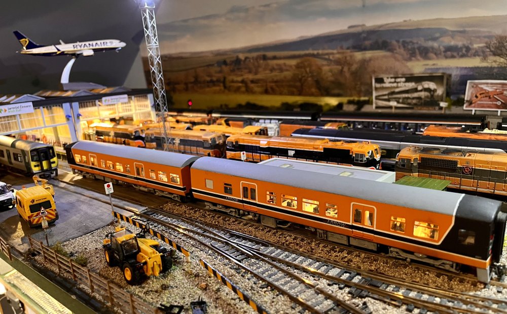

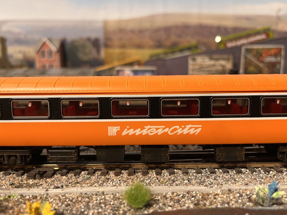

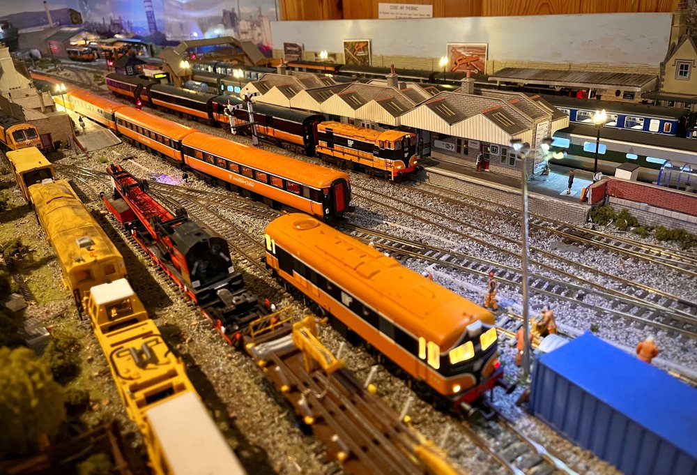

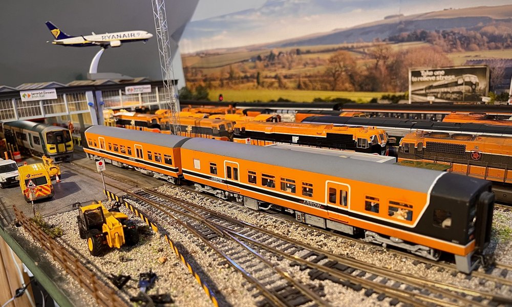

ttc0169 Posted March 8, 2024 Author Posted March 8, 2024 I have been working on improving the recently released Murphy models Mk2D set, Firstly I removed the roof,added passengers, then interior lights and lastly replaced the tension lock couplings with the Westhill wagon works buckeye magnetic couplings. Delighted with the results 11 Quote
Georgeconna Posted March 8, 2024 Posted March 8, 2024 closer couplings are the Job Noel. lights too. and Bleed through the sides? 1 Quote
ttc0169 Posted March 8, 2024 Author Posted March 8, 2024 6 hours ago, Georgeconna said: closer couplings are the Job Noel. lights too. and Bleed through the sides? Thanks George…yes there was a small amount along the sides but easily solved with black paint-the roof was most noticeable but again sorted with black paint, West hill wagon works buckeye couplings need to be glued to the underside of the NEM pockets-it will cause the coaches to derail otherwise if inserted into the NEM 2 Quote
Gabhal Luimnigh Posted March 8, 2024 Posted March 8, 2024 Where did you get those couplings Noel? 1 Quote
DJ Dangerous Posted March 9, 2024 Posted March 9, 2024 On 23/2/2024 at 9:11 AM, ttc0169 said: Found another MIR two axle wagon kit and finished it off as an ex works barrier wagon for the rear of the oil train,complete with red tail lamps,coupling and vacuum brake pipe. A short oil wagon transfer trial is seen in Lakeview freight yard behind 018. Is that a Tayto van stripped naked? 1 Quote
ttc0169 Posted March 9, 2024 Author Posted March 9, 2024 10 hours ago, Gabhal Luimnigh said: Where did you get those couplings Noel? https://westhillwagonworks.com/ 8 hours ago, DJ Dangerous said: Is that a Tayto van stripped naked? Yes-donated and altered by a good friend-a similar van was used in the 1980s for moving mail bags from Claremorris to Ballina and visa versa off the night mail train to Westport 1 1 Quote
Keano30 Posted March 9, 2024 Posted March 9, 2024 9 hours ago, ttc0169 said: https://westhillwagonworks.com/ Yes-donated and altered by a good friend-a similar van was used in the 1980s for moving mail bags from Claremorris to Ballina and visa versa off the night mail train to Westport Which couplings in particular did you use Noel? 1 Quote
DJ Dangerous Posted March 9, 2024 Posted March 9, 2024 10 minutes ago, Keano30 said: Which couplings in particular did you use Noel? At a guess, either the Hornby Mk2D or Airfix Mk2 ones? 1 Quote
ttc0169 Posted March 15, 2024 Author Posted March 15, 2024 On 9/3/2024 at 7:35 PM, Keano30 said: Which couplings in particular did you use Noel? Apoligies Keano30 for the late reply, These are the couplings used for the Mk2ds-they need to be glued under the NEM coupling,they won’t work when inserted into the pocket as it restricts their movement. 1 1 1 Quote

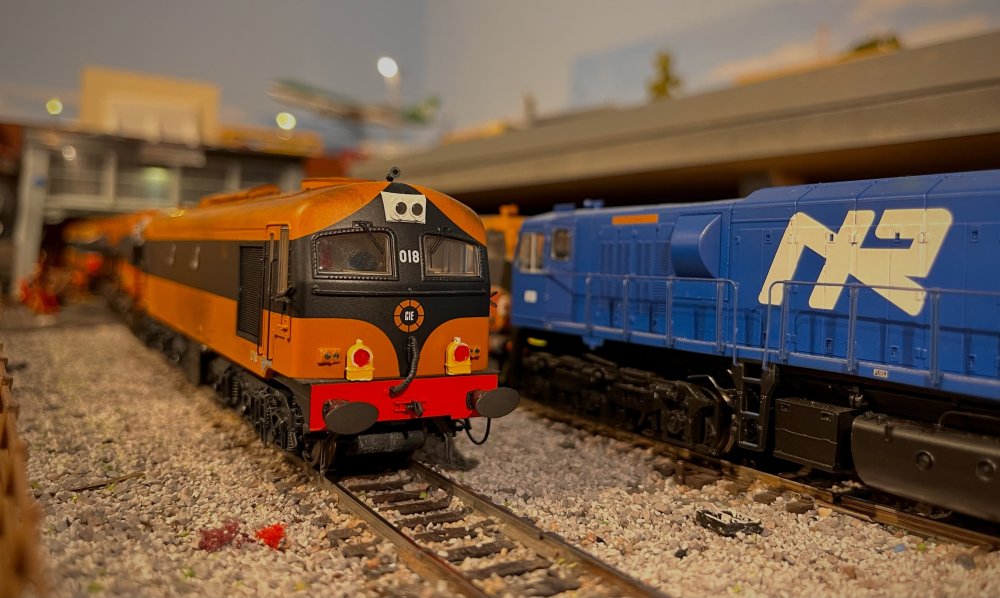

ttc0169 Posted March 17, 2024 Author Posted March 17, 2024 Thanks to Enda Byrne for supplying the 1990s style French tail lamps-seen here in position on locomotive 018 7 1 Quote

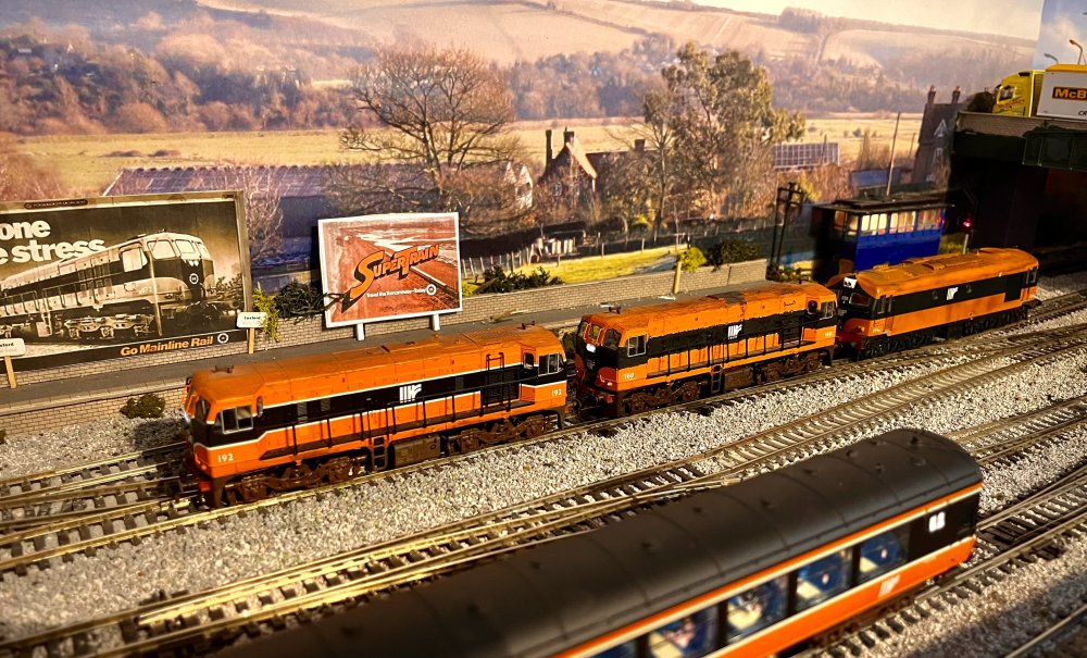

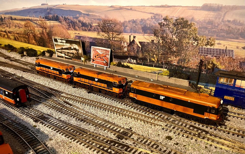

ttc0169 Posted March 22, 2024 Author Posted March 22, 2024 Having been inspired by one of Tony Cooke’s photos on the IRRS slide show last night-I recreated the scene earlier on Tara junction….the photo showed a triple header of locomotives consisting of 2x141 coupled to an 001 heading to Northwall from Inchicore to form the evening departures to Westport (2x141s) and the Sligo (001) liner trains 11 1 1 Quote

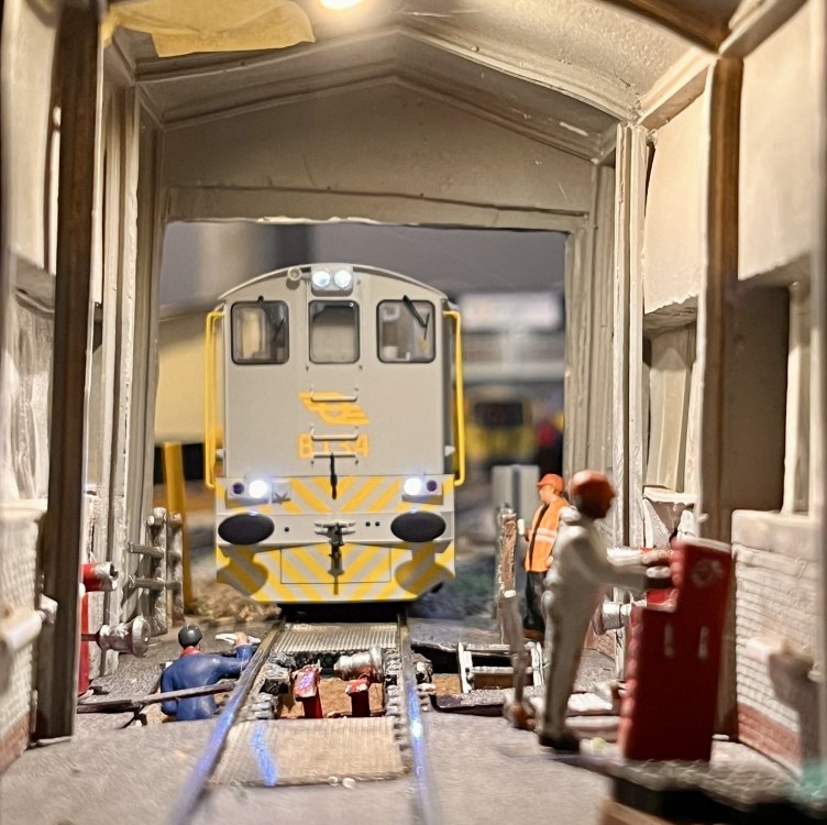

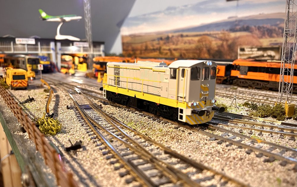

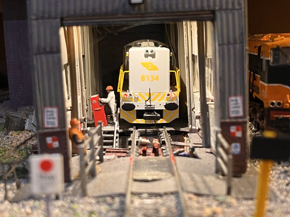

ttc0169 Posted March 29, 2024 Author Posted March 29, 2024 The RPSI locomotive B134 is seen here in on the wheel lathe on Tara junction. 11 2 Quote
TimO Posted March 30, 2024 Posted March 30, 2024 Is it possible to remove the seats and upholster them? If so, what pattern should they be? I think they reflect a lot of ‘orange’ light that doesn’t look quite correct. I am also thinking of blackening or papering the ceiling and walls. Your peeps look the part. Quote
ttc0169 Posted March 31, 2024 Author Posted March 31, 2024 16 hours ago, TimO said: Is it possible to remove the seats and upholster them? If so, what pattern should they be? I think they reflect a lot of ‘orange’ light that doesn’t look quite correct. I am also thinking of blackening or papering the ceiling and walls. Your peeps look the part. No Timo-originally green as far as I can remember-best option is to paint the interior sides and roof for best results. 1 1 Quote

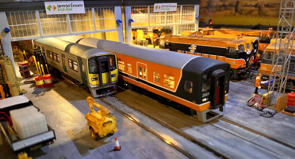

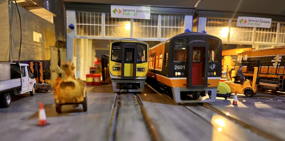

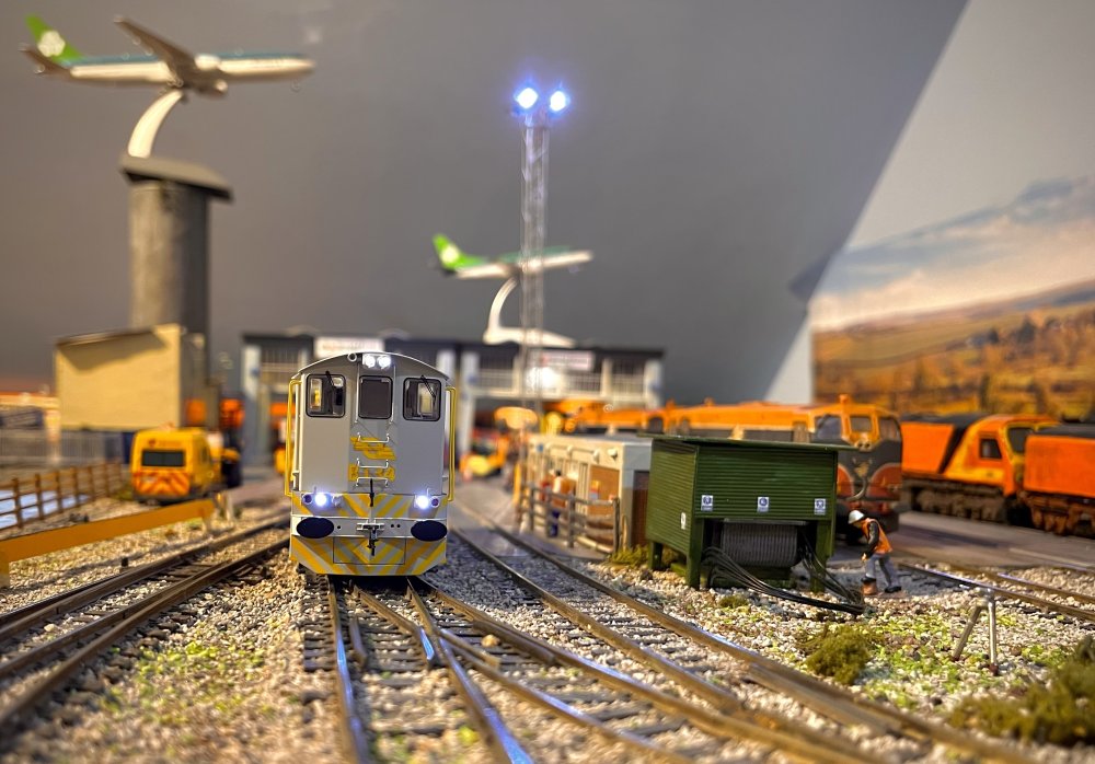

ttc0169 Posted April 6, 2024 Author Posted April 6, 2024 Arrow railcars 2601+2602 & 2607+2608 are seen here at the Tara junction MPD undergoing servicing. 7 2 Quote

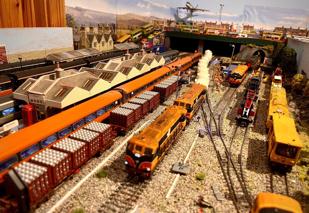

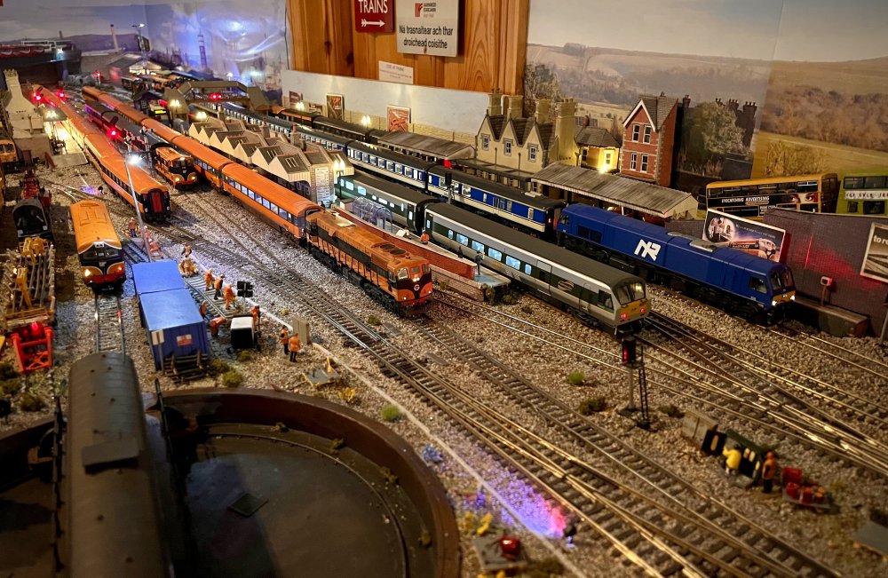

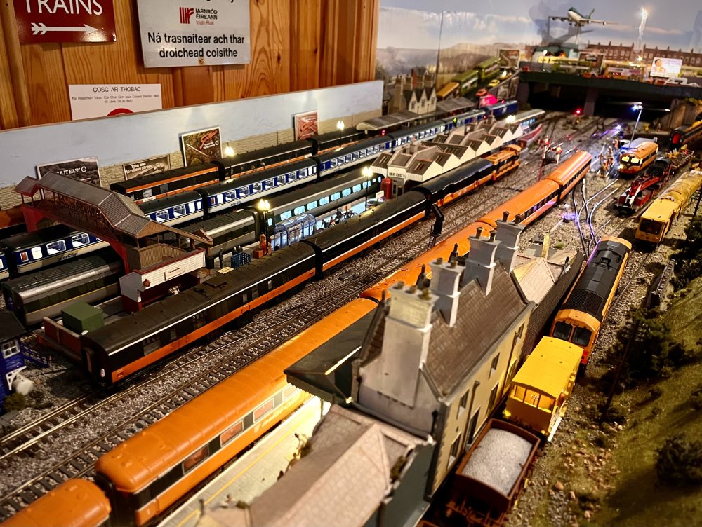

ttc0169 Posted April 12, 2024 Author Posted April 12, 2024 Friday night for @DJ Dangerous 121 class locomotive 133 serves the platform with the night mail to Dublin,when loading was completed the train was propelled out of the platform and routed to the down main to allow the Tralee-Dublin Heuston Mk3 set hauled by 087 overtake-Enterprise sets are stabled on platforms 1 and 2. The permanent way crew on locomotive 049 take a break prior to working a rail train out of the yard. 7 1 Quote

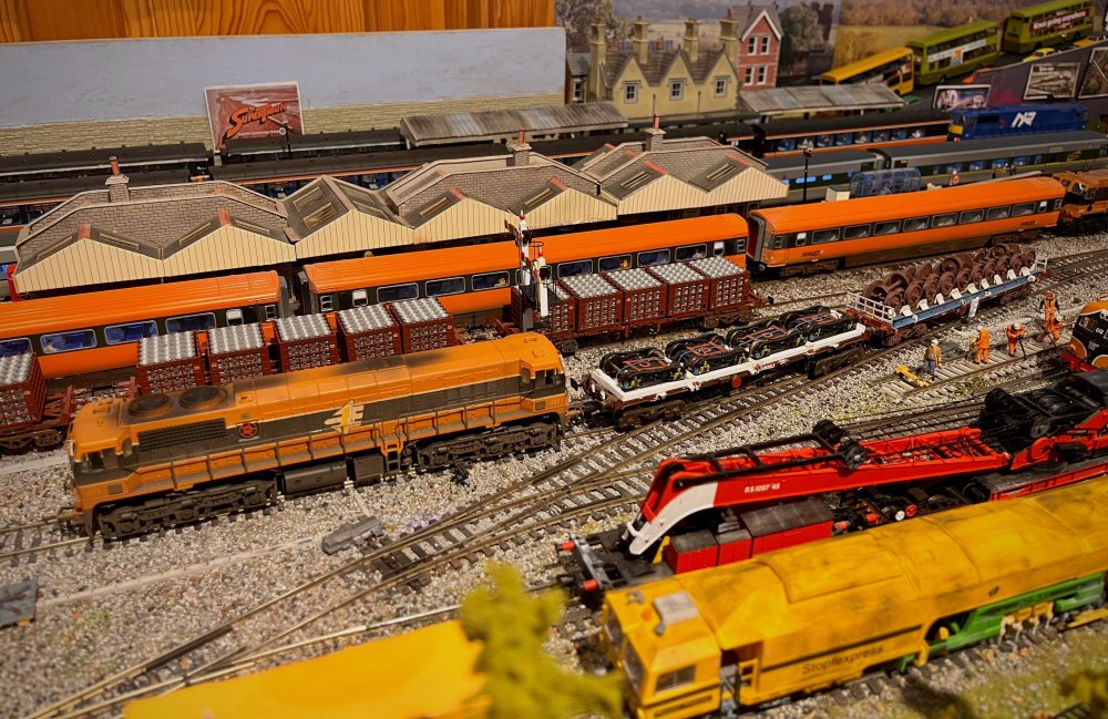

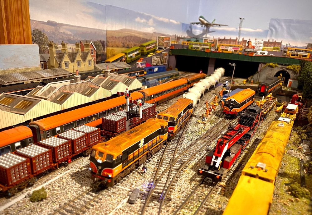

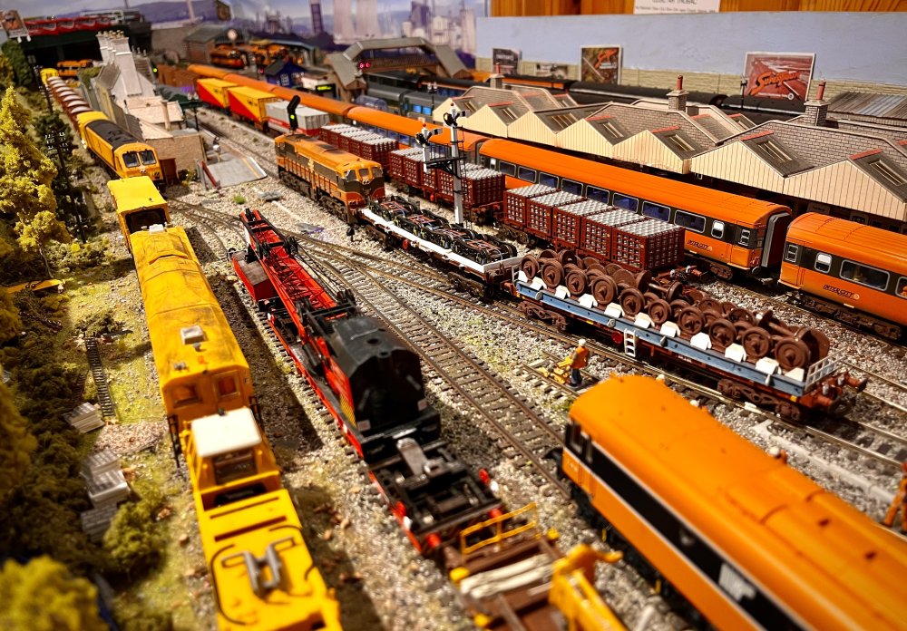

ttc0169 Posted April 19, 2024 Author Posted April 19, 2024 1 minute ago, DJ Dangerous said: Tick tick….bang…..085 works the bogie and wheel carrier wagons towards the MPD on Tara junction…..thank you 8 Quote

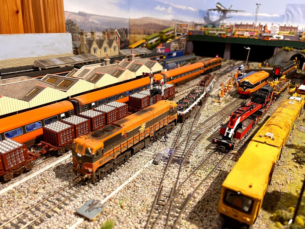

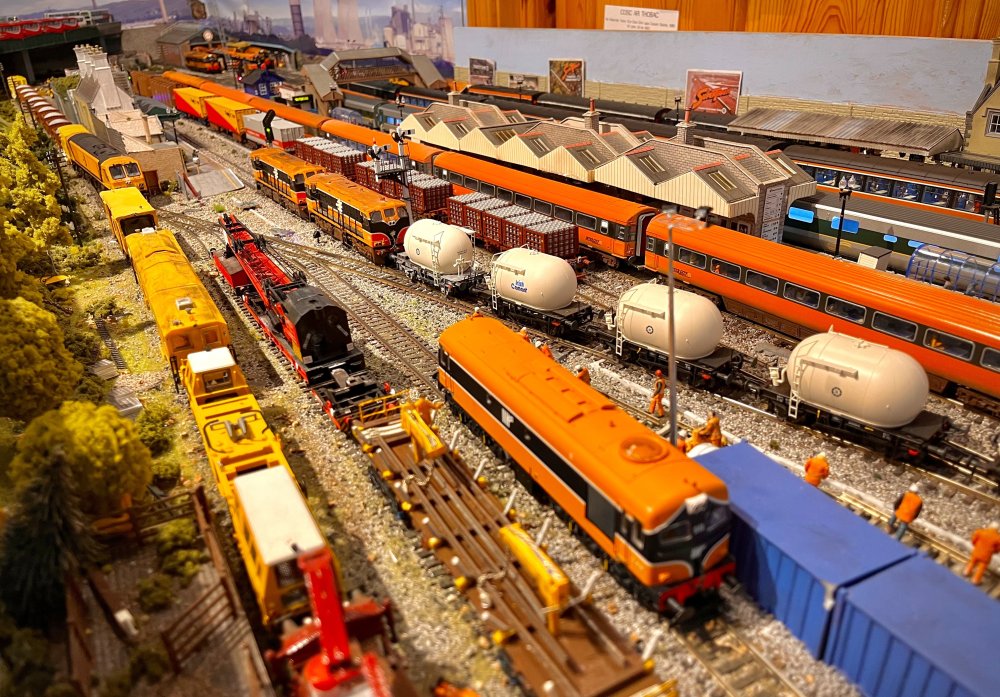

ttc0169 Posted April 21, 2024 Author Posted April 21, 2024 190+184 arrive on the loop platform with a Platin-Tullamore two axle bulk cement working. 12 Quote
ttc0169 Posted April 25, 2024 Author Posted April 25, 2024 As can be seen above with the real railcar……the miniature 2600 has also received the grey bogies and under frame on Tara junction in a day and night time scene. 6 3 Quote
