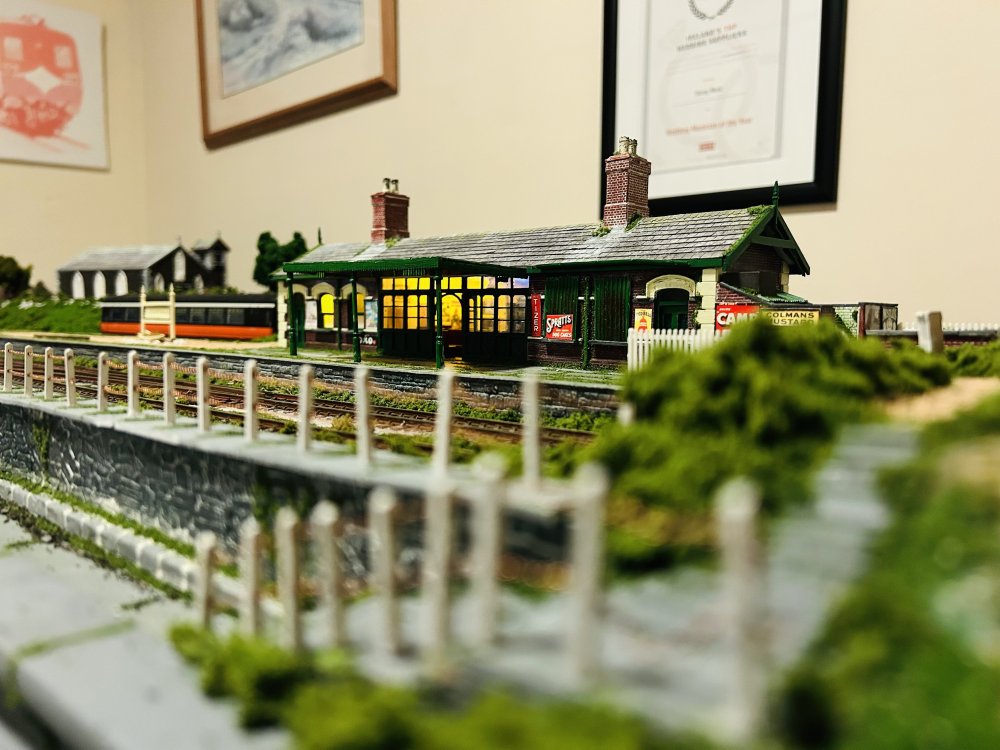

Patrick Davey Posted January 31, 2024 Posted January 31, 2024 Here’s my contribution to this very useful thread! Due to impatience, my current project progressed beyond the stage where it was still straightforward to add lighting to the buildings, so I started thinking of alternatives. I was looking for miniature lights which could be placed individually in rooms and I found a set of 10 tiny key rings on Amazon, for only £7.00: So I took off the metal key ring parts and using double sided tape, I fixed the torch parts to the underside of the roofs of my buildings: Yes, it’s not as straightforward (or as professional) as flicking a switch to turn all the lights on and off, but it’s considerably cheaper and does not involve complex wiring! In fact, it doesn’t involve any wiring 6 2 Quote
skinner75 Posted January 31, 2024 Posted January 31, 2024 (edited) Brilliant idea! Nice bit of 'thinking outside the box' that. You could always give them a light wash with a yellow, to tone down the ice white light to a more old-time yellowish glow Edited January 31, 2024 by skinner75 1 1 Quote
Patrick Davey Posted January 31, 2024 Posted January 31, 2024 3 minutes ago, skinner75 said: Brilliant idea! Nice bit of 'thinking outside the box' that. You could always give them a light wash with a yellow, to tone down the ice white light to a more old-time yellowish glow I was thinking it gives me an excuse to buy a box of Quality Street then I will have lots of shades to choose from!!! 1 3 Quote

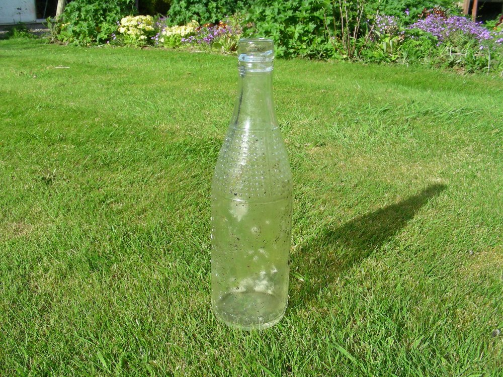

skinner75 Posted January 31, 2024 Posted January 31, 2024 3 minutes ago, Patrick Davey said: I was thinking it gives me an excuse to buy a box of Quality Street then I will have lots of shades to choose from!!! Or back in the day, a bottle (glass) of Lucozade, with the orange plastic wrapper, that you could take off & look through for an orange-tinted view of the world! 2 2 Quote
Broithe Posted January 31, 2024 Posted January 31, 2024 18 minutes ago, skinner75 said: Or back in the day, a bottle (glass) of Lucozade, with the orange plastic wrapper, that you could take off & look through for an orange-tinted view of the world! I found this sticking out of a spoil heap after some work at the Quakers' Bridge level crossing on the Nenagh branch a couple of years ago. 5 Quote

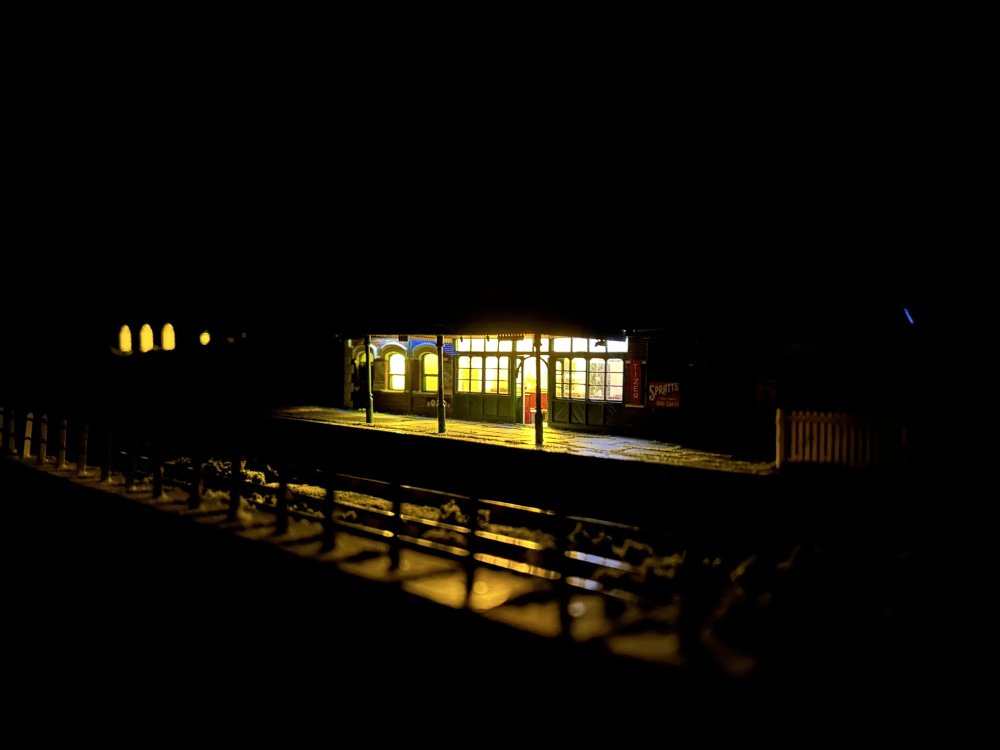

Patrick Davey Posted February 7, 2024 Posted February 7, 2024 3 minutes ago, derek said: Sorry Patrick, all Quality Street are wrapped in paper now Yeah saw that but am hoping the thicker paper will help tone down the brightness (a cheap resistor!) as well as give the orange 'sodium' glare....... will be checking this later 1 Quote
Patrick Davey Posted February 7, 2024 Posted February 7, 2024 So it turns out that the new style of paper on the Quality Street sweets works a treat for what I was trying to achieve! As I had hoped, it helps to dull down the brightness of these lights, and also adds the distinctive sodium glare: 4 1 Quote
Broithe Posted February 7, 2024 Posted February 7, 2024 8 minutes ago, Patrick Davey said: So it turns out that the new style of paper on the Quality Street sweets works a treat for what I was trying to achieve! As I had hoped, it helps to dull down the brightness of these lights, and also adds the distinctive sodium glare: Sweet! 1 4 Quote
