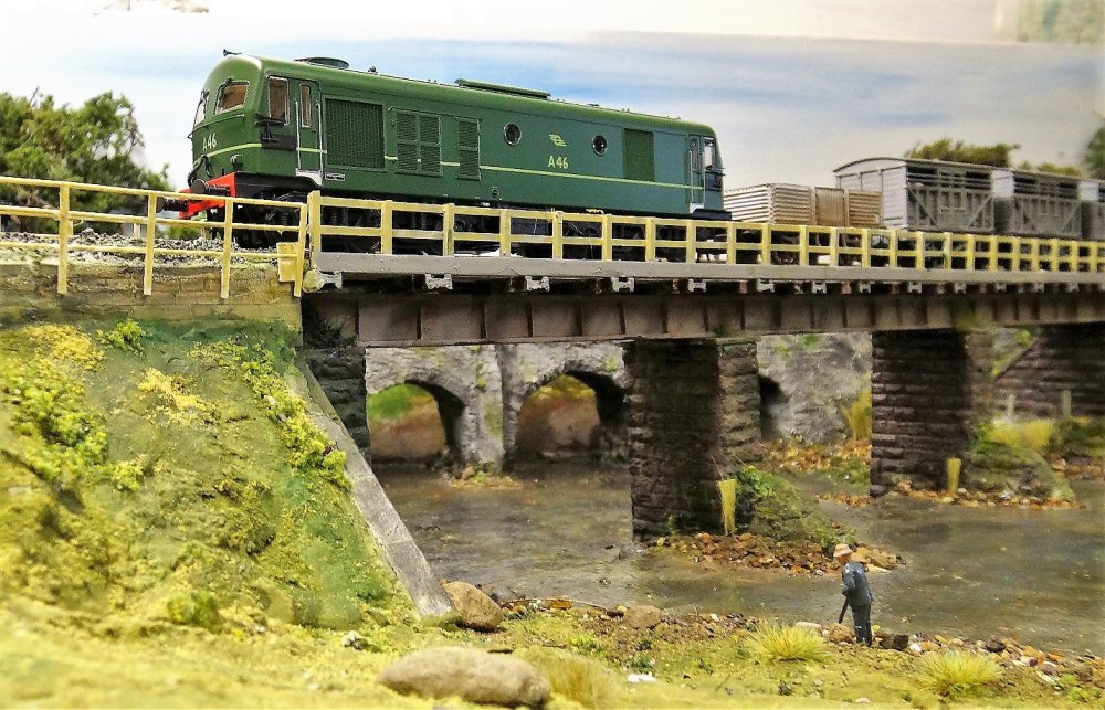

Very nice, Ernie. Love that layout, attention to detail is excellent, rocks, man working, blending foreground to background as mentioned previously. Top stuff! Cement bubbles look well behind the A. You deserve some play time away from the Archive (but we do enjoy it!)

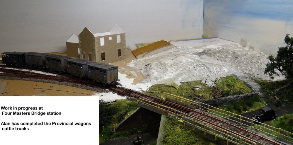

Progress, of a sort.
The third van is lagging a touch behind the others as its sides had warped somewhat. A soaking in hot water then spending overnight clamped in a vice between bits of plywood appears to have sorted it.
Edited by Brack
  • Like 7
Done a bit more after the kids went to bed. Details on and given a spray.
I used the last of my can of Halfords CIE gray, down to fumes, but just about got there.
Tomorrow I might get the decals and weathering on.
We should really have come to see you at the end of the week Dad, rather than on tuesday! Still, your birthday/christmas present is sorted!
Although I still need to make some sort of trolley for you little works line.
  • Like 8

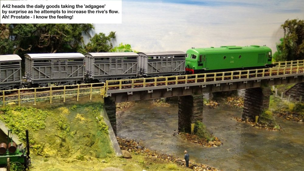

Going to have a couple of days living in the railway room 10th November as I have to isolate after my  Covid Swab until an Operation 2 days later so need to check I have enough modelling supplies. Had a notification that A3r is on its way but still nothing regarding my green A42. At least it looks like I will have a cattle special to run.

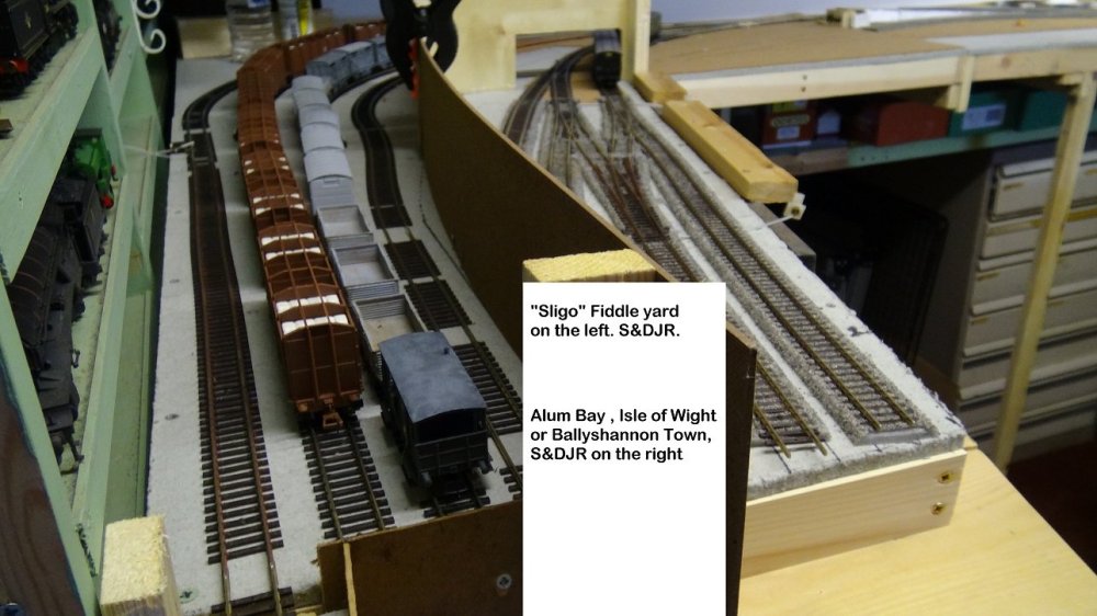

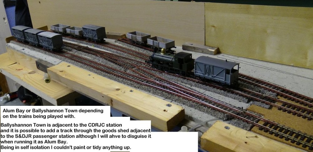

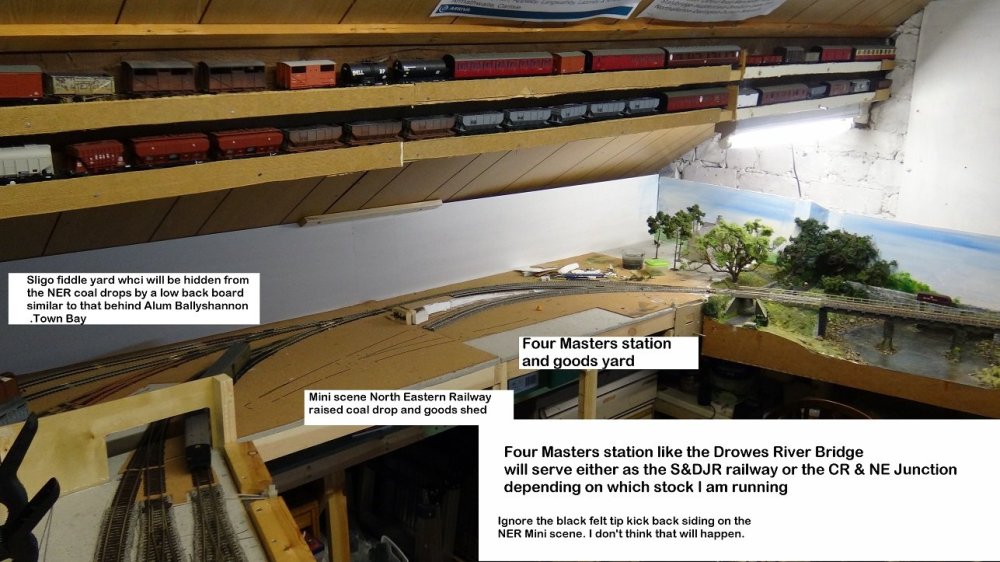

Four Masters fiddle yard is now operational and the remaining track for the goods yard plus Alum Bay station (which will function as loco holding sidings in Irish running mode) plus a link to a planned North Eastern Railway coal drop cameo should also be laid.

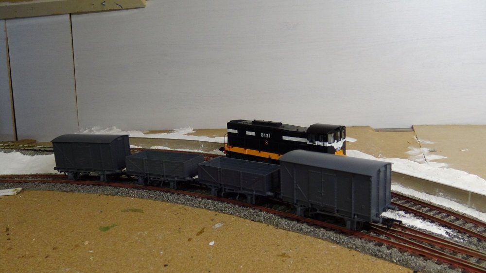

Bit of a pain today with the cattle wagons - the snails curled up and wouldn't stick, despite attempting to persuade them with carrs transfix and others. I haven't had any trouble shoving transfers straight onto halfords grey before, but these definitely aren't cooperating.
Plan B involves a coating of klear on the area first, and I've ordered some microsol/microset as I've heard others swear by it. So there might be a brief hiatus until they turn up.
It was all going a bit too smoothly!
As an aside, the cattle wagons are a vastly easier build than the corrugated wagons - there is a lot of drilling, but a pillar drill makes light work of it. I only broke 1 drill this time too.
  • Like 7

I'm back in the land of the living. Here are the results of my days in self isolation. I also did a few running sessions which confirms that as usual my track laying is up to its usual crap standard so I have endeavoured to ensure that the new sections are up (or should it be down to) to the same standard. I have also ordered a Bachmann Ffestiniog Double Fairlie -  well your only on this planet once. The plan is to put a 5'-2' board above the fiddle yard between Glengarriff and Drowes River but 12 inches above it and do a roundy roundy on that.
Here are some views of the last few days handiwork.

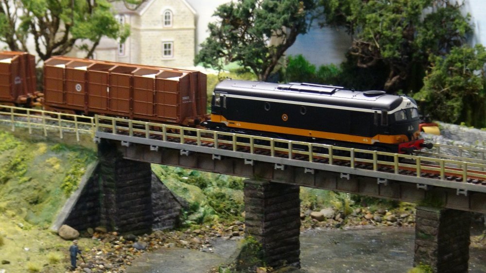

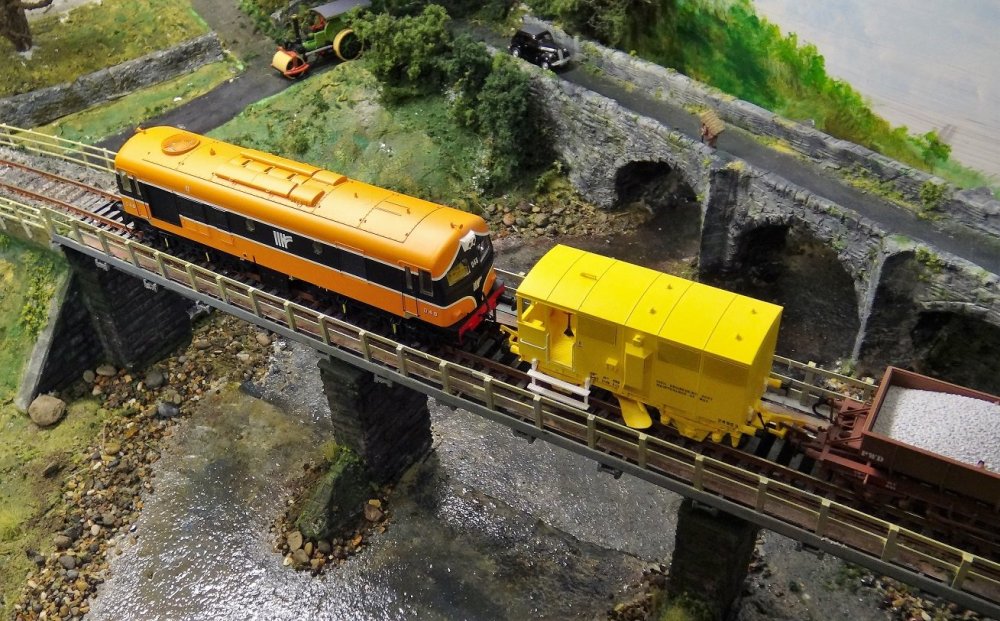

036 brings the A total up to 7, it could have been more but the horse at Drowes Mill threw a shoe and the Owners decided to upgrade to steam power, however I think they have possibly over-done it but they couldn't resist it.
Edited by Irishswissernie
  • Like 5
  • Funny 1

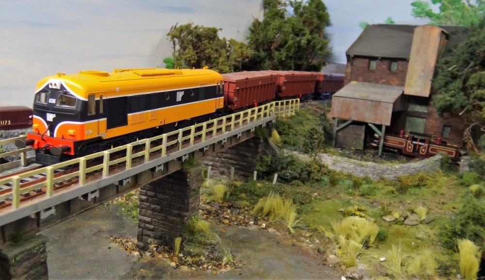

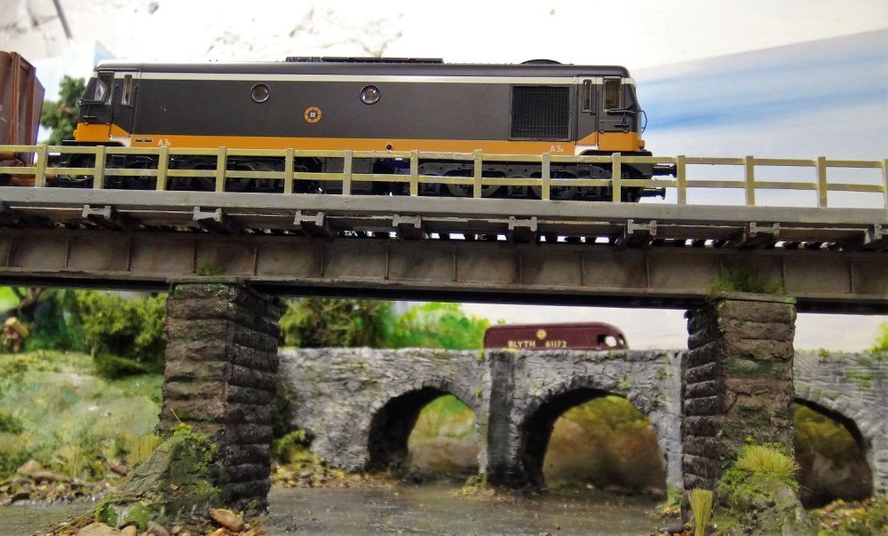

Had 20 minutes playtime today so here's the result. My last 2 A's have arrived and put to work
Gorgeous scene here! Love the river details and water effects - well done :)
