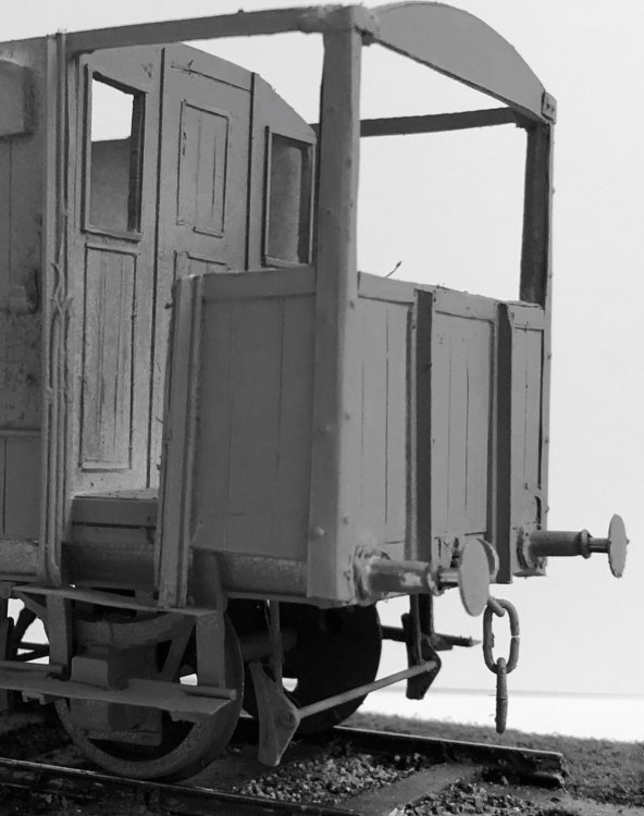

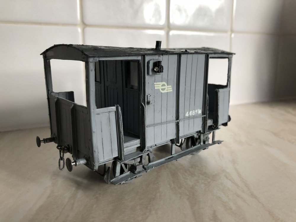

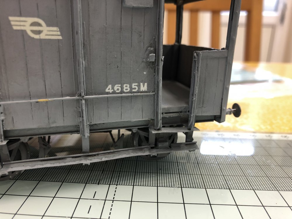

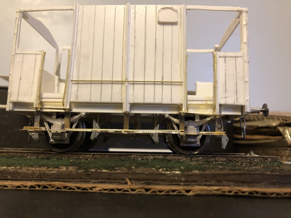

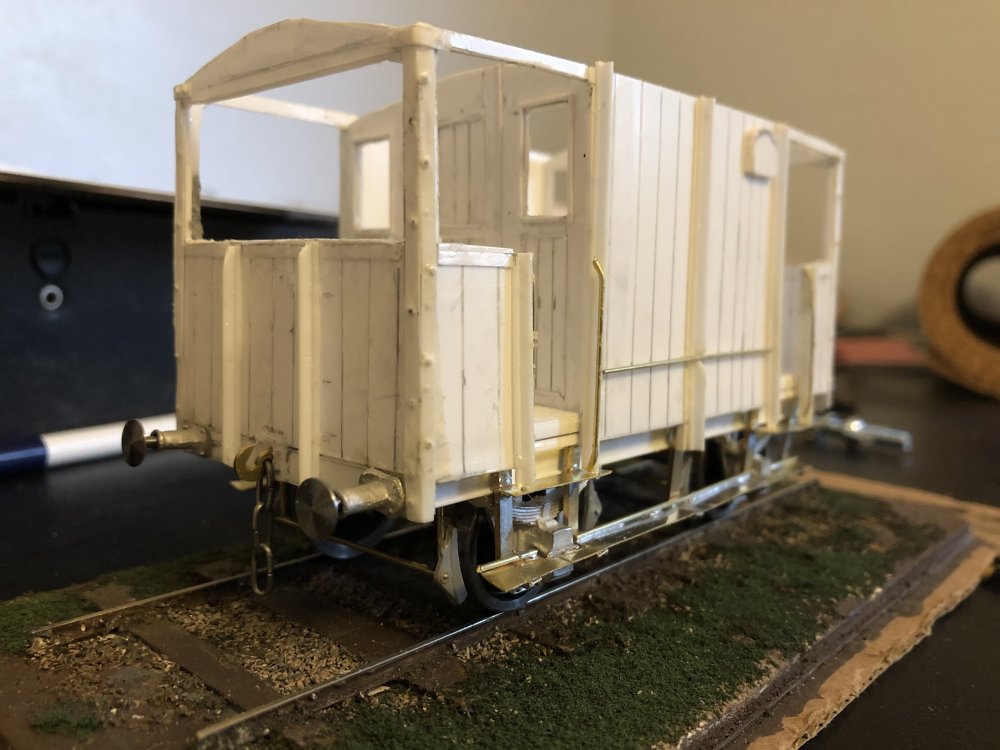

Galteemore Posted June 6, 2019 Author Posted June 6, 2019 (edited) One of the big gaps in the 7mm market is the humble brake van. Alphagraphix do a SLNCR one but there’s nothing from the main lines. So when I needed a CIE brake van I had to make one from drawings. So here’s a glimpse before she goes into primer...it’s an MGWR prototype. Plasticard body and chassis. Handrails 0.7mm brass wire. Slaters wheels and brake blocks. Invertrain axleboxes - thankfully the steps hide the Caledonian Railway markings! GWR buffers from Northants Model Supplies. Worst bit was fabricating the steps and brackets from bits of brass. A painful few hours of soldering.... Edited June 6, 2019 by Galteemore 4

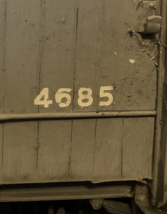

Galteemore Posted June 12, 2019 Author Posted June 12, 2019 (edited) Decals on and some weathering under way..... Edited June 12, 2019 by Galteemore 4
jhb171achill Posted June 13, 2019 Posted June 13, 2019 (edited) That's as good as REAL! Excellent job. While logos, lettering and numerals were often actual white when applied, virtually 2 or 3 outings had them off-white. Thus, pure white anything on a model never looks realistic. What you have done is super-realistic! Edited June 13, 2019 by jhb171achill 1

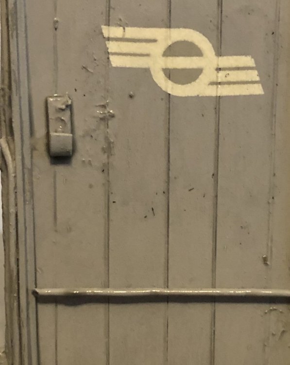

Galteemore Posted June 14, 2019 Author Posted June 14, 2019 (edited) Suitably knackered fabric roof on and painted. Lamps are on and the stove pipe is in. Let her dry overnight and she’s done - if I can pluck up the courage I’ll weather it down a bit more.., Edited June 14, 2019 by Galteemore 4 1 1

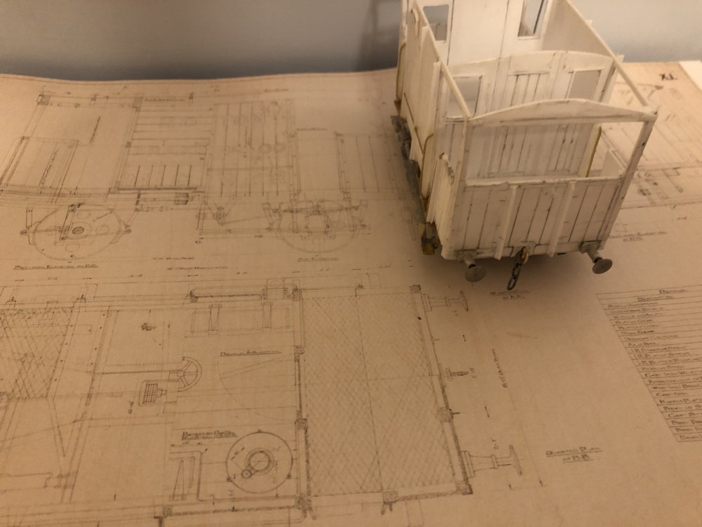

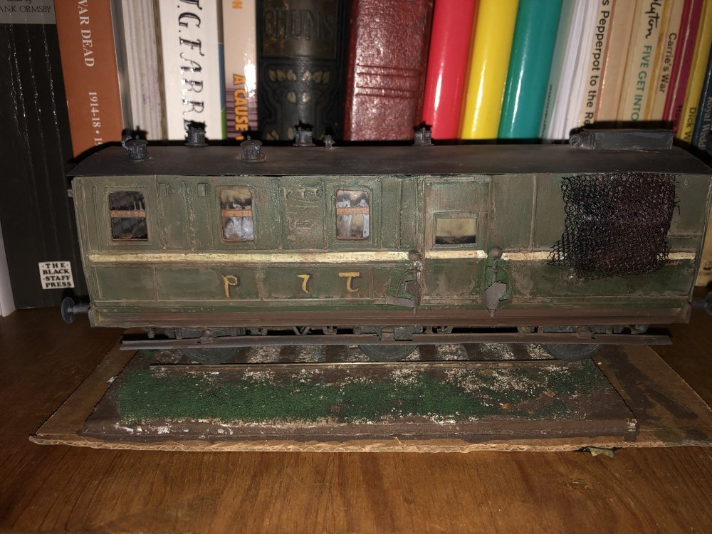

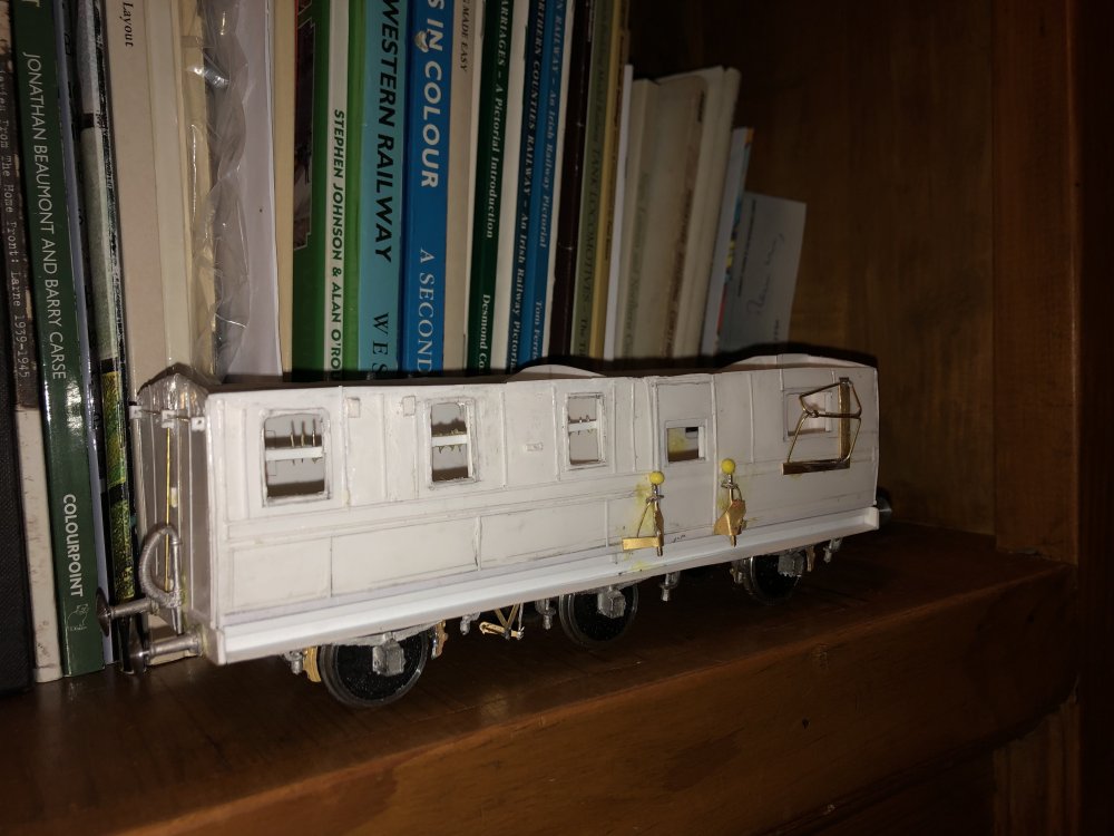

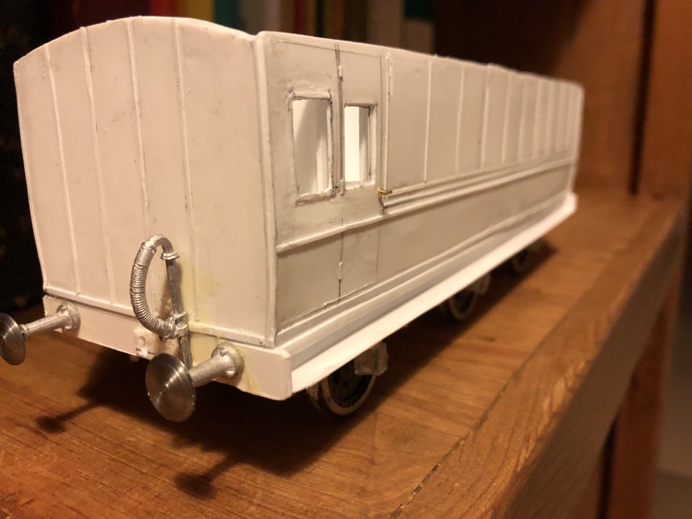

Galteemore Posted June 29, 2019 Author Posted June 29, 2019 (edited) Going postal....my first ever scratch built coach. I should really have gone for something simple. But no - it had to be a TPO for some reason. In fairness, the drawing did look simple. But then I saw a pic in Des Coakham’s book - and my prototype still had all the TPO bag and bracket gubbins which would have to be cobbled together .....Almost done now - just lower footboards to fabricate from brass, and I can prime her. Built from Alphagraphix drawing using David Jenkinson’s principles from ‘carriage building made easy’. More pics when the painting’s done.... Edited June 29, 2019 by Galteemore 7

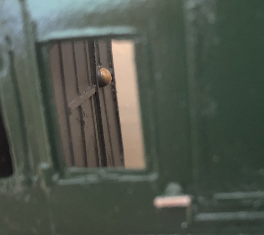

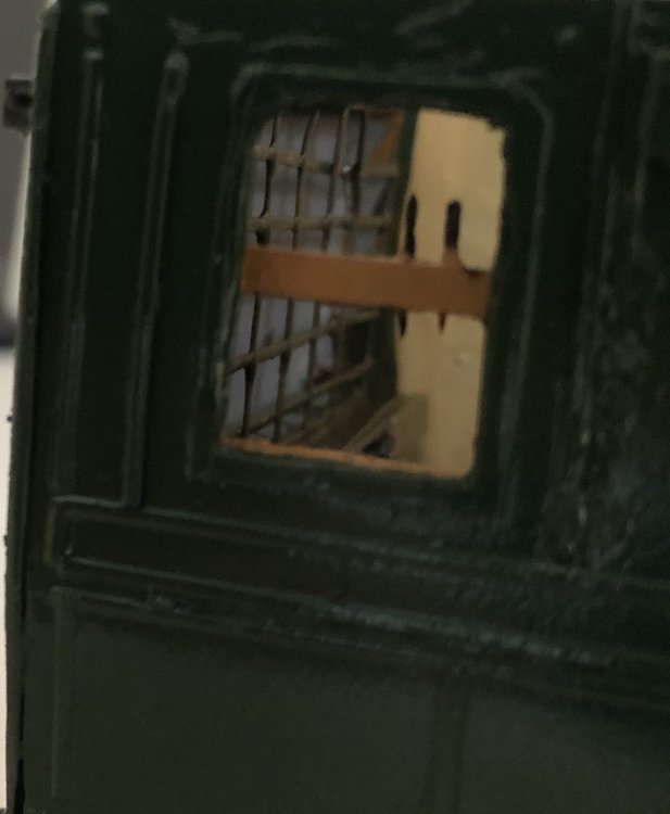

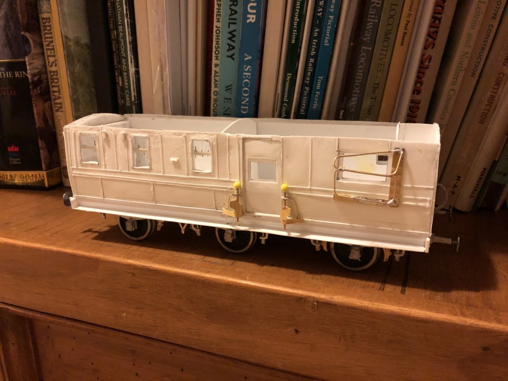

Galteemore Posted July 4, 2019 Author Posted July 4, 2019 (edited) A few sneak peeks through the windows of the TPO interior before the roof goes on and all goes dark - toilet compartment and sorting rack....the daggers on the window bars are of course mail bag hooks... Edited July 4, 2019 by Galteemore 6

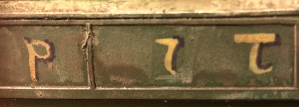

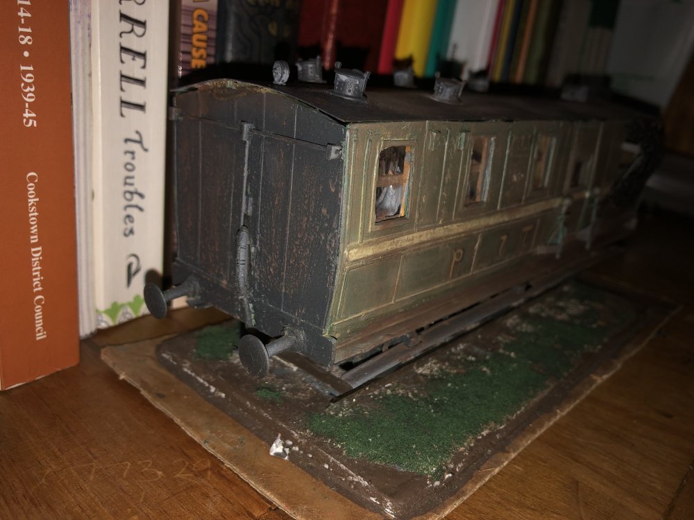

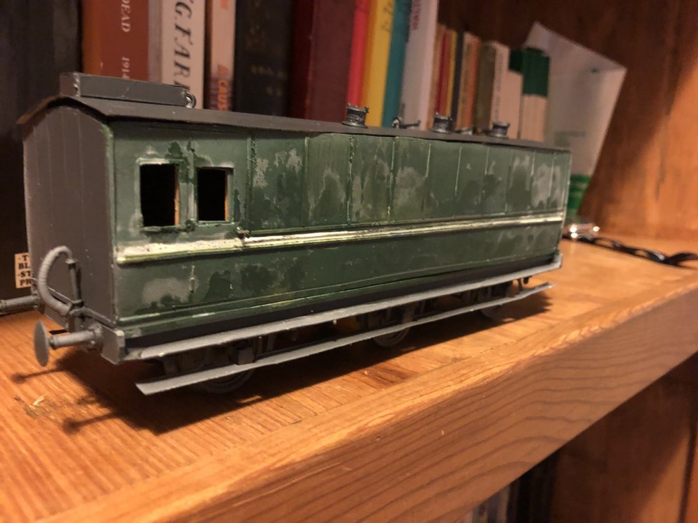

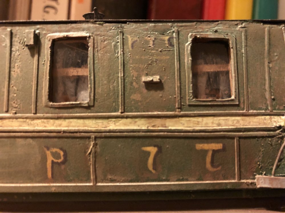

Galteemore Posted July 7, 2019 Author Posted July 7, 2019 (edited) Not sure if I meant the varnish to come out like this ...but I’ll try to live with it! Looks rather apt for an ancient vehicle at the end of its career. That’s what I keep telling myself...Roof and windows still to be fitted. I may get her done tomorrow. Edited July 7, 2019 by Galteemore 4

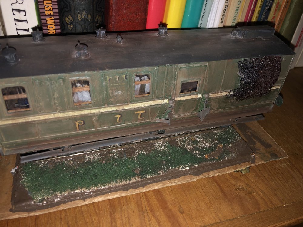

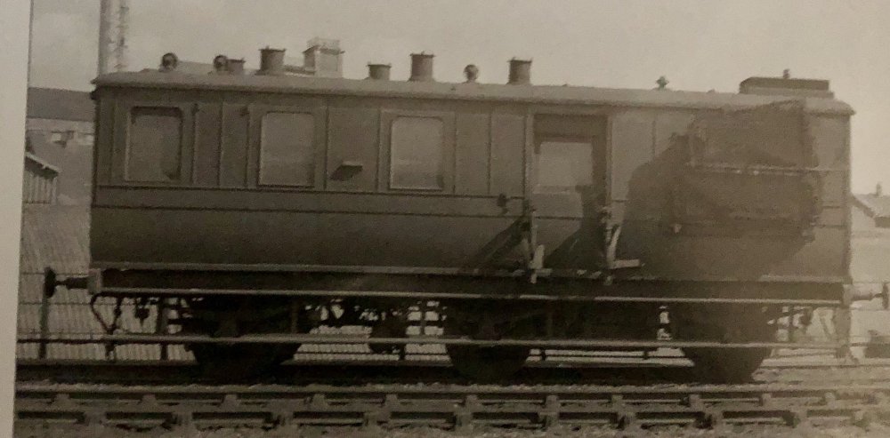

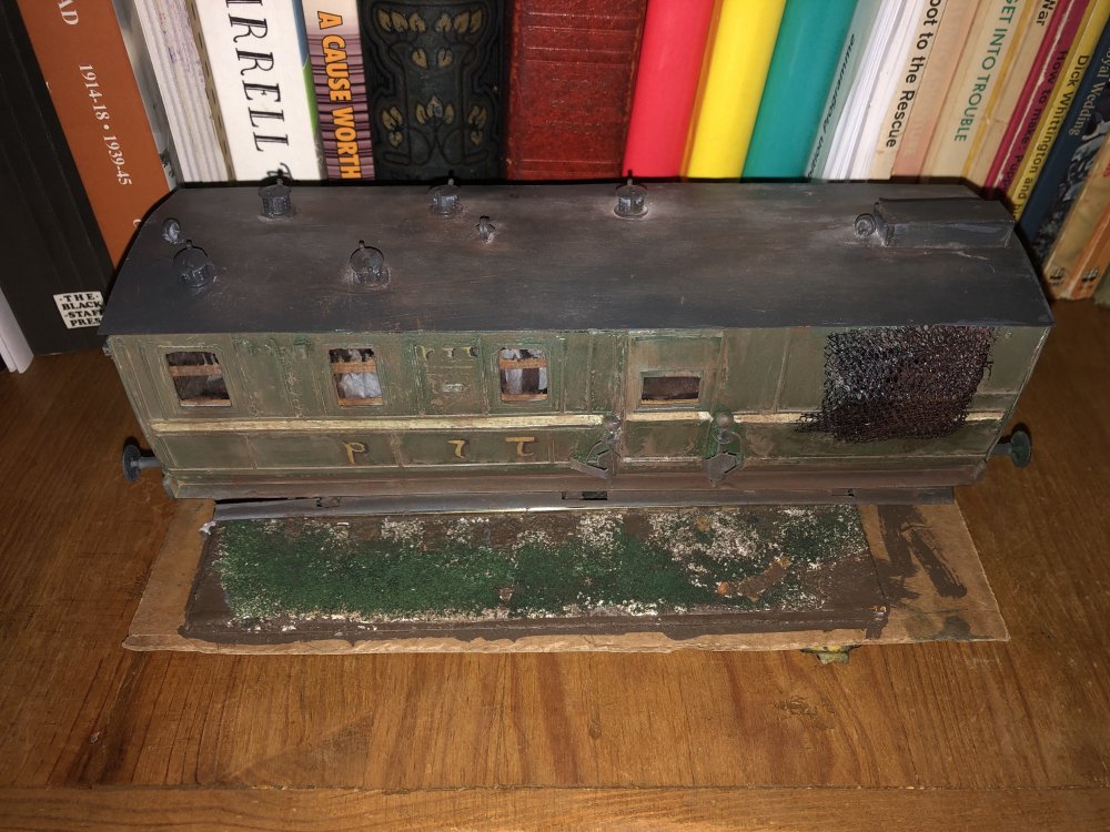

Galteemore Posted July 8, 2019 Author Posted July 8, 2019 (edited) And that’s about it. Just the couplings to fit. Despite the decrepit appearance there’s mailbags in the windows so all ready for attachment to the Sligo mail tonight ! Also attached are some pics of the original in GSR days. Edited July 9, 2019 by Galteemore 2 1
David Holman Posted July 9, 2019 Posted July 9, 2019 Getting a really worn appearance like that is just as hard as doing a pristine one and easy to over exaggerate too. This one is nicely subtle and very convincing. Fine job. 1
Galteemore Posted July 9, 2019 Author Posted July 9, 2019 Thanks David. Bit of an accident really - the acrylic varnish left a rather odd effect of white patches which I hadn’t expected. Frantic coats of dirty thinners and some gentle dusting with powders and talc helped restore things a bit!

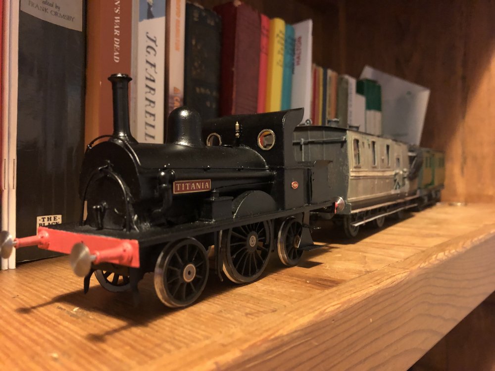

Galteemore Posted July 10, 2019 Author Posted July 10, 2019 (edited) Inauthentic authenticity. The Rosses Point portion of the Sligo mail. A complete MGWR train as it might have appeared in the 1950s if a single wheeler had lasted in service. Edited July 10, 2019 by Galteemore 5

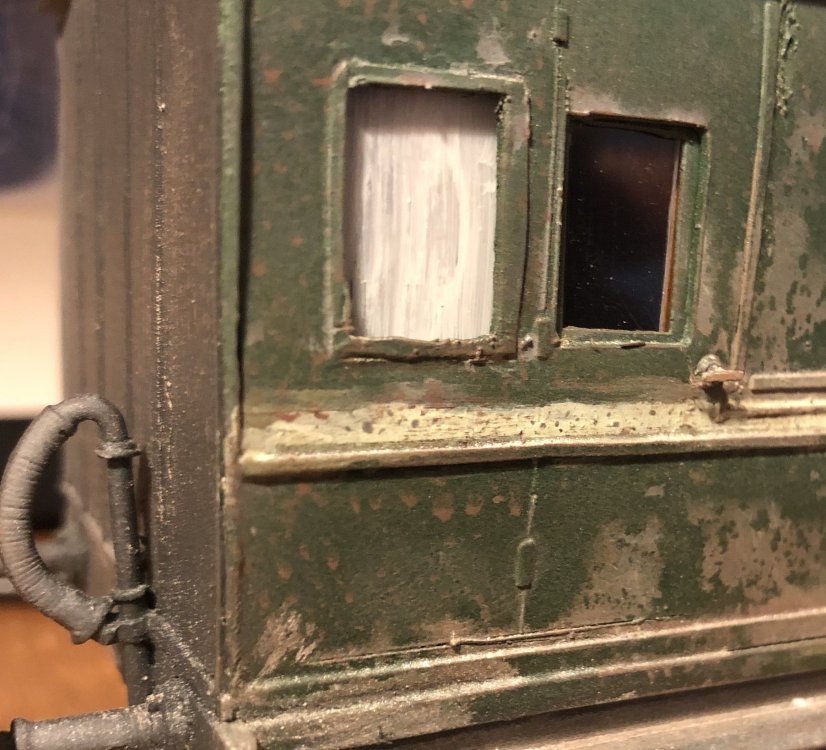

jhb171achill Posted July 20, 2019 Posted July 20, 2019 That's a suitably shabby appearance indeed! Postal vehicles rarely seemed to be at the top of the queue when men with paintbrushes were about! I have an old Hornby coach which with a bit of alteration will look like one of the last pair of WLWR brake 3rds. I have painted it a flattish green to make it look like the earlier dark green turning as shabby as yours. The green looks right for this, but I am not sure how to go about adding the "eau-de-nil" lining to match the faded shabbiness - indeed, this lighter shade on a badly-weathered coach seemed to fade even more than the dark green. I had thought of approaching a manufacturer of lining to make a batch of "weathered" lining, but probably too much effort and expense for too little use. I will eventually have no more than two or three vehicles that i would want to look as worn as that. 1
popeye Posted July 21, 2019 Posted July 21, 2019 You could just use white lining and put a bit of dirt over it. I think the lining usually faded to white over time when bleached by the sun.
jhb171achill Posted July 21, 2019 Posted July 21, 2019 Possibly, yes..... I recall seeing coaches in scrap lines. The green was by now a flattish shade - hard to describe. The lighter green was by this stage showing a greenish creamy colour, rather than white as such. Maybe some sort of creamy colour..... I'll experiment with paints at some stage. I also seem to remember that if really worn, it showed as streaky, like the paint was washing off to show the darker colour underneath. On my first visit to Inchicore (mid 60s?) I wish I'd had a camera... there was all sorts of stuff about in scrap lines...!
David Holman Posted July 21, 2019 Posted July 21, 2019 Martyn Welch very much shows the way to go in his Weathering book. Put on the base colours first - wood/primer/rust/darker original etc - then gradually rub back to reveal once dried. Glass fibre pencil, fine wetndry, T-Cut or whatever. That simulates actual wear. It should only be dirt that goes on top and rust comes through from underneath. 2

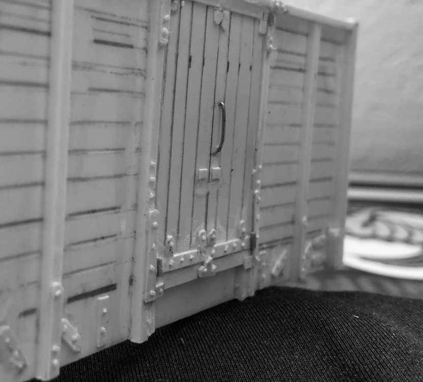

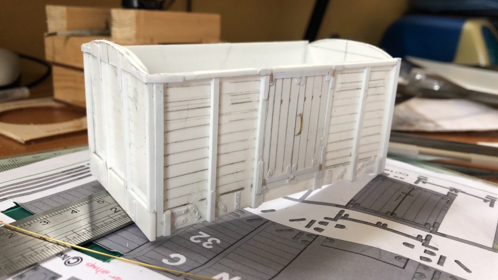

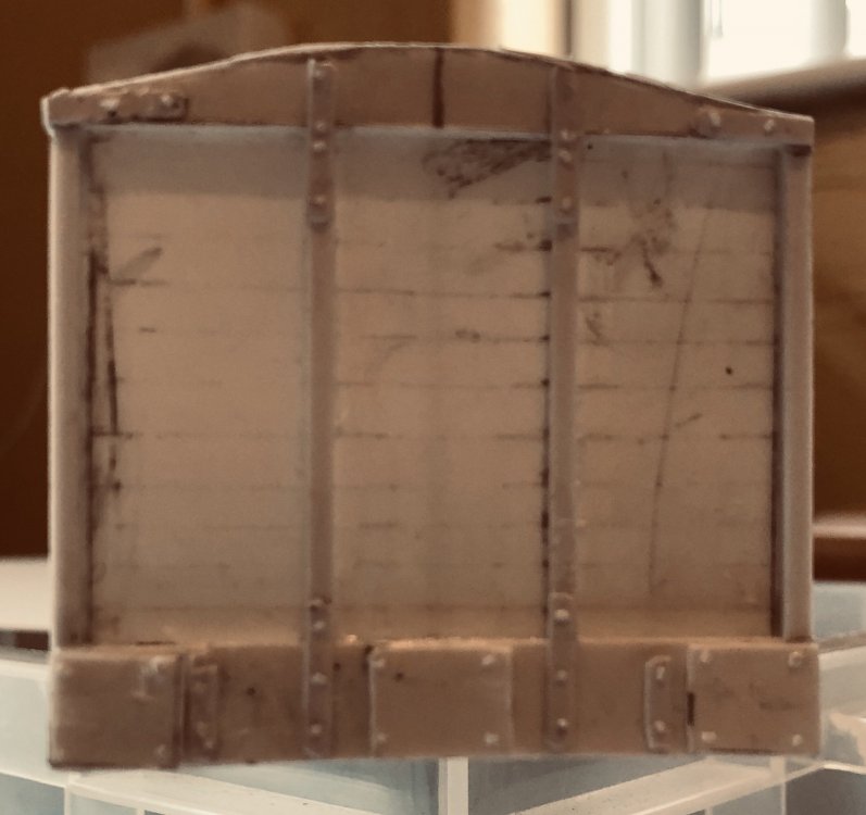

Galteemore Posted July 30, 2019 Author Posted July 30, 2019 (edited) Sligo Leitrim 7 ton van under way ...trying a new technique of applying individual bolt heads cut from 10x20 thou strip Edited July 30, 2019 by Galteemore 6
popeye Posted July 30, 2019 Posted July 30, 2019 The bolt heads look excellent, must be a slow job, there are so many. 1
