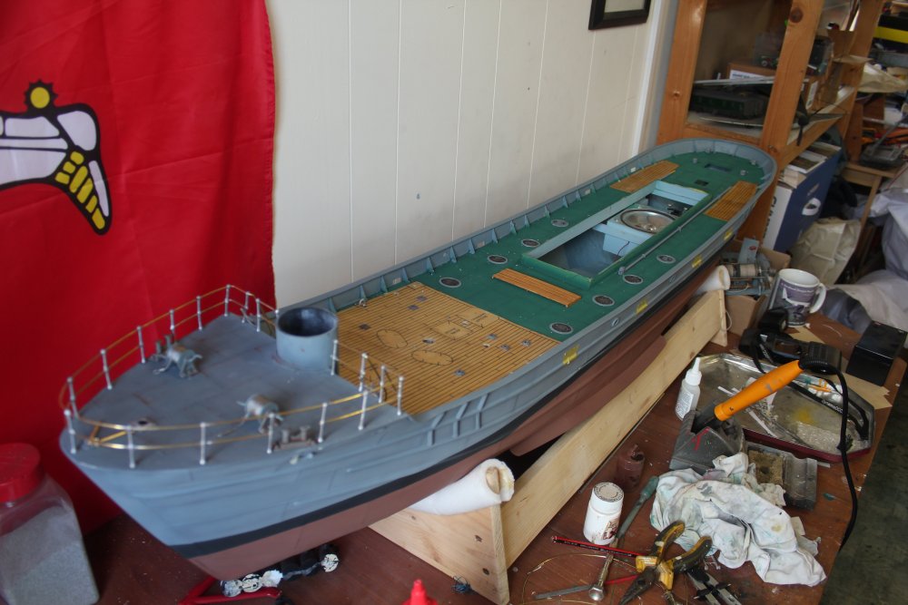

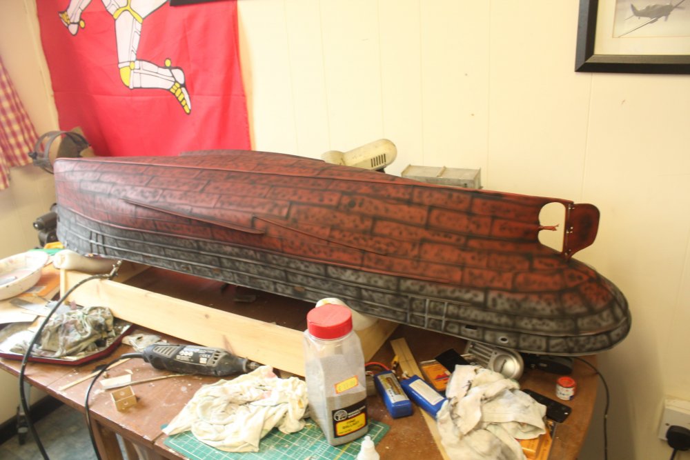

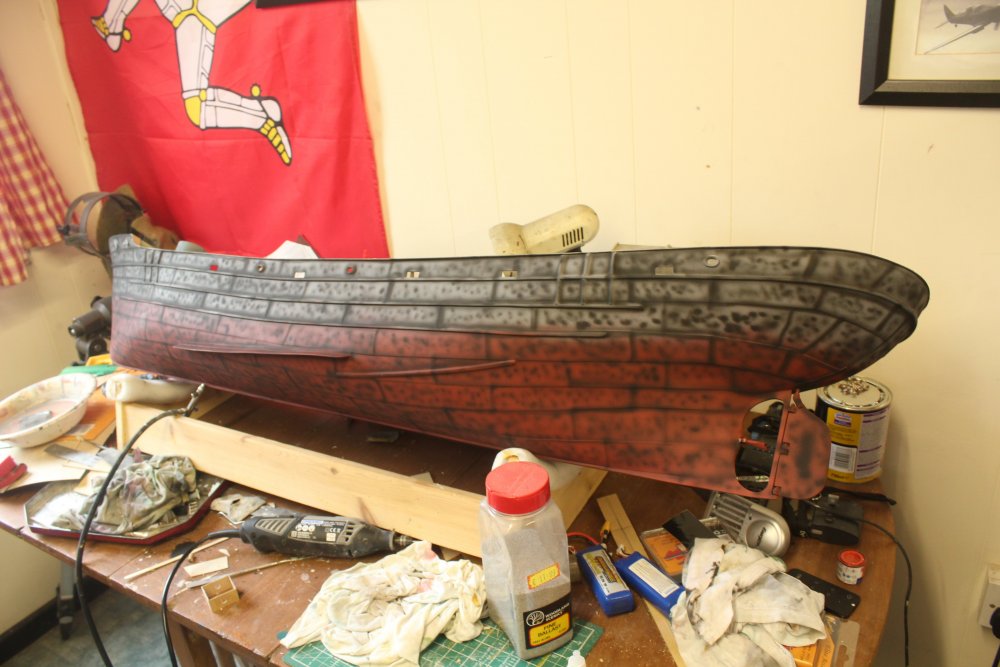

Georgeconna Posted July 9, 2021 Author Posted July 9, 2021 Bit of Pre Shading going down, White next, Was gonna do that colour last night but the Humbrol paint was like Cement and useless and it was a new pot.. 5 1 Quote

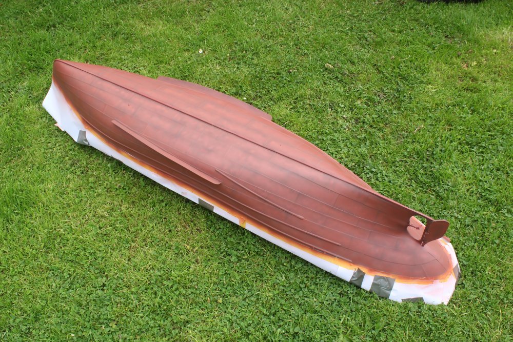

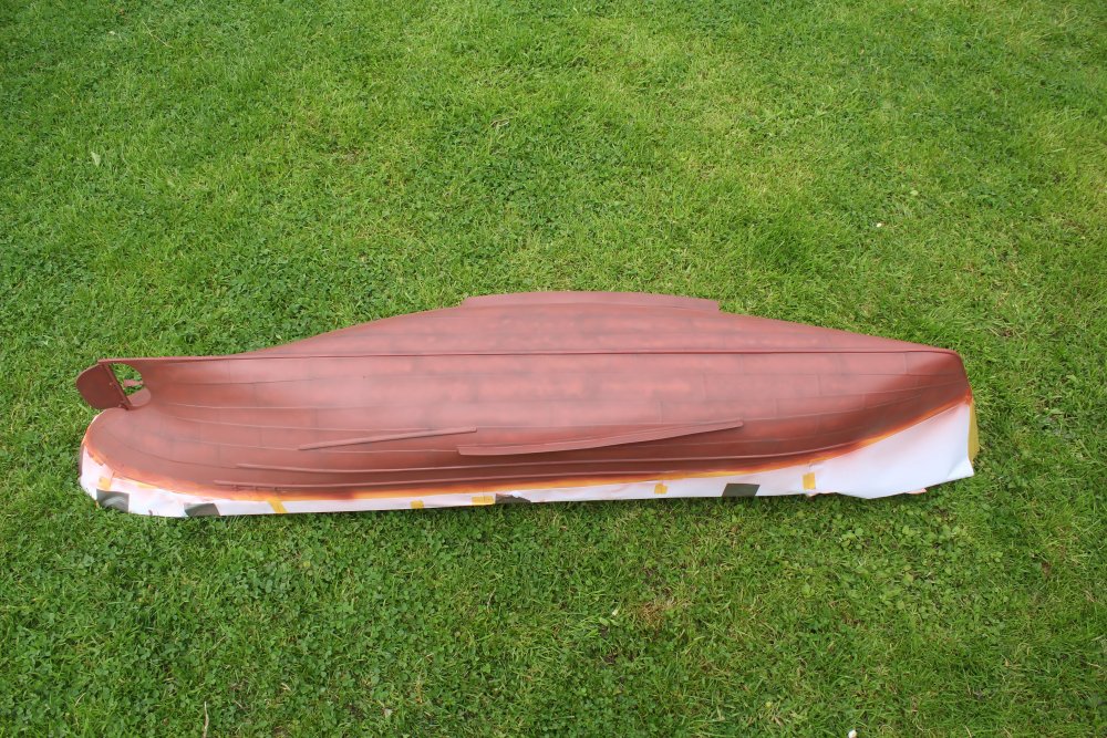

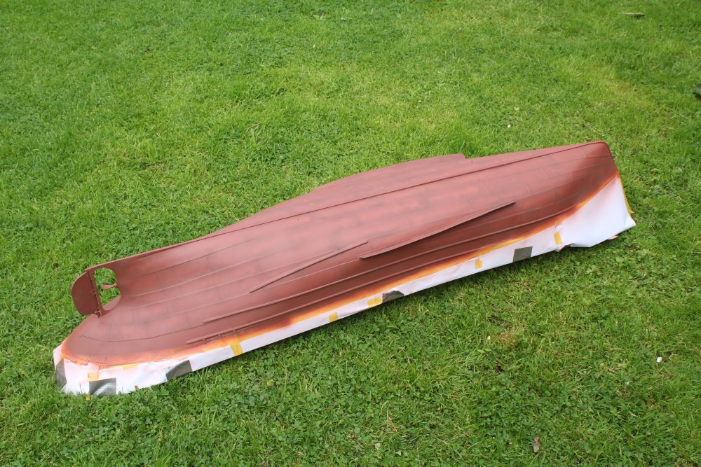

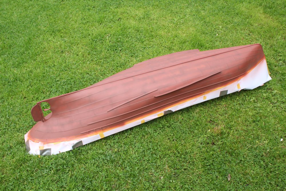

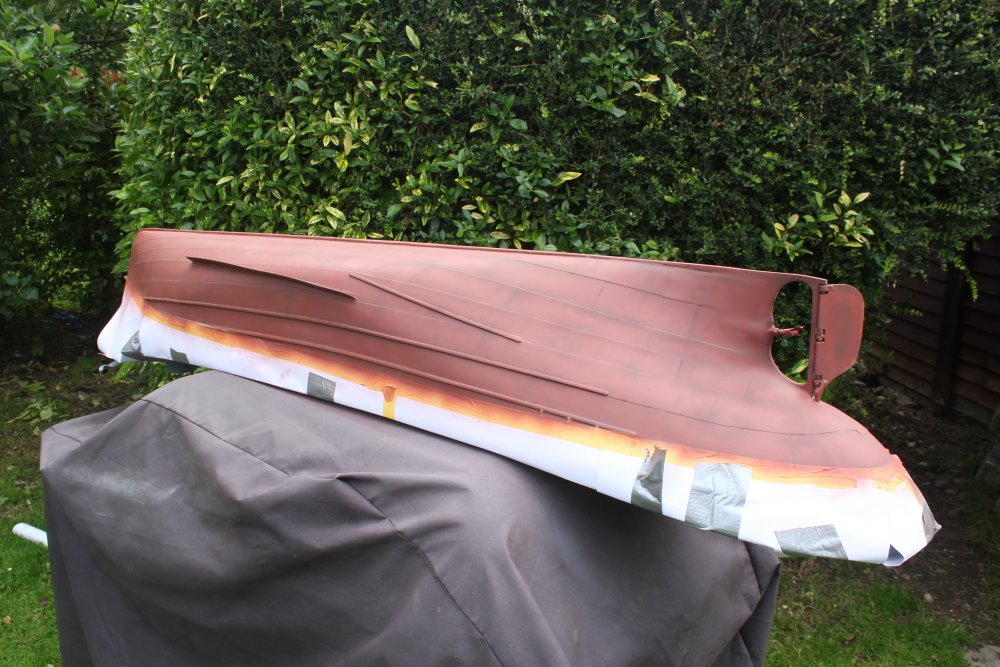

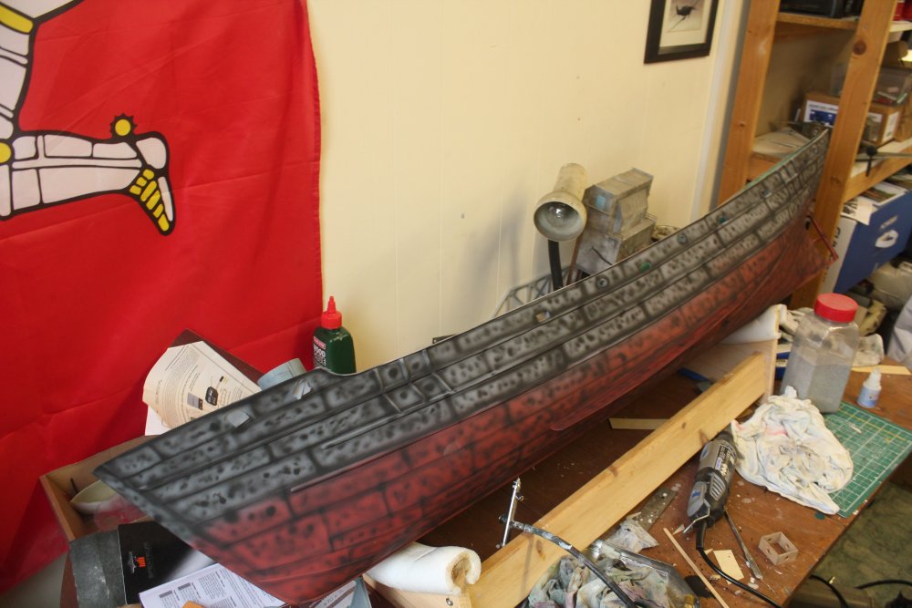

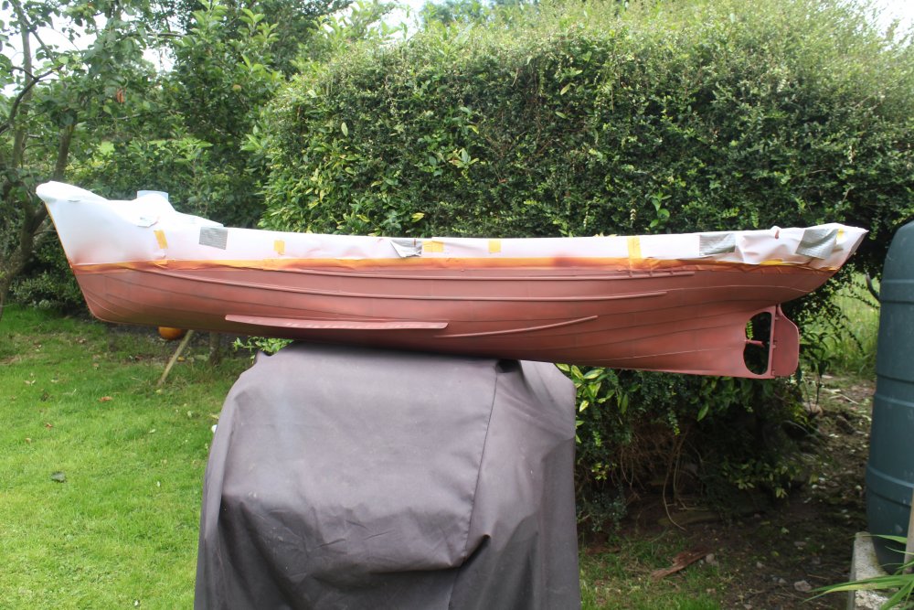

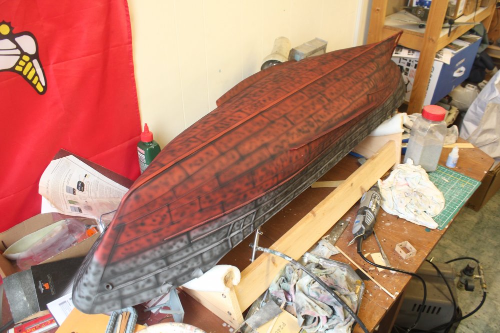

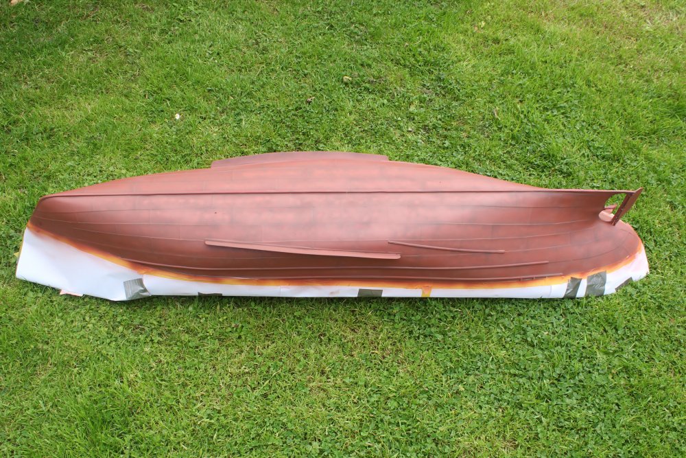

Georgeconna Posted July 13, 2021 Author Posted July 13, 2021 (edited) Hi Lads, The Finishing line is coming up soon I hope unless the misses pushes me to lay a patio out the garden but we are in situ now for 20 years and never seemingly needed one till now. In Ireland we would use it for about 3 days I expect a year so complete waste of good cold cash, Pond enlargement would be better! Anyhow a quick visit to Halfords last weekend before another a climb of Ireland highest mountain and which was Probably my 3rd retail visit over the past 8 months was taken to get some primer for the hull this was sprayed on and any blemishes dealt with. Next was the Pre Shading of black and white to take the boring flat grey scape off of the hull. another cost of the Red needs to be done yet but took her out in the natural light to see what needed to be done and the pics below are the results. This was all done by Airbrush. A Badger 155 Anthem I have had for years. Looking up at O'Sheas Gully Looking at the trail up from Cronins yard. Onthe way down the Zig Zags. Edited July 13, 2021 by Georgeconna 4 1 Quote

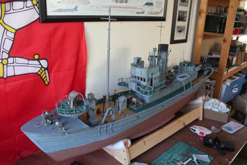

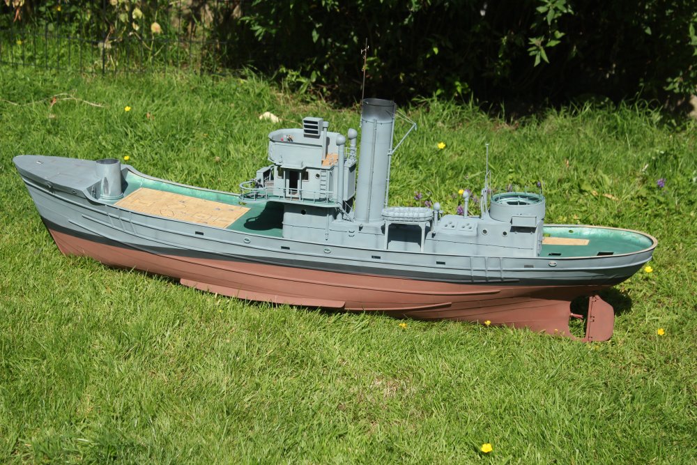

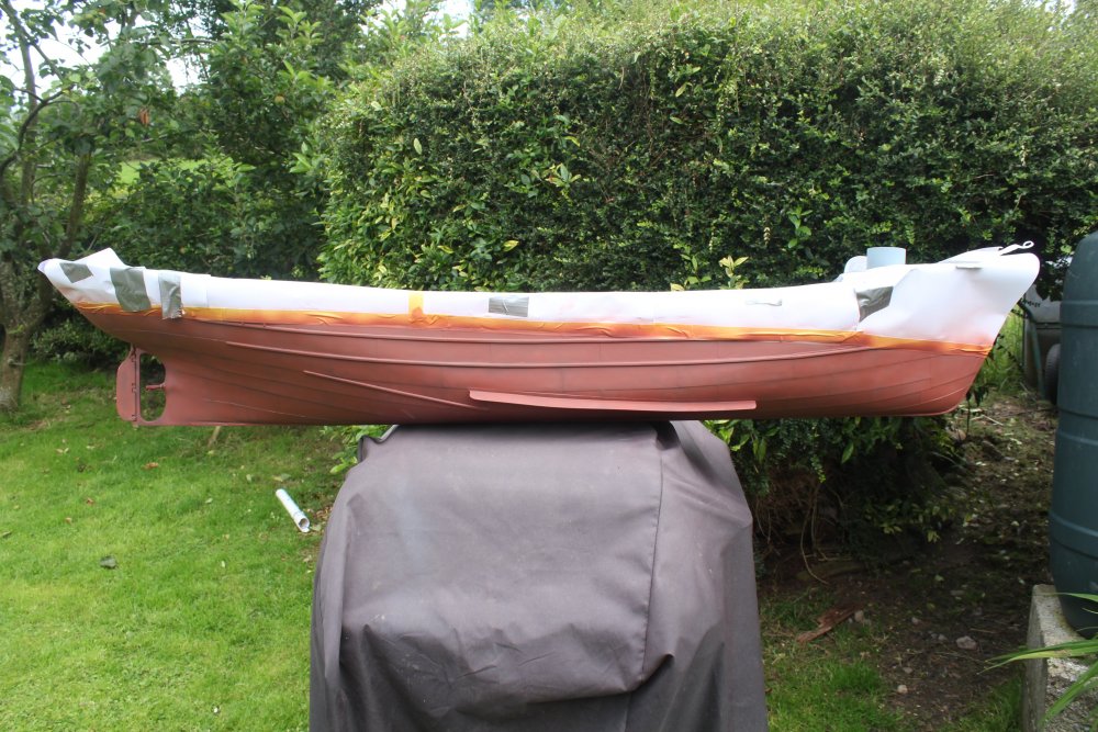

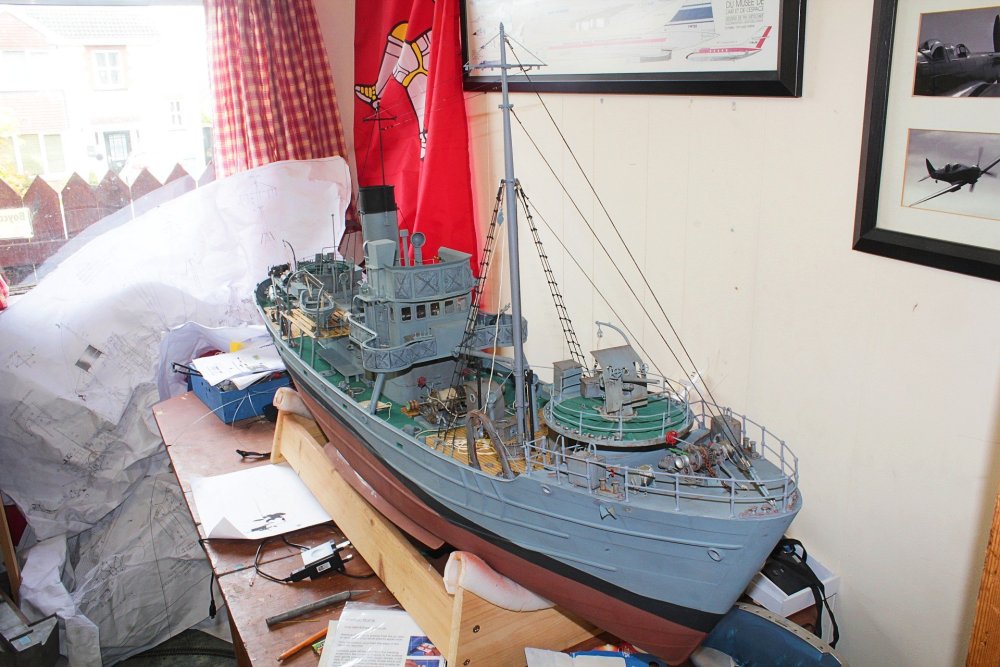

Georgeconna Posted July 16, 2021 Author Posted July 16, 2021 (edited) Hull Grey and the Red done, The Masking lines for the Black cheatline is done also so at Lunchtime I will start to mask this up, Should make it pop then. Test Fitting of a lot of the deck bits also. Looking the bizz now! Hopefully on the water at the end of next month! Bit below the bow are from the Albatross which came to Grief Tuesday night due to Receiver issue. took off and then nosed in from 30FT. Shame as it was a lovely Flyer and Parkzone don't do them anymore but I will have to replace this as it was me Dads one! Dynam do a slightly bigger one. Hope he wont notice. Edited July 16, 2021 by Georgeconna 5 2 Quote

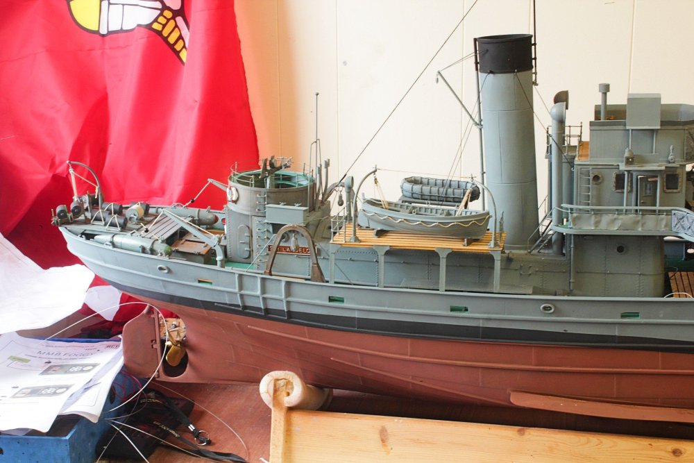

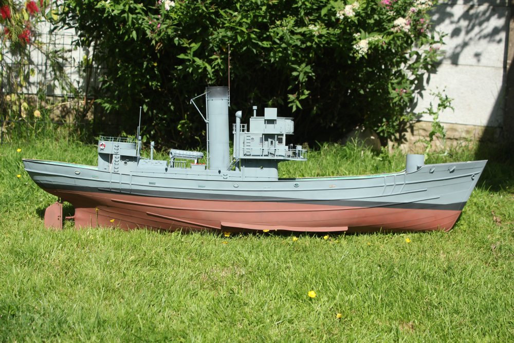

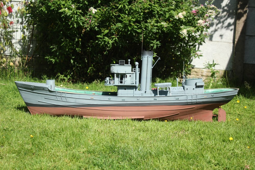

Georgeconna Posted July 18, 2021 Author Posted July 18, 2021 (edited) Cheatline done, Was worried this would bit come off giving the Curves, Lumps and bumps, Used a Pencil on a Square and ran it around the hull to get consistent height, but it has turned up very nice indeed , Very happy, used anthracite grey instead straight black. Edited July 18, 2021 by Georgeconna 5 4 Quote
PJR Posted July 22, 2021 Posted July 22, 2021 On 18/7/2021 at 3:25 PM, Georgeconna said: Cheatline done, Was worried this would bit come off giving the Curves, Lumps and bumps, Used a Pencil on a Square and ran it around the hull to get consistent height, but it has turned up very nice indeed , Very happy, used anthracite grey instead straight black. Expand Stunning workmanship 1 Quote

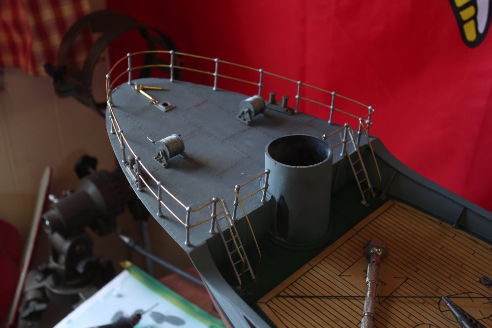

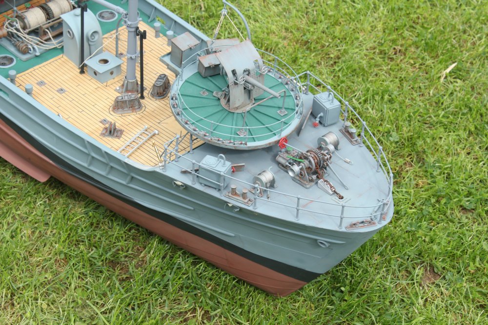

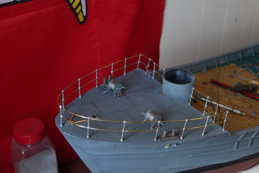

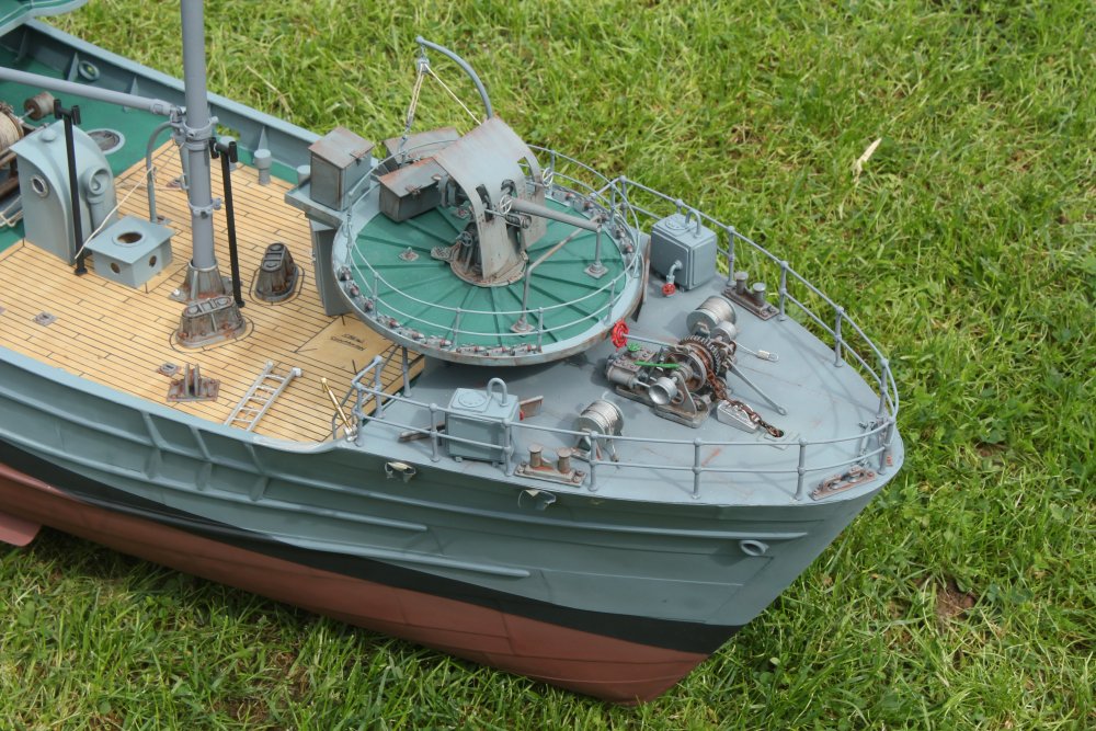

Georgeconna Posted July 31, 2021 Author Posted July 31, 2021 Front handrails being done over the past 2 days also the Bulwark supports are in.... 6 Quote

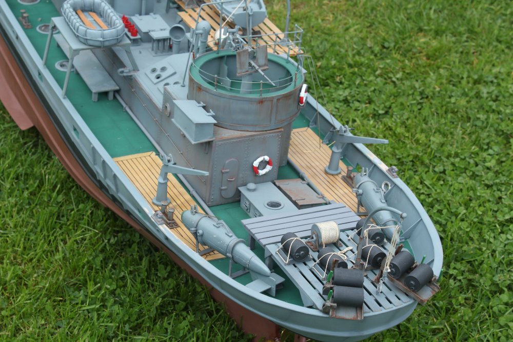

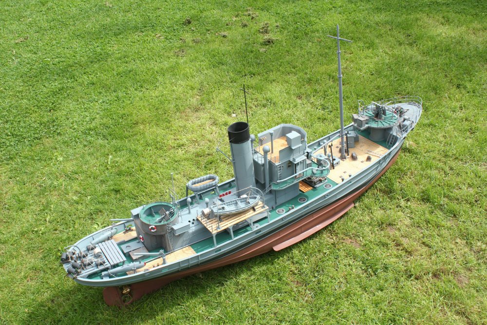

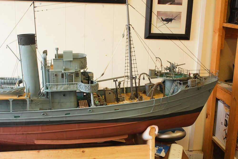

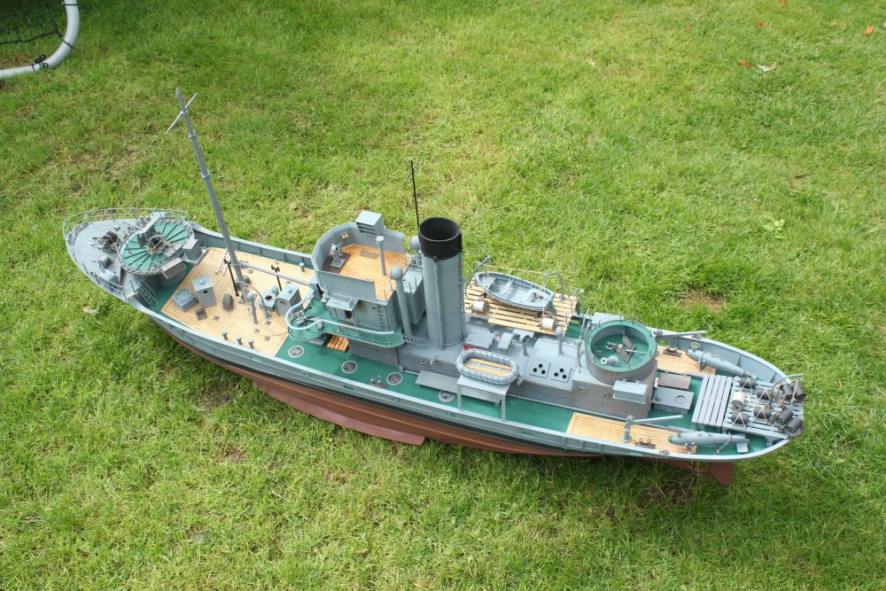

Georgeconna Posted August 6, 2021 Author Posted August 6, 2021 A few Gratuitous shots in the sunshine to see what the weather was like that I put on yesterday. Few more bits done, The Lifeboat davits rigged and the Life boat sorted with grab ropes around the sides. The Gun Platform Davit also rigged and there is another Davit on the main deck Rigged. 7 1 Quote

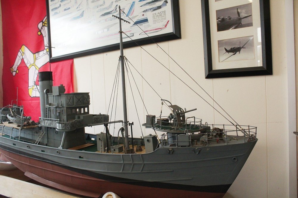

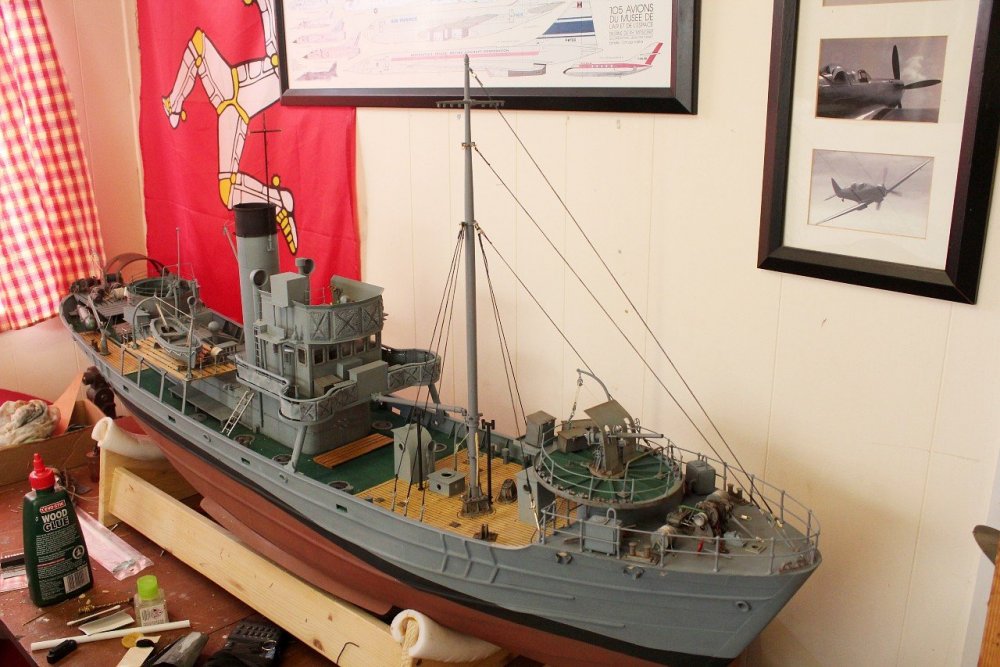

Georgeconna Posted August 17, 2021 Author Posted August 17, 2021 Small bit more done and the more bits that came in from Cornwall model boats enabled me to start the rigging. BTW did not get stopped for any customs so lucky again! The Main things are the splinter mats on the handrails and the gun platform supports. And the Mast has been glue in and the rigging started. 7 1 Quote

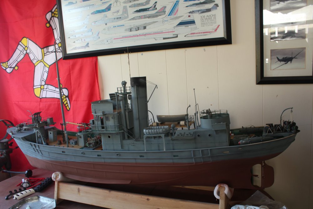

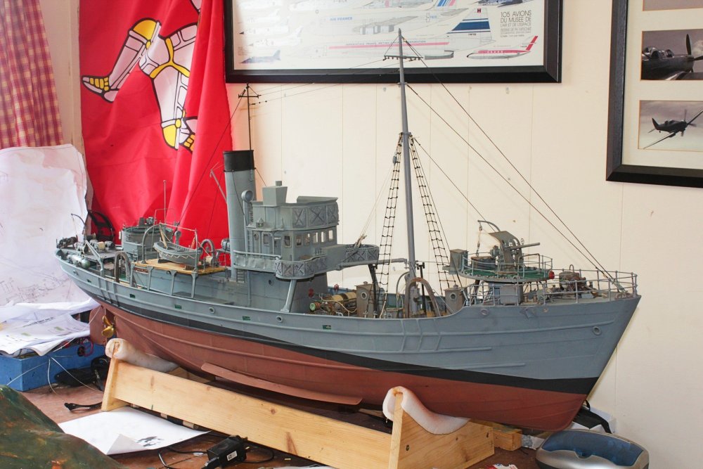

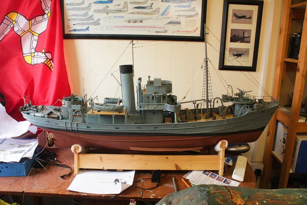

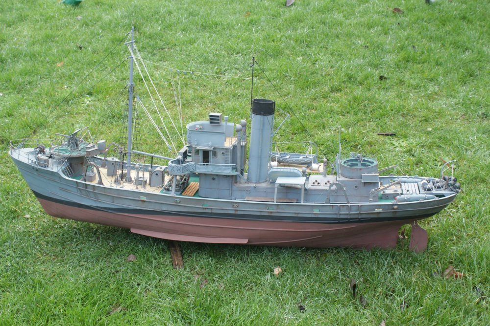

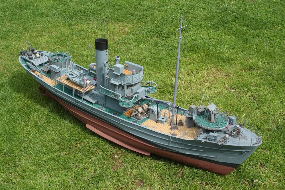

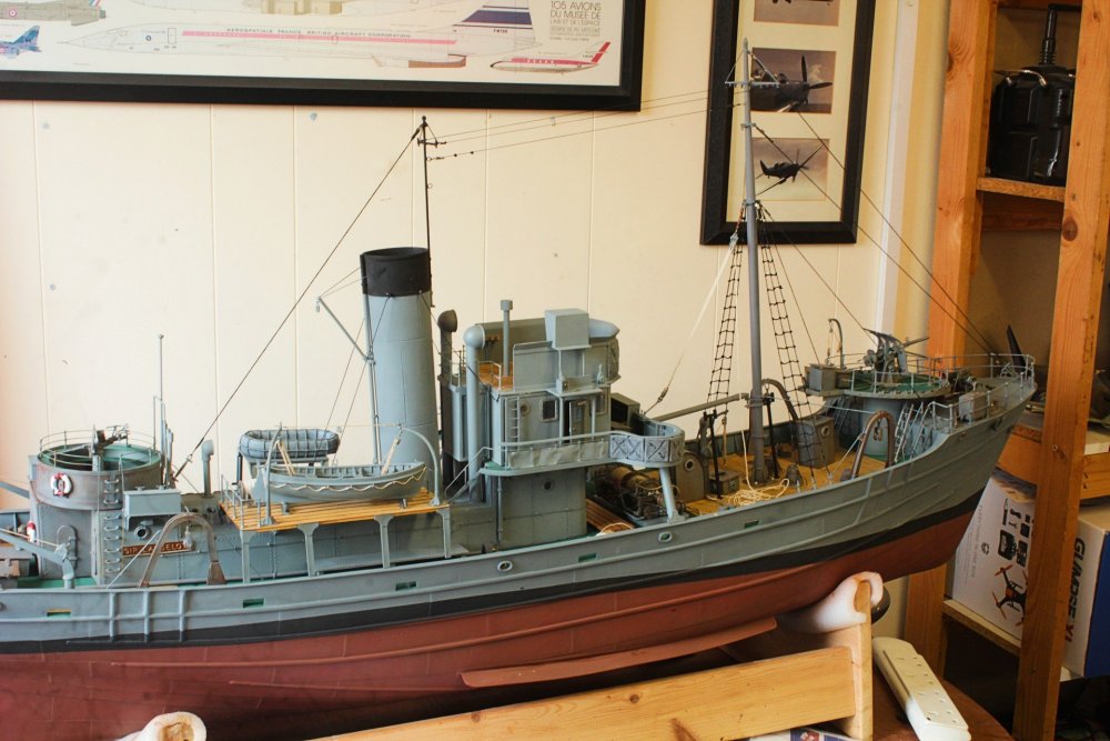

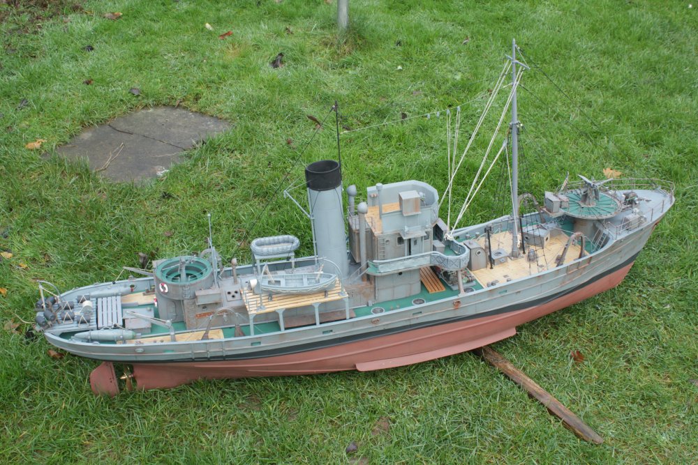

Georgeconna Posted November 16, 2021 Author Posted November 16, 2021 Crikey have not updated this in a while! Up to this stage now so here a few piccys, Gallows are in, Ratlines are complete, the Nav lights are in, The Aerials and done and a few other bits. 8 2 Quote
popeye Posted November 16, 2021 Posted November 16, 2021 Will it have a crew? Must be near done now. Quote

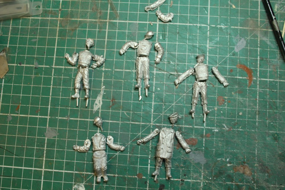

Georgeconna Posted November 16, 2021 Author Posted November 16, 2021 (edited) On 16/11/2021 at 6:26 PM, popeye said: Will it have a crew? Must be near done now. Expand Nearyl done, Just stumbled on the Aerials set up as these needed to be removable from the Main mast. I tried some very thin brass wire but could not get the tension I liked and when too taught snapped the mast white metal cross bar. In the end the Daughters jewellery box and a nice sized elastic thread came to the rescue. Oh yes the crew, These lads will have a big problem doing the Hoky Koky when it comes to the left arm.......say no more. Edited November 16, 2021 by Georgeconna 2 Quote
popeye Posted November 16, 2021 Posted November 16, 2021 They look like they have been already torpedoed. 3 Quote

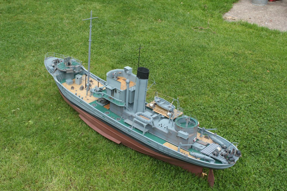

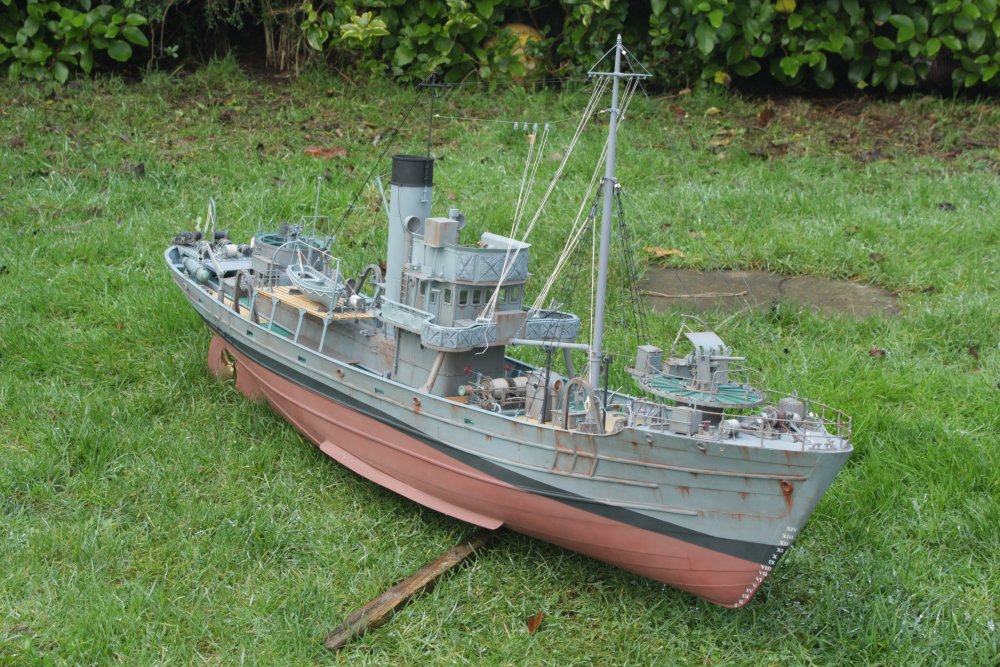

Georgeconna Posted November 29, 2021 Author Posted November 29, 2021 Started on the weathering, doing this inside is not great under artificial lighting so took it out side. I feel it is a Tad too heavy on the right side so I will blend this in a bit and work on the other bits, Less is more kinda thought 7 3 Quote

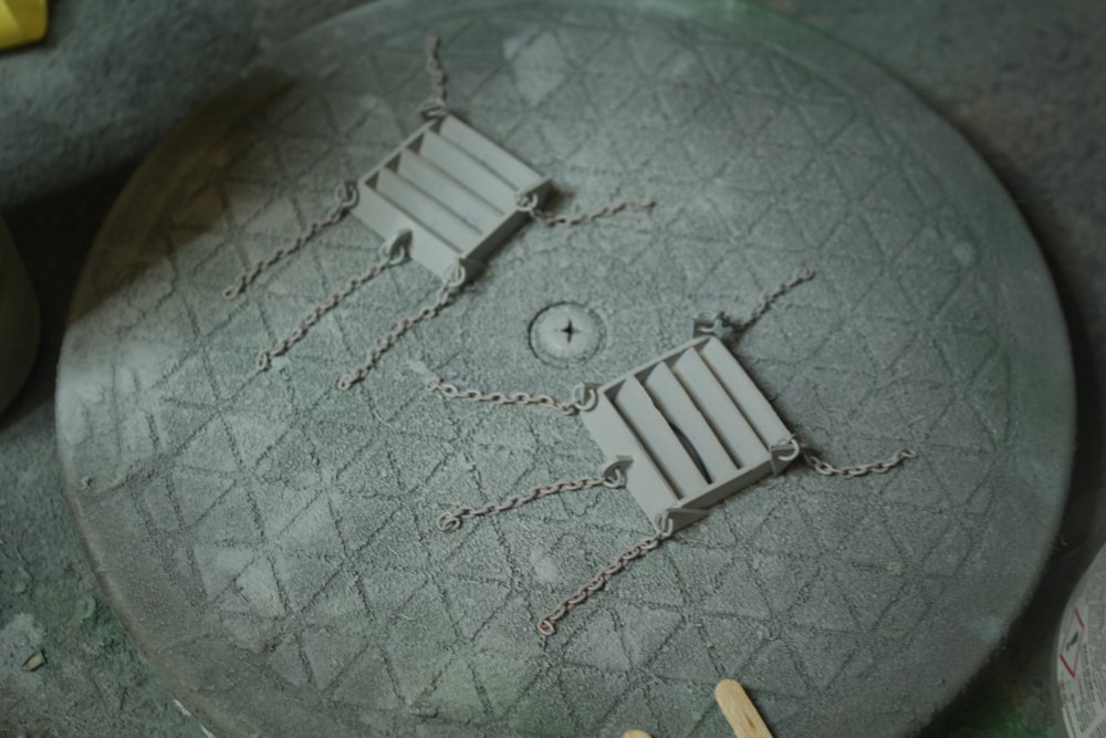

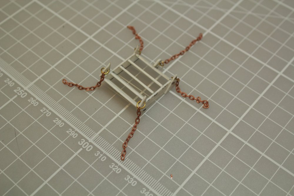

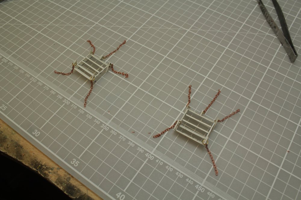

Georgeconna Posted December 23, 2021 Author Posted December 23, 2021 Work on the small bits still on going, the Deadline of a year slipped by but now rush now. Still waiting for the sound unit and year later..... thing is with doing something different is the new things you learn, I am making these things now, Called Kites. Used on the Sweeping line to get it down deep. Scratch built plasticard and some chain. Simple. Now need another 2 to make. 4 Quote
KMCE Posted December 23, 2021 Posted December 23, 2021 Nice work George. The drag created by the kite, otter & oropesa must have been considerable, slowing an already slow process. I assume the lengths of chain on the kite would help to create the correct offset from the ship by adjusting their lengths? Ken Quote
Galteemore Posted December 23, 2021 Posted December 23, 2021 (edited) It was slow and painstaking - thirty years ago I was doing it as part of NATO’s 10 Mines Countermeasure Squadron. Got very exciting when the sweep wires got close to crossing each other. But amazing to see when you cut a mine wire and saw the little black ball bobbing in the water…, Edited December 23, 2021 by Galteemore 3 1 Quote
Georgeconna Posted December 24, 2021 Author Posted December 24, 2021 Interesting stuff, How did ye get rid of them when they popped up. Shoot a few rounds into them? Quote
Galteemore Posted December 24, 2021 Posted December 24, 2021 Yes - these were unarmed test mines, laid by friendly forces the week before. So when the mines appeared they were recovered for reuse. The SOP for real ops though was shooting at them with an SLR - 7.62 rounds can really have an impact. Modern 5.56 ammunition has a very different ballistic profile! 1 Quote

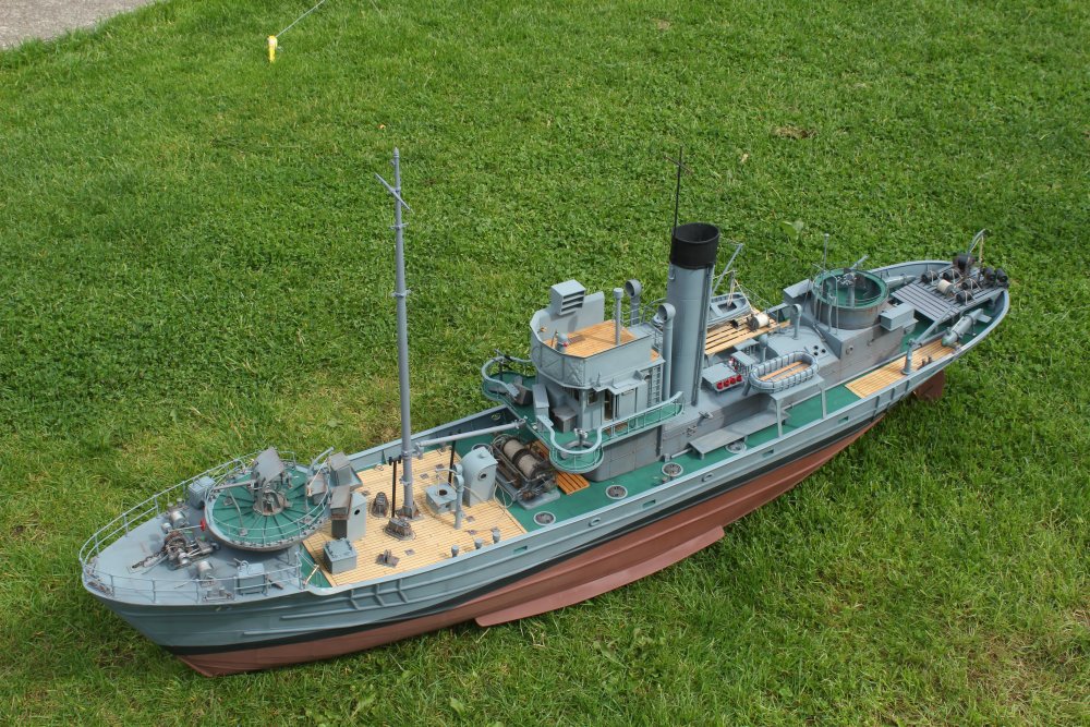

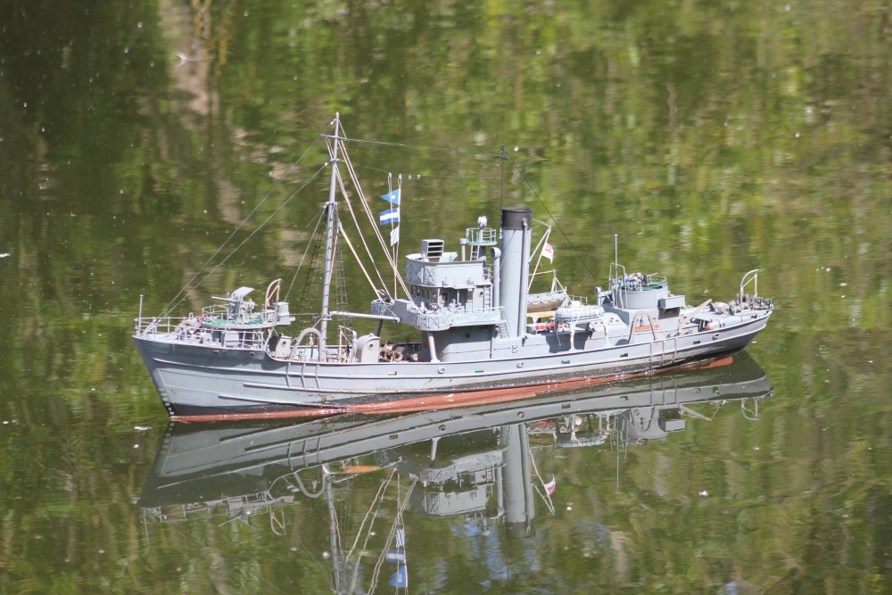

Georgeconna Posted May 29, 2022 Author Posted May 29, 2022 Well the 1st Voyage happened today and it stayed topside! Result, Nice solid ship to handle too, Well Worth the Effort! 9 2 Quote
popeye Posted May 29, 2022 Posted May 29, 2022 Looks great and so much detail. It's a work of art. Quote

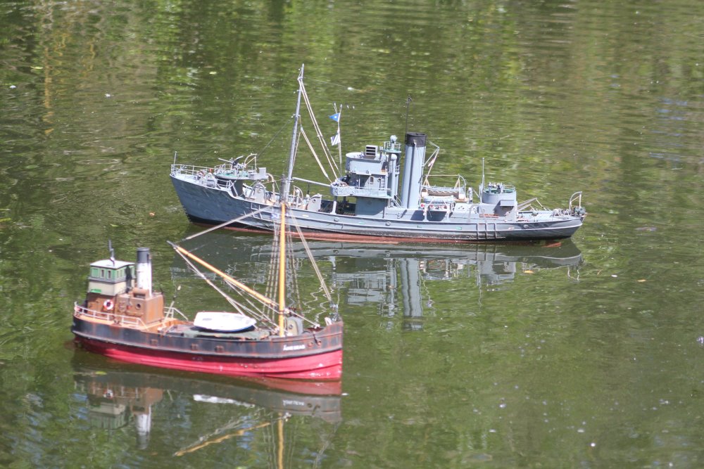

Georgeconna Posted June 12, 2022 Author Posted June 12, 2022 Thanks Lads Some short vids of it in action today down the Marina Park in Cork. 6 2 Quote
murphaph Posted June 12, 2022 Posted June 12, 2022 You must be well pleased George. Looks the absolute business and as an aside, that park looks perfect for the hobby! My nearest lake is a proper lake. Always worried about losing radio contact and the young lad's boat drifting off! 1 Quote
Georgeconna Posted June 12, 2022 Author Posted June 12, 2022 Thanks for the comment Phillip, Sure am delighted, Takes about 30 mins to get it sorted for sailing, Thats the down side. The Park is a small park next to the GAA Stadium, was before waste ground so badly needed green space in Cork TBH. Not enough of them. As you say no fear in Losing contact but the area is a tad small for Turning my one given one screw operation, Mind you the 2.4 stuff will be out of eye sight well after you loose contact. It is handy enough now for Launching and recovery and the lads a gonna (sushh) insert some rings into the 'Quay' wall to hold the model boats. Rumours are now the council what to run a road through it... 1 1 Quote
