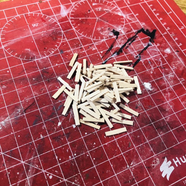

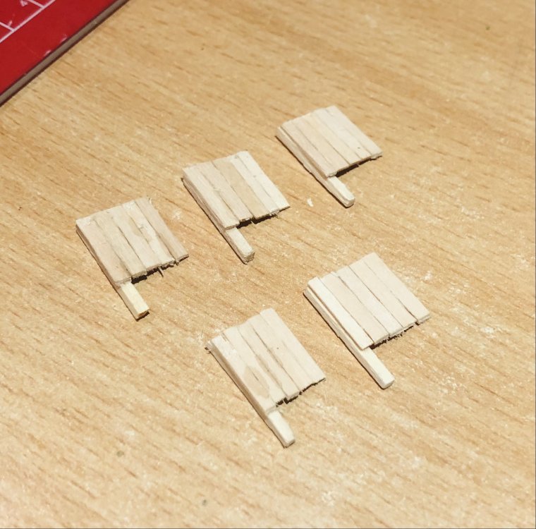

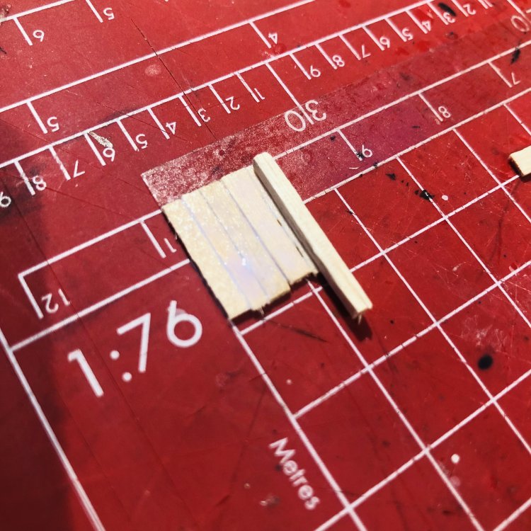

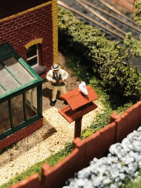

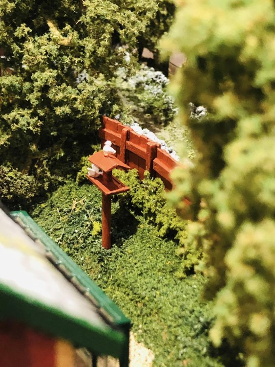

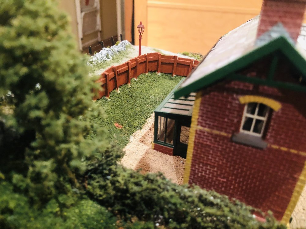

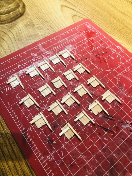

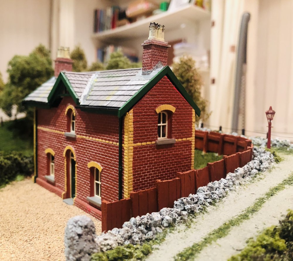

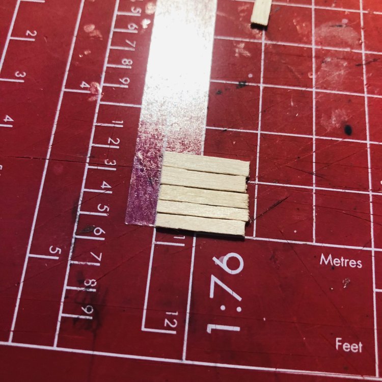

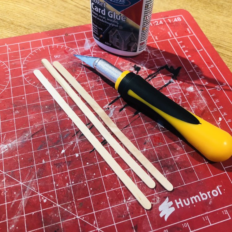

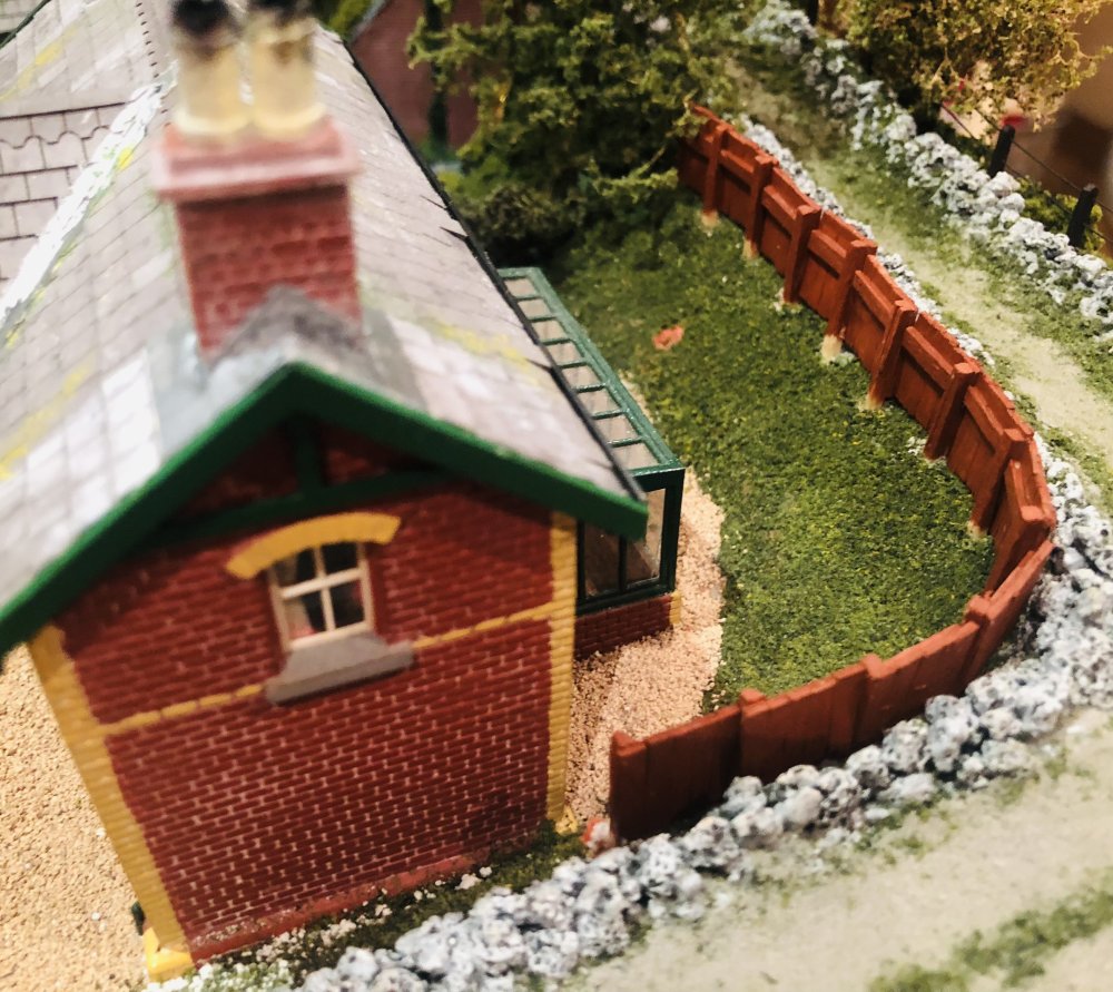

Patrick Davey Posted October 15, 2022 Author Posted October 15, 2022 (edited) Mr. Weaver had been asking his groundsmen to build a fence around his garden and eventually it was done. The garden is on a curve and a slope so they decided to build a series of individual panels which could easily follow the contour of the location. Starting point - coffee stirrers. Appropriate material for building something that will be in the ground...... Lots of planks Creating the panels by aligning the planks onto double sided tape before adding a spot of glue. Each panel had a post attached. Some completed panels before the posts were sharpened at the base. 19 panels were needed - here they have been braced and are ready for staining. The bracing would also be trimmed when everything was fully dry. Stained and installed - only a few to go. Fence installed. They needed a particular type of wood stain and the groundsmen asked Mr. Weaver if there was a B&Q in Lisburn - he told them that there was a B but definitely no Q. All's left will be to try and straighten up some of the uncooperative panels then blend the fence in with foliage etc. Edited October 15, 2022 by Patrick Davey 6 Quote
Tullygrainey Posted October 15, 2022 Posted October 15, 2022 Versatile stuff, those coffee stirrers 1 1 Quote

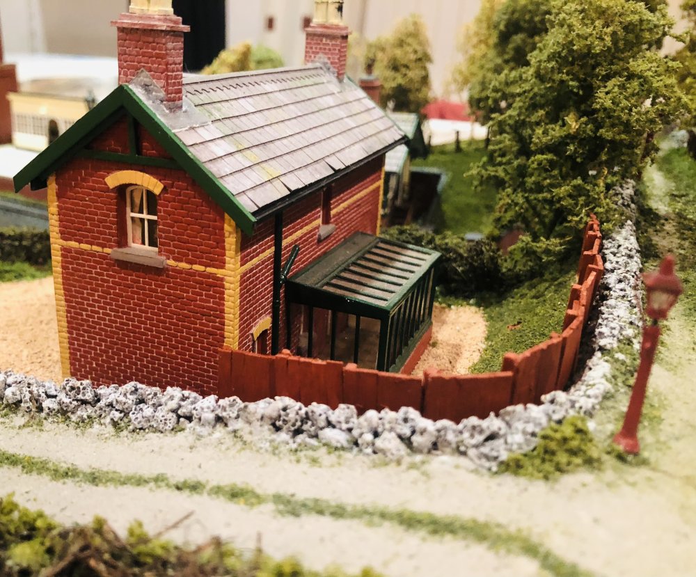

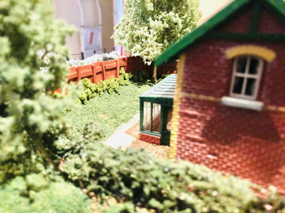

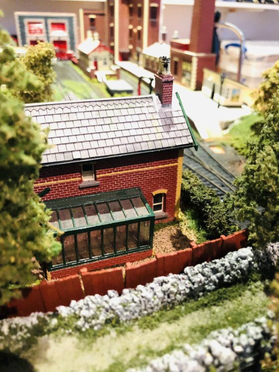

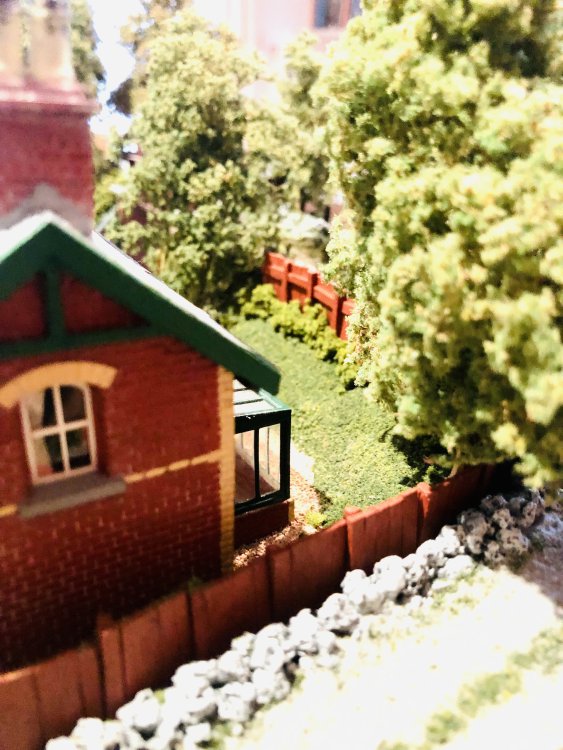

Patrick Davey Posted October 15, 2022 Author Posted October 15, 2022 That's the fence bedded in, and a very rapid-growing tree has appeared above it! 10 2 Quote

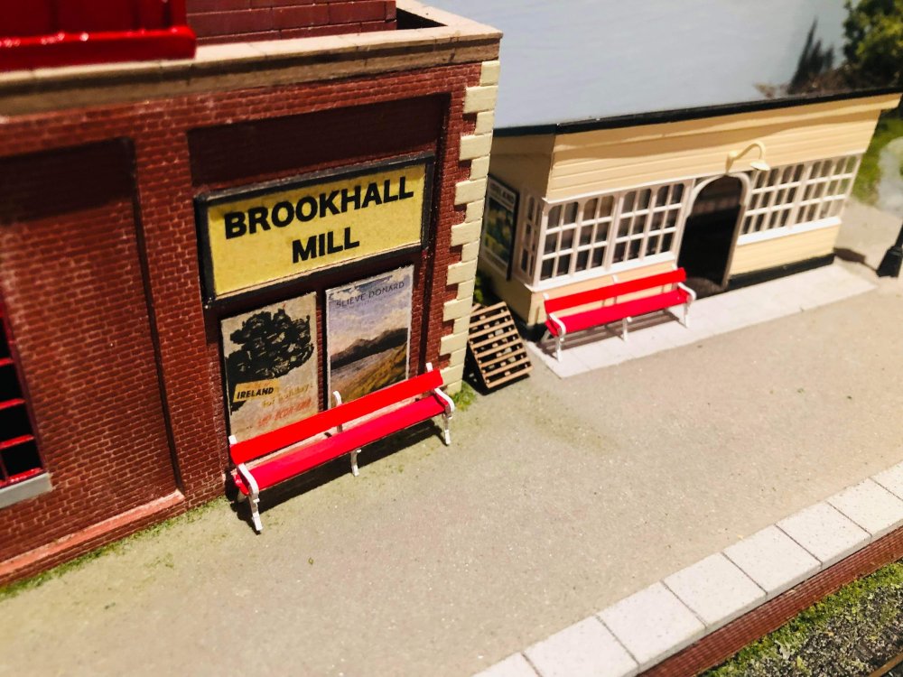

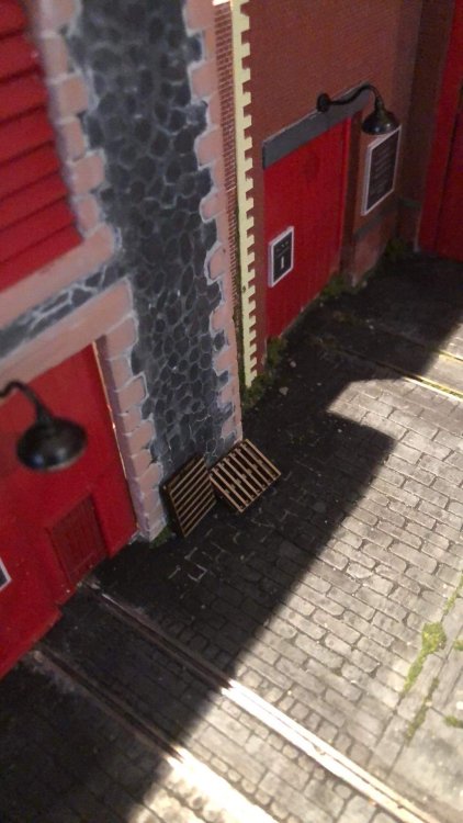

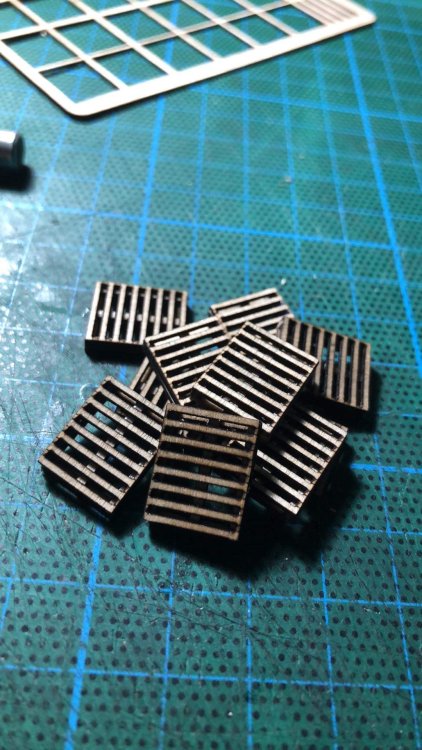

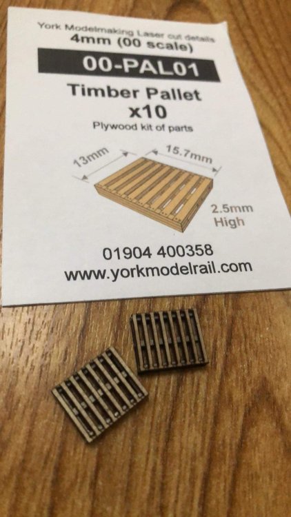

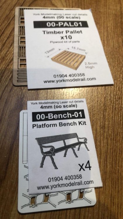

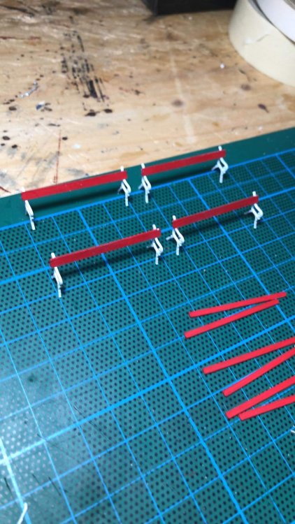

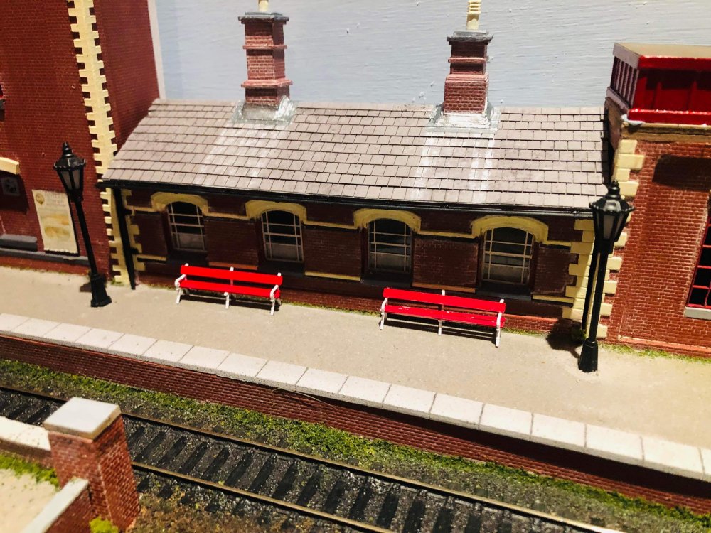

Patrick Davey Posted October 19, 2022 Author Posted October 19, 2022 (edited) Some goodies arrived today from the fine folks at York Modelmaking: The pallets were easy enough to knock together and being made from plywood, they already look correct! The platform benches were NOT easy to assemble, very fiddly and it was a classic case of one's fingers being stickier than superglue. I painted the 'wooden' parts red first and left the 'iron' parts white. Maybe the red is too loud? More goodies on the way too, to help further develop the insanity side of things....more characters to create crackpot scenarios with...... Edited October 22, 2022 by Patrick Davey 9 Quote
popeye Posted October 20, 2022 Posted October 20, 2022 I love those benches, they really look the part. 1 1 Quote

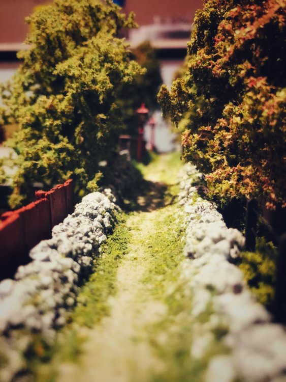

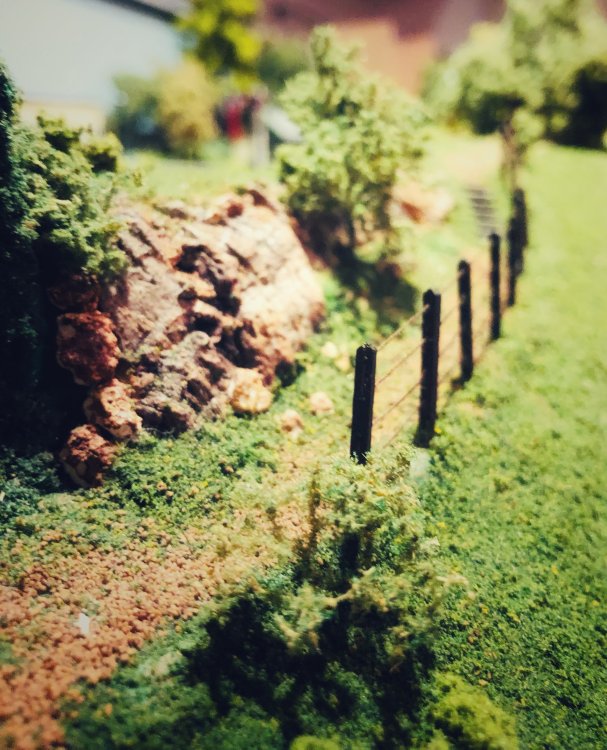

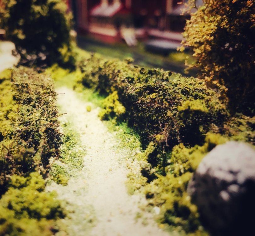

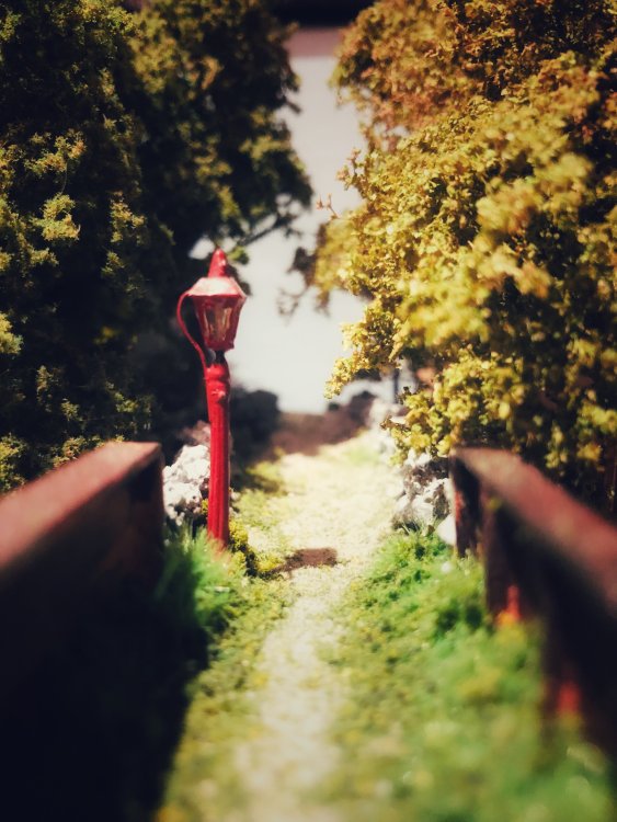

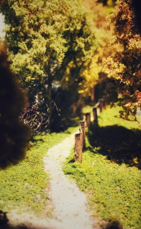

Patrick Davey Posted October 20, 2022 Author Posted October 20, 2022 Mr. Weaver is always concerned for the health and well-being of his staff so he always encourages them to take time to explore the lanes around Brookhall Mill 8 2 Quote

Noel Posted October 23, 2022 Posted October 23, 2022 (edited) On 20/10/2022 at 10:12 PM, Patrick Davey said: Mr. Weaver is always concerned for the health and well-being of his staff so he always encourages them to take time to explore the lanes around Brookhall Mill OMG the visual story telling is sublime. Master piece. Edited October 23, 2022 by Noel 1 1 1 Quote

Robert Shrives Posted October 29, 2022 Posted October 29, 2022 Great work, just to say the Yrk modelmaking benches are lovely and the 2mm version very fiddly ! Robert 1 1 Quote
Patrick Davey Posted November 1, 2022 Author Posted November 1, 2022 I wasn’t happy with the colour of the benches so I repainted them grey and also found an ideal use for the extra bus destination blinds which I had for my GNR buses. Also picked up some handy flower tufts at the show yesterday so I quickly knocked up a planter for some of them from matchsticks, to replace the one which used to sit on top of the air raid shelter. 8 Quote

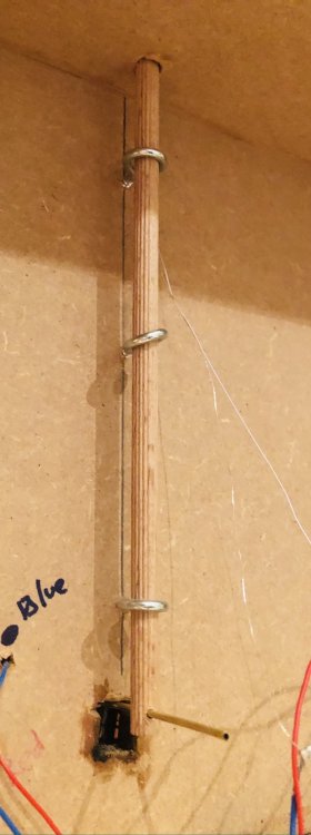

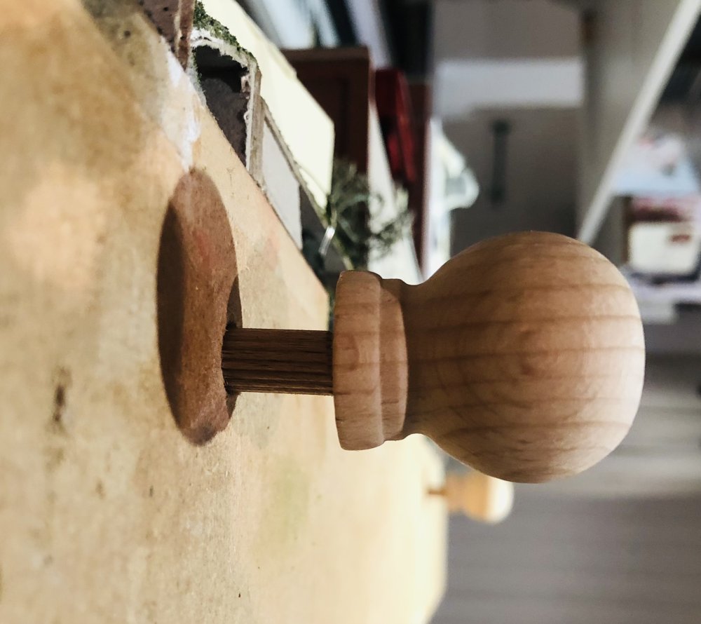

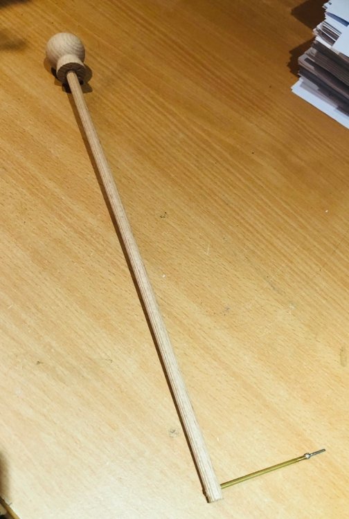

Patrick Davey Posted November 15, 2022 Author Posted November 15, 2022 I had a decision to make regarding the turnout control on Brookhall Mill. There are only three turnouts, and not being electrically-minded, I wanted to keep all the electrics as simple as possible so I was considering some form of mechanical solution. One of my modeller mentors had previously offered to wire the turnouts for me but then with lockdown etc I got impatient and kept building the scenery and buildings etc and thought that this would make it tricky to work on the electrics (I know now that this isn't the case as the baseboard is quite deep and can easily stand up on its side). Anyway I seem to have found a mechanical solution, a bit rough 'n' ready but it seems to be working! An 8mm wooden dowel, with a short length of brass tube inserted at one end which has a 1mm Peco turnout pin soldered inside; a drawer knob at the other end: The dowel assembly is positioned under the layout, after an 8mm hole is drilled in the baseboard side and screw eyes provided: The knob (behave in the back row) is on the outside of the baseboard side: And...... it works! Points.m4v It certainly is rough but it works, and as the three knobs (stop the sniggering) are very close together, they can all be accessed without having to move from the operating position. So the next stage is to set the layout up for a running session tomorrow and to find out if I have destroyed the electrics...... 8 Quote
popeye Posted November 15, 2022 Posted November 15, 2022 It's basically underground point rodding. 1 1 Quote
Patrick Davey Posted November 15, 2022 Author Posted November 15, 2022 4 minutes ago, popeye said: It's basically underground point rodding. Without the voltage! Quote
