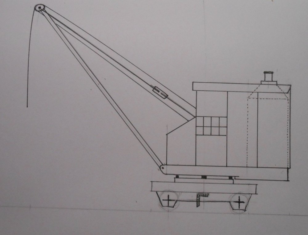

Track laying [mostly] completed today, though the crane track is still to be done and, apart from running a couple of wagons through the points, nothing has been tested yet. I started modelling in EM gauge, progressing through 0n16.5 to 7mm standard gauge and now Irish 5'3 and 3'. Over a dozen different layouts only two have used Peco ready made track, so I ought to know what I'm doing by now, but the trouble is that several years often elapse between building my own, so some of the techniques have to be relearned! As previously mentioned, the basics are fairly simple. You make up a length of 'half track' in a jig, fix that down and then solder the second rail in place using one or more roller gauges. No 'flexitrack' here & mores the pity... Points might seem harder, but in fact you can build one in an hour or two and what's more tailor it to fit your chosen location, rather than relying set formations. This has certainly helped in the restricted space I have available. The main jobs when building a point, once you have set out the sleepers on your plan, using double sided tape, are as follows: Lay one of the 'stock' rails, then make the Vee. These are a bit more trouble with flat bottomed rail, but is essentially just a case of filing two short lengths of rail and soldering them together. Roller gauges are then used to solder the Vee in place and then the second stock rail is added The long switch blades come next and these need a fair bit of filing and shaping. I find it helps to file a small nick in the base of the rail before bending it to go next to the Vee, while alignment at this point really is critical. I use a piece of aluminium strip [about 1.8mm thick] to set the gap at what is called the 'crossing' [or frog] and also to ensure the route through this section is nice and straight. Especially on the Y points, I also find it helpful to file away the foot of the stock rails where the thin end of the blades touch, as this ensures wheels follow the route nice and smoothly. The main task today has been laying the track over the baseboard join. With only one of these on the scenic section and only two tracks involved, there is no excuse for errors here! I used my usual method of countersinking cross headed screws in the end boards, then laying the track across the join and soldering it to the screws, before cutting the rails to separate the boards. A lot of cleaning up followed, to get rid of the flux & then came the slightly tedious job of cutting the insulation gaps in all the sleepers. So, ready to start on the wiring now and then it will be a case of cross everything when it comes to testing to ensure all my stock will run on the new layout. Logic says it should be ok, but experience suggests otherwise!

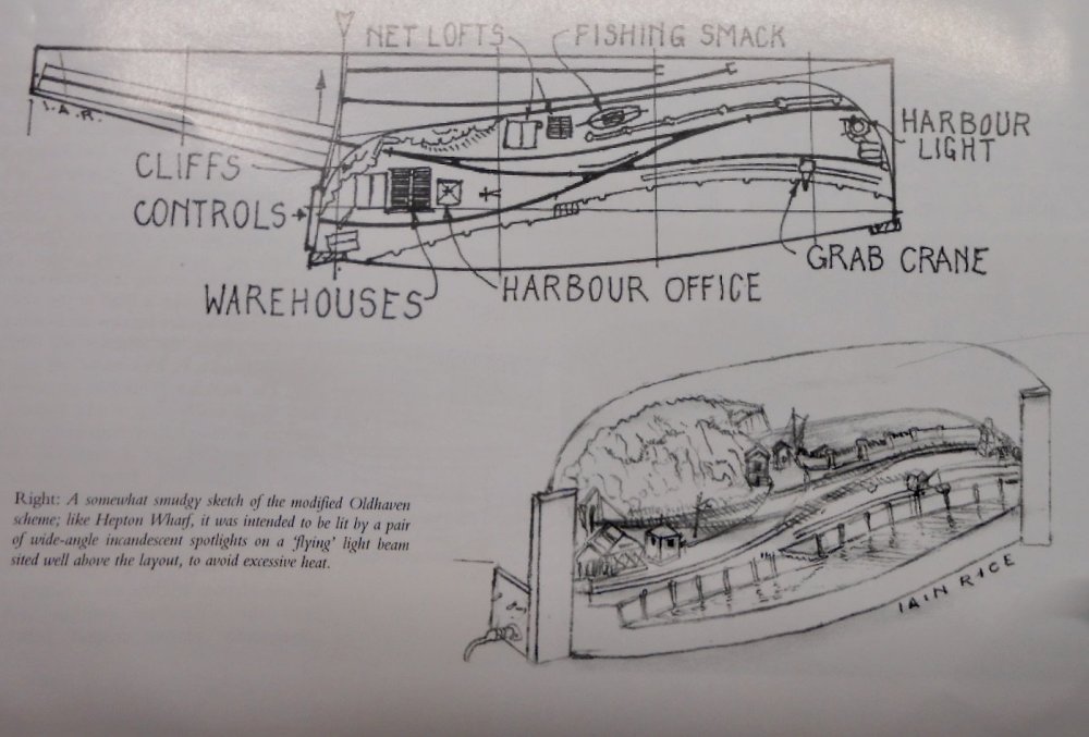

Sounds great to me! The concept is just that little bit different, yet eminently achievable. As I discovered with Fintonagh, you don't need a huge space to create a layout that is interesting to operate, while Iain Rice and Chris Nevard, the gurus of cameo layouts have long proved how much enjoyment can be had in modelling a small space really well. Already clear I am not alone in looking forward to seeing this one develop.
