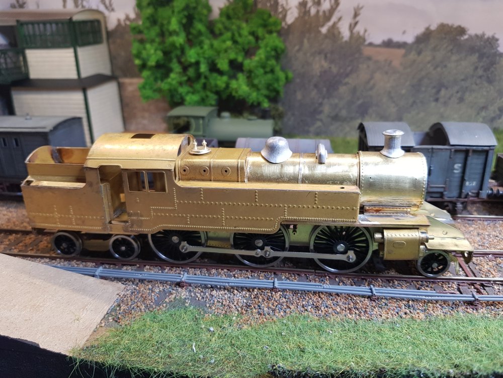

	Thanks @Galteemore, I suppose given my journey so far, I can provide some insights..... MGWR110Bat, I model in 21mm and as it happens P4. I agree with Andy regarding P4 vs EM - you do not have to jump straight to P4. As noted P4 flanges and tolerances are much tighter which does take time to get right. As to your model, I would hazard that it is a TMD kit originally released in 1981 which was the building blocks for the Studio Scale Model (SSM) version. I built one of the TMD versions, but built it as 560 as used on the Tramore line - my area of interest is the DWWR / DSER / GSR. To provide some additional information on your questions: 1.) Where would be a good place to start sourcing some suitable axles for 21mm Stock? Either make your own as Andy suggested, or split the axle and sleeve with 2mm ID brass tube, or shop with Scalefour society shop (https://www.scalefour.org/stores/stores.html) 2.) Has anyone tried regauging 16.5mm stock to 21mm? What was required and how did you go about doing it? I generally build my own locomotives and stock so don't have much experience. I do know modifying steam locomotives is difficult as there is insufficient space in the splashers to allow the wheels move out. 3.) Any recommendations for sourcing further M&GWR and GNR(I) locos and rolling stock from the latter part of the 19th Century through to the 1920s? There is not much out there for MGWR - @Mayner does some models kits in brass, and @leslie10646 does quite a few kits for GNR. My stock https://irishrailwaymodeller.com/forum/65-kmce-models/ is mainly DSER for now. 4.) Unrelated to the M&GWR, but anyone tried converting a Hornby 4P tank into a UTA 'Jeep' in 21mm or is that a stretch too far? The Hornby 4P can be converted to a lookalike and others have done it. As mentioned by others Worsly Works do some etches for the Jeep, but they are really scratch aids and need a lot of work to develop to a running model. I am building one (now and again) and it has proved to be quite a task. With regard to building track and points in 21mm, the traditional route was ply and rivet with the necessary gauges, again all available from Scalefour shop, however with improving technology, 3D printing is getting closer to being mainstream. Straight track in any methodology is quite simple and straightforward, points take a little more effort. I have been dabbling with the 3D printing route, but started with the ply and rivet method - 3D printed version is so much quicker! This is a mix of ply and rivet and 3D printed - older finished track is ply & rivet, and obviously new point and headshunt is 3D printed. One thing to bear in mind is that 21mm track needs quite a bit more space- points are longer than mass manufactured versions. Top point is 21mm B6 point, while bottom is Peco short point for reference. Hope this is of some assistance. Overall 21mm is a challenge, but well worth the effort. Good luck with your venture either way. Ken

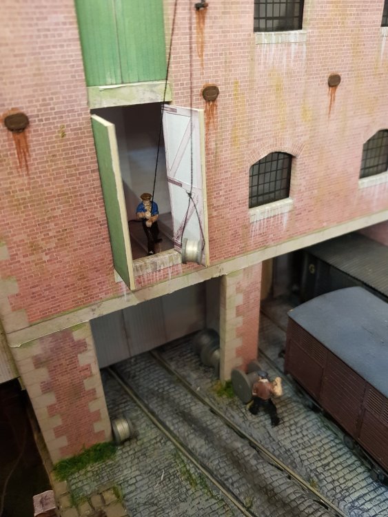

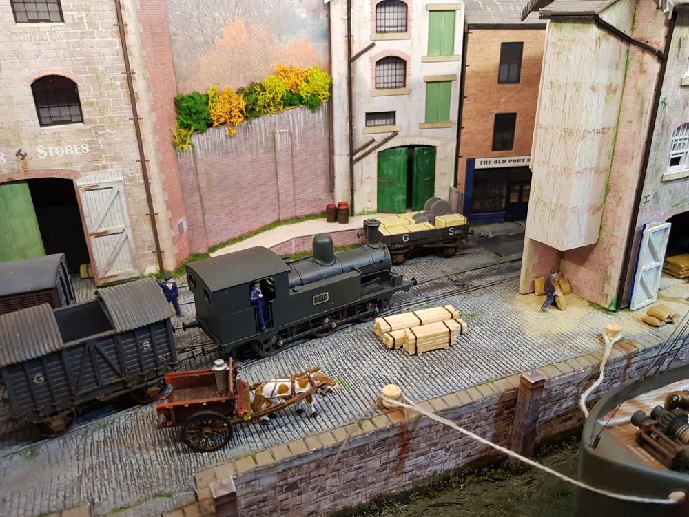

	Finally got round to doing some work on the wire ropes company building & accessories. Some 3D printed cable drums full ready for shipping and some empty drums coming back with a delivery of timber for the timber store. Timber bales were also 3D printed in various sizes. Timber store really needed some timber, some bales were added for interest. Busy docks.... Some work to get those drums back in place - can't beat the leverage of a long stick. That other wall hoist is getting some use after a few tweaks. Some empty cable drums coming back to the port with a delivery of timber for the timber store. Happy with how this is coming together with some good interest to flesh out the scene. All for now. Ken

	Little bit of work on the layout. Some fine 3D printing allowed me to add some wildlife to the scene. First up, a few ducks to bother the skipper of the Galway Hooker - got any bread???? And no port would be complete without the ubiquitous seagulls, or in this case seagull. Very fine print and only one of the models came away intact from the supports. Need to re-visit the supports and run off a few more. Some sitting gulls needed for the rooftops to complete the look. More as time and energy permit. Ken

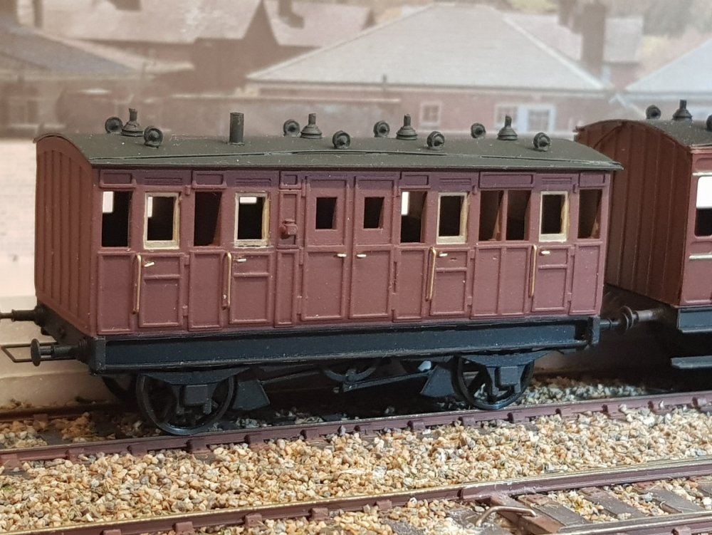

	  Two Axel Coaches in Ireland?KMCE replied to Auto-Train Original's topic in Photos & Videos of the Prototype There is also the 1878 Metropolitan Carriage Works 21' 6" 4-Wheeled Third Brakes operated on the DSER line. As far as I know there were at least two and were in use on commuter trains between Dublin & Bray. Both appear to have ended up being used by the loco dept. in their later lives. Quite small overall, and noticeable in the lack of tumblehome and narrower loading gauge than standard Irish stock. Ken

	First of all, many thanks for the heartfelt good wishes, they are much appreciated. My treatment is going well and in time I should be back fighting fit. In the meantime, I have been doing a bit of detailing on the port layout and some additional figures arrived from Dart Castings which helps to populate out the layout somewhat. The drifter needed quite a bit of work with wheelhouse painted to brighten up the look, the lifeboat finally covered, hatch opened and stocked, some mooring lines, etc. The Galway hooker got some weathering and stocked with some goods for market from the islands. Some additional figures help to add to the business of the port. That poor guy on the hoist finally got some assistance! Unloading grain from ship in the day was a manual and laborious process, but it's got to get done, and the gaffer is keeping a good eye on progress. Back to the milk run from the island - the man from the creamery cannot be overly pleased with having to lug those churns up the steps to his cart. "And now he wants me to take the empty beer barrels to the pub for refilling!" Anyway, all for now, more when time and energy allows. Ken

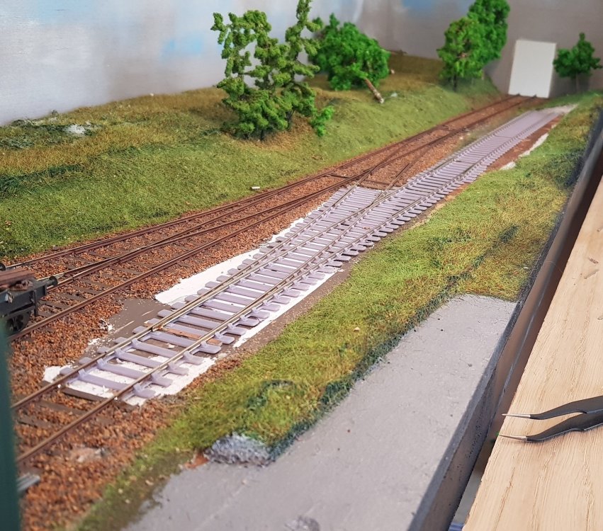

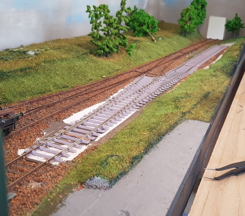

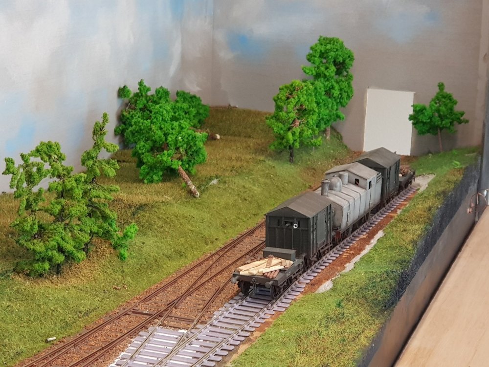

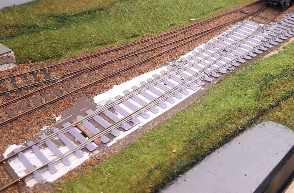

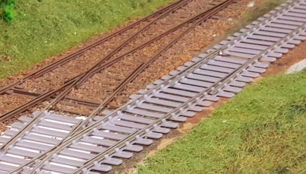

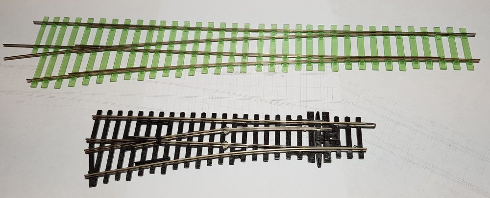

	The layout was out at the last Bray fair, however it proved somewhat limited in operation, so I decided to add a headshunt which will provide more operating possibilities, plus more space to show models. The existing points were A6, so an A6 point was printed off and made up with some straight lengths for the headshunt itself. Existing track was cut and new rails modified to match the divergent rails from the incoming point. Straight track added to provide space - scenic section needed to be cut back a little, which should provide a nice detail when dressed down to the track level. Nothing fixed down yet - just needed to check all is working and stock moves freely in all directions. What looks like a wobble in the straight track is a catch point, basically made up of the leading section of the point print. All working fine so I can get on with fixing down, painting and ballasting. But in the interim, a quick shot with the armoured train. All for now. Ken

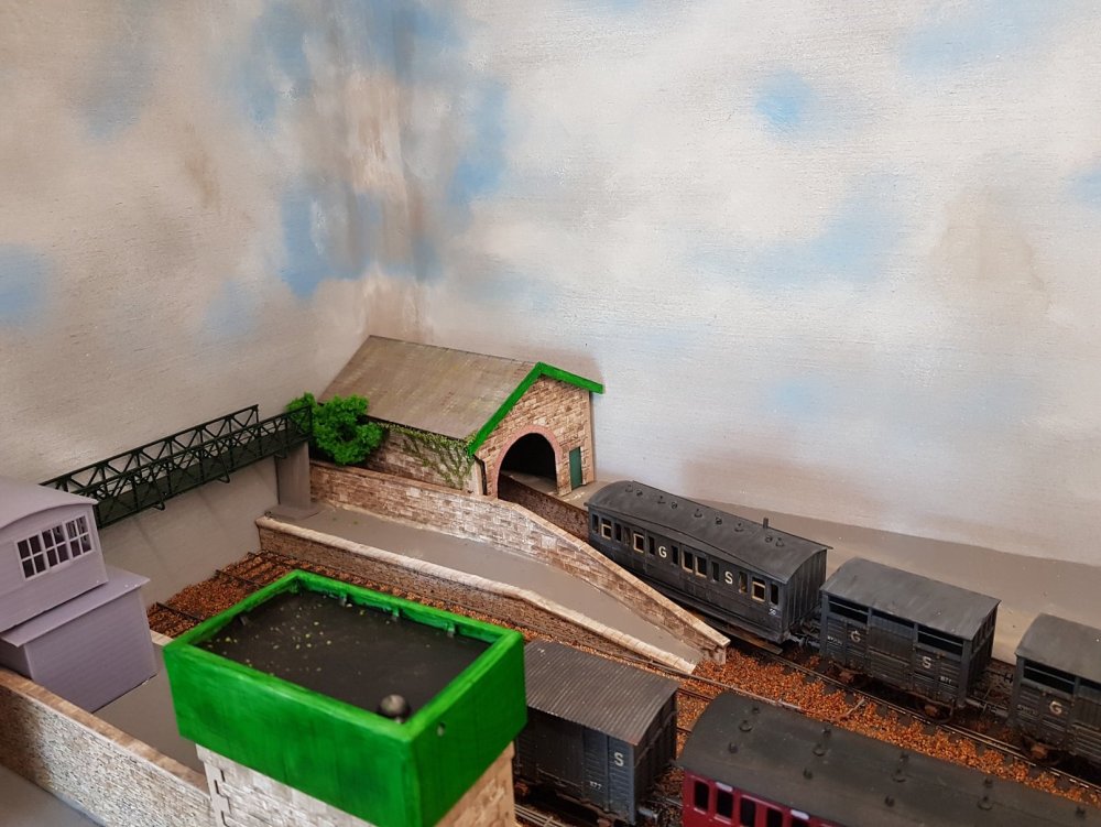

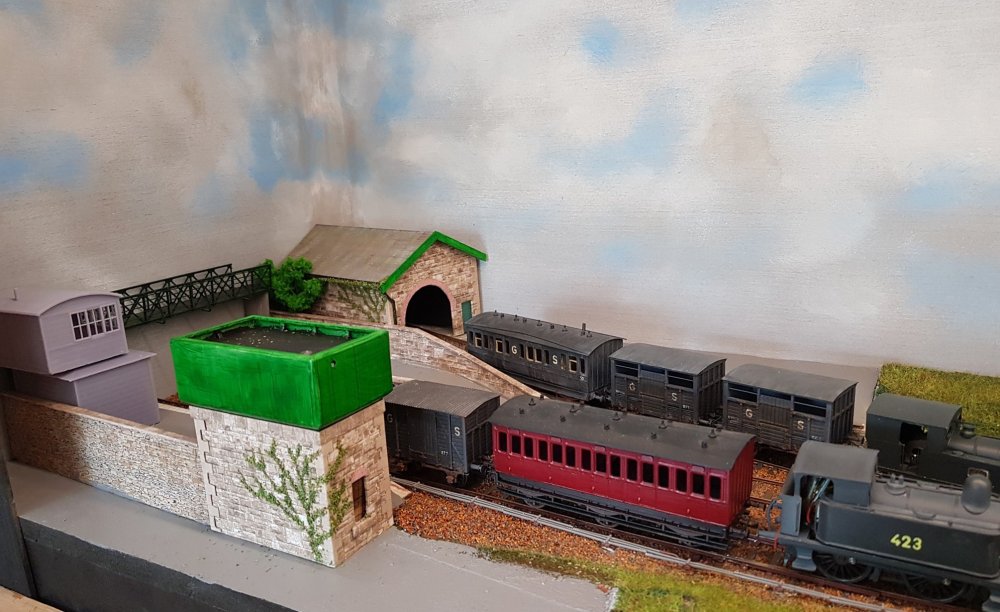

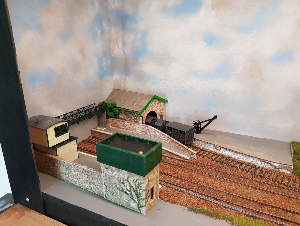

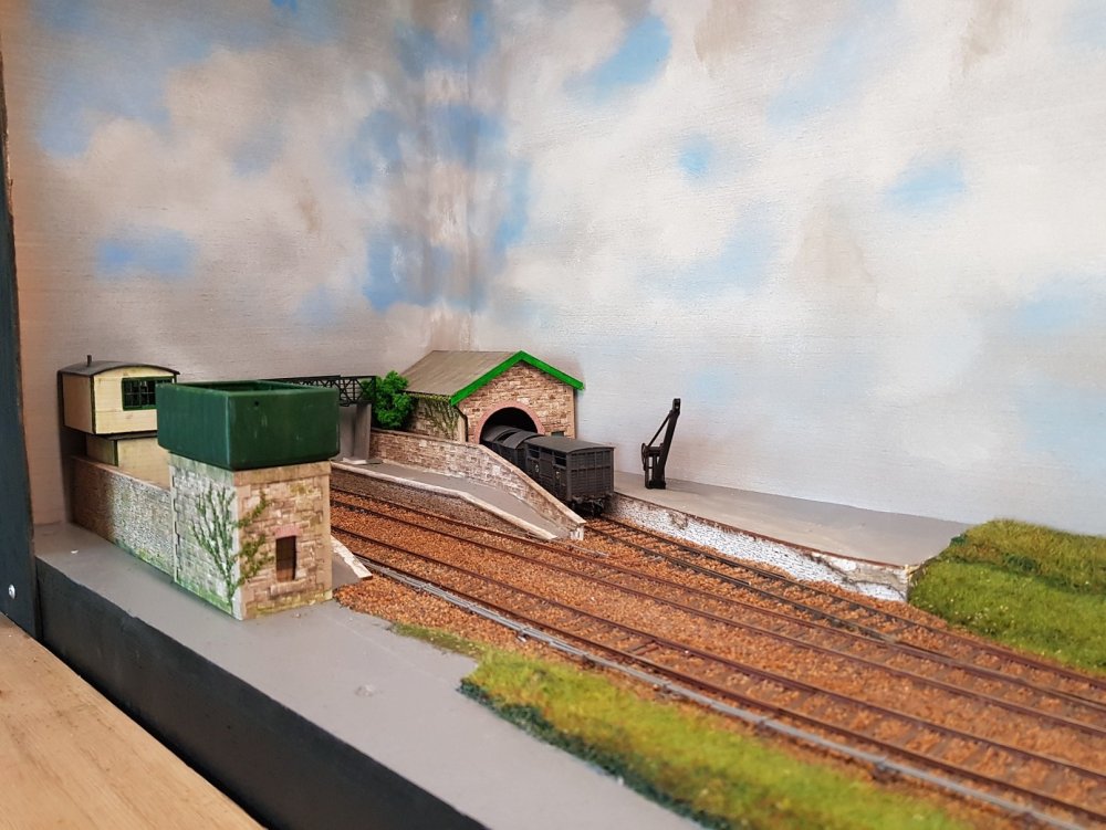

	Little bit of progress. Water tank painted & slightly weathered. Signal box painted, weathered & planted into the layout. Yard crane installed on the platform - hook & weathering needed to blend it in. Goods platform wall will need to be redone - it picked up moisture when I was doing the ballast. Not a big one, but needs tidying up. All for now.

	Actually I couldn't - the sharp corner in the sky was just distracting, so a bit of filler & painting, those corners are softened which helps to focus the eye on the models themselves. So progress on the layout included track ballasting and some weathering on the goods shed & water tank. Points have have also been connected and are manually operated via wire in tube - so now the layout is operational & trains can trundle up and down! All for now!

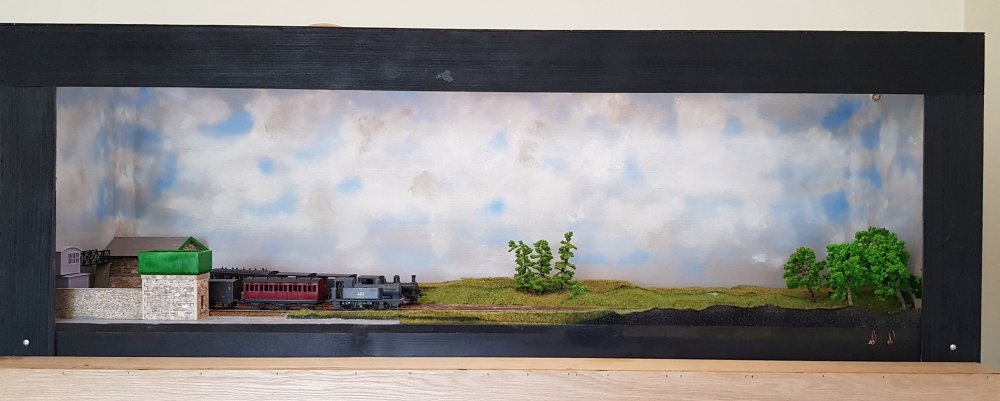

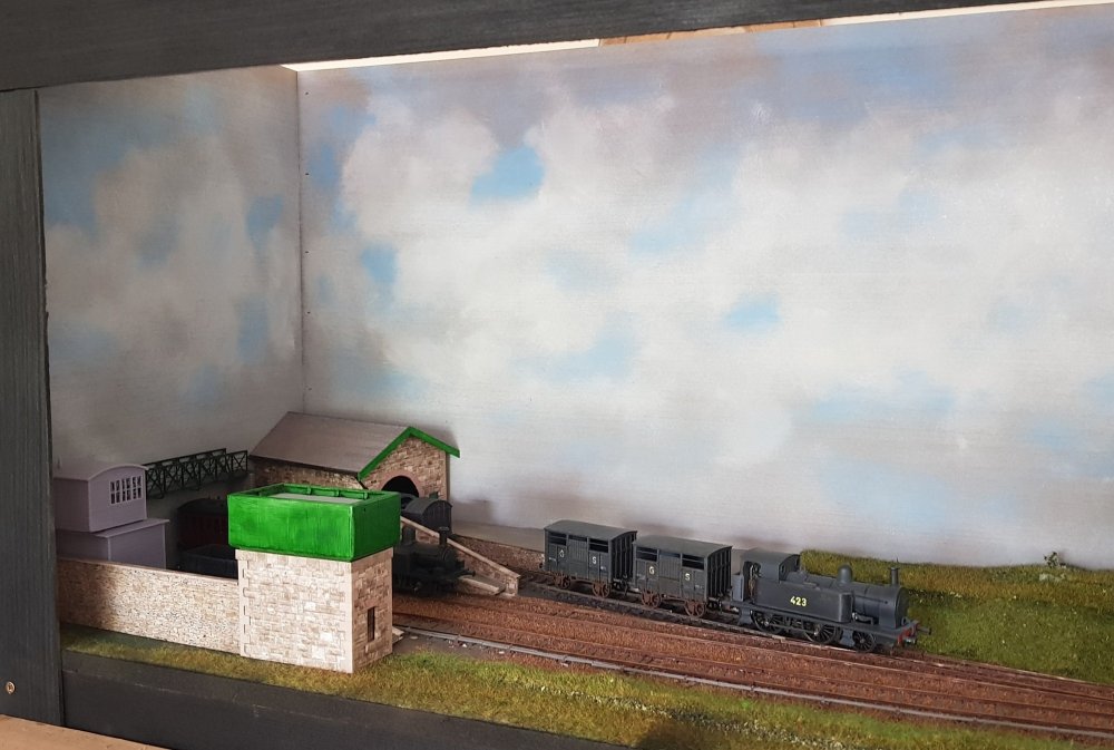

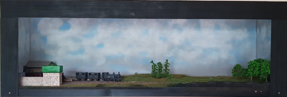

	So, Layout in box. Some 4mm plywood with MDF bracing to help hold it together. Bit of black spray paint for the outside and some sponge painting on the inside. Corners are not ideal. but as a moveable layout for display, I can live with it. Need to get some lighting installed as it's gotten quite dark over the layout. All in all it's starting to come together now.
