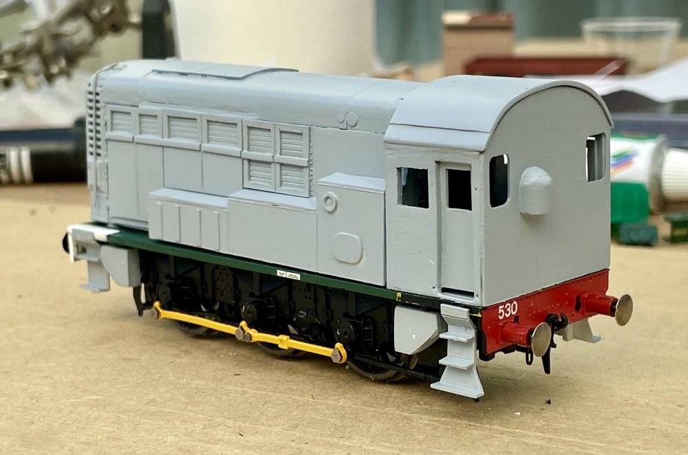

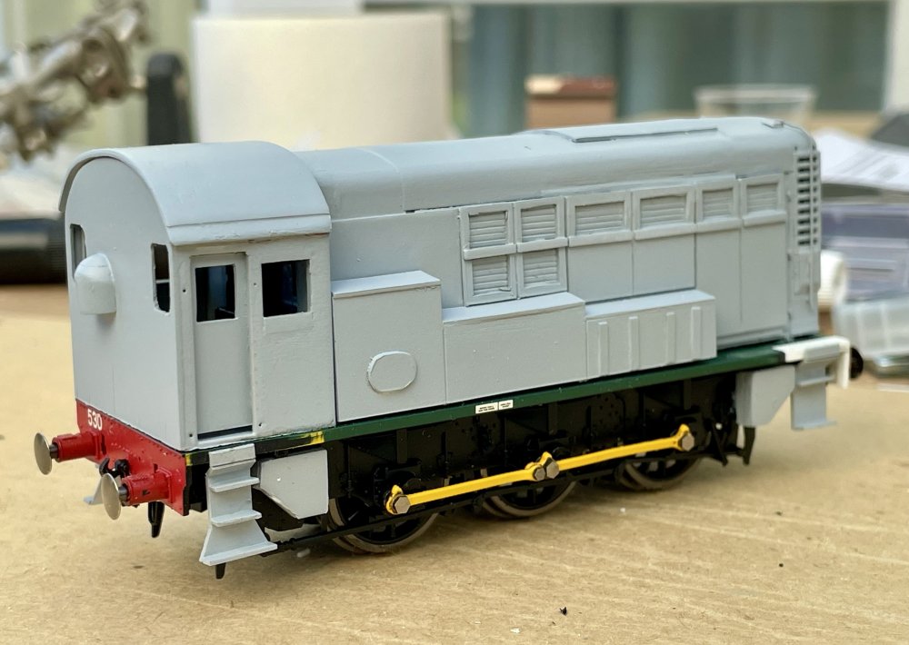

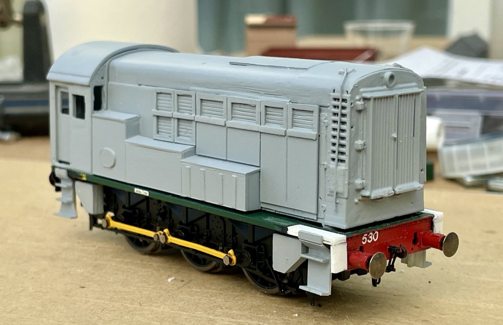

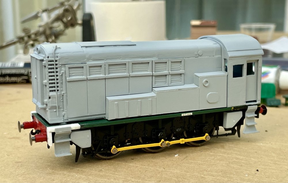

Started yesterday afternoon.

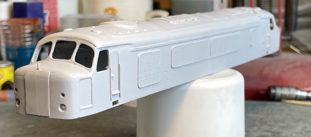

Bodyshell assembled and joints filled.  Hornby chassis modified to fit.
Some filling and fettling later…
The fit of the headcode box leaves a lot to be desired…
So out with the Dremel…
Some more filling and fettling later…
Cheers
Darius

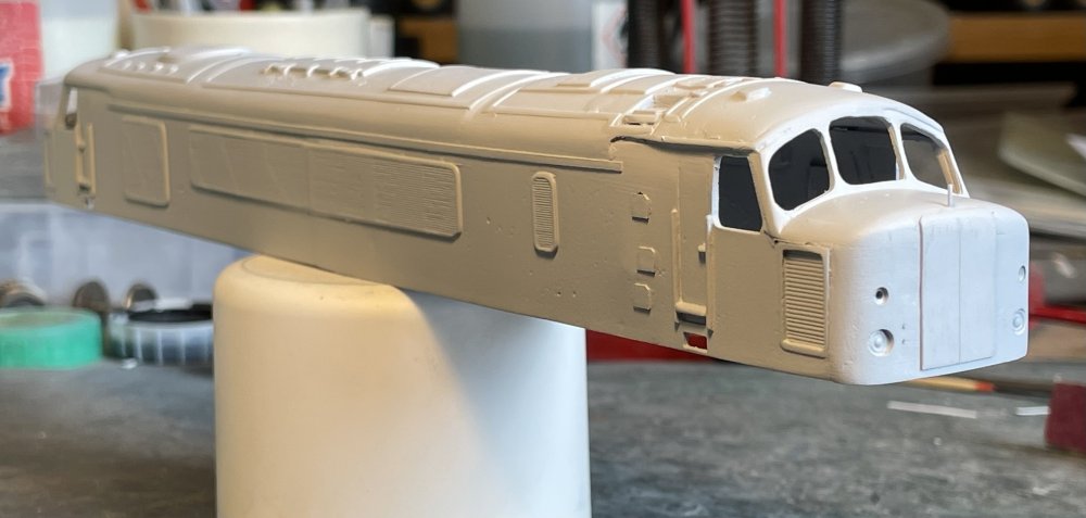

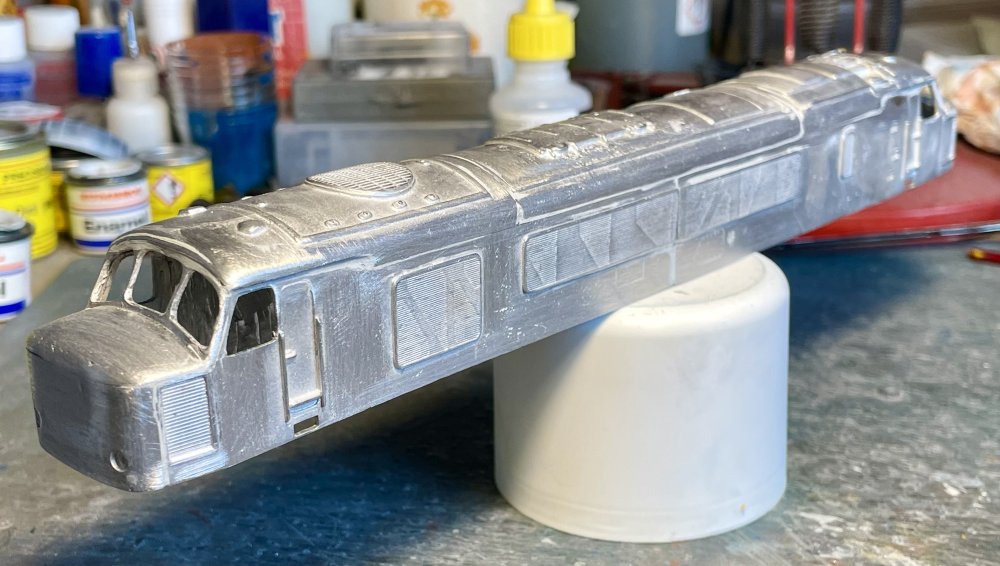

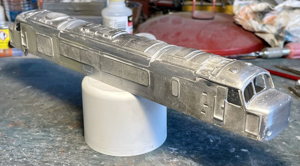

Started yesterday morning.  Plan is to use a heavily modified Lima Class 40 chassis with new wheels from Peter’s spares.
Bodyshell parts cleaned up.
The kit is missing the distinctive split headcode boxes but I have some spares from an MTK Class 45 that can be made to fit.
Bodyshell assembly - always worth checking that both sides are the same length…
Plastic shims added to the shorter side…
For stability and strength I added the MTK cast central “box”.  This means that each bogie will need a separate chassis rather than one common chassis.
The roof parts were fitted in turn working from the cab ends towards the centre.  The large central part needed to be trimmed and ground down using a Drexel so that it sat flush with the other roof parts.
Lima Class 40 bogies modified to accept the MTK cast sides.
The fit of the nose ends is best described as appalling.
Filling and fettling next - a lot of filling and fettling.
I cracked open a new tube of filler, which, being new, was a bit more “fluid” than the old one…
I taped over the grilles and doors prior to  applying the filler to protect them from being filled and then removed during the sanding process.

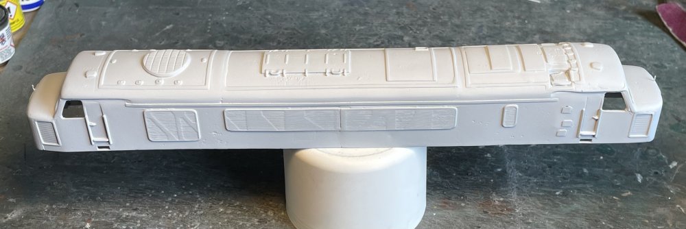

Whilst awaiting the arrival of a chassis for the Class 44, I thought I’d get this part completed (by someone else) MTK example up to the same level of completion as a Class 46.
Some disassembly required…
Disassembled.
Reassembly completed along with joint filling.
Dunprimin.
Dunpaintin…again.
Cheers
Darius
