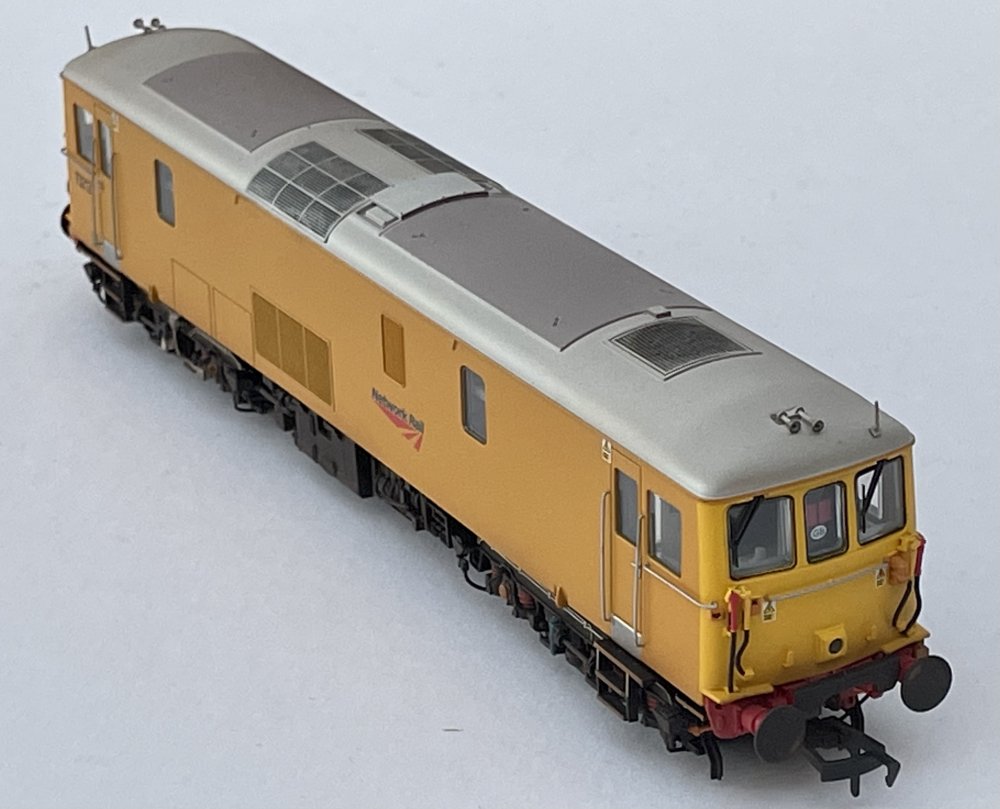

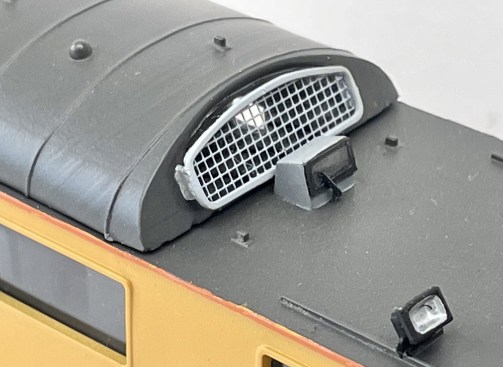

On 9/9/2022 at 7:18 PM, Darius43 said:
Light roof weathering applied.
Cheers
Darius

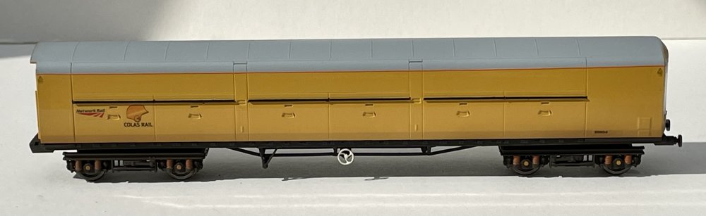

Give it a bit more, don't be afraid of it :) especially around the exhausts.

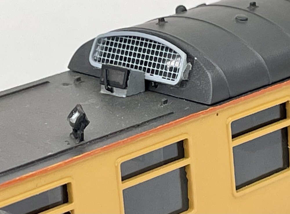

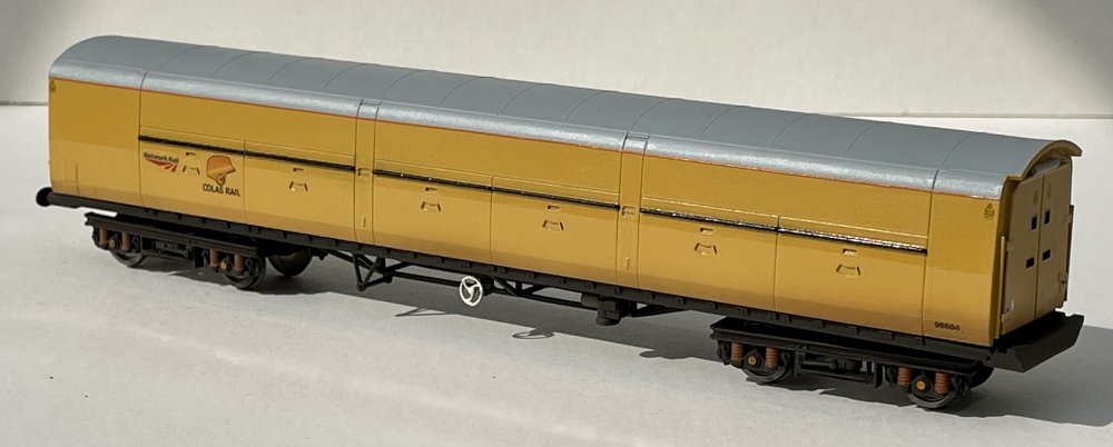

3 hours ago, Darius43 said:

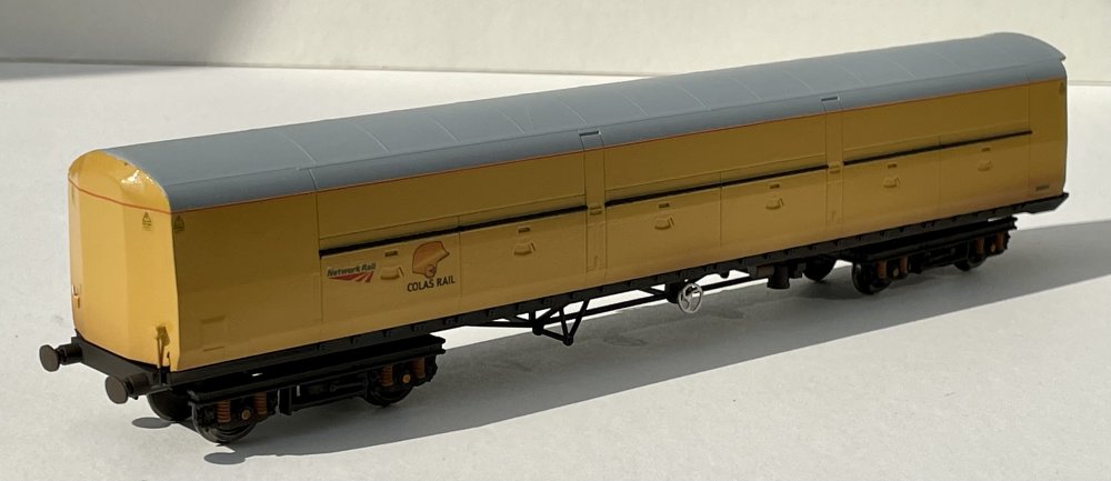

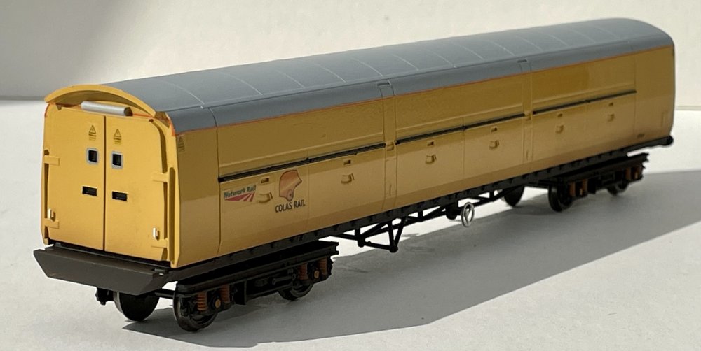

Additional painting, details and weathering to complete the NVA (apart from couplings).
Cheers
Darius
What was this wagon for?

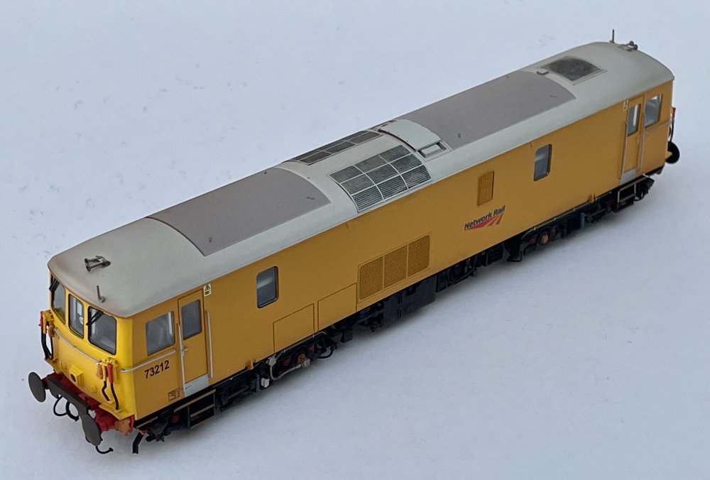

I looked at photos of NR Class 73s and they don’t appear that dirty even around the exhausts.
The NVA is used as a brake force runner.
Like a lot of NR liveried stock, launched in a blaze of glory to spend a lot of time lying around the place. The only 73's NR have in use now are their 2 Minions - the rebuilt 73/9's

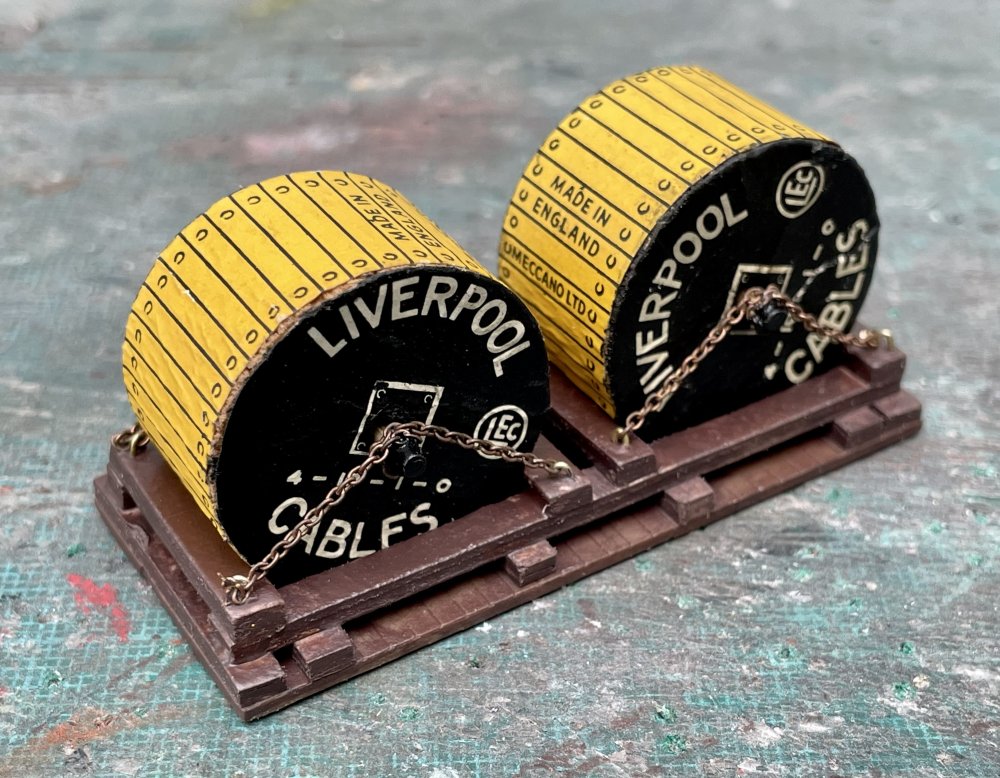

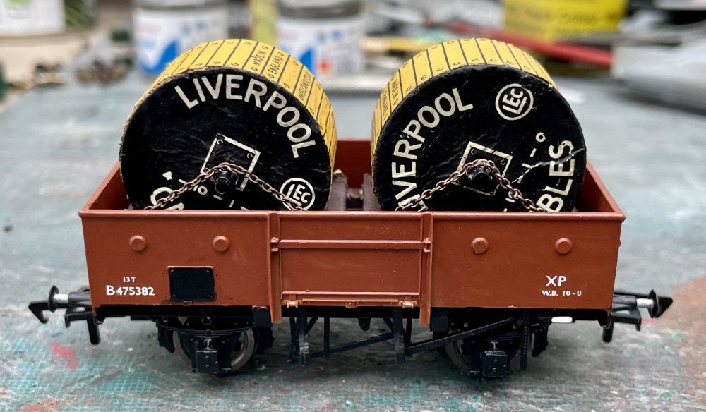

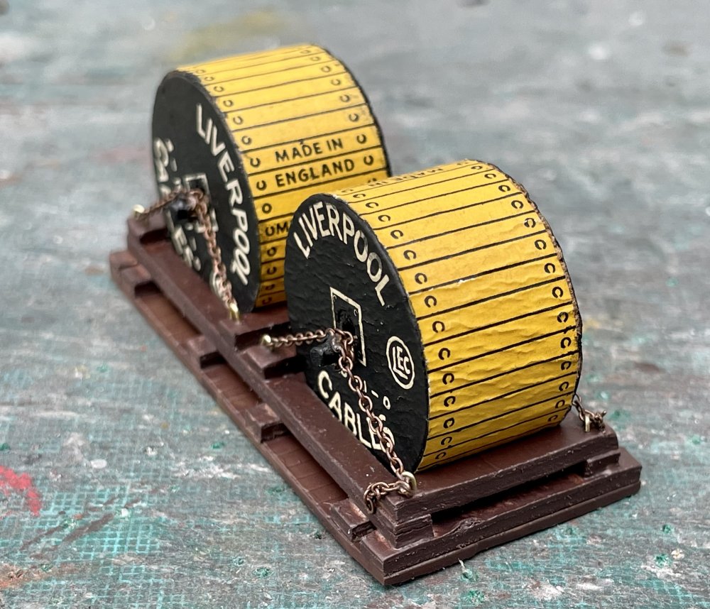

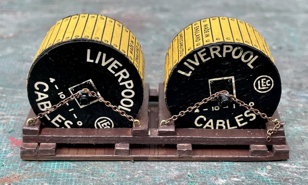

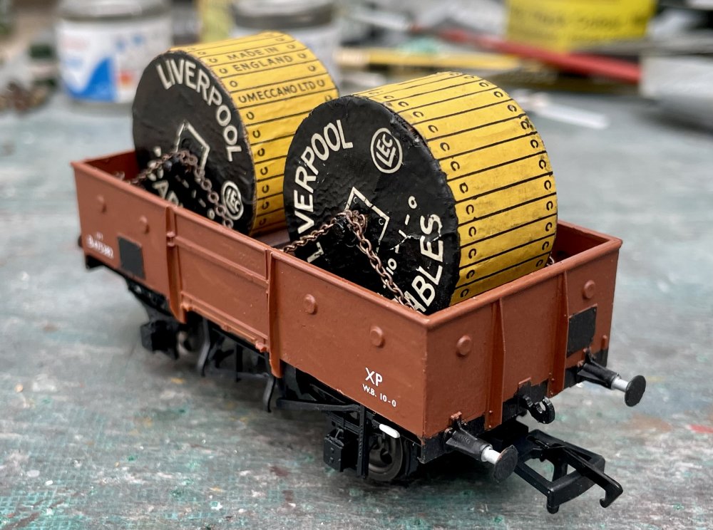

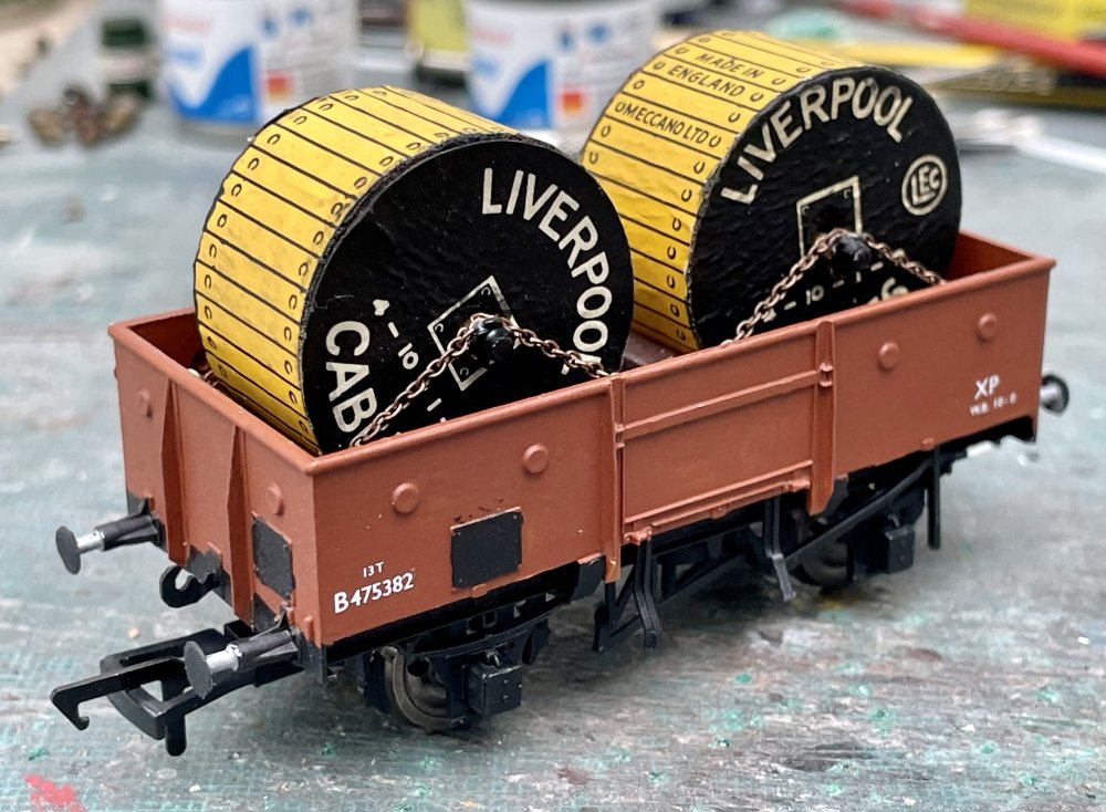

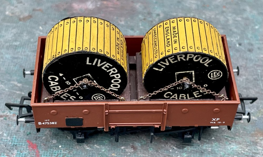

Two of the remaining few bits in the box were these cable drums.  I built a “timber” support cradle using cardboard and fine chain to create a wagon load.
And installed in a wagon (Parkside Kit).
Cheers
Darius
Edited by Darius43

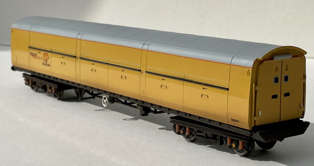

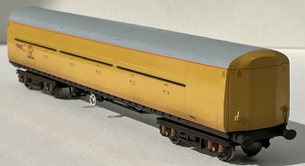

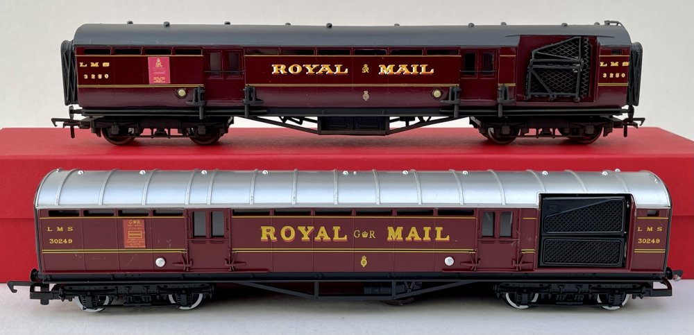

Major refurbishment of the 1970s era Hornby LMS TPO coach into something less toy-like and more presentable.
Coach disassembled.  Only the chassis and body will be retained - the operating gear, coach ends and glazing will be discarded and the bogies will probably be replaced.
Bodyside and roof moulded details carved away and sanded down.
Cheers
Darius
Amazing how the addition of some bits of detail can really lift and transform a model. This was what so many skilled modellers had to do years ago with basic RTR products - nice to see the old ways on show here !
Painting completed.
Original Hornby bogies temporarily re-fitted.  Looks like it is sitting too high on the bogies - replacement Bachmann LMS bogies will be fitted.
Cheers
Darius

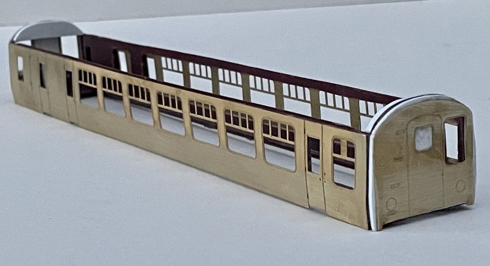

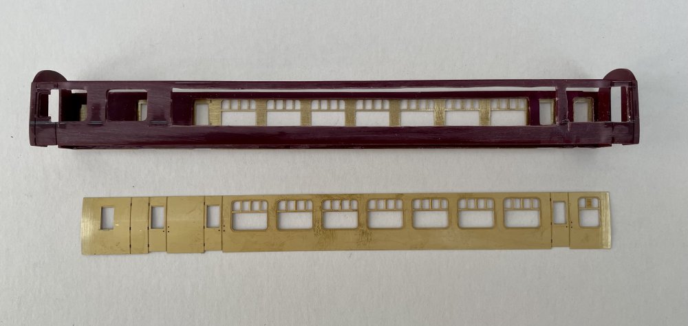

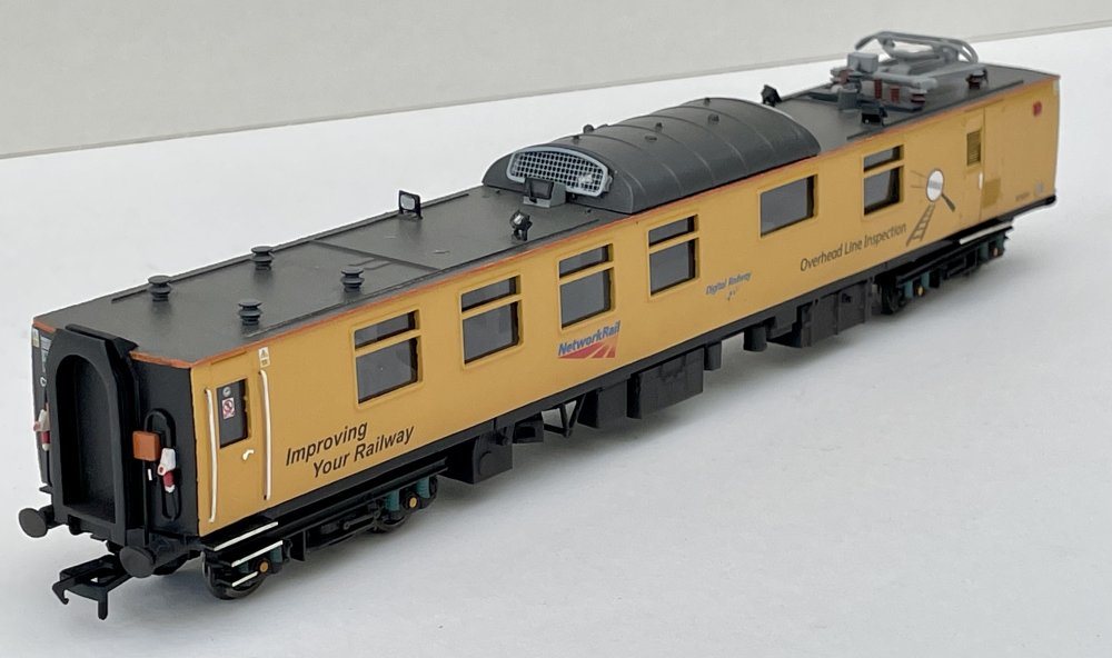

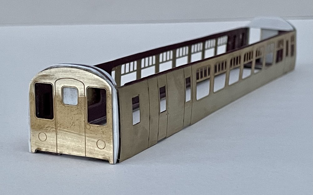

It’s MPD time!!!
Construction commenced using a Dapol 60’ LMS coach as the base model.
The, interior, glazing, wheels and couplings are discarded.
The raised detail on the roof and coach sides is removed and sanded down.  The moulded coach floor is removed apart from at the ends.
Etched sides removed from the fret and offered up to the coach body.  The etched sides are longer than a scale 60’ so I trimmed 3mm off each end to make them just shorter than the Dapol coach.  This allows the ends to be sanded round.
Cheers
Darius
Edited by Darius43
  • Like 6

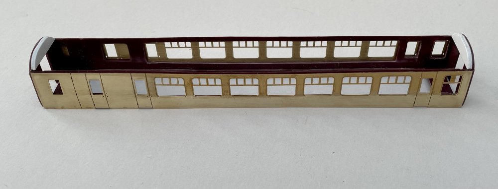

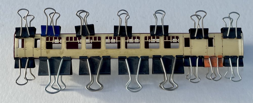

Holes cut in coach bodyside to enable flush glazing of new sides.
Sides glued to coach body.

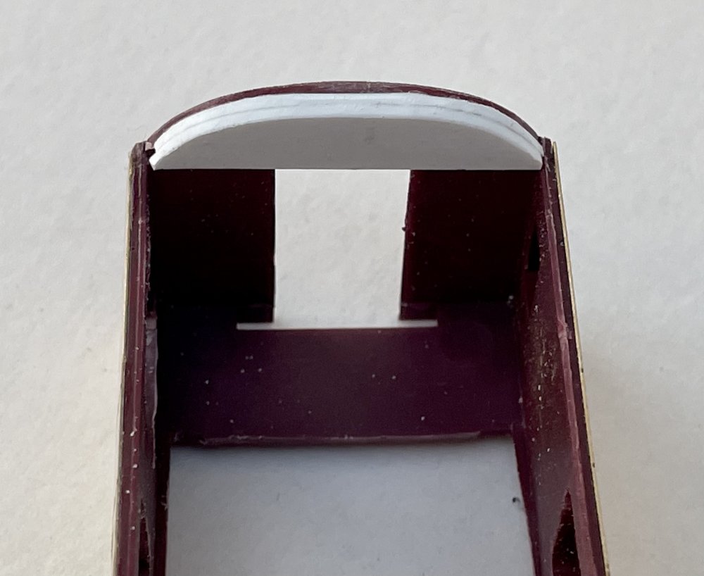

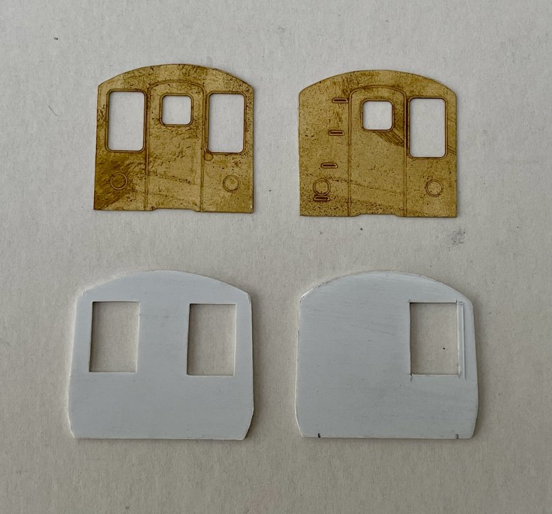

Etched cab ends laminated to 1mm thick plasticard.
Coach ends “thickened” at the roof joint to enable a rounded roof profile to be sanded.
Sides and cab ends in place.
Cheers
Darius
  • Like 11
31 minutes ago, Blaine said:
Take it these are Worseley Works 'scratch aids' kits??
Yes indeed. I commissioned the sides and ends from Allen a year or so ago.  They are now available on his website.
Roof attached and cab/roof edges filled and sanded round.  Door hinges and handles attached.
The gangways are temporarily attached using black tack.
Cheers
Darius
Edited by Darius43
  • Like 9
