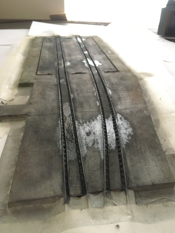

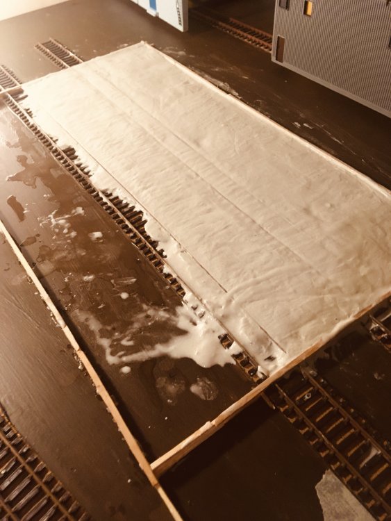

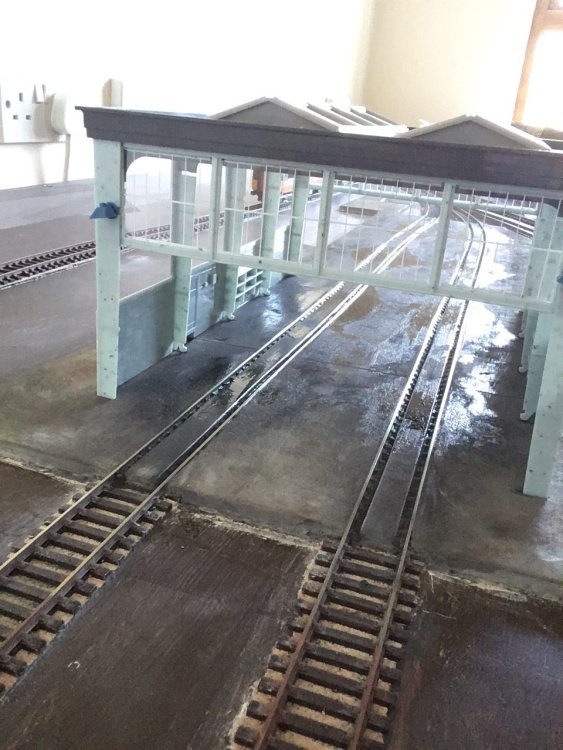

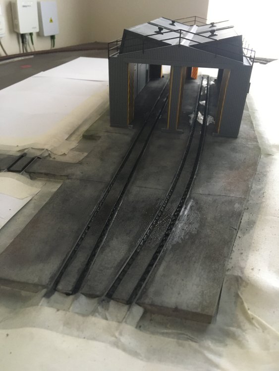

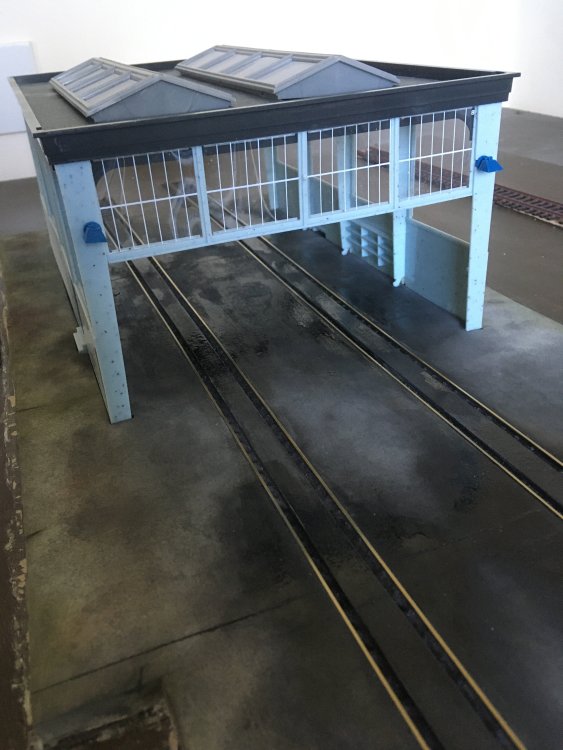

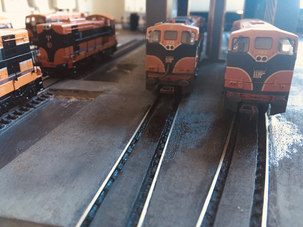

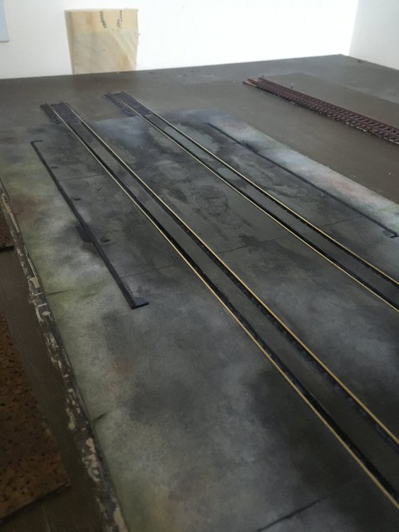

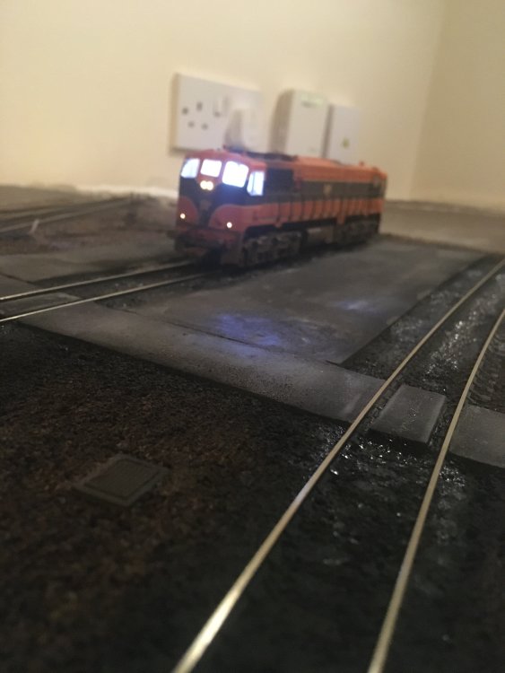

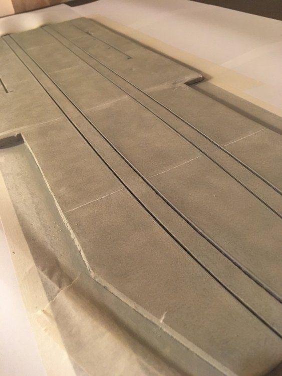

 Love the weathering on the depot floor and intrigued by the DAS clay. Use it myself, but how did you get from the rails being completely covered over to the neat channels in the later photos?
Hey @David Holman, with lots of learning! I cut along the inside of the rails with a scalpel and then used a metal ruler to cut along the channel, then dug it out with the scalpel, then I learned that the channels were too narrow which caught the wheels and I had left the surrounding clay a little too high which bumped them up and broke the contact (this is after spraying :( ). It was fine for stay alive fitted locos but not good on older ones. I had to resand and make the channels wider and respray again (which actually worked out well as the concrete ended up with two different textures). Then after weathering I learned that you gotta clean the inside top of the rails as well, as the locos were depending on that for contact (especially older Lima wheels which are not flat but at an angle). Then I learned not to let the varnish pool too much or it would lift the wheel again as it passed over lol.
So trial and error on the first attempt but once figured out, the second hardstand went much smoother. I'll have a video up soon which shows the technique so will plop a link down here for ya :)

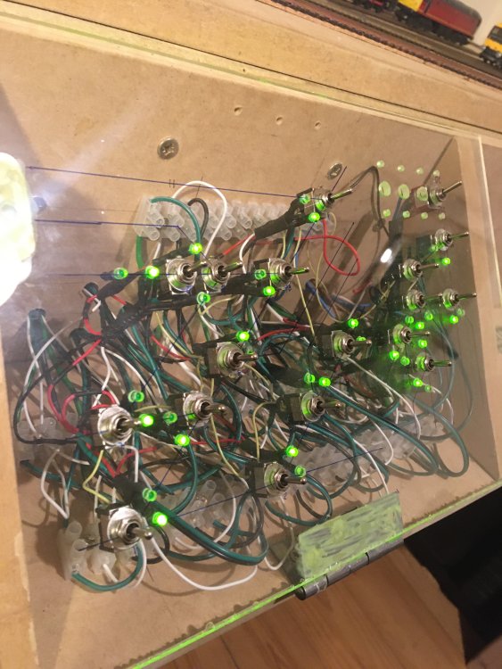

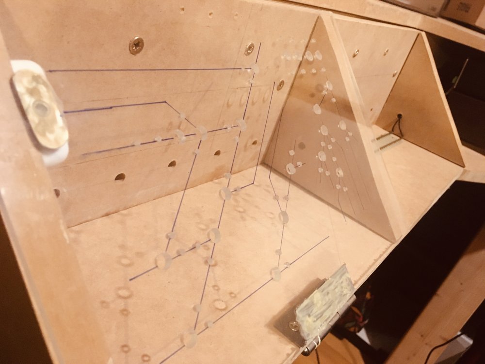

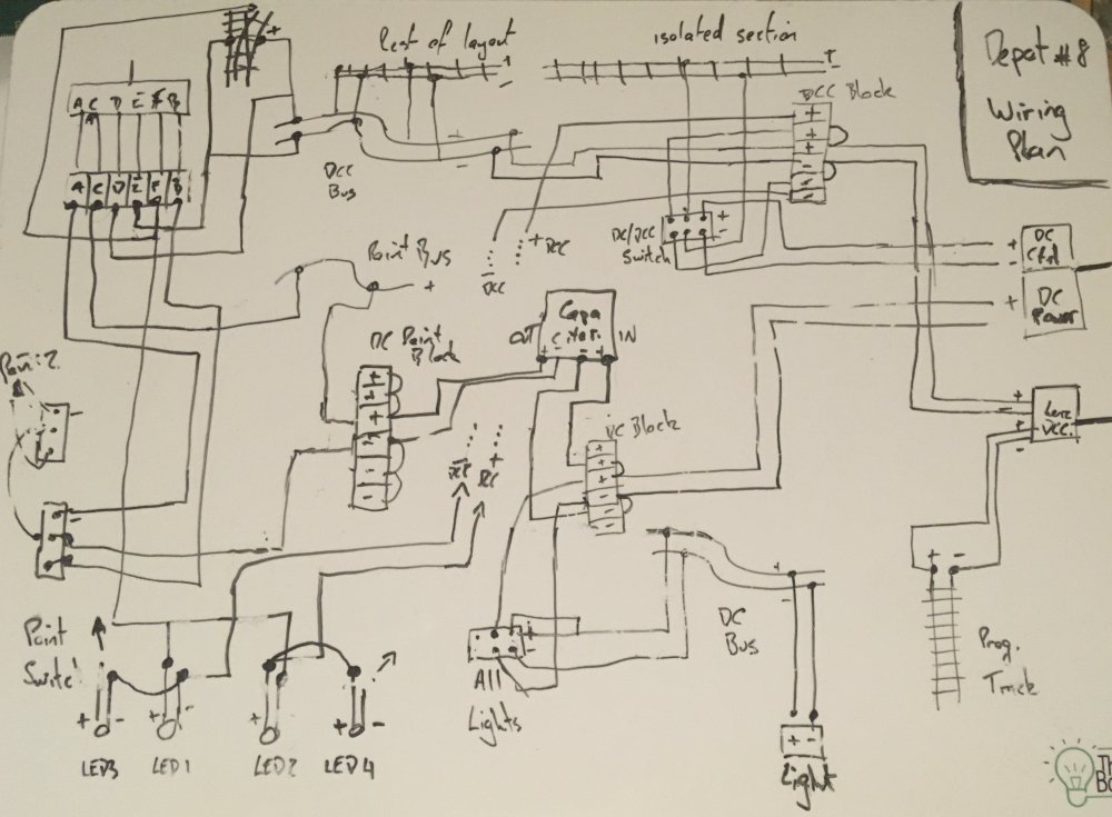

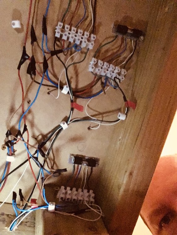

thats awesome Adrian you are quite tallented, i get terrified when i see the wiring diagrams but i guess im gona have to figure them out. thats exactly the idea i had for my own command center as such again didnt think there was gona be so much wiring lol i never soldered a thing in my life but i got one today from the amazon man so im gona practice on some fine cable before i touch resisters and cable for the lights and such before i move onto points and important stuff,

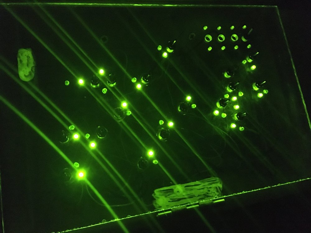

Thanks dude! I was the same, never soldered anything before this time last year, there's a bit of fear at the start, but as you say, if you start practicing on random bits of wire, getting a single LED working etc you'll be flying. That's what I did anyway - here's some of my earliest experiments... :)
https://photos.app.goo.gl/VfP7U8AKyb8oATDx9
https://photos.app.goo.gl/NhUH1XjLJSMfHEwh8
Quick tip, when soldering flux makes everything easier :)
@David HolmanHere's the vid for cutting out the grooves in the rails - one thing to note, they need to be 1.5 to 2 times wider than what you're seeing here - as I learned!

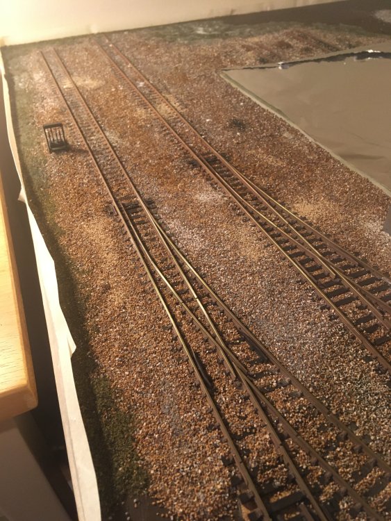

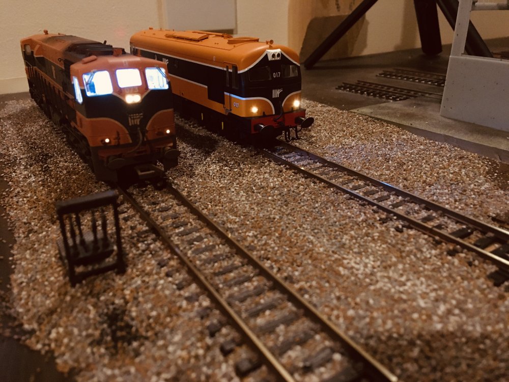

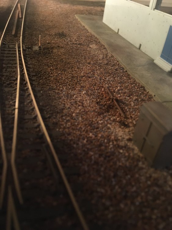

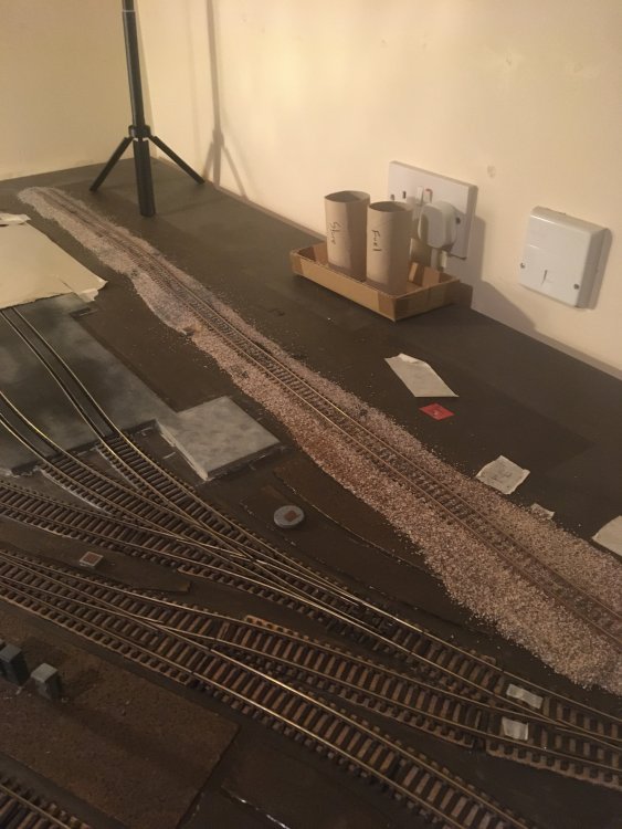

Having fun with ballasting, first section is gluing now. I love the creativity you can unleash :)
Going for a brownish mix around the main areas of the depot with plenty of variation, second pic shows an oil tanker siding a bit away from the main track work, so different ballast mix

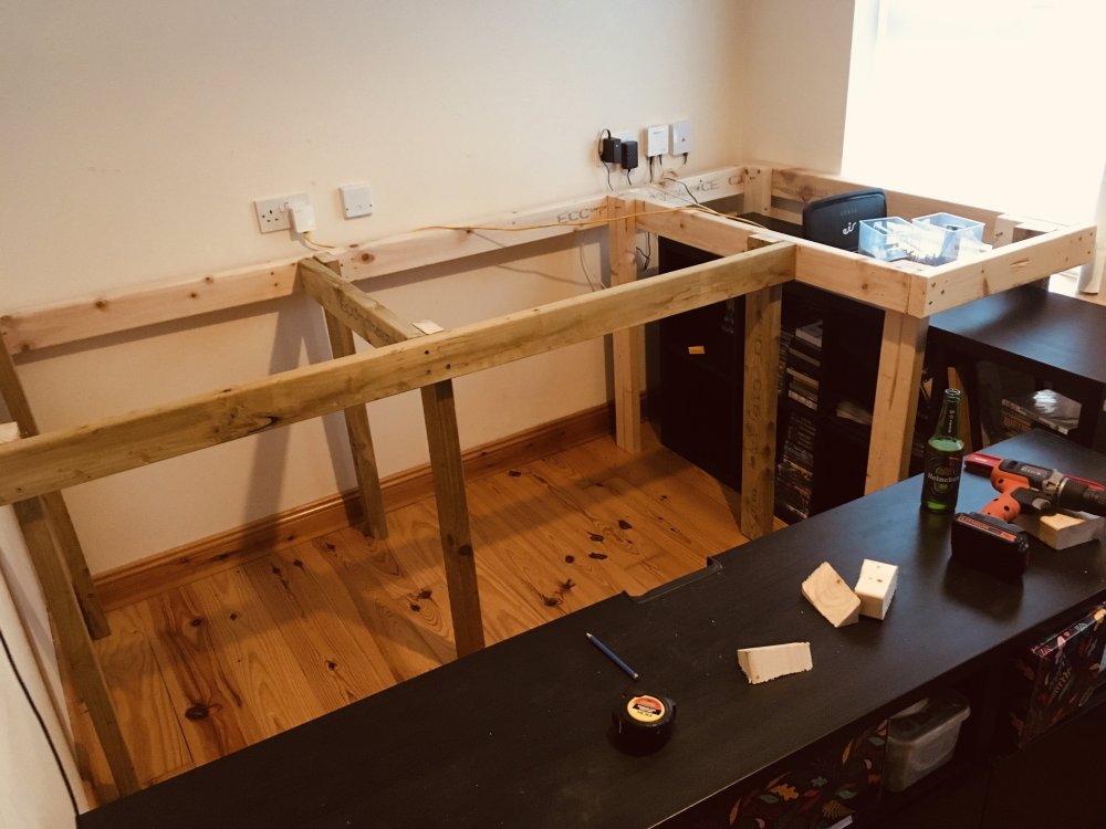

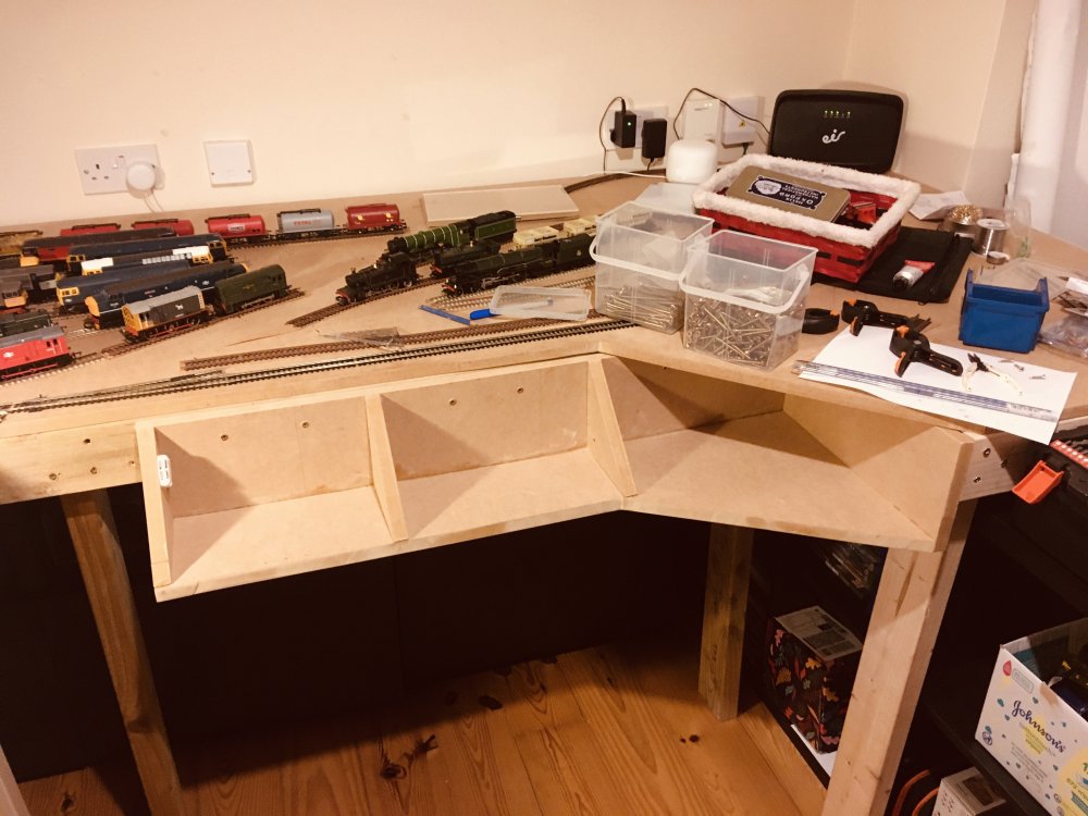

Wow that's an amazing return to the hobby after 25 years.  I returned in 2014 after a similar absence and found things had moved on so much since I had left, so much new stuff and materials to learn. Well done, progress so far looks excellent. Layout looks fab. Btw, those carpentry skills looked spot on too. Enjoy layout, its like gardening, and will never end nor complete, but the journey is so enjoyable.

Thank you very much Noel, appreciate those comments! Especially the carpentry which was never my strong suit 🤣

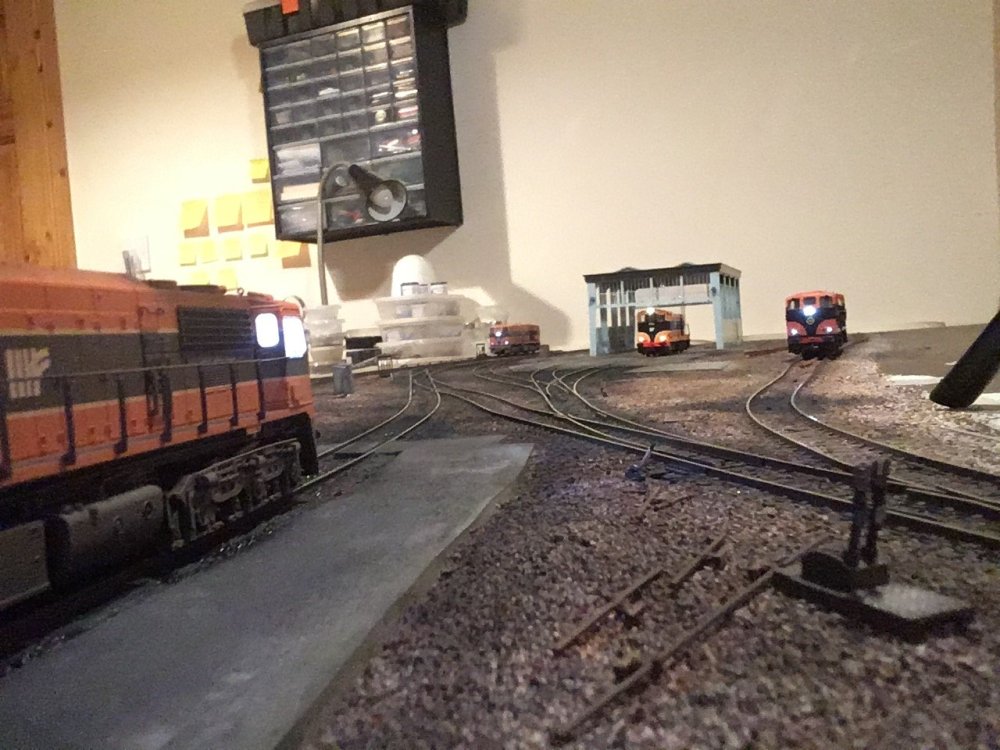

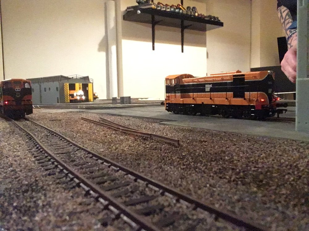

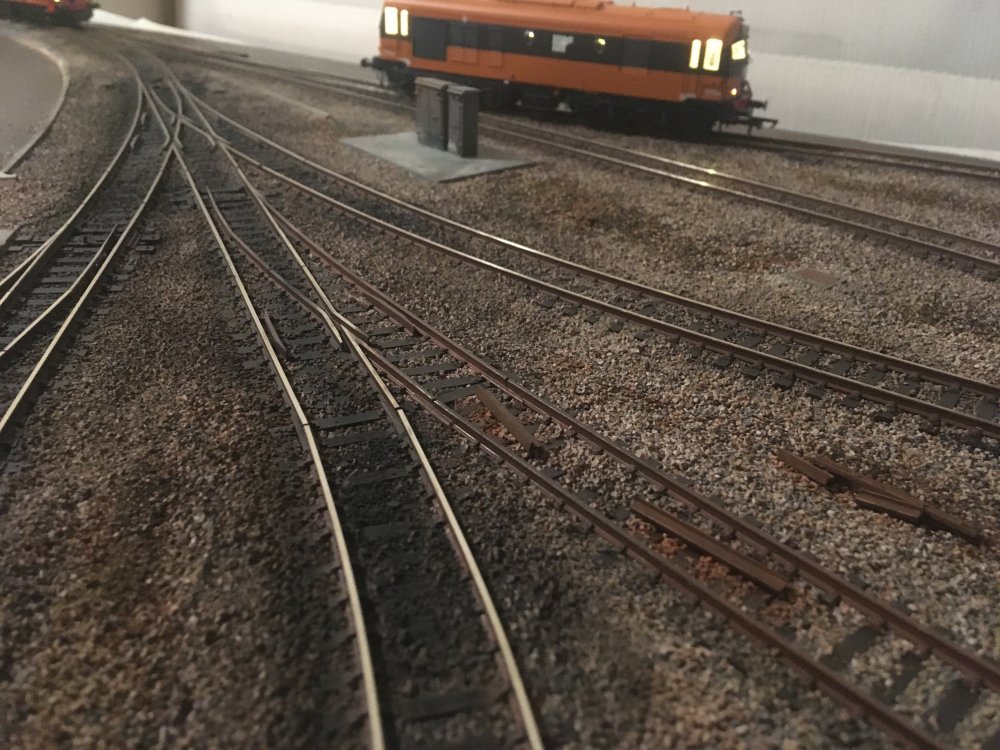

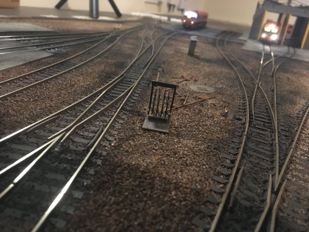

Phase 2 is complete! So in this phase I concentrated on getting the ballast in place with a base level of weathering and some trackside details. I've gone for a really dirty, oily 1980s depot look, with lots of spilled oil around the tracks as well as oil leaks from the locos along the most used routes in the depot. Things are much cleaner nowadays but they really didn't bother cleaning anything in the 80s! Have included a set of reference photos as well that I was working from.

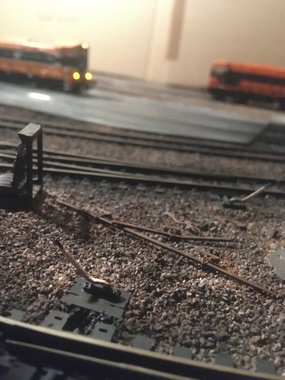

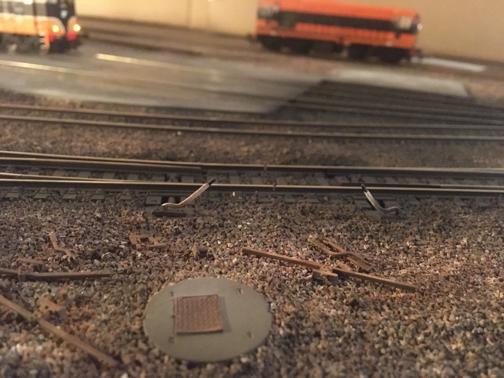

I also experimented with point motors, manual levers and point rodding to see how it would look - it turned out great but the point rodding was very fiddly (especially as I had already laid the ballast and had to dig some of it up). In the end I decided that in our depot, the last of the old point rodding was about to be removed and replaced with manual levers, and some of the previous point rodding was just lying around, rusting with time. This will eventually be overgrown with grass and weeds etc. in the next phase.
Honestly, I'm delighted with this result :) One thing I found as well is that as most phones have cameras at the top, if you hold the phone upside down you can get a much more realistic perspective :) Also, reversing the camera and placing the phone in unusual places can give you great, normally unseen shots looking out from the back of the layout - just a quick tip for any folks reading this :)

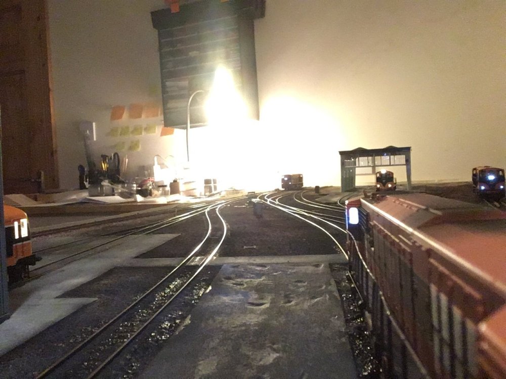

Looking across the depot from the fuelling point into the setting sun (got this shot totally by accident when the phone looked directly at the light bulb :) )

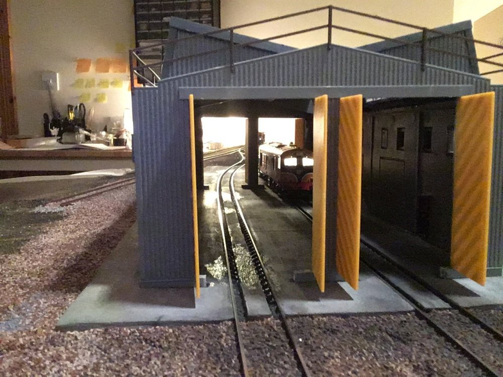

Looking through the engine shed with light reflecting on oil stains

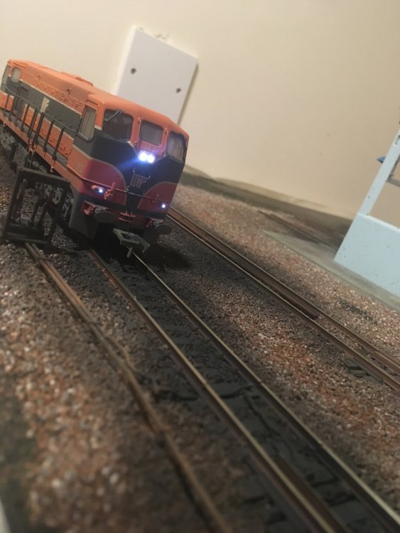

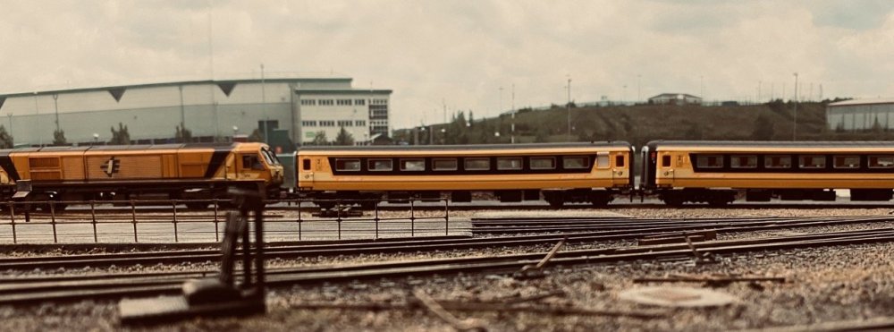

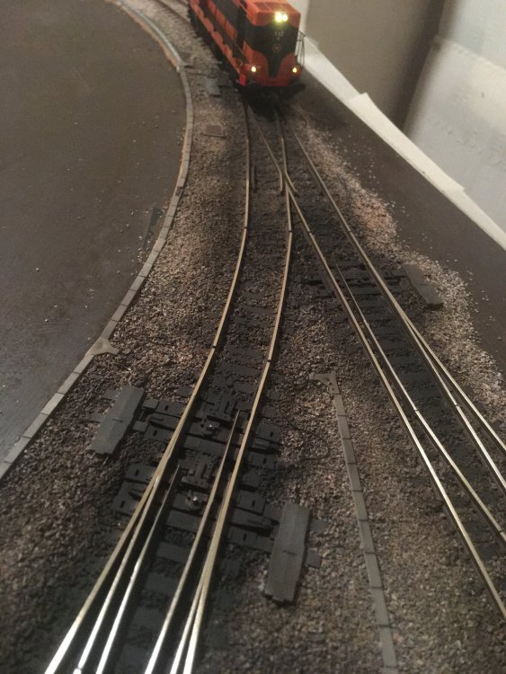

#183 in the headshunt with old rails and the last of the point rodding still in place before being replaced in our fictitious depot
Obsolete point lever frames and rusty point rodding, with manual point levers, a relay box, manhole and rusted rails

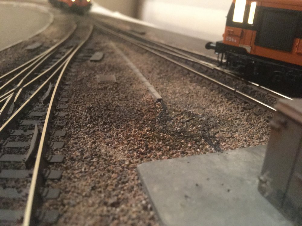

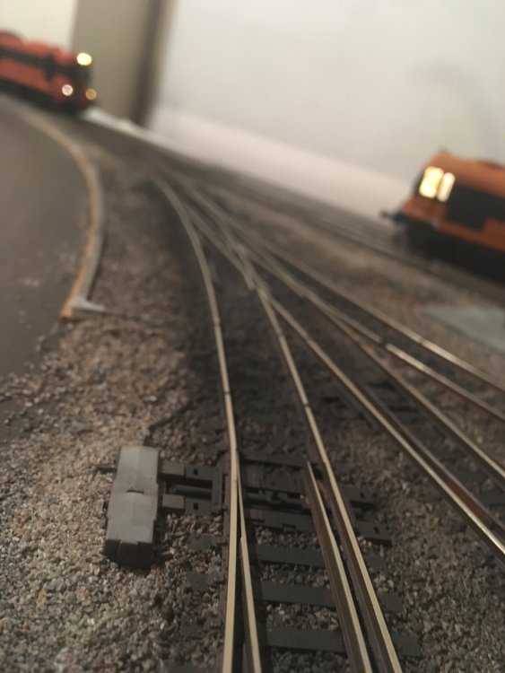

The other section of the layout (initially just for loading locos out of sight, but I decided I might as well practice here too and make this section more modern) has electronic point motors, with cable trunking emerging from a (future) tunnel and exposed wiring to the motors and relay boxes
Note the oil stains where locos idle, waiting for release from the sidings, between the sidings will have some weeds and static grass added in the next phase. The rusty siding to the lower right is no longer used and will be totally overgrown.
Cable bundles running from the trunking to the relay boxes, these will also be overgrown with weeds

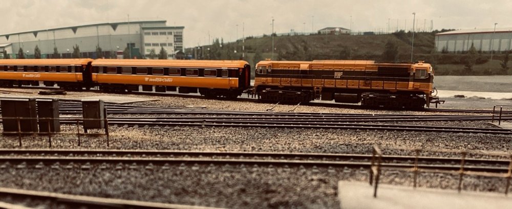

Murphy Models class 071 #073 on a short move from the headshunt into the fuelling point
