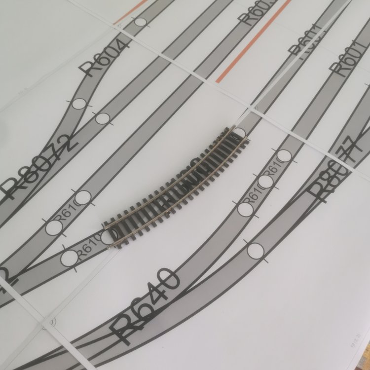

If you are using set-track then the Peco track geometry is the same as Hornby. As previously mentioned, Peco much better quality track than Hornby.
41 minutes ago, Sean said:
The larger express type points are far more reliable than hornbys little points, they also plumb into set track geometry without issues. you cant do this with any of the larger peco points from what i have found however for smaller points peco ones are very reliable and hornby ones are the devil.
I think the peco curved point may be the same as the hornby one but im not 100% sure, peco have a template you can print on their site.
railmodeller express will allow you to plan the layout in peco.

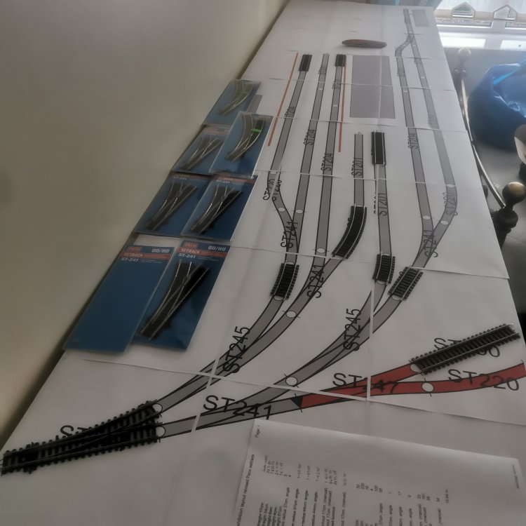

I will look into it further, maybe down load some of those templates off peco. I do have peco track and some points I was collecting for when I build my actual layout but the way that is unfortunately a long way off.

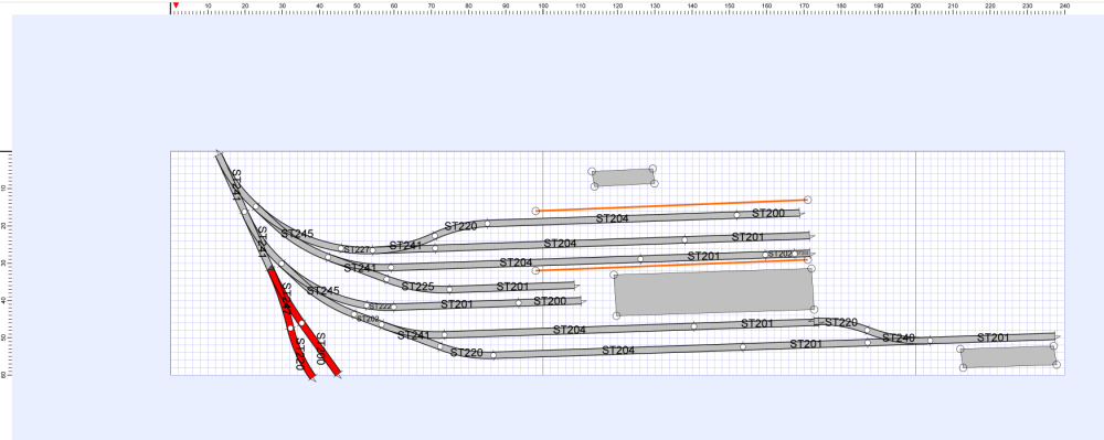

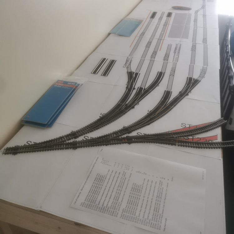

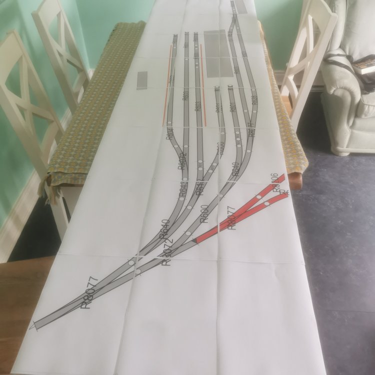

Spent the morning designing using peco set track. I had hoped to use my stock of code 75 trackage and points I had for my actual layout as a cost saving option but the available points would not have allowed me to use the space. The set track by peco that was suggested in earlier posts has given me more room and some longer sidings and run around tracks and I must admit it think it'll add more value running wise to the layout. Thank you all for your suggestions. I'm glad I went back and took the time to revise these plans.

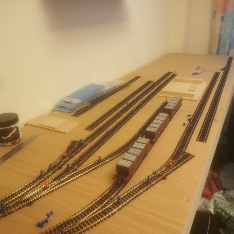

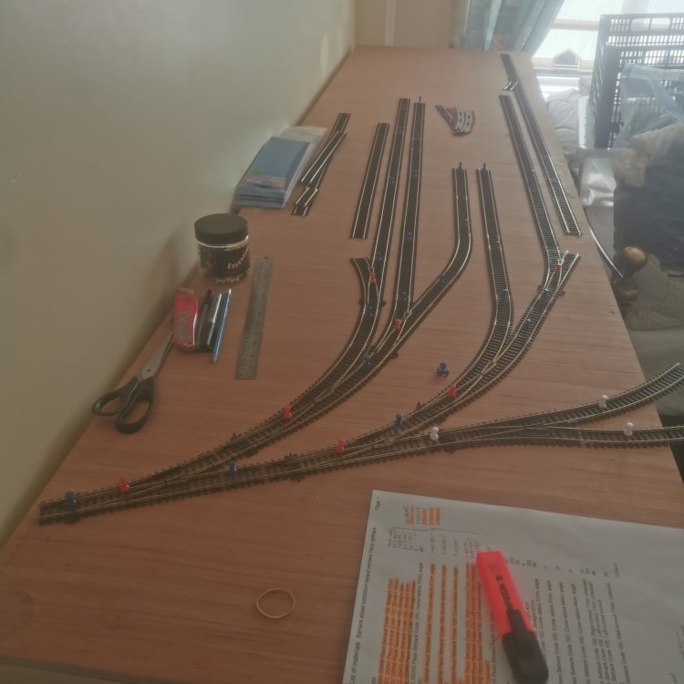

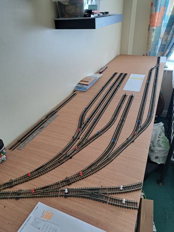

Layout update.

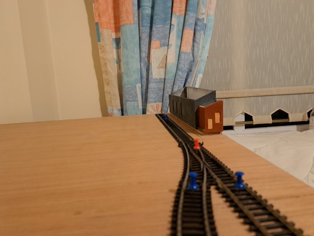

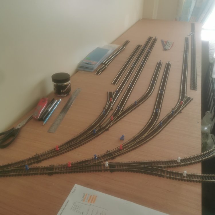

Track has started to arrived with must of the points and the slight curved sections having been purchased.
Having had the opportunity a few weeks ago thanks too @jhb171achill to meet various others from the hobby who were extremely helpful and more knowledgeable, the layout will be powered DCC wise by the NCE Powercab control system with points being operated by tortoise  point motors.
Also did a rough fit of the points leading into the yard. The unpowered scenic section leading off the board I decided to recycle some old hornby track and point I had has nothing will run on it and it doesn't need to be prefect.

With most of the track having arrived save for the last three remaining pieces the track plan has begun to reach it's final stage. Some slight changes have been with some lengthening of curtain sections to expand the width as it seems too comprised. I think even though the changes are slight it makes a huge difference.
  • Like 9

For some perspective here are three keg wagons on one of the storage sidings

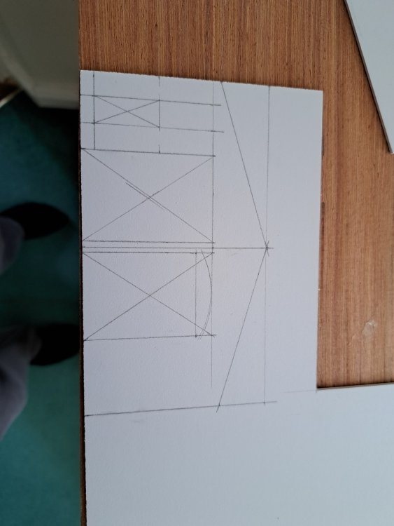

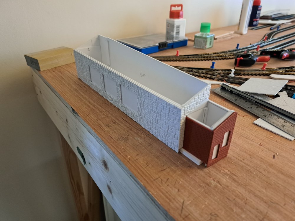

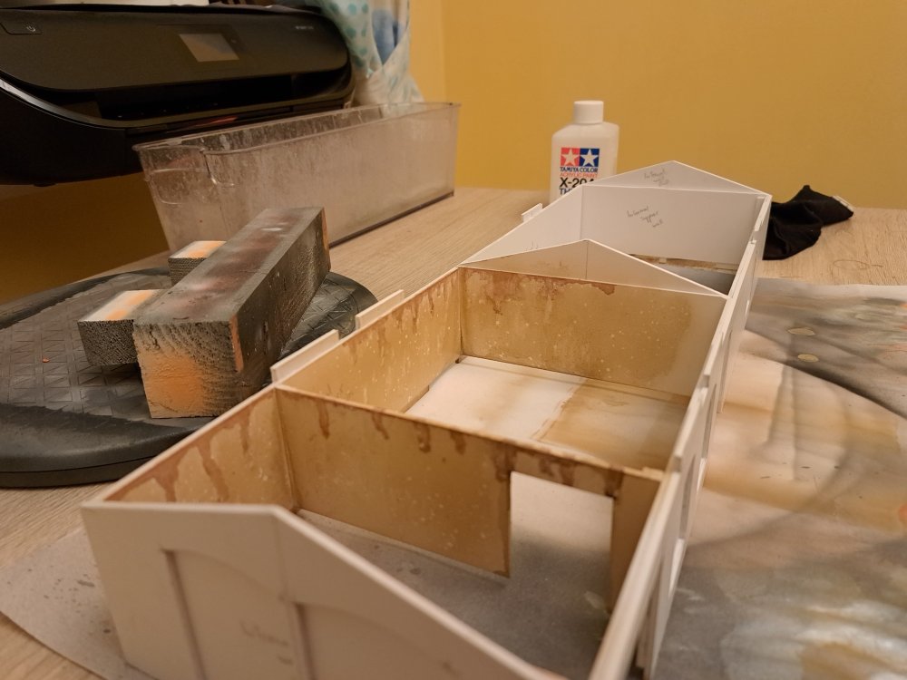

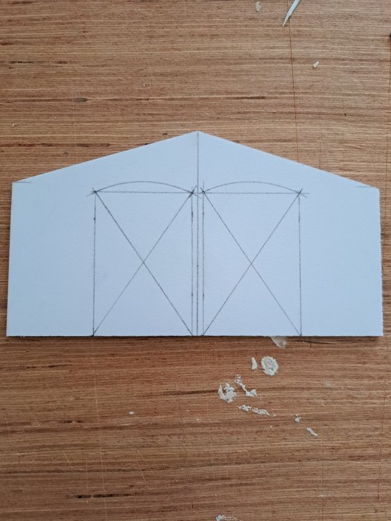

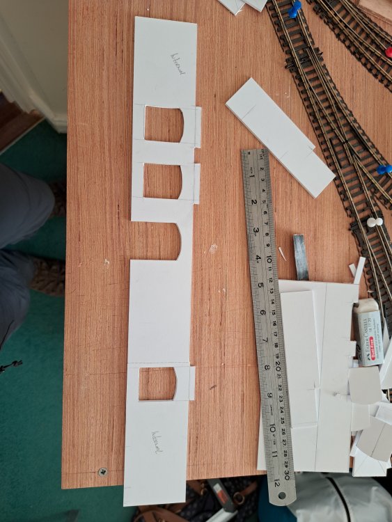

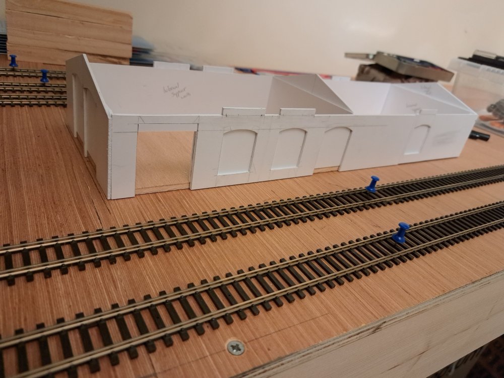

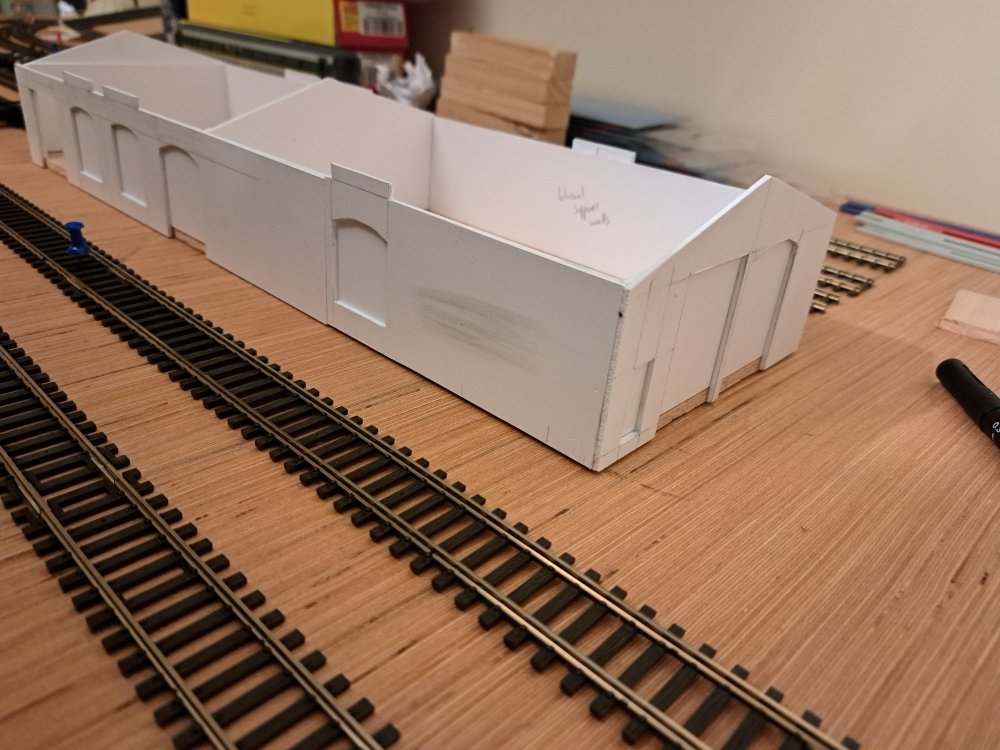

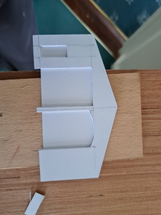

Some more work done today. This saw the addition of an internal wall which I noticed from the reference video.
Painting of the visible wall which you will only be able to see after the roof is fitted.
  • Like 17
13 hours ago, Bob229 said:
Progressing well
There are a few more jobs to do internally before work begins on the outside such a the floor and detailing but overall for a first stretch build I'm delighted so far.

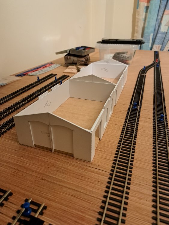

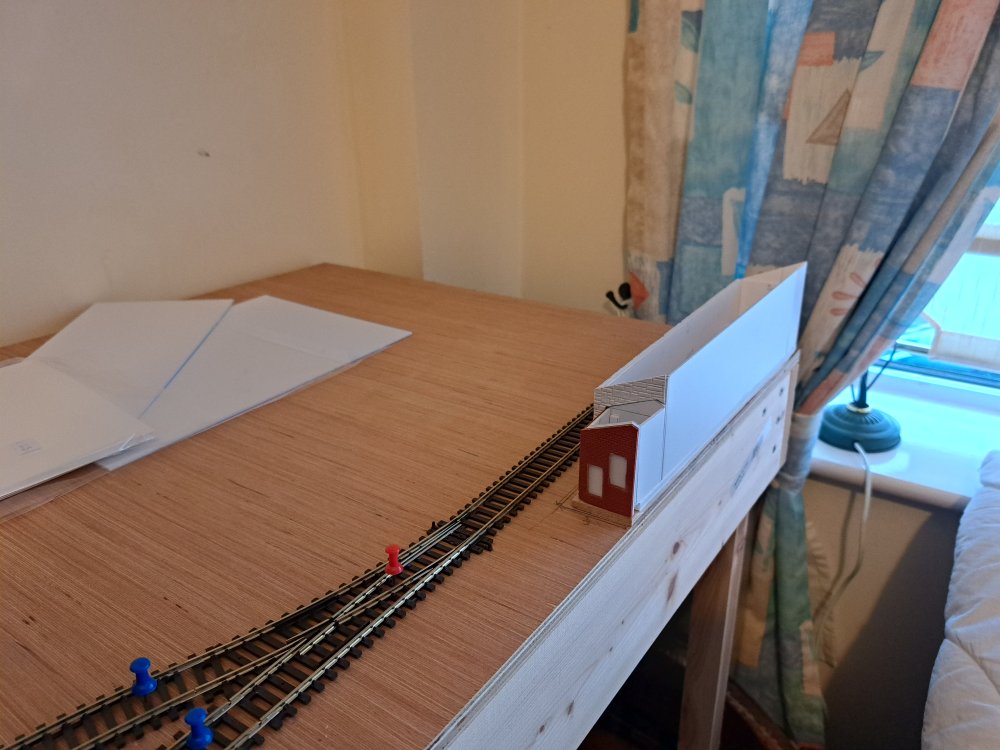

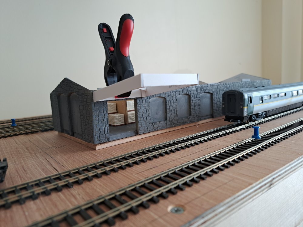

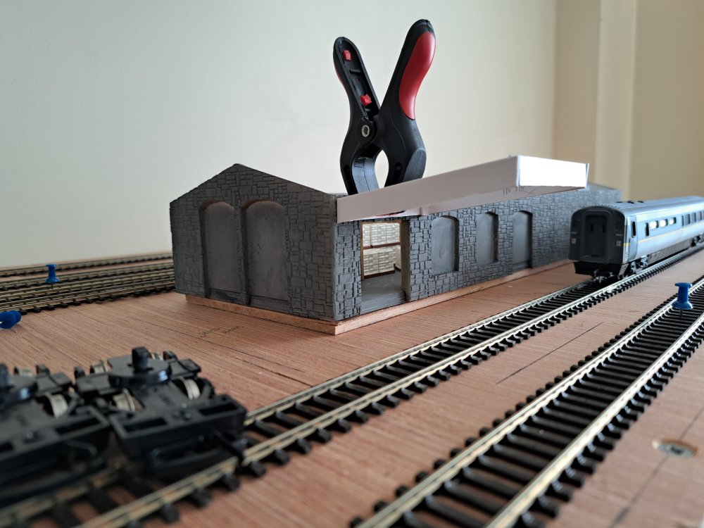

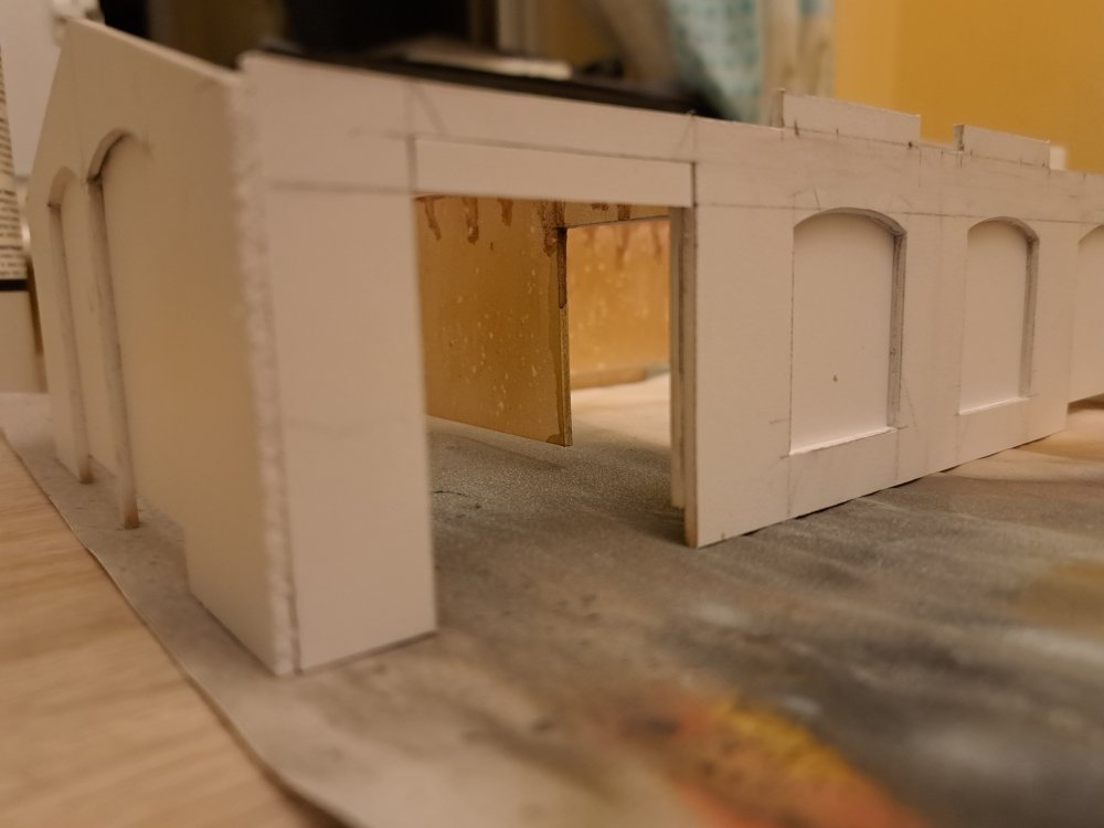

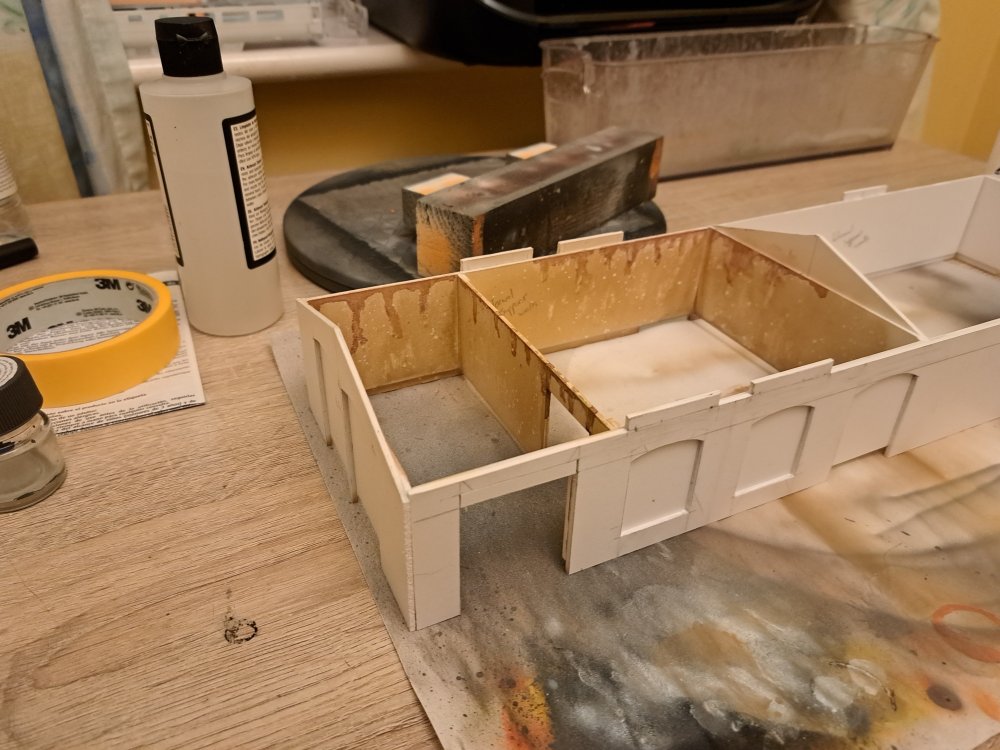

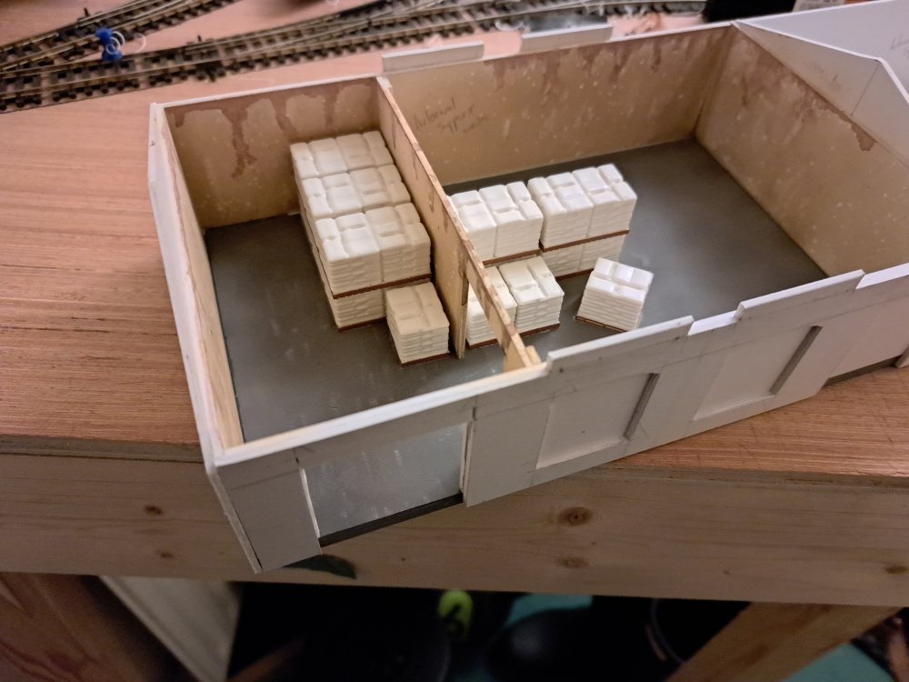

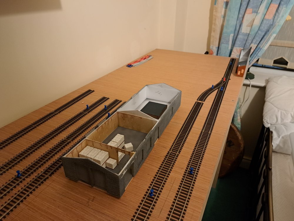

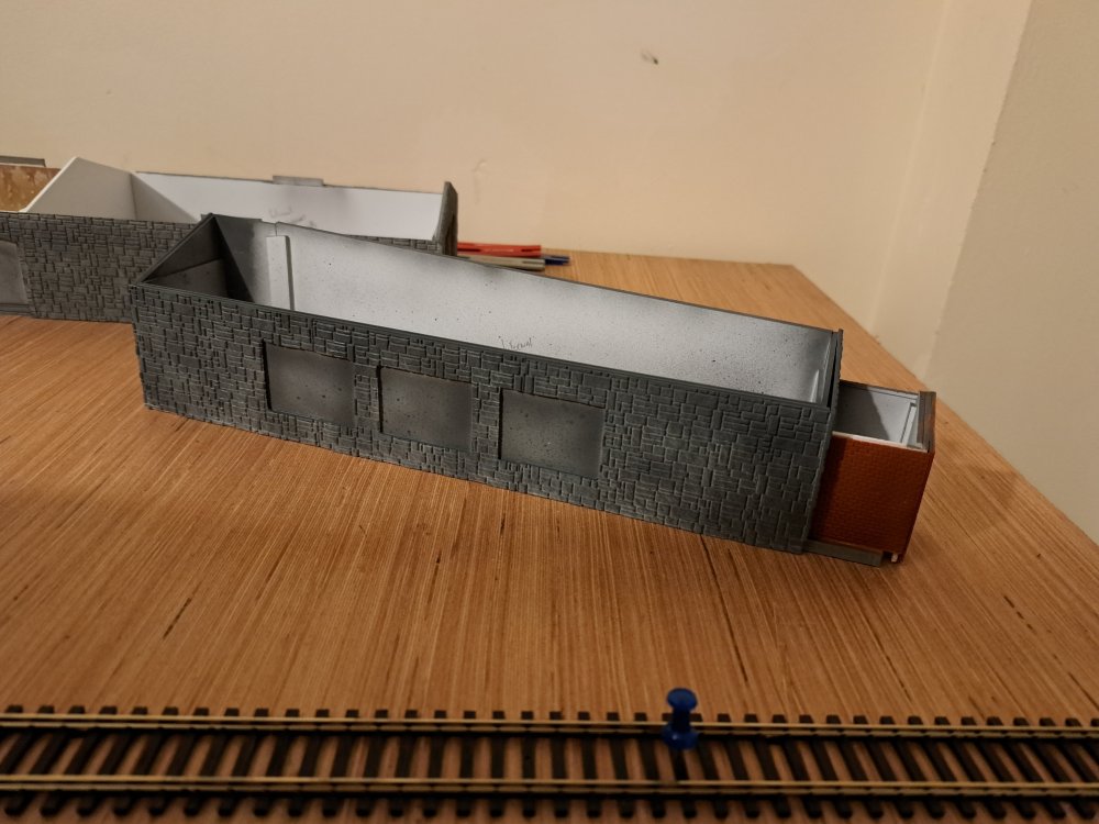

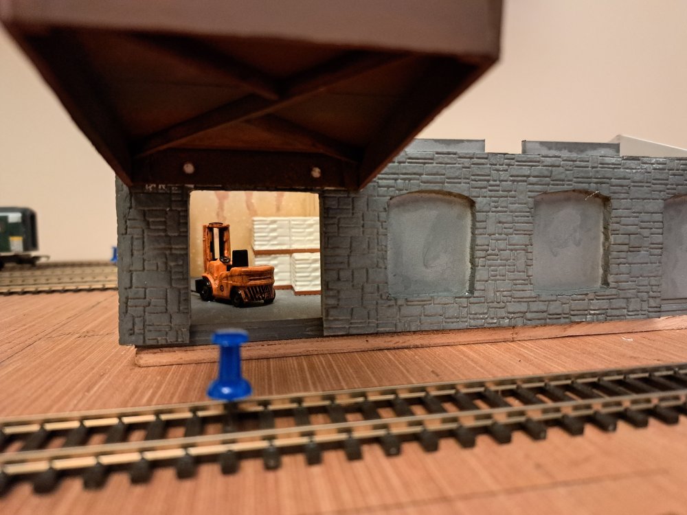

Update.
The first two pictures show the work to the internal scene within the large shed. Not yet finished awaiting figures, forklift, lighting and drums and pallets.
The second pair of pictures show the shed with its basic paint applied and a test fit and clearance test of the canopy which over hangs the first track.
  • Like 16

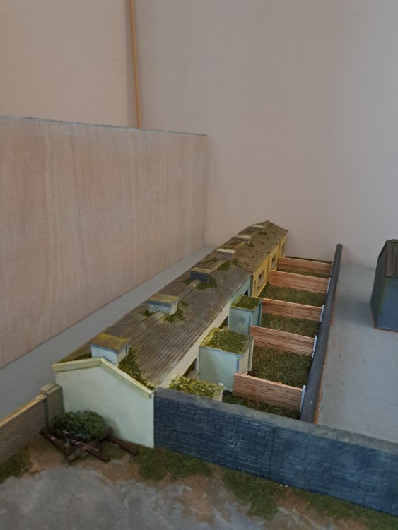

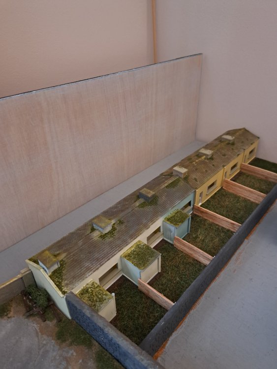

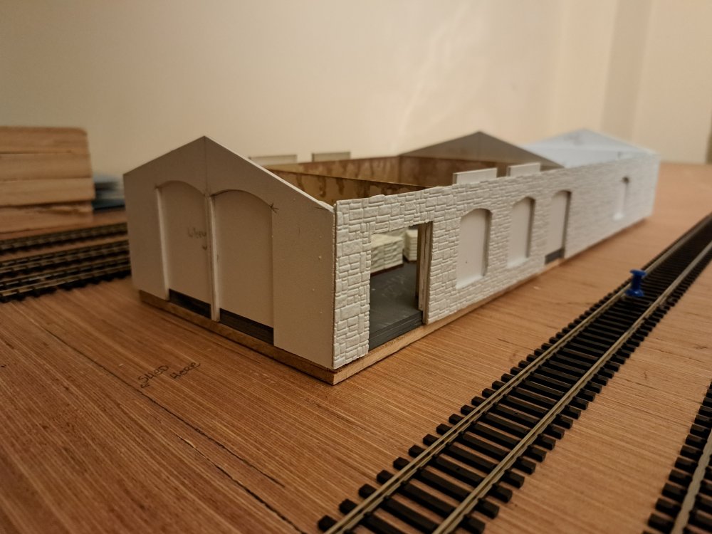

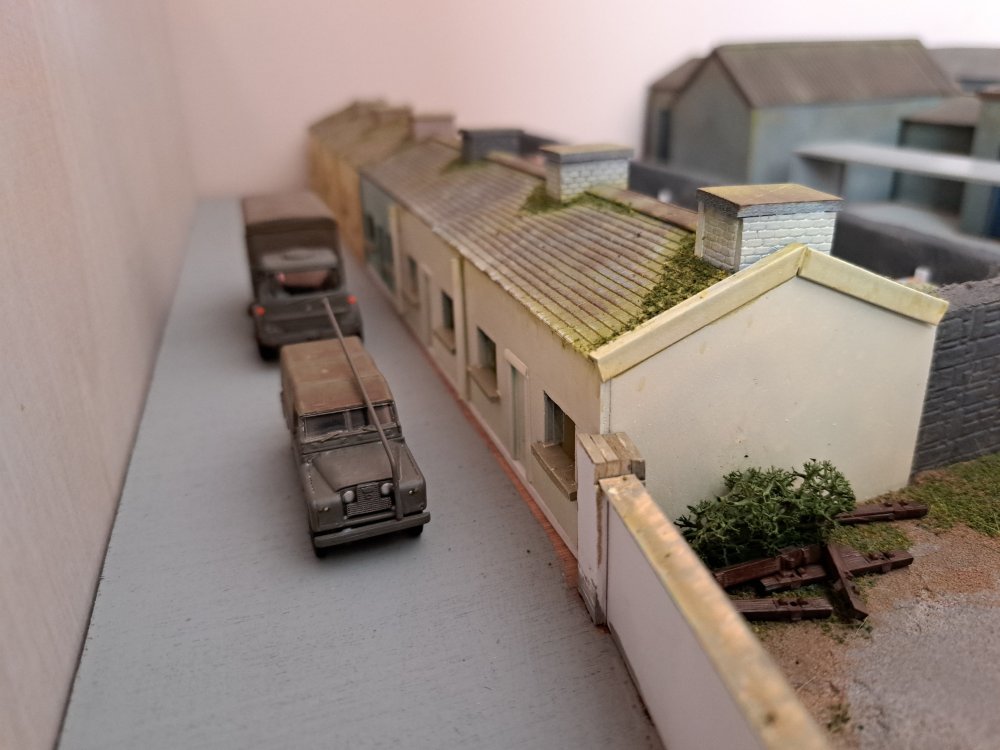

Layout update.
Building progress continues slowly. The second building is effectively a low relief building with the remainder being off layout.
The main building has had an overhanging shelter (not finished) fit with the addition of a IRM forklift to handle the loading/unloading duties of fert wagons.
  • Like 11
