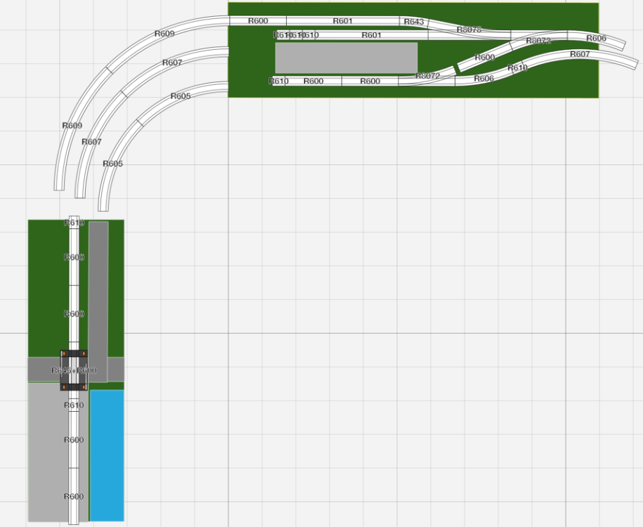

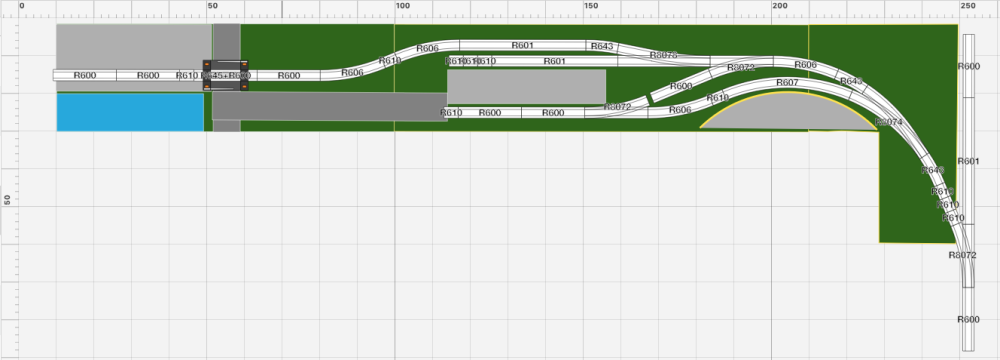

Although the other layout is not yet finished,  I have been talking myself into building a small inglenook that could be Placed ontop of the main fish tank in the living room as a place to display rolling stock on.
Well ambitions have gotten the better of me and that idea has now morphed into somthing a good bit larger.
Had been looking for a prototypical location to base it on which narrowed me down to 2 completely different scenes. either the south facing yard at greystones (omitting any kind of station),  or westport quay and branchline to the dock(also omitting the station except for the loading platforms). I also did not like fintona, as unusually i did not want to have a run around loop due to space constrains. however in the end it was realised that without it a very long headshunt would be needed regardless so tried to squeeze one in as best i could.
Greystones would be simple, but westport has been a favourite of mine since getting back into the hobby and would give the opportunity to model a real bit of "countryside" rather than having a layout completely centric around a yard on station. we all love wesport to the point that it has been done to death, but its a very versatile little terminus.
SO i got to work on making the smallest iteration of this plan that i could with the following constraints: it has to be built from existing in stock track and it must follow the rules of the inglenook game. it also MUST incorporate the dock scene to be located in such a way that it does not feel incredibly bunched in ontop of the station and as part of the same facility. a LOT to ask but i have an 8 foot wall off of the slaney lake fiddleyard, so it has been designed to fit into this space. taking this length into consideration,  and the fact that I still want a fish tank display piece, I have designed to build the layout over 3 baseboards which I will A. allow me to work in phases, B keep a module downstairs as i am working on it or to be left as the display piece whilst i am building the others and C allow me to later make other modules which could extend or change scenes within the layout as i will explain below.
The track on the right at 250 will be the existing fiddleyard which will be laid with traffic from both layouts in mind and a clear thru road for layout to layout running.
The dock module on the left will be quite simple with an extended single track down to a small dock area built to accomodate 3 wagons plus a locomotive with the level crossing gate shut, this module will be built first to later become the living room piece if and when desired. it also allows for a small branch off through bare boggy land to the docks and creates a feeling of seperation between the dock and station.  short 3 wagon loads can be pushed and pulled from the dock which in real life would be a couple of miles away.
the middle board is essentially westport quay station. scaled down to as small a size as possible whilst maintaining the rules of inglenook. the headshunt will be big enough for loco+3 and the siding will just accomodate 5 wagons. the station house and platform have long since closed and all that will remain is a old abandoned platform with plenty of weeds etc growing up out of it. Quite often we see stations modelled in quite a detailed fashion with the yard areas either omitted or very much scaled down. I want to challenge this concept by focusing on the goods, with passengers being an afterthought or simply nonexistent,  this makes sense from another point of view also.
Era wise I am aiming to be around 1970s with the main stars being my supertrain 121 and 141's But a caveat to this is that i also have a grey 121 which i am wishing to run on this(and BNT on the shopping list) and lets face it is going to see all manner of stock when connected to my other layout so the era is simply going to be "loose goods" and left at that. lack of any station signage and only generic sort of road and dock signs from the general period should mean that by lifting  all of the cars and rolling stock and changing them for those from a given decade means i will be able to change between given eras depending on what i want to operate at the time.. my other layout is very rigidly sticking to half of a certain decade whilst this one will allow me a bit more freedom in that regard.
the railcar will also operate on occasion to the abandoned halt. but rarely.
the station also has a through road. meaning with given space the middle module and right modules could in time be used with a continuous loop of track to create a round and round circuit.
The third board is mainly just a means to connect to the fiddle yard with some space left over for some boggy fields.
the loop is on a bend and squeezed into a tight space im mostly planning on running dapol loose coupled stuff, with the slightly bigger couplings so im not as worried about issues here but it is a concern. running older stock like this also means it should be more forgiving on the hornby trackwork, which is once again reluctantly being used but actually makes sense for this one.
Another version of the third board will also eventually be built which will just be a bufferstop and headshunt with no connection to another layout. for standalone use should i ever want to use the layout away from home.
Plans wise its pretty simple. I'll get all my baseboards built at once, decide on an underlay system and lay all of the track,  from there ill split the layout back up and build a board at a time starting with the docks. Expect progress to slow as i am still finishing the other layout but the boards and trackwork should happen quickly enough.

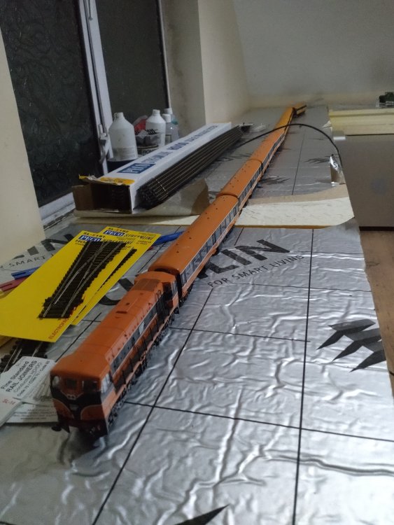

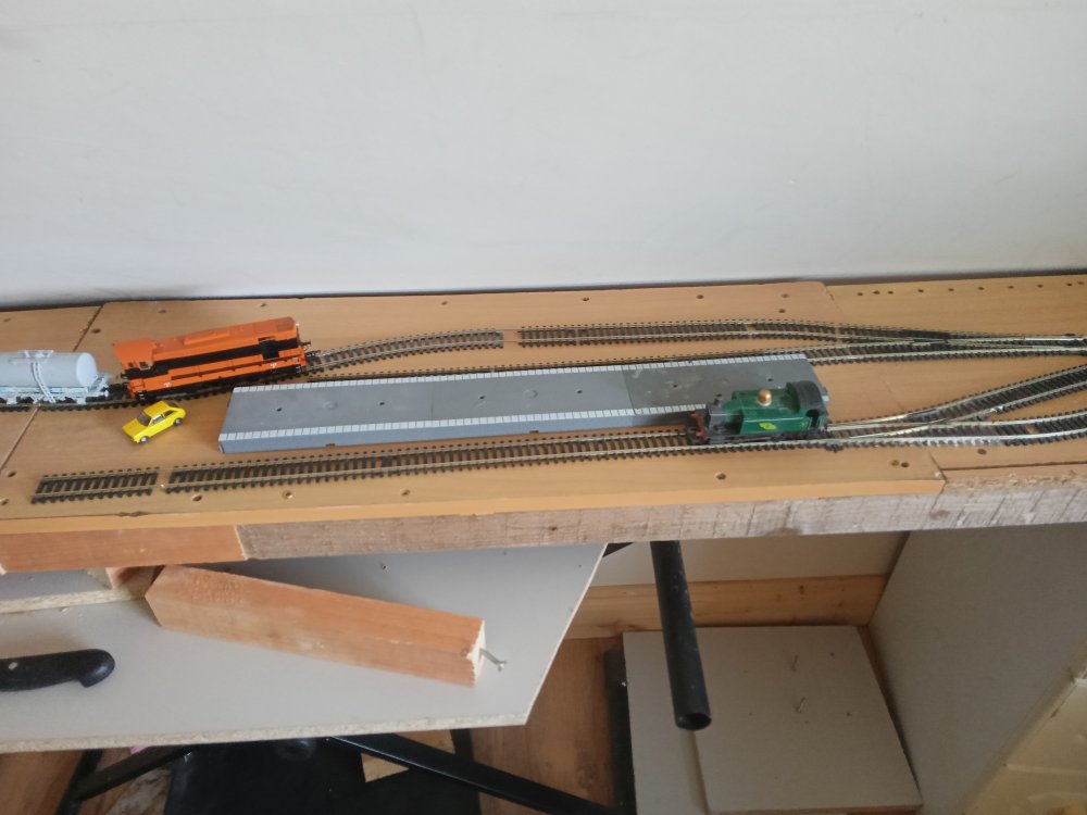

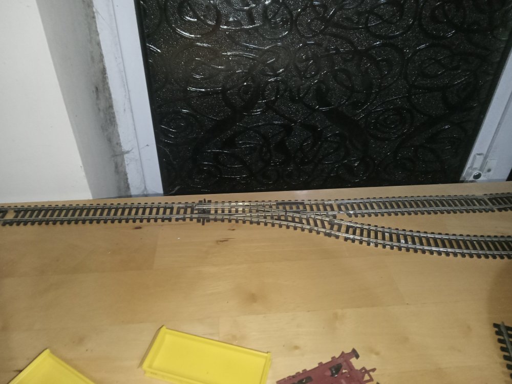

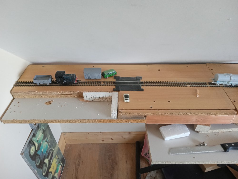

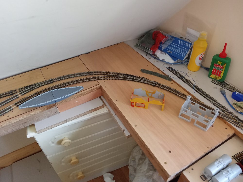

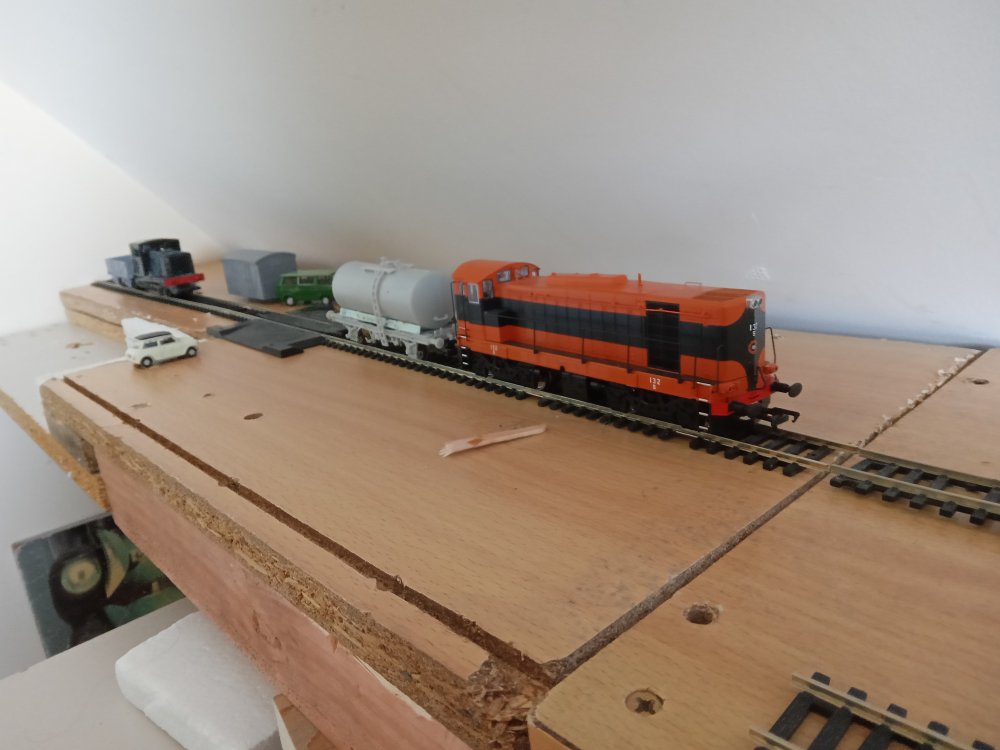

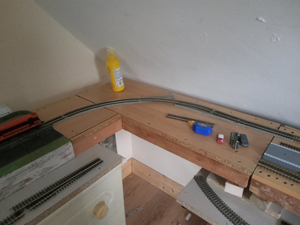

IMG20220714082646.thumb.jpg.51c865f43f7dd8a507d4b4b1b0dd3d9b.jpgIMG20220714082719_01.thumb.jpg.d8bf48900a85401ca8a796690cef5e77.jpgIMG20220714082730_01.thumb.jpg.b2f3d11bb0761b3ec4b18770a2a710cb.jpg
as anticipated the baseboard and trackwork have happened very rapidly indeed! Minor trackwork adjustments as always but the overall plan has not changed and the dock module has a straight transition to the other board. The compact size means two of the boards can be permanently joined for improved point running.
Some placeholder buildings and platforms gone in the usual stuff that may change in time.
My priority here is finalizing the trackwork so I can break away the dock module and work on it exclusively for a while. I also need to find a reliable way to join/split this module and keep the track aligned.
I can get the dock module progressed fairly fast as I have most of the items to finish it in stock Except for some scalescenes buildings I still need to print.

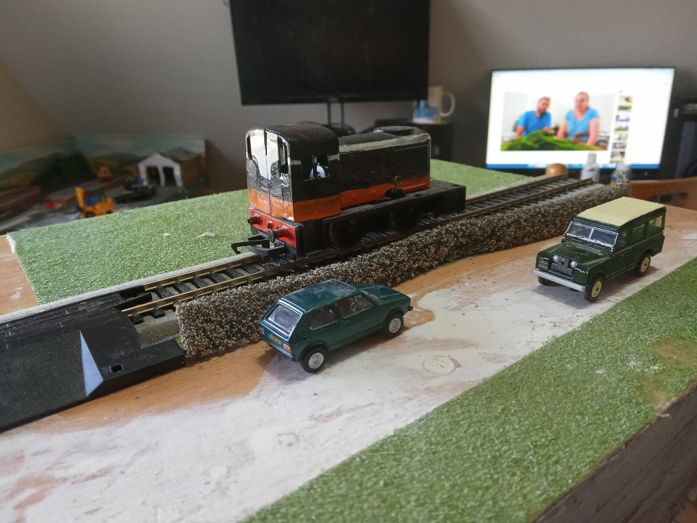

Deutz at the dock!
132 shunts accross bog land!

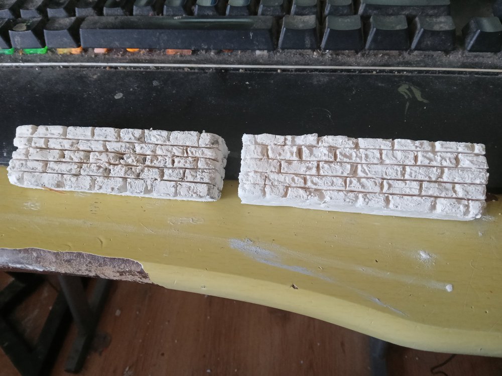

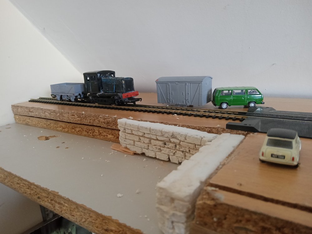

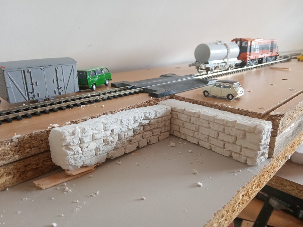

was torn on whether I will buy or make the dock walls and cobbles. I have some nicely sized polystyrene bits in stock and loads.of filler so I said I'd see what I could rustle up after a few YouTube videos.
First and second attempts respectively.  Very pleased with the second attempt and I might salvage the first one yet as the filler is very forgiving (it's also rock hard in under two hours!) Should look the part once painted up and washed.
Even a light sand from here I am thinking would work wonders on them but that's for tomorrow to know and me to find out.

I wanna get a bit more prototypical with this, despite the vagueness. So probably going to have to pick your brain for some of the local goo/knowledge about specifics of this line  and backdrop from time to time 😁
This particular track plan which you uploaded/authored(delete as appropriate) many moons ago has  always stuck with me as one of particular interest, Alas, the length has always made it super challenging to effectively build everything as i would have liked it to be. I think ive found a very effective balance here thats going to look super interesting when the board is more decorated up.

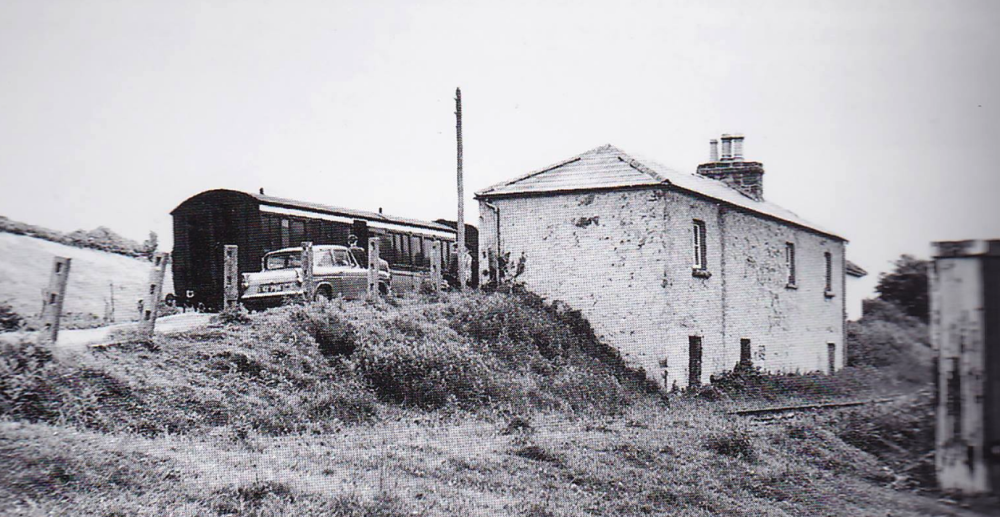

In that top (B&W) pic, the palvan seen on the left is at the end of the "new" siding shown on mjy diagram above as a dotted line. The van in the foreground is a GSR van. Note the water column, disused even then, in nthe distance on the right. Odd place for it, given that Westport station was less than 2km away.
I have lately found a definitive date for the final closure of this line to REGULAR goods trains. This was Monday 1st March 1943.
Thereafter, OCCASIONAL goods trains would operate on an "as-required" basis, and staff in the Quay station (which was fully staffed until then, I think with 2 people) were transferred eslewhere.
In the second pic, the very low height of the platform will be noted. The station building was an odd design, more like a small country cottage than railway architecture. Single storey on the platform side, 2-storey on the other side. A very unique and interesting type of prototype for a model.
Link to comment

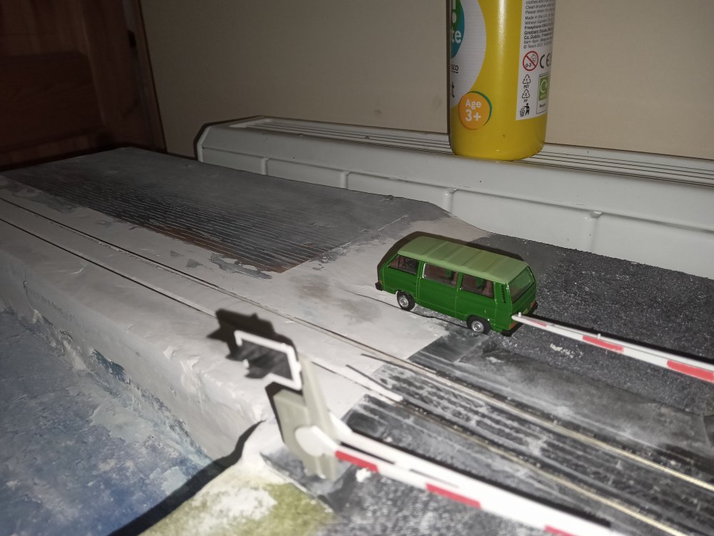

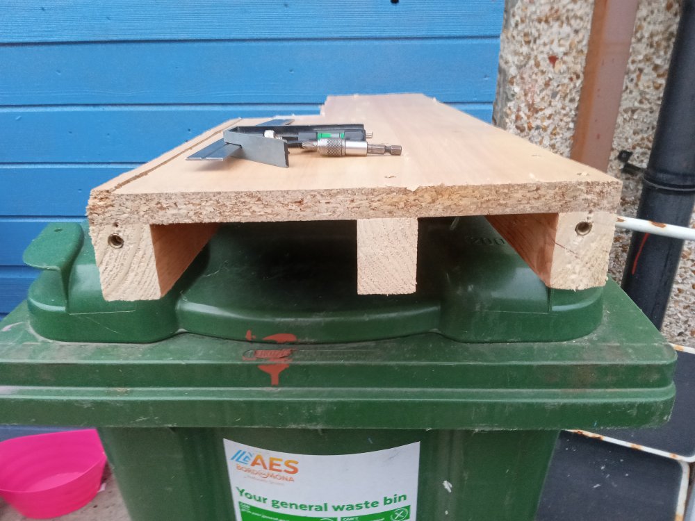

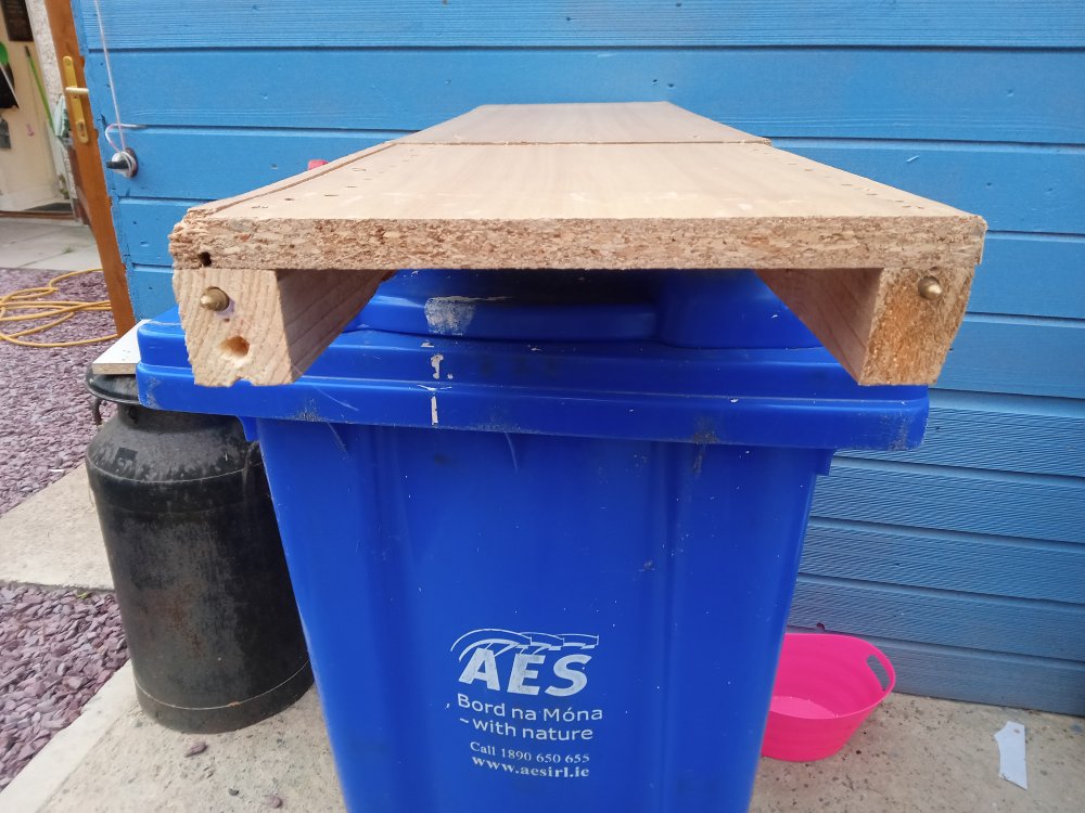

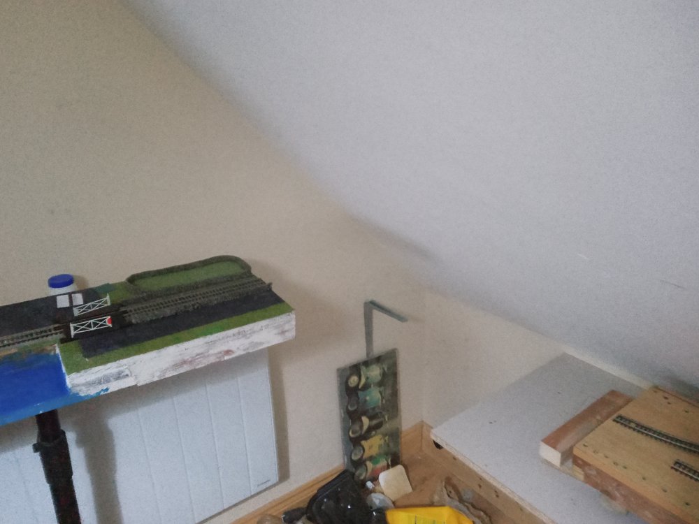

A small but significant job has been carried out today.
My most recent build had been wracked with derailments pretty much anywhere the track crossed from one base board to another. So I am very conscious of it this time around.IMG20220716205330_01.thumb.jpg.8e4fdb4013c16160e4b1cd0af97d24ed.jpg
So I salvaged these dowels from an old kitchen table and went about adding them to the dock
They are basically the exact same as the DCC concepts product. But without the price tag.
Unfortunately this has highlighted some of my raggedy carpentry skills as clearly the panel for the station baseboard has not been cut perfectly straight 🤣. Not a huge worry as I have plans to partially rebuild the middle board, for the moment my main concern is that the trackwork joins up accurately every time. And without fishplates, which if does.
It's only a small panel anyway, which I can easily replace, or I could open up the gap a bit and stick in a stream. Although that may get messy 😁
As stated in the first post, I have been rushing to get this part done quickly as once I get the track laid down to the dock I want to again remove this module and work on it as a standalone piece.  I want to build it up to as close to exhibition standard as I can get it. This is due to it being a living room piece but also as future practice for any exhibition layouts that I might decide to build.
I won't be holding the station module to as such a high standard as this will be more so a place to play trains, eventually it will get the full works treatment also though but I'm thinking longer term there.

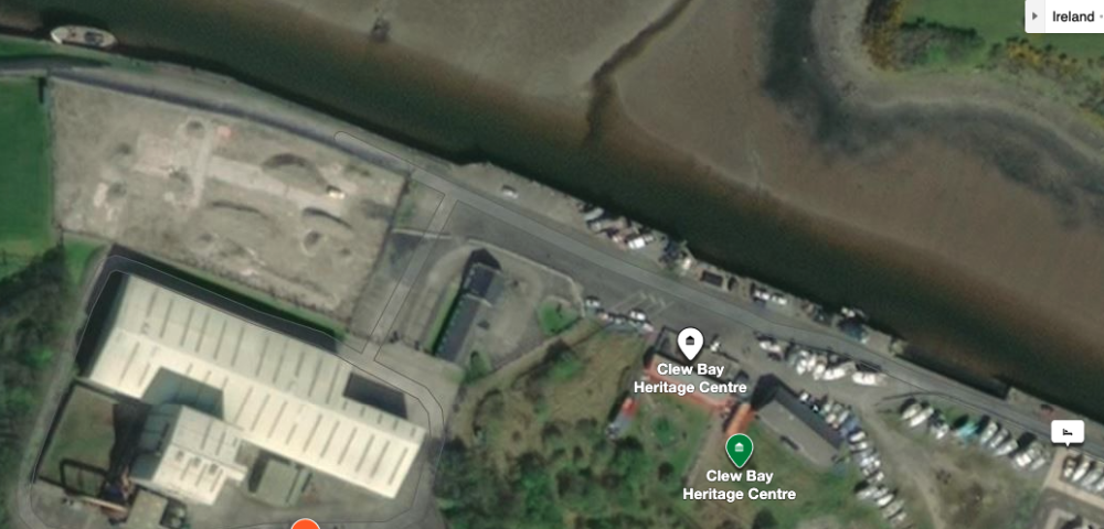

found it, and now im very intrigued, was the clew heritage centre an ex railway building by any chance?
547052009_Screenshot2022-07-17at02_21_20.thumb.png.b4697f1ce0dc5b39019114ccbd2916ec.png
i get the impression that the line may have ran paralell to the road road behind the wall where all the yachts are parked out of water. it then curves in behind or infront of the clew center(good store on 25 inch i THINK) with the point into the 2 seperate sites just beyond that. not sure though. its squinty work reading all these old maps and comparing to modern imagery. I think i have given myself way more geographic references than i need now given how small the layout actually is.
whats the story with the really low sea levels also? it seems to be down on some maps but not others, making things ever harder to trace than they should be.

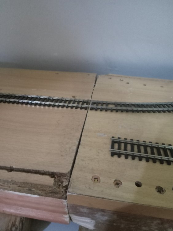

A couple of thoughts.
 As your baseboards line up nicely, if you want to avoid the earthquake crack between them, use car body filler. Put clingfilm on one face, liberally smear the filler on the other and clamp firmly together. Once the filler has set, you should have a nice, almost invisible join, though if the boards are going to be permanently joined, you can fill over it anyway.
 As for the quayside surface, am guessing you are aiming for something post 1960s and if so any setts, cobbles etch would probably have been main be covered in tarmac or concrete, so a lot less work to model.
  • Agree 1
Link to comment
Excellent, im going for 1970's but passable as 60's by changing out the cars and rolling stock.
the dockside module feels like its gonna be a real "layout in a day" piece as learning to cobble was going to be a big annoyance for me but for standing i have everything in stock and ready to go, and its one of the first things to be done!
to tidy up the massive crack ive taken that panel off and as soon as everyone is awake ill just give it a shave again with the chop saw to bring it back to a square edge and ill offer it back up with the square edge facing the baseboard join and screw into place, that  will close it but creates a mid baseboard crack then but as you say it is easily remedied with filler. As usual ive just built the baseboards from crap left around the place, this time an ikea cd holder unit that fell apart and the boards just happened to be the perfect width, whilst free it does create the work of a lot of filling in the little holes and chips around it. so that is to say I was going to have to go heavy on the filler one way or another anyway and its no real extra work!

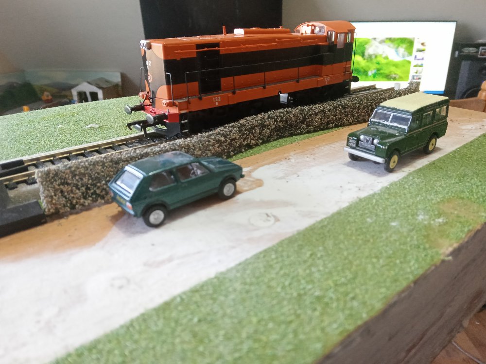

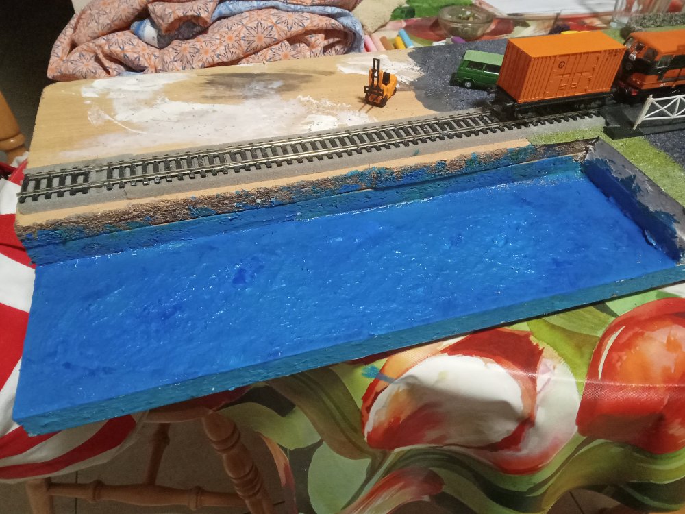

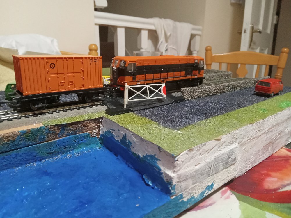

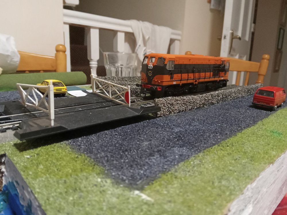

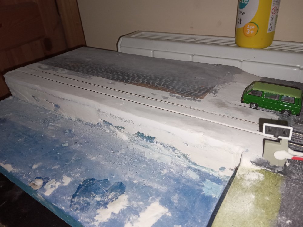

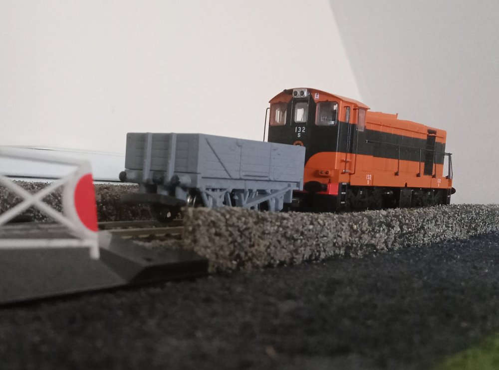

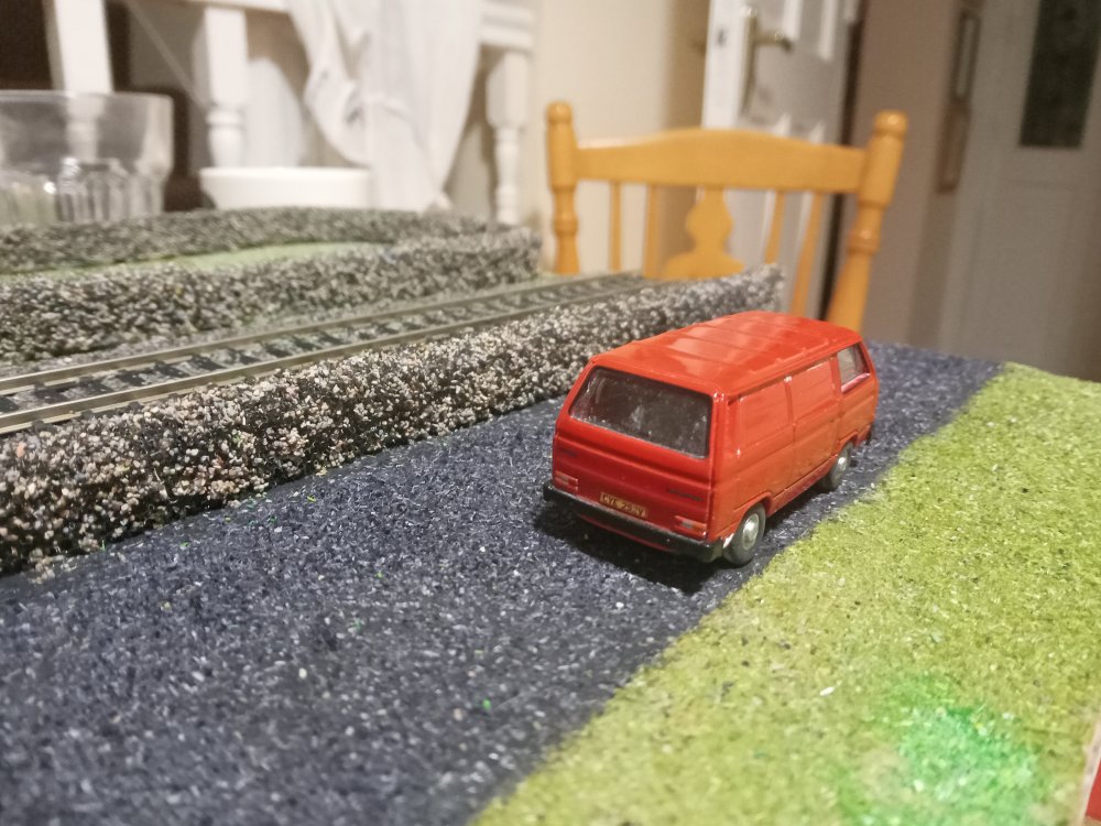

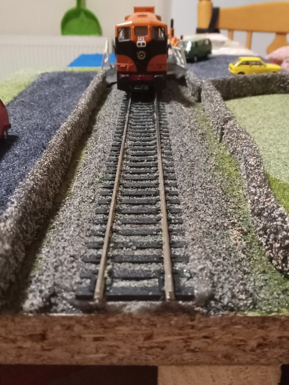

Super productive day today. Despite almost melting. Being able to work on this piece outside helps a lot.IMG20220719002246_01.thumb.jpg.d5bd4d03e55351b7f2415111cc31c6f8.jpg
Road paved and I'm rather happy with the outcome.
Half the water work is done. Not as green as I was going for but as this took a few attempts as is. Will look nice once finished tomorrow.
Ballasted the very short bit of ballasting that needs doing with n scale ballast.i wanted to make it a bit darker but I wanted to avoid that new ballast look so these small grains are the solution for now. Tried to leave a little green verge beside the track bed as in the prototype.
And stone walling everywhere. Wouldn't be mayo without it.
142 awaiting the  mgwr ish gate.
Sher I can't lift this yoke are you sure it's the right wagon?!
142 returns with its wagon.
Edited by Sean

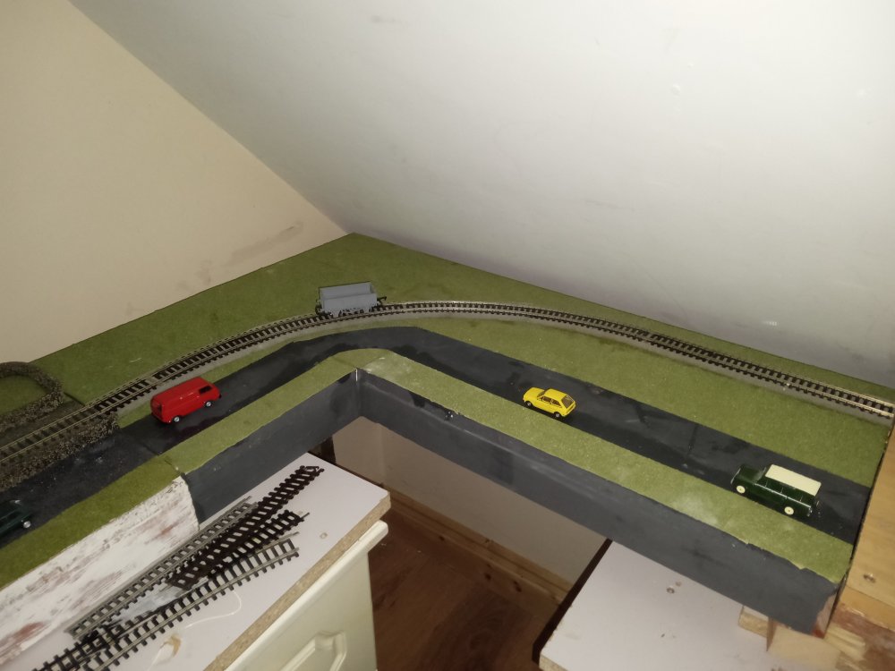

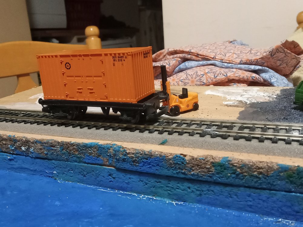

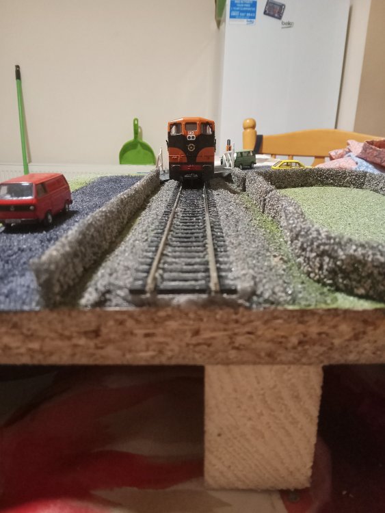

Some time later.
Guess I need to build another baseboard for the other side now.
First radius curve but shouldn't cause too much heartache with my chosen rolling stock.
This should let me tease out the narrative a bit more and add to my scenic skills..
I'm really enjoying the pace of taking out a section and doing a lot of scenics in a small space at once.

2121703823_Screenshot2022-07-21at04_33_09.thumb.png.dc024cb42fd09fd180482bb460a893b6.png
This one is estimated 1970's (around my time) good to note a lack of cobblestones which will make my life far easier. Apparently this ship was built in 1957 for general cargo and carried in coal and timber.  It was renamed in 1986.
So with tonights digging it seems that even in the later days of this harbour it was still accommodating big ships as well as just being a small fishing harbour which greatly increases what i can do here.
as well as box vans and cattle vans  we will also see coal  and ranks grain hoppers. alongside a few other misc pieces of traffic that would have moved by sea and rail
Where i am going to deviate from prototype is simple ; instead of being lifted in the 70's the line remained for another 20 years as a goods only line right onto the quay. I am not going to specify train frequency as im sure this will change as much as my mood and the operating era does. it can alll be operated by a single engine and even in the latter days it was almost unheard of to have a second engine on the line although it did happen from time to time. the station is completeley disused except for the goods platforms and the very occasional railtour.
I want to set up an automated shuttle from the dock to the station for goods. a small platform is being considered for a railbus to run down to the docks also however I dont think that idea will make my final cut.
Edited by Sean
Link to comment

you might like this one.
Frank Gill’s Caravan Park, Roman Island, Westport Quay. 1973. Original photo by Liam Lyons
Would this platform/weigh house refer to the Limerick steamship building you are talking of? I actually have the scalescenes coalstage/weighbridge building ready to be assembled to go into that place, however  if that one was more suitable it would definitely be within my budget. There is another little hut marked weighhouse at the other side of the pond also. Ive also got a resin version of a similar stone hut that came with  the ratio oil depot kit that i could swap out for the scalescenes kit as this layout is definitely becoming more detailed than the one that building lives on now.
Not sure where i seen this now, but the lift is dated 1904. which explains the confusion in dating of earlier photos.

Another great day today!
All of the ground work done on this module. Dowels in. Track down and aligned. green matting down. No ballast left and that has to come from hattons so it must wait.
The little lick of the paint really cleans up the look too when compared to the messy front of the dock still.
Leaves me with a sort of blank canvas for what is to come next.
Quay built. Just have to paint this module again and make stonework now. Then I'll think buildings.IMG20220721220640.thumb.jpg.705b1d21ecc9cb2cd67ca92511c966bb.jpg
Level crossing cemented in situ.

On 17/7/2022 at 1:44 AM, Sean said:
some non railway shots to add reference points...
1786475053_Screenshot2022-07-17at01_26_43.thumb.png.bedfadf91345cde18bc48753ff031973.png
hard to see any evidence of a railway today except for what we know from geohive. would those old buildings in the foreground possibly be the mills you are referring to?...
This view shows a marked change since I last visited this place in December 2001. There are many more cars present.
The buildings fronting the main road in the background had not long been converted into holiday flats and were all empty - after all, not many people tended to holiday in Westport in the depths of winter, so I had the place to myself. The red building wasn't painted red back then, and the parts painted cream in the photo hadn't been painted either.
The old structures in the foreground of the photo were of course still there.
I could sort of pinpoint where the goods platform at the Quay station had been - it was more or less adjacent to the spot latterly used for turning buses round - but there was little else to suggest that a railway had ever been there.
