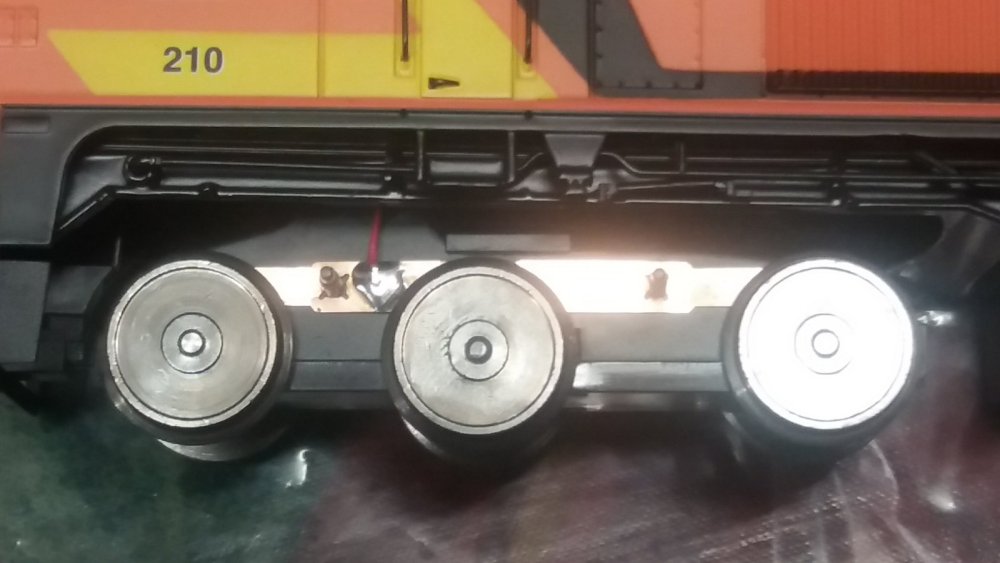

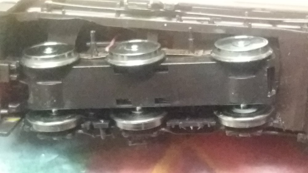

So I managed to pick up a 201 when IRM put up a small bit of extra stock the other day. However, when I took it out of the box both couplers, one of the buffers, and half of a bogie fell off, along with some other minor parts. The train still runs though with an exposed piece of metal that causes sparks whenever it touches the track.
I still have the missing pieces. What should I do now?
Looks better in those pics. Maybe just the light/camera combination in the original pic. You won't want to send it back because there are no replacements and putting the bits back on a loco is basically par for the course with many models, so the best thing is to lay out the bits and try to match them up using the exploded diagram. The only thing of any real concern would be the shorting you reported. Which piece is it sparking from?
That's the power pickup spring. It should be parallel to the bogie frame and in behind the 3 wheels, touching the insides of the wheel faces. Can you compare to the other side of the bogie and try to seat the pickup to match the good side?
It apears the post man was not to kind to the 201s due for cork. As yet another 201 has been reported pretty seriously broken. Once again 230 burst through its box and r the front from the buffer beam down ( and some bogey detail missing)…..good bit  of damage done unfortunately
The phosphur bronze pick up strip has two holes in it. These holes slot over the two protruding lugs between the wheels. The outside of the chassis frame has two holes that these lugs slot into, holding the bogie side frame in place. As your phosphur bronze strip is askew, one end could be hitting an axle thus shorting out. It will be o.k. when fixed properly in place. Here are some photos 0f 210. They show the protruding lugs and the phosphur bronze strip in place.

Thank you for the help, everyone. I managed to reattach the fallen couplers and buffer, and though it was incredibly fiddly I finally got the bogie reattached and in line. Haven't run it yet (piles of Monopoly boards to avoid the carpet isn't really a good running environment) but the train looks well again, at least.
Thanks again!

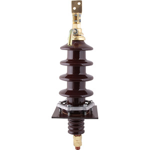

I once got a letter from some obscure place in the ex-colonies, asking for a spare terminal bushing* for a thing that I'd never heard of. Some searching found the details of the component. It was clear that there would not be 'one lying about somewhere' and, it would be hugely expensive to attempt to make one, plus the design required materials that would have been illegal many years before, so it would require a completely new design.
I informed the potential customer of the ridiculous price that we would require, should we agree to have a go at making something that might work.
They got quite shirty about us not having one on the shelf, even after I pointed out that they had bought it before my father was born.
* This sort of thing.
Discover Quality Wholesale Transformer Bushing For An Amazing Price -  Alibaba.com
