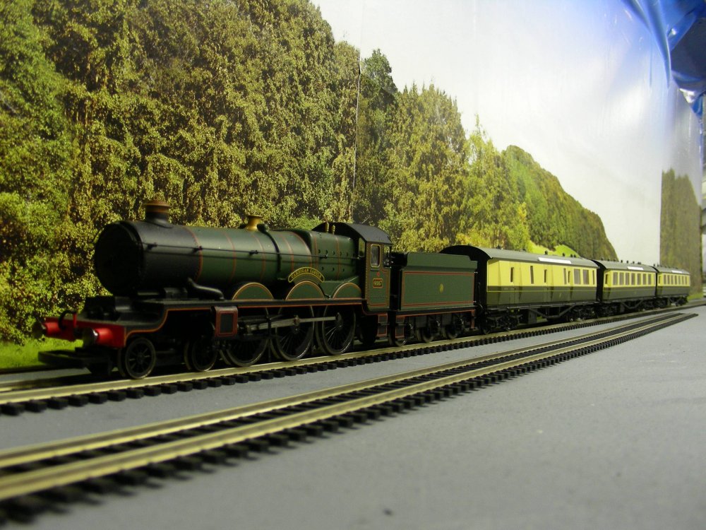

Broithe Posted June 19, 2013 Posted June 19, 2013 (edited) The only thing I wasnt sure about, which is more clear in photo2, is the 'turn' at the corner, and how to smoooth it out. Either that, or just photograph either side It's good if you can sweep the bend, with a bit of hardboard or something - "there are no corners in the sky", as somebody once said. Not the best picture, but here's an example. It does make a difference. Edited June 19, 2013 by Broithe
BosKonay Posted June 19, 2013 Posted June 19, 2013 Hmm, reckon I'll have to have a go at a curve, the one in the photo is too abrupt, and will cast a shadow no matter what I reckon...
Broithe Posted June 19, 2013 Posted June 19, 2013 Hmm, reckon I'll have to have a go at a curve, the one in the photo is too abrupt, and will cast a shadow no matter what I reckon... It's worth the effort at this stage. Something like a one foot radius allows the lighting to blend nicely. Any corners will always show up.

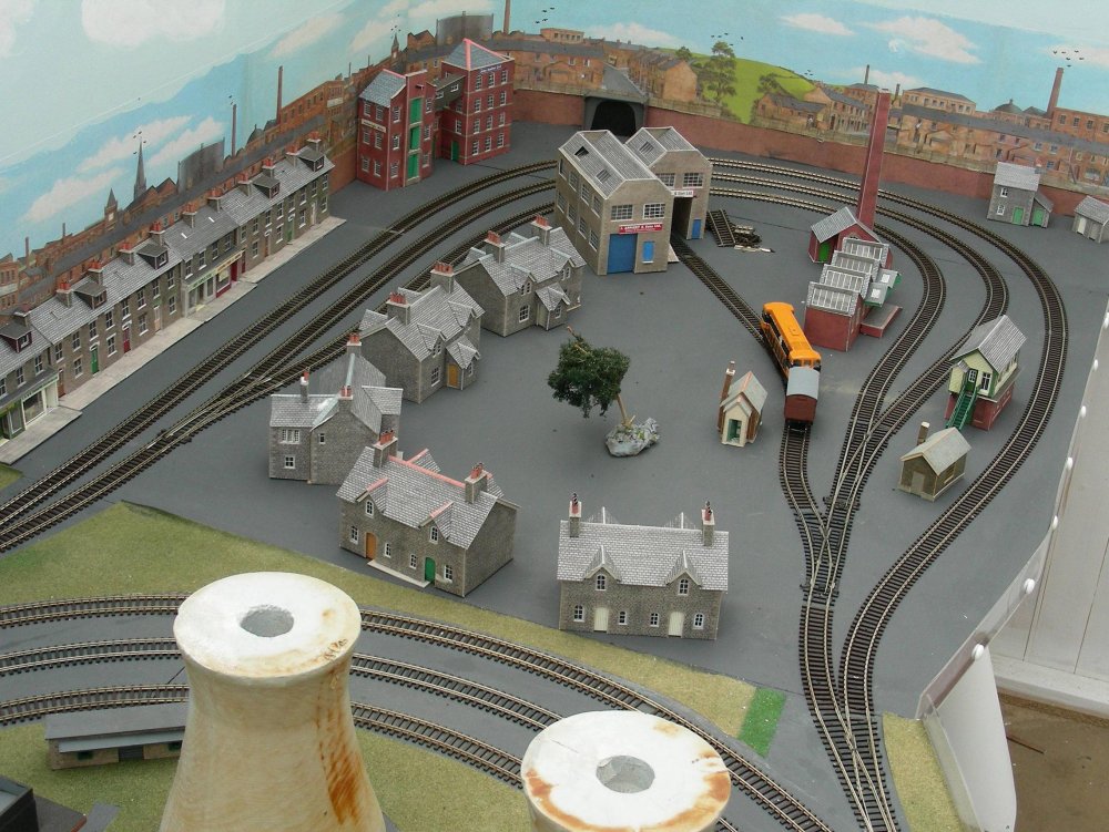

Broithe Posted June 20, 2013 Posted June 20, 2013 These came from International Models - http://www.internationalmodels.net/acatalog/26_Inch__26___High_Backscenes.html - they're about two foot three...
