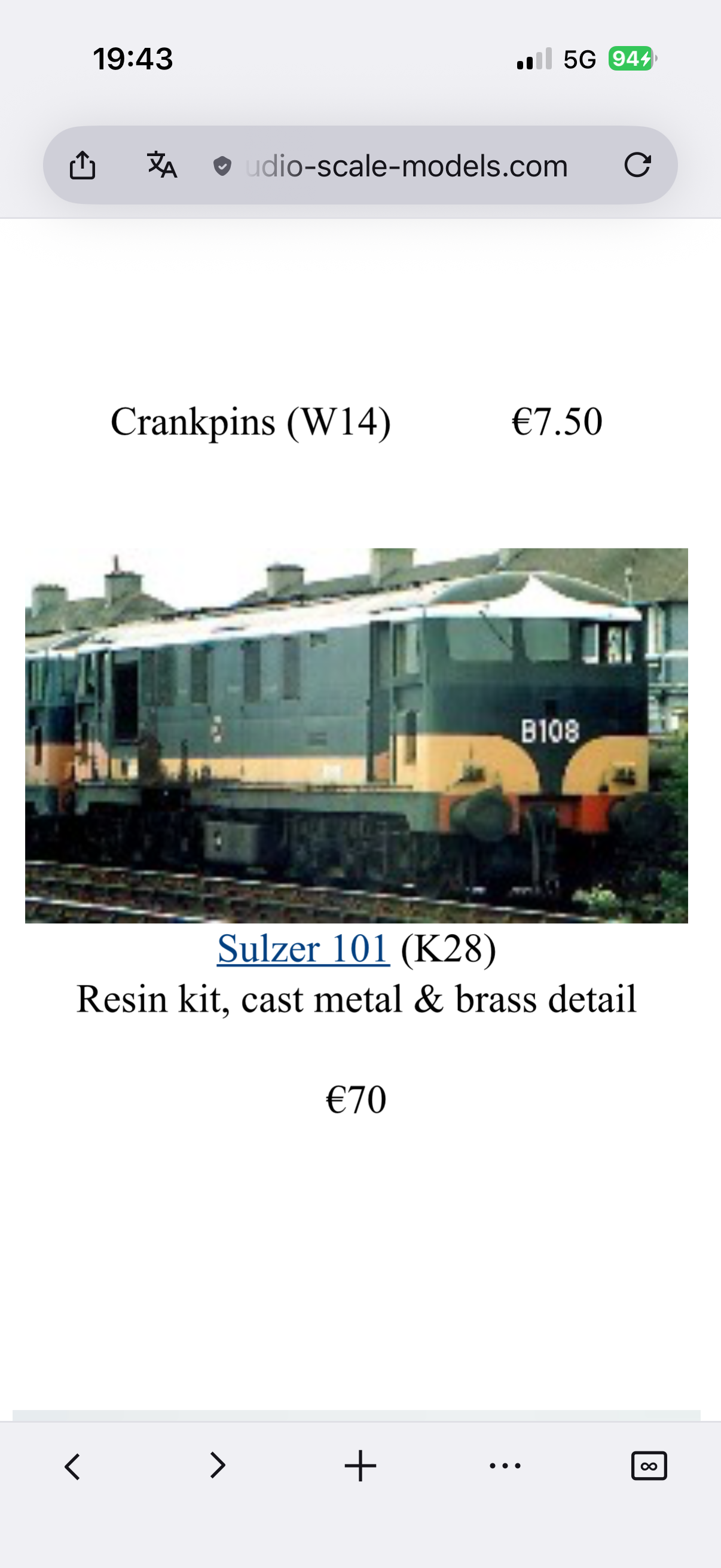

jhb171achill Posted July 18 Author Posted July 18 Now THAT looks like a brass kit - I thought the SSM one had a resin body? Is that wrong?
GSR 800 Posted July 18 Posted July 18 6 minutes ago, jhb171achill said: Now THAT looks like a brass kit - I thought the SSM one had a resin body? Is that wrong? It was the brass master for the moulding 1 1
DJ Dangerous Posted July 18 Posted July 18 Resin body with brass parts, according to the SSM website. Possible that @Weshty switched from full brass to a hybrid resin / brass at some stage. I’d assume that the chassis requirements are the same but would suggest contacting Dez to confirm, before taking his very last kit. 3

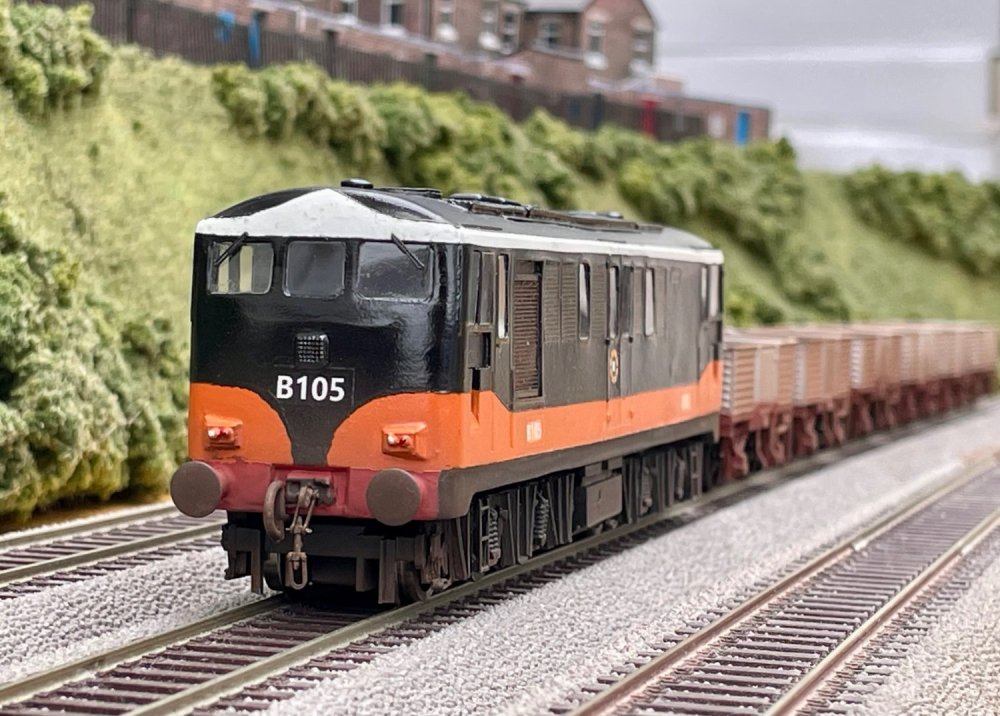

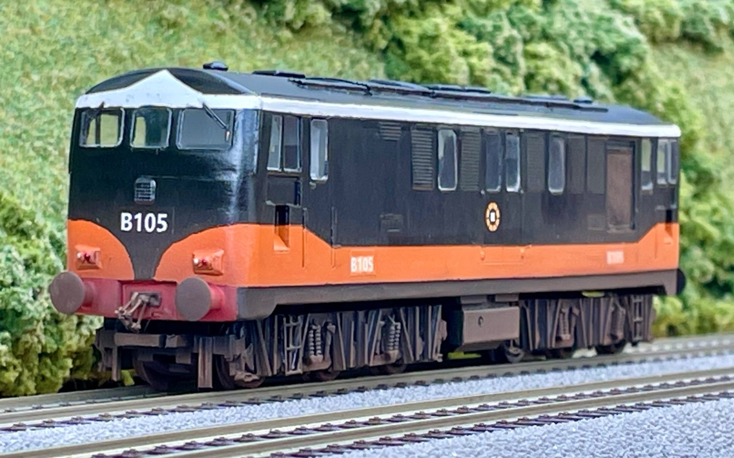

Darius43 Posted July 18 Posted July 18 (edited) I built the Silver Fox resin bodied version a year or so ago, using a cut down Lima Class 55 chassis. Cheers Darius Edited July 18 by Darius43 9
Mol_PMB Posted July 18 Posted July 18 Nicely done. Am I right in thinking that the Lima Deltic had HO scale bogies, making them too short for the Deltic model but conveniently a better match for the B101? as a reminder, there are some drawings here:
Darius43 Posted July 18 Posted July 18 1 minute ago, Mol_PMB said: Nicely done. Am I right in thinking that the Lima Deltic had HO scale bogies, making them too short for the Deltic model but conveniently a better match for the B101? Not sure but it sounds like something that the Lima of that time would do. Cheers Darius
jhb171achill Posted July 18 Author Posted July 18 34 minutes ago, Darius43 said: I built the Silver Fox resin bodied version a year or so ago, using a cut down Lima Class 55 chassis. Cheers Darius That looks VERY well. 2

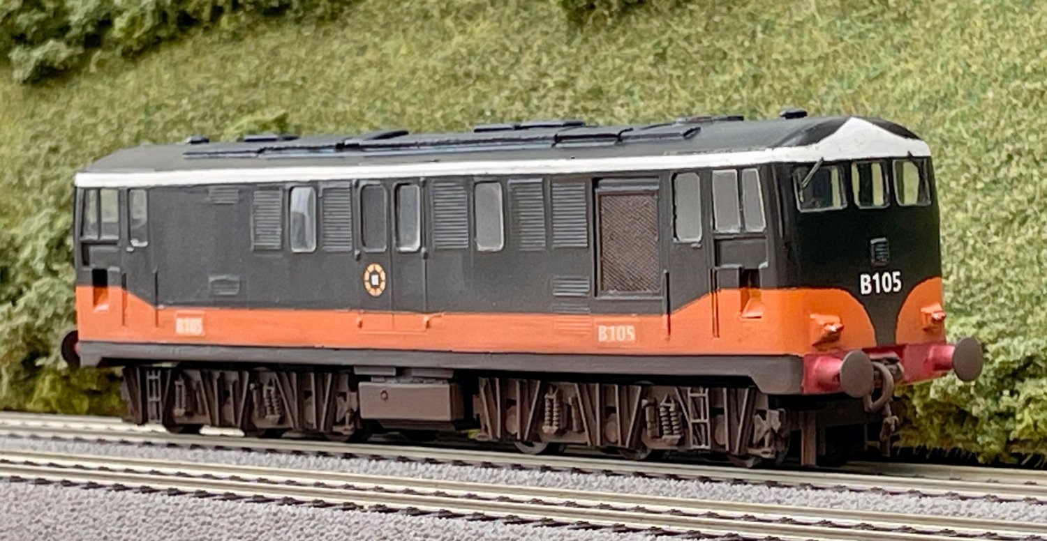

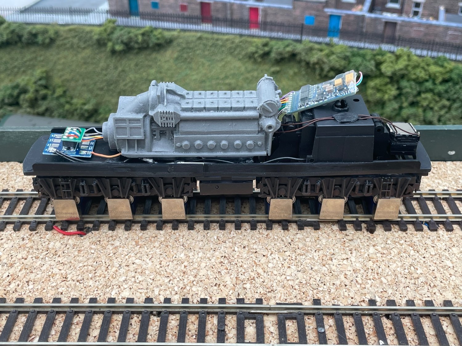

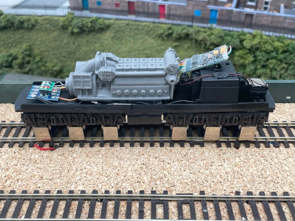

Mike 84C Posted July 18 Posted July 18 Heres mine, it now has windows and decals. Cutting the windows to fit was the most tedious job on the planet! But it does sound rather good with a 1250hp Sulzer sound file. Chopped Hornby Deltic chassis, detail filed off the bogies and whitemetal sideframes from the kit glued on. I'm not as brave as Darius with the close up shots! 10

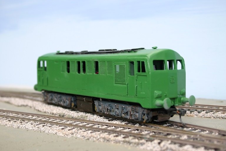

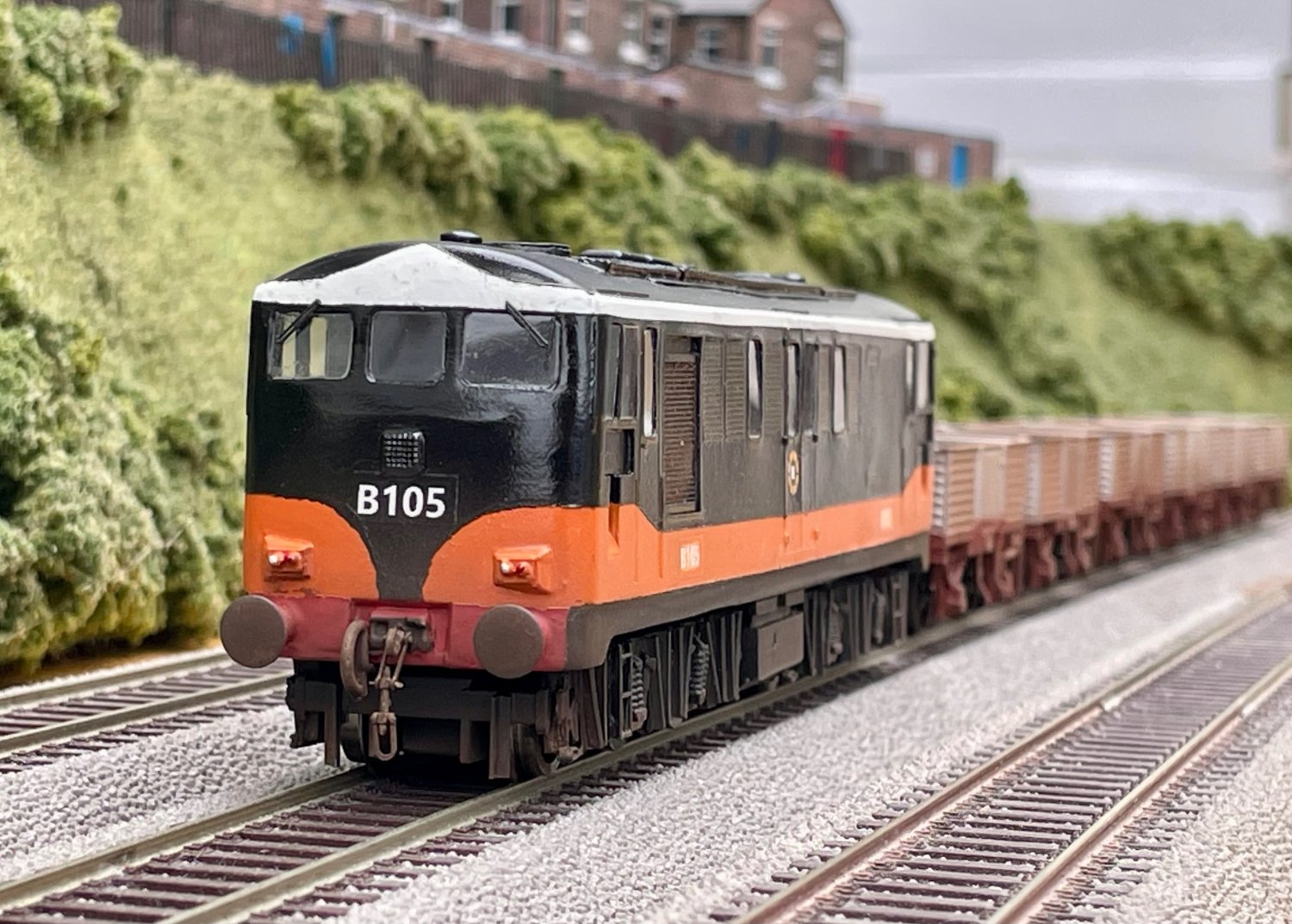

dropshort105 Posted July 18 Posted July 18 3 hours ago, jhb171achill said: Now THAT looks like a brass kit - I thought the SSM one had a resin body? Is that wrong? Resin body, photo etched brass parts, mine runs on a cut down hornby class 55, not a bad little kit. 1 1
jhb171achill Posted July 18 Author Posted July 18 That’s actually as good as I’ve seen. Now I’m tempted again. So it’s SSM? 1
dropshort105 Posted July 18 Posted July 18 1 minute ago, jhb171achill said: That’s actually as good as I’ve seen. Now I’m tempted again. So it’s SSM? Go on, splash out Mine originally ran on a lima 55 bogies on the supplied brass chassis, but not very well, replaced it with the cut down hornby 55 chassis runs fine now. 1

Weshty Posted October 5 Posted October 5 (edited) Hi all, just so you know, I have stocked up on castings and etched parts, so ready to supply your 101 kit needs. To be clear, the kit is resin, but all the roof detailing, walkways and grills are brass etched. The buffers, bogie sides and fuel tank are cast metal. Edited October 5 by Weshty 11 3
