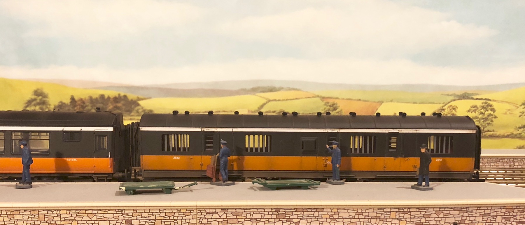

Noel Posted March 18, 2018 Author Posted March 18, 2018 (edited) CIE Brake Parcel Van finished at last. Converted from a Bachmann LMS parcel van. Lightly weathered using a mix of weathering powders and airbrush. I've enjoyed doodling with this little project. I'm reasonably happy the way the light weathering turned out. Woodvale Junction station pilot about to shunt CIE brake parcel van onto rake of laminate coaches. Bachmann donor before and after conversion Edited March 19, 2018 by Noel corrected photo error 5 2 Quote
PaulC Posted March 18, 2018 Posted March 18, 2018 (edited) Doodling? What would you be capable of if you really put your mind to it?! Paul Edited March 18, 2018 by PaulC 1 Quote
Noel Posted March 18, 2018 Author Posted March 18, 2018 2 hours ago, jhb171achill said: Nice job! Thanks Jonathan. ''Twas your advice last year that gave me the idea of doing a brake parcel. 1 hour ago, PaulC said: Doodling? What would you be capable of if you really put your mind to it?! Cheers Paul. The main thing was it was enjoyable. 1 Quote
popeye Posted March 18, 2018 Posted March 18, 2018 That's a beautiful job Noel. Great weathering. 1 Quote
Noel Posted March 18, 2018 Author Posted March 18, 2018 (edited) 21 minutes ago, popeye said: That's a beautiful job Noel. Great weathering. Thanks Popeye. Encouragement from a skilled maestro such as yourself is humbling. The cutting and filling was scary but took it slow. CIE Brake Parcel van made it debut on the layout this evening. Its play time. Edited March 18, 2018 by Noel typo Quote
popeye Posted March 19, 2018 Posted March 19, 2018 I don't think i have ever seen a clean one of these, you have weathered it just right. 1 Quote
JasonB Posted March 19, 2018 Posted March 19, 2018 On 18/03/2018 at 4:53 PM, Noel said: CIE Brake Parcel Van finished at last. Converted from a Bachmann LMS parcel van. Lightly weathered using a mix of weathering powders and airbrush. I've enjoyed doodling with this little project. I'm reasonably happy the way the light weathering turned out. Woodvale Junction station pilot about to shunt CIE brake parcel van onto rake of laminate coaches. Bachmann donor before and after conversion Lining looks spot on Noel very crisp, lovely finish too with the weathering 1 Quote

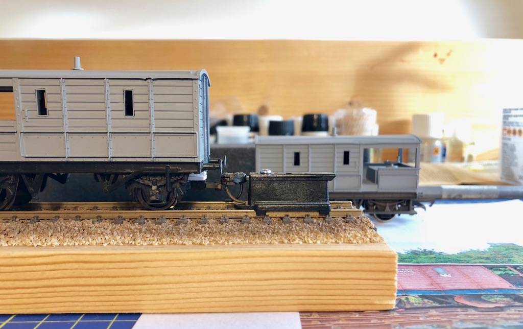

Noel Posted March 27, 2018 Author Posted March 27, 2018 Back doodling with the pair pseudo ex-GSWR ballast ploughs converted from 1972 Tri-ang GWR brake vans. Jeepers these old plastic models were rough mouldings in their day, with loads of flash and mould line ridges that had to be filed and sanded down. Dog rough but then again they were designed to be thrown out of cots! Got the windows cut out and framed, removed the industrial revolution sized brass coupling rivets, got the massive metal tri-ang tension lock coupling removed and all the surplus plastic from the chassis including brake gear. Just fitted a NEM pocket that will take a Bachmann tension lock or a Kadee no 19, which is seen here test fitted with the kadee coupling gauge. Had to decide what size wheel i'd fit before aligning the NEM pocket for ride height. First coat of primer on the body, a few spots of filler needed. The chassis were made out of a very soft bendable plastic - cot proof I guess. Before going much further need to figure out how I'm going to fit the oil lamps and a flickering stove light. Chimneys to be moved and stanchions added to the veranda. Think I'm crazy trying to recycle this pair but its fun doodling occasionally with them. Quote
David Holman Posted March 29, 2018 Posted March 29, 2018 One of those projects that might have been quicker and easier to scratch build, but if it is enjoyable, then why not? Looking good too! Quote
Noel Posted March 29, 2018 Author Posted March 29, 2018 4 hours ago, David Holman said: One of those projects that might have been quicker and easier to scratch build, but if it is enjoyable, then why not? Looking good too! Hi David. Yes that dawned on me too just after I started out, but I am just enjoying the doodling while recycling these old toys from 1970. It's been fun cutting them up with little risk if it goes wrong as they were ancient and rather crude Tri-ang hornby wagons. Noel Quote
jhb171achill Posted March 29, 2018 Posted March 29, 2018 Those are looking great! Not sure when they started painting them yellow, but probably after they covered them in steel sheet. In this guise, either a slightly darker grey all over (inc. chassis obviously), or brown all over..... The DCDR one, as most will know, is completely incorrect in its livery. GSWR markings, but CIE brown on sides; and black chassis - a mix of the unmixable, and the never-used! SSM have suitable snails or roundels. 1 Quote
