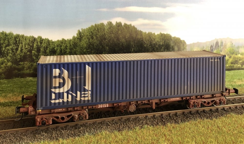

Getting around to 42ft containers now. Just a very gentle bit of weathering, just enough to take the pristine look off them. These are growing on me, but I did wash my hands after handling something so modern, and I am booked for confession with Fr Black O'Tan next week. Fearful of what my penance might be, it could be something awful like four trips on a 22k   😱 , or if deemed a mortal painting error perhaps 3 trips on a luas. 😱  😱   😱   😱 Seriously though the bodies of the 42ft container flats are really superb.

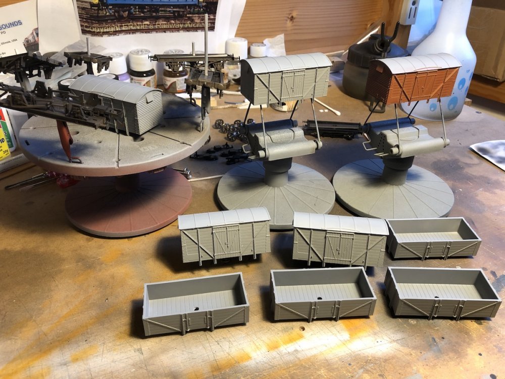

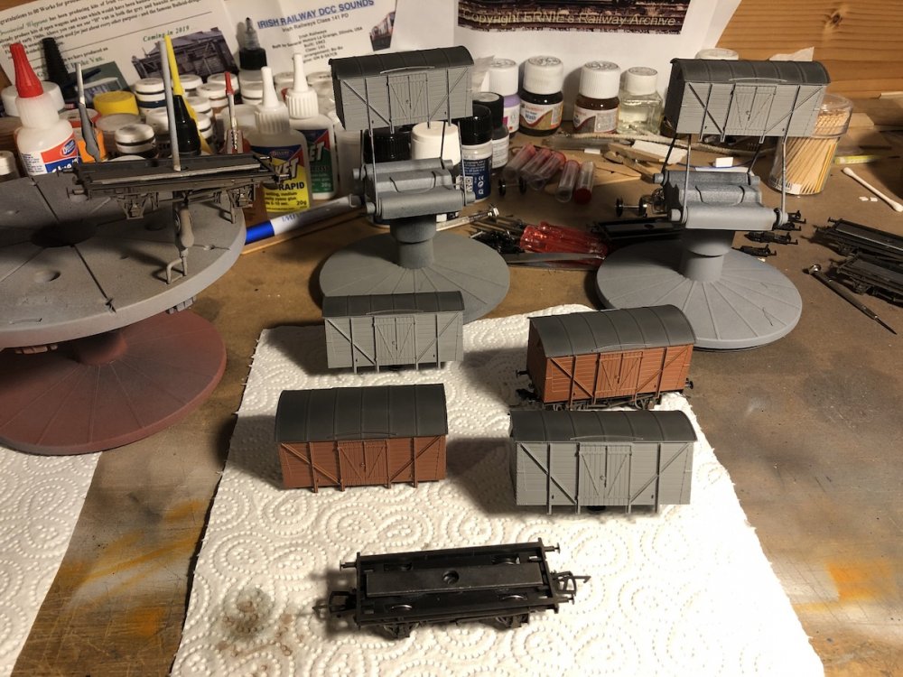

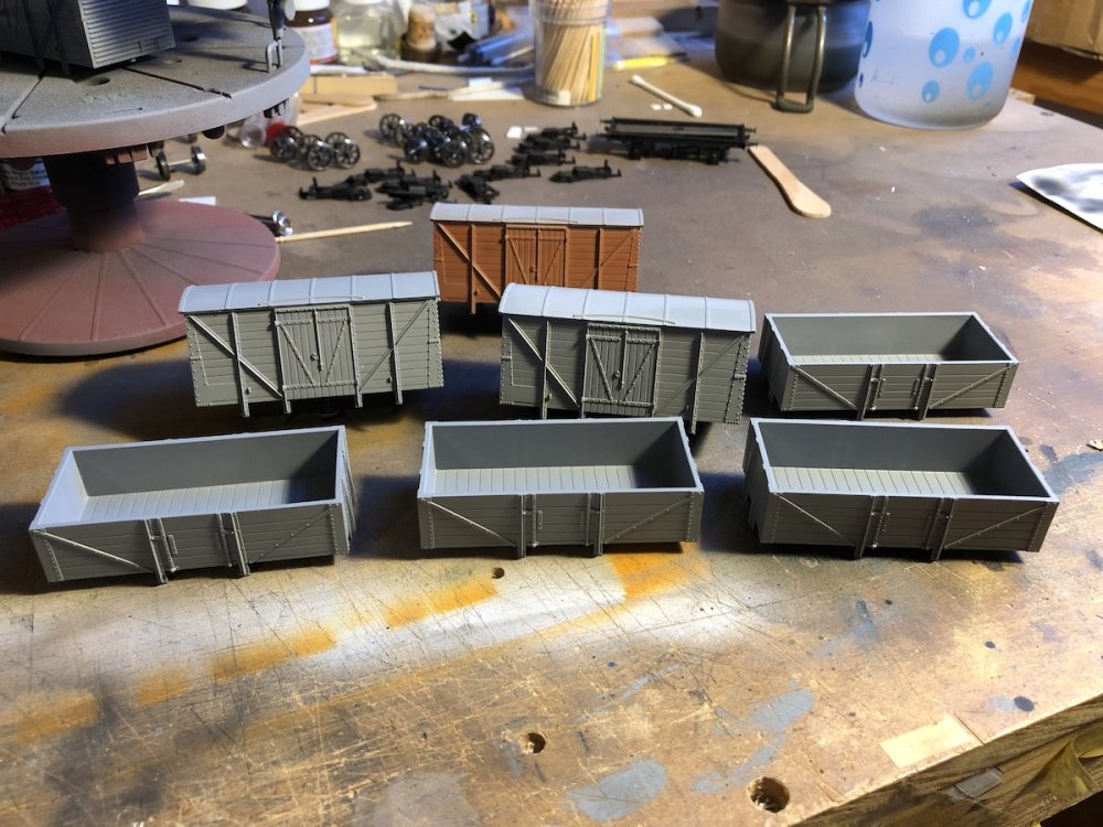

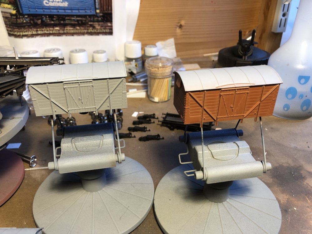

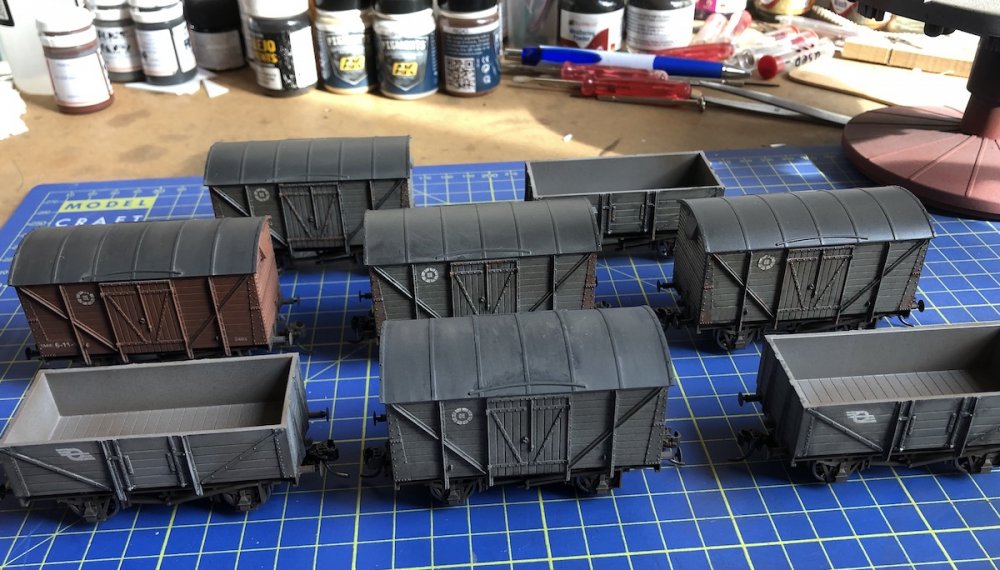

A visual recap of recent Dapol kit bashing to CIE wagons
Primed using Halfords plastic grey primer, then started airbrush their wagon colours
Airbrushed grey and brown van colours
Did some 5 plank open wagons while I was at it for flying snail era
Roofs next, NEM pockets tweaked ready for kadee no 18 couplings. Small bit of fettling to ensure weights fitted back inside.
Varnished and then decals applied. A few fails here that had to be redone as I took a short cut that I shouldn't with spot painting gloss varnish

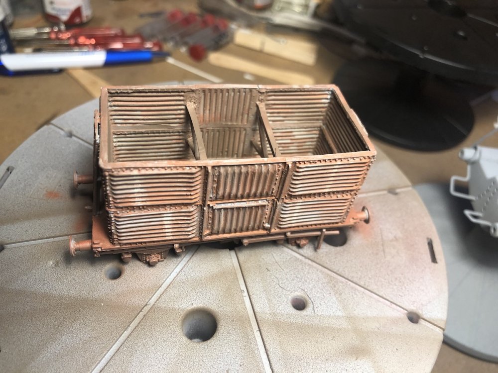

The first step in weathering. Powders in solution (50% water/50% Humbrol decalfix), brush on, wipe off.
Chassis had already been sprayed with gunk. A tiniest bit of frame dirt over spray on wagons.
Finish up with a bit of touching up rust spots
Finally acrylic matt varnish and finished
The cost of each wagon ended up being about €10 including couplings transfers and paint.
I'm bored now, what's happening next?  Ah some more cement pallet wagons perhaps, DCC conversions, and some resin stuff.

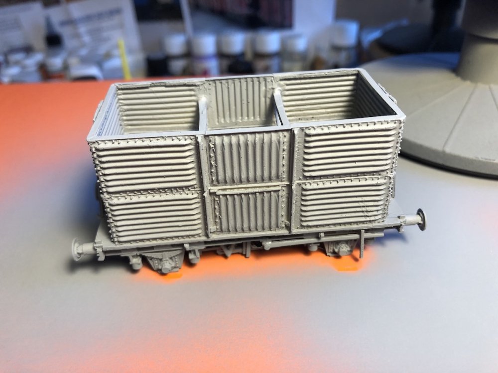

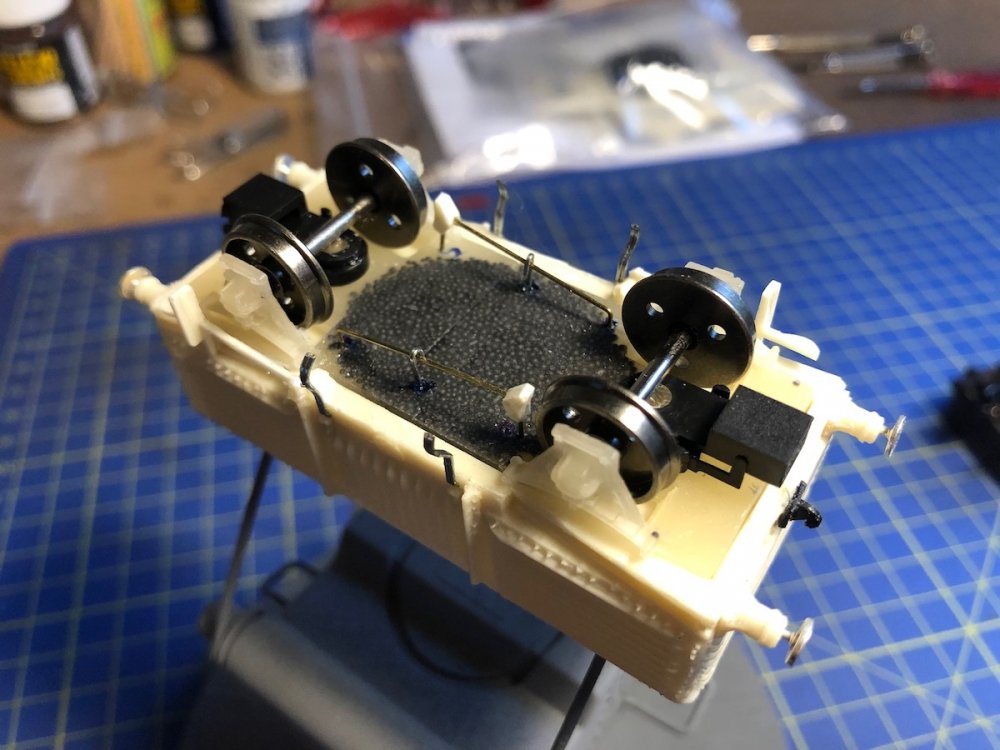

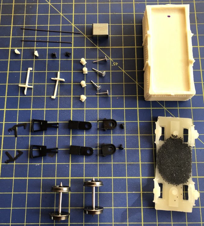

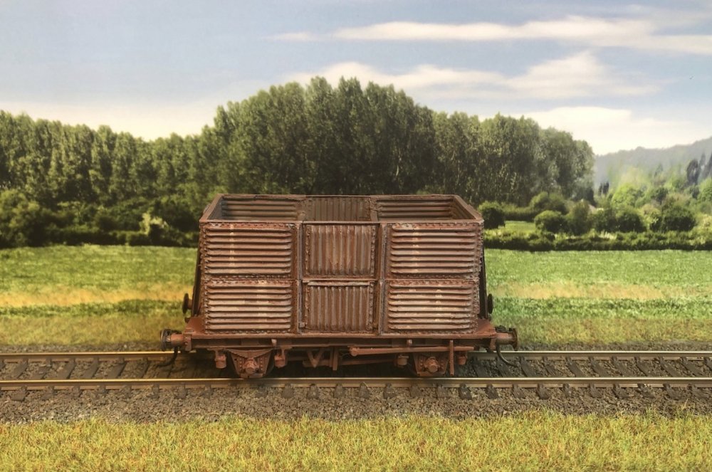

Started a provincial wagons double beet wagon kit. Five more to complete after this test build.
Prepared the parts, removed flashing, a little cutting and filling and hey presto a kit is ready to assemble.
This is a fairly straightforward build once you figure out what goes where and drill a small number of holes. Wheels fit really well and test run she was smooth and free. Nice bit of weight in the body due to the embedded lead in the resin chassis floor.
Add some brake gubbins below the sole bar and off to the priming booth

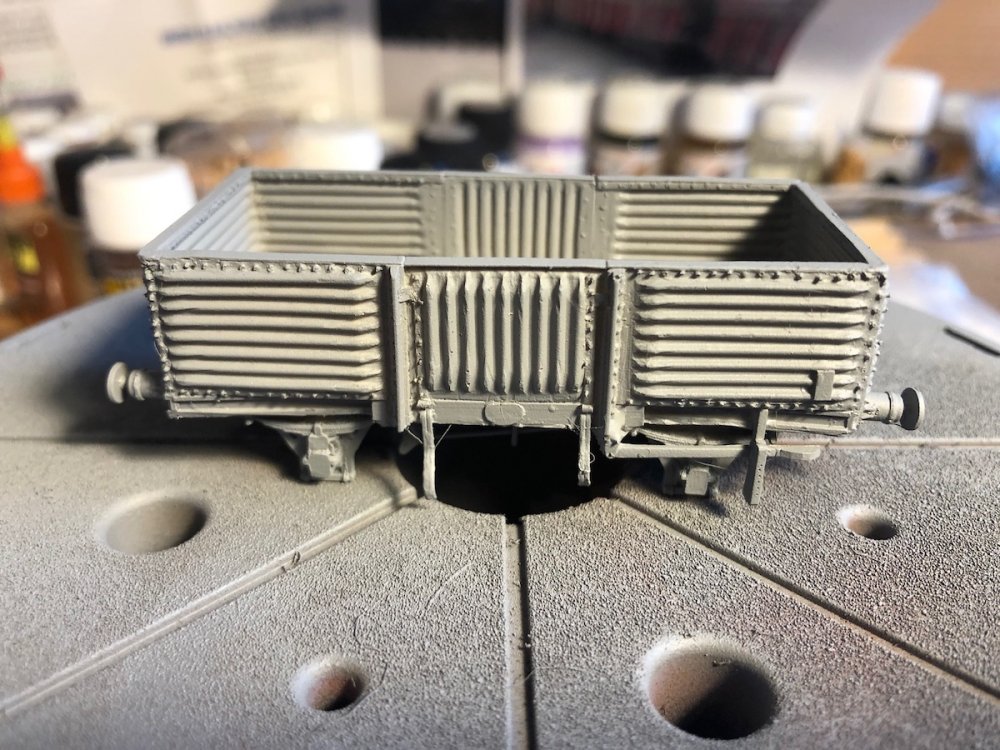

Halfords plastic grey rattle can primer used. Gave good coverage and I opted for grey rather than the traditional red for reasons that will become apparent at the end. I made a boo-boo at the weekend and fitted the internal cross braces too high, next morning when I saw, didn't like the position I'd put them, so out they came and refitted at a better height inside the wagon. These nicely push the upper body sides slightly apart to parallel and square.
Decoration and weathering started this evening. Hopefully will finish her tomorrow or Wednesday. Before the postman arrives with 5 more.

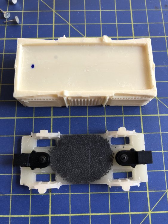

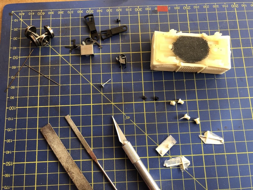

Just starting another Provincal Wagons kit. This time a single beet wagon. Preliminaries include removing flashing from resin parts, fettling under wagon floor so that chassis block fits nicely, drilling and screw fitting NEM coupling pockets to under chassis block, and a little filing and sanding. Might make a few modifications as I have some dart castings heavy buffers in the toolbox for the later CIE iterations of these wagons. Enjoying this. Tomorrow the break gear has to be fabricated and fitted. Happy days during CV19 confinement.
All the parts prepared
A little fettling needed to get the under chassis to fit snuggly into the base of the wagon floor. NEM coupling pockets mounted and adjusted to avoid the classic dapol coupling droop (ie by filling the screw stock a little shorter so the coupling is tight). Kadee's work better this way on 2 axle wagons.
This is another test run for future builds of these wagons.

On 4/21/2020 at 8:59 PM, Noel said:
Thanks guys. This was a first for me (ie double beet assembly and decorating same). Now to figure out suitable seed for a load. I'm glad I primed it grey rather than red oxide.
Given the odd report of seeds getting damp with interesting results is it worth doing a load on a piece of plastic sitting on the braces and then moulding some in resin ?  Or perhaps for variation  is it possible to make a mould that is several wagons in size and cutting shapes to suit and give variation?
A great build report and yes the lead in resin works well.  I have numbered mine but left in red primer but having seen this It makes me wonder if going over in grey and starting again would be better , I plan to run mine empty so making a removable load might be a way  to finish.  Thanks for sharing.

8 hours ago, popeye said:
Great minds think alike, i discovered that idea for droopy couplings a couple of days ago, works well. :D
Yes and I have quite a few 2 axle wagons using Dapol RTR donor chassis. They all had droopy NEM pockets. Stiffning them up was necessary for kadee's by filing the screen lug shorter. The dapol NEM pocket doesn't need to be able to pivot for use with Kadee's successfully. I even considered supergluing the dapol NEM coupling mounts to the chassis rather than using a screw. Eliminates two more holes to be drilled.
Edited by Noel
Link to comment
Hi Popeye. I just superglued the NEM pockets to the mount on the underside of the chassis because the protruding retaining screw fouled the wheel axle causing 'stiffness' and resistance. But it seems to have worked out ok. Hopefully I have the NEM pockets oriented dead centre and perpendicular to buffer beam so the kadee's will couple and uncouple ok over magnets.
Coupling screw was just rubbing wheel axle so used glue instead to retain the Dapol NEM pocket. Solves the dapol droop as well.
Chassis is running freely now without any friction.

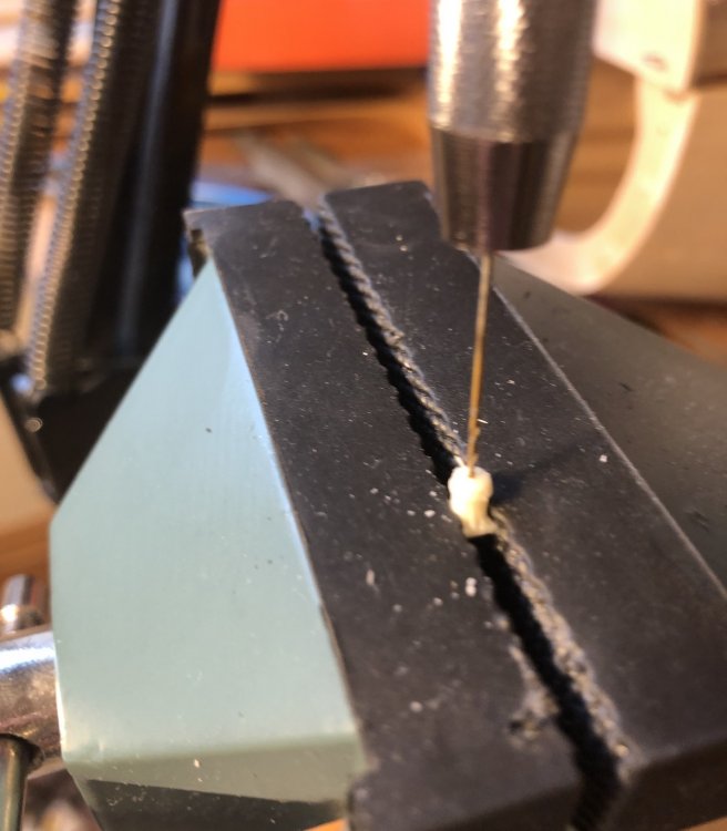

Drilling buffer stocks ready to take buffer heads. This is quite fiddly and needs a 0.8mm drill bit done by hand. Was tempted to fit IRM sprung buffer accessories but saving them for next batch of double beet wagons.

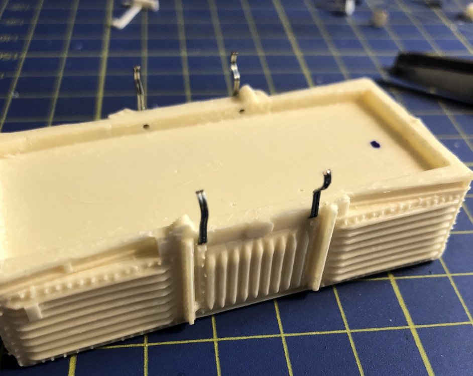

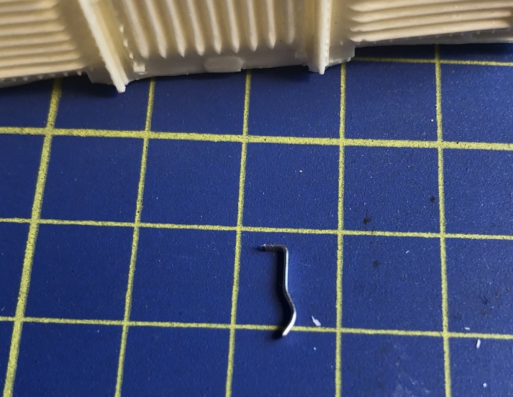

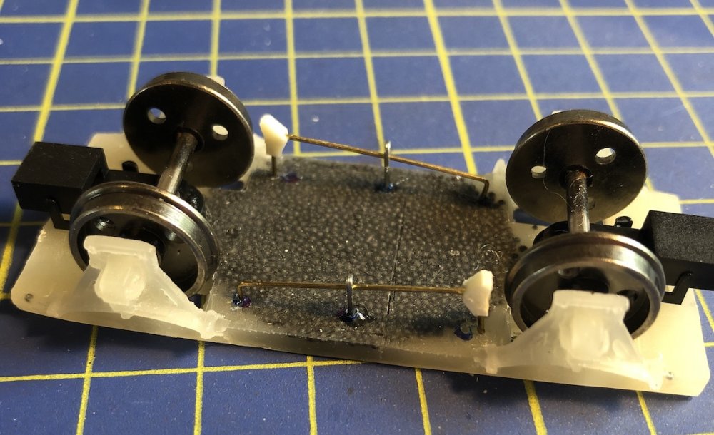

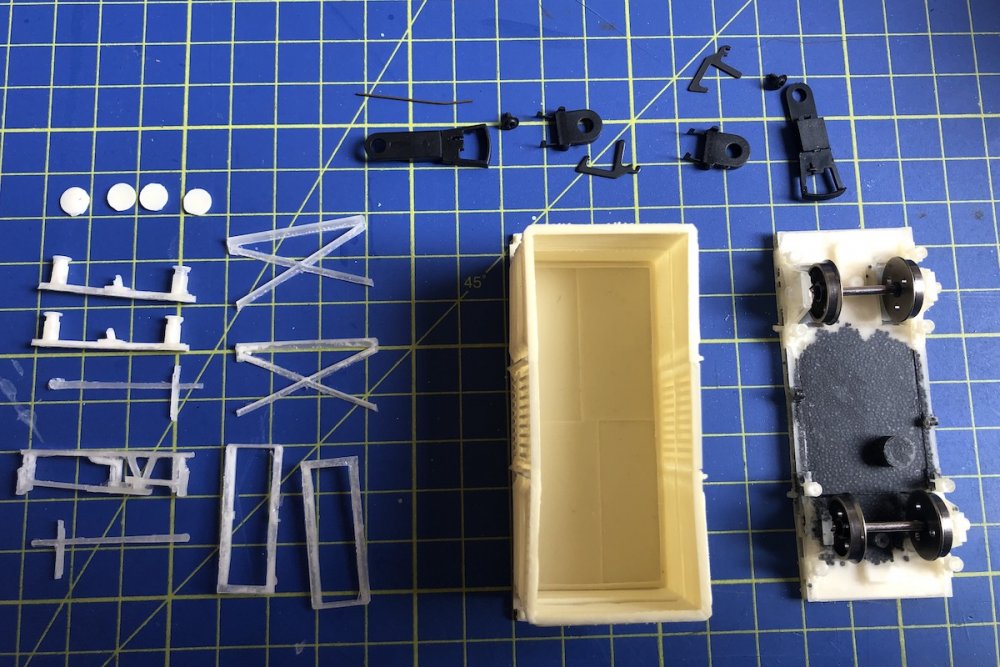

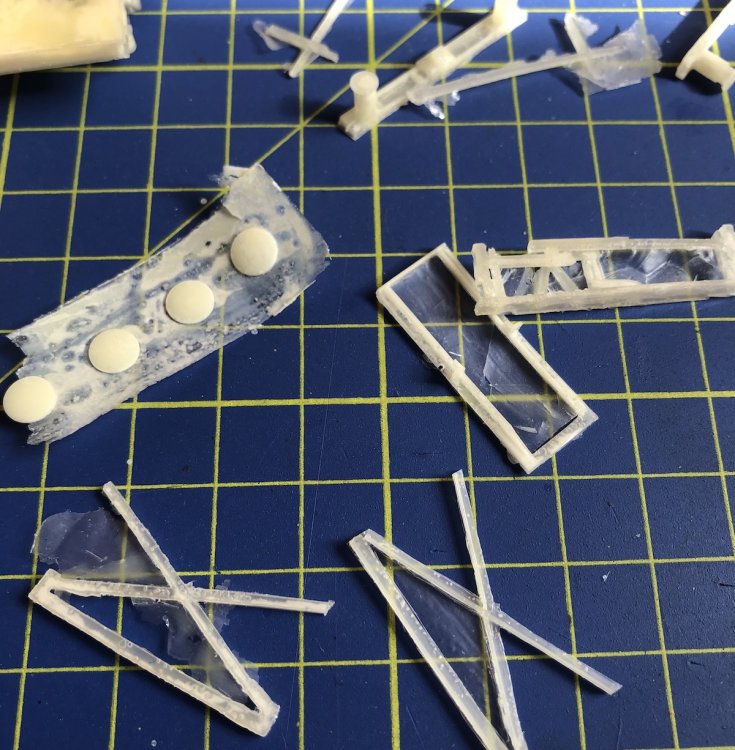

No wonder I don't get on with brass. Spent a few hours fiddling with tiny bits of wire and cutting staples for the brake gear and the door catchers (ie brake gear protection bars for when doors swing down open). Tiny fiddly parts my fingers are bigger than when I was 10yo and my eyes are not those of a 10yo anymore either. :) Frustrating yet enjoyable at the same time.
Not entirely happy but its the best I can manage with these clumsy fingers
Then had to shape four sets of door swing limiters (ie door stops to protect brake gear from damage on prototype). This bit took forever because the pairs of stables kept separating. Mind you my kadee pliers came in handy here to shape the curved bit.
At long last done. Waiting for super glue to cure than will finish it off with the buffers and painting tomorrow. I don't ever want to see a stable again. In future I'll might try and cut strips of aluminium to form these.

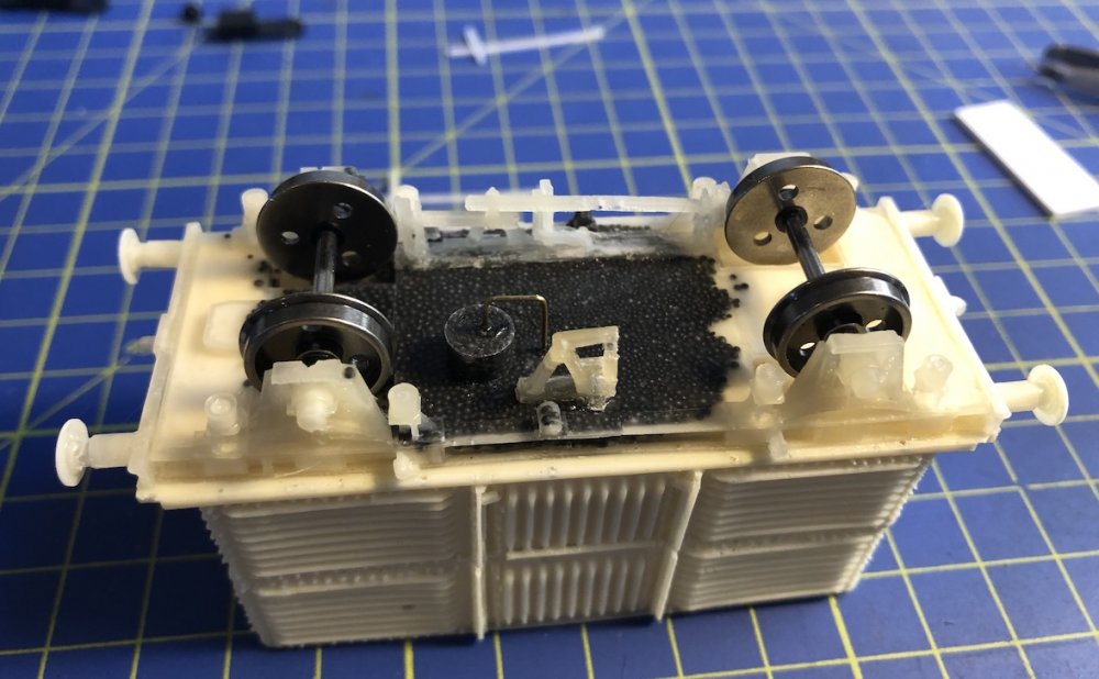

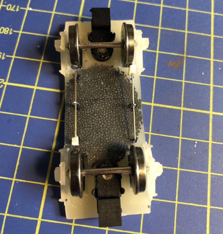

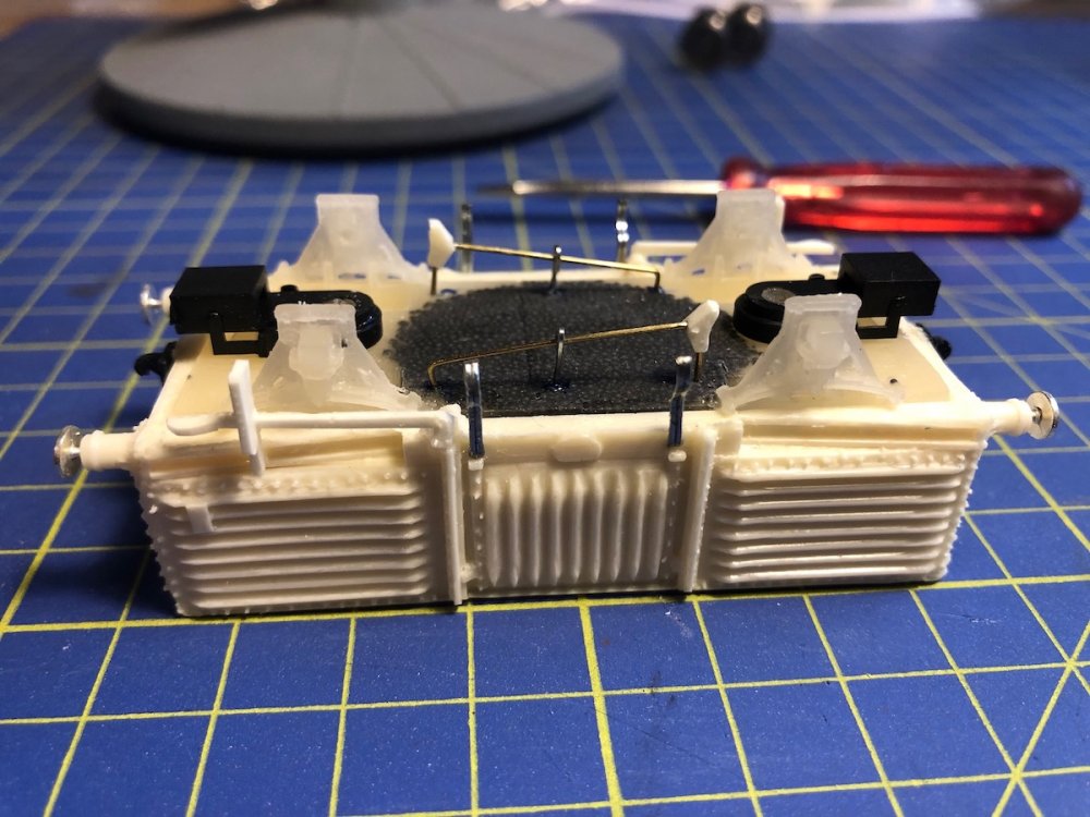

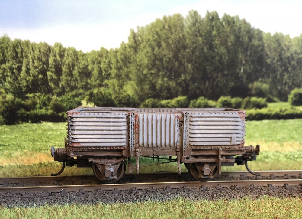

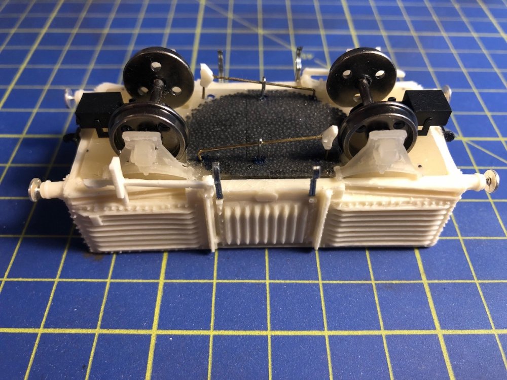

Some more progress this evening. Finally finished the fiddly brake gubbins stuff under the sole bar and buffers added. I decided to build the kit as intended by its designer rather than make any additions such as heavy buffers coupling hooks, etc. It is surprising how it all comes together in the end.
Brake gear stuff. NEM coupling pockets don't protrude past the buffer beam.
All the gobbledy gook gubbins underneath

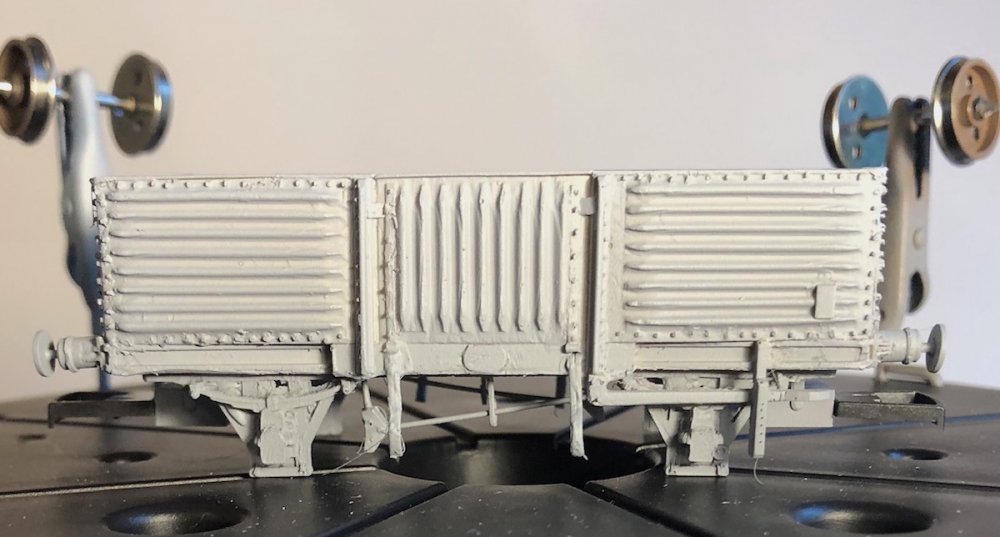

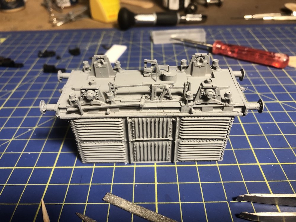

First coat of primer on. Some nice details on this wagon kit like the CIE plate and the consignment paperwork clip plate.
Wheels got some frame dirt added to hide the shine. The gubbins underneath looks at home after bring primed.
There is quite a lot of work on this iconic wagon kit, mainly below the sole bar. Station platforms tend to hide that from my memory. Now ready for tidy up and painting. A most enjoyable little kit. Next time I'll take Popeye's advise and avoid the staples. Happy days. :)
Link to comment

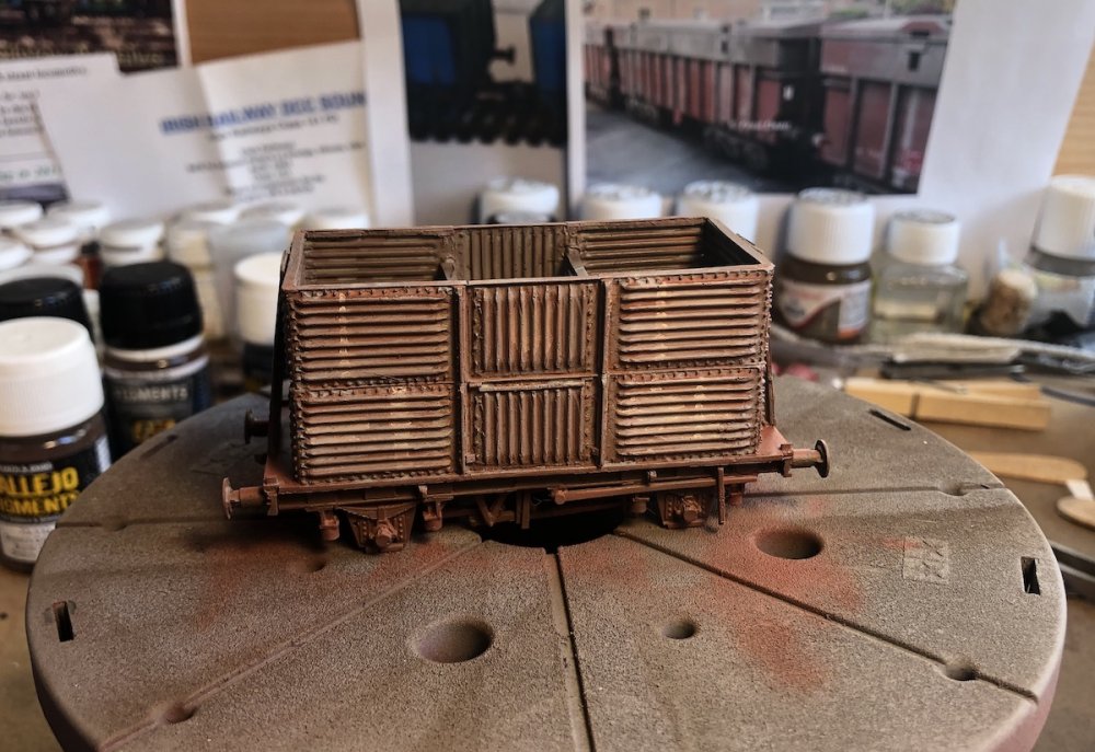

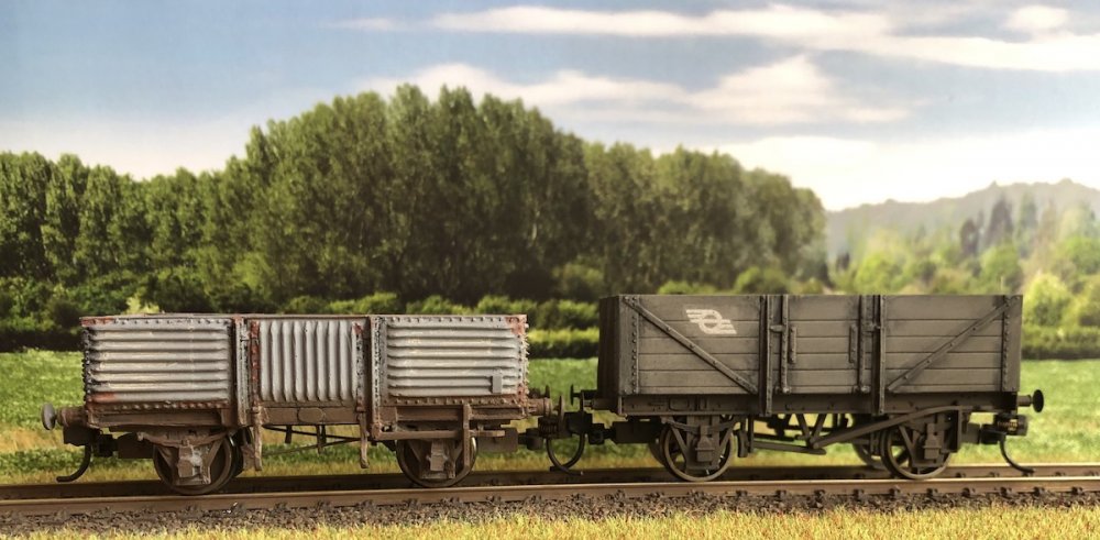

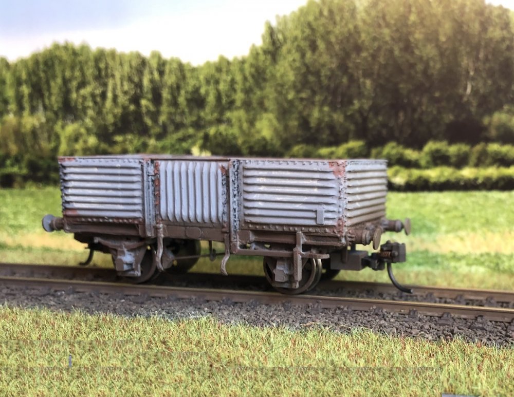

Finished for now. I missed a few spots on the chassis which will have to be revisited. A most enjoyable resin kit build once I figured out the brake gear. Wasn't sure which colour finish to go for, the all grey chassis, or the chassis that had once been bauxite red. Have to paint the buffers properly.
Now joining its recent companion a kit bashed Dapol donor
The bulleid corrugated open wagon was the most widely used wagon on Ireland railways for many decades and by far the greatest number of rolling stock on the railways here in Ireland. It was originally used as a general purpose open goods wagon carrying all manner of agricultural and construction merchandise as well and general purpose merchandise. Along with the GSR/CIE vans these at one time made up almost the entire stock of goods/freight wagons. In their latter days they were almost exclusively used to transport beet.
Thank you Leslie, I finally got around to building this kit. Almost two years after I first bought it.
