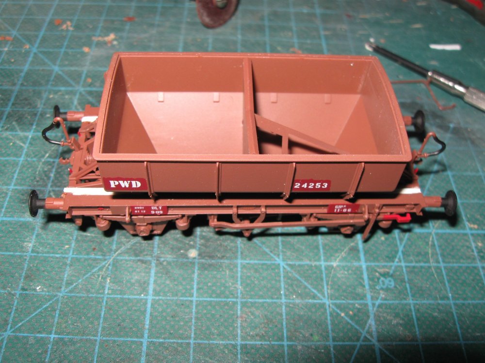

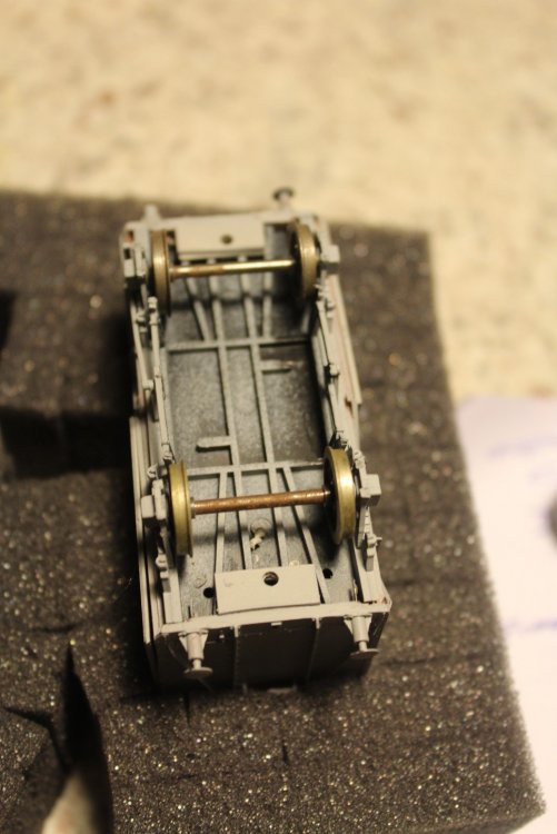

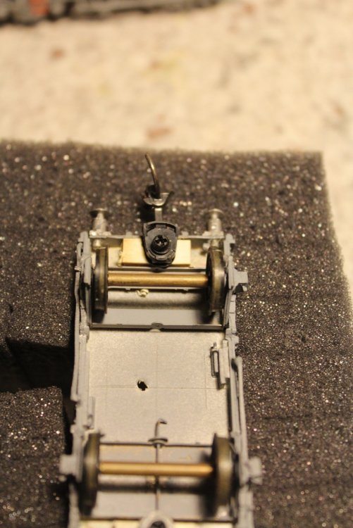

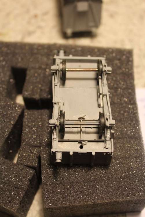

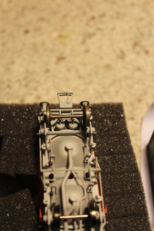

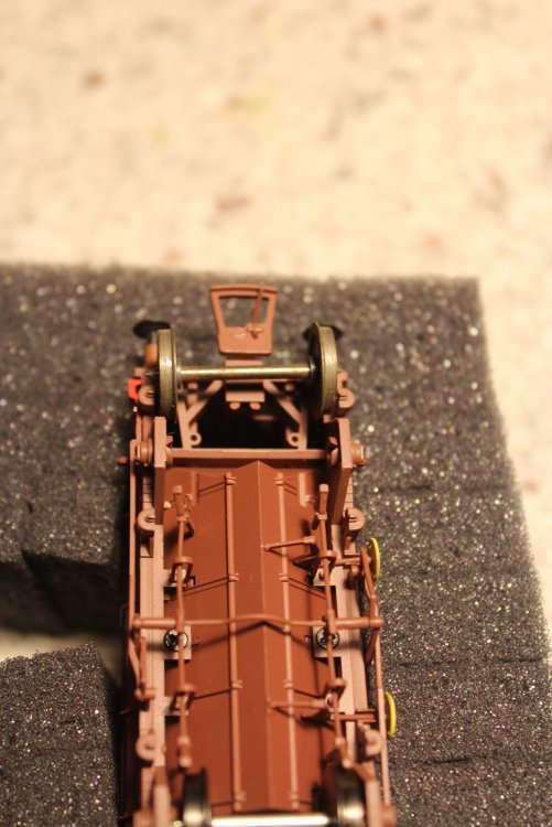

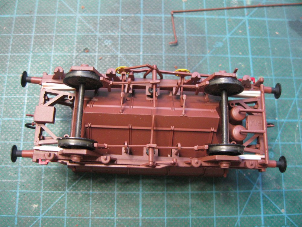

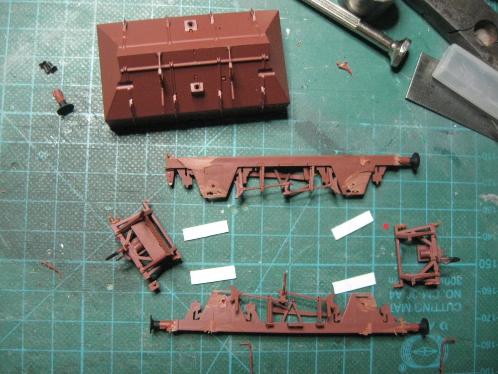

Brendan8056 Posted September 21, 2018 Posted September 21, 2018 I have converted a ballast wagon to 21mm. It was not easy. Removing the plastic collars gave an extra 4mm of width, perhaps this would be enough for the thinner wheels used by P4 modellers? I had to dismantle the model to put in plasticard spacers and enlarge the axle box interiors and fit brass bearings. The pictures attached may explain more. I used one of my last Gibson 21mm gauge wheelsets but Maygibs would work just as well. The existing IRM wheels cannot be used as one side is non insulated and integral with the axle. I also filed the back of the axle boxes to thin them to give a little extra space. It runs really well and I am converting a second wagon at present. I make the axles myself using 2mm steel rod and a mini drill and file the pin point ends. I have re-gauged 3 cement wagons and these did not need dismantling but still needed the axle boxes thinned and modified. I am looking forward to the Taras and the pull out wheelsets. 1 2 1 Quote
Noel Posted September 21, 2018 Posted September 21, 2018 Superbly executed 21mm conversion. Looked like quite a bit of work. Very neat. Quote

Brendan8056 Posted September 21, 2018 Posted September 21, 2018 Stephen, Hopefully the pictures tell a story. IRM have taken on board comments I made and I expect future wagons will be easier to convert to 21mm gauge. The most disappointing part was the IRM wheelsets. I do not like wheels and axles that can't be dismantled. I was unable to reuse them for 21mm gauge of the same wagons but I have kept them and may use them on kit built wagons instead. Murphy's coaches had the same problem and an even shorter axle length, but I used them to replace HO scale wagons on some Marklin wagons I purchased. I have attached a picture of a bubble converted to 21mm gauge. Note how thin I have filed the axle boxes to provide enough clearance. 1 Quote
Garfield Posted September 21, 2018 Posted September 21, 2018 Hi Brendan, Thanks for your feedback. Regarding the W-irons, with the ballast wagon we were constrained by the fact that we did not have direct control over the manufacturing process until a very late stage (documented elsewhere). When you contacted us in relation to the W-irons on the ballast, we listened and made adjustments to the bubble chassis. However, we were again constrained by the fact the same chassis design was required for the bubble, as well as minimum manufacturing tolerances. If we had made the W-irons any thinner, the structural integrity would have been compromised and they likely would have warped while the plastic cooled after exiting the mould. We used the same method to accommodate re-gauging of our Accurascale 24.5t hoppers and customers report being able to drop-in EM and P4 wheelsets with little or no adjustment required - the difference being we had complete control of the design process for this model from the outset. Regarding the wheelsets, the recognised tolerances for 21mm gauge are governed by P4 standards, which means that RTR RP25.100 OO gauge wheelsets are incompatible and require replacement in any case. As you say, the the Taras, etc. have wider axles and it should be possible to fit P4 wheels directly to them. Regards, Patrick 2 2 Quote

DiveController Posted September 21, 2018 Author Posted September 21, 2018 (edited) 6 hours ago, Brendan8056 said: I have converted a ballast wagon to 21mm. It was not easy. Removing the plastic collars gave an extra 4mm of width, perhaps this would be enough for the thinner wheels used by P4 modellers? I had to dismantle the model to put in plasticard spacers and enlarge the axle box interiors and fit brass bearings. The pictures attached may explain more. I used one of my last Gibson 21mm gauge wheelsets but Maygibs would work just as well. The existing IRM wheels cannot be used as one side is non insulated and integral with the axle. I also filed the back of the axle boxes to thin them to give a little extra space. It runs really well and I am converting a second wagon at present. I make the axles myself using 2mm steel rod and a mini drill and file the pin point ends. I have re-gauged 3 cement wagons and these did not need dismantling but still needed the axle boxes thinned and modified. I am looking forward to the Taras and the pull out wheelsets. That looks really well but a lot of work for a rake of 12 or more. Beautiful job, though. I'd plan on P4 wheel sets if I did this, I think to cut down on the time/labor. Thanks a lot for sharing this and the excellent pictures. That's been really helpful! @Brendan8056 The bubble conversion look easier thankfully. Again I have a rake of 12 orange bubbles to potentially convert and another 9 ivory livery to mix in with them for a later timeframe. The axle boxes certainly need a lot of thinning and P4 wheel sets may help make this easier and cut down on time even if it is a little costlier. Patrick, thanks for weighing in on the thread. That explanation was very helpful and important for people to understand why there are difficulties in created a truly 21mm compatible product. If I understand you correctly the proposed CIE ballasts, blue and bauxite Taras and other Project 42 wagons such as the fertilizer wagons should be compatible for drop in P4 wheel sets, correct? @Garfield I am planning on buying rakes of these Edited September 21, 2018 by DiveController Quote

Noel Posted September 21, 2018 Posted September 21, 2018 8 hours ago, Brendan8056 said: I have attached a picture of a bubble converted to 21mm gauge. Note how thin I have filed the axle boxes to provide enough clearance. Hi Brendan. Very neat again. Interesting you went for draft gearbox Kadee's instead of NEM Kadee's (e.g. No 18). I've been thinking of doing similar, but interested in the reasons you went for draft gearboxs? Noel Quote

Brendan8056 Posted September 21, 2018 Posted September 21, 2018 Noel, I used Kadee number 5's as I had a lot of them in stock, purchased very cheaply at a swap meet. They are very reliable. They are easy to get the right height and length from buffers. I keep my number 18s for my HO stock and Murphys locos and coaches. Incidentally what has been said by others about 21 mm gauge is true. We are not all P4 modellers. I too model to finescale/EM standards and I was very pleased at Ally Paley show the other year when an 141 class I had re-gauged using the existing Murphy wheels with longer axles ran perfectly on Valentia Harbour. You should only use P4 wheels if you have track to P4 standards, otherwise the wheels may not go through points (though should be alright on plain track.) The flange and tyre widths on such wheels are very fine. Brendan 1 Quote

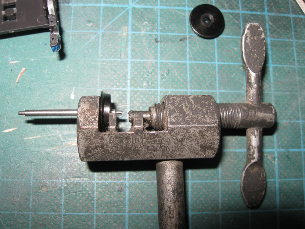

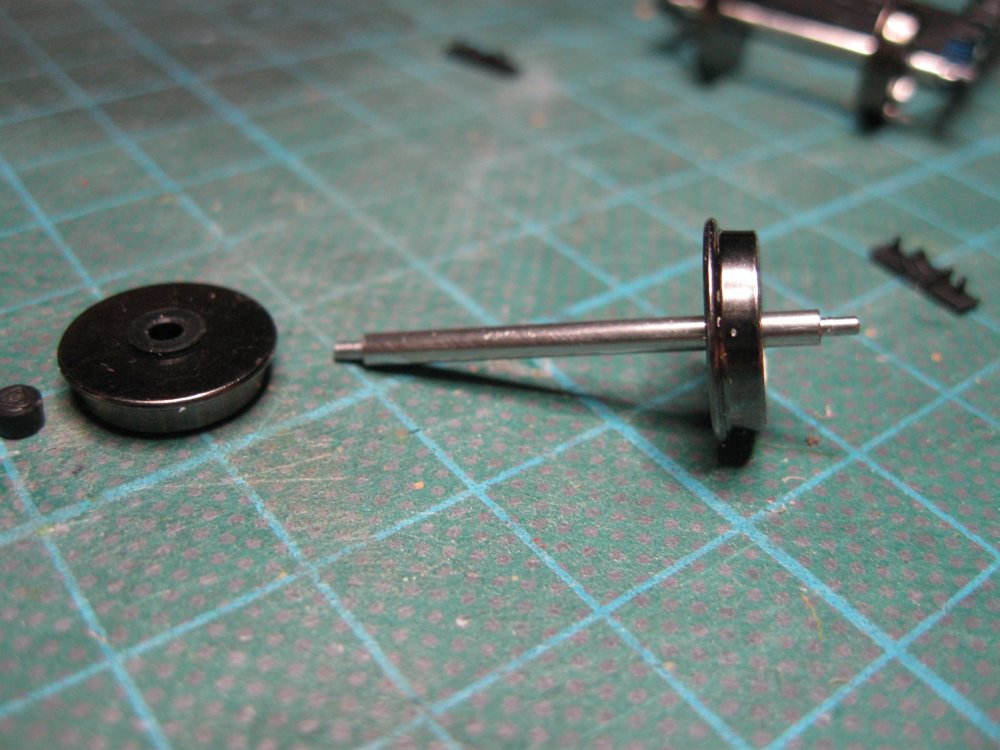

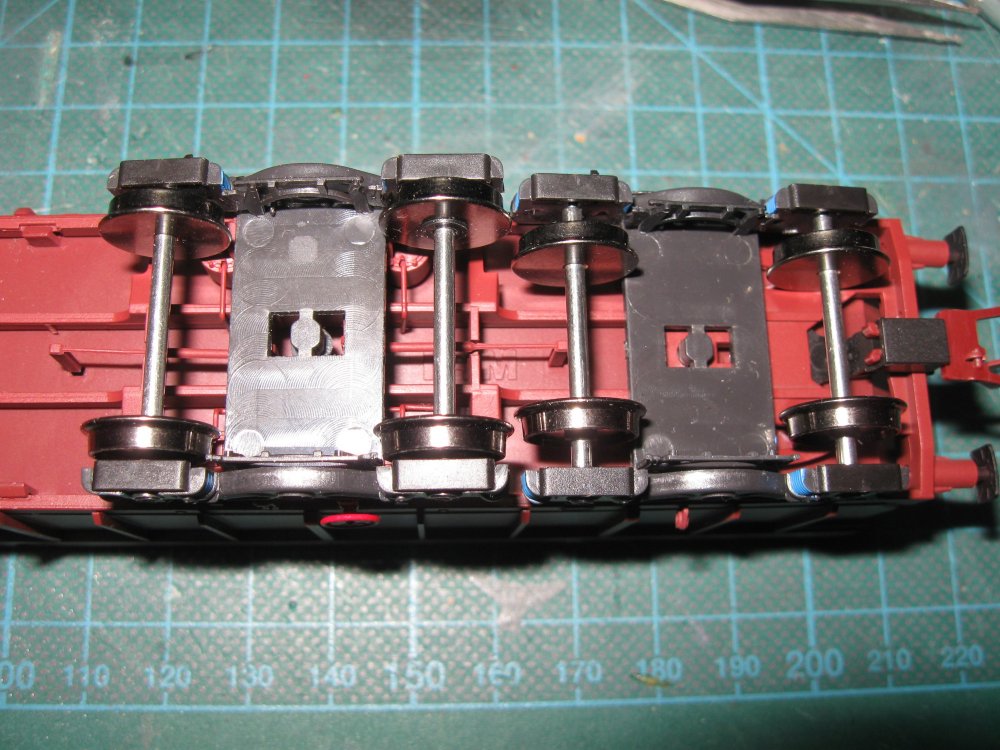

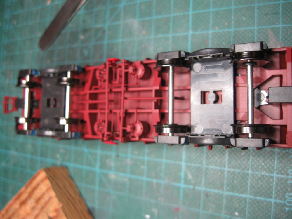

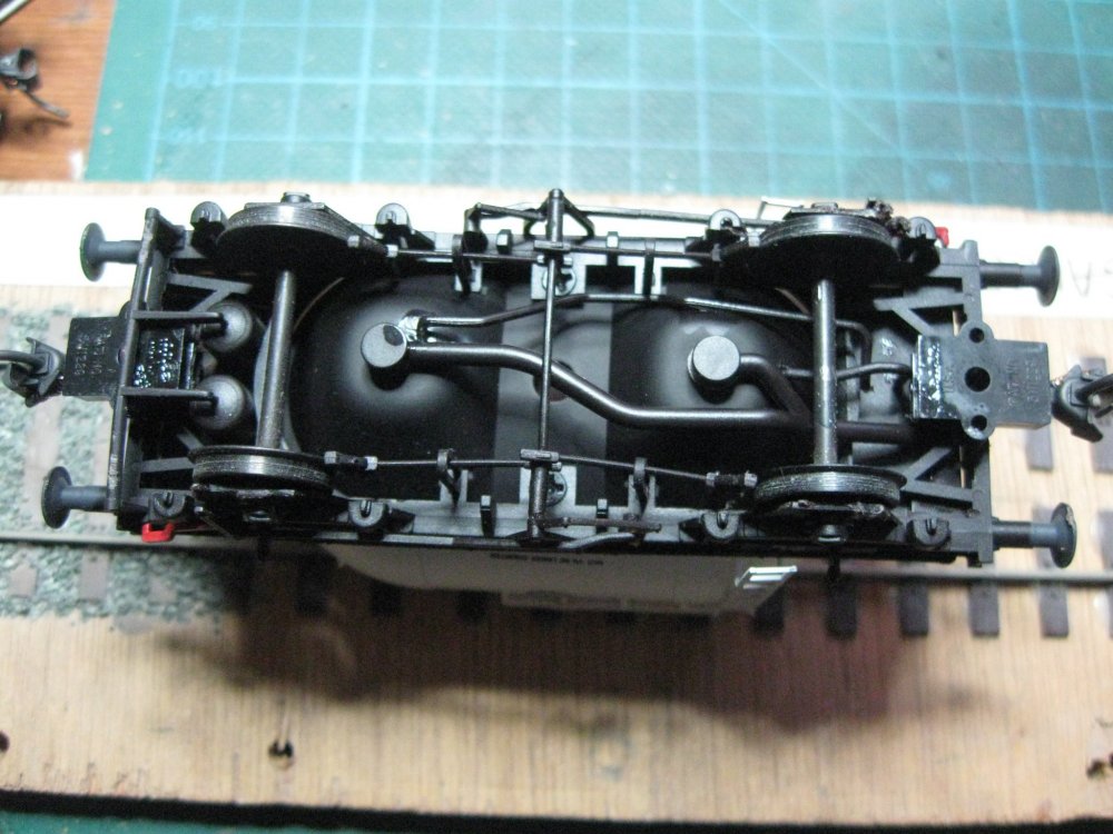

Brendan8056 Posted December 6, 2018 Posted December 6, 2018 I received my Taras today. They are everything I have wanted from an Irish RTR wagon, and more. Not only do the axlebox hubs turn but they are even fitted as per prototype, from the underside of the bogie frame. But even better, using my old bicycle chain puller, I was able to easily convert them to 21mm gauge, using the existing wheelsets. This saves modellers like me money and allows me to buy even more IRM items! The pictures show how easy it is. Ease off the flat plastic plate below the axle hub. Pop the wheel set out, remove the plastic axle hubs. Then remove the insulated wheel and put the axle in a chain puller (or a very strongly built wheel puller) and push it out against the non insulated wheel until a couple of millimetres short of the narrowed bit of the axle. Put the insulated wheel back in place, also a couple of mm short, checking the gauge back to backs. Refit the plastic hubs and pop the wheel set back in place. Adjust if required, otherwise replace the flat plastic plates and there you have it. I have put a converted bogie beside a narrow gauge one to show the difference. Well done IRM team. I hope the A class will be as easy to do, Brendan 7 1 1 Quote
DiveController Posted December 8, 2018 Author Posted December 8, 2018 Great shots, really shows the difference on the comparison. Quote
murphaph Posted January 20, 2022 Posted January 20, 2022 Ah chain puller! Why didn't I think of that. I've got one of those already so maybe I can save the money I was going to spend on a H0 wheel puller. Same design anyway as far as I can see. Sorry for reviving an old post but it had to be said lol. 1 1 Quote
