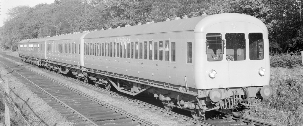

33lima Posted June 30, 2014 Posted June 30, 2014 (edited) any further updates on the finished wagons. QUOTE] The wagons are on the "back burner" as I'm working on some MPD's. As you can see above the is a lot of "Cutting & Shutting" to be done. Nearly every one of these MPD's were different. Power Cars will have Black Beetle Motors fitted, a first for me trying out these motors. Lovely job - great to see some MPDs will be joining your 80 Class sets soon! Can't wait to see these finished; must dig out my 80% complete suburban MPD after seeing these! Really like how you're tackling the sides for the later cars, to get the slim windows - great job! Minor points of detail - from studying pics, the MPD's big sliding brake compartment doors, when closed, always seemed to sit flush, in UTA green days - the recessed appearance seemed to start in the NIR maroon & grey era, for some reason. And I don't think the slam-door suburban cars ever carried corridor connections, until after they were rebuilt as open configuration with mostly new side panels - they just had three windows in front, like this one: Edited June 30, 2014 by 33lima
