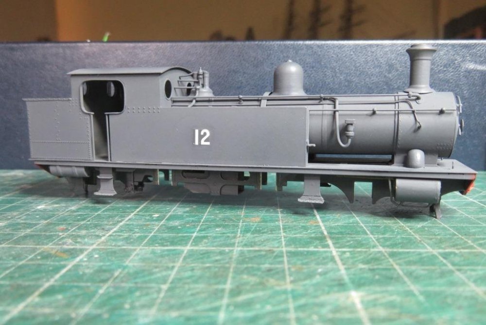

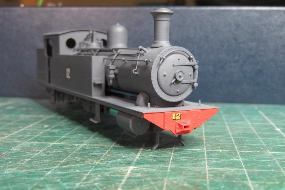

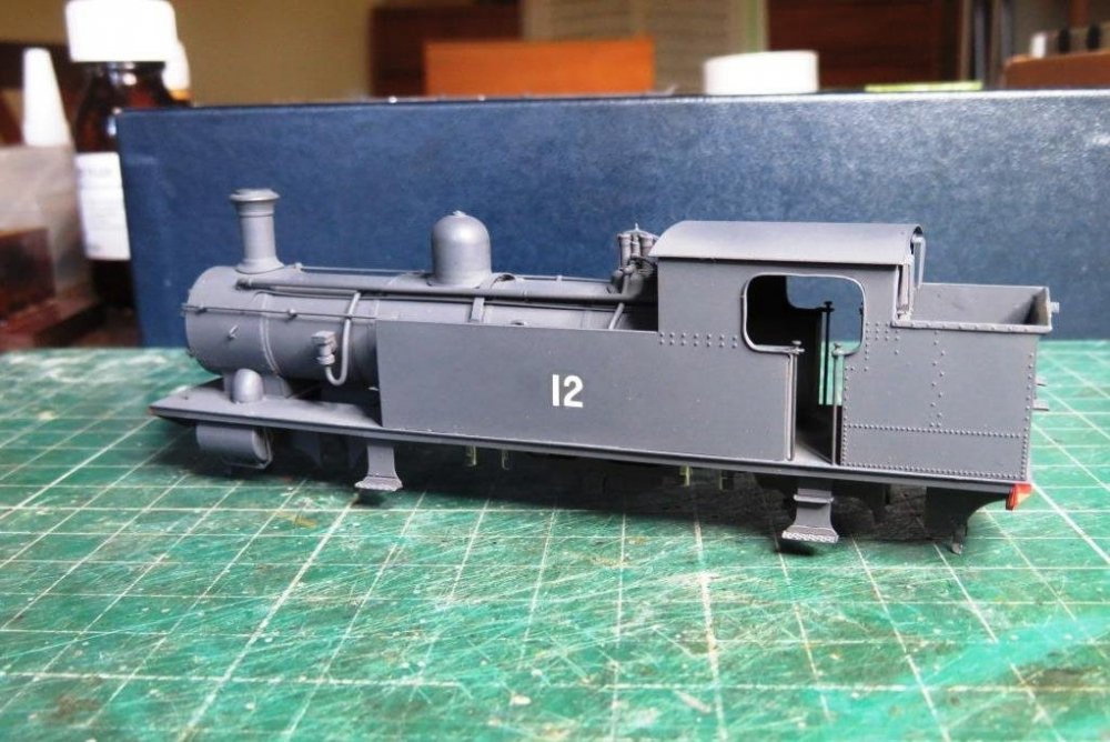

Hi Phil I know that colour is always a big discussion point when it comes to models, but I am sure I have seen a colour photo of one of these locos in a much darker shade of grey almost black, (inside of Irish Railways in Colour 1955 to 1967 by Tom Ferris) I do understand that this as build or before it goes into service, you learn something new everyday.
A great model thanks for sharing it with us.
Colin R
Link to comment
Colin R
They came out of Inchicore looking very much like the above, drab as it was! Perhaps very very imperceptibly darker, but the above is as close as anyone can tell to accurate - I'm looking at an 0 gauge model in front of me painted with actual GSR paint.
However - and there's always a however! - once in traffic they obviously got dirty very quickly. Cleaning was done with oily rags, and as people at Whitehead who worked on 186 in recent years will tell you, it dulls and darkens a bit in use.
If we look at colour pictures of Donegal or GNR blue locomotives in their final days, you could be forgiven for thinking that the domes, and sometimes boilers, or EVEN the cab front and back, were actually black, such was the level of filth, soot and gunge on them. They weren't - they were without a solitary exception ALWAYS cherry red (CDR) and blue (GNR). Have a look at the disgraceful state that green-painted CIE locos got into in that period - especially (and surprisingly) the Woolwiches and 400 class. I have seen more than a few pictures of both of these classes where only a faint trace of lining, or a slight green tint on the tender side, gives any indication of whether they were painted grey, black or lined green.
GSWR / GSR / CIE locos painted grey suffered the same fate, especially from 1955 on, when it was clear their days were numbered. Narrow gauge ones, in particular, were dreadfully neglected cosmetically.
Many steam engines of all railways appear not to have red buffer beams due to filth - but they all did.
Senior recalled a jaunt on the C & L, not sure when, probably late 1940s, just into CIE days. He was doing a PW survey and travelled on the footplate of the morning train to Ballinamore. He said that while the carriage and the loco LOOKED like they belonged in a scrapyard, indeed, as the longest residents there, the loco was in excellent mechanical condition, and the C & L track was very well kept indeed, right until closure.
Anyway; point being - any C & L model at all can be sent to the Great Weathering Monster to do his worst!

This model of 12L is on course to be the best I've seen of one of the CB&PR locos, which in my opinion were one of the most elegant locos to run on any of the narrow gauge lines here.
Top work! :)
Couldn't agree more  -  a truly inspirational job done on a much neglected prototype! Always wondered how one of those would perform on the modern track of the IOMR. The Passage tanks were capable of 50 miles an hour - and that was on the twisty Passage line. I daresay they could do more in the right location.

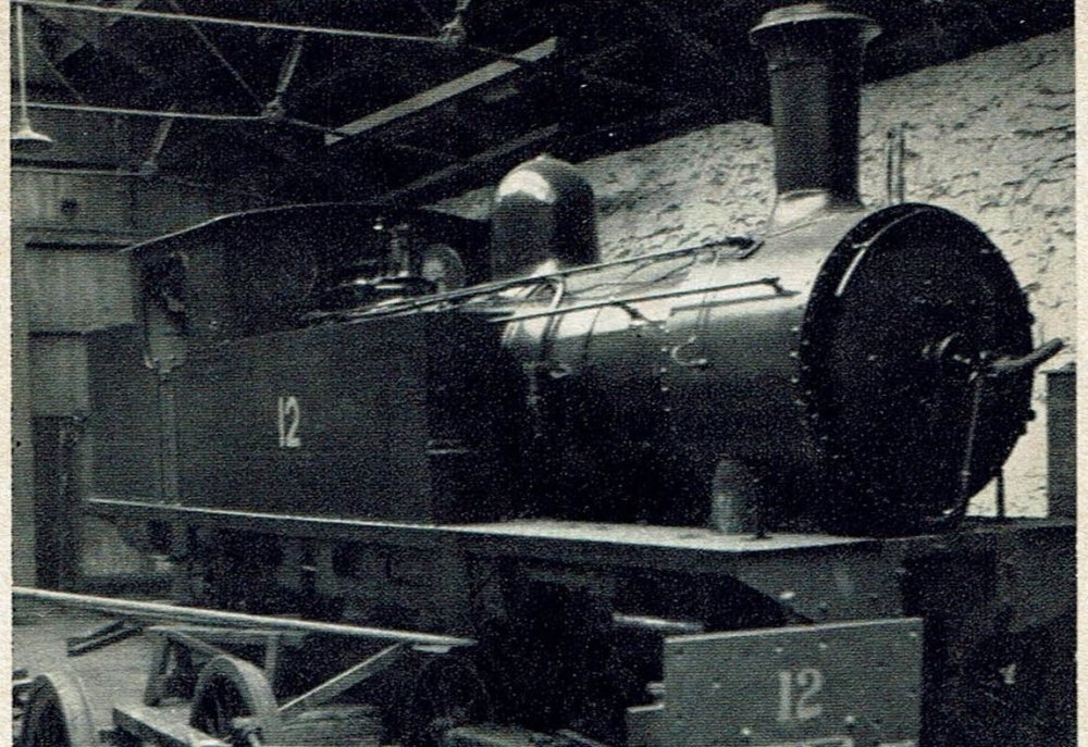

An un-credited photo of 12L under repair in Ballinamore Works in 1956 from the Pan Paperback edition of P J Flannigans book.
It looks like the loco was recently repainted and is being re-assembled following repair, the colour is anyone guess.
Ballinamore had lost most of its machine shop facilities when overhauls were concentrated at Inchacore in the 1930s, 12L last visited Inchacore in 1947 so it looks like Ballinamore retained capability to carry out all but major overhauls.
There are some excellent colour photos of C&L locos in their final years of operation in Midland Publishing "Irish Railways in Colour" series, the most noticeable thing is that the locos were kept very clean despite burnt chimneys and smokebox doors and badly worn paintwork. Goods stock appeared to be well maintained and in good external condition in order to handle the relatively healthy goods traffic, passenger stock was a different story with one or two reasonable coaches on the Dromad-Belturbet main line and a a couple of decrepit former C&L coaches retained for the daily Arigna mixed train.
The model looks fantastic, I am tempted to build a Passage Tank but its likely to stick on the curves on my layout just like 13L did with a coal special on the Tramway in 1934, nothing like prototypical accuracy even on a fictious extension of the Tramway to Boyle or Sligo

No criticism intended, as I was taken aback at a loco looking so clean and not what I was expecting, I bow to the greater knowledge of how these locos looked back then and just how wrong even some of the current modellers still get it wrong.
For those who have the Irish Narrow Gauge book by the late David Lloyd pub by Peco even he painted his locos a Dark Grey, it is great that there are people out there who can still tell us where we have been going wrong all these years.
Would the T&D locos as well as the C&L locos that went to inchicore for overhaul would they have come back having been repainted in this shade as well?
Link to comment
Well if the colour is wrong the person to blame is none other than JHB! I recall him posting that the 00 Works J15 was spot in. It so happened that my great grandson and I were painting one of his model tanks using Tamiya German tank grey when I noticed that this matched the J15 almost perfectly. That is the colour used on no. 12. Obviously there is some serious weathering to come.
Great - thanks. I’d looked at Panzer paint and wondered - my next GSR loco will be ‘Guderian grau’......
Indeed - it is a good match.
The colour used by Roderick on the 00 Works models wasn’t just a “close” thing - it was exactly matched with the real thing, an actual sample of the GSR paint.
Phil’s model looks to me to be the same.
Most confusion over the shade stems from filth in day-to-day use, and occasionally the accuracy of the (manually set!) exposures in old photos.
The model looks superb! Weathering, of course, is obligatory on any steam loco, and a grey livery like that would be very susceptible to it
I recall Senior commented several times on how light an ex-works engine looked compared to a well-worn one.
Now thats something I like 10ml XF-63 German Grey Acrylic Tamiya 81763.

Ah,Phil, that's just lovely (even though it's narrow gauge!). As Garfield said, one of the neatest looking little locos built for the Irish Narrow Gauge.
Of course, it was from a line (unhappily short-lived) which looked like a "proper" railway, as it was almost unique in having double tracks.

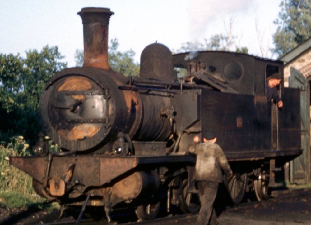

Anyway, this is what you have to turn it into, not No.12, but 10L -
Photo at Dromod by the late Lance King, IRRS Copyright.
Good luck with it, a super piece of work.

Yes - look at the buffer beam, which was RED!
If anything, some CIE locos got into even WORSE state than BR - and that is saying something.....

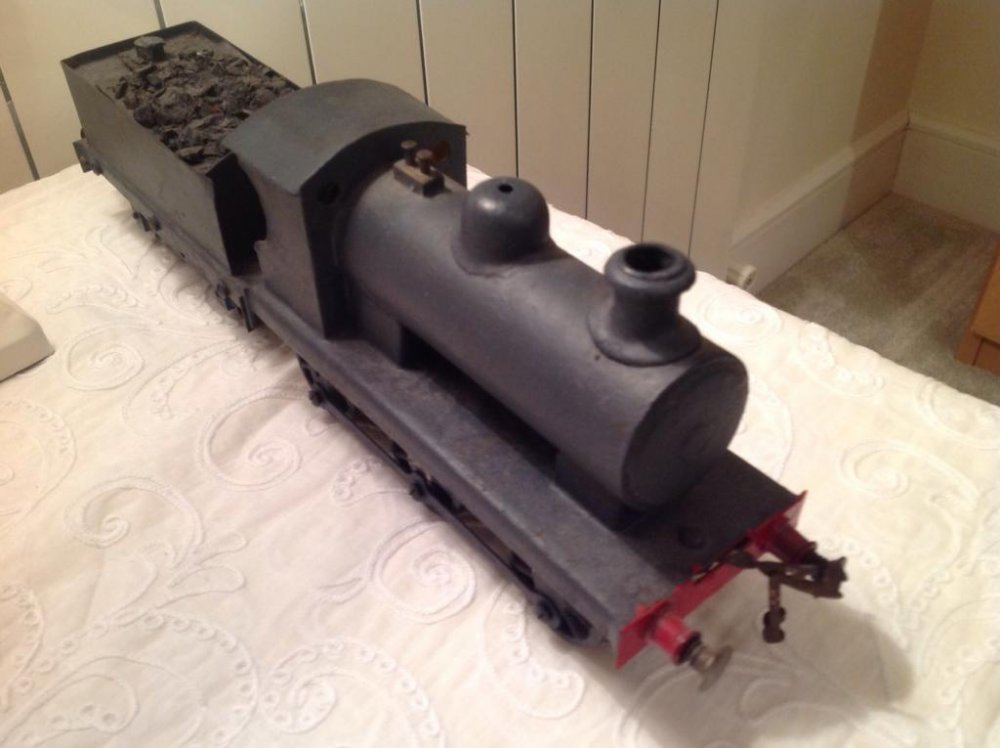

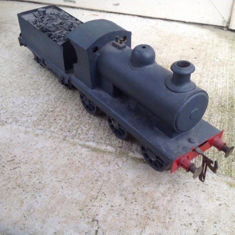

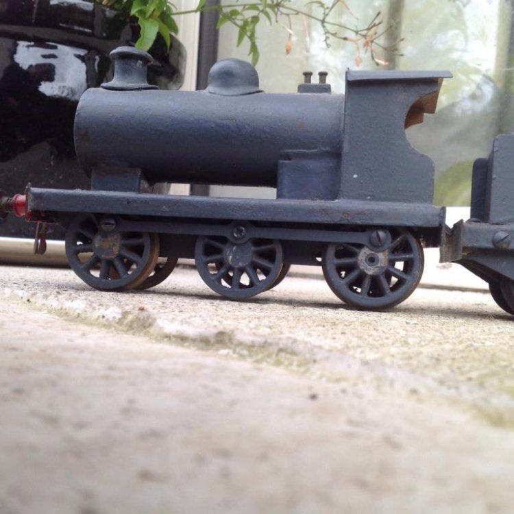

I don't know if anyone remembers that at one time I posted pics of a model my grandfather made using actual Inchicore paint. To show how light can show it up differently, I took a pic of it in sunny daylight, shaded daylight, and (in the house after dark) artificial light. All looked different - but there's only one "real thing", whatever light, photographic techniques or weathering does to it.
Many modellers prefer their models to be pristine, and many others prefer them prototypically filthy - though it will be a brave person who weathers a new Murphy 121, I would think! Tis up to the individual.
