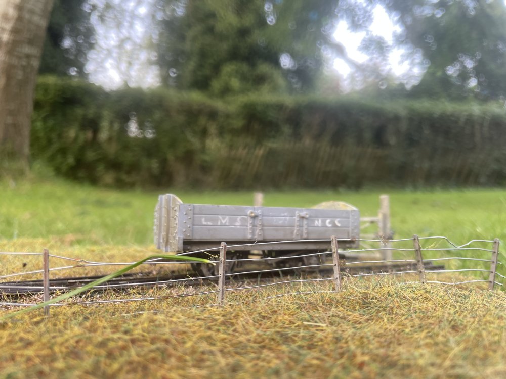

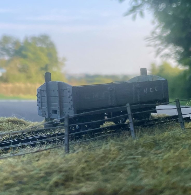

David Holman Posted January 2, 2024 Posted January 2, 2024 Splendid and as you say, fiendishly difficult. A coach is a box (albeit with many add ons), a steam loco is a box with a boiler (ok, sweeping generalisations for both), but a railbus is another level in terms of all the complex curves and glazing. Road vehicles likewise, which is why we don't see many scratchbuilds of such things. Seriously multimedia and great to see a whole host of techniques brought together. Very neat on the trailer too and will have to look into the idea of a capacitor for my 2b. Shame they never ran the two back to back, Colonel Stephens style - it would solve the problem of turntables! 1 Quote
Galteemore Posted January 2, 2024 Author Posted January 2, 2024 (edited) 3 hours ago, David Holman said: Splendid and as you say, fiendishly difficult. A coach is a box (albeit with many add ons), a steam loco is a box with a boiler (ok, sweeping generalisations for both), but a railbus is another level in terms of all the complex curves and glazing. Road vehicles likewise, which is why we don't see many scratchbuilds of such things. Seriously multimedia and great to see a whole host of techniques brought together. Very neat on the trailer too and will have to look into the idea of a capacitor for my 2b. Shame they never ran the two back to back, Colonel Stephens style - it would solve the problem of turntables! Thanks David. As you’ll see it fits quite well ….think it’s a 35/470 one that’s recommended. Key issue is that it’s not polarised, given that current flow will regularly reverse. Edited January 2, 2024 by Galteemore 2 Quote
Gabhal Luimnigh Posted January 2, 2024 Posted January 2, 2024 That's a lovely model, I think you've captured the look brilliantly. 1 Quote
Northroader Posted January 2, 2024 Posted January 2, 2024 You’re right, it’s all the curves in the bodywork. Buried in all the boxes somewhere there’s a few pieces for the NCC one. Will I ever do it? will I ever find it? Yours is an inspirational job. 1 Quote

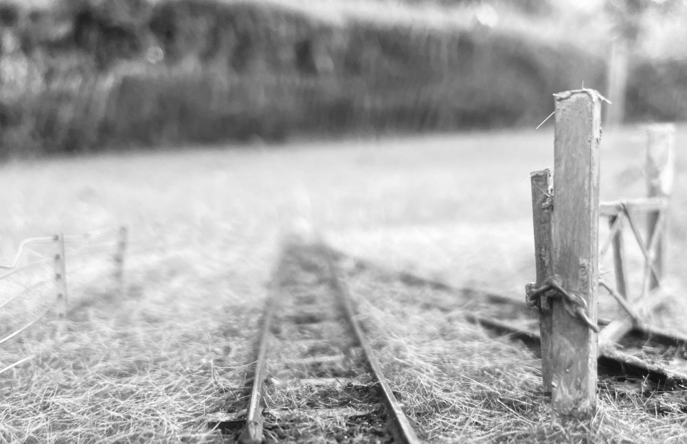

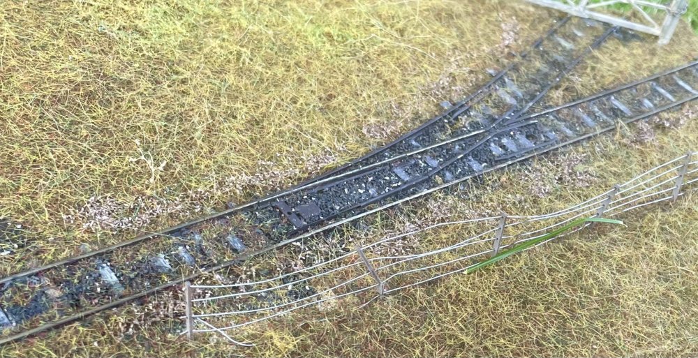

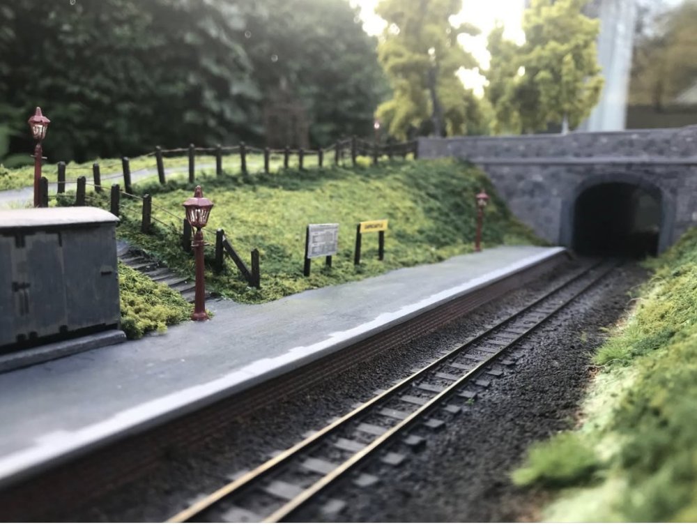

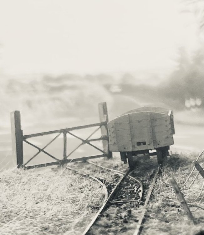

Galteemore Posted September 21, 2024 Author Posted September 21, 2024 (edited) Back in east Antrim more times than usual this year, sadly due to my father in law’s final illness and death. As a lad, he and his brother used the 3’ gauge yard at Larne as a playground / shunting trucks by hand! Spending a fair amount of time around Larne this year rekindled my childhood interest in the east Antrim 3’. Reading some of @Patrick Davey’s musings on scale inspired me to make a little 5.5mm scale diorama on a wargaming base. It allows very cheap and easy sources of material - 16.5mm track and components being easily found…thus standard Hornby train set track duly butchered here to produce 3’ panels. So here’s Kilwaughter siding during lifting c1954, based on a photo kindly supplied by @airfixfan complete with an IoM wagon for now - NCC stuff is in progress! This will be a sideshow to my main projects but may eventually come to something. I have at least 1 loco chassis in stock…..spot the large blade of grass when I tried taking pics in back garden!! Some of the other pics were taken within 20 yards of the GW main line near Swindon- hopefully some day I will find a suitable spot in the Vale of the White Horse to take backdrop pics! Edited September 21, 2024 by Galteemore 8 3 Quote
David Holman Posted September 22, 2024 Posted September 22, 2024 Lovely diorama - only goes to show there is always room for a model railway. Thought you were going garden railway at first, but using the great outdoors for the photos works a treat. 1 1 Quote
Patrick Davey Posted September 22, 2024 Posted September 22, 2024 Nice David! The earthworks for that siding are still clearly visible on Google Earth. Am a big fan of outdoor photography for model railways, and I am reminded of this shot I took of Capecastle: 3 2 Quote
airfixfan Posted September 22, 2024 Posted September 22, 2024 (edited) Great stuff digging out more photos of the Ballymena and Larne for another project. Showed some of these photos to galteemore senior recently Edited September 22, 2024 by airfixfan 2 Quote

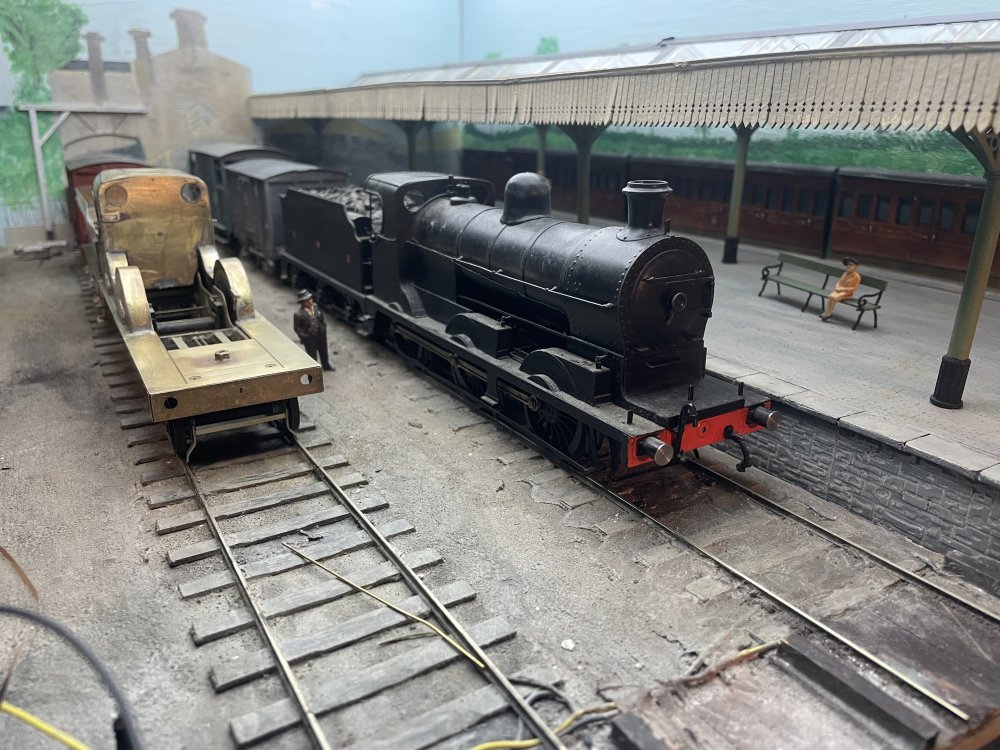

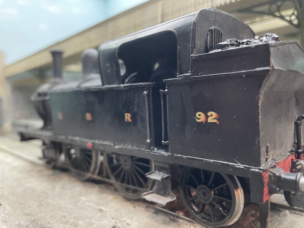

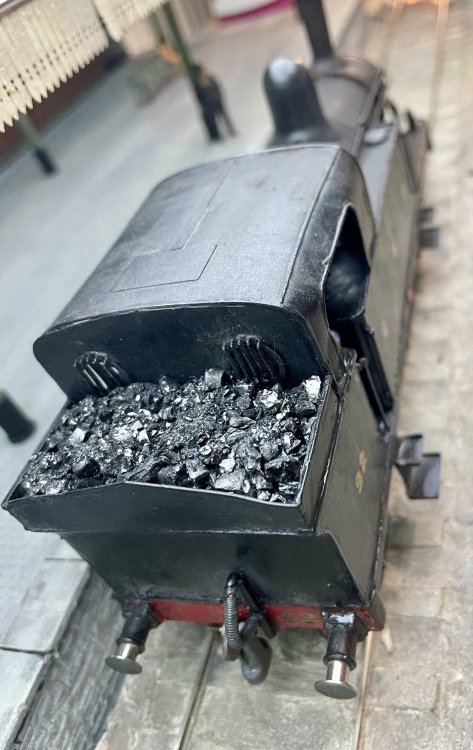

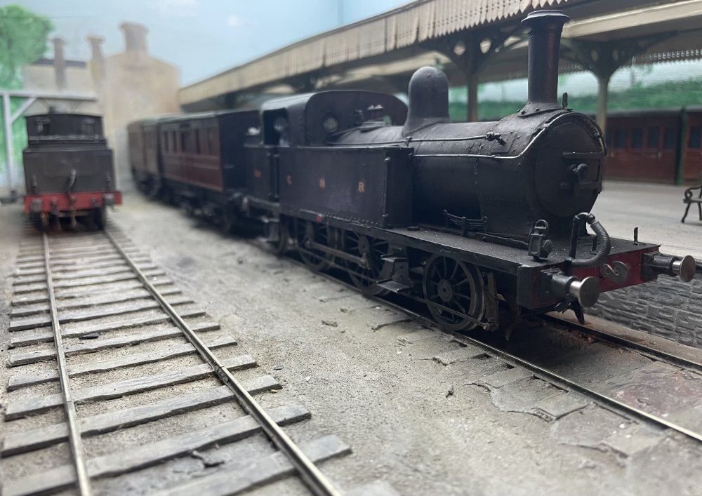

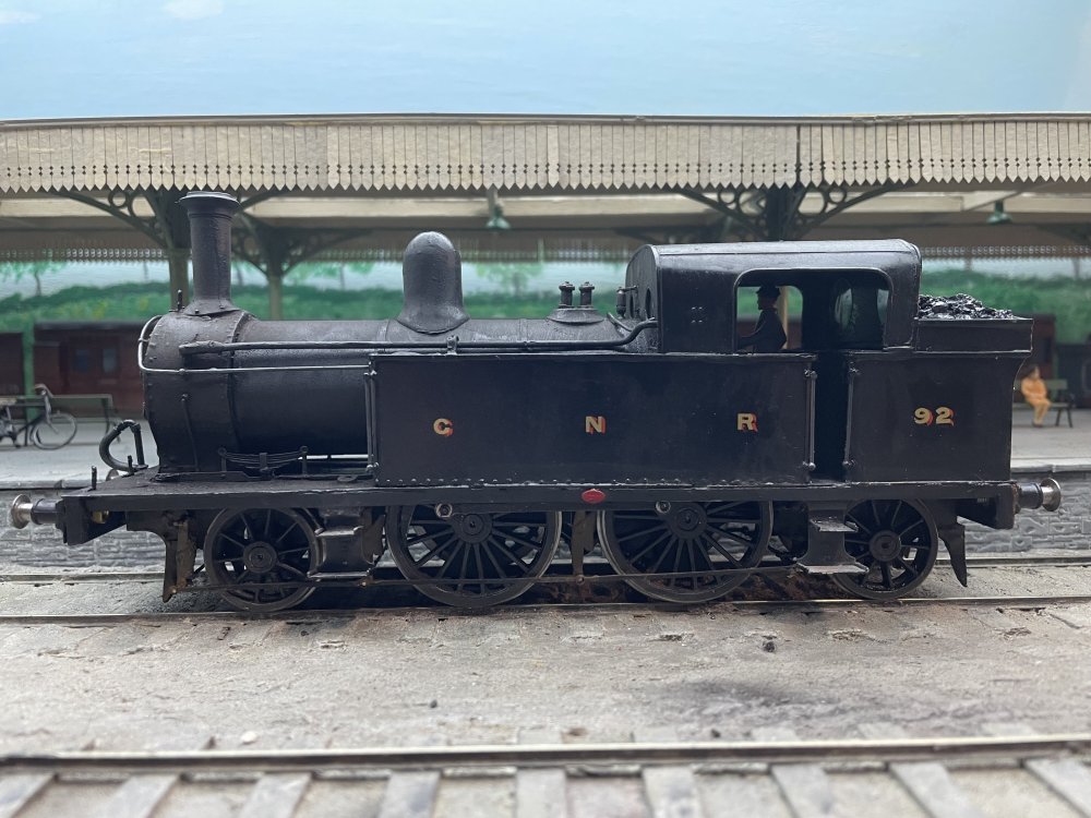

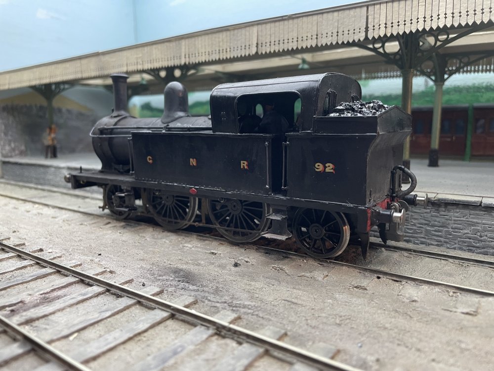

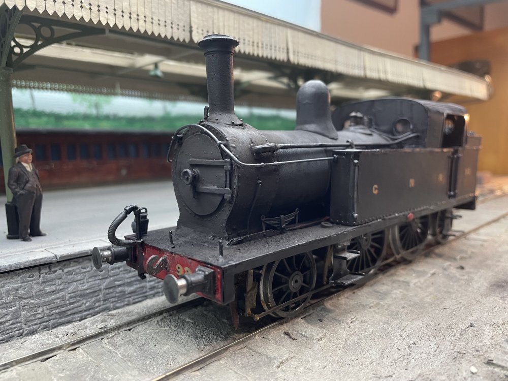

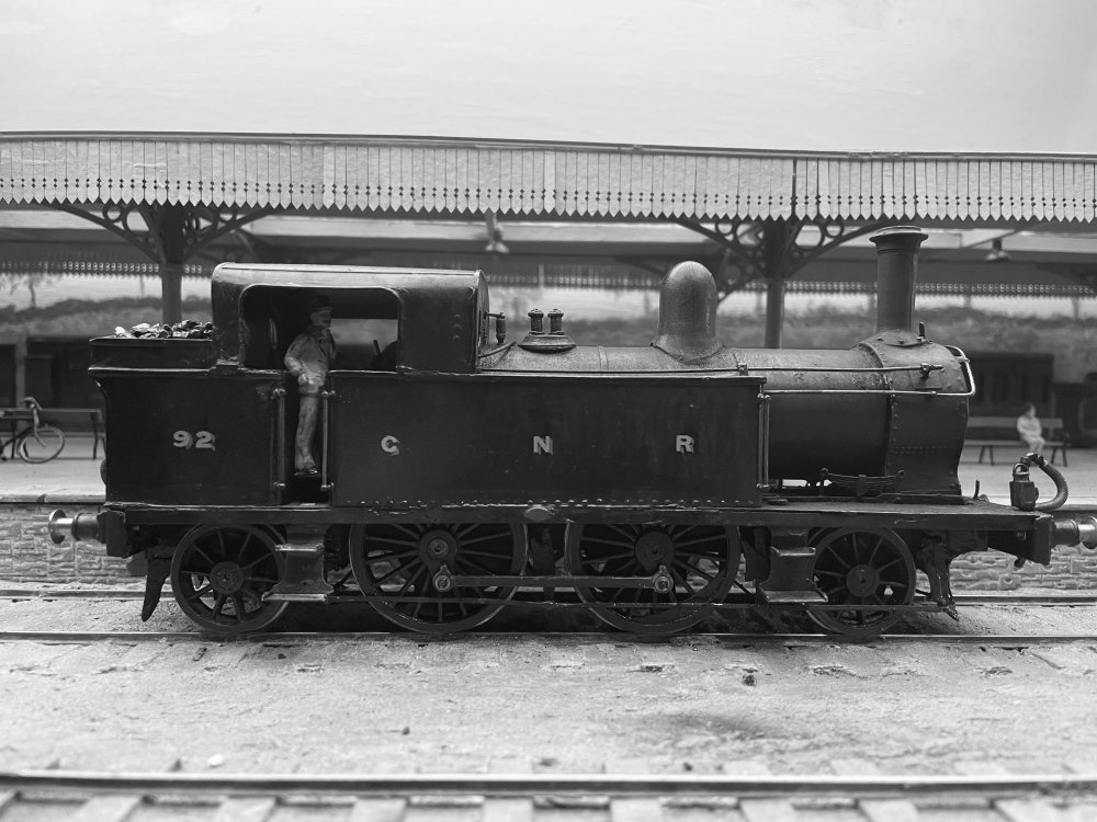

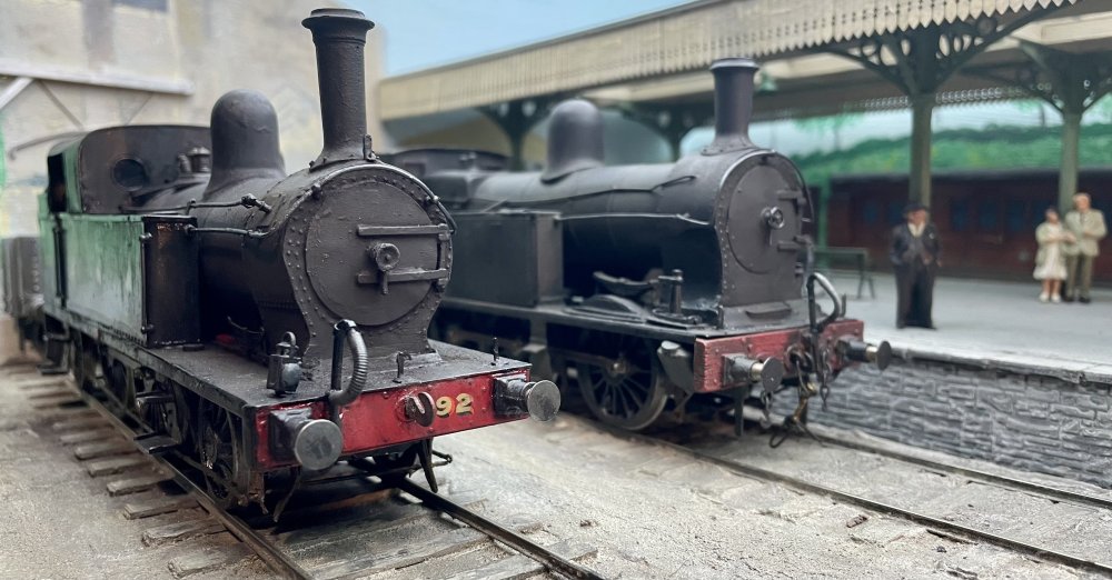

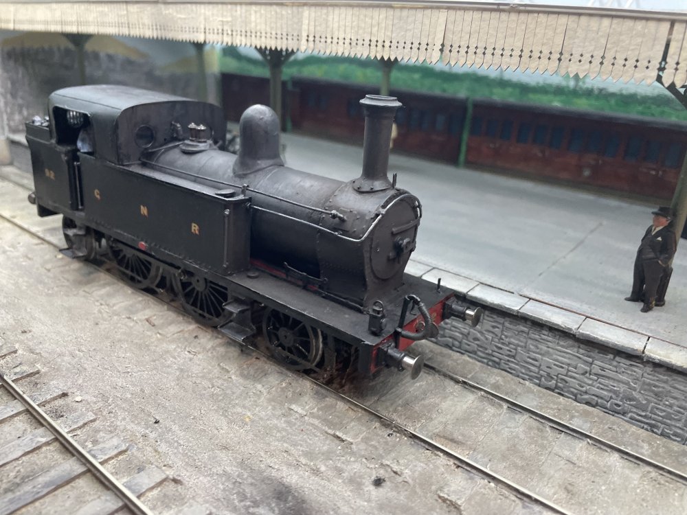

Galteemore Posted October 26, 2024 Author Posted October 26, 2024 (edited) Earlier this year I decided to try building another Alphagraphix loco kit, for myself, as I have sold all the ones I’ve built. Roger doesn’t do any Sligo locos but GN locos did venture into the SLNC yard at Enniskillen for shunting, so I can justify a JT - I think! @Richard EH mentioned the Alphagraphix JT recently as a 4mm proposition, so this may of interest to those wondering about Roger’s kits. As @leslie10646knows, I was brought up to love the elderly black locos of the GN out in the wilds of Fermanagh and Cavan even more than the main line bluebirds. So here’s no 92, with a few build photos. I have very few modelling rules but one is that black engines must be weathered, or the details won’t show. This weathering is based on extensive photo study and has been an interesting exercise in its own right. The appearance of dusty smears on the tanks is very evident on 1950s colour pics of GN tanks. If the vid works, you’ll see that she does work….kit is more or less as supplied; new buffers and chimney are main changes, plus adding rivets and such fripperies as sandbox lids. Much fettling was required to build it to scale 5’3” and extensive grinding of the interior parts with a Dremel was the only way to allow the rods to rotate. Even then the bolts on the coupling rods had to be trimmed right down. The wheels are extensively padded with washers to ensure that everything stays lined up under the footplate!! IMG_2827.mov Edited October 26, 2024 by Galteemore 10 Quote
David Holman Posted October 27, 2024 Posted October 27, 2024 That looks great - subtle weathering and very much at home on Enniskillen. 1 1 1 Quote
Tullygrainey Posted October 27, 2024 Posted October 27, 2024 Fine job David. You’re right about the weathering and No92 looks convincingly work-worn. 1 1 Quote
Northroader Posted October 27, 2024 Posted October 27, 2024 Interesting that you changed the chimney, the Alphagraphix one looks a bit slender? Lovely little engine now it’s done. 1 Quote

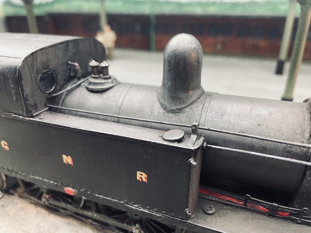

Galteemore Posted October 27, 2024 Author Posted October 27, 2024 (edited) 8 minutes ago, Northroader said: Interesting that you changed the chimney, the Alphagraphix one looks a bit slender? Lovely little engine now it’s done. Thanks Bob - that’s right. I had actually finished it off with Roger’s chimney - and showed a picture to my dad, who can actually remember seeing a JT working - no 91. First thing he said was - the chimney’s wrong! So a quick chat with Laurie Griffin and a J88 alternative appeared. Thankfully I hadn’t mixed the epoxy very well so it was quite easy to remove version 1. The whistle is also a buy-in, as the provided casting was a little bulky in the wrong places. Edited October 27, 2024 by Galteemore 3 1 Quote

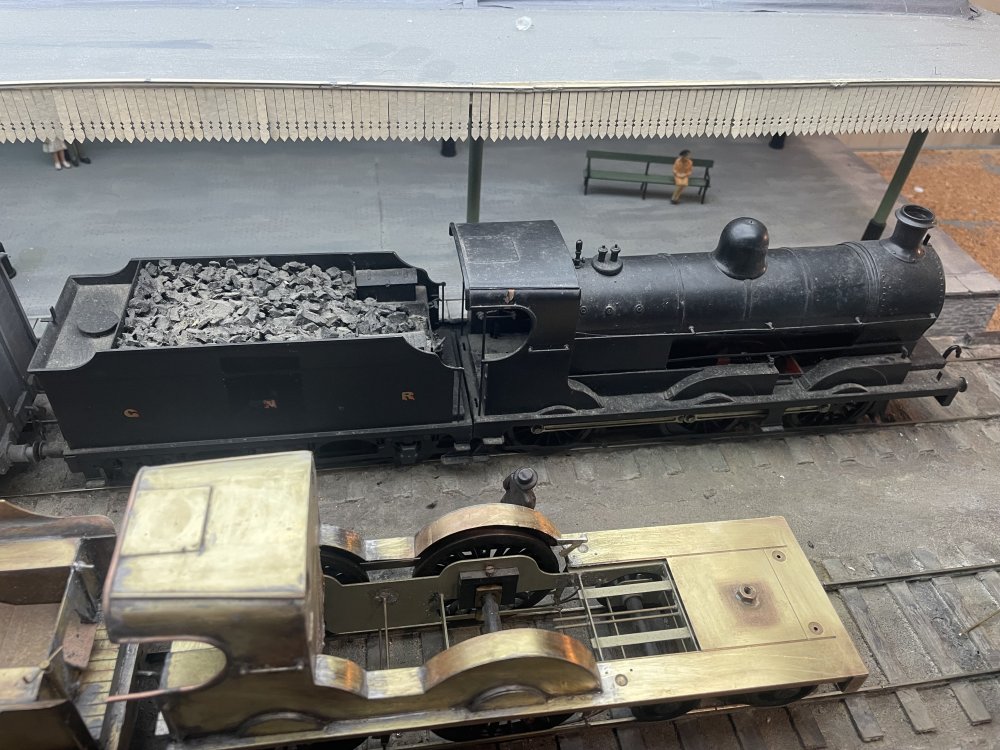

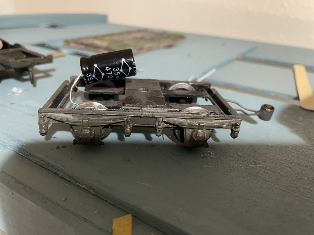

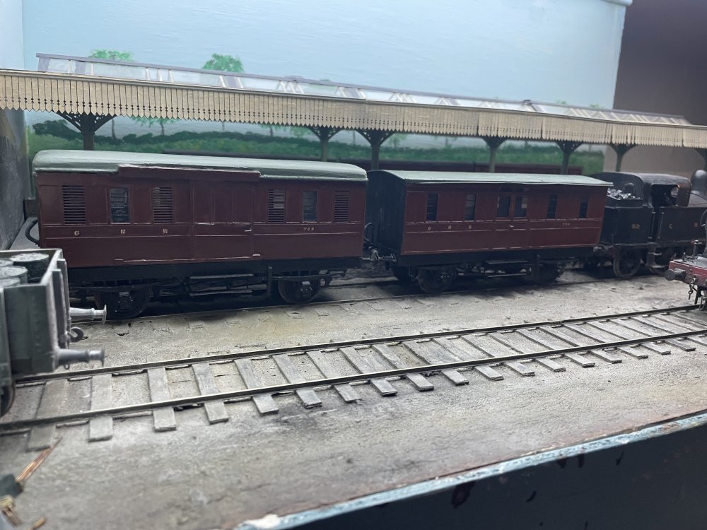

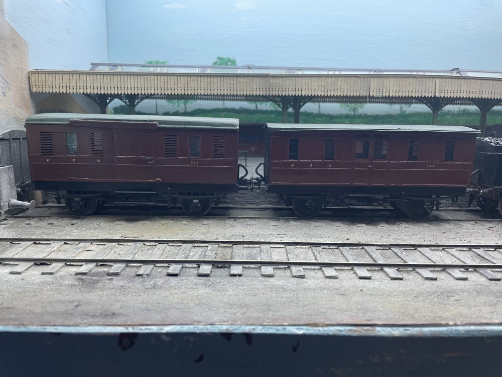

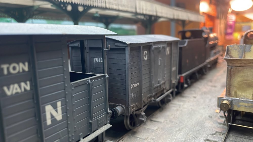

Galteemore Posted December 23, 2024 Author Posted December 23, 2024 (edited) Latest project - two GNR parcels vans, variants of which traversed SLNC metals regularly. Alphagraphix kits. Not quite finished yet / need to sort last few transfers. Will lightly weather them when that’s done. Nice little kits. Rocking axle allows some compensation. Edited December 23, 2024 by Galteemore 8 1 Quote

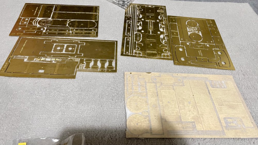

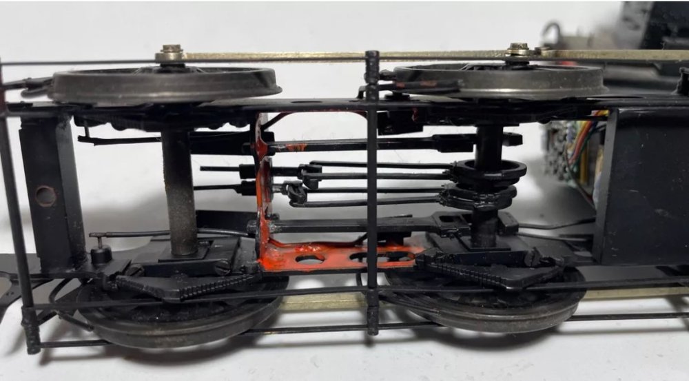

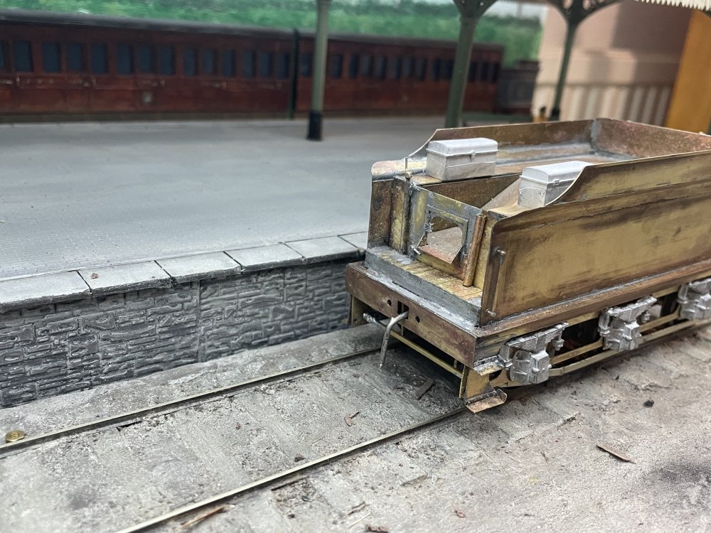

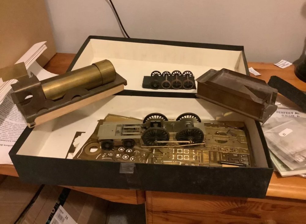

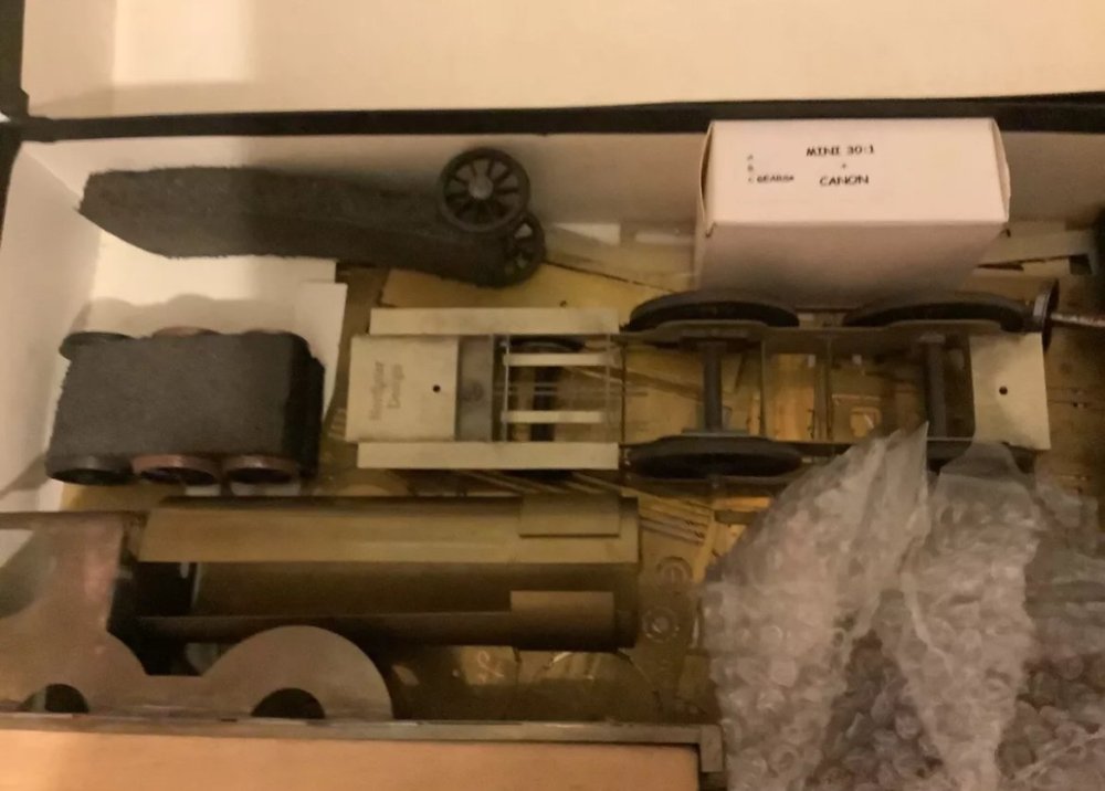

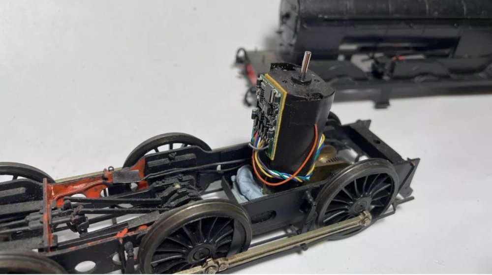

Galteemore Posted January 9 Author Posted January 9 (edited) There are two main hazards with buying a half built kit off the web. One is that it may be incomplete. The other is that work done so far will be badly done. This PP arrived as a box of half-used etches and a few made up body parts. The chassis did look good in the eBay pics, and so it proved in real life. The body was mounted on a wooden block, which is a combat indicator that the builder knew their business. Having gone through the boxes, most of it seemed to be there, bar the tender chassis. It took longer than I would have liked to make this from scratch , but it’s more or less done now. Several attempts were required to get it right and I will fine tune it before final assembly. It will be sprung - albeit crudely - and the weight will be transferred to the loco as per Mike Sharman’s recommendations for 4-4-0s. The tender body carcass had been very competently assembled and just needed detail work such as lamp irons and water filler. The arrival of tender toolboxes from Laurie Griffin today mean that the tender is basically done. The loco needs a little more work….some of the cab parts were distorted by the time in storage - and horribly tarnished - but 74 is coming together. I had to desolder some of the existing work as the parts had not been assembled as per the kit instructions. Adrian’s very clear on the order in which things should be done and it’s not wise to ignore that. As you can see, the cab area is now more or less on track after some careful cleaning, metal bending/squeezing, and not a little soldering. I am a little alarmed to find that this is my fourth GN model in a row and I haven’t touched anything SLNC for a year…..I blame @leslie10646…. As an historian by training , it’s been fascinating to discover from the paperwork accompanying it that this was one of the first kits to be bought - the builder was on Adrian’s ‘expression of interest’ list, and this kit dates from 2001/2. Edited January 9 by Galteemore 12 1 Quote
leslie10646 Posted January 9 Posted January 9 Don't blame me, @Galteemore, when the PP is finished, you'll be happy that you did it! My PP, built by Tony Ragg and came to me via Ken Gillen, is delightful. 3 Quote
David Holman Posted January 10 Posted January 10 Great to see this progressing. Certainly looks like somebody knew what they were doing re initial construction, so looking forward to seeing it completed. NPQ booked again for Aldershot in October. A parcels special via the Burma Road? 1 1 Quote
Galteemore Posted January 10 Author Posted January 10 2 hours ago, David Holman said: Great to see this progressing. Certainly looks like somebody knew what they were doing re initial construction, so looking forward to seeing it completed. NPQ booked again for Aldershot in October. A parcels special via the Burma Road? Thanks David. A PP on the Burma Road - what’s not to like? They were called ‘the wee bouncers’ by GN crews because of their springing - can just imagine a PP bouncing along near Tubbercurry….. 2 1 2 Quote

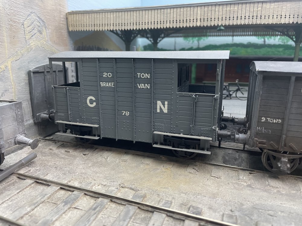

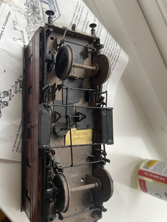

Galteemore Posted January 14 Author Posted January 14 Well @leslie10646you were correct of course. That GN brake van does look good at Enniskillen…..and look what brought it in….same seller was offering a 36.75mm SG. It needs some TLC but it’s built to an incredible standard with springs and plungers and goodness knows what. It may need a repaint but will try a clean first….. 15 2 Quote

David Holman Posted January 15 Posted January 15 Looks like quite a find! Jealous? Absolutely! 1 Quote

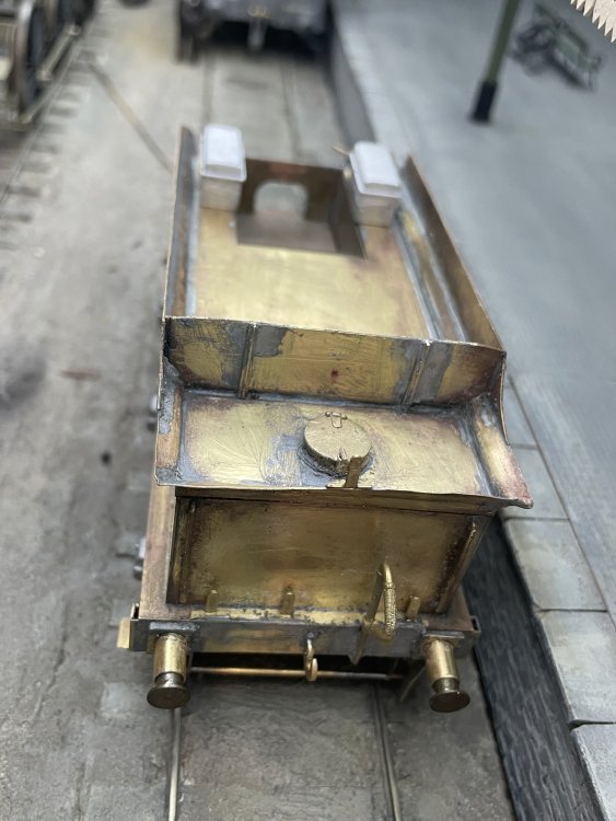

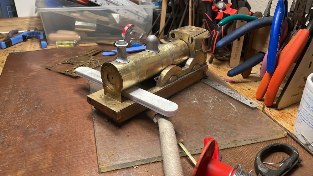

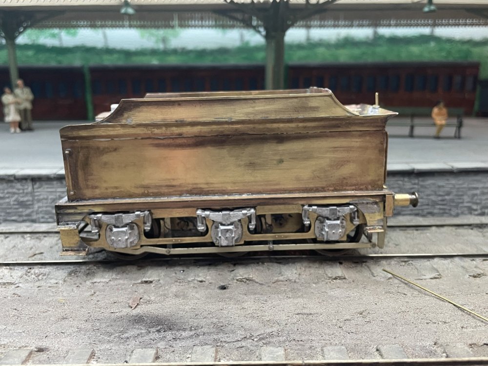

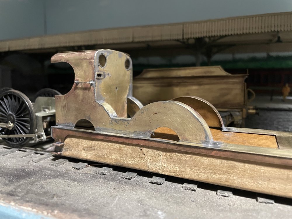

Galteemore Posted January 18 Author Posted January 18 A positive post before the inevitable frustration of adjustments kick in. Boiler rolled and it fits - just…… 9 Quote
Mol_PMB Posted January 18 Posted January 18 2 minutes ago, Galteemore said: A positive post before the inevitable frustration of adjustments kick in. Boiler rolled and it fits - just…… Very nice! It already captures the character of the prototype. 1 1 Quote
David Holman Posted January 19 Posted January 19 Yep, looking good. And if it just fits, then it is probably just right! 1 1 Quote

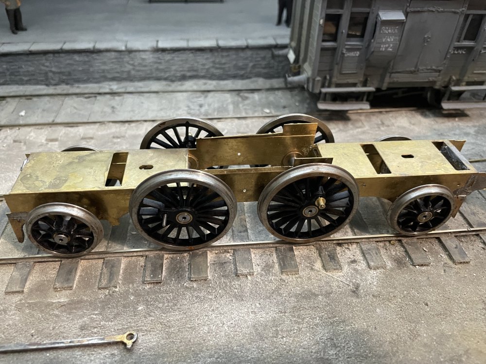

Galteemore Posted January 19 Author Posted January 19 9 hours ago, David Holman said: Yep, looking good. And if it just fits, then it is probably just right! On the original etched boiler spacers it wouldn’t have / they’d been etched too large! Adrian included a ‘revised’ smaller set which the original builder had snipped off the etch (despite not being at that point in the build when he/she stopped construction). Thankfully the ‘PPs Revision’ discs were still in the box of miscellaneous empty etch sheets and random bits of wire…. 2 1 Quote

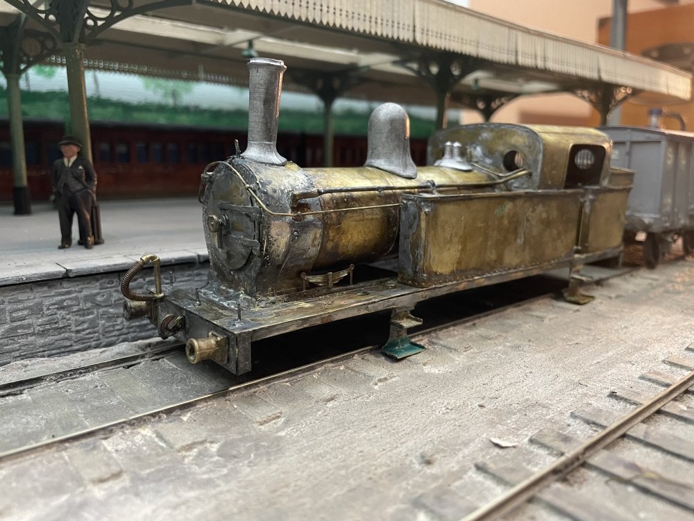

Galteemore Posted February 9 Author Posted February 9 More fettling and fiddling lies ahead but most of the grunt work is done. Lots of scrubbing and cleaning and then we’ll try the primer. That will doubtless reveal all sorts…..something I have already noticed that she droops at the front end, so we’ll have to beef up the bogie spring. 4 4 Quote
Mol_PMB Posted February 9 Posted February 9 Beautiful work! Really captures the lines of the real thing. Will she be blue or black? 1 Quote
