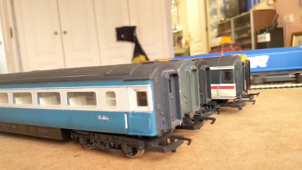

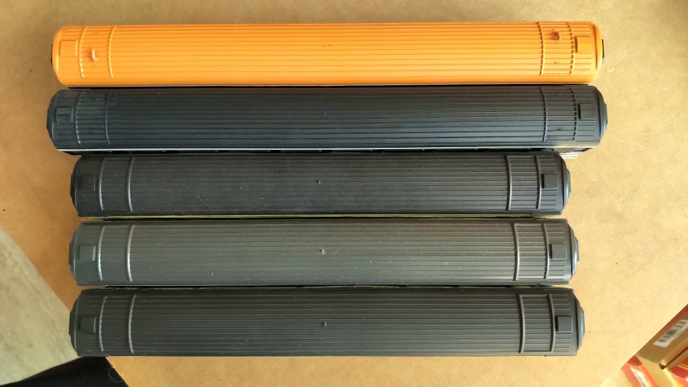

Dempsey Posted November 11, 2019 Share Posted November 11, 2019 On 11/10/2019 at 3:08 PM, DJ Dangerous said: Wow, some gorgeous looking coaches there Dempsey and Past-Avenue! I went to my mechanic and ordered a can of RAL2011, as things like that are not readily available over here. Hope to try some repainting on my day off next week. I used white primer for the lines, satin black and the orange is RAL2011. The decals are from railtec 1 Quote Link to comment Share on other sites More sharing options...

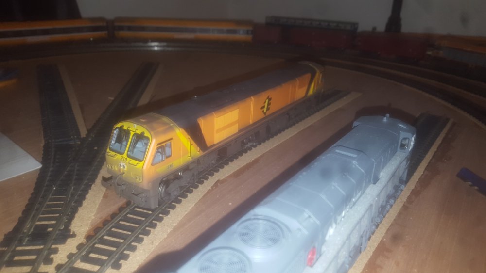

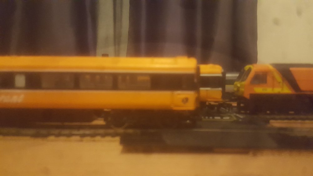

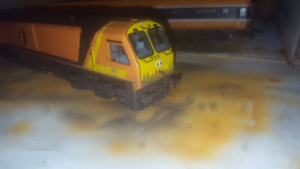

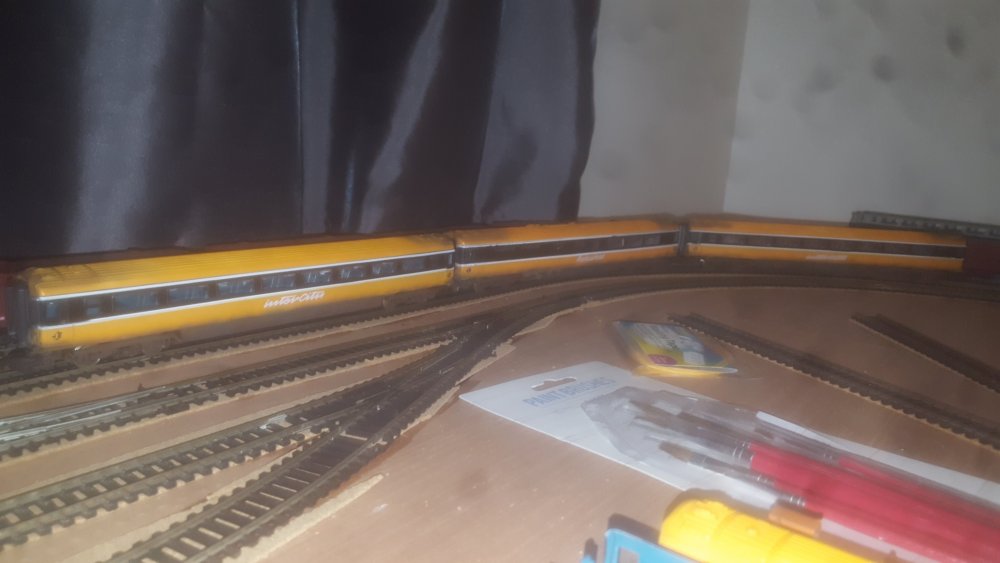

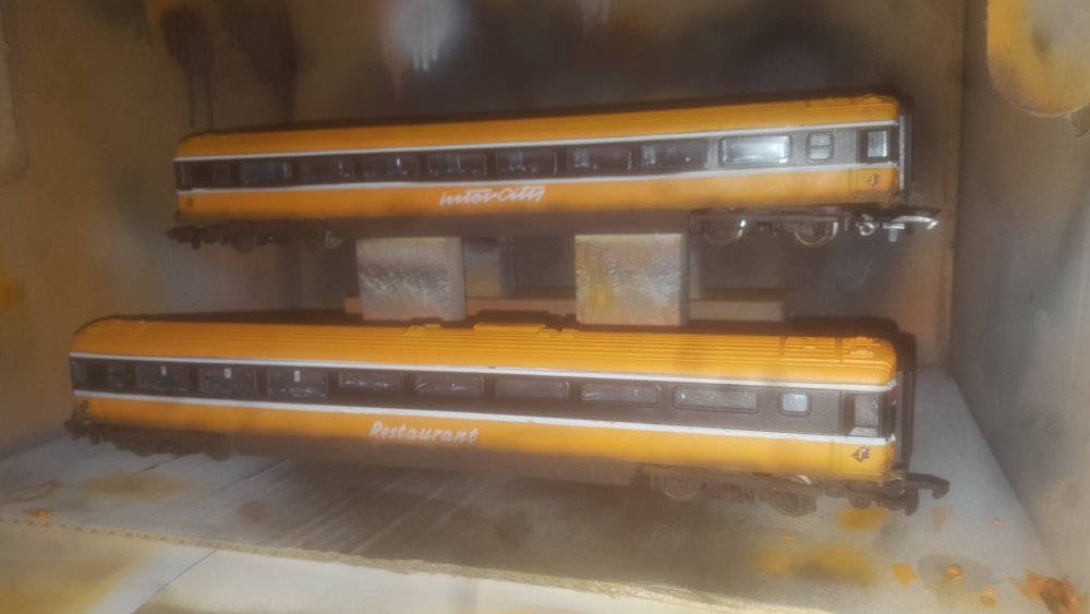

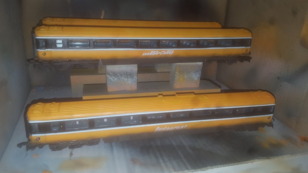

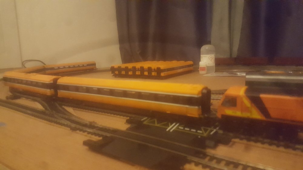

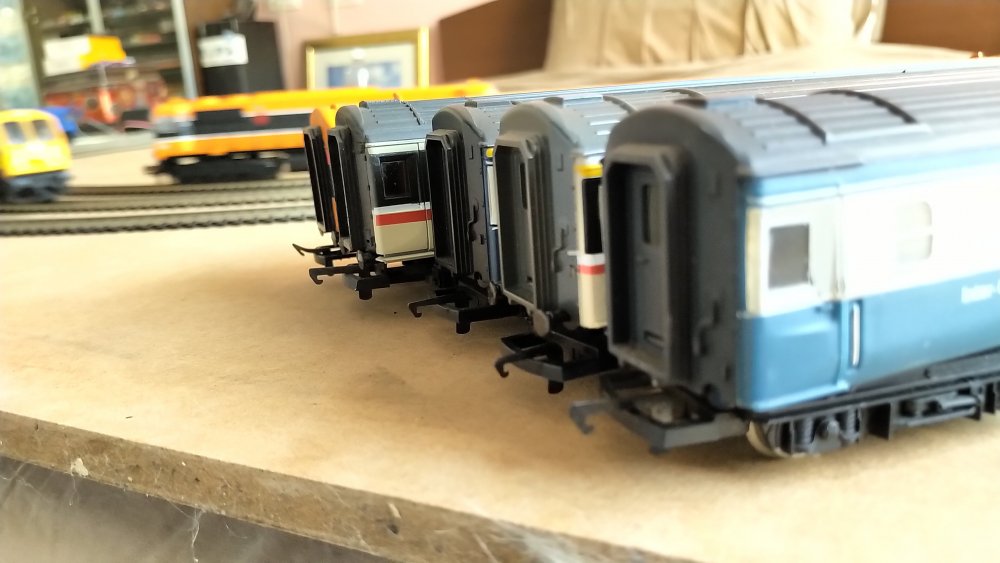

Dempsey Posted December 8, 2019 Share Posted December 8, 2019 The first three in the make shift spray booth i.e. cardboard box. Decals applied and first stage of weathering done. I know it's not for everyone but i personally think it adds to the detail. I'm going for a these couches are not far off needing to visit the wash look. Had some mix left over so thought i'd try a loco so since 210 is going to be hauling this rake i figured i'd give it ago. Thoughts and comments as always appreciated. 2 2 Quote Link to comment Share on other sites More sharing options...
Dempsey Posted December 8, 2019 Share Posted December 8, 2019 Three down, four to go and first attempt at weathering a loco done. 1 Quote Link to comment Share on other sites More sharing options...
