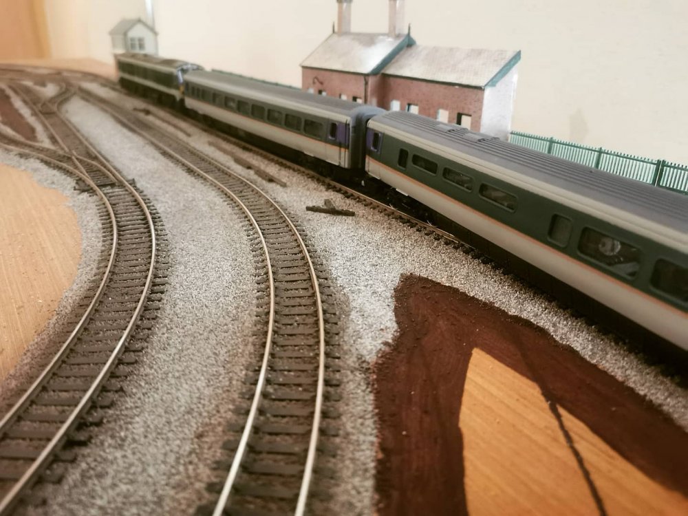

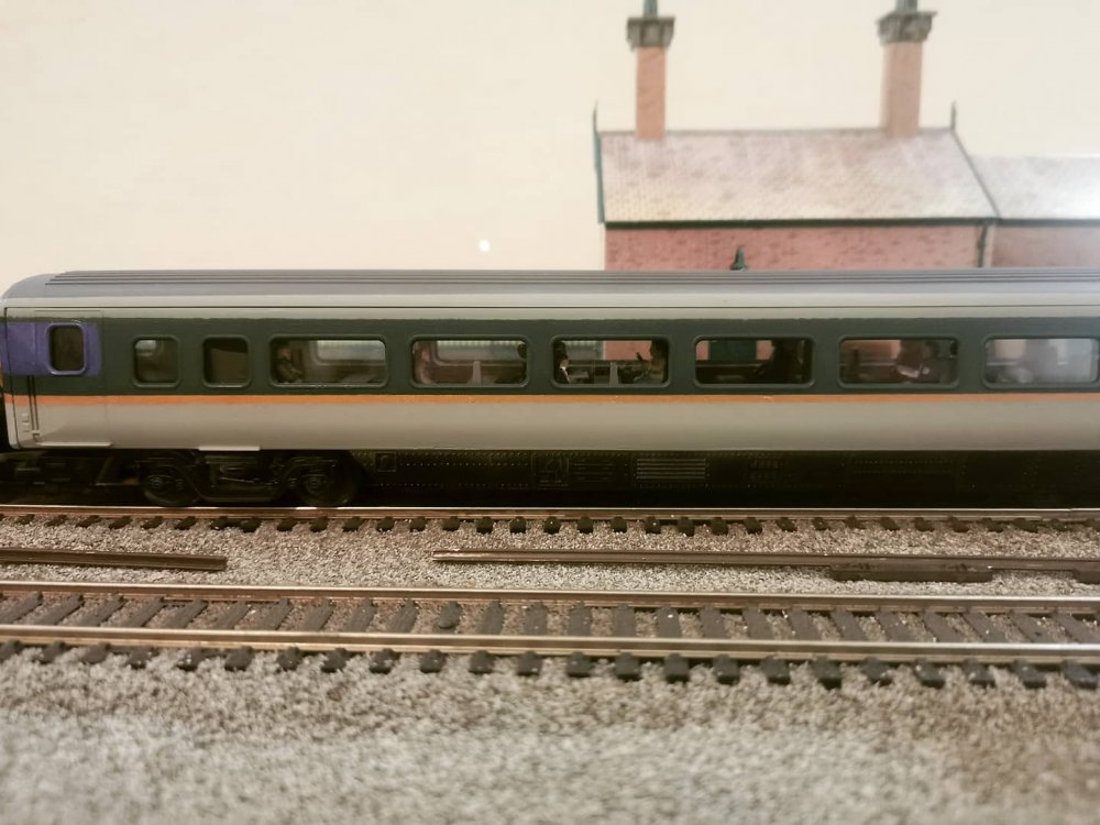

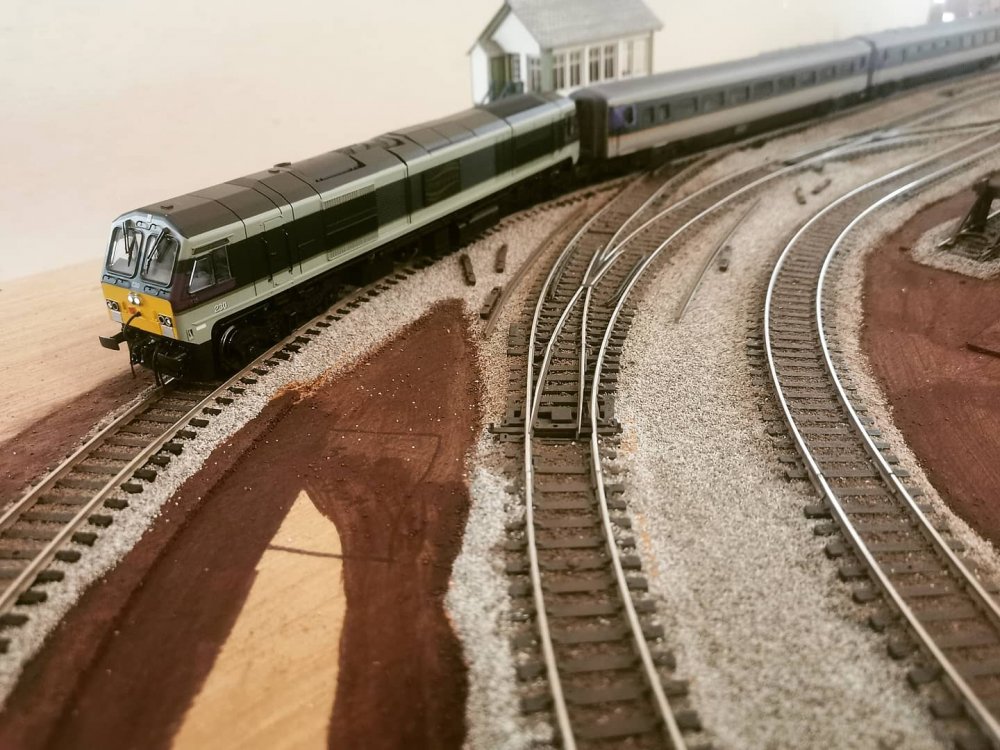

Dempsey Posted March 7, 2021 Author Posted March 7, 2021 Finally no.230 has some matching stock to haul having spent the last few weeks repainting hornby mk4s. Complete with passengers. As always guys I appreciate your feed back and thoughts. VID_20210307_194351.mp4 7 Quote
David Holman Posted March 7, 2021 Posted March 7, 2021 A fine compliment to that well laid track! 1 Quote
JasonB Posted March 7, 2021 Posted March 7, 2021 Have to admit, I've never really liked that livery. Fan or not, that's an excellent paint job. 2 Quote
Rob Posted March 7, 2021 Posted March 7, 2021 Looks excellent- really good. Got it just right so the result is spot on- as always. Brilliant 1 Quote

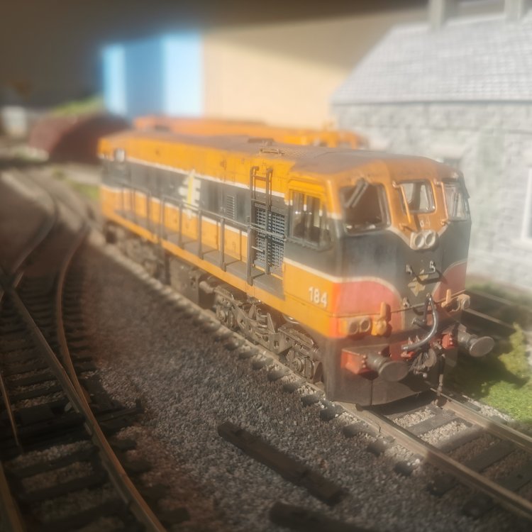

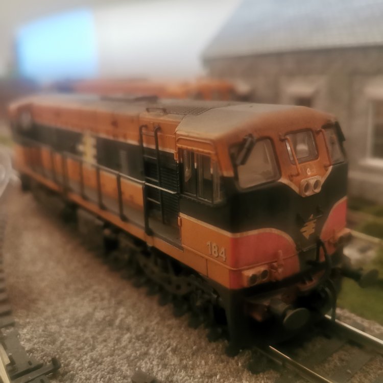

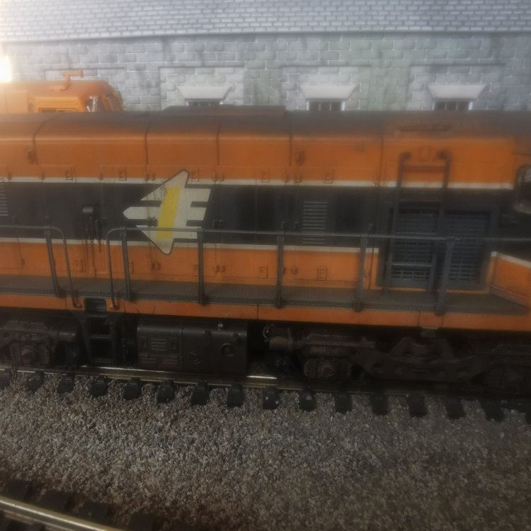

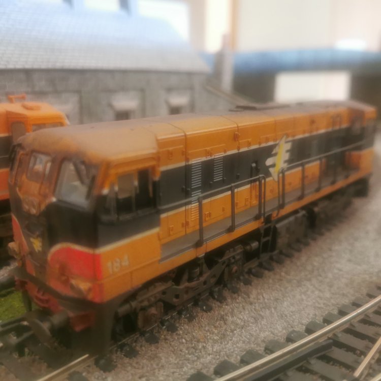

Dempsey Posted June 4, 2021 Author Posted June 4, 2021 The latest edition to the fleet no.184 found itself in the weathering line. My goal was to give the paint more of distressed look as opposed to a more filthy appearance and to push myself more and more with weathering. Your thoughts and comments as always are appreciated 13 Quote
popeye Posted June 4, 2021 Posted June 4, 2021 Nicely done, but images look a little misty, is your lens clean? 1 Quote
murphaph Posted June 4, 2021 Posted June 4, 2021 Maybe take a pic of the roof? That's the bit you tend to see most of as a modeller. Nice work Whenever I build up the courage to weather my MM IE stock that's the sort of look I'll be going for. Dirty but not as manky as the IR stuff. 1 Quote
Dempsey Posted June 4, 2021 Author Posted June 4, 2021 38 minutes ago, popeye said: Nicely done, but images look a little misty, is your lens clean? It was an awkward angle to take the pictures from. 5 minutes ago, murphaph said: Maybe take a pic of the roof? That's the bit you tend to see most of as a modeller. Nice work Whenever I build up the courage to weather my MM IE stock that's the sort of look I'll be going for. Dirty but not as manky as the IR stuff. As requested. I do offer that service if you don't feel comfortable weathering yourself 8 Quote
Rob Posted June 4, 2021 Posted June 4, 2021 Looks excellent- not over done. I think you have nailed it!!! 1 Quote
Dempsey Posted June 4, 2021 Author Posted June 4, 2021 27 minutes ago, Rob said: Looks excellent- not over done. I think you have nailed it!!! Many thanks rob Quote
JasonB Posted June 24, 2021 Posted June 24, 2021 On 4/6/2021 at 9:11 AM, Dempsey said: Impressive. Less is more, as the saying goes. 2 Quote
Dempsey Posted June 24, 2021 Author Posted June 24, 2021 26 minutes ago, JasonB said: Impressive. Less is more, as the saying goes. Thank you as always Quote

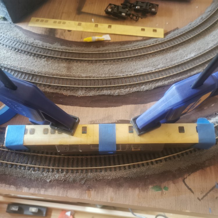

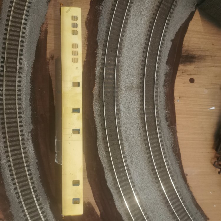

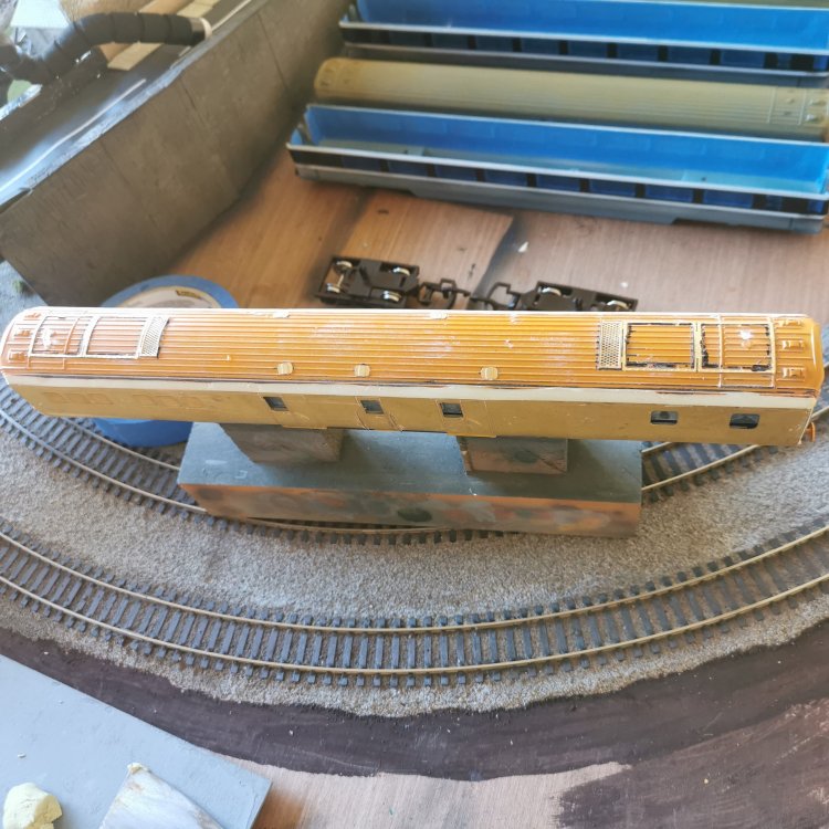

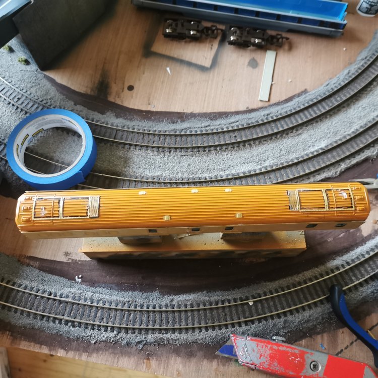

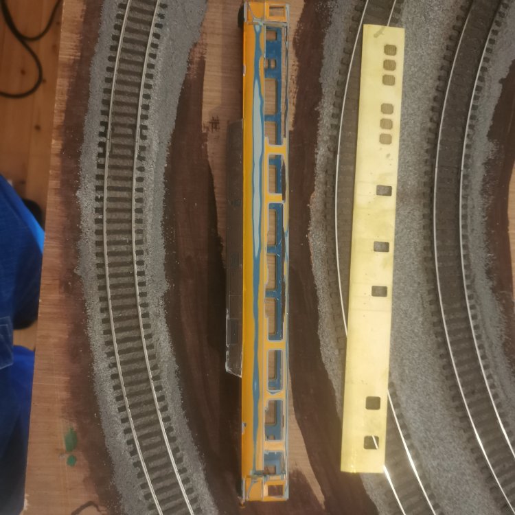

Dempsey Posted June 28, 2021 Author Posted June 28, 2021 Work has begun on my EGV kit from scale studio models. After cutting away parts on the donor coach which blocked are partly covered the brass overlay windows. The overlays themselves were then glued to the bodyside. 4 Quote

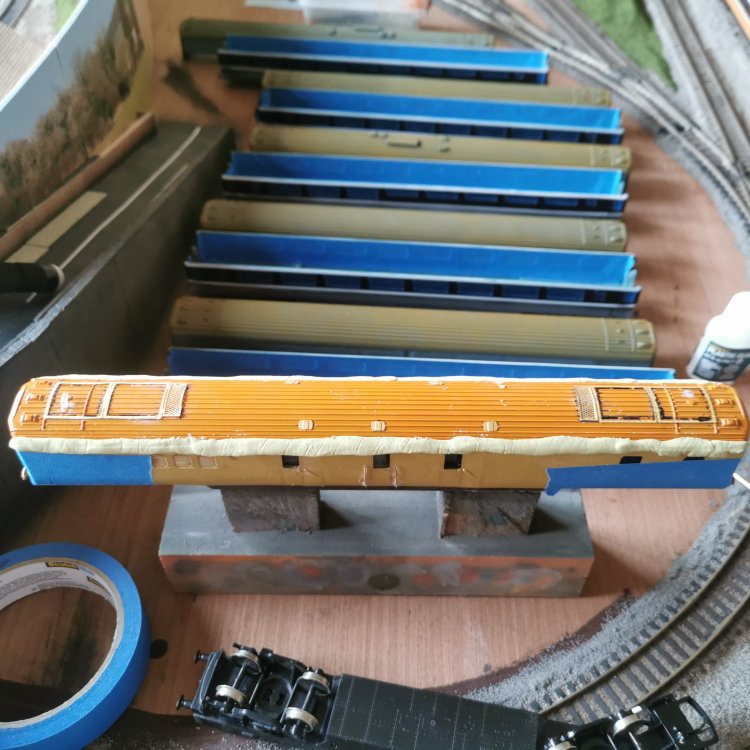

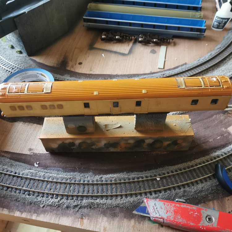

Dempsey Posted July 13, 2021 Author Posted July 13, 2021 Overall lessons learnt so far on my first attempt at this kit. 1. Patience - not that I rush it but as I wasn't using the recommended hornby or lima mark 3 coaches because i didnt have one I had to plan around how the coach came after and went back together. I could have given this more time as this forced me to jump some steps or do other sooner then was intended. 2. Milliput - using this for the first time on a project. In some areas i put too much and in others not enough which became apparent when primer was applied after sanding. I think starting in small amounts and slowly building it up would have been better. 3. Glue - too much on some parts not enough on others. In the areas with too much it can be seen through the paint as a raised lump. These are my main take aways for anyone looking at giving it ago. I enjoyed the process and thought the kit very good and this was a good learning experience for the others I will be planning on building in the future. Thanks Chris 10 Quote
Robert Shrives Posted July 13, 2021 Posted July 13, 2021 That is coming long very nicely , getting a good fix and blending what is a "mixed media" kit is a skill. The roof details for access of the gen sets looks very good. Thanks for showing Robert 3 Quote
JasonB Posted July 17, 2021 Posted July 17, 2021 On 13/7/2021 at 8:17 PM, Dempsey said: Good stuff. Can't beat a bit of old school modelling. 3 Quote

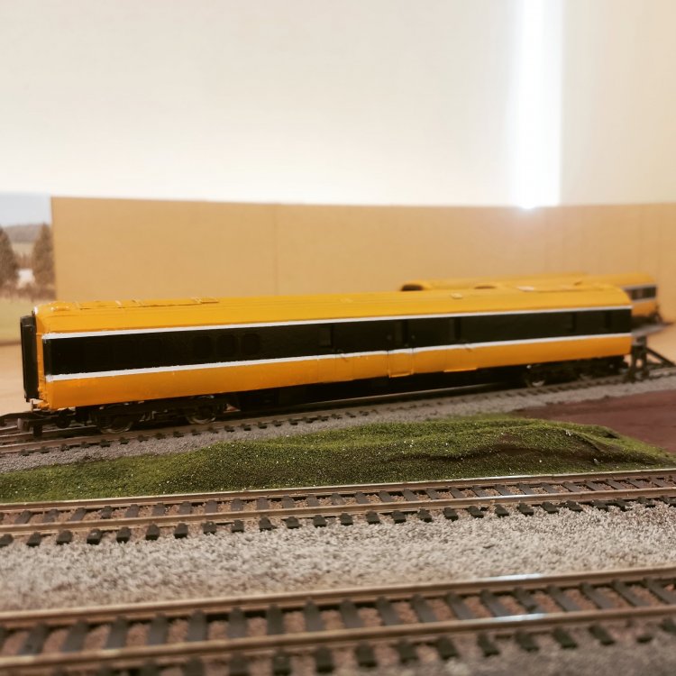

Dempsey Posted July 24, 2021 Author Posted July 24, 2021 Minus decals and weathering for now. Alot of lessons learned on this for the next time. Your thoughts as always are appreciated guys. 9 Quote
murphaph Posted July 24, 2021 Posted July 24, 2021 Nice work. I learned a lot from looking at @Noel 's Paintshop thread and @Georgeconna gave me valuable pointers on this livery too. I'll try to pass on some of what I've learned in the past few weeks as a total newcomer to this painting lark. It looks like you're spraying the white on last. I suggest you spray a white pigmented primer over the whole body first, then use good quality (eg Tamiya) 1mm masking tape to mask off the white stripes, then spray the orange, then mask off the rest. Leave the 1mm tape on, lay the lower and upper edges respectively if your upper and lower masking for the black band directly over the centre line of the 1mm tape. It's easier than it sounds. Then spray your black band and start removing masking tape asap in reverse order The last thing to come off will be the white stripe tape. Burnish the edges of your masking tape with the tip of a cocktail stick. If you take time doing this, you can eliminate bleed. Work the tape well into door shuts etc. What orange did you use? It looks well. Are you spraying with an airbrush or rattle cans? 2 Quote
Dempsey Posted July 24, 2021 Author Posted July 24, 2021 I normally do reverse masking as I've done on my repainted rakes of mk3s. Was trying something new for my own experience more then anything. As this was my first time building the kit I used it more as a way to experiment. Never the less thank you and I've been following your thread and the work on those mk2s are excellent. 2 Quote
Dempsey Posted July 24, 2021 Author Posted July 24, 2021 (edited) Also in addition to your point for anyone looking to try their hand at repainting, putting down the white first as even a primer layer helps give the orange a brighter look. I use Ral 2011 through an airbrush. Edited July 24, 2021 by Dempsey 3 Quote

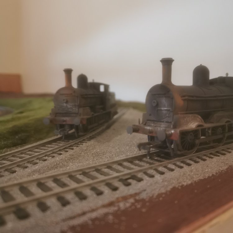

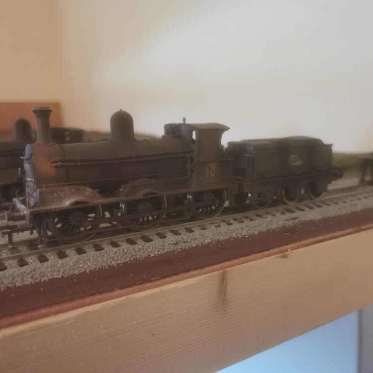

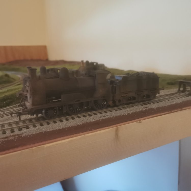

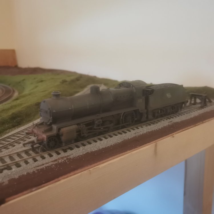

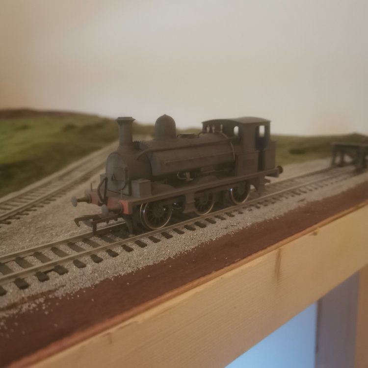

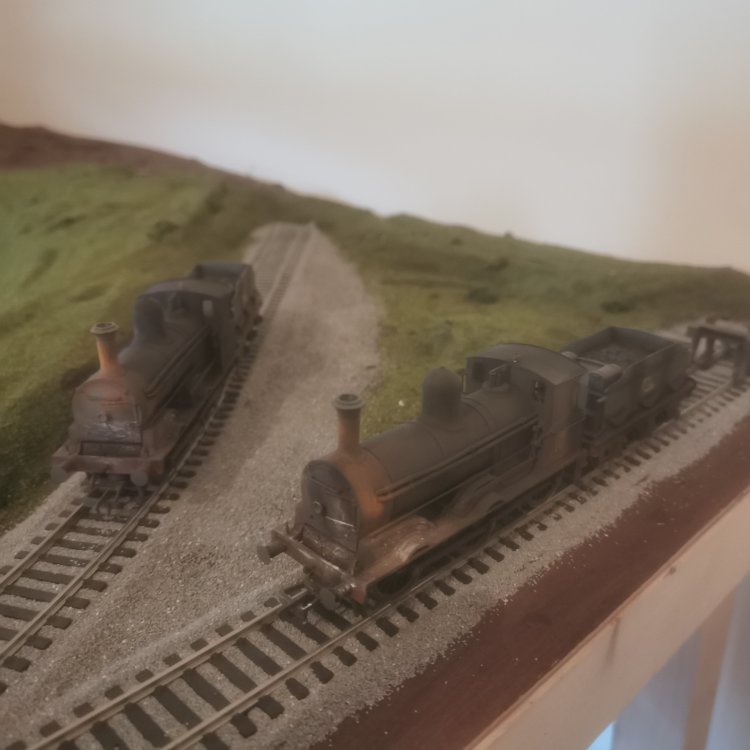

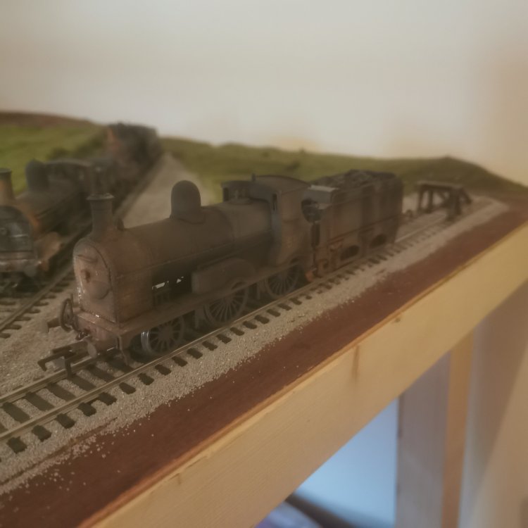

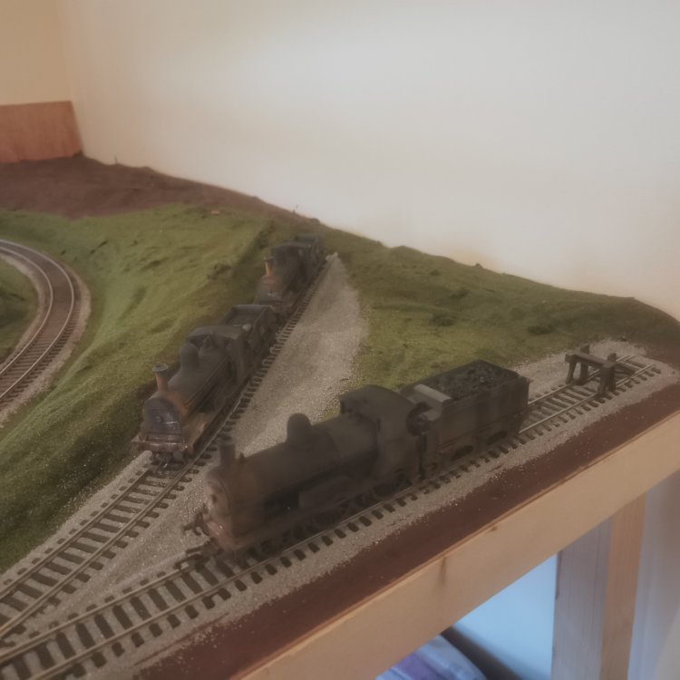

Dempsey Posted October 12, 2021 Author Posted October 12, 2021 I recently had the opportunity to try my hand at weathering various steam locomotives for the first time. Yoir thoughts as always are appreciated. 12 Quote
jhb171achill Posted October 12, 2021 Posted October 12, 2021 That looks PURE 1961! This actually shows up very well how a grey-painted model ends up with realistic coal dust, oil and soot weathering. Many people thought that most engines were black - I did myself as a mere spotty teen - in late CIE days; in fact only a few were, if they'd seen a paintbrush literally within the last five years or so of steam. Not many did - but they all ended up looking exactly like this, as numerous photos show in numerous books, and an ever-decreasing handful of us remember. After all, it's 58 years since steam ended on CIE, and some SEVENTY years before the AEC railcars largely displaced it from main line passenger trains.... The green Woolwich is exactly as many of the green engines ended up - so disgracefully grubby that it was actually not easy to tell whether they were green, grey or black under it. Excellent job, Dempsey; beautifully filthy, decrepit and untidy looking locos - thus, highly recommended! 5 Quote
Rob Posted October 12, 2021 Posted October 12, 2021 They look excellent to me- not an expert on things steam but those photos look excellent 3 Quote
David Holman Posted October 13, 2021 Posted October 13, 2021 Good stuff, poor things! As JB says, once the writing was on the wall, few bothered about cleaning steam locos, it was only about keeping them running. Given their use of such a dirty fuel, it doesn't take long for a coat of grime to appear and maybe because I'm old enough to remember the end of steam, I actually find weathered locos attractive. I think a coat of grime can serve to highlight certain features, while the initial cost of black or grey often does the opposite. Either way, nicely done. 4 Quote
JasonB Posted October 23, 2021 Posted October 23, 2021 On 12/10/2021 at 9:31 PM, Dempsey said: I recently had the opportunity to try my hand at weathering various steam locomotives for the first time. Yoir thoughts as always are appreciated. I have no interest in steam whatsoever if I'm honest. Even so, that's a great job. 3 Quote

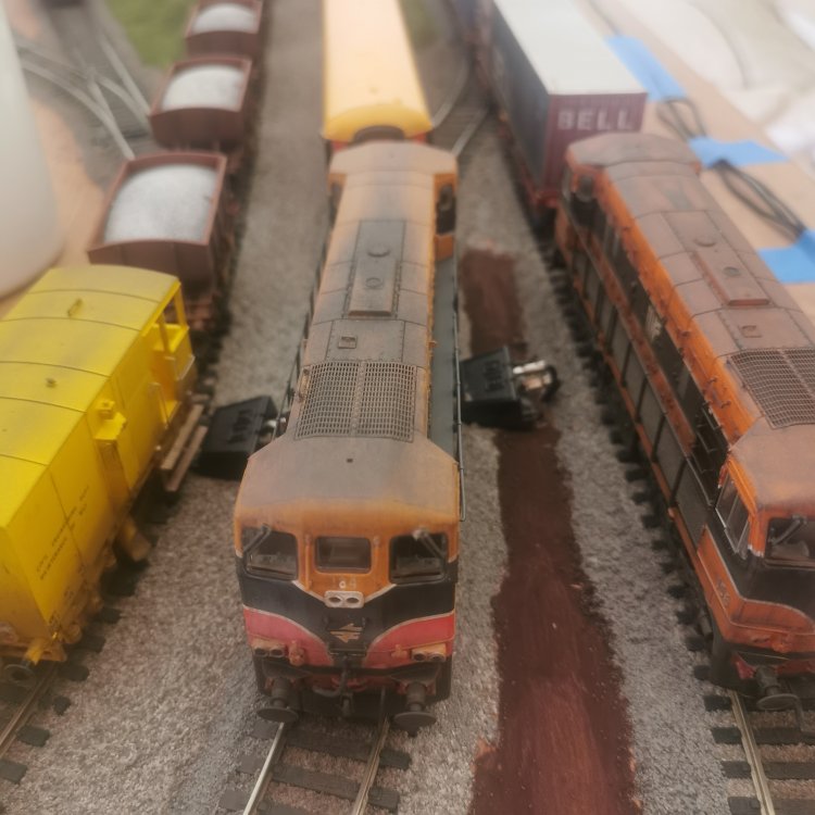

Dempsey Posted December 28, 2021 Author Posted December 28, 2021 080 got the good news over the Christmas break and 210 got some work done removing some of my early attempts at weathering. 085 is currently on the work bench receiving some work to help with that factory weathering. As always your thoughts are appreciated. 9 2 Quote
Galteemore Posted December 28, 2021 Posted December 28, 2021 080 looks fab. Just as I remember them 1 Quote
