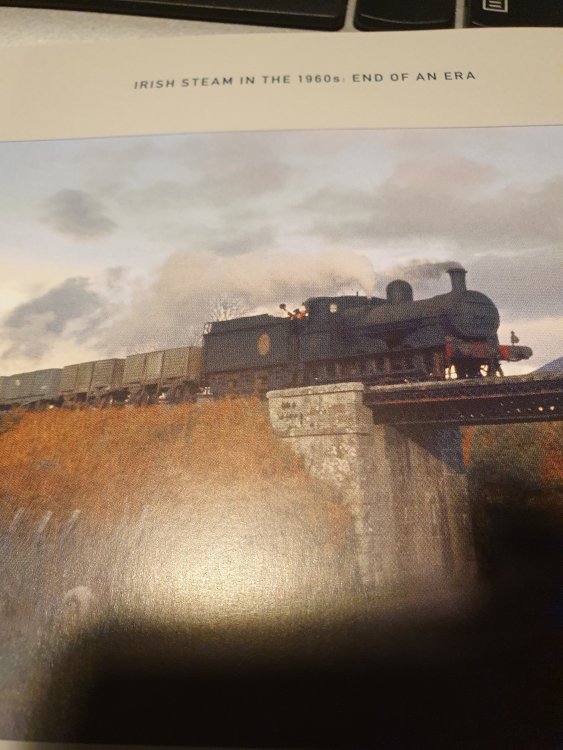

From Conrad Natzio's Irish Steam in the 1960s.....
He mentions that j15 No197 had been subject to a further oil burner trial as late as 1954....most of the others had been during the "emergency "...but converted back to coal afterwards.....
Below is no197 back burning coal in early 60s on a beet run to Palace East....
The tender sides and smokebox doors had large white circles painted on them.
No tank engines were treated thus as far as I am aware.
The white circles were an indication to the signalman that it was a oil burner and wouldn't get stuck mid section bailing out a bad fire.

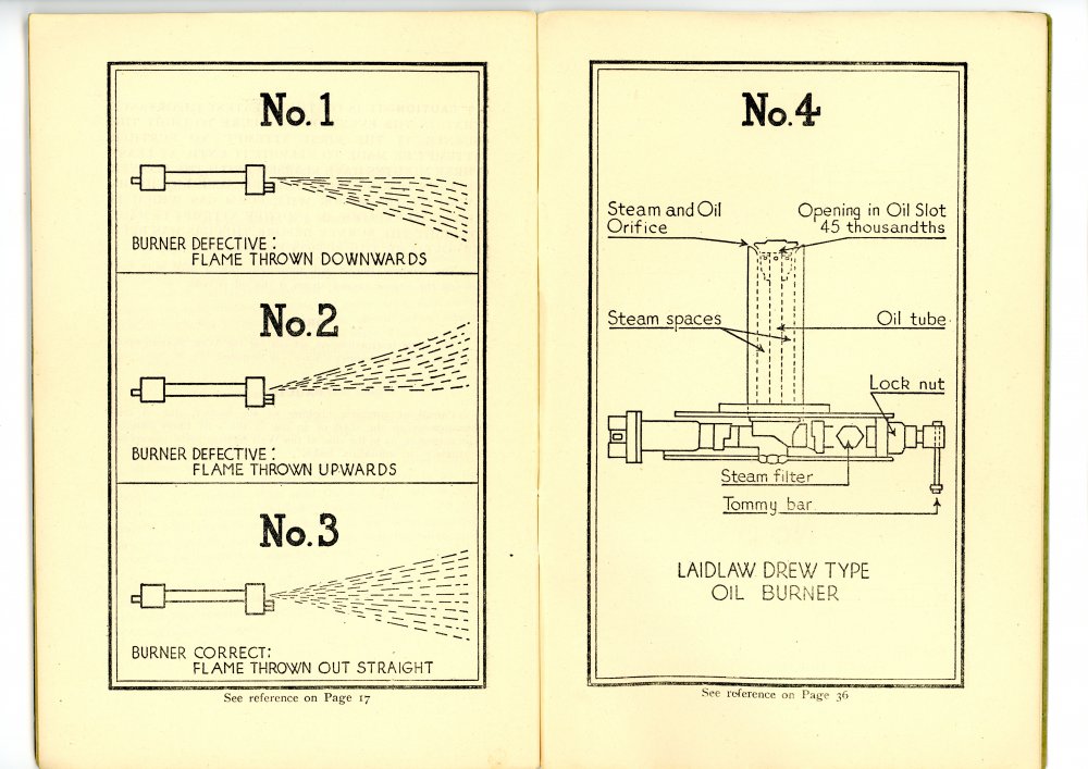

The Laidlaw-Drew burner is the same type used by the Festiniog Rly in its oil burning days, the burner was fixed vertically in the middle of the firebox with a machined saucer shape on the burner end which sprayed the oil out and a swirler caused the resulting fuel mist to rotate. The result was better fuel mixing with the combustion air coming through the pan plate which in effect replaced the ashpan. The firebox  mod's were refactory concrete in the pan plate and cast refactory concrete slabs to protect the firebox foundation ring and the bottom10/12" of the firebox.
  Be interesting to know how the burner was positioned in CIE loco's.
