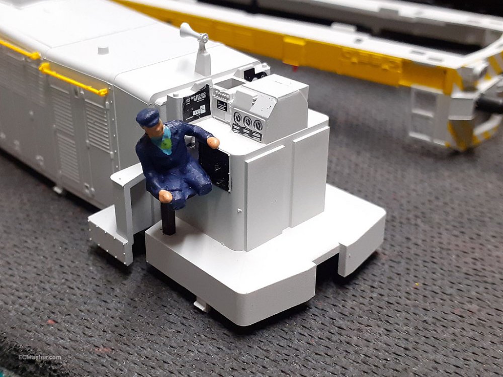

  3. The model is now complete. The cab window frames and glazing were finally installed after the body was given two coats of satin lacquer. The lads posing again! Then final assembly to take a run on the rolling road. I'll post up a short video soon. Eoin
