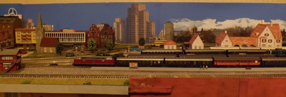

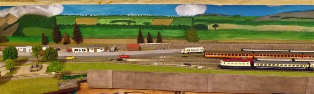

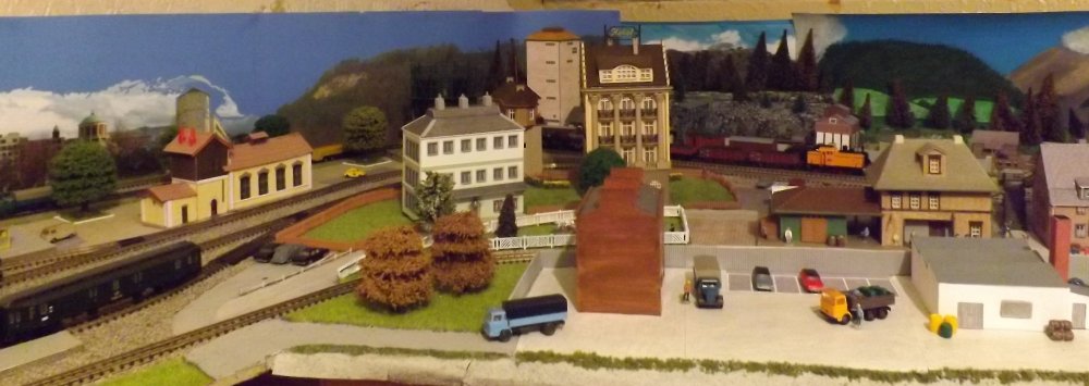

MikeO Posted June 5, 2021 Posted June 5, 2021 (edited) Both DiveController, Rob and DJ Dangerous have made a lot of good suggestions. I model Irish and German N Gauge. Changing to N Gauge will involve much more expense. There are lots of RTR British, European and American N Gauge stock, buildings and scenery available. There are no Irish RTR stock you would need to buy other suitable RTR stock and convert them. While N Gauge is roughly half the size of OO the advantage is that you can run longer trains. However you will still have to make compromises as to what you include on your layout in terms of sidings and buildings and where they can be positioned. Even in N Gauge things are still going to be fairly close together. By way of illustration I am including 3 photos of my German layout. This is my second revision which does not fully meets my needs so I will have to expand it again. Edited June 5, 2021 by MikeO 3 Quote

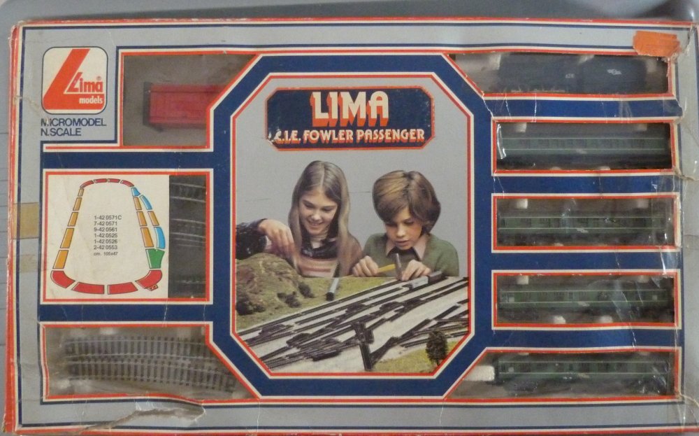

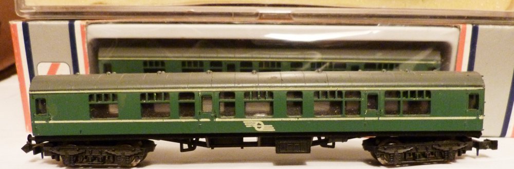

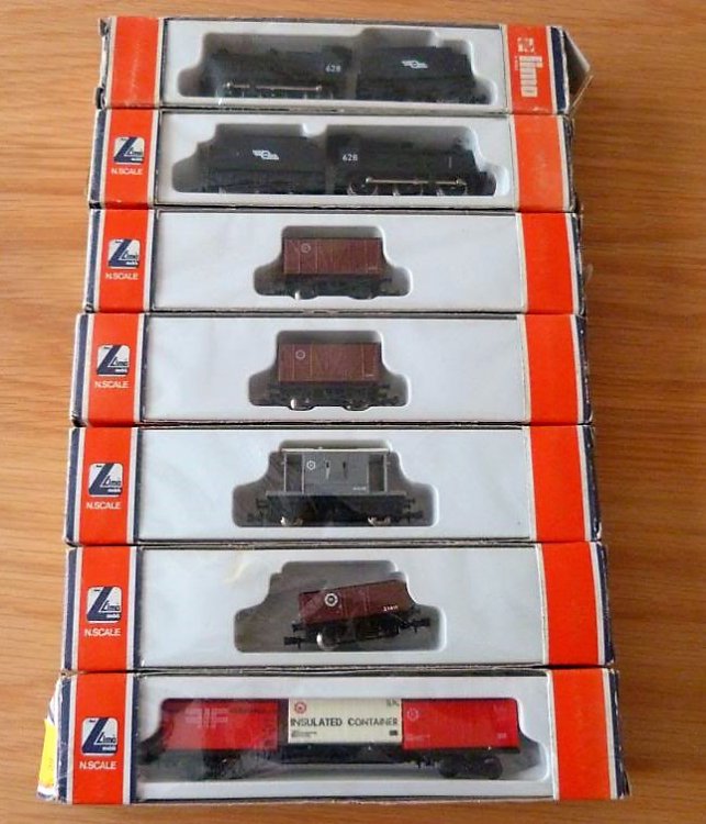

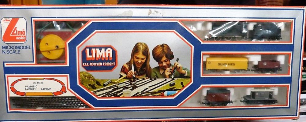

WRENNEIRE Posted June 5, 2021 Posted June 5, 2021 Although not prototypical there is a small, and expensive, amount of Irish RTR stock available, but it is very hard to pick up. 2 1 Quote

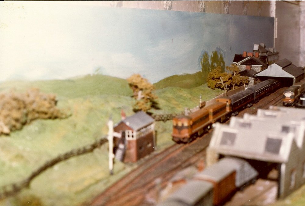

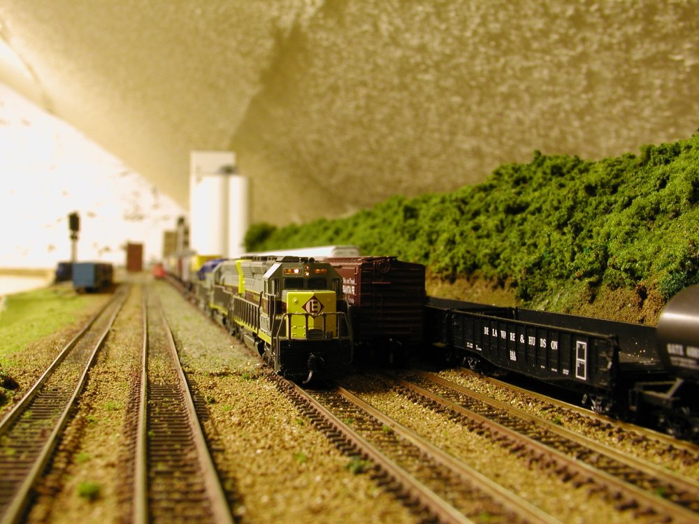

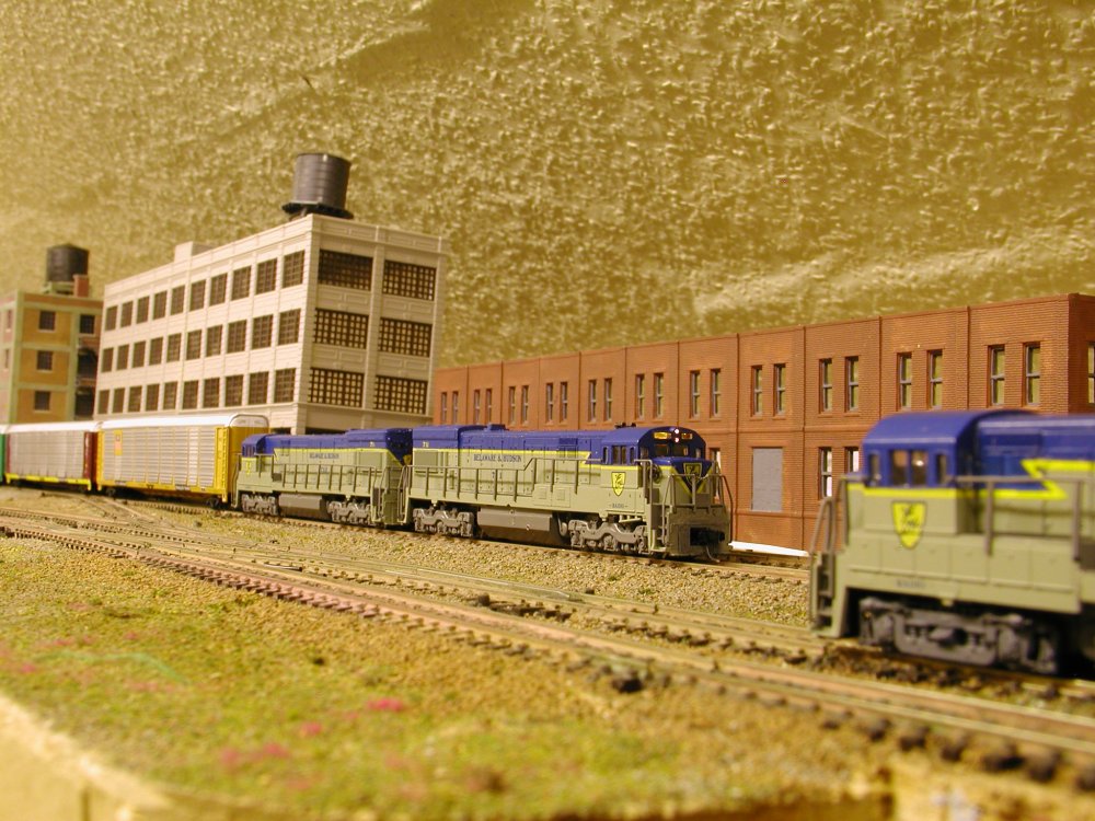

Mayner Posted June 6, 2021 Posted June 6, 2021 I downsized from OO to N in my late teens as it was a better option for building a realistic layout in a restricted space than OO and built a U shaped end to end layout in my bedroom which was approx. 11X11. I had struggled to fit a similar OO gauge layout into an 8X6 box room and was not happy with the crammed in effect with 2' radius curves and short train lengths, 18" radius in N is the equivalent of 3' in OO , it was easier to fit station layouts without major compression into the available space and I could run longer trains. Originally I focused on modelling Irish buildings and structures running British locos and stock, but eventually began re-painting and modifying rtr locos and stock and ended up with several Irish diesels which passed the 2' rule. I abandoned the Irish N Gauge layout as a result of a house move and focused more on building locos or stock in 4mm as I did not have an opportunity to build a layout for another 20 years. Although my main interest is Irish modelling, I started collecting American N gauge during the late 1980s and eventually built a looped 8 N gauge layout in the 17'X8' loft of our house in Dublin and started work on an American style walk-round layout in a 24X12 converted garage following a move to New Zealand in 2004. My N gauge layouts were fairly short lived on average 2-3 years usually as a result of a house move or change in circumstances, but were thoroughly satisfying both in terms of the realistic appearance and operation modelling the railway rather than focusing narrowly on the locos and stock. These days I work mainly in large scale with a 1:20.3 American garden layout and Irish modelling in 4mm, but I still retain my collection of N gauge American locos and stock. For an operating railway I would avoid the Lima Irish N gauge locos as I found from bitter experience the locos were unreliable with poor power pick up and motor quality even by the standards of the 1970s & 80s though the coaches and wagons were ok Irish N gauge layout c1980 pair of 121s kitbashed from Atlas SW1500 switchers hauling repainted Minitrix BR coaches. Terminus station c1980 Station with allover roof based on Foynes, background buildings from sketchbook on Irish architecture, GSWR style sawtooth loco shed American N c 2005 yard module re-located to New Zealand American layout final Dublin op session Apl 2004 before re-loacting 6 Quote

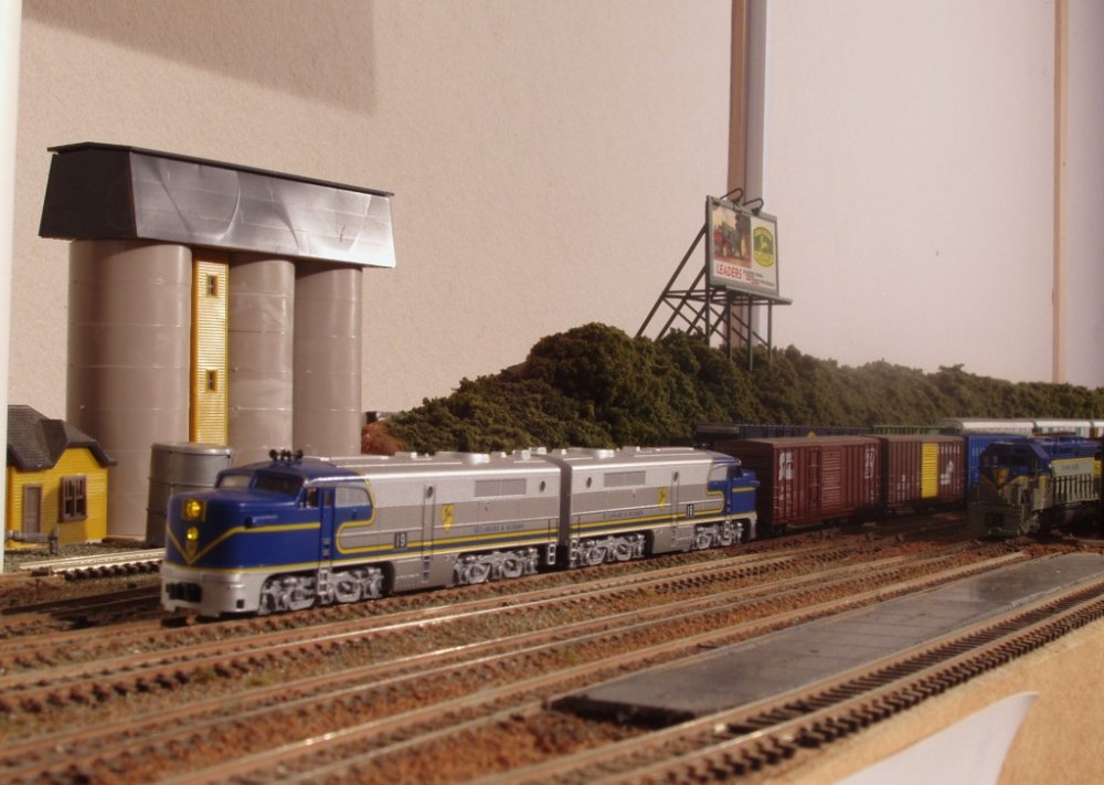

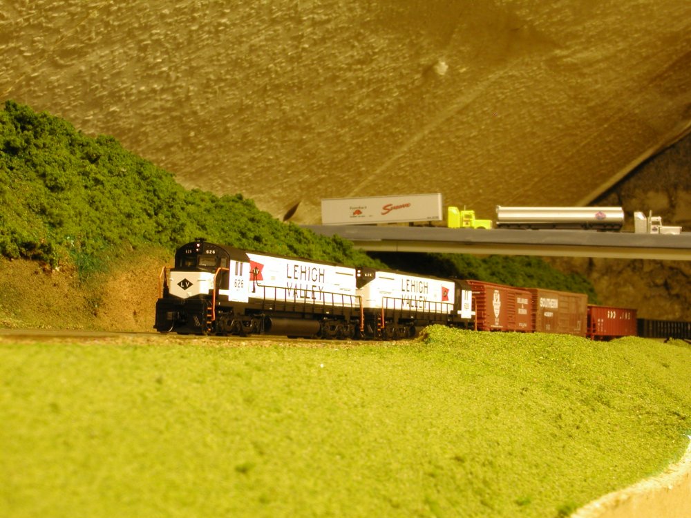

Mayner Posted June 13, 2021 Posted June 13, 2021 American outline is probably a better option than British if you start modelling in N very large range of relatively inexpensive locos, stock and buildings from a large number of manufacturers including Atlas, Kato, Walthers, Intermountain and Micro trains, most DC locos are supplied DCC ready if you want to convert to DCC at a later stage. The scale gauge ratio is correct and perhaps most importantly the majority of American N Gauge locos and stock are fitted with knuckle couplers suitable for magnetic uncoupling. I found that I could get an American layout up and running very quickly, building 12" wide shelf modules based on the One Trak system which started as a self contained switching layout that was later incorporated into the main yard on an attic layout. 7 Quote
