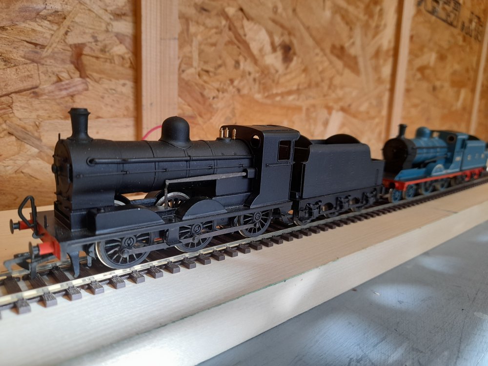

GNRi1959 Posted October 12, 2021 Author Posted October 12, 2021 (edited) The GNRi UG and his big brother the U Class on a bit of test track. Out of their boxes for the first time in a couple of years and running like a dream. Some new rolling stock arriving this week to get me started again. Edited October 12, 2021 by GNRi1959 9 Quote

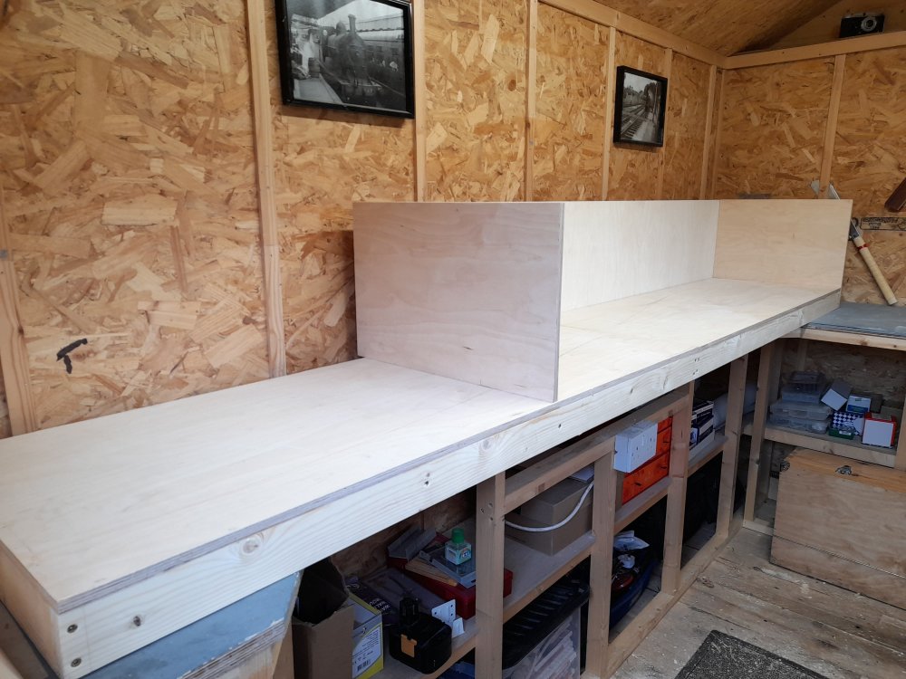

GNRi1959 Posted October 28, 2021 Author Posted October 28, 2021 (edited) Here is the baseboard, almost complete. I have marked a rough pencil guideline on top and hope to order track soon. The fiddle yard section is 700mm and the remainder 1.8mts. Edited October 28, 2021 by GNRi1959 7 Quote
StevieB Posted October 29, 2021 Posted October 29, 2021 Fast and tidy work. Looking good. Stephen Quote

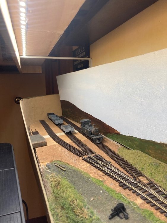

Galteemore Posted November 2, 2021 Posted November 2, 2021 (edited) Use a view block like a building at front of the layout - that will help disguise the transition. Here’s an old N gauge layout I built. You can see how the factory essentially distracts from the line exiting stage left The same principle was used on my 7mm layout - seen here under construction. The white building essentially disguises the brake van about to leave ….even a siding with a wagon strategically parked can work. Edited November 2, 2021 by Galteemore 1 Quote

Galteemore Posted November 3, 2021 Posted November 3, 2021 (edited) 3 minutes ago, GNRi1959 said: Great idea, I think there is a goods store I can use, what do your actual opening look like them, if you don’t mind Here you go. Note how the holes are only as big as they need to be, and how the skyline is higher than the holes. This is an old Richard Chown dodge / a ‘hole’ in landscape strikes the eyes as less odd than a hole in the sky! The layout is built to be viewed side on so this area is designed to be within peripheral vision and not viewed full on like this! Edited November 3, 2021 by Galteemore 3 Quote
